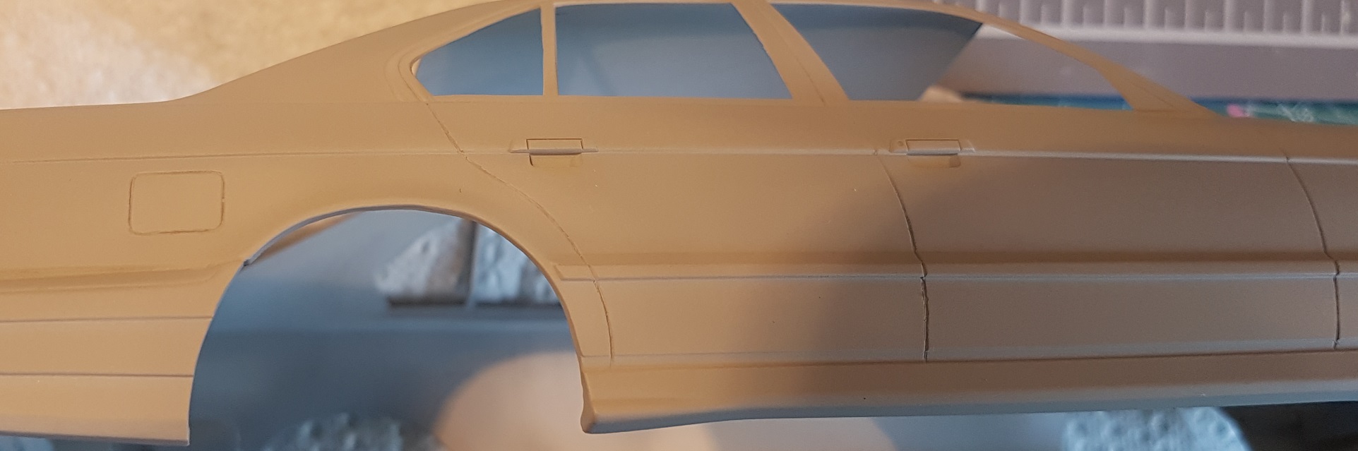

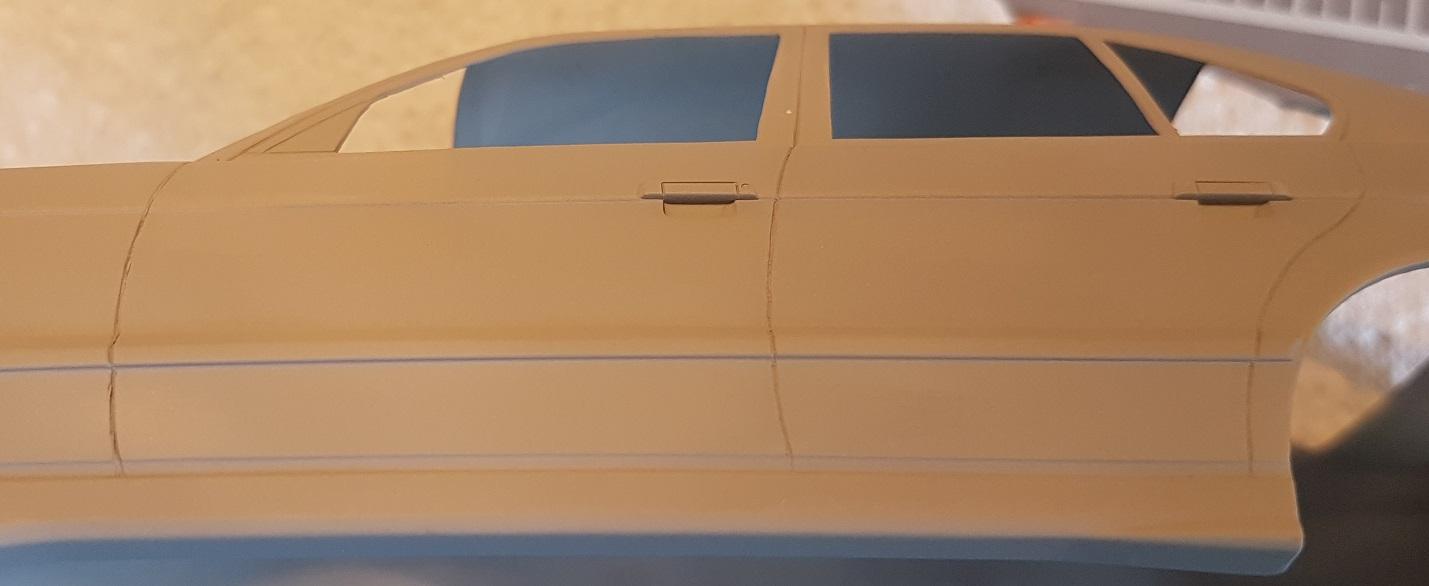

Funkychiken Posted August 6, 2017 Posted August 6, 2017 Hi All, I hope someone can help me, there are lots of tips, tutes etc that suggest one can deepen a panel line by "using the back of a hobby knife". I had never really tried it, as when I had, it is nigh on impossible to keep the blade in the "groove" (obviously there isn't much of a groove - that's why i'm trying to deepen it) and I used to end up cutting outside the panel lines so much, that it ruins the body - it's quite difficult to use filler to fill an incorrectly cut groove - right next to where a panel line is. Anyway, I digress, I tried to do it more recently, but the result is terrible. please see photos, is there at technique or method or video of it being done properly? what am I doing so wrong to get it so bad...? thanks...!
Snake45 Posted August 6, 2017 Posted August 6, 2017 I use the back of an old Xacto blade and I guess the secret to success is experience. I start a groove very lightly and don't use much pressure until I've established a real groove for the blade to follow. Push too hard too early and as you know, the blade can jump out and scratch where you don't want it. I'd estimate it takes 30 or 40 strokes to get a properly deepened groove--maybe even more. Scratches are more easily filled with superglue than with putty. Keep trying--the results are MORE than worth the effort. Soon you too will be looking down on modelers who don't take the time to do this extremely important step (IMHO).

astroracer Posted August 7, 2017 Posted August 7, 2017 (edited) Like most modelers I also use the back side of a broken hobby blade. What I do different is outline the door line with fine line tape. The tape will help guide the blade if you go easy. You can do one or both sides if the lines are mostly straight and do both sides if curvy, as in your case.Outline your doorlines then, like Snake said, go VERY lightly until you get a consistant groove going. If I am doing a master and moving door lines I will make a cardstock template of the door and tape that in place to use as a guide.Mark Edited August 7, 2017 by astroracer

Jon Haigwood Posted August 8, 2017 Posted August 8, 2017 You might try angling the blade back to help stay in the groove util you establish a deeper groove.
