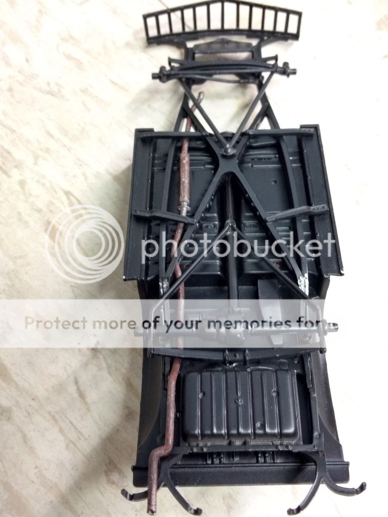

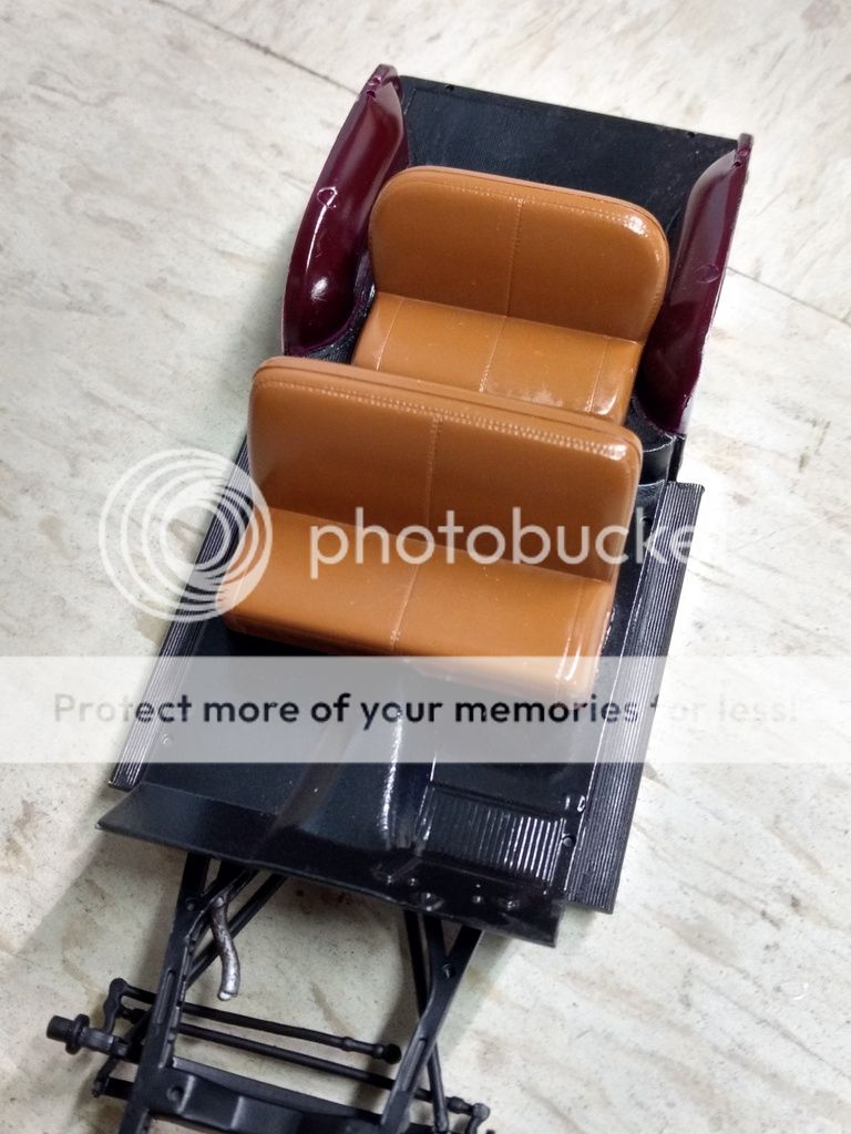

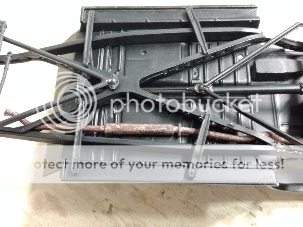

Modlbldr Posted November 10, 2017 Author Posted November 10, 2017 Moving along. Began painting the rack. http:// Got the seats installed. http:// Got the exhaust painted and installed with the suspension parts. Just need to detail paint the chassis. http:// http:// I'm taking this home for the weekend to, hopefully, get to work on it a bit more. Later-

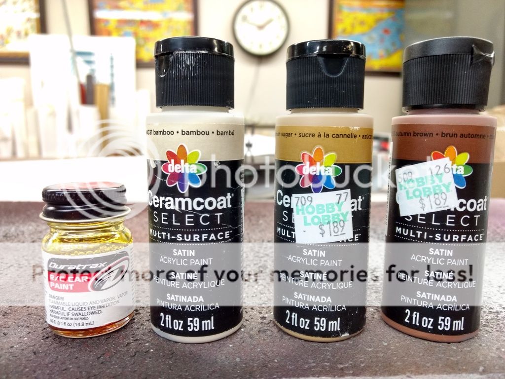

Modlbldr Posted November 10, 2017 Author Posted November 10, 2017 Here is what I used for this wood. http:// Left to Right is: Duratrax R/C paint "Candy Yellow", Ceramcoat satin Craft paint "Bamboo", "Cinnamon Sugar" and "Autumn Brown". I started with brushing a coat of the Candy Yellow and then a coat of the Bamboo. After that I dry brushed the Cinnamon Sugar and Autumn Brown a bit. At that point it didn't look right so I went back and dry brushed the Bamboo a bit more. It took about three rounds like that then finishing it up with a final light dry brushing of the Bamboo. I have to say that it really didn't look right to me until I taped off around the finished area. That's when it looked right to me because I wasn't seeing the unpainted white plastic around the painted area. What I mean is that the tape helped with tricking my mind into seeing the finished product. I hope this helps. I have to say that this is too light for what I want. I may try painting over the entire thing with a bit of clear orange to try to make it darker. If that works then I think I'll go with it. Later-

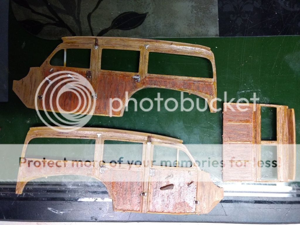

Modlbldr Posted November 17, 2017 Author Posted November 17, 2017 I finally finished the paint on the framework. Next is to paint the panels and install. http:// http:// http:// http:// Slow progress, but it is progress. Later-

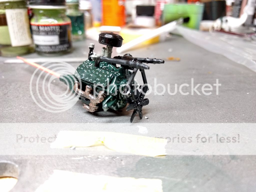

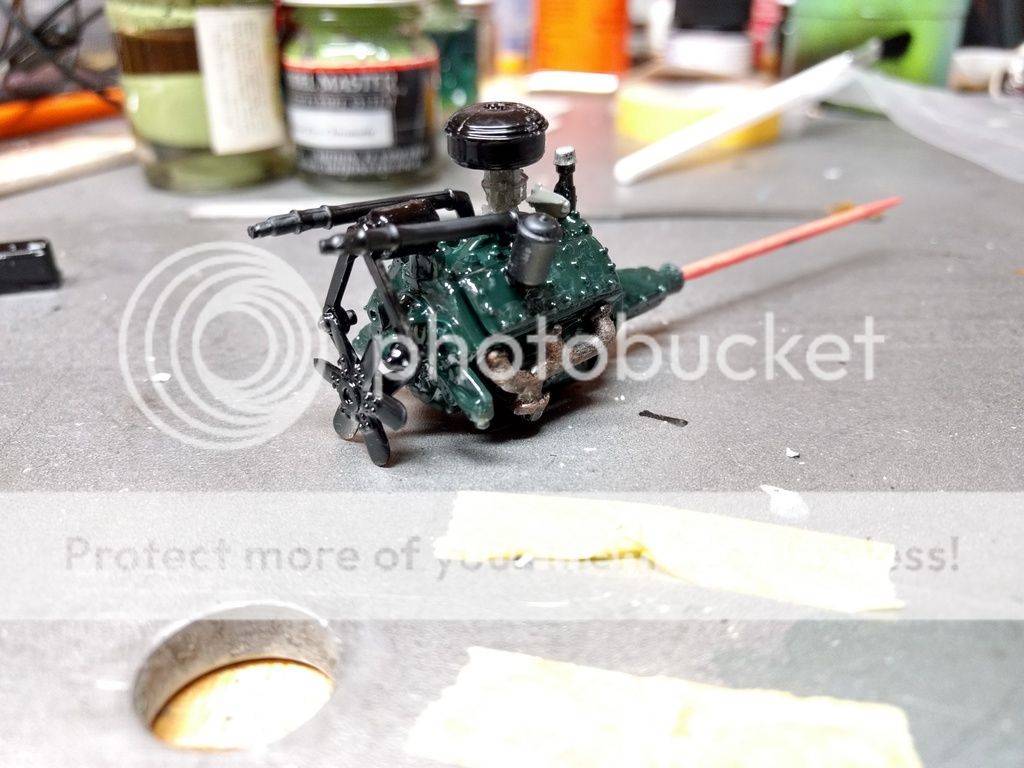

Modlbldr Posted November 24, 2017 Author Posted November 24, 2017 Some of yesterday's progress. http:// http:// http:// http:// Still have a bit of detailing to do on the engine. Later-
Modlbldr Posted November 26, 2017 Author Posted November 26, 2017 Finally getting the wood stained and beginning the install. The wood panels are Birch with a Minwax Golden Oak stain and a coat of Future. Once the wood dries in place I will put another coat of Future on it to help seal it in place. http:// http:// Later-
