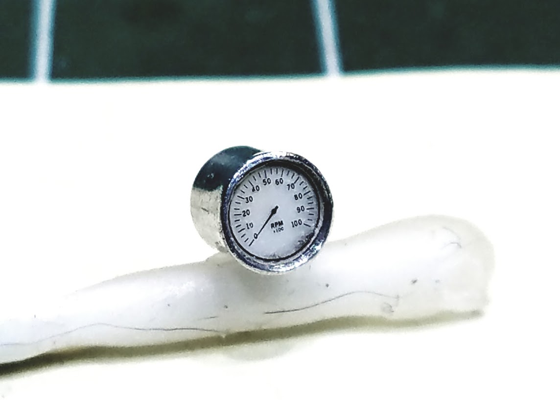

Taxdude Posted January 11, 2018 Author Posted January 11, 2018 Some work on the dashboard. I filled the gauge opening with a piece of .030 sheet stock, still needs final sanding. Decided that the spacing between the gauges would be .030. Using a .097 punch the four holes were...well punched. The endgame here is that I wanted the gauges to be below the surface and the trim rings flush. To achieve this I punched out 4 disks, using a .087 punch from .010 stock and then the gauge faces, Model Car Garage, were epoxied to them (and yes the volts is backward, drats). Total size .015. I little fine tunning around the perimeter of each face and they drop right into the holes. The bar across the back sets the correct depth. The tach cup is a piece of aluminum tubing that has been slightly expanded at the opening to accept the gauge face and then polished. It will then be mounted on the steering column. can't decide on a steering wheel. Maybe a 40 Ford. The next thing to sort out is the windshield frame. I want the windshield to be kicked out at the bottom. To this, the frame is way to thick and a new piece of glass needs to be cut. I haven't decided if the frame can be sanded to half its width and then a lip installed to hold the glass or it a whole new frame scratch-built with a recessed area to accept the glass. Also, need to make the 2 hinges that hold the windshield out. At some point, big progress will be made. Quick build fail.
