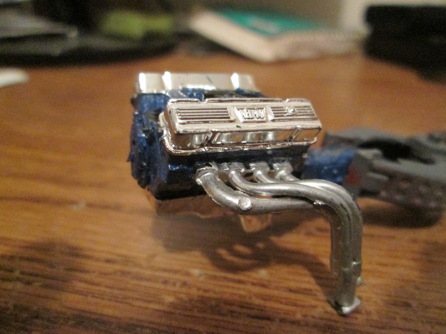

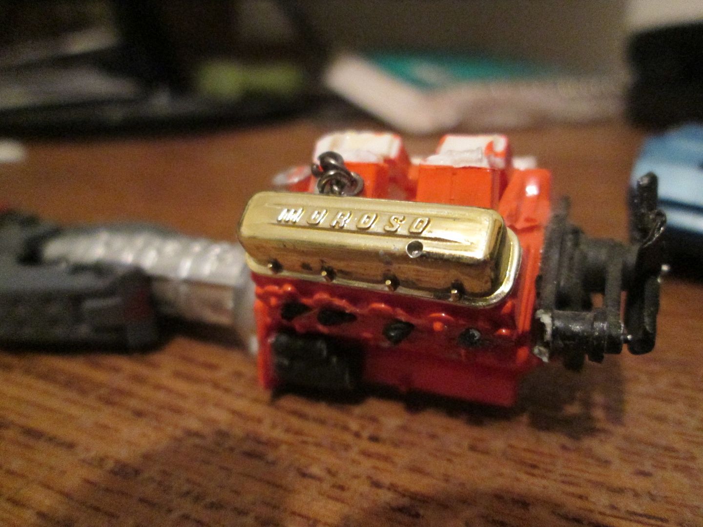

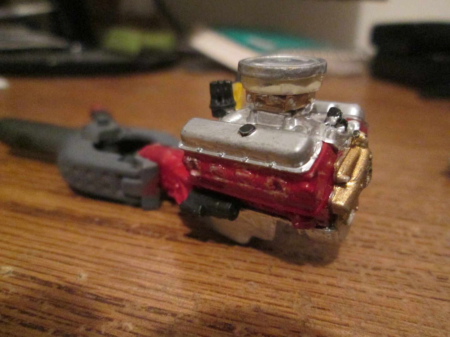

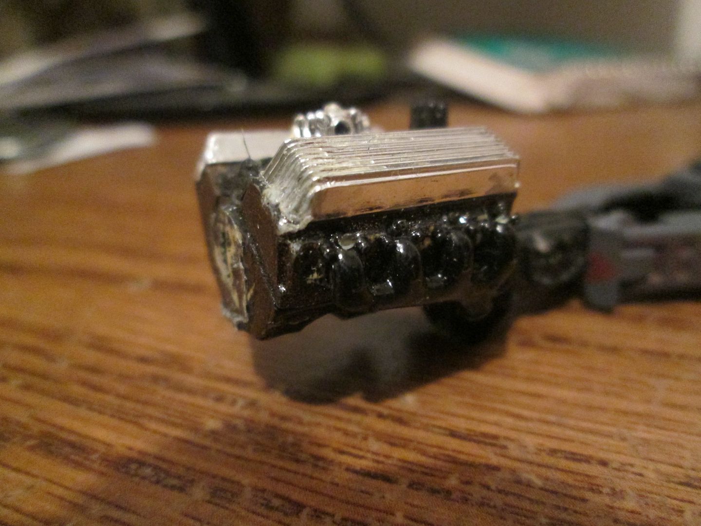

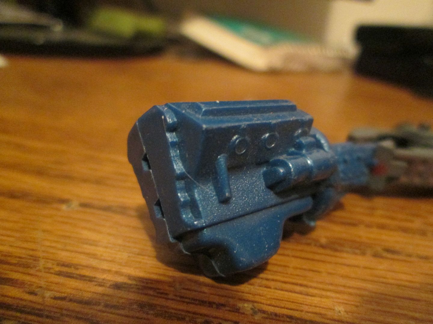

landman Posted January 23, 2018 Posted January 23, 2018 Which one of these is the likeliest big block Chevy? All junkyard, bought on eBay.I think 1. may be a Pontiac. 5. looks good to me. I'm open to comments & suggestions. The selected candidate will likely turn out with the Nelson twin turbo set up I got today. 1. 2. 3. 4. 5.
TarheelRick Posted January 23, 2018 Posted January 23, 2018 Not really good with identifying engines, but I believe #3 is a Y-Block Ford. Yet the circles, which I presume to be exhaust ports, represent a V-6; which I have never heard of in the Y-block series. #1 looks a whole lot like the many BBC's I have seen in builds.
landman Posted January 23, 2018 Author Posted January 23, 2018 18 minutes ago, TarheelRick said: Not really good with identifying engines, but I believe #3 is a Y-Block Ford. Yet the circles, which I presume to be exhaust ports, represent a V-6; which I have never heard of in the Y-block series. #1 looks a whole lot like the many BBC's I have seen in builds. Thanks Rick. I think you may have a point with 3. The circles would be frost plugs. The ports would be on the heads which aren't there. But the tall crankase looks like that of a y-block.. Also I thing the Chevies have the starter on the other side.

larman Posted January 23, 2018 Posted January 23, 2018 Ok. Here we go: 1. Big Block Chevy, looks like a mix of parts, appears to be of AMT, or possibly MPC origin. 2. BBC pro stock motor from the many Monogram Camaro and Firebirds of the 80's and 90's. 3. 440 6 pack Mopar, most likely from the Monogram '69 Super Bee, possibly the '70 GTX which was also molded in blue once. 4. BBC from either the MPC '57 Chevy flip nose gasser or '53 Ford F-100 flip nose pick up. 5. BBC from AMT '61 Ford Ranchero. The later issues came as custom only and had that BBC. You can tell by the valve covers. Hope that helps! -Larry
landman Posted January 23, 2018 Author Posted January 23, 2018 7 hours ago, larman said: Ok. Here we go: 1. Big Block Chevy, looks like a mix of parts, appears to be of AMT, or possibly MPC origin. 2. BBC pro stock motor from the many Monogram Camaro and Firebirds of the 80's and 90's. 3. 440 6 pack Mopar, most likely from the Monogram '69 Super Bee, possibly the '70 GTX which was also molded in blue once. 4. BBC from either the MPC '57 Chevy flip nose gasser or '53 Ford F-100 flip nose pick up. 5. BBC from AMT '61 Ford Ranchero. The later issues came as custom only and had that BBC. You can tell by the valve covers. Hope that helps! -Larry It certainly helps. Actually when I had received the big bag, I had sorted it out by SBC, BBC, Ford and Chrysler. quite a few by the obvious valve covers, and obvious port layouts like the small block Chevy. So now, that blue Chrysler will rejoin its brothers. And one of the others will end up with the Nelson setup. Thank you muchly.

Casey Posted January 23, 2018 Posted January 23, 2018 1) BBC, looks AMT or MPC 2) BBC "mountain motor" from 1/24 Monogram Pro Stock Camaro or Firebird kits 3) BBC (Big Block Chrysler) from 1/24 Monogram '69 Coronet Super Bee 4) Looks BBC ish, but the valve cover are not, at least the bolt pattern is wrong for a BBC 5) Hard to tell on this one what it is. Wouldn't use it regardless.
landman Posted January 24, 2018 Author Posted January 24, 2018 21 hours ago, Casey said: 1) BBC, looks AMT or MPC 2) BBC "mountain motor" from 1/24 Monogram Pro Stock Camaro or Firebird kits 3) BBC (Big Block Chrysler) from 1/24 Monogram '69 Coronet Super Bee 4) Looks BBC ish, but the valve cover are not, at least the bolt pattern is wrong for a BBC 5) Hard to tell on this one what it is. Wouldn't use it regardless. You know your stuff Casey, I looked at my unbuilt complete 440 and it is exactly the same.

NYLIBUD Posted January 28, 2018 Posted January 28, 2018 Yea,well number two is definetly a BBC pro stock motor,from one of Revell's/Monogram's pro stock cars.Not sure about the others though.
