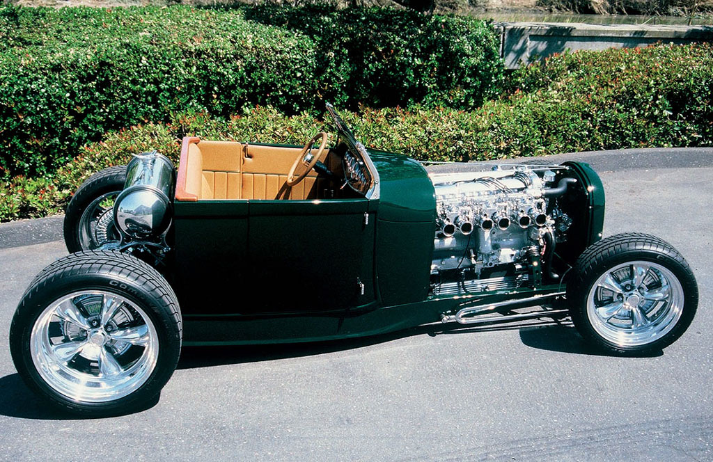

LDO Posted February 15, 2018 Author Posted February 15, 2018 (edited) My idea was inspired by this: This thing is so cool, I would consider making a real copy. I just don't know about a roadster, though. Maybe the closed cab pickup. Definitely with air conditioning. Hey- I live in Texas. Hey I just noticed it's on Deuce rails. I have only seen that pic on my phone. I think I'll dig out a Duece kit and see where that goes. Edited February 15, 2018 by LDO

MarvinGardens Posted February 15, 2018 Posted February 15, 2018 Lee, your inspiration (prototype) sits on stretched '32 rails. You WILL need to stretch the kit rails as well, just like the 1:1.

Ace-Garageguy Posted February 15, 2018 Posted February 15, 2018 Re: Proportions On the real car in your reference pic, note the relationship between the front of the stamped reveal in the '32 rail, and the base of the firewall. This is the critical point that defines where everything else has to go to get this really great look. The rails have been stretched FORWARD of the firewall, and the rear of the rails have been bobbed, with the rear axle moved forward of its original location.
LDO Posted February 15, 2018 Author Posted February 15, 2018 Yep. I don't want to hide the back end of that engine. To me, it is a beautiful thing. It just looks so nice. Little bit of recess in the firewall=ok. Need to stretch kit chassis. Model will be closed cab pickup with fenders, so no need to chop up a Deuce frame.
