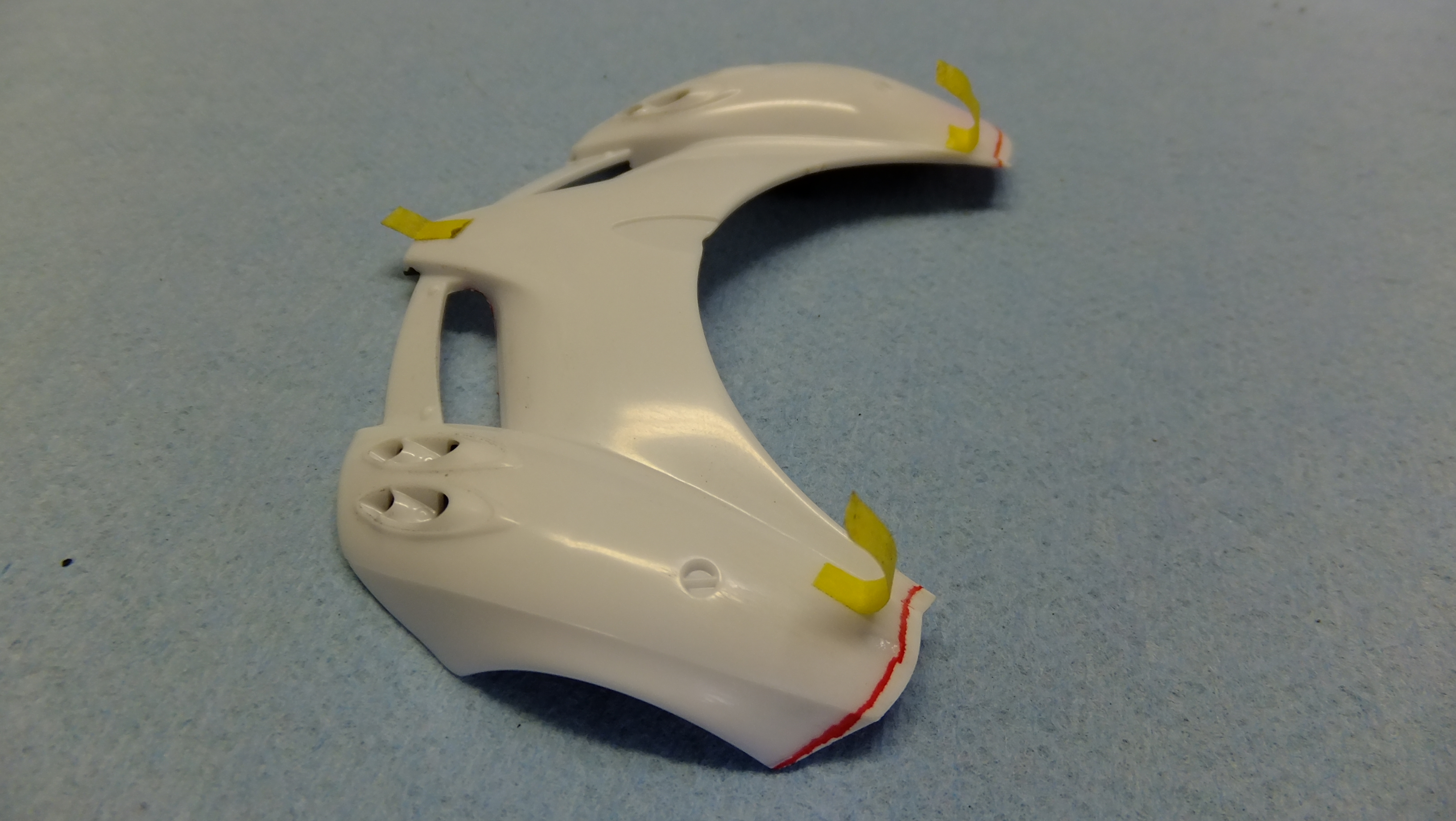

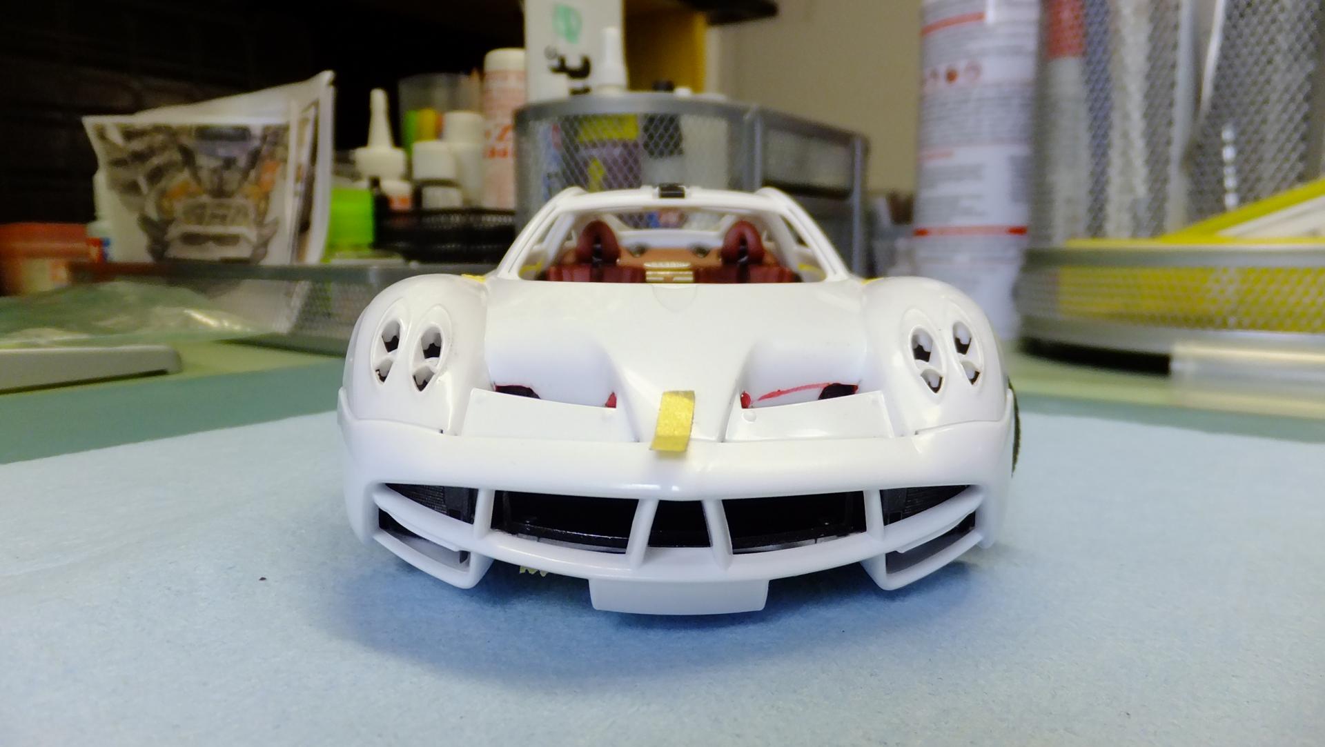

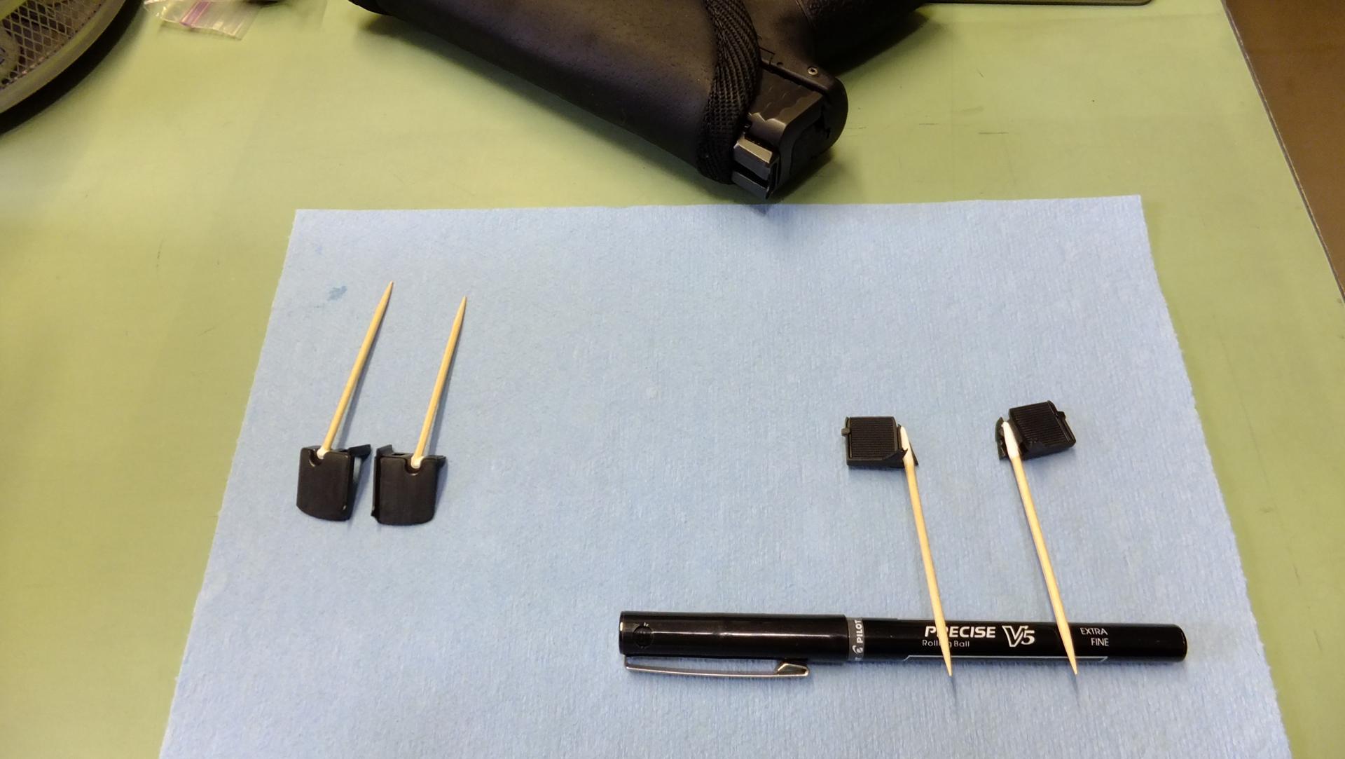

Dann Tier Posted May 17, 2018 Author Posted May 17, 2018 Heres one last little update before I start prepping the body for paint.....I like to use Canopy glue to attach my parts to be painted; in this case, it also kept paint out of the contact spot, ensuring a positive, and strong bonding point.

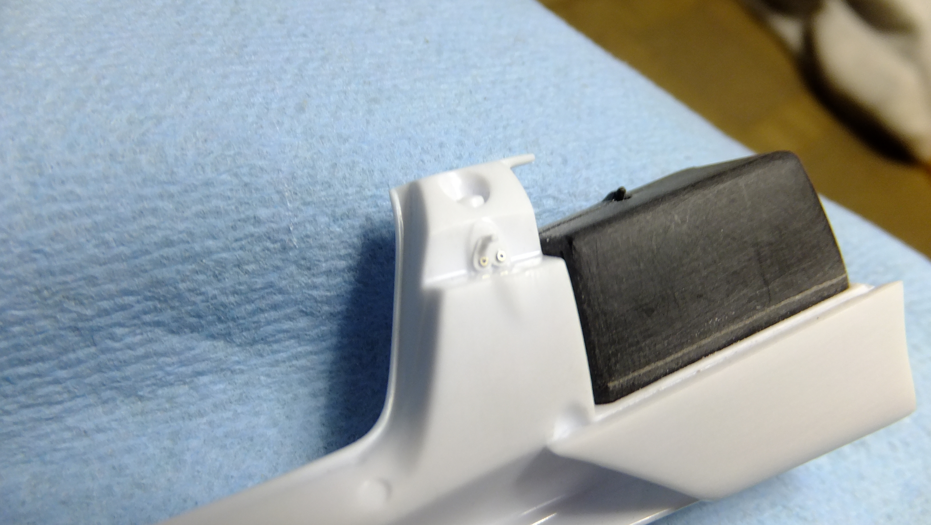

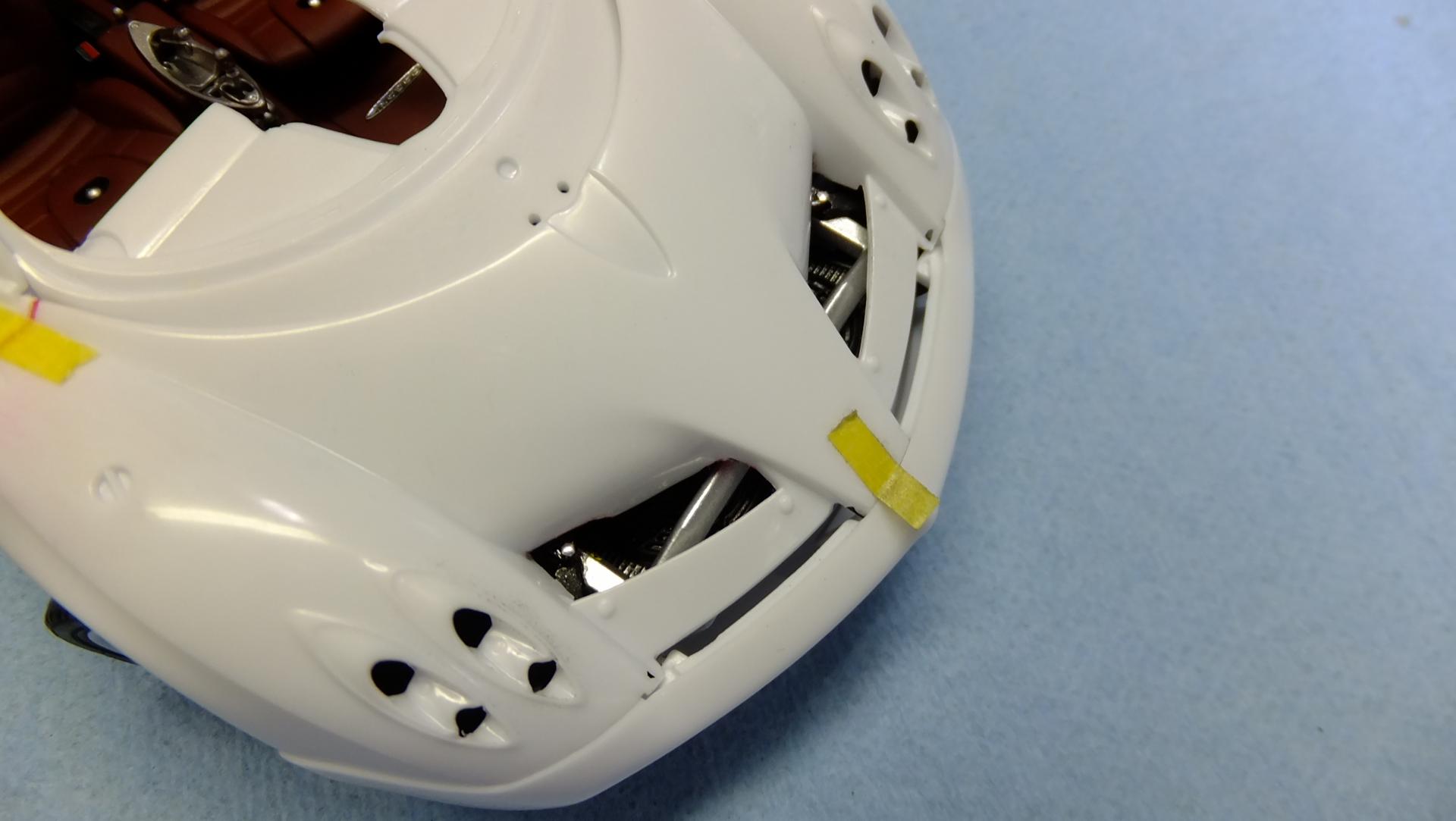

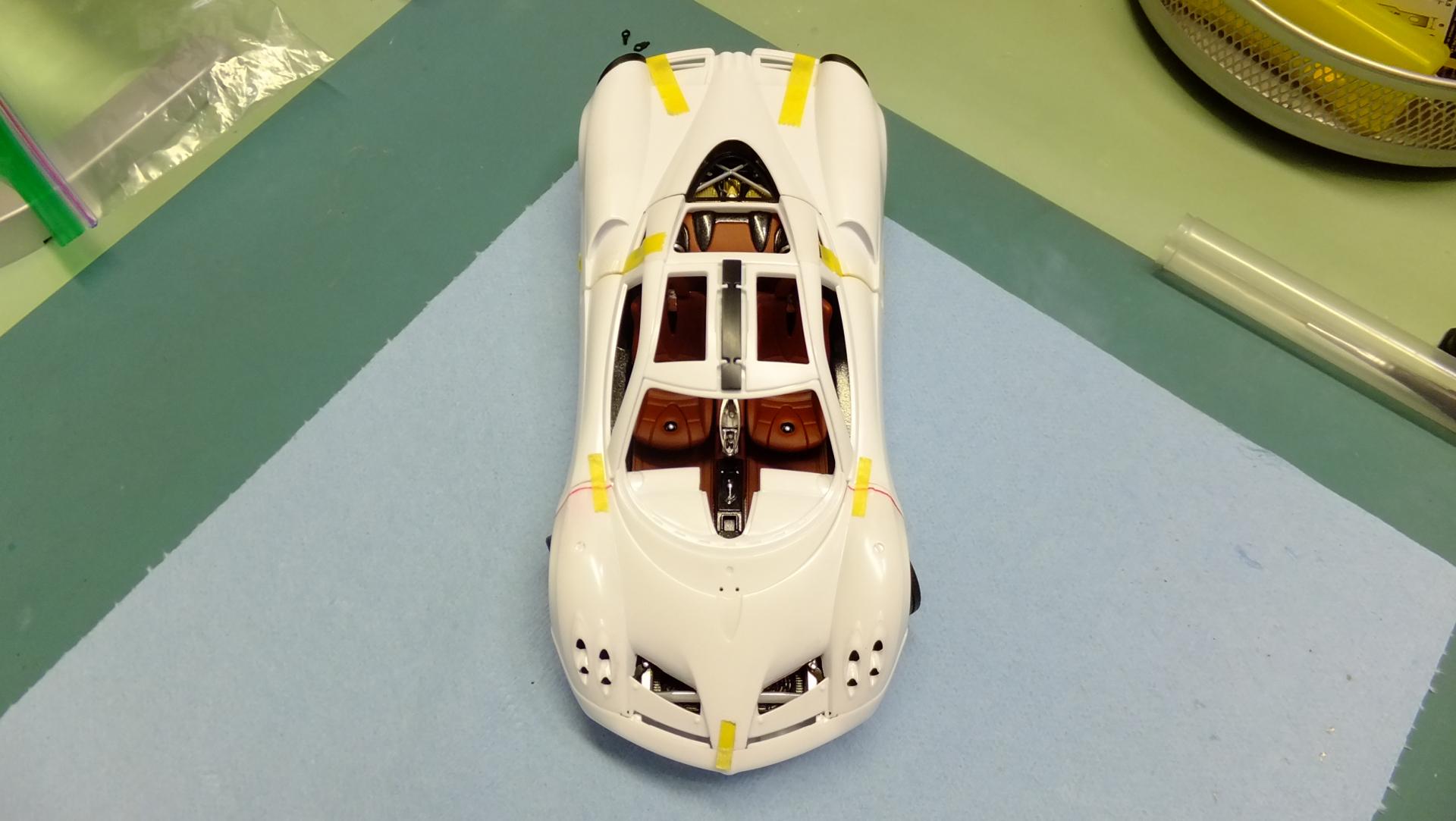

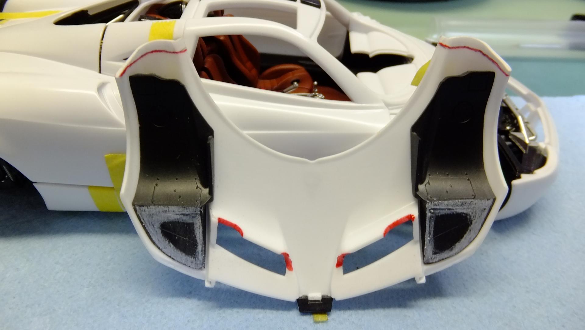

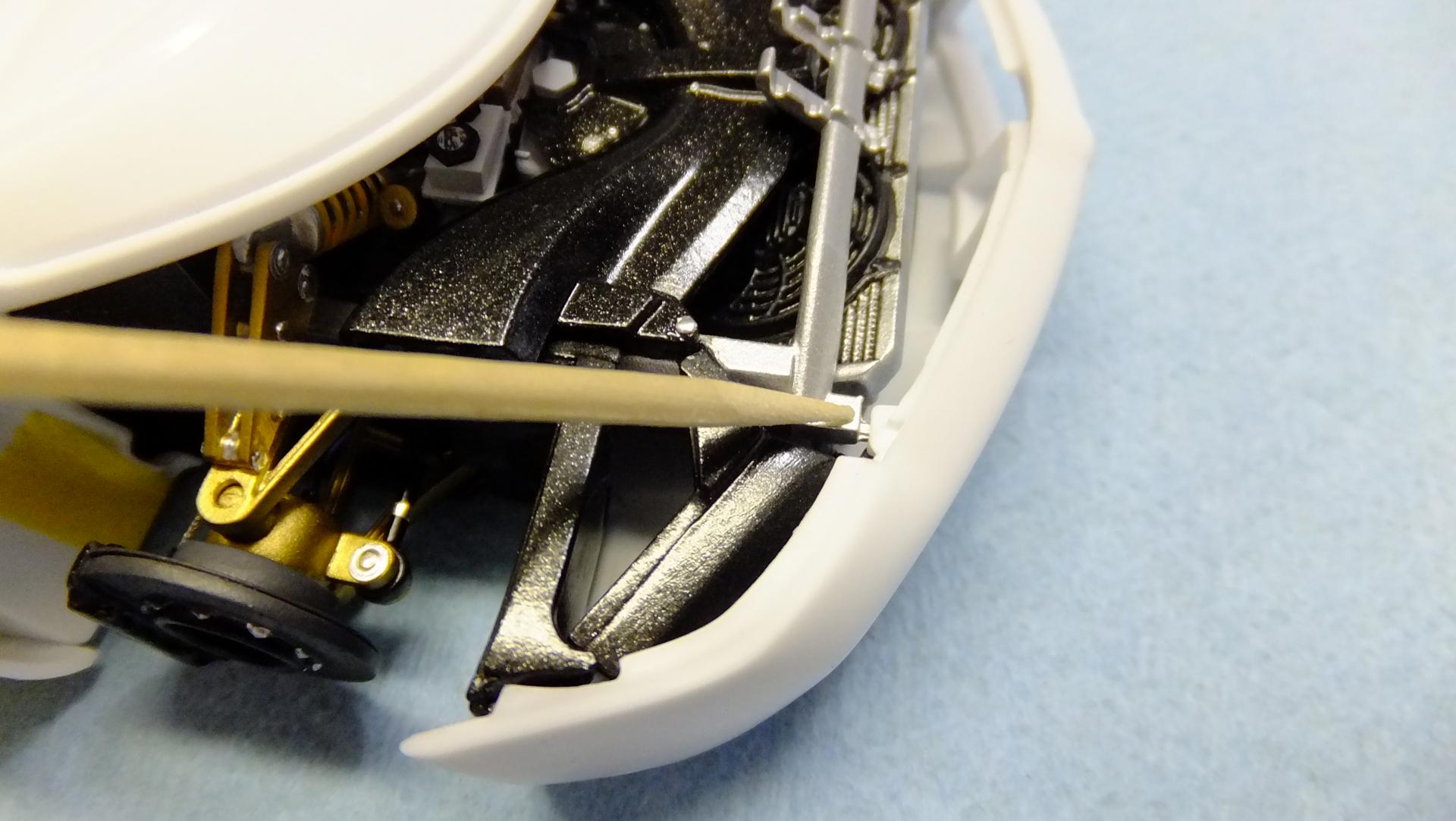

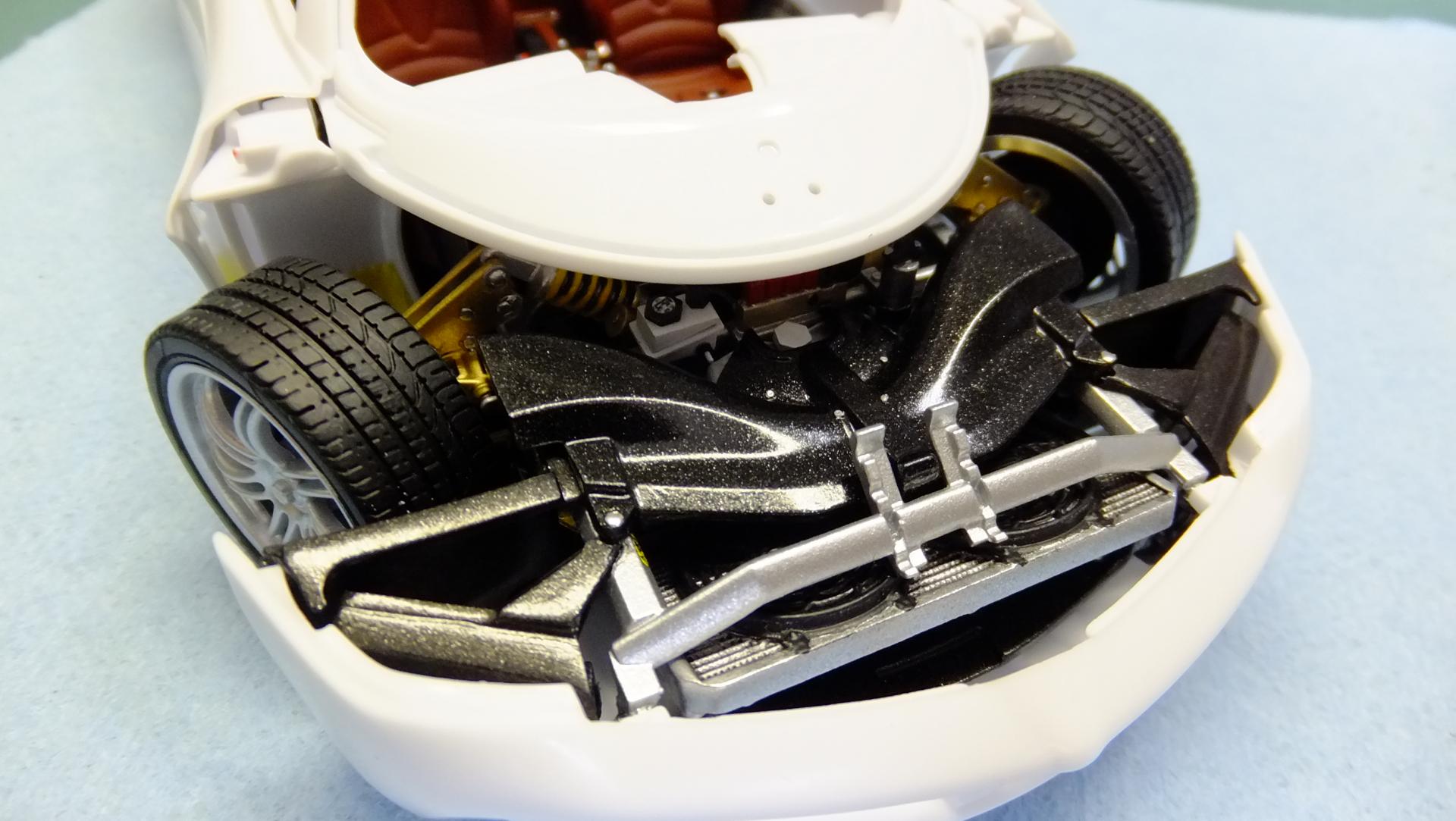

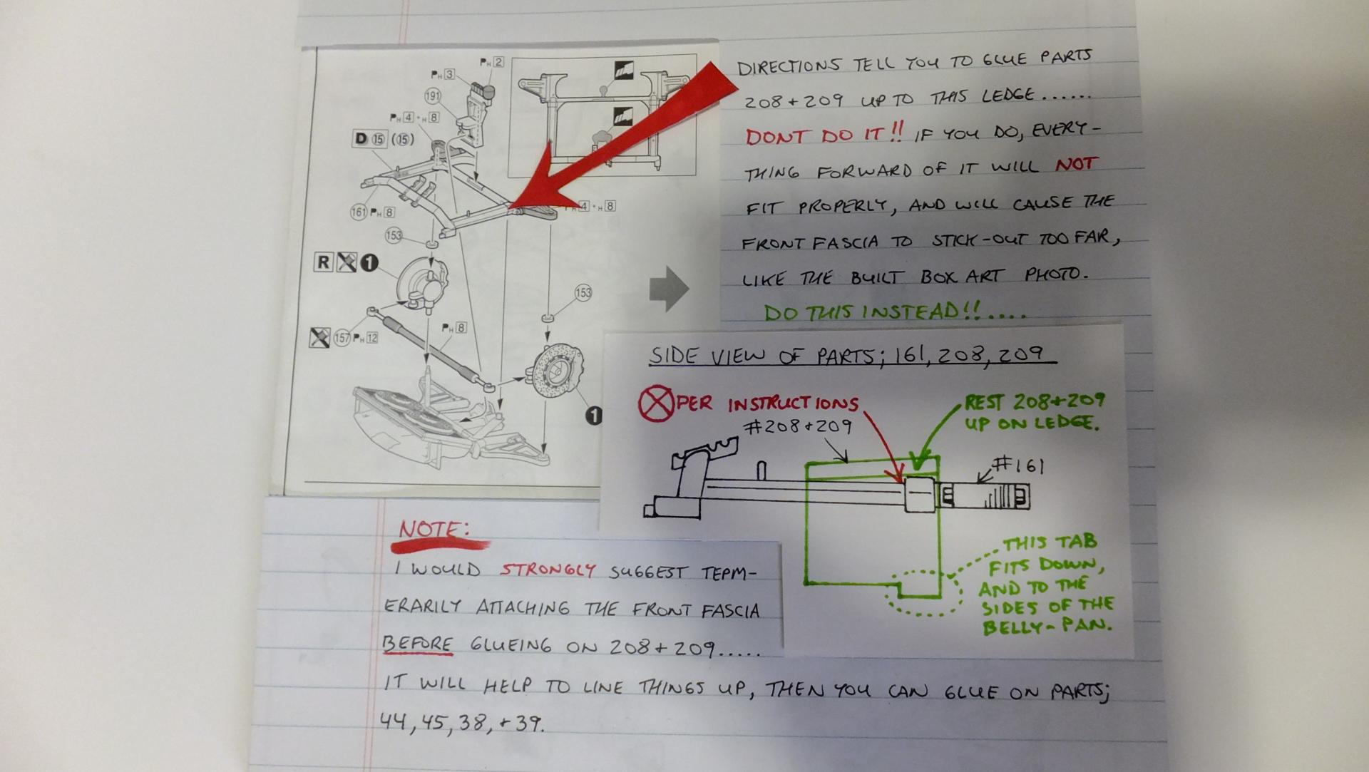

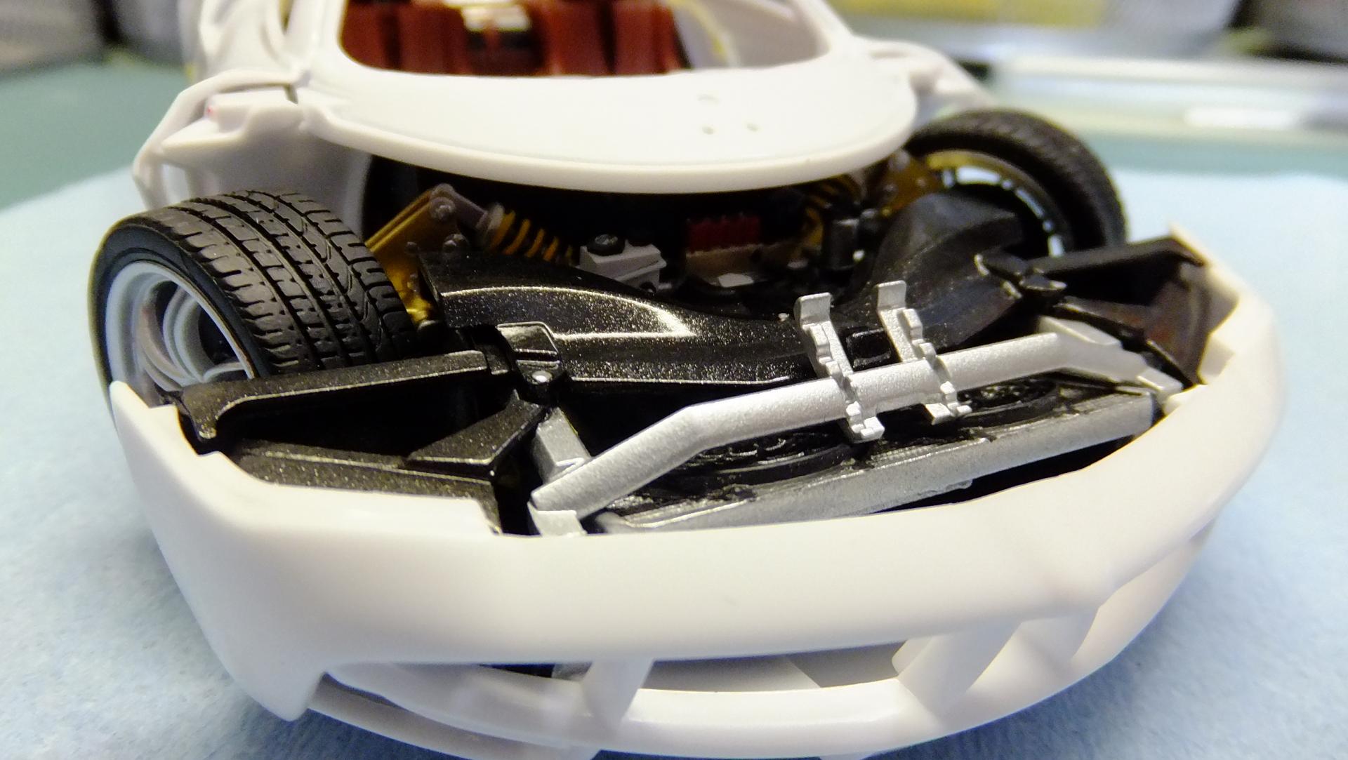

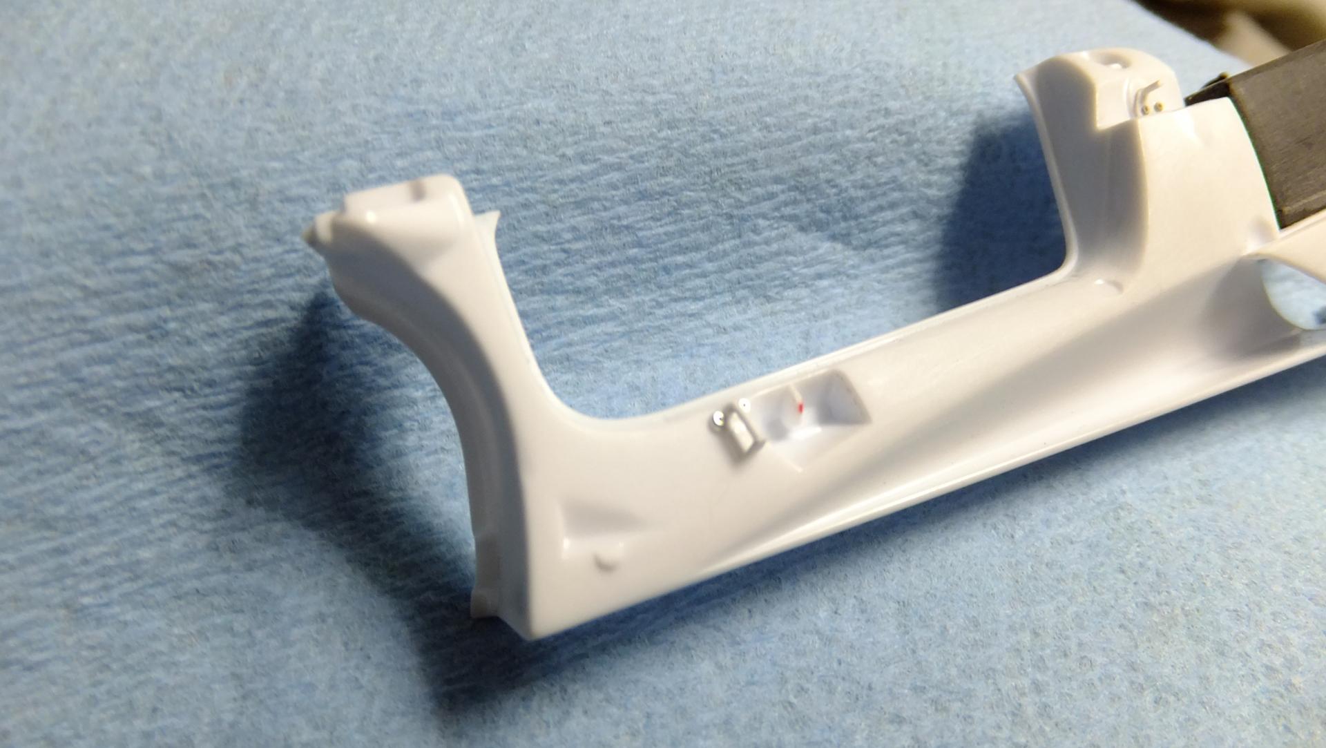

Dann Tier Posted May 18, 2018 Author Posted May 18, 2018 I just got done installing the two intercoolers, inner splash guards, top air channel, and photo-etch screws, and bolts. I also made the final tweaking of the front end bits, and came up with a couple of very interesting things that are wrong/not clear with a couple parts. I will be getting some photos drawn up explaining these issues that cause the front fascia to stick-out too far, and how to fix it. I also posted photos of all the things I either cut-off, added, or filed-down.....shown in red, or white. The photo with the toothpick, is pointing at the top two contact points on the fascia. When lined-up properly, there WILL be a tiny gap!

Dann Tier Posted May 19, 2018 Author Posted May 19, 2018 Here are a couple VERY important things I found out about the front end fitment issues....

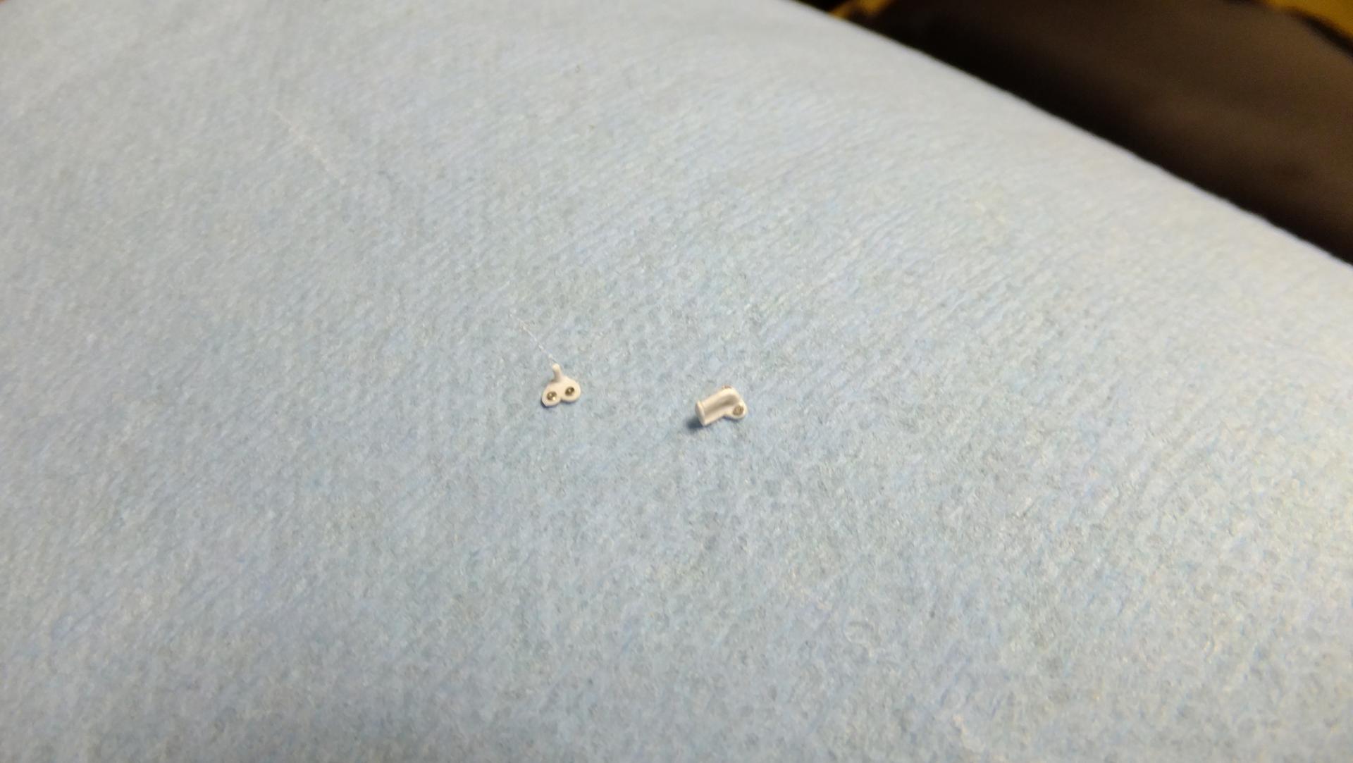

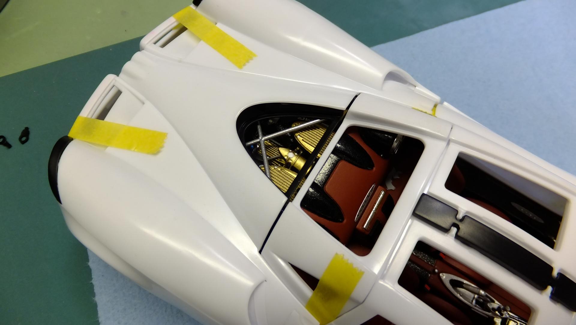

Dann Tier Posted June 19, 2018 Author Posted June 19, 2018 And now back to the Pagani!.....I finally pulled my finger out, and decided to start scratchbuilding those cowl, and door catches.....here they are:
