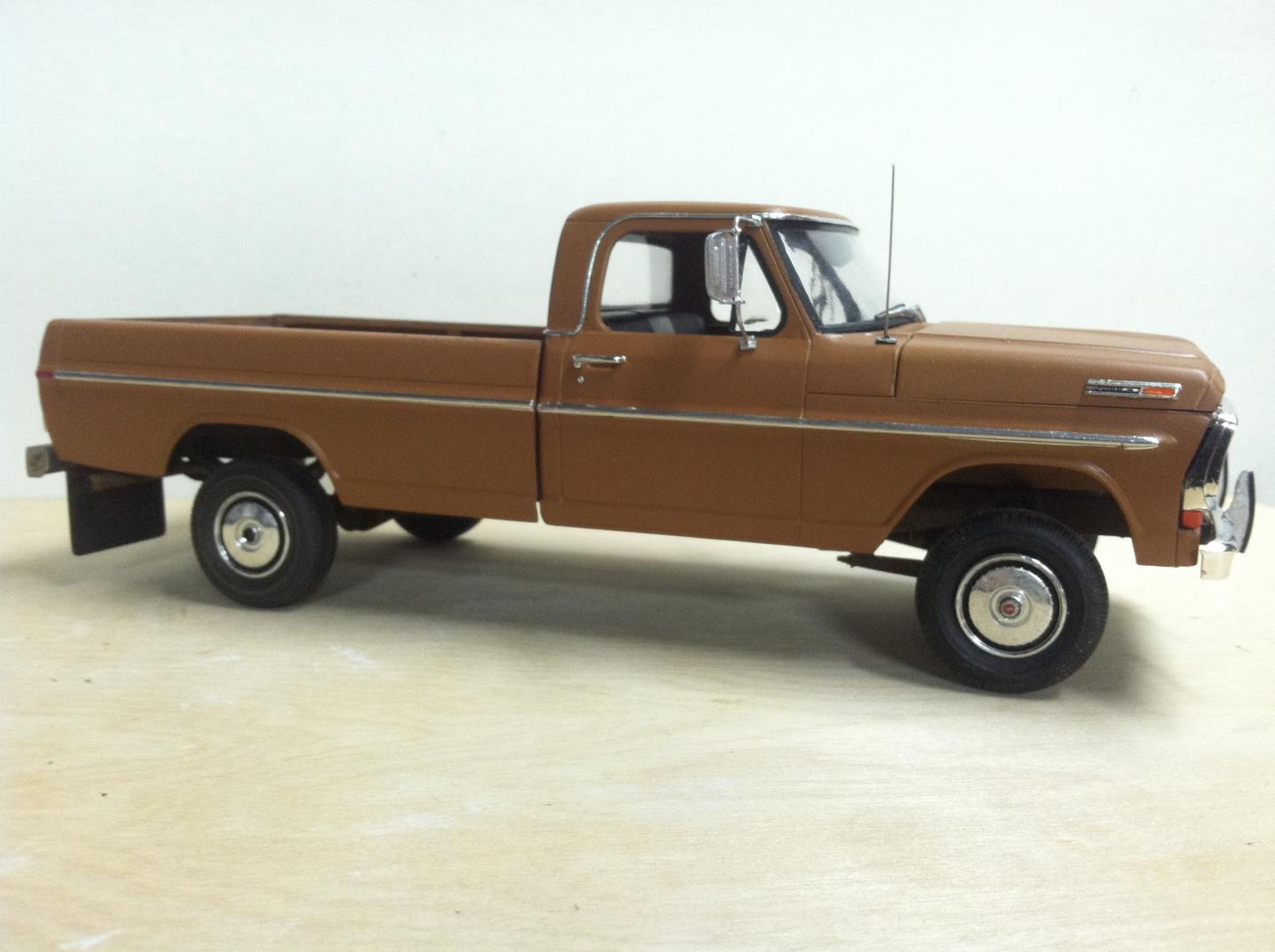

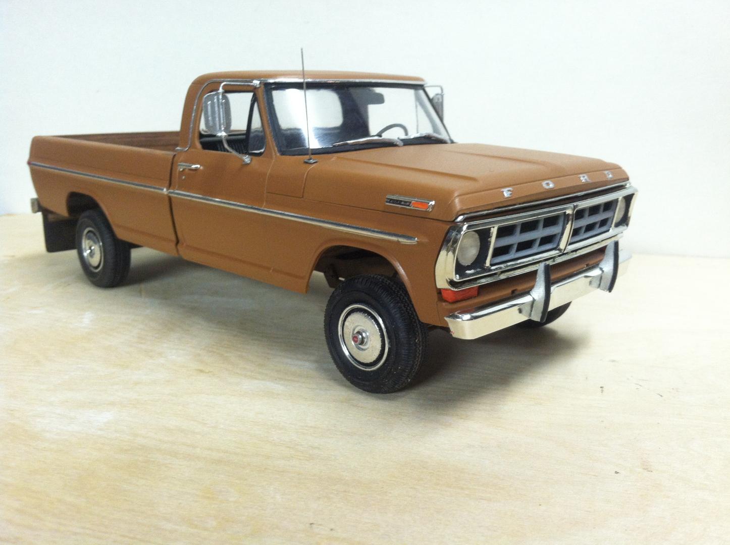

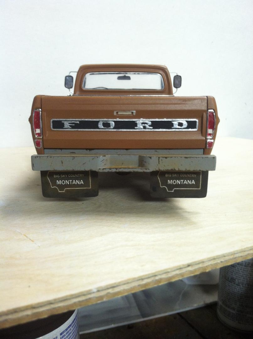

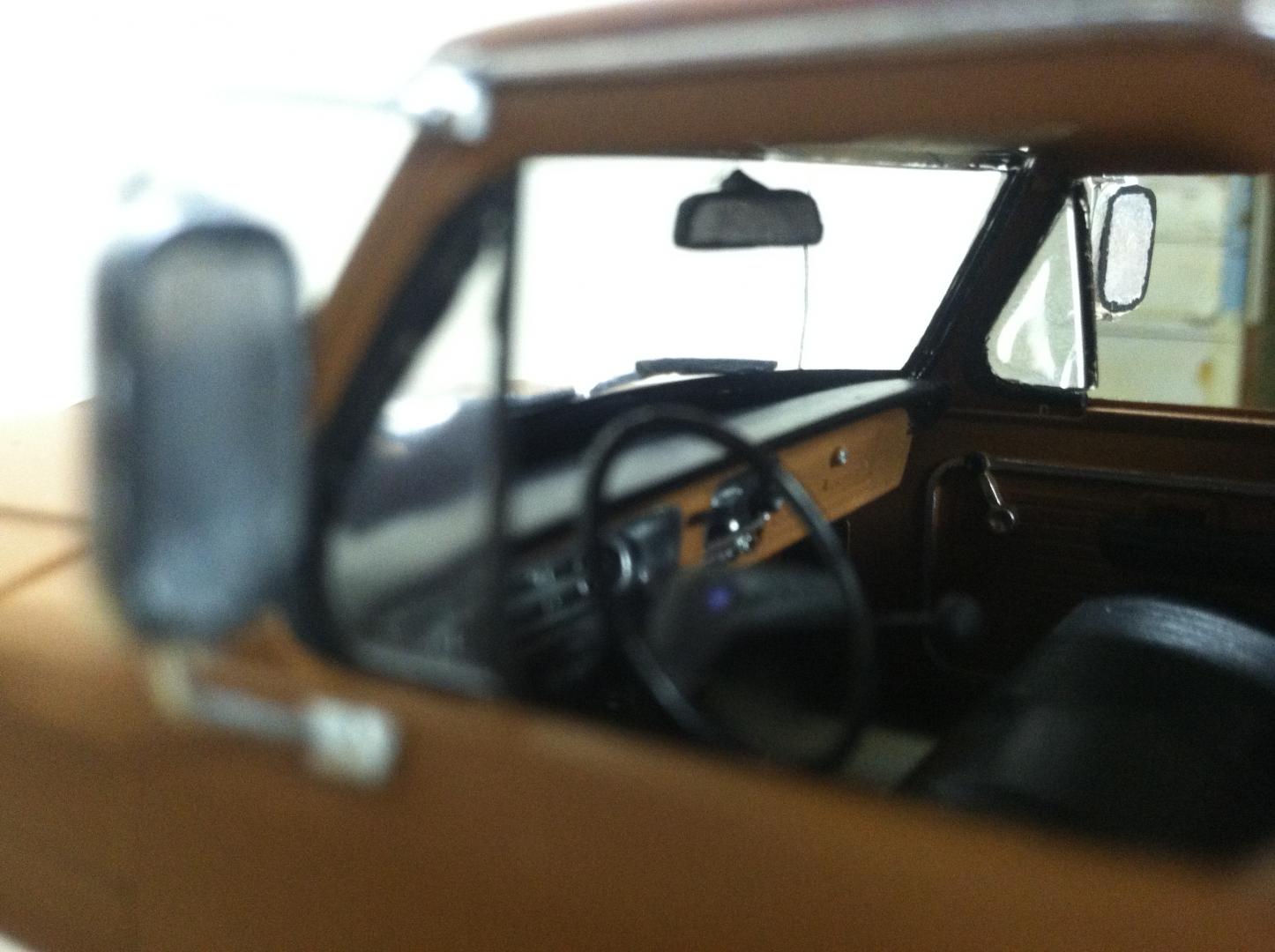

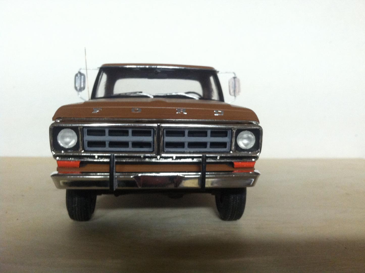

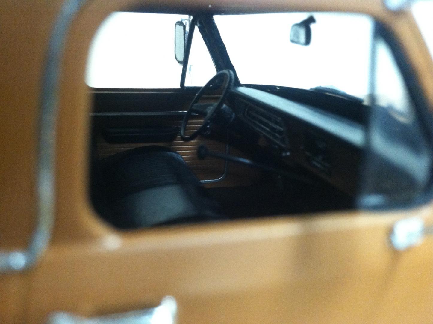

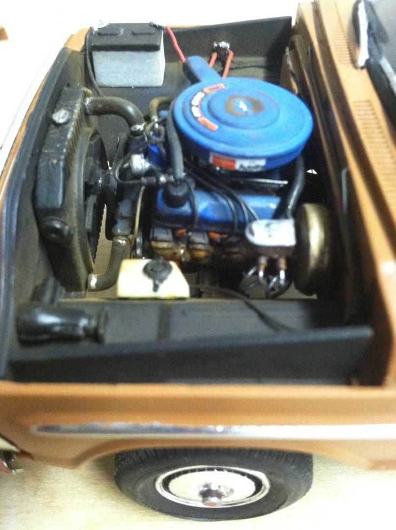

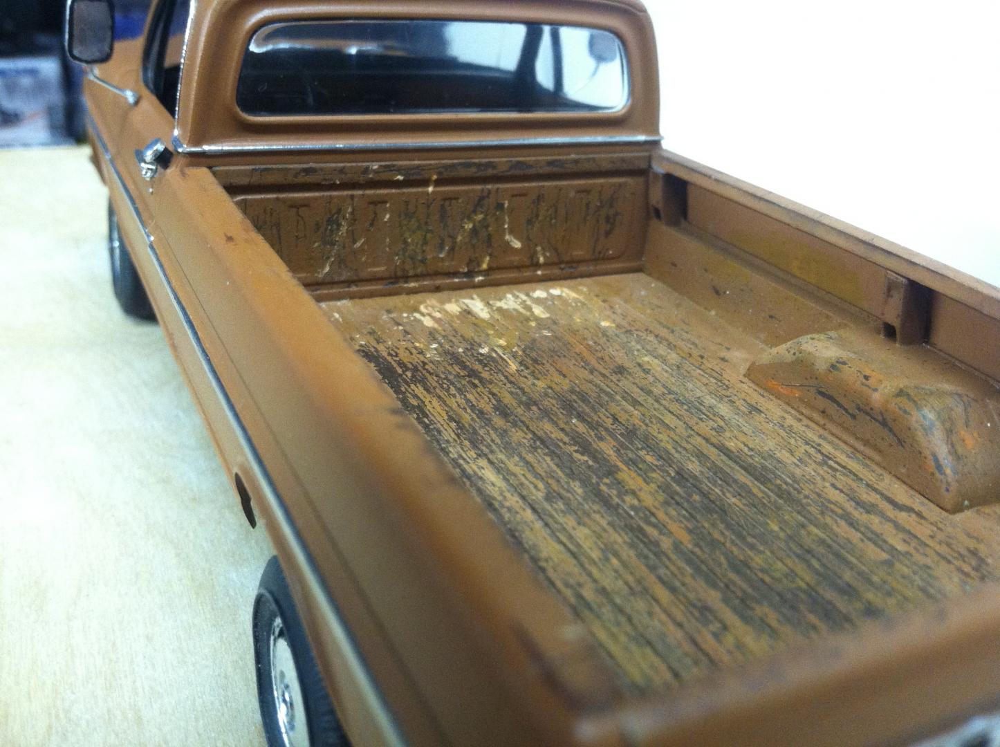

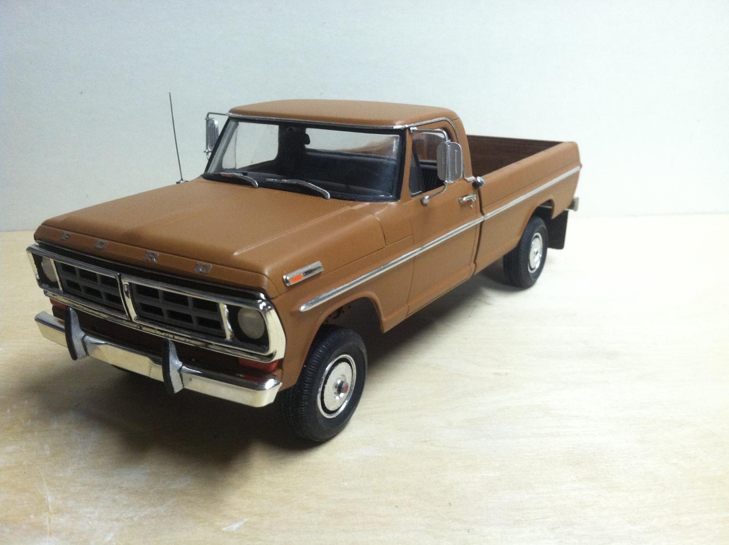

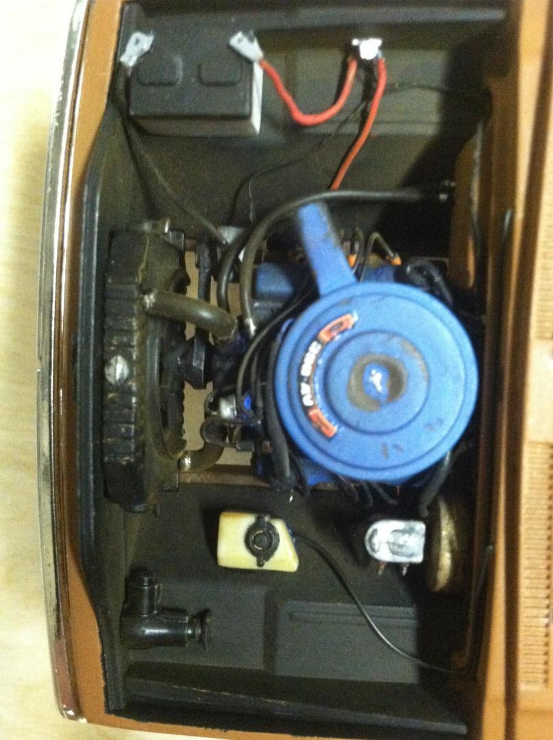

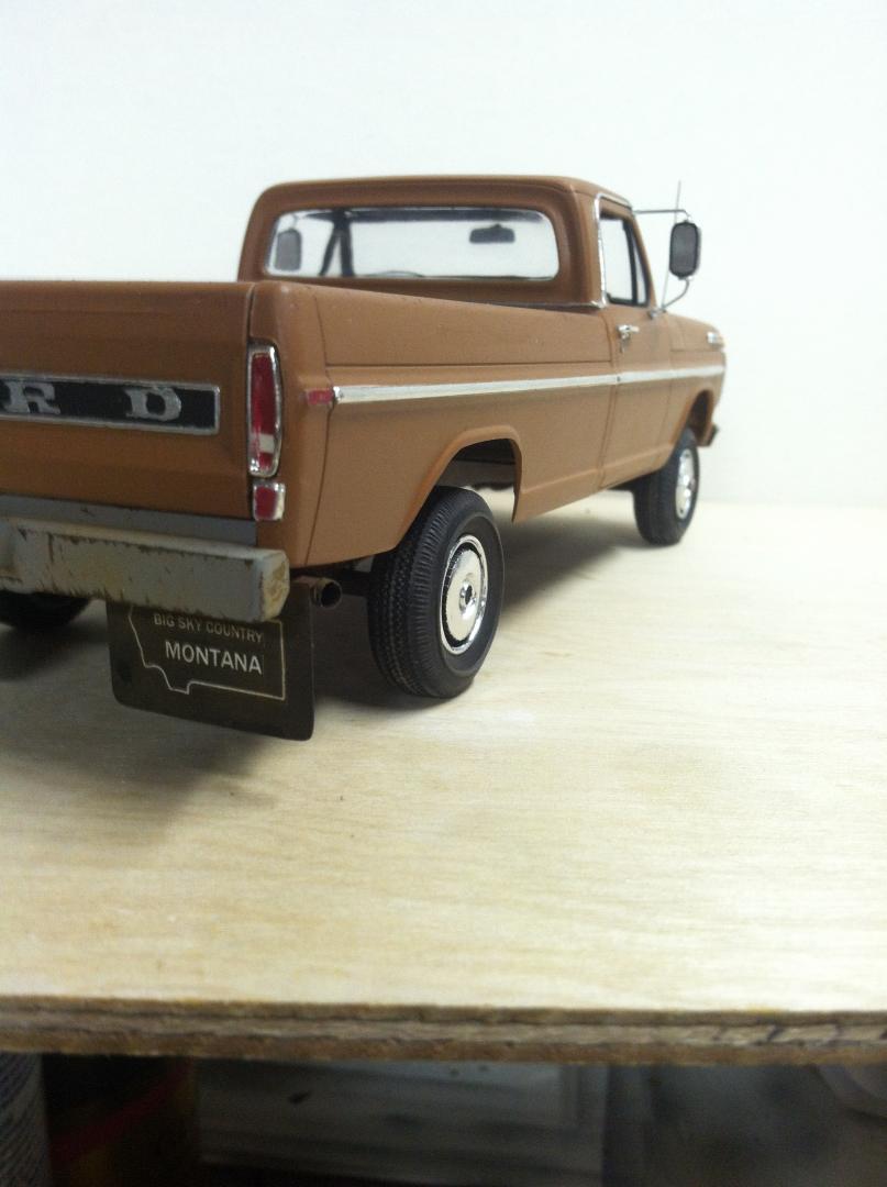

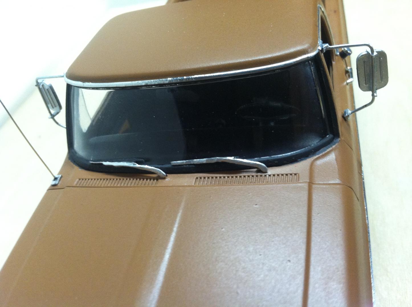

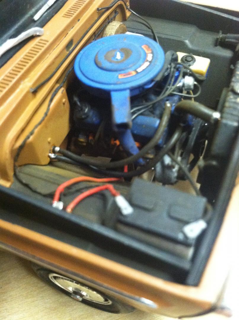

bill lanfear Posted March 5, 2018 Posted March 5, 2018 Just finished my 4th build in my "A day in 1979" series for my future diorama. It began as the Moebius 71 Ranger xlt. I combined AMT's 78 Ford Firestone kit for the 4x4 components. I wanted a bare bones Ford Custom cab with a lower trim level than the XLT. I picked up a Moebius 70 Ford for the use of the door panels, seat, and tailgate. Modifications are minimal as the kit is pretty good as is. I had to fix the steering column to get the steering wheel straight, grind a little off the area where the firewall and interior tub meet in order to get the bed to line up with the cab properly, shave down the windshield wipers and pedals, and bend the exhaust to fit with the new suspension. Scratch built items are: mirrors, antenna, bumper guards, mud flaps with angle iron, gas filler neck and cap, shifters, dash pad, drive lines, exhaust extension, lock out hubs, starter solenoid, thermostat housing, heat riser, dip stick, all vacuum lines and hoses, throttle linkage and spring, battery cables, wiring harness, alternator bracket, brake lines at master cylinder, and the washer hoses to cowl. I used scale model spark plug wires from an aftermarket company (cant remember the name). Parts box items not including the 4x4 parts are: fan belt assembly, rear view mirror (inside), hub caps, valve covers, 4 speed transmission, and bell housing. I have a pretty thorough explanation of the build under the workbench section if interested. Thank you for looking and comments are welcome! I would be happy to answer any questions if you have them. Enjoy!

espo Posted March 5, 2018 Posted March 5, 2018 Great looking well used base truck. I like the mud flaps, must see a lot of gravel roads.
Jim N Posted March 5, 2018 Posted March 5, 2018 Really superbly done! The weathering and the "wear" in the bed are top drawer.

stavanzer Posted March 7, 2018 Posted March 7, 2018 Put the "Shrink Ray" down, and nobody gets hurt. What an awesome finish you have. The rear bumper looks so real. I'd like to see how you weathered it.

bill lanfear Posted March 9, 2018 Author Posted March 9, 2018 Thank you everyone for the positive comments! To answer Alan's question about how I did the bumper...I started with dark brown rattle can paint (semi gloss), sealed it with semi gloss clear coat, painted the grey (air brush) with craft paint (dull opaque), took a soft brass bristle wire brush to it to get the fine scratches, sealed again with semi gloss clear, then dusted it with real rust powder I make. Hope that answers your question Alan. Thanks again for the interest everyone!

RustedBronco Posted March 11, 2018 Posted March 11, 2018 Love the weathering. Inside of box is perfection!
Classicgas Posted March 11, 2018 Posted March 11, 2018 Well done. The inside of the bed is especially well done.

Oldcarfan27 Posted March 30, 2018 Posted March 30, 2018 On 3/4/2018 at 6:23 PM, bill lanfear said: Well done work. Now it just needs a proper load. How about bales of hay, or fishing poles and a small aluminum boat or an over-the-cab camper. It looks like a good weekend work horse. BTW - if I may say one thing. The shiny grille doesn't match with the weathered appearance of the rest of the truck. Since it was made from anodized aluminum, the grille would be just as faded as the truck's paint. Try spraying some fully mixed Testors dull cote into a cup, taking a small brush and painting a light coat onto the chrome and let it dry. If its still too shiny, add another coat and let dry again - until it looks properly oxidized. The more coats you do, the cloudier it gets. Check online for reference on old unrestored cars with faded aluminum trim.
bill lanfear Posted March 31, 2018 Author Posted March 31, 2018 Ya, I agree about the grill and front bumper. I don't know why I didn't dull them down....maybe I will revisit that in the near future, Thanks. As far as it needing something like a boat etc., I am on it, as I felt the same way and plan to build something to complement it.
Gerald Haney Posted August 15, 2018 Posted August 15, 2018 This is an awesome looking truck. The inside of the bed the starter solenoid all of it...just wow! Great job on this bump side ford!
