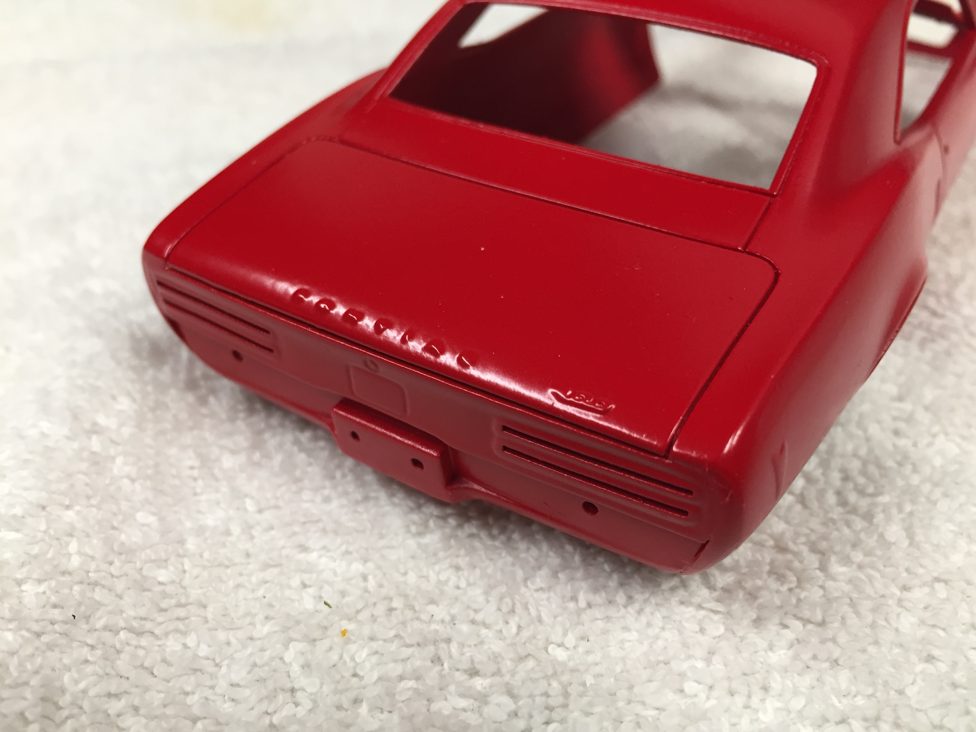

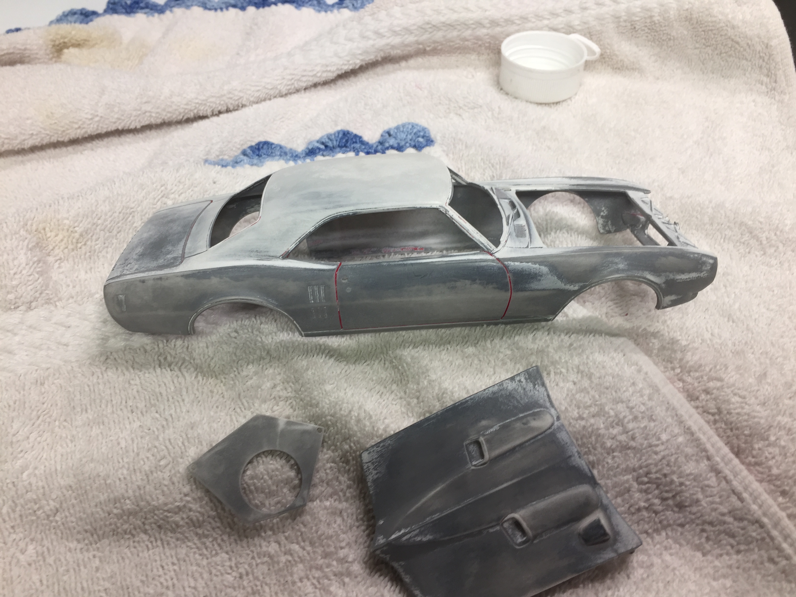

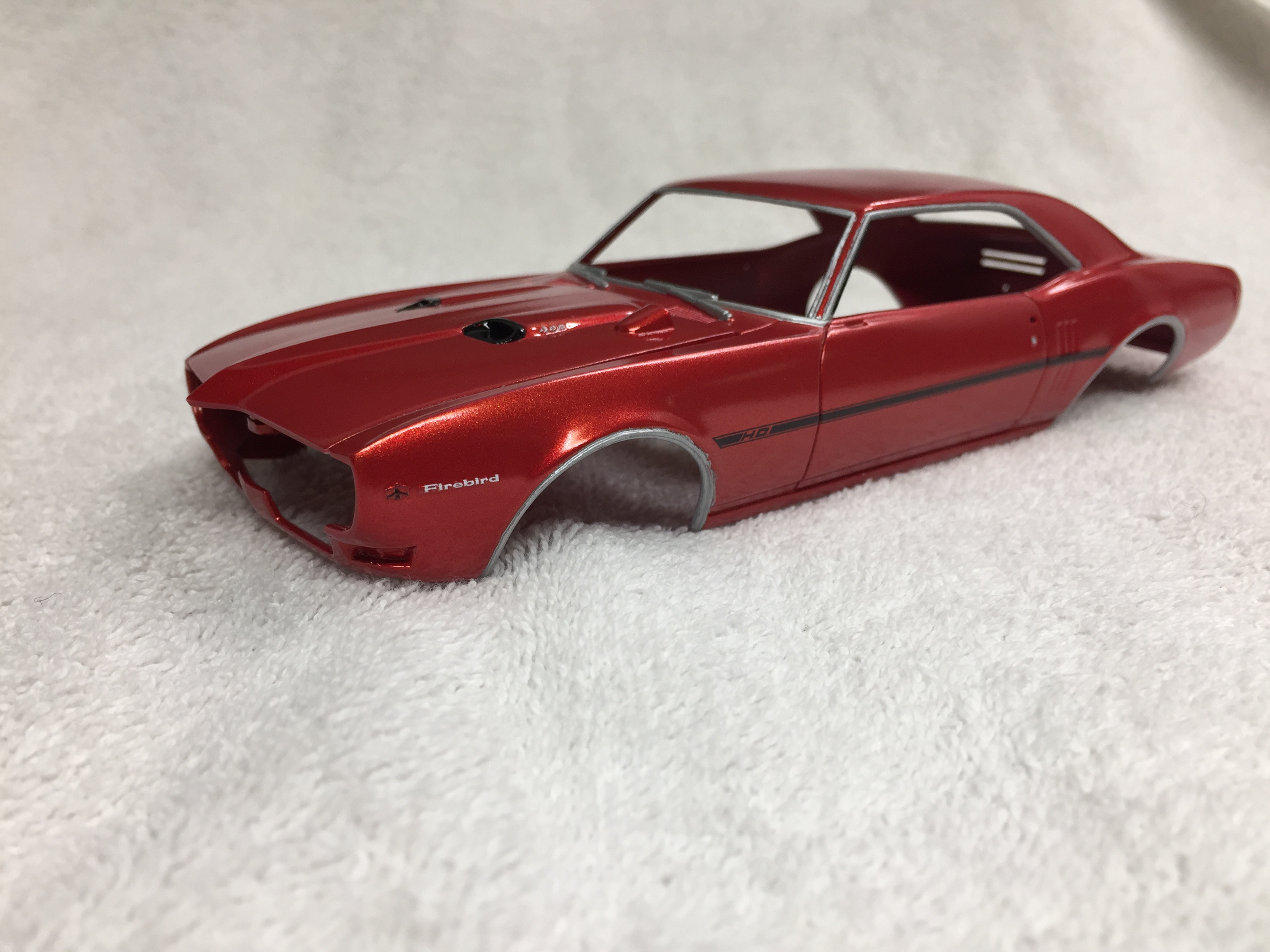

NOBLNG Posted March 9, 2018 Posted March 9, 2018 I started painting this with Spaz Stix red and although I really liked the color, it was getting so thick that I was losing detail. So into the superclean it went! My second attempt was using Testors Aztec red pearl with Aztec clear topcoat.
PARTSMARTY Posted March 9, 2018 Posted March 9, 2018 4 hours ago, StevenGuthmiller said: Looks much better the second time. Steve x2
espo Posted March 9, 2018 Posted March 9, 2018 I have to agree with everyone else on the color choice. The chrome trim looks perfect also. Did you use a Pin for the window moldings ?
NOBLNG Posted March 9, 2018 Author Posted March 9, 2018 (edited) 1 hour ago, espo said: I have to agree with everyone else on the color choice. The chrome trim looks perfect also. Did you use a Pin for the window moldings ? Thank you all for the compliments. The Aztec paint is nice stuff. I wish it came in more colors. I am not sure what you mean by a pin? I scribed all the mouldings with the back of an exacto blade just like the panel lines, and hand painted them. I realize now that all I would need for a paint dividing line is a very thin score. Edited March 9, 2018 by NOBLNG clarity
Modlbldr Posted March 9, 2018 Posted March 9, 2018 Looking beautiful. Great color choice. I believe that what espo is referring to is a Molotow Chrome Pen. Later-
NOBLNG Posted March 9, 2018 Author Posted March 9, 2018 No, I don't have one of them. This was done with a Craftsmart paint pen dabbed into a bottle cap and I dip my paintbrush into that. It goes on real nice. I have not tried the BMF that I bought yet, but I think painting the trim would be far faster than foiling it . Is it as real? I don't know... I will try the BMF on the next one.
espo Posted March 10, 2018 Posted March 10, 2018 On 3/9/2018 at 9:31 AM, NOBLNG said: Thank you all for the compliments. The Aztec paint is nice stuff. I wish it came in more colors. I am not sure what you mean by a pin? I scribed all the mouldings with the back of an exacto blade just like the panel lines, and hand painted them. I realize now that all I would need for a paint dividing line is a very thin score. Ya my question is a little vague. I was thinks the Molotow pen and I even misspelled "pen". I see you have already answered the question to others. The method you used on the chrome trim is the tried and true but looks more like a satin finish compared to the Foil and Motolow pen that seems to be the norm now. You did an excellent job and the light scoring with a blade is how I learned that technique.
