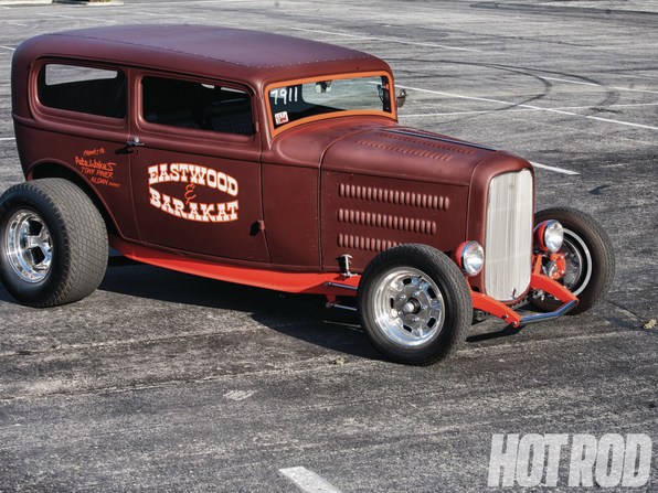

1 hour ago, Pat Minarick said:
Thought of this when I saw yours!downloadfile.jpg.f8ebd9ab75c9f1e81071a2f0863b5692.jpg
I know Eastwood, have seen the re-creation in person several times and have met Barakat. Killer car, Awesome guys!
