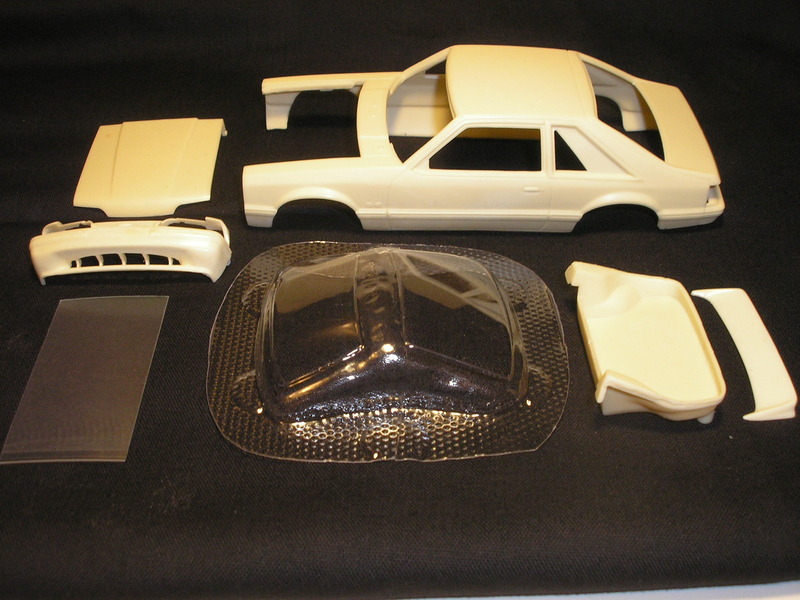

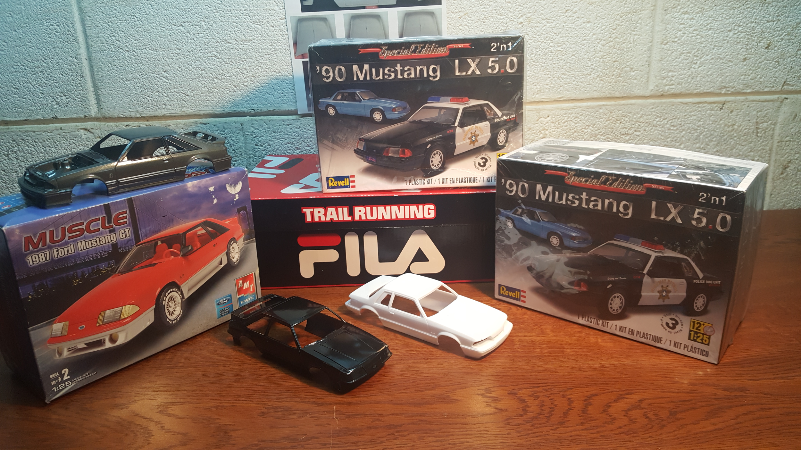

Well, here's my next Project! I've taken on a build that first seemed pretty simple... build a 90 ish Mustang GT Hatchback for my central air furnace repair guy. Easy enough... I like building 1.1 subjects and this guy digs my work so it's a win win right?
It wasn't until he texted me pictures when I had a feeling that I'd bit off more than I could chew. I had to wrap my head around the car to use and then finding that kit.  It took awhile to track the kit down, but Thanks to a loyal member here on the fourm I was able to secure a favorable kit. (Thanks so much, Zenon, you're a lifesaver.) Now I can keep my word and build the proper scale replica that I said I could.
I can say that I am out of my lane with this kit but with a little research I've found that two kits will be needed to get accurate results. Any help/suggestions along the way will be greatly appreciated. You folks are good about lending support with tips and ideas. Thanks in advance.
For now the first order of business will be swapping the front bumper/grill and rear bumper and taillight assembly. I think I'll build the notchback (Revell cop car) with GT equipment (phantom?) So I won't ruin a body. It will be fun to build a rough and tough LX with GT parts from the Local junkyard. Kind of a Redneck budget GT wanna-be. A Daily-driver, kind of a Big dreams with empty pockets owner. We all know guys like that. So it will be weathered with multi colored panels, fading, and any thing that says I care but my lack of money and resources are limited.

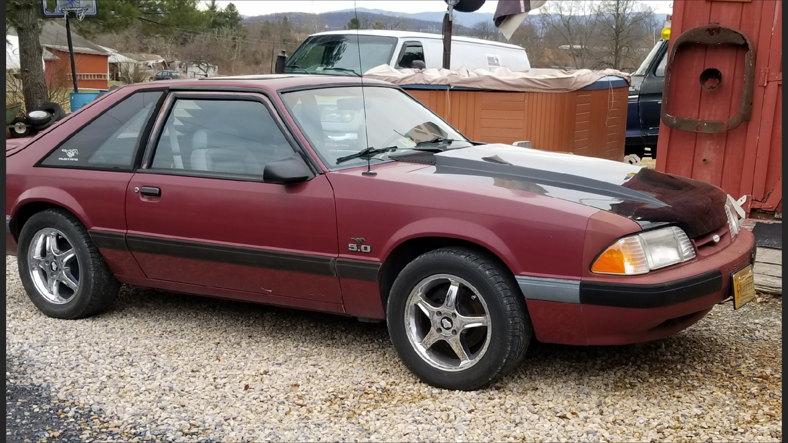

Speaking of which, do I build the hatchback with weathering (as pictured) or build it as the restored Dream car he wishes it would be? I guess my decision will be made the further I get along with the build. So here goes! Check back for updates. Thanks for looking!

The parts are a decent fit, I'll have to do some trimming and filling. But it will work out I think. The other thing is the side trim is a perfect fit and actually looks good on the notchback. I've desided to build both cars simultaneously. If anyone has any ideas for the color choices on the notchback like mis-matched bodypanels I'm open to ideas. I was thinking as a base maybe the blue on the box with red or burgandy bumpers, white passenger fender, grey fiberglass hood... and yellow where the paint has sun baked off the plastic and weathering (peeling paint) on the metal like that old sealer ford used to use.
According to the boxes, they are the same scale, but they don't seem that way from the parts swapped on the nose. You should have fun with this.
There is resin cast version already out, he's a member of this forum, I believe Greg Wann is his name, I want to order a couple myself I just keep forgetting.:wacko:

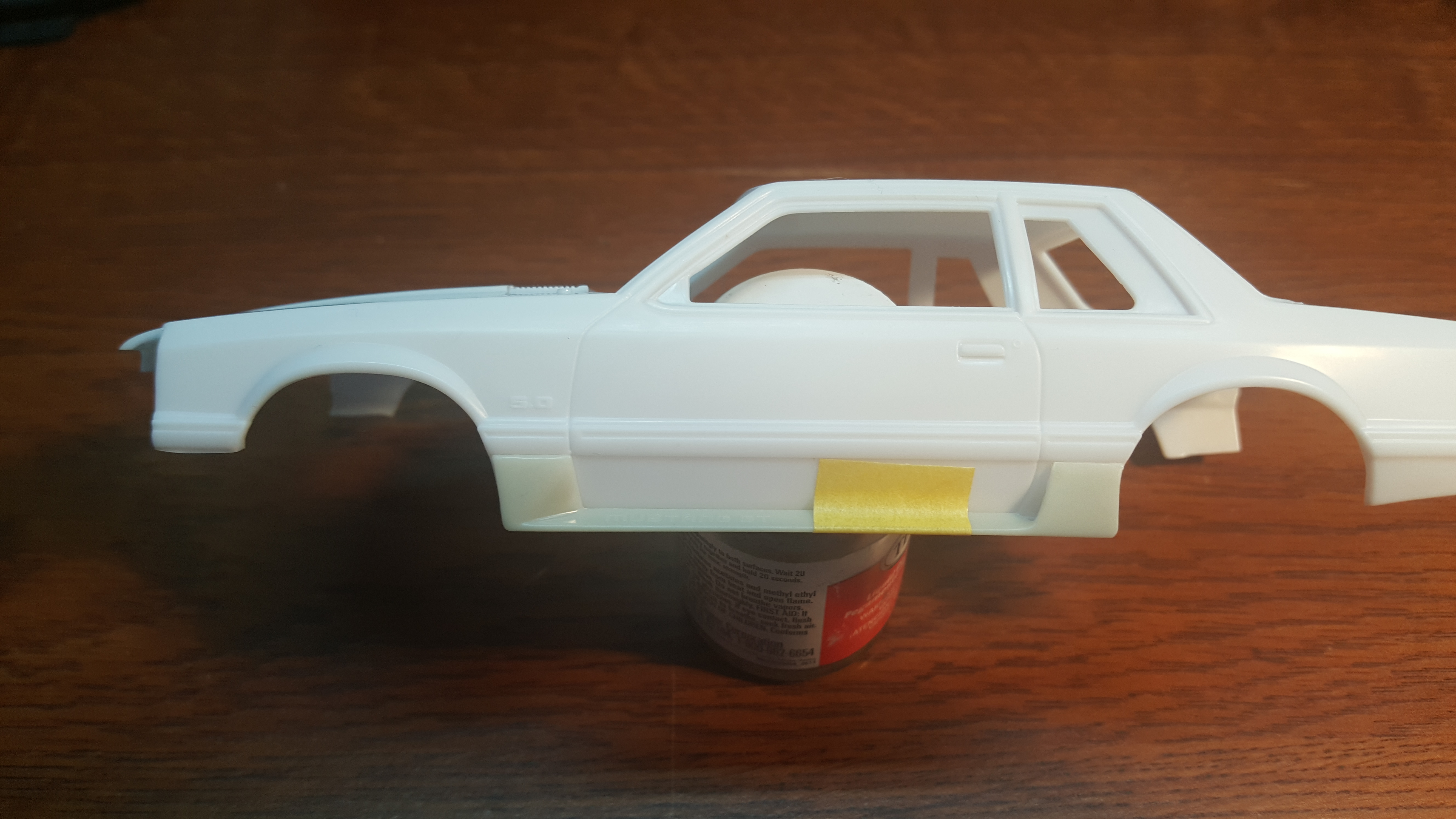

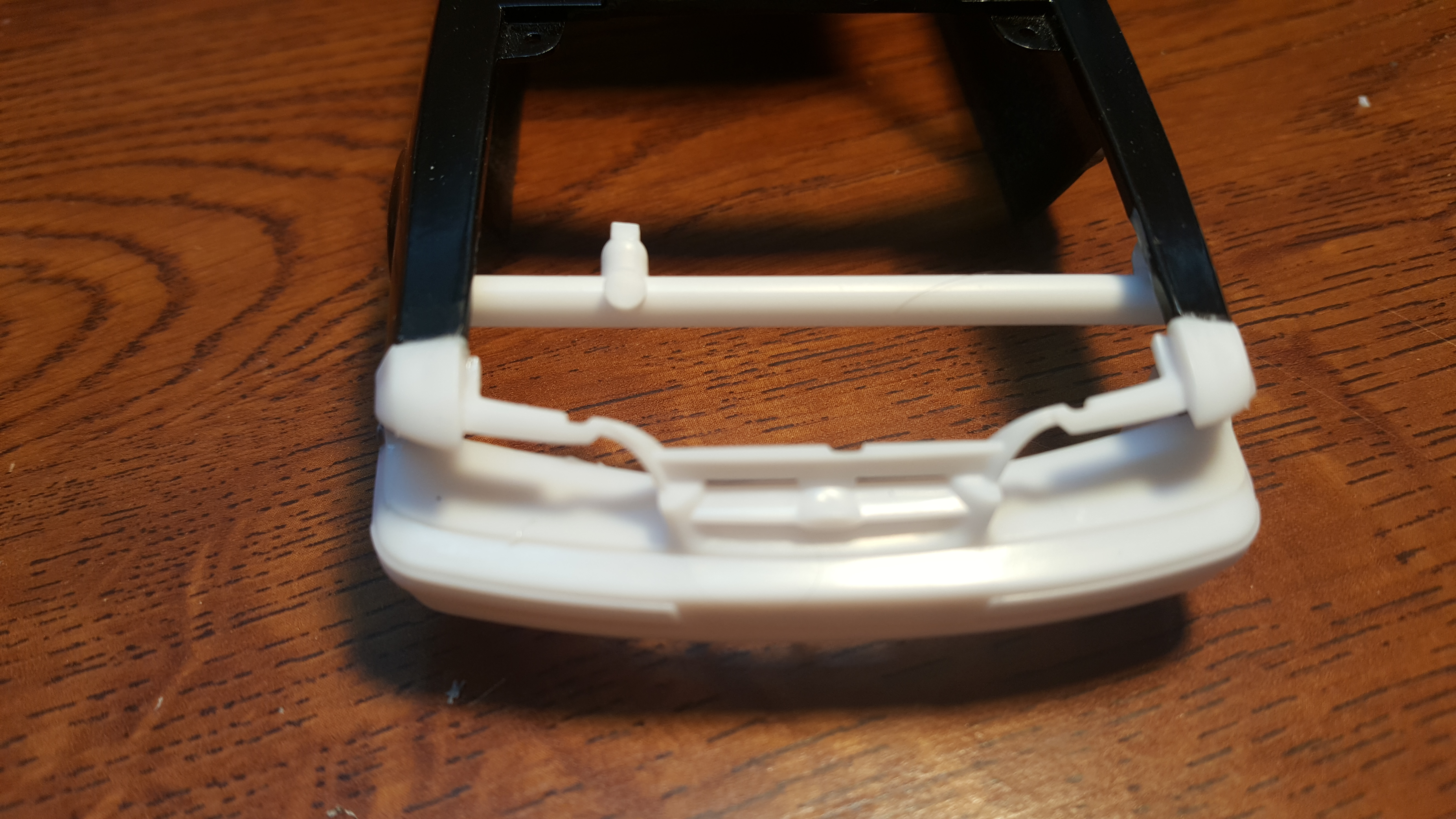

Yes, even though both kits are 25th scale the Revell car is slightly bigger... I added the brace between the fenders on the hatchback to push them out for a closer fit. Then I assembled the front ends to the bodies with welders glue. Next I'll be adding filler to merge the panels so they are a closer fit. Probably won't be 100% but... meh. Lol! I try not to take myself to serious. or I'd never finish anything.

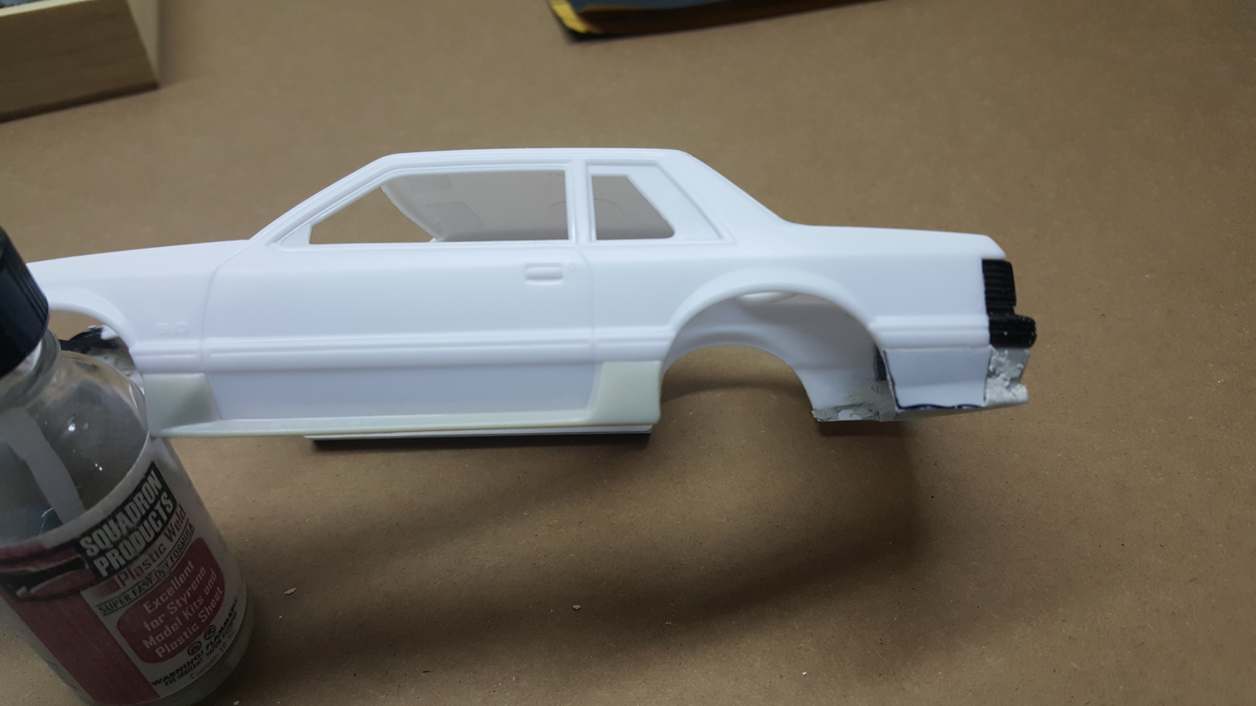

On the notch car I was unable to get the smaller GT parts to fit closer so I just "bonked" them onto the body. I'm hoping with a little filler work it'll look better.

I packed some filler on so the panels line up better...off to contouring when that dries.  I've got an audience here with Casey cat...

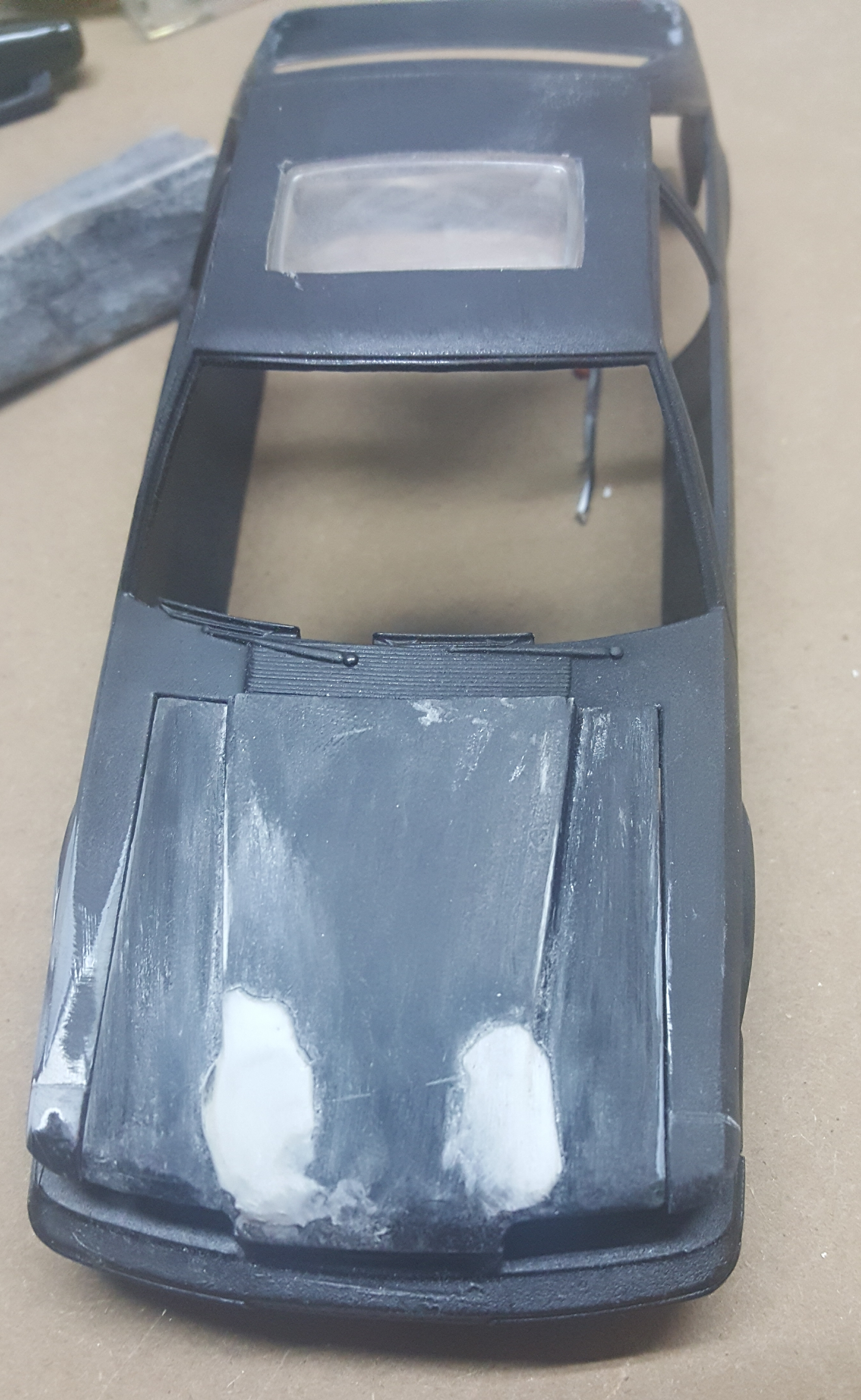

I'm gettin the hood scoop work done on the black one but I have to admit that I've lost steam on these lately. I've been busy working on the house and yard work. I really need to get back to work on them. Today is a prefect day because it pouring rain.

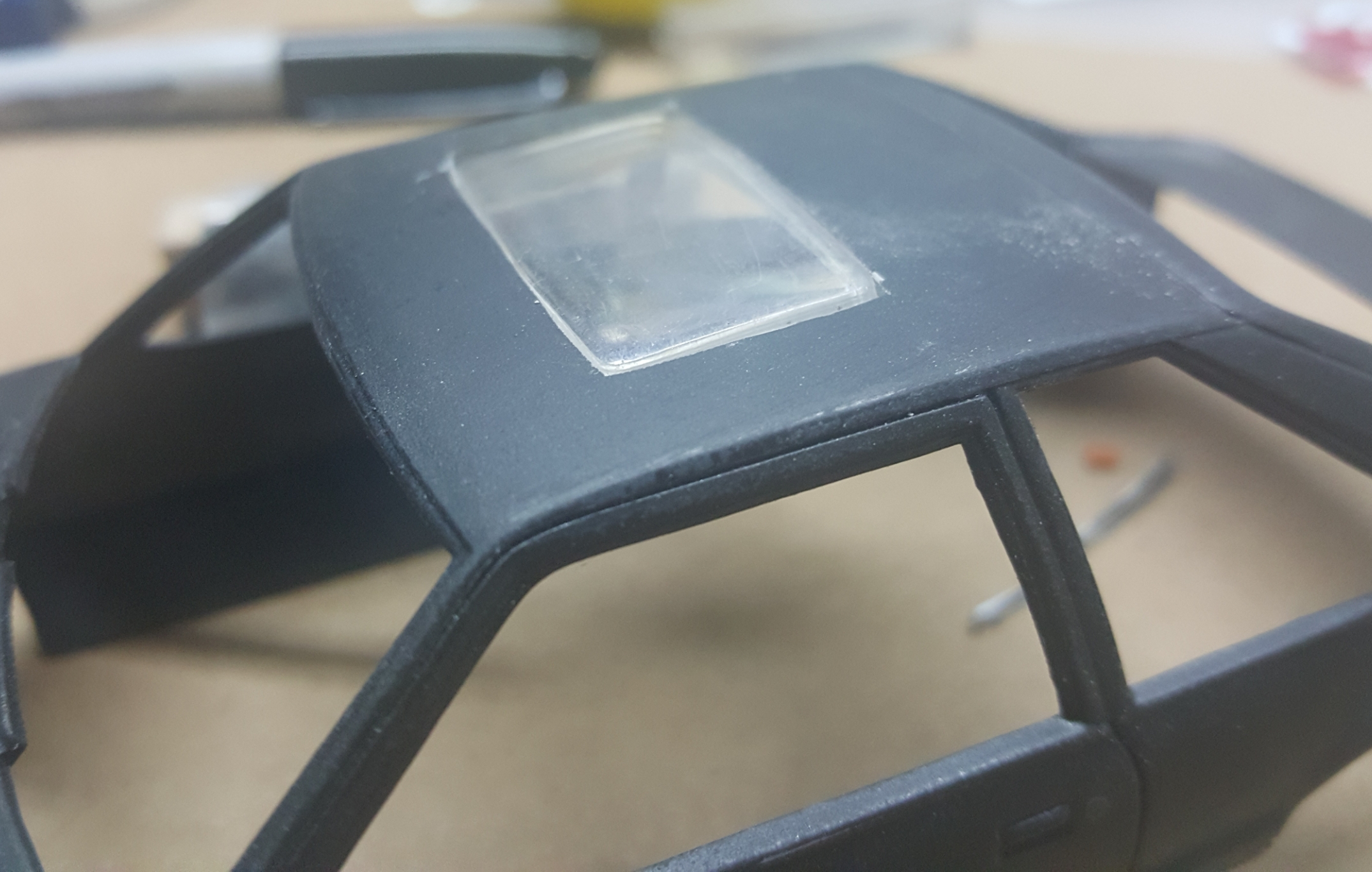

I'm working on the replica today... the real Mustang has a sunroof so I'm working on grafting a PT crusier glass. It seems to have the same contours. Would've been nice to have the cutout lines for it, instead it has t-top cutouts. Also doing bodywork and raising the middle of the hood to look like the 1-1/2 inch scoop on the real car.
