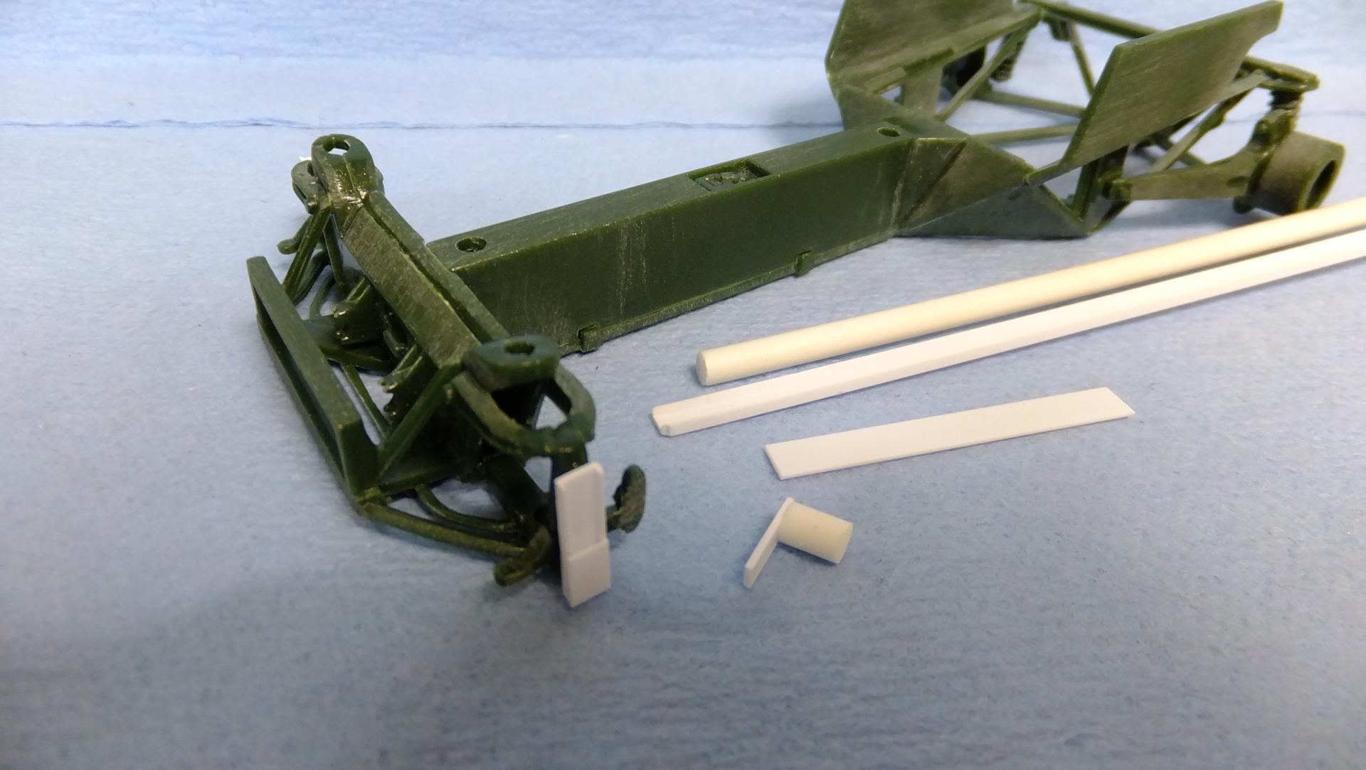

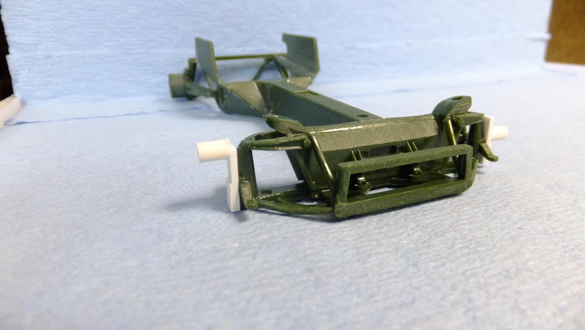

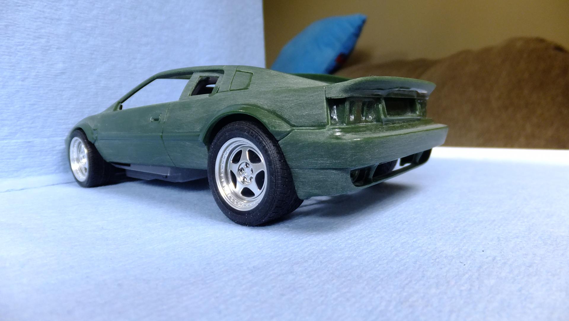

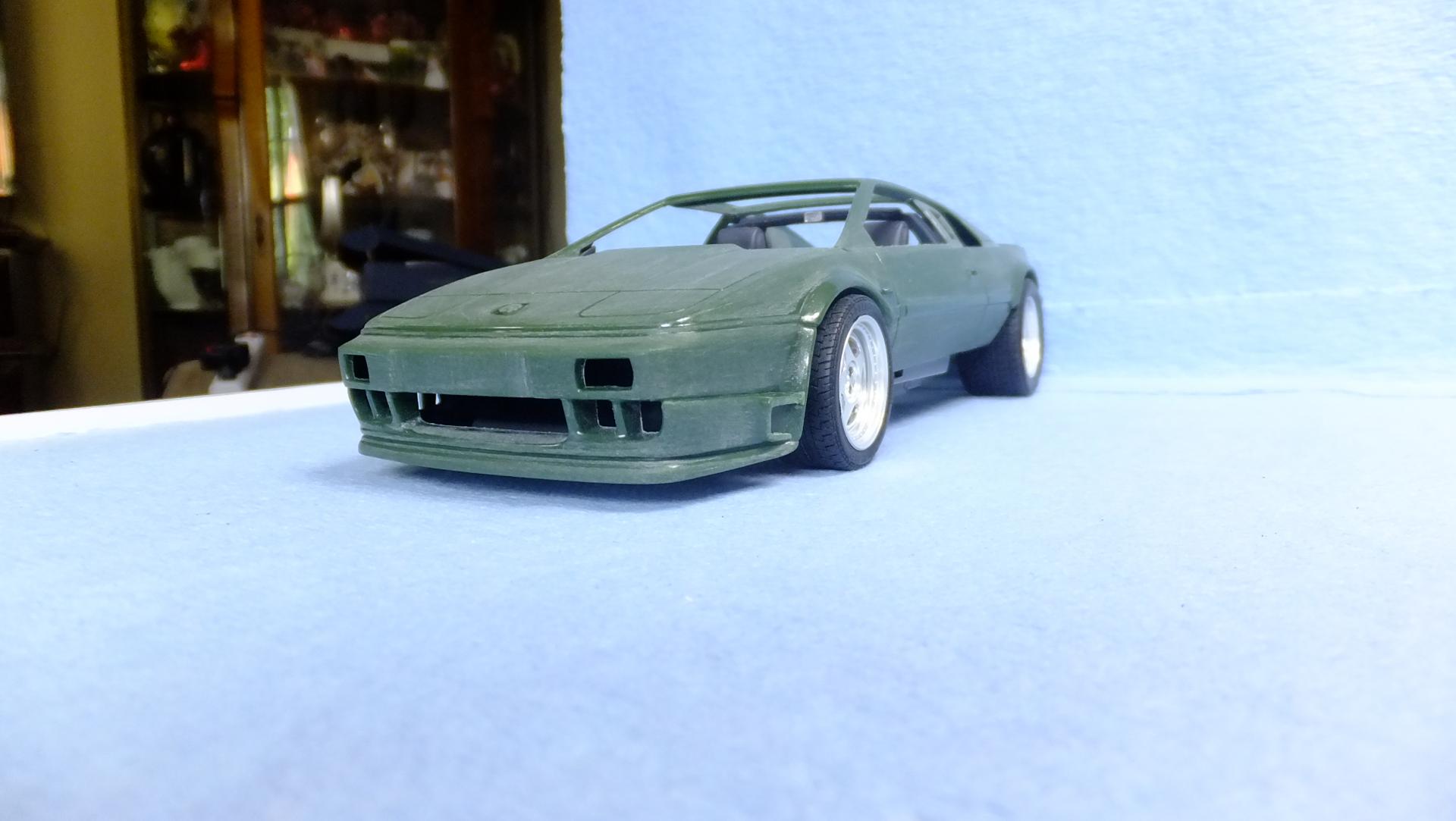

Dann Tier Posted July 11, 2019 Author Posted July 11, 2019 (edited) Hey, everyone!, Here is how i dealt with the front end suspension lowering. Wish i woulda got to it sooner for you, Randy, but here it is..... -Photo 1; Here are the bits for the job....to make the slide that the spindles are attached to, i just carefully cut the lips off the C-channel. -Photo 2; Cant remember the size of rod i used for the spindles, but it was barely loose in there, which helps with Canter, and Camber.....i always use a thicker glue for mounting my wheels, and tyres. E6000 craft glue is my favorite, it gives you time to tweak things....fills in the loose space, and cures great!! -Photo 3; Starting position, which happens to be where i'm gonna set it at. -Photo 4; Look how high the spindle on the left can slide up.....drastically lowering the car!!....notice the one on the right is still at the start position. FINAL THOUGHTS; This technique can be used to fix so many issues....including kits that were built right, but doesnt fit flat on all fours. Hope this helps with other kits as well!! Edited July 11, 2019 by Dann Tier
Dann Tier Posted July 11, 2019 Author Posted July 11, 2019 (edited) 5 minutes ago, randyc said: Okay, that is a good looking solution! Thanks! You bet, Bud!!...it works a treat!!, AND theres still plenty of room for brakes, and rotors!! Edited July 11, 2019 by Dann Tier
cobraman Posted July 11, 2019 Posted July 11, 2019 Cool solution. I have a model tip toe once in awhile. I find a hammer works good to get it level but it is tough on the body.
