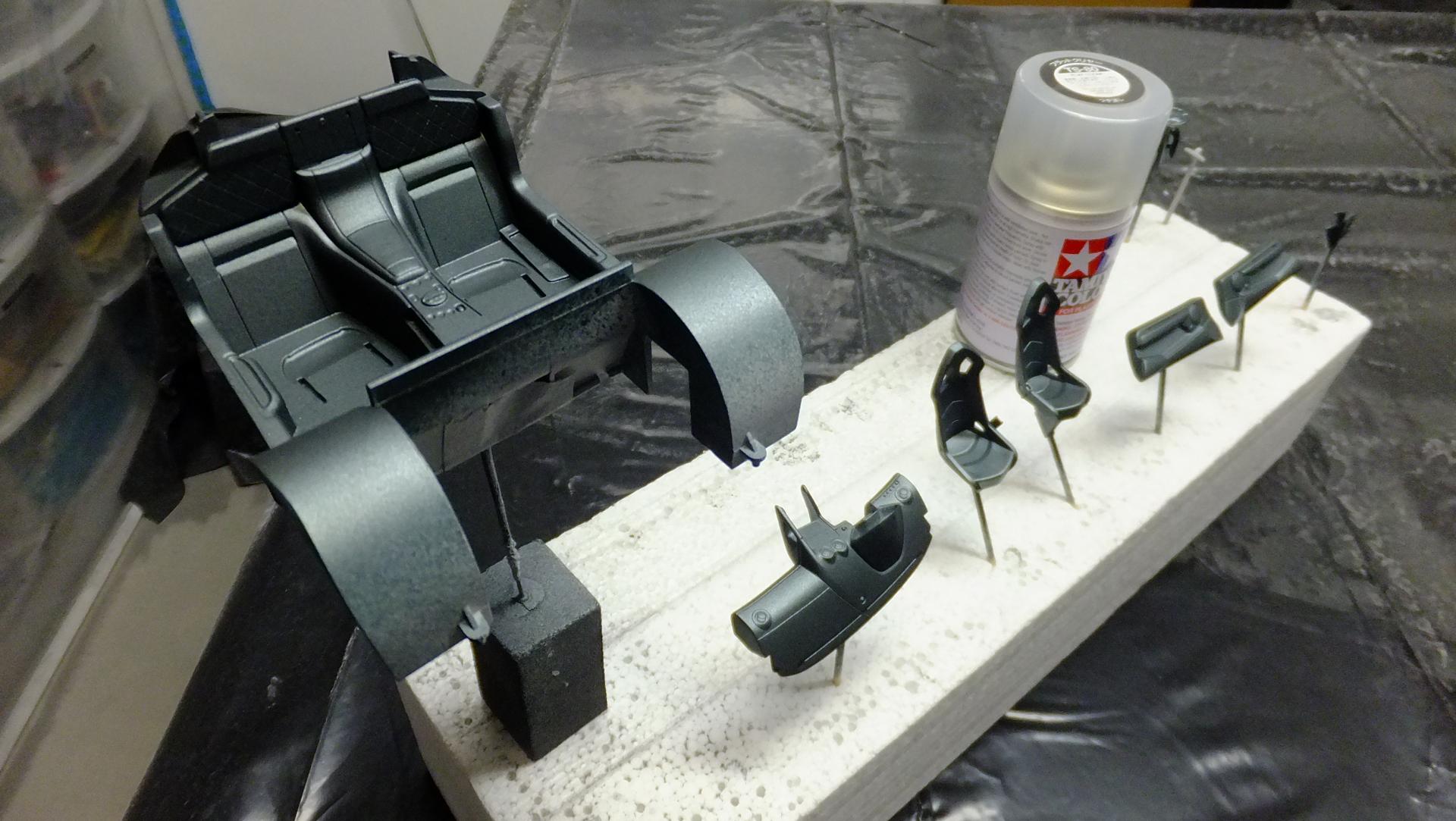

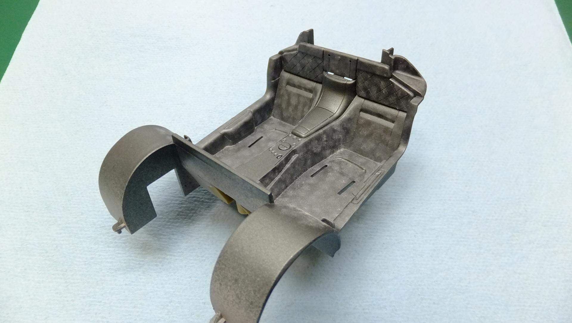

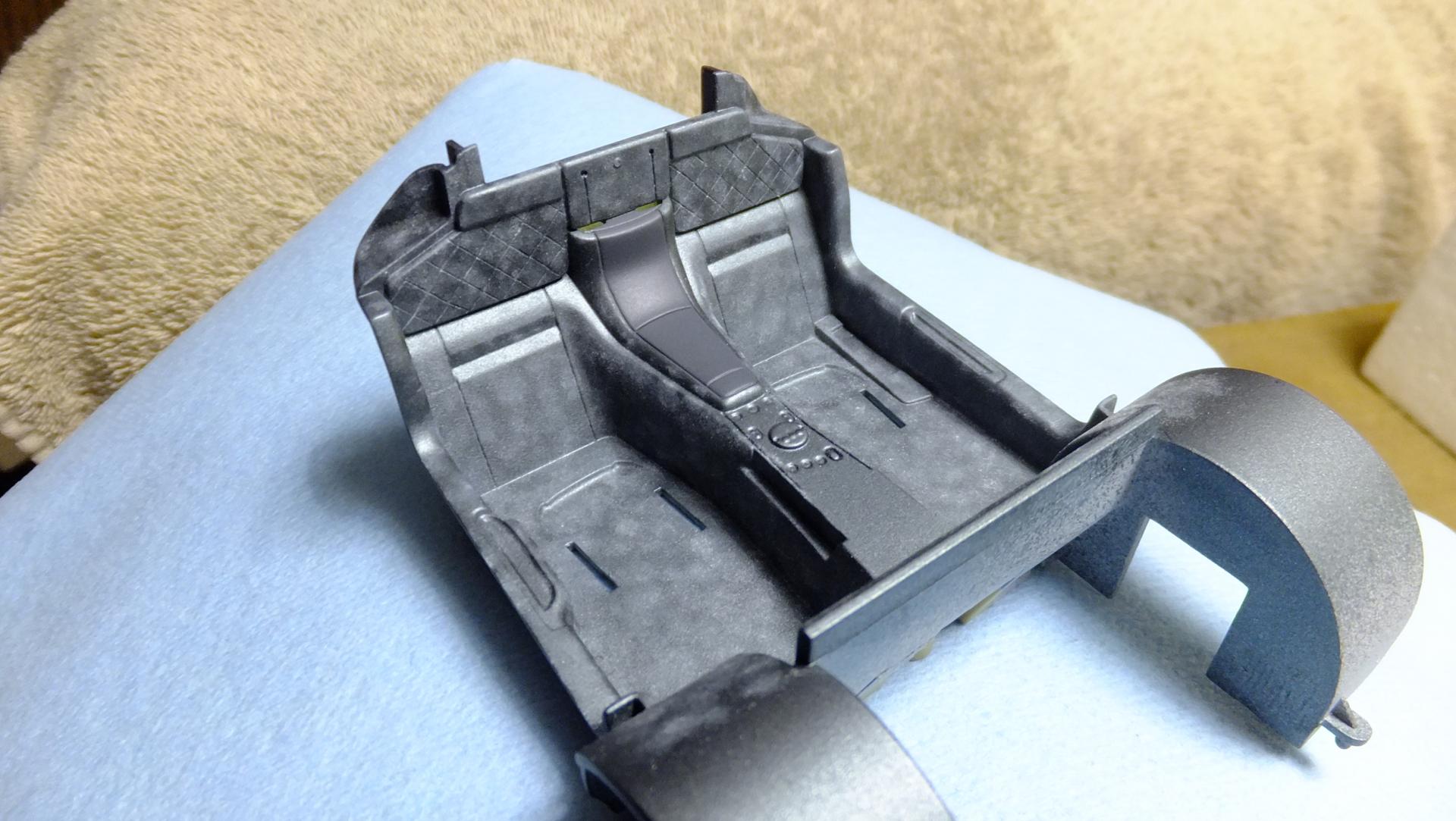

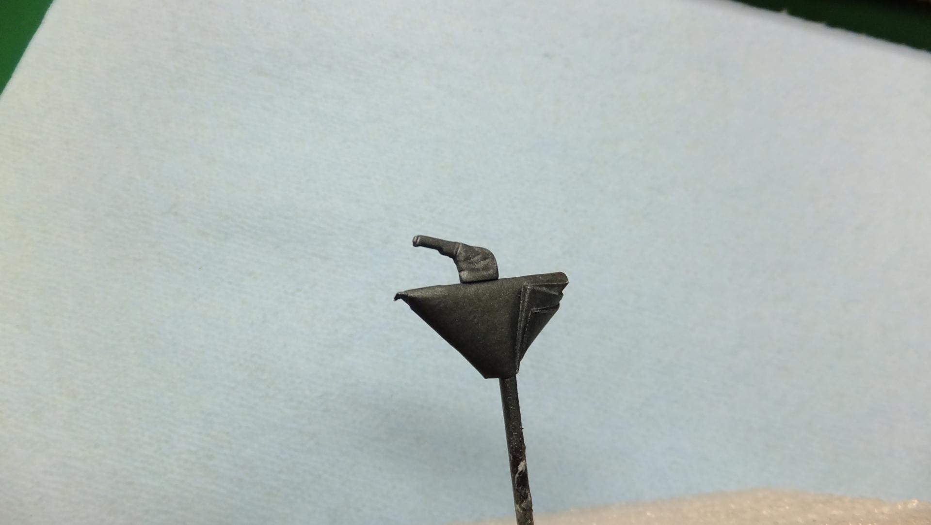

Dann Tier Posted September 28, 2018 Author Posted September 28, 2018 Heres an interior kolor update......I sprayed a kolor that resembles an Aston Martin green, and since its a gloss, I had to cover it with a flat clear, so that I can properly replicate the Alcartana leather.

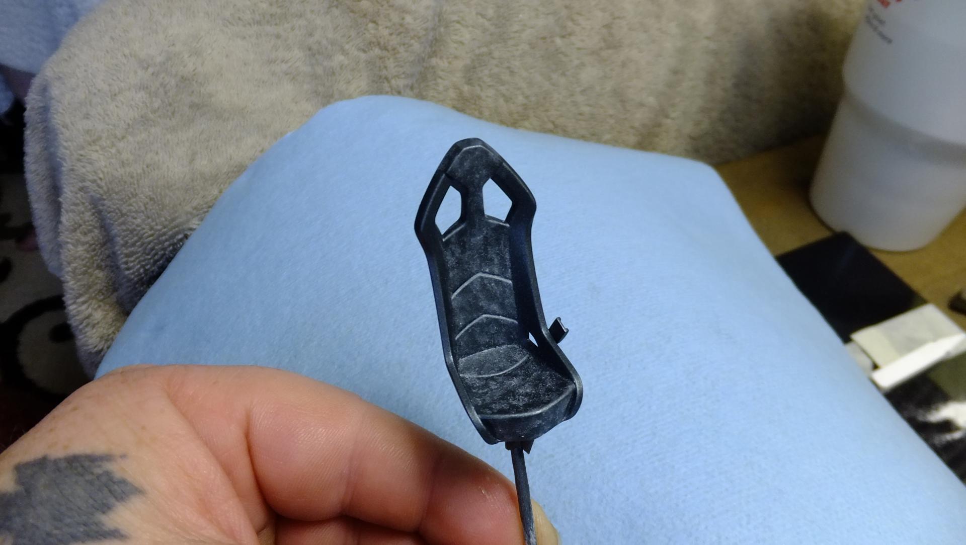

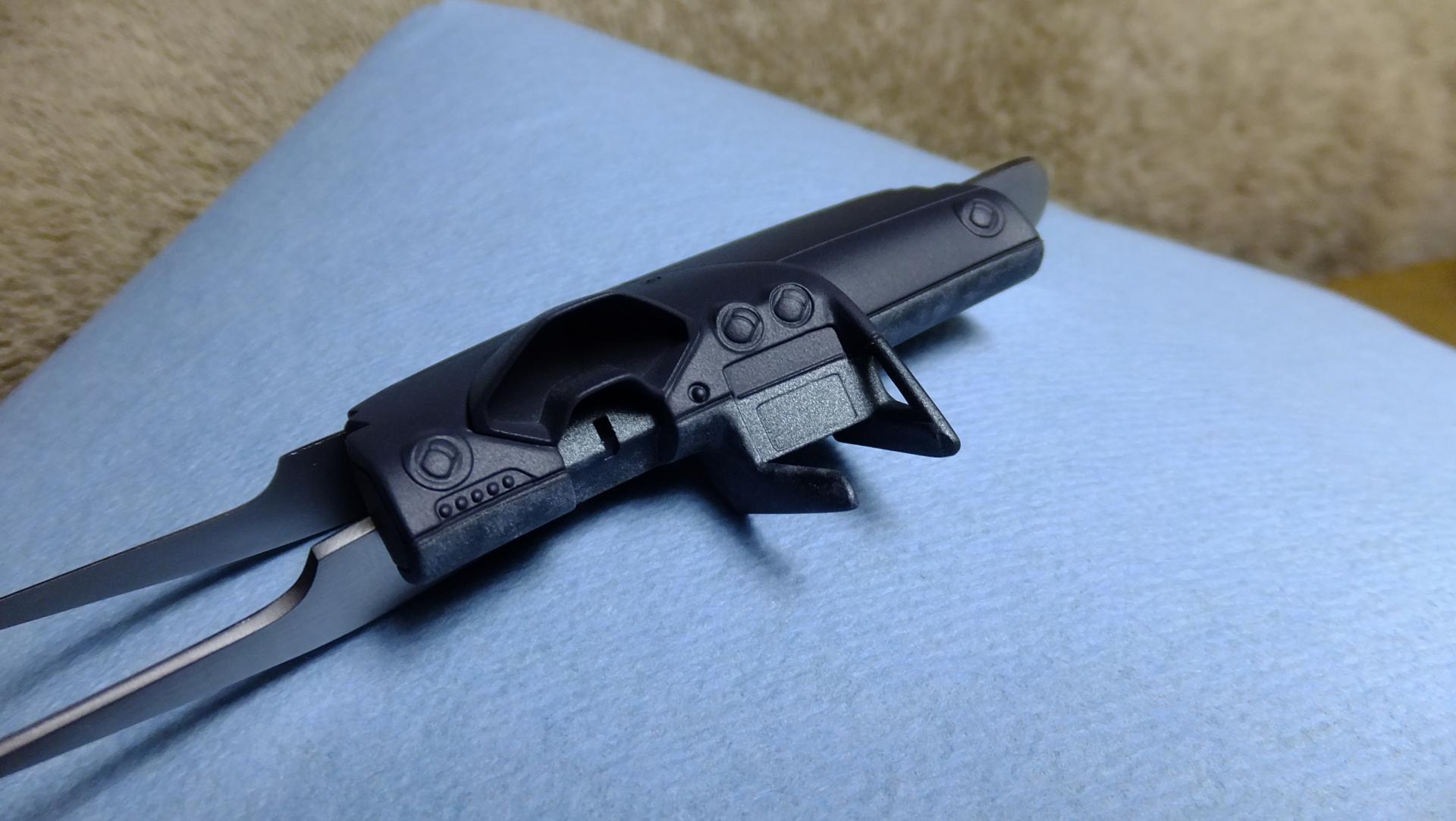

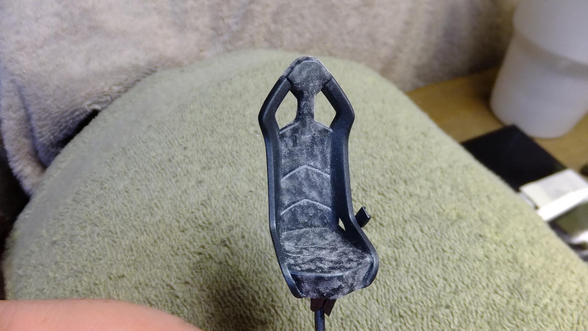

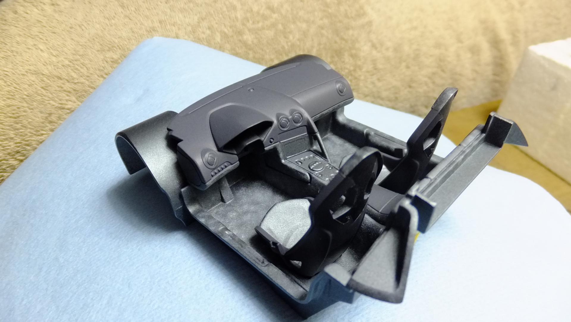

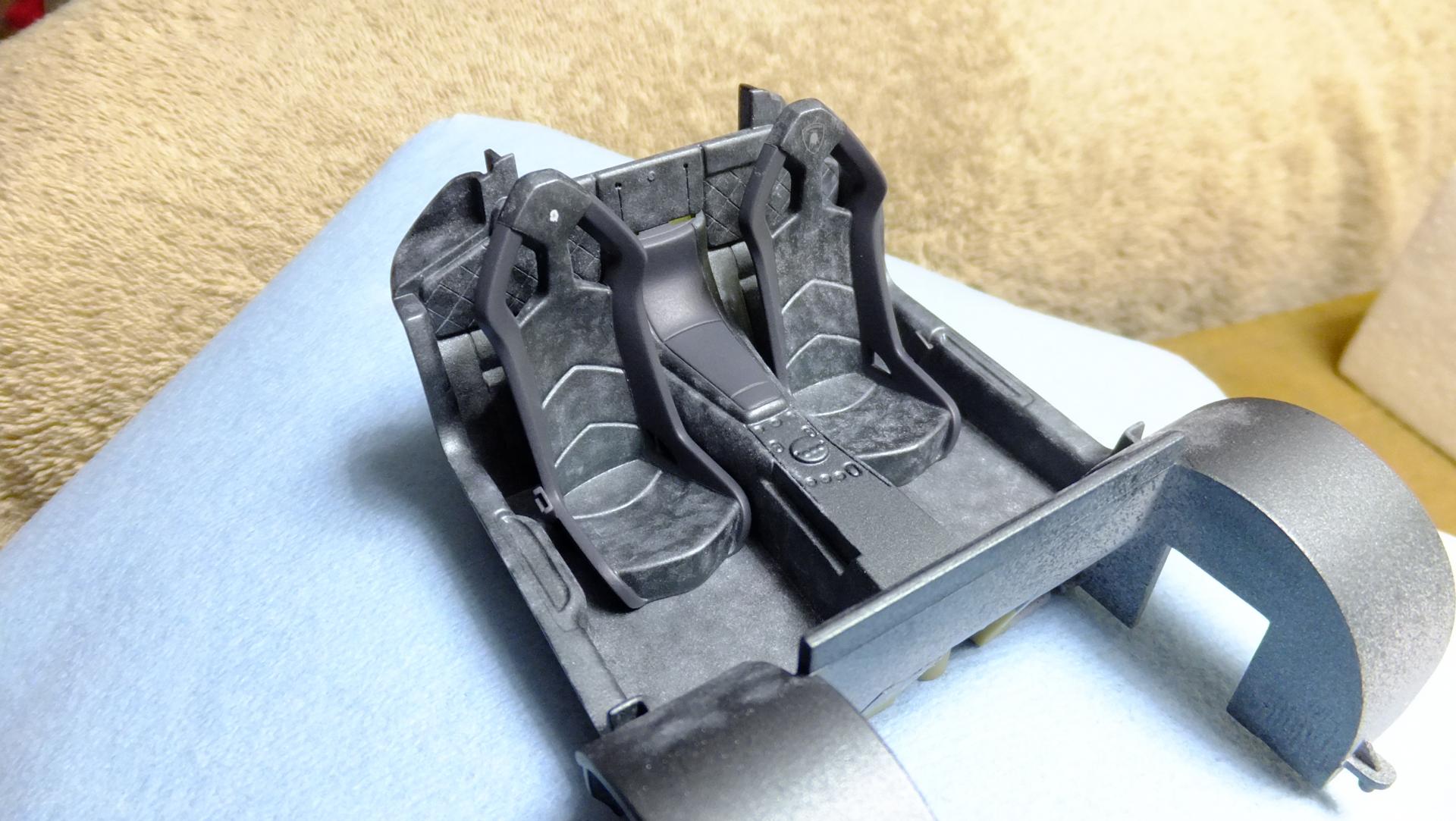

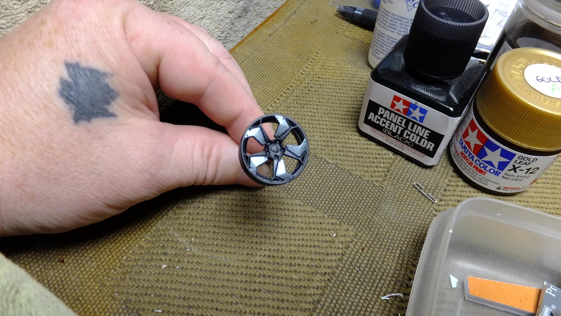

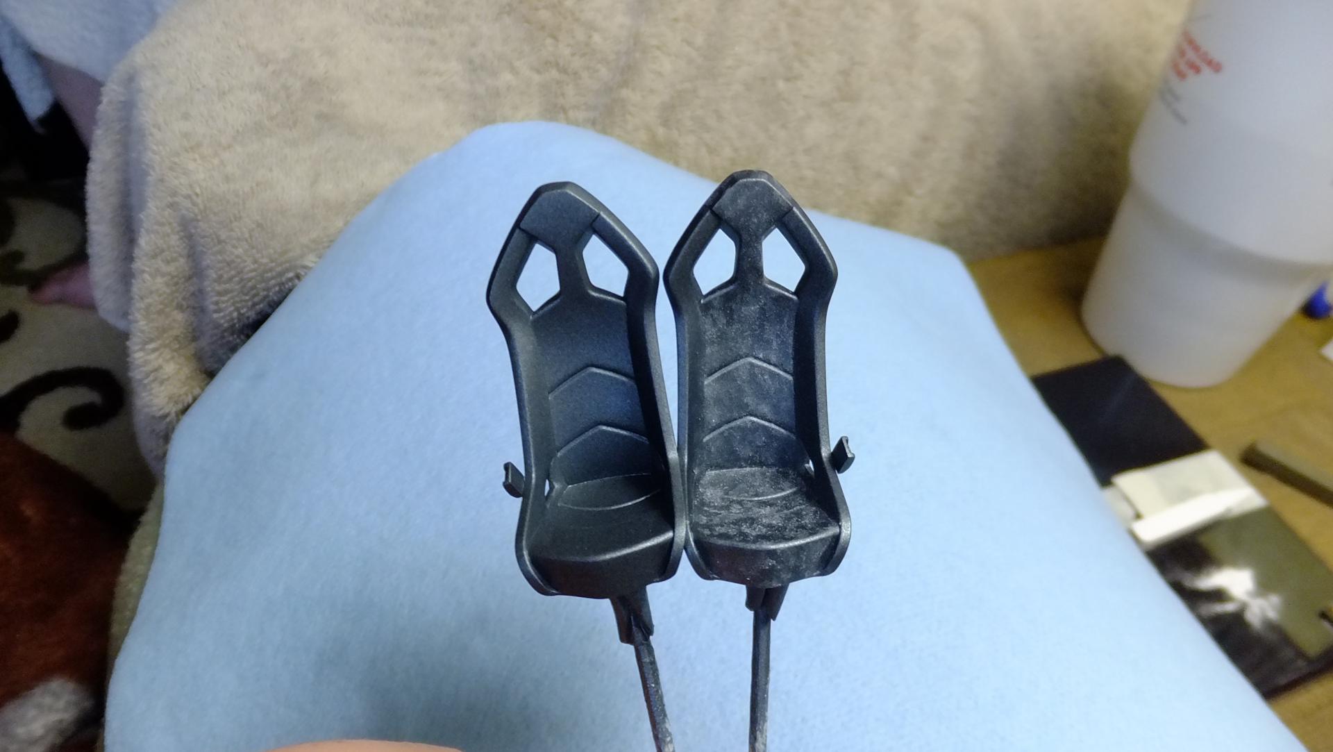

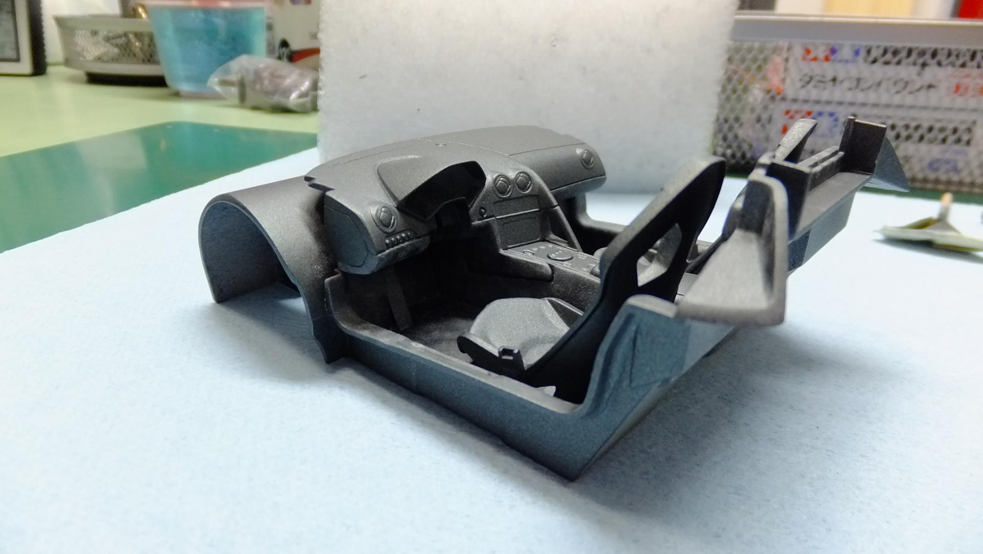

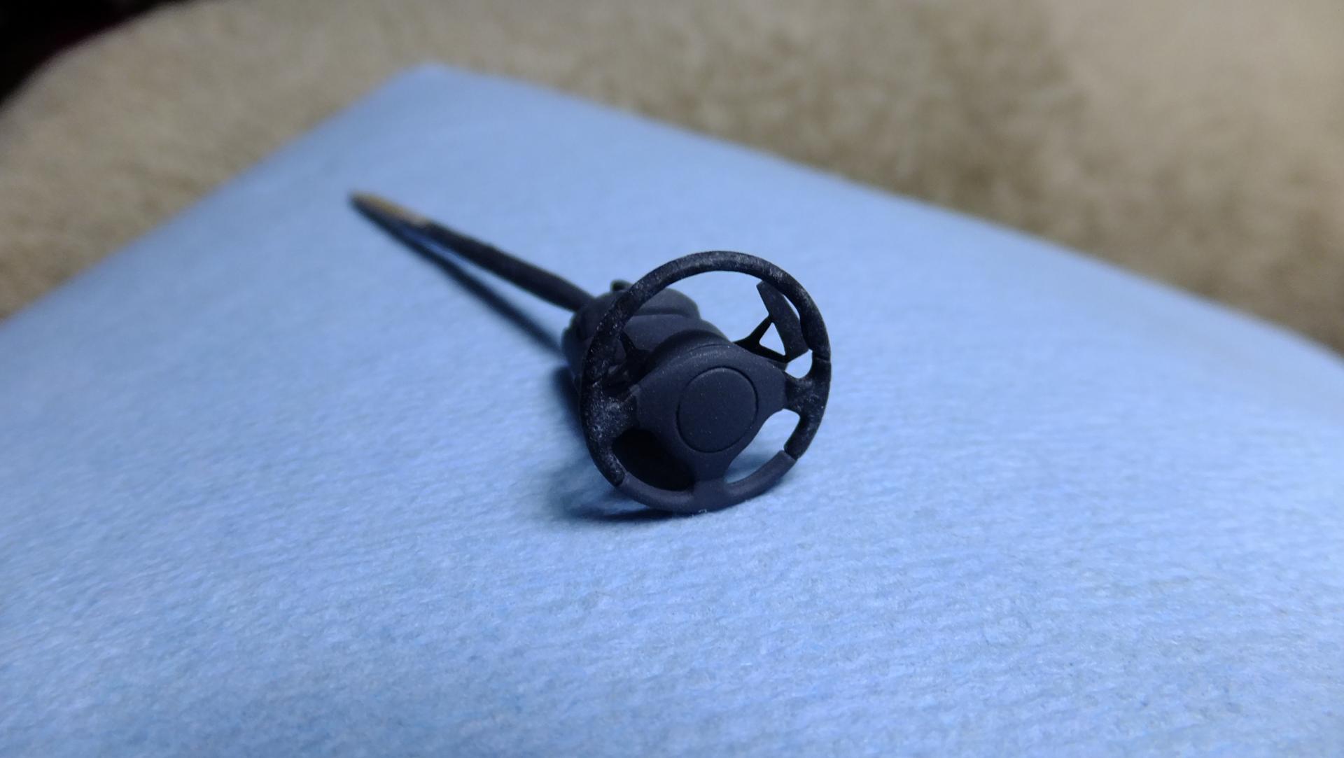

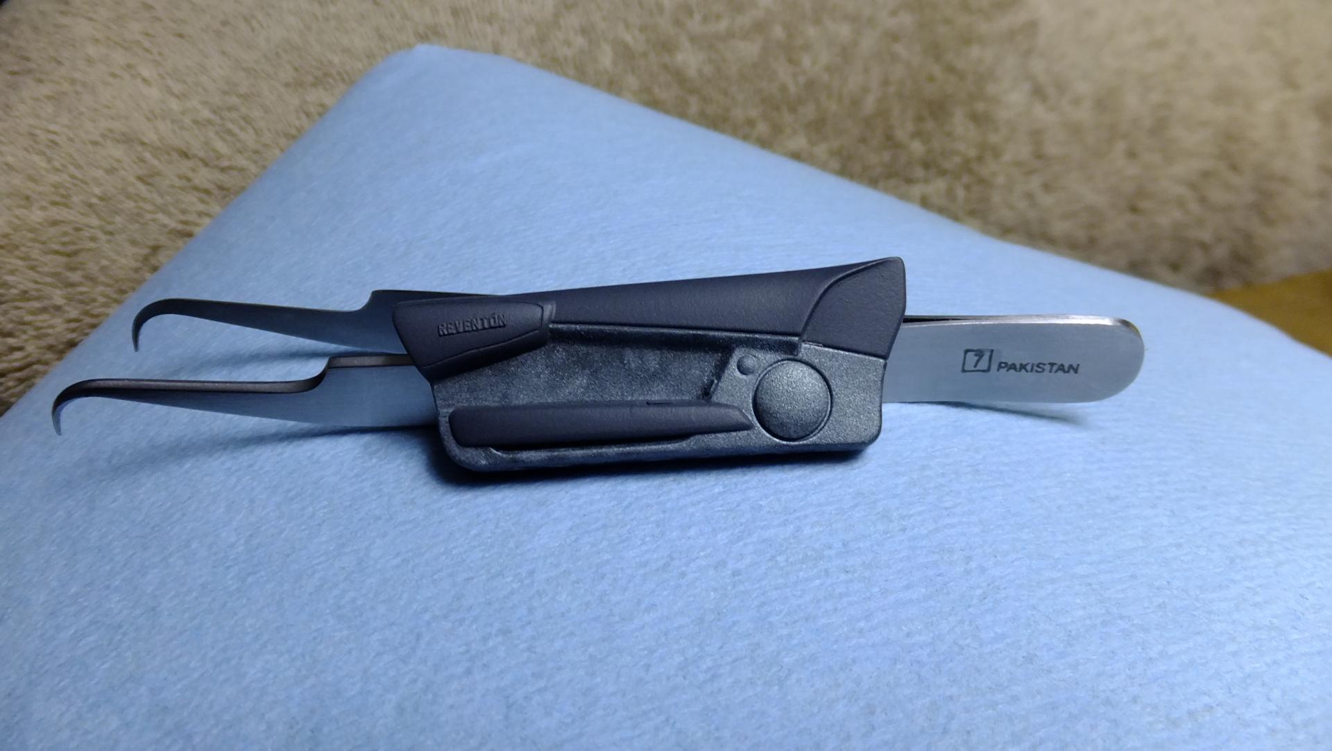

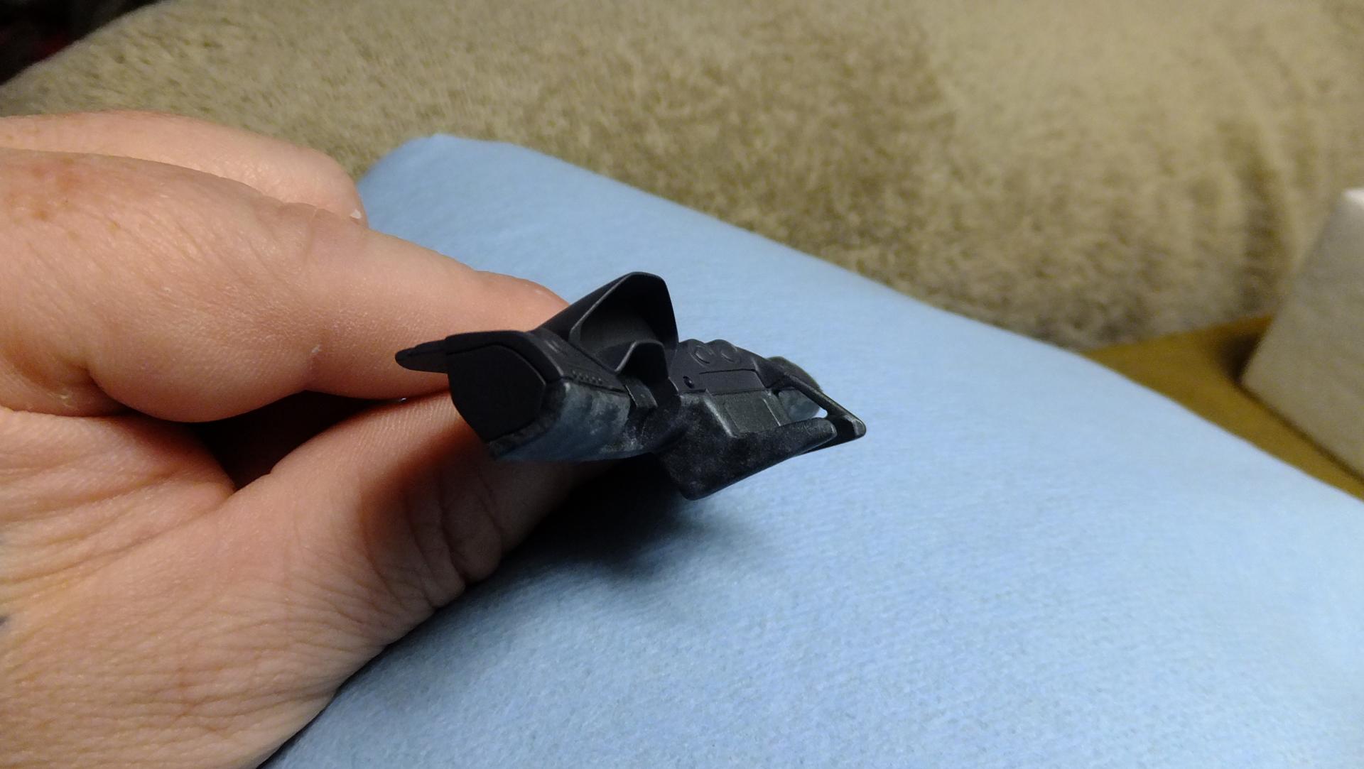

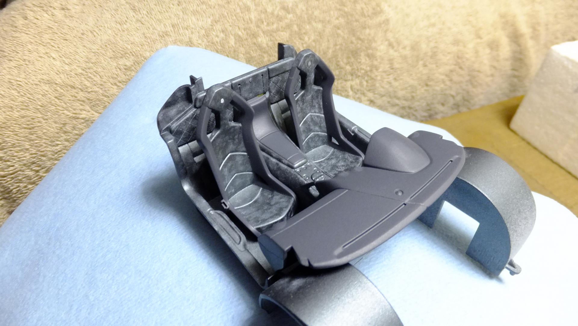

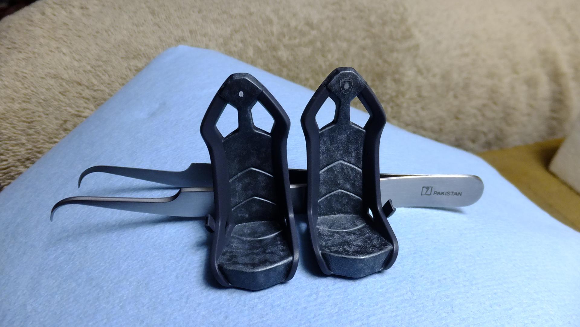

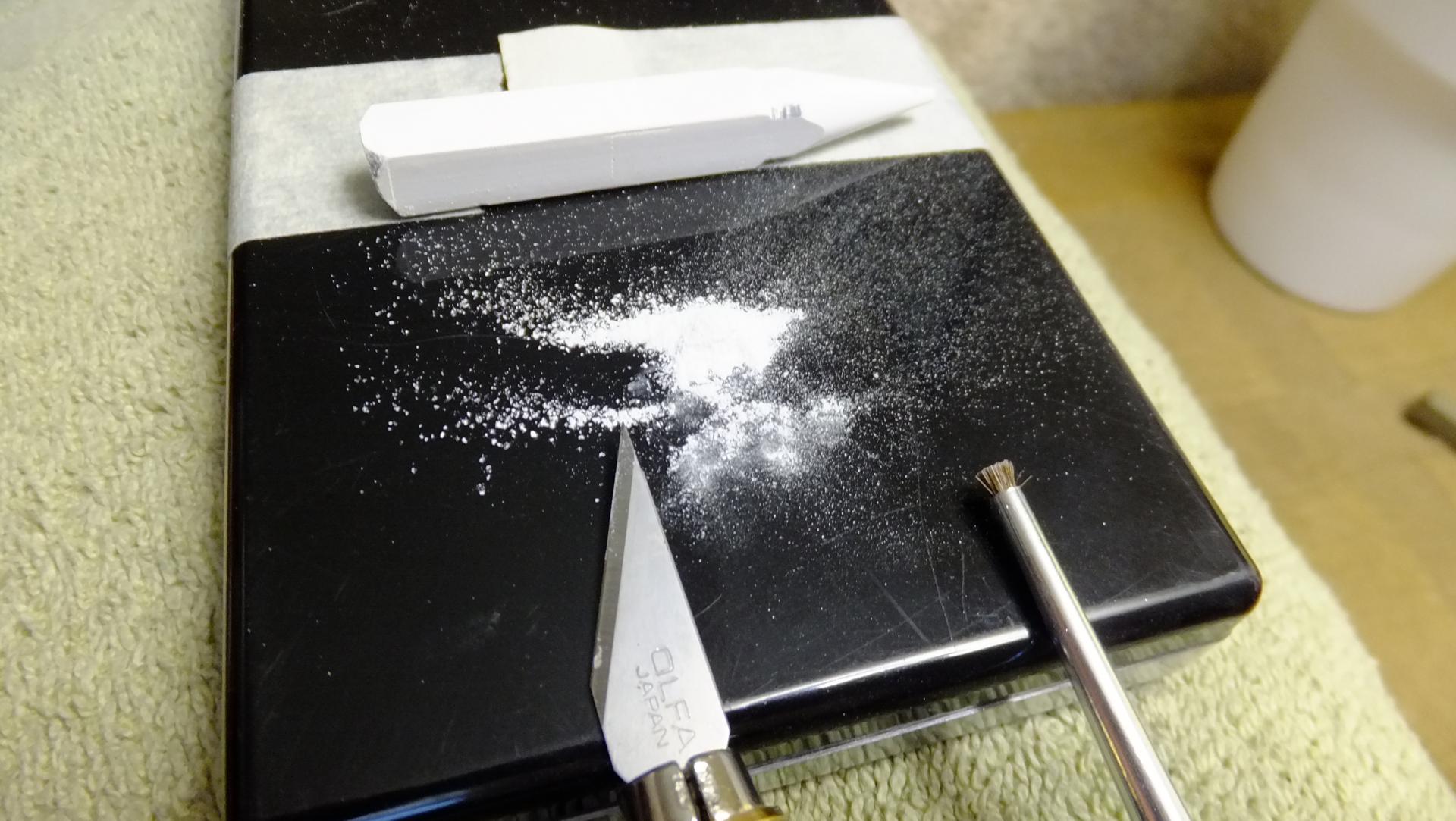

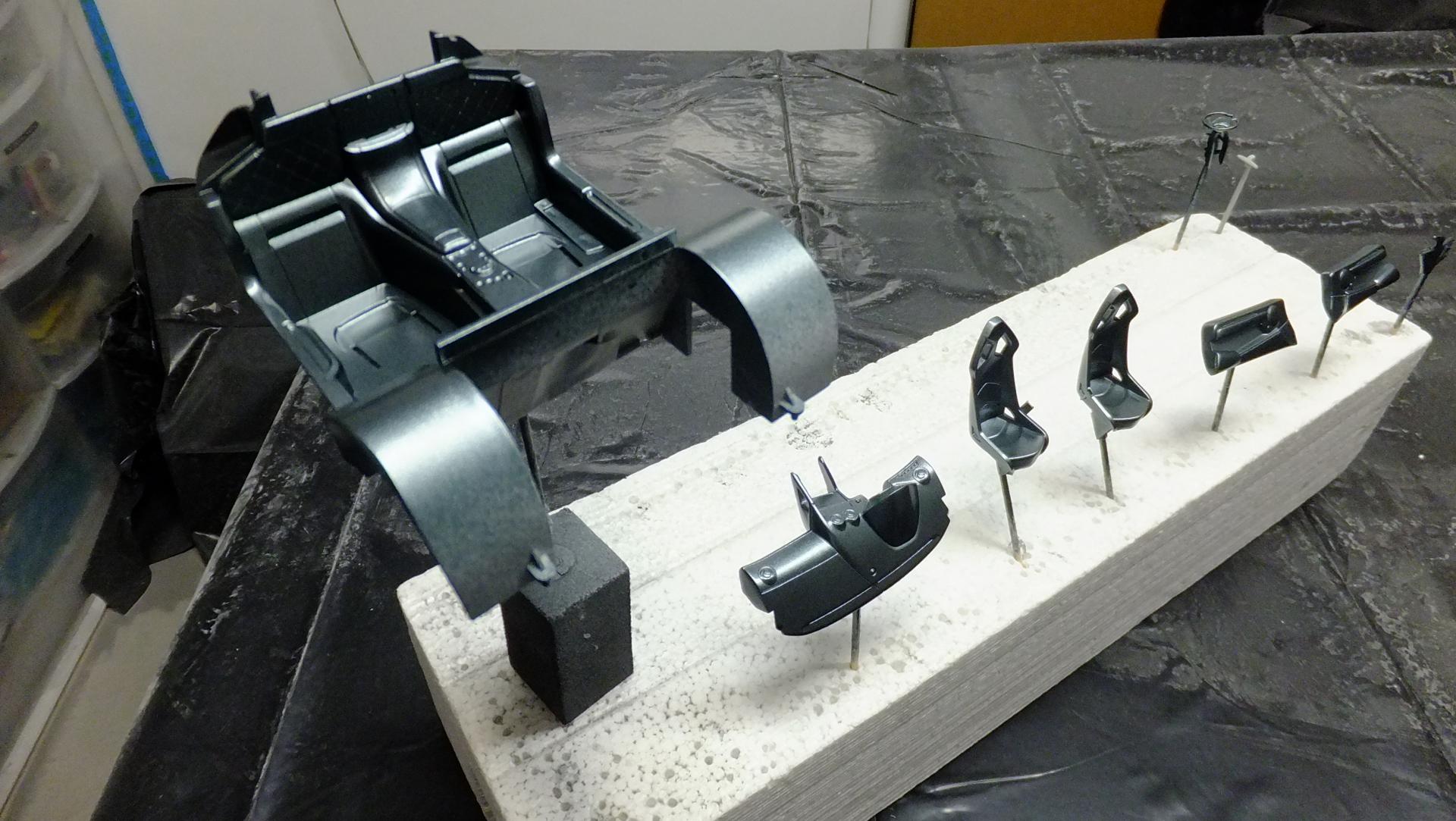

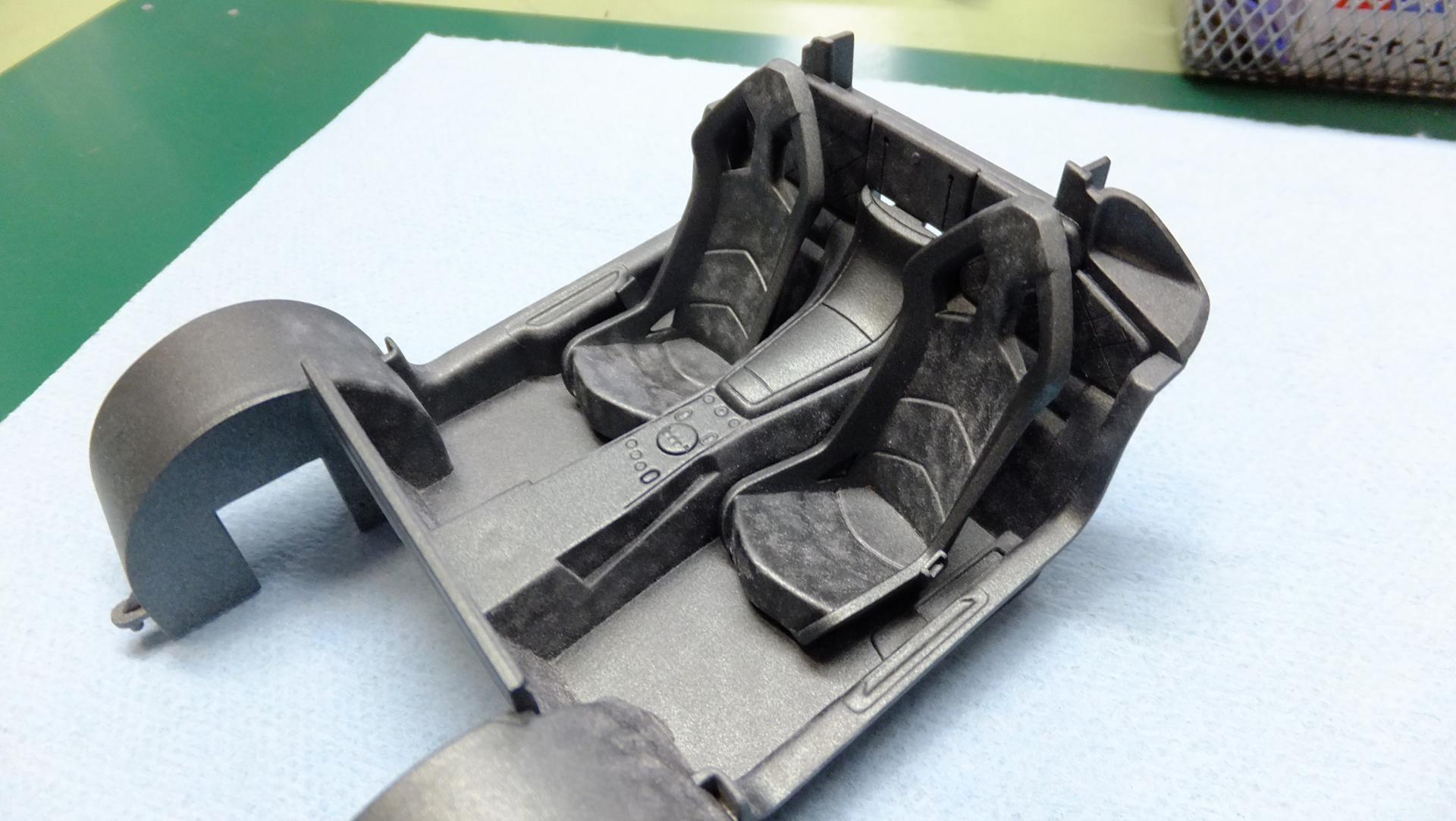

Dann Tier Posted October 8, 2018 Author Posted October 8, 2018 Okay, everyone, as promised, heres how I replicate Lamborghinis Alcantera leather...... -Photo 2; I chose to scrape white calk with a blade, then used an old brush that I chopped short to make it stiffer. -Photo 3; Here you can see how I dabbed it on.....it needs to be a bit heavier than what you want, since the flat clear will cause some of it to disappear. -Photo 4; This is what it will look like after you seal it in with flat clear.....I used Tamiya brand. -Photo 5; Heres the comparison with the painted kit seat.

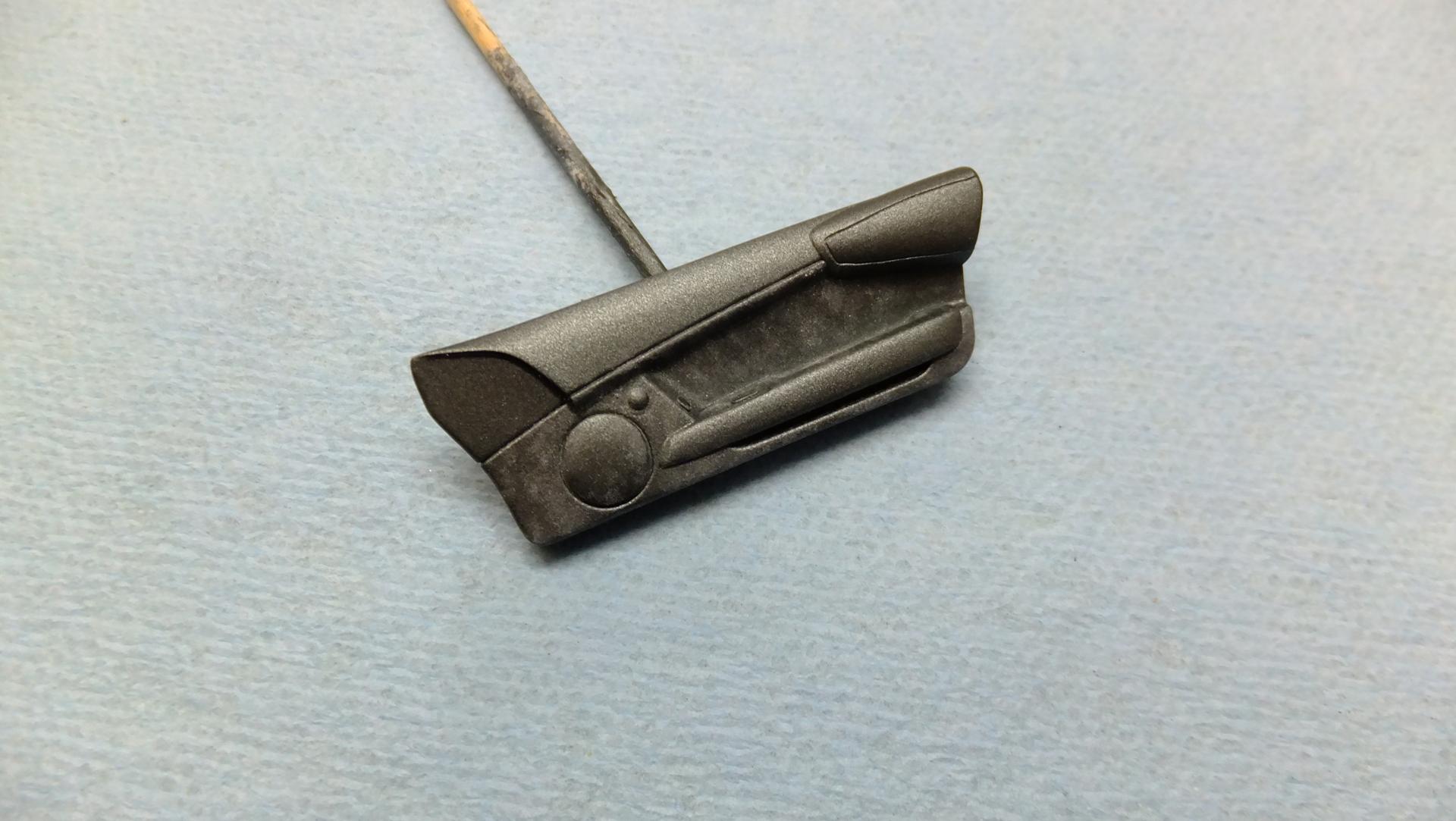

Dann Tier Posted October 12, 2018 Author Posted October 12, 2018 6 hours ago, Codi said: Dann, you're appealing to all of my scratch-building hot buttons. That's a great tip you shared and love the way you tackled it. Keep it up sir. cheers Thanks, Tim!!...glad you're liking it!...its a fun build. Within the next day or so, I will mask-off the Alcantera parts, a spray the satin leather kolor.

Exotics_Builder Posted October 13, 2018 Posted October 13, 2018 You dabbed it on with that chopped paint brush in the photo? Anything specific about the chalk? That is about as close a look of ALcantara that I have seen. I have been mist spraying a light color from a distance to get the effect, but it is too regular.
89AKurt Posted October 13, 2018 Posted October 13, 2018 Since I have this kit, will lurk and learn. Does the chalk suck up the paint, so it remains really dull?
Dann Tier Posted October 13, 2018 Author Posted October 13, 2018 41 minutes ago, Exotics_Builder said: You dabbed it on with that chopped paint brush in the photo? Anything specific about the chalk? That is about as close a look of ALcantara that I have seen. I have been mist spraying a light color from a distance to get the effect, but it is too regular. Thanks, Gerry!, theres nothing really special about the chalk, its artist's chalk from Hobby Lobby. I did dab it on with the chopped brush in the photo.
Dann Tier Posted October 13, 2018 Author Posted October 13, 2018 18 minutes ago, 89AKurt said: Since I have this kit, will lurk and learn. Does the chalk suck up the paint, so it remains really dull? That's what i'm here for, bud!, to help. I dab it on a little heavy, because the clear will soak some up, but not too bad. Remember to hit the part with twp light coats from 12" away.

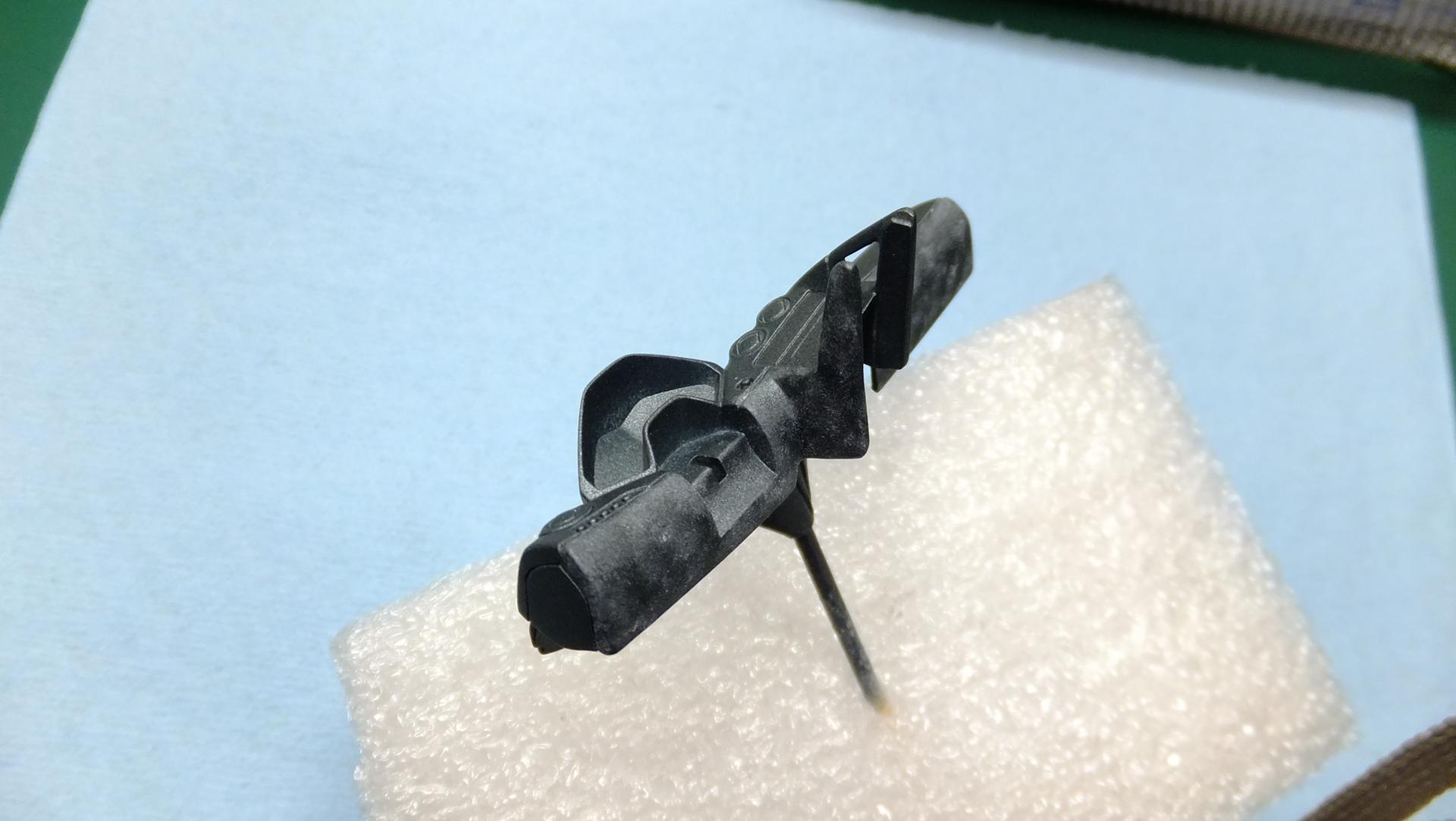

Dann Tier Posted October 23, 2018 Author Posted October 23, 2018 Well, its coming together now, just got done masking, and painting the gray leather, next will be the CF accents, switches, buckles, and something new for the headrests, since the masking pulled off one of the decals...….a bummer, but no worries, I have a fix. The Alcantera was a bit of a bugger to do on the steering wheel, but after my 2nd attempt, I was happy with it.

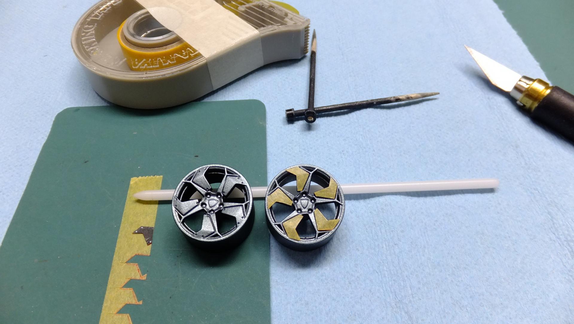

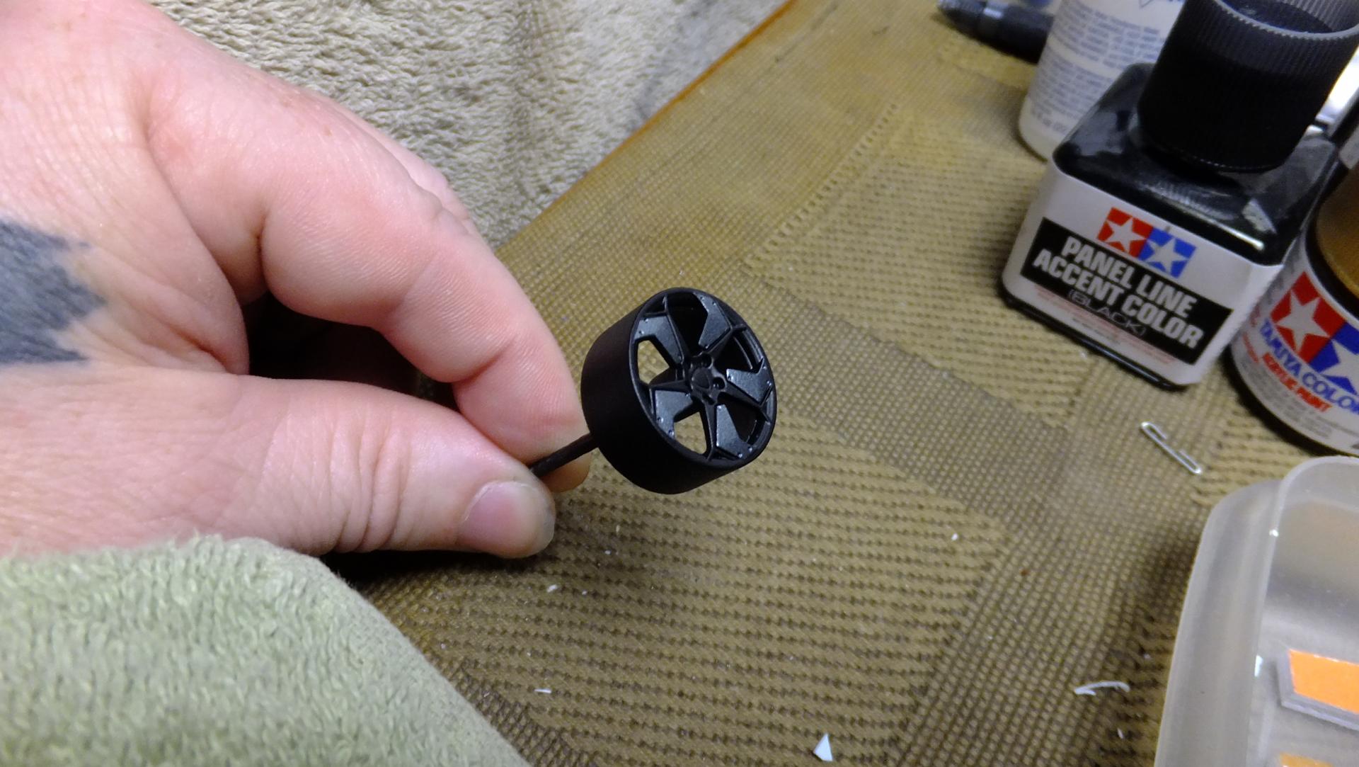

Dann Tier Posted November 2, 2018 Author Posted November 2, 2018 Tday, I managed to just get the wheels done, but they turned out great!
Tommy124 Posted November 2, 2018 Posted November 2, 2018 The master of masking strikes again - great result!
Dann Tier Posted November 2, 2018 Author Posted November 2, 2018 7 hours ago, Tommy124 said: The master of masking strikes again - great result! LOL!!….thanks, Thomas!!...I love masking stuff!!
