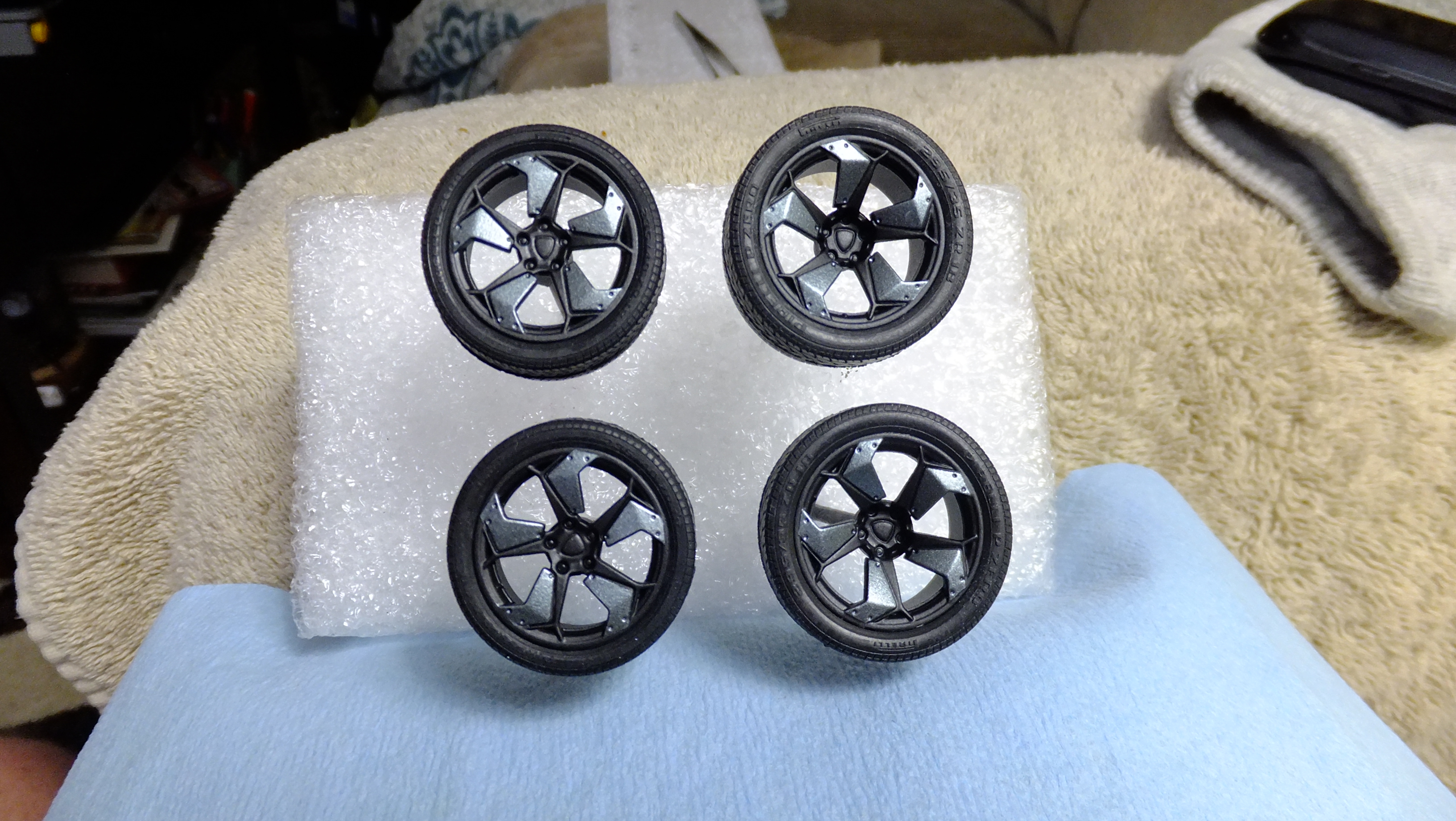

Tommy124 Posted November 7, 2018 Posted November 7, 2018 On 6.11.2018 at 2:38 AM, Dann Tier said: Wheels look great!

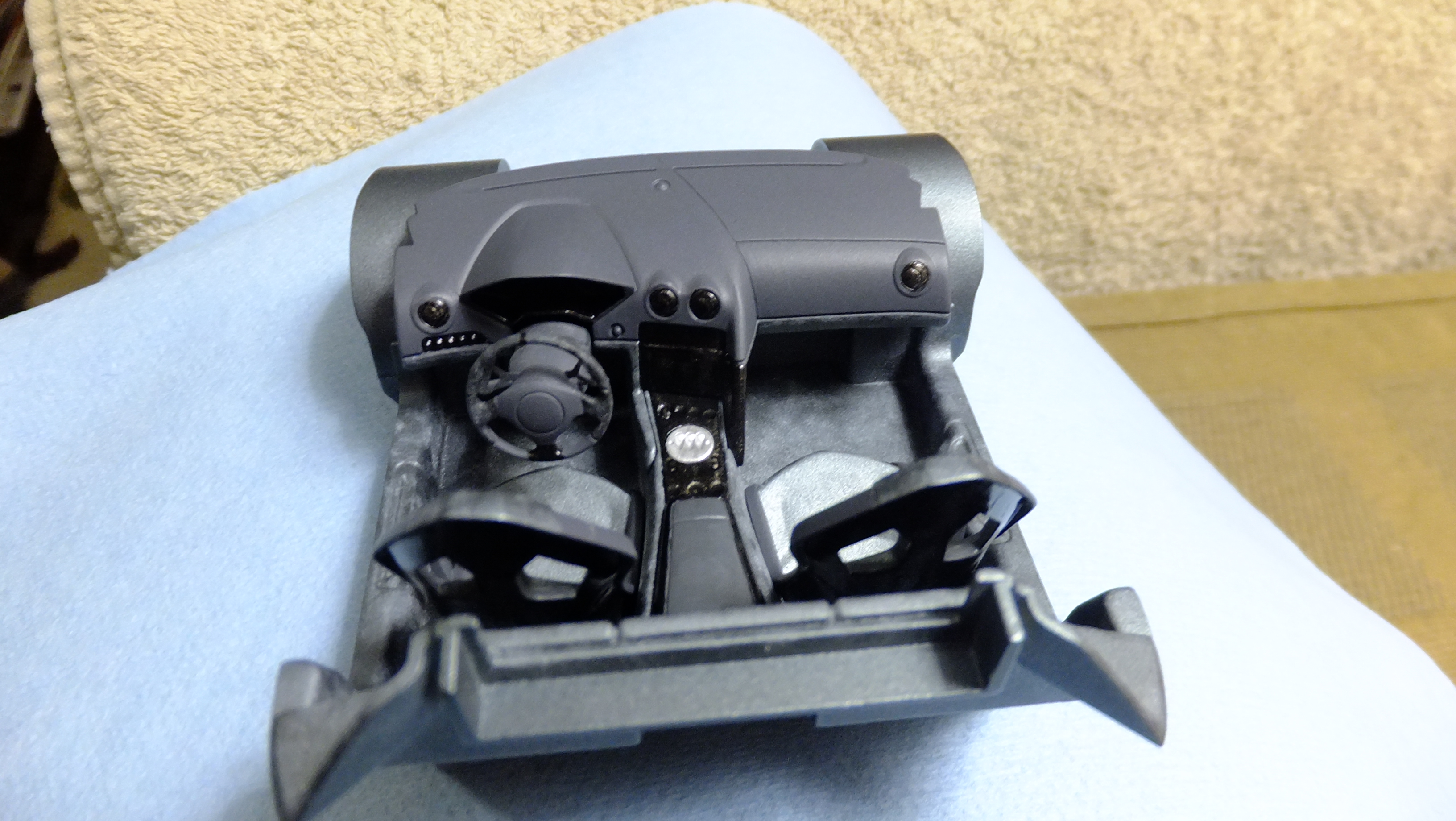

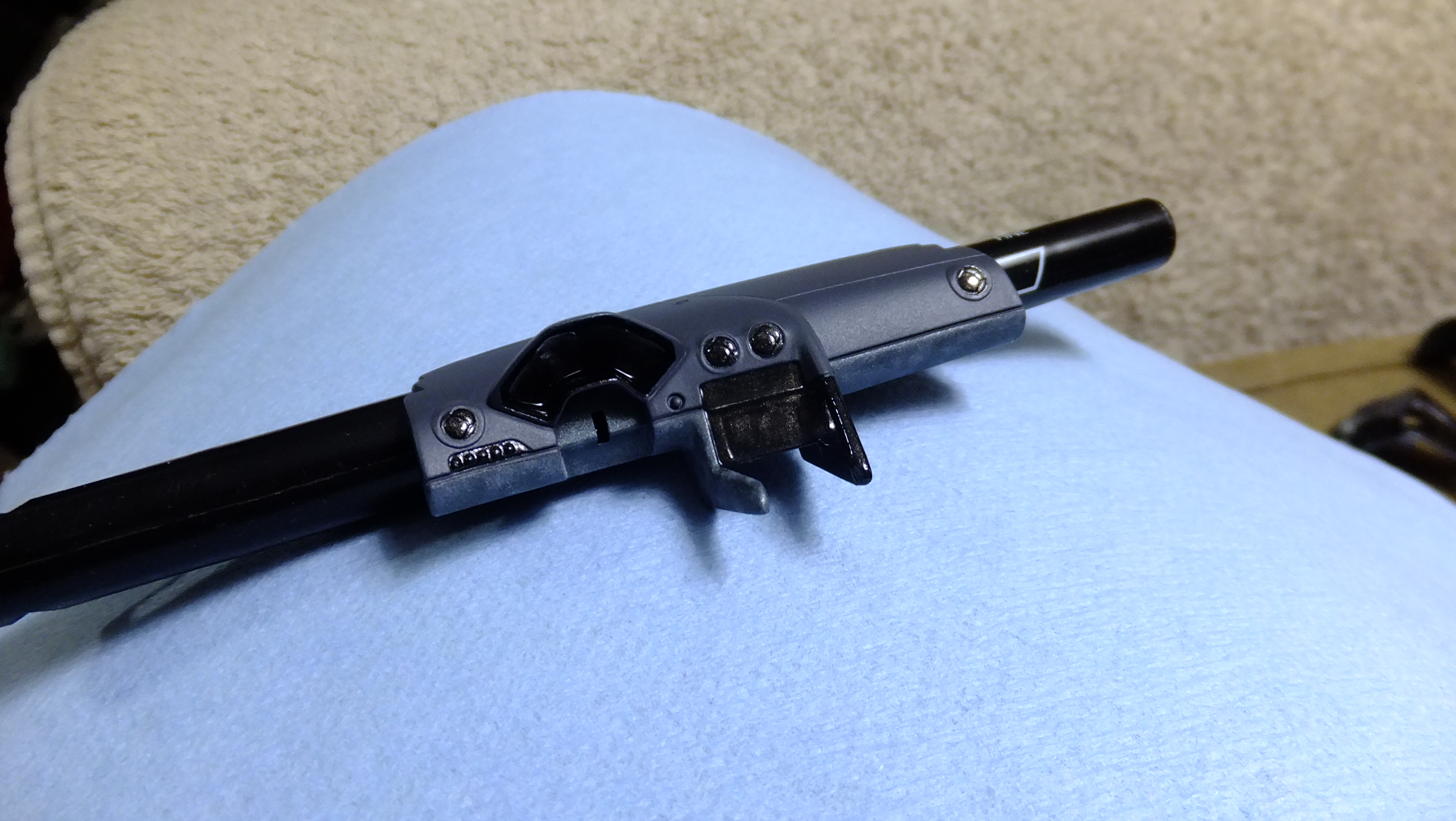

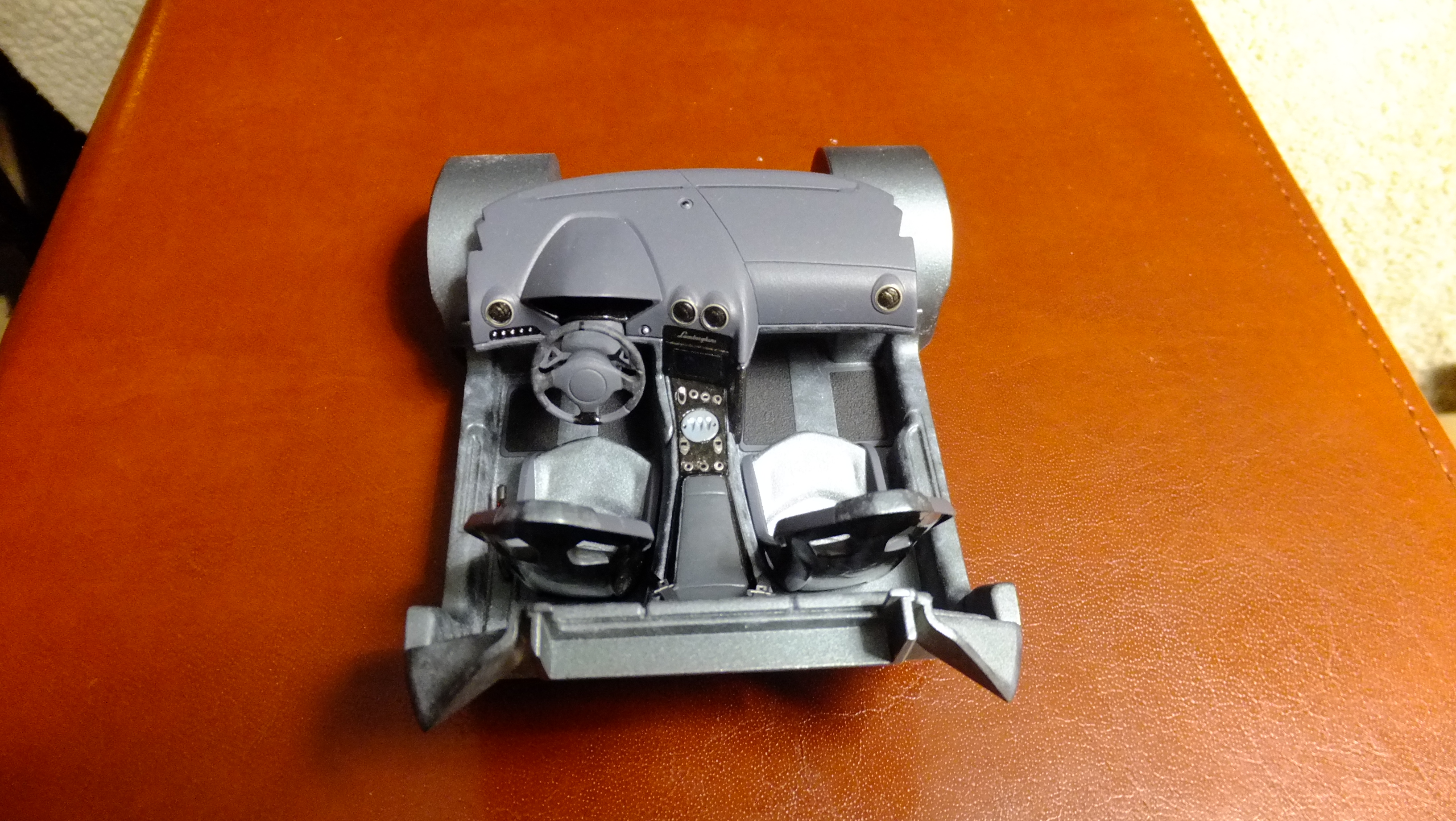

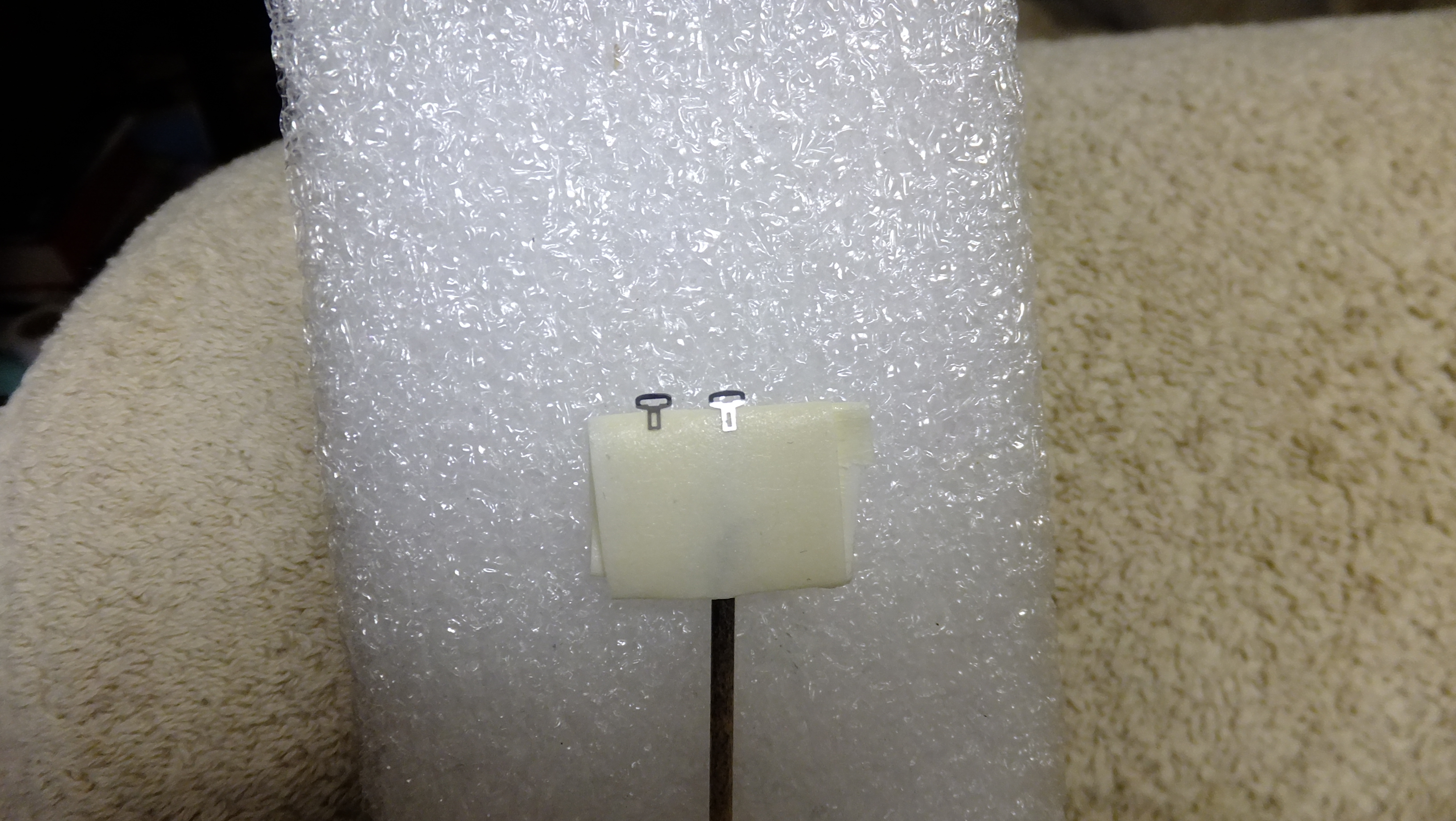

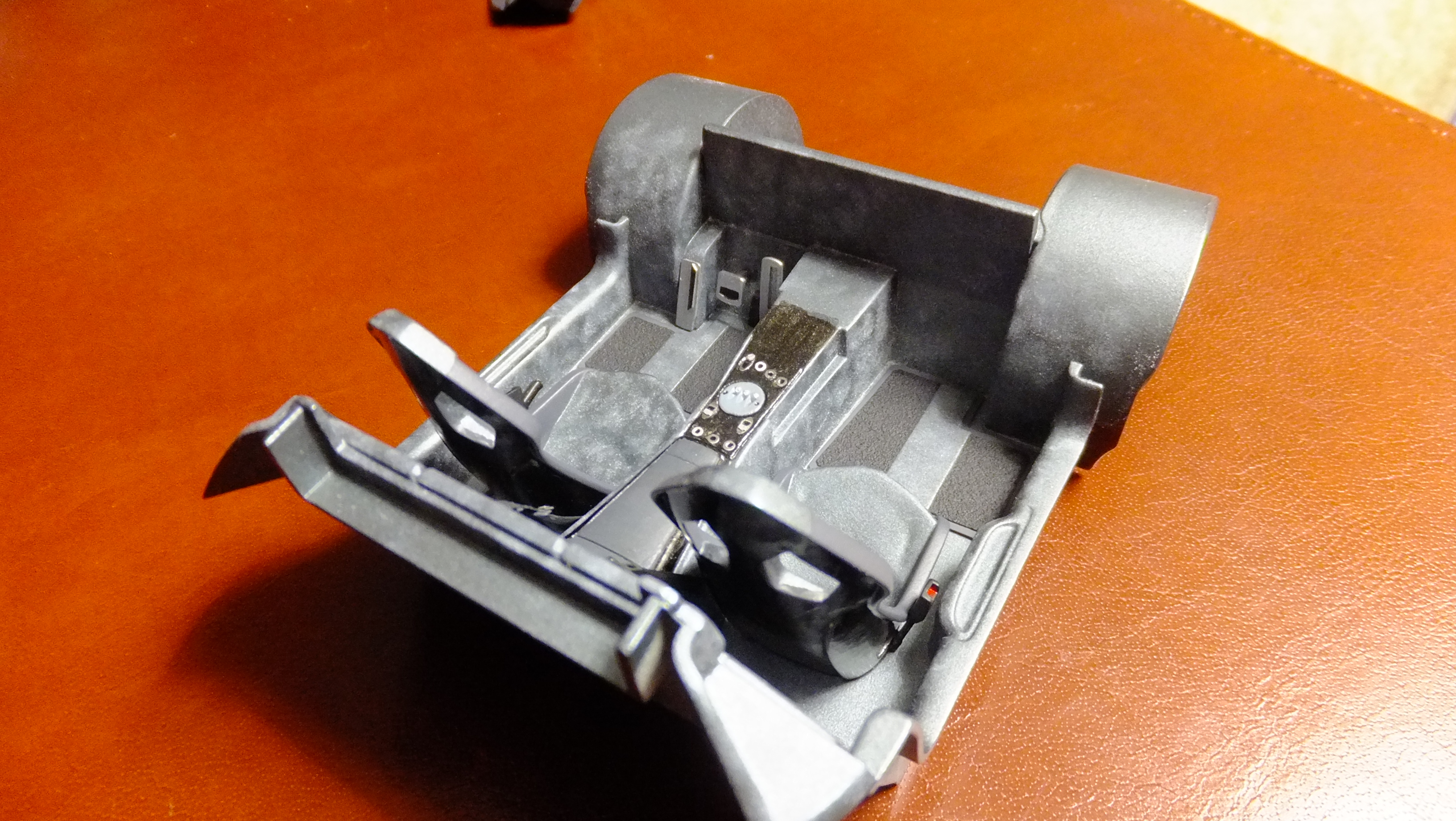

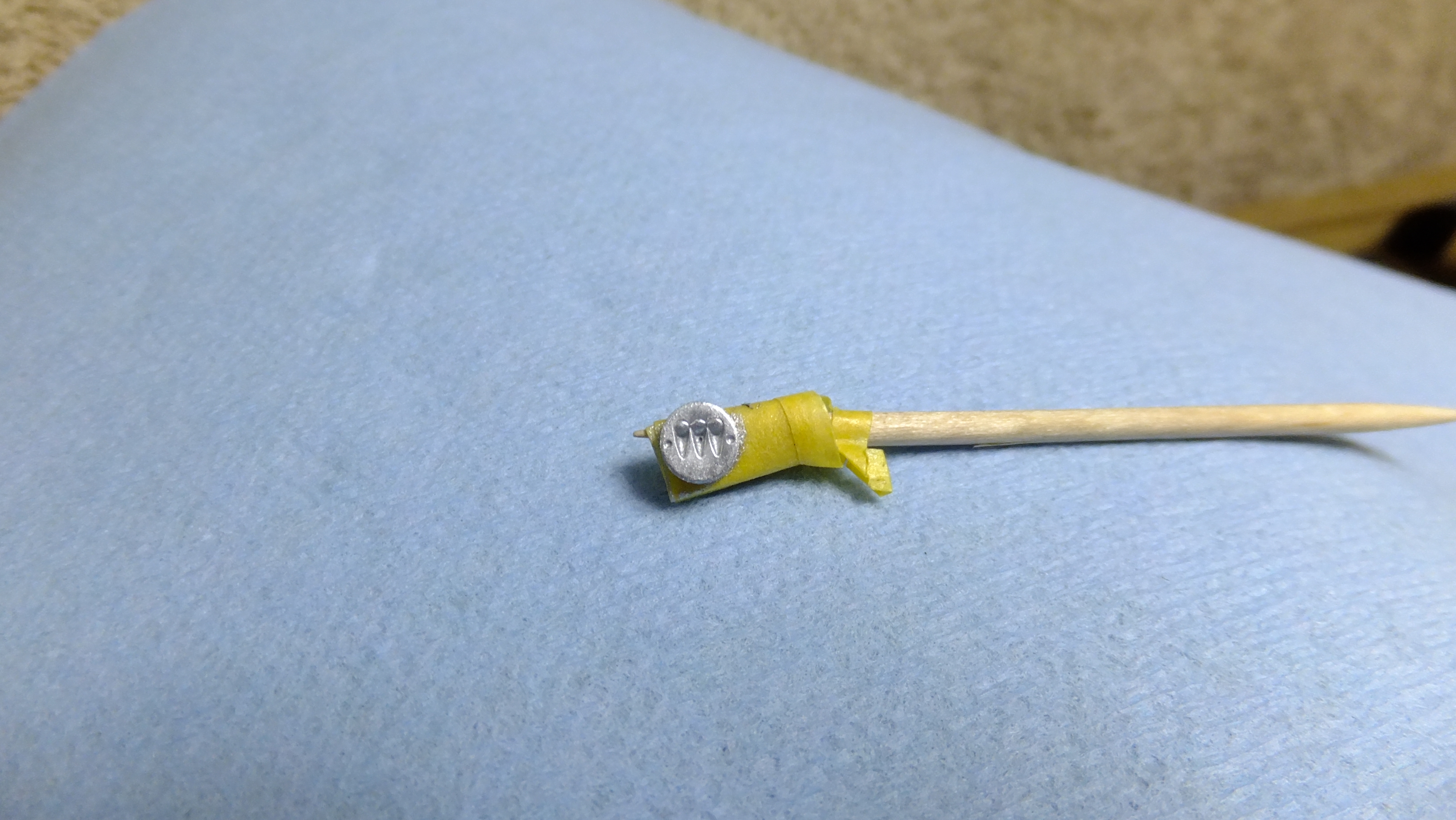

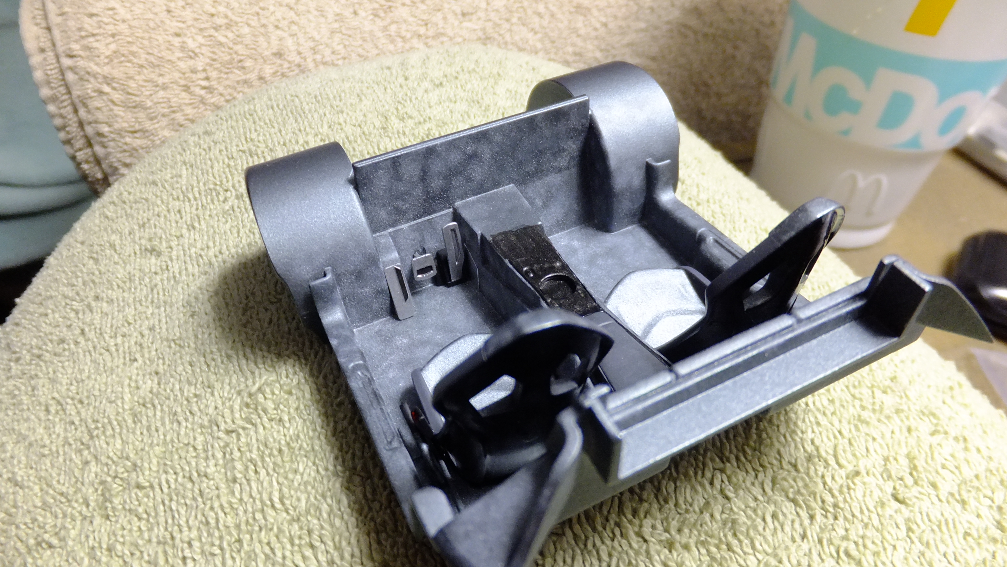

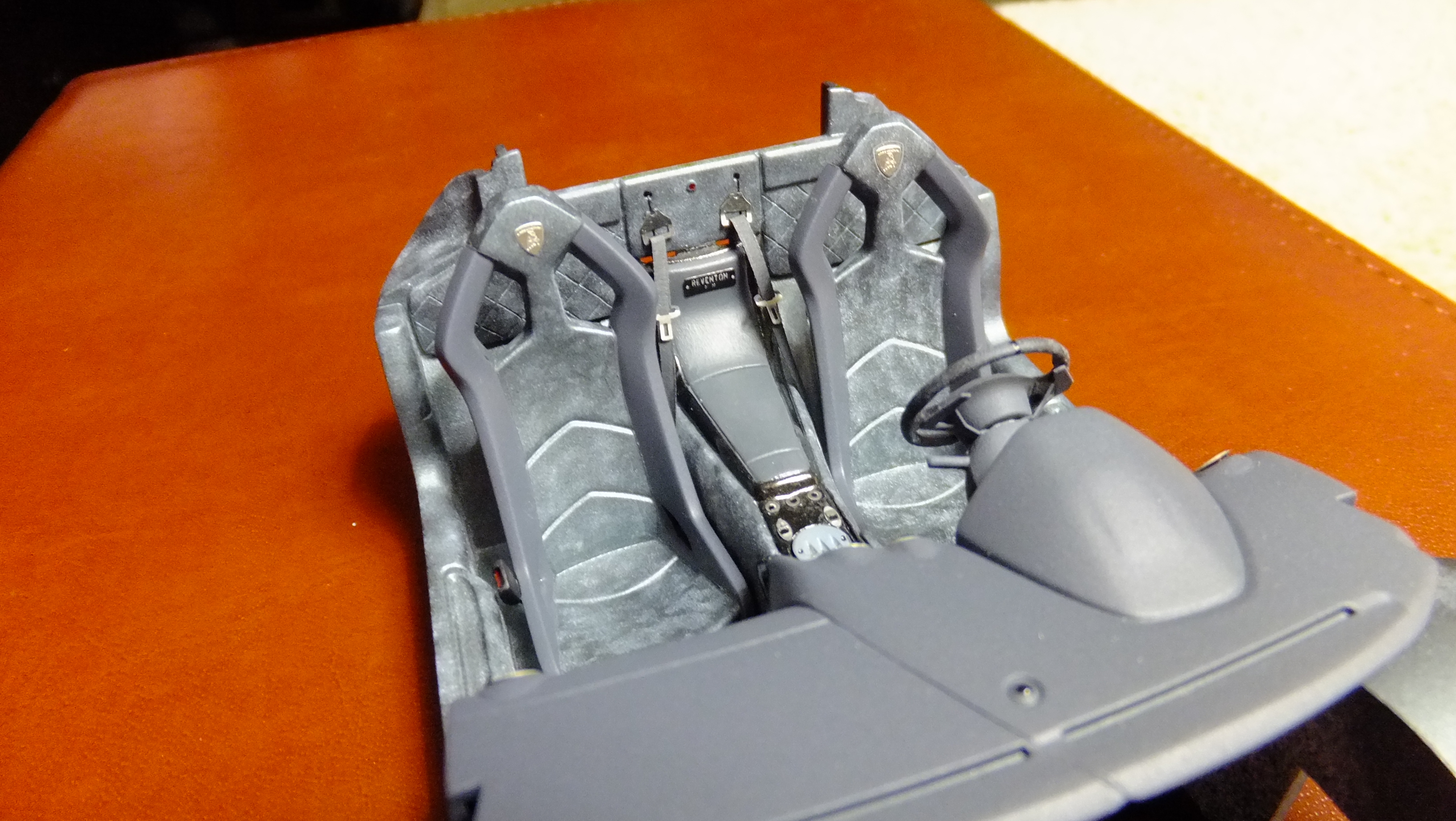

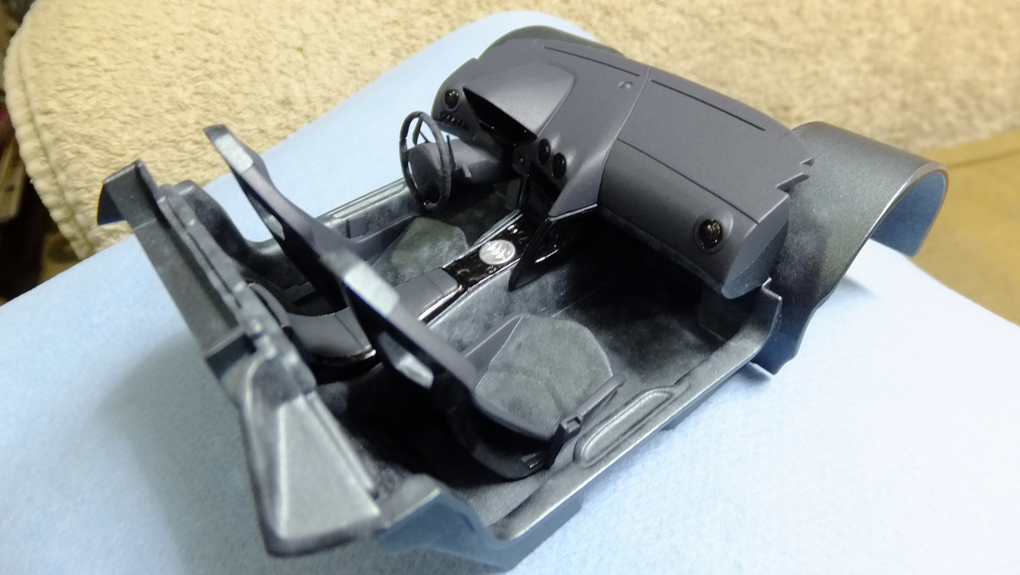

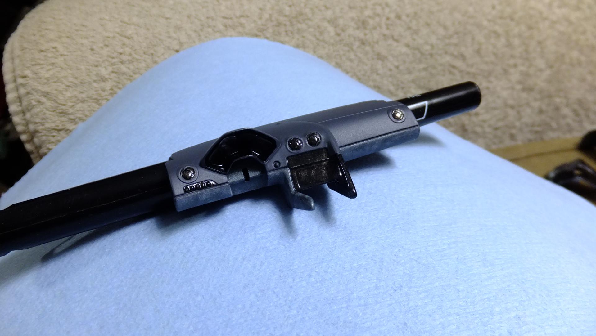

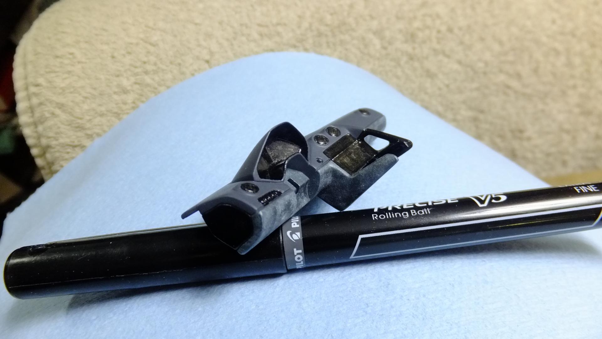

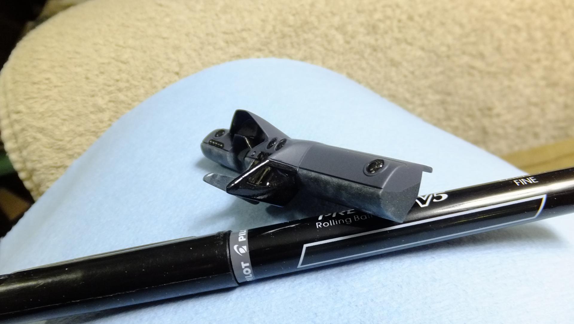

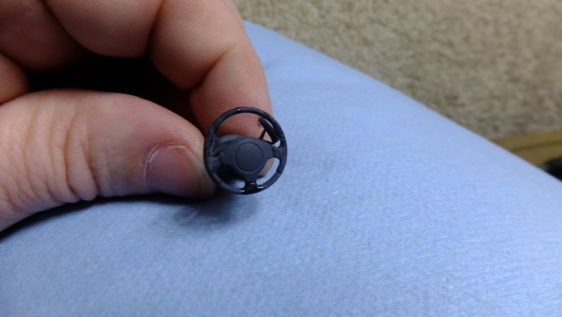

Dann Tier Posted January 15, 2019 Author Posted January 15, 2019 Finally got some building done after fighting the flu....a bunch of tedious detail painting. Hopefully this interior will be done by the end of tomorrow.... -Photo 1; I decided to drill-out the molded in switch assembly on the center column, because it wasn't very pronounced after painting. I glued a piece of styrene under the hole to hold the new part that I got from a Mercielago kit..... -Photo 6; the new part from the Mercielago looks 10x better! _Photos 8-11; just a quick mock-up....decals, and final assemblies next!

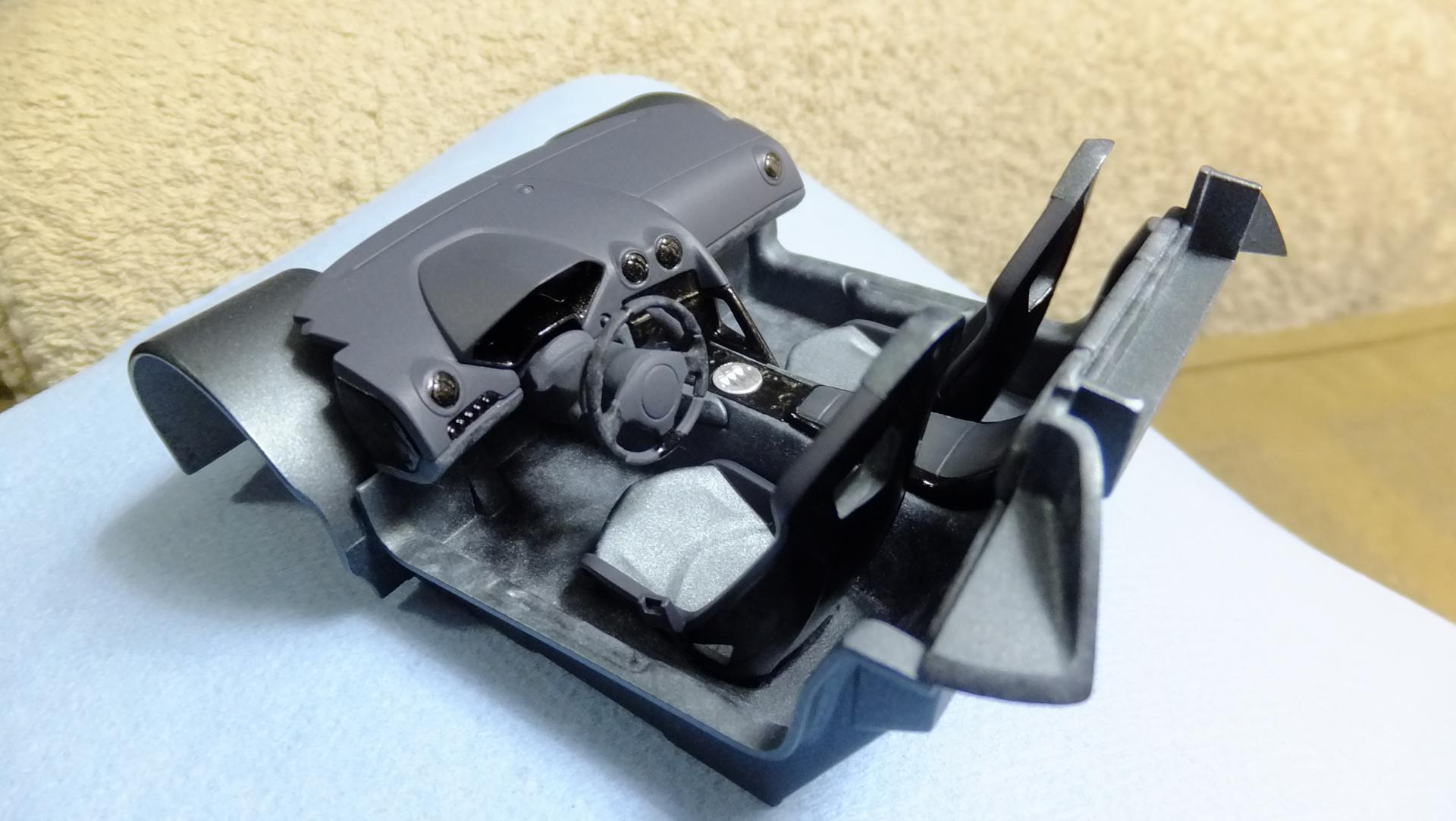

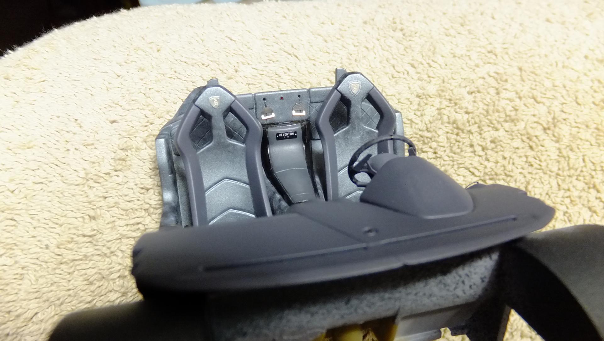

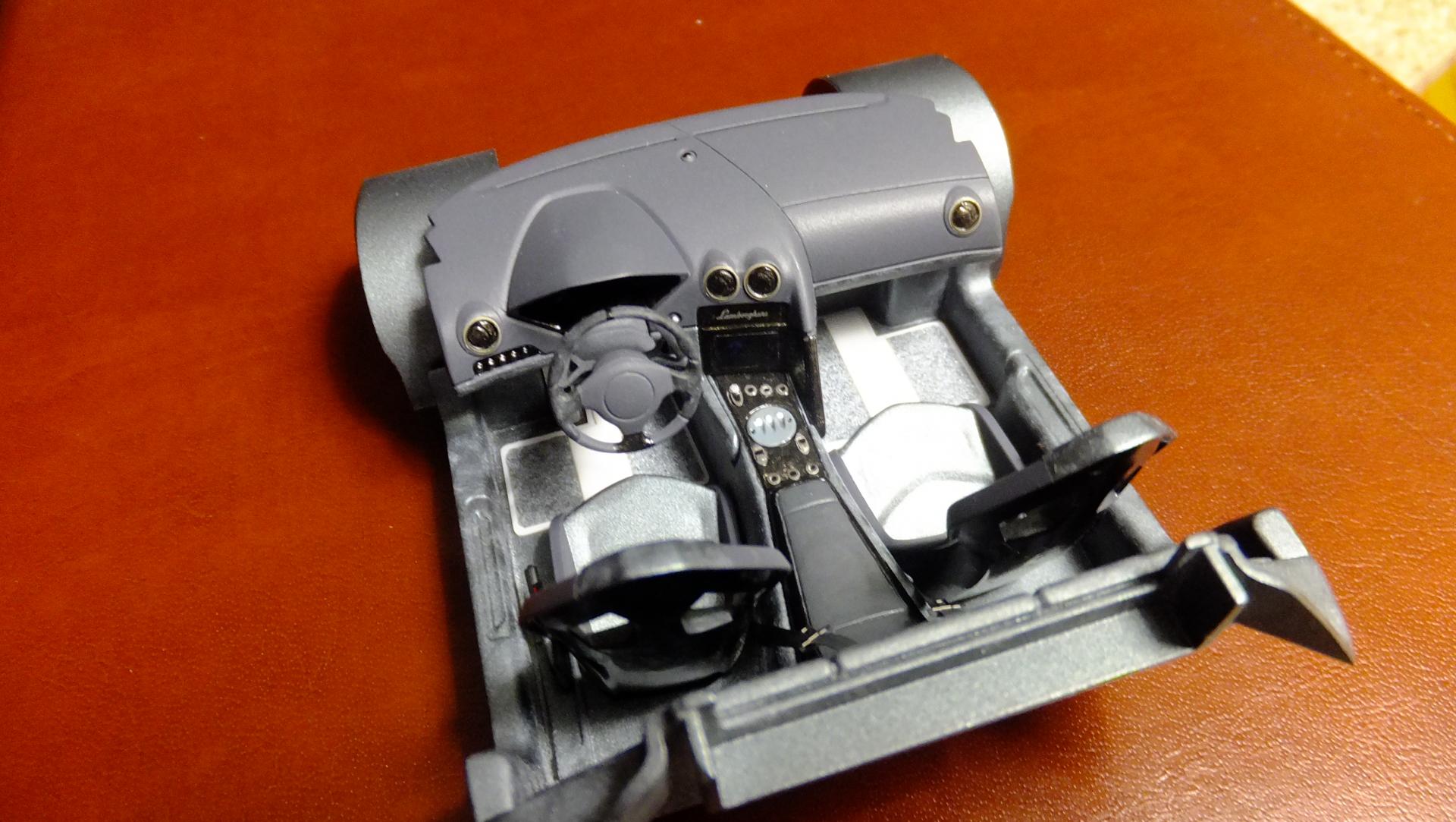

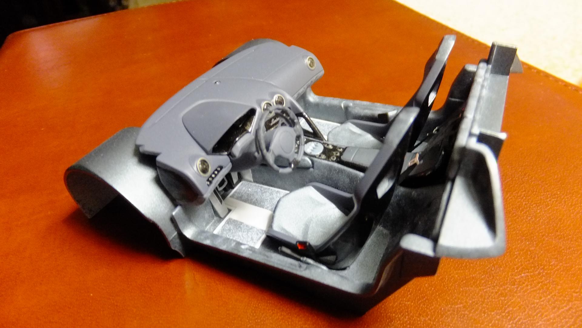

Dann Tier Posted January 17, 2019 Author Posted January 17, 2019 the interior is now soooooo close to being done!!
NOBLNG Posted January 17, 2019 Posted January 17, 2019 Wow, that is awesome looking! Your talents and patience amaze me!

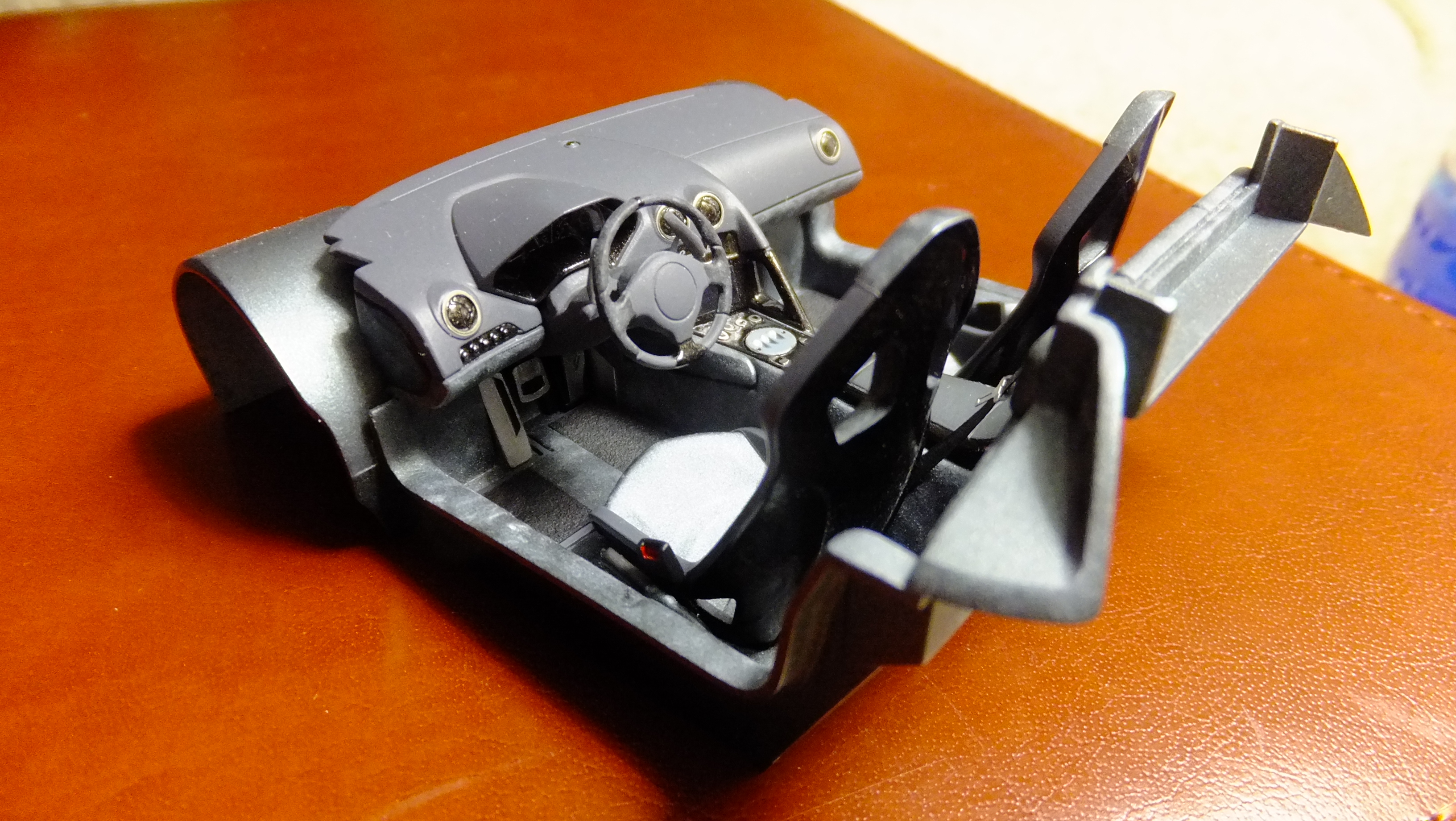

Funkychiken Posted January 17, 2019 Posted January 17, 2019 Hey Dann, did you paint on, or draw on those silver rings around the air vents? Or are they photoetch?
ATHU Posted January 17, 2019 Posted January 17, 2019 That interior looks stunning. Excellent work as always Dann!!
Dann Tier Posted January 17, 2019 Author Posted January 17, 2019 Thanks a lot, guys!!….much appreciated!!
Dann Tier Posted January 17, 2019 Author Posted January 17, 2019 10 hours ago, Funkychiken said: Hey Dann, did you paint on, or draw on those silver rings around the air vents? Or are they photoetch? Hey, Atin!, those rings are PE gage bezels from Model Car Garage, it was the cleanest way to go.

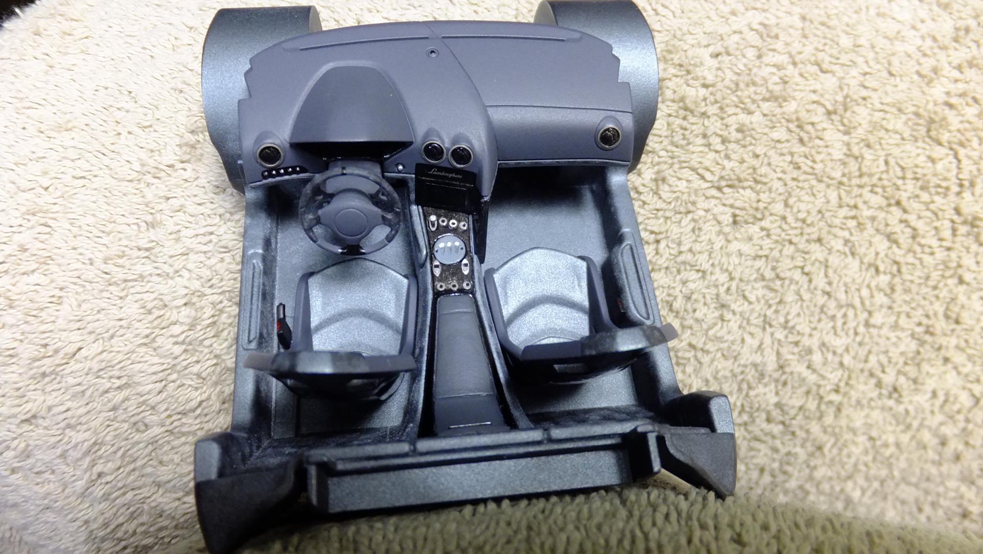

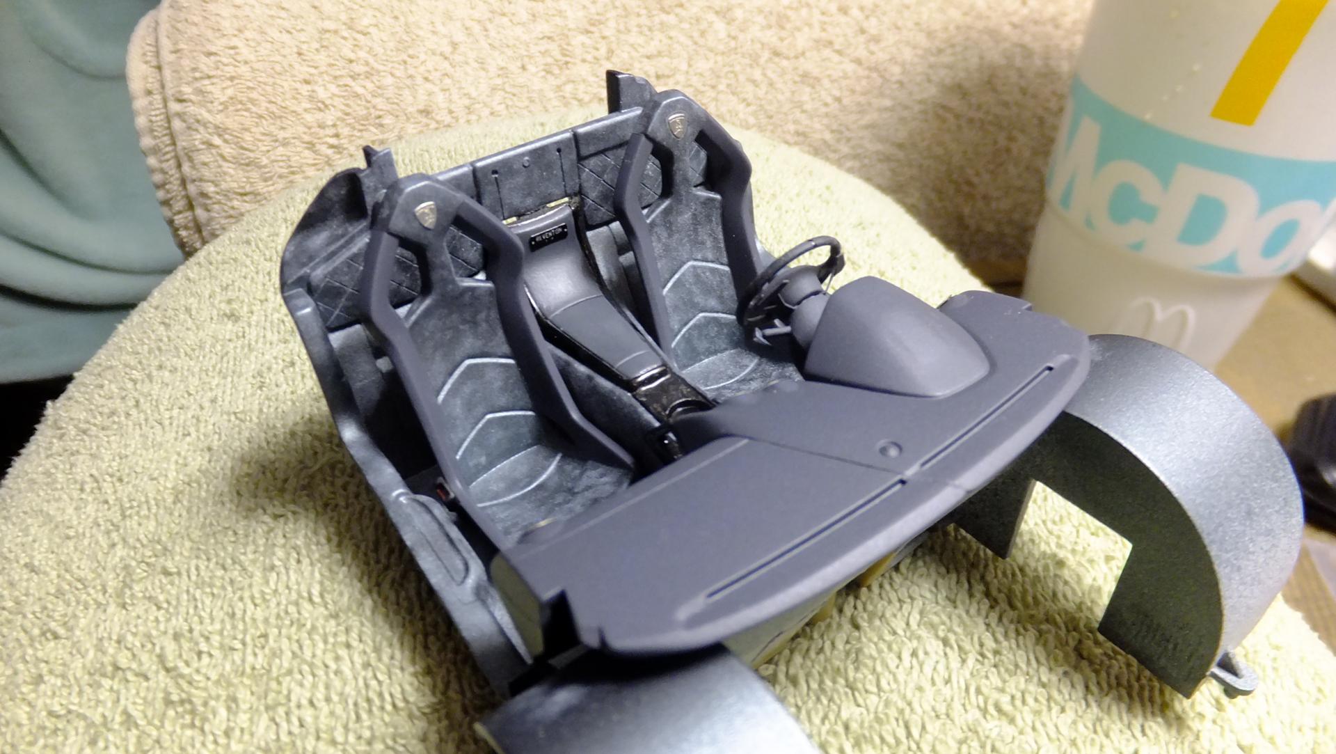

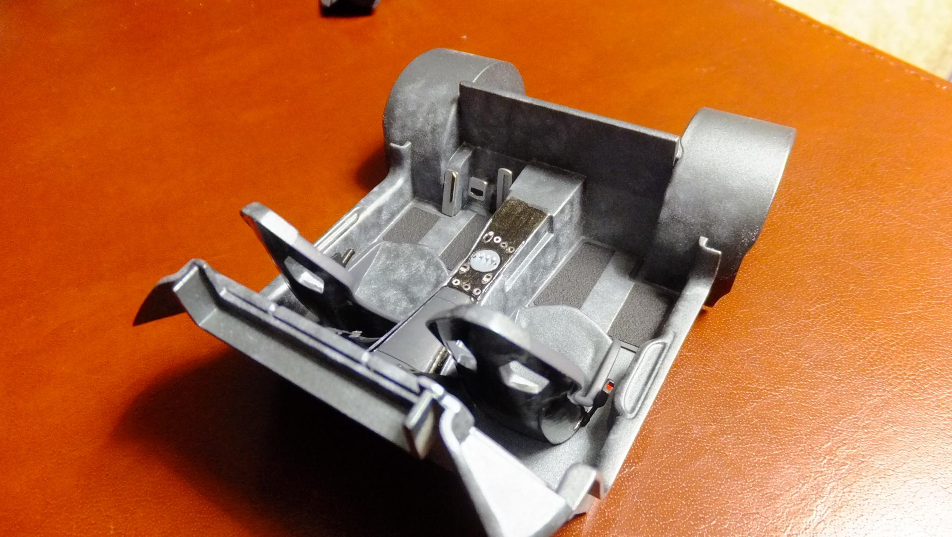

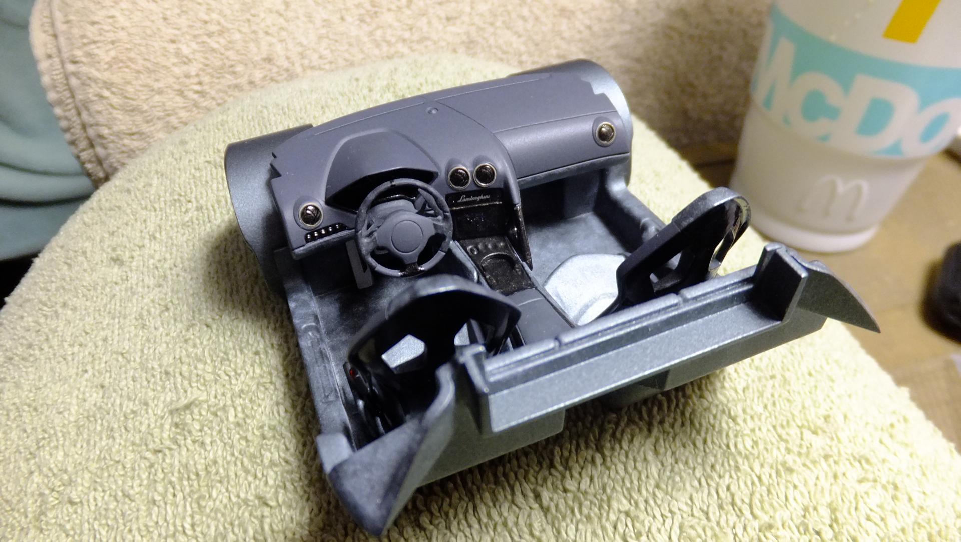

Dann Tier Posted January 17, 2019 Author Posted January 17, 2019 Hey, everyone!, I have another update here. All the center column switches are on, all I need to do now is finish the seat belt parts....it will be done very soon!!

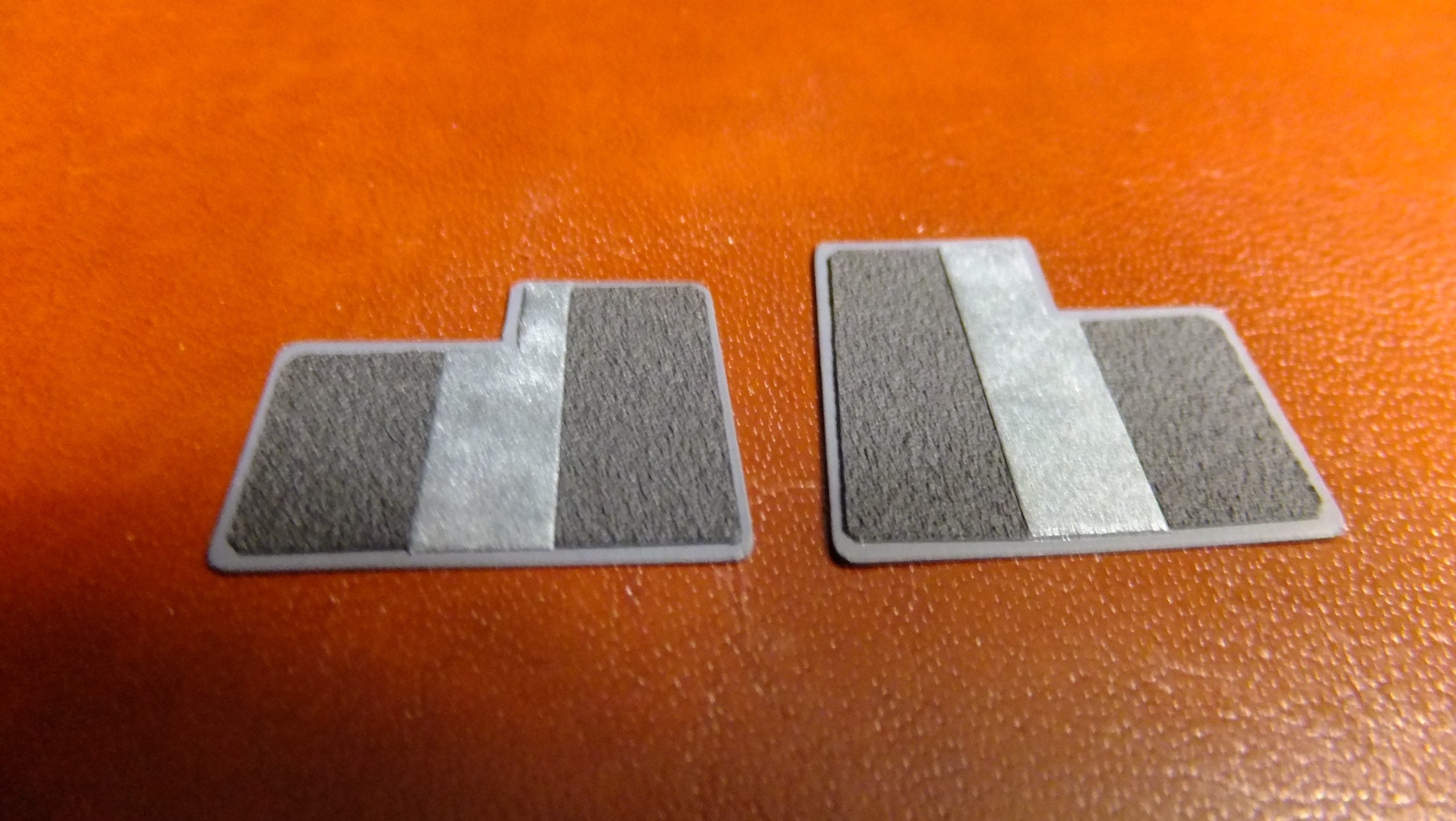

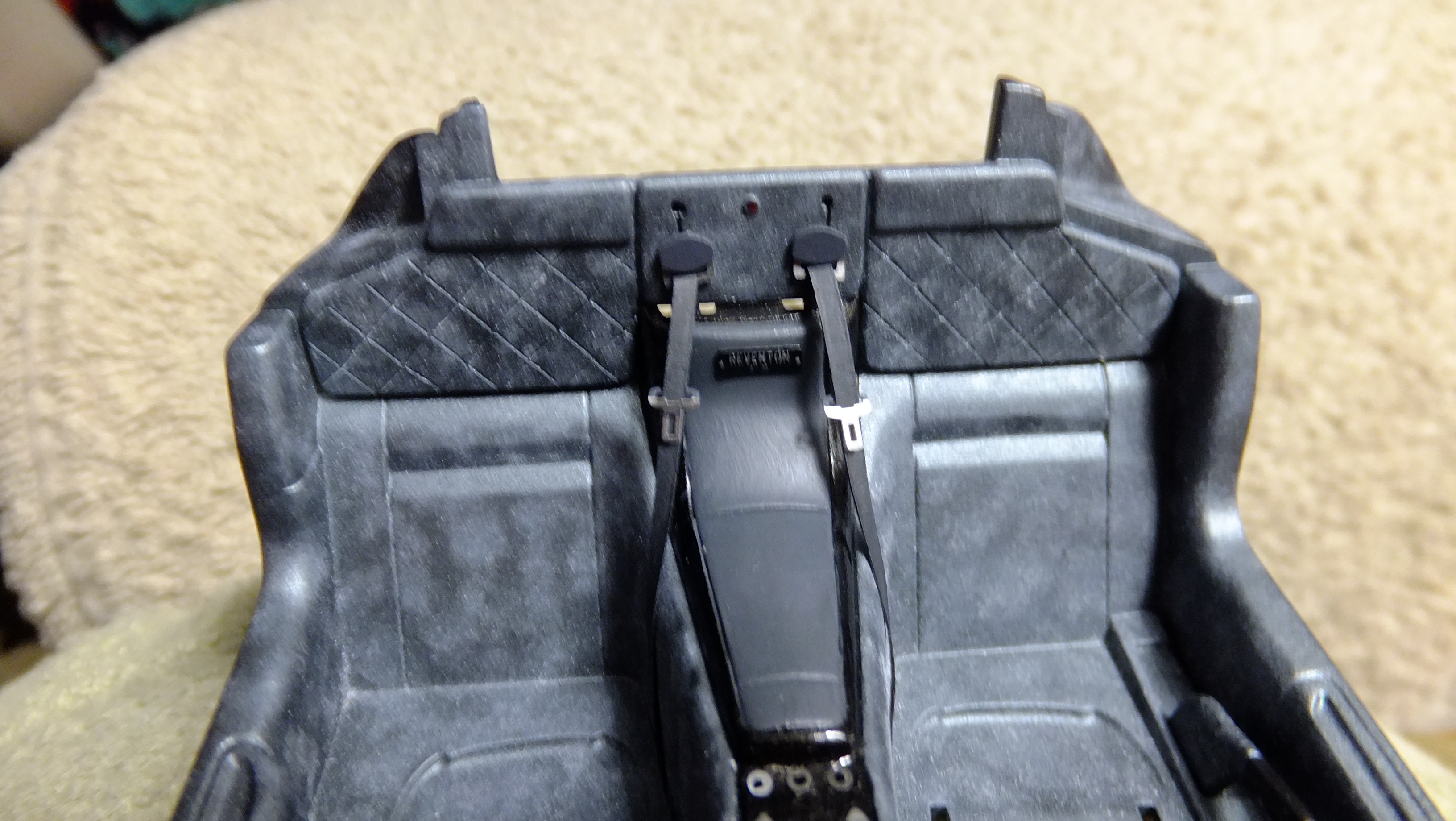

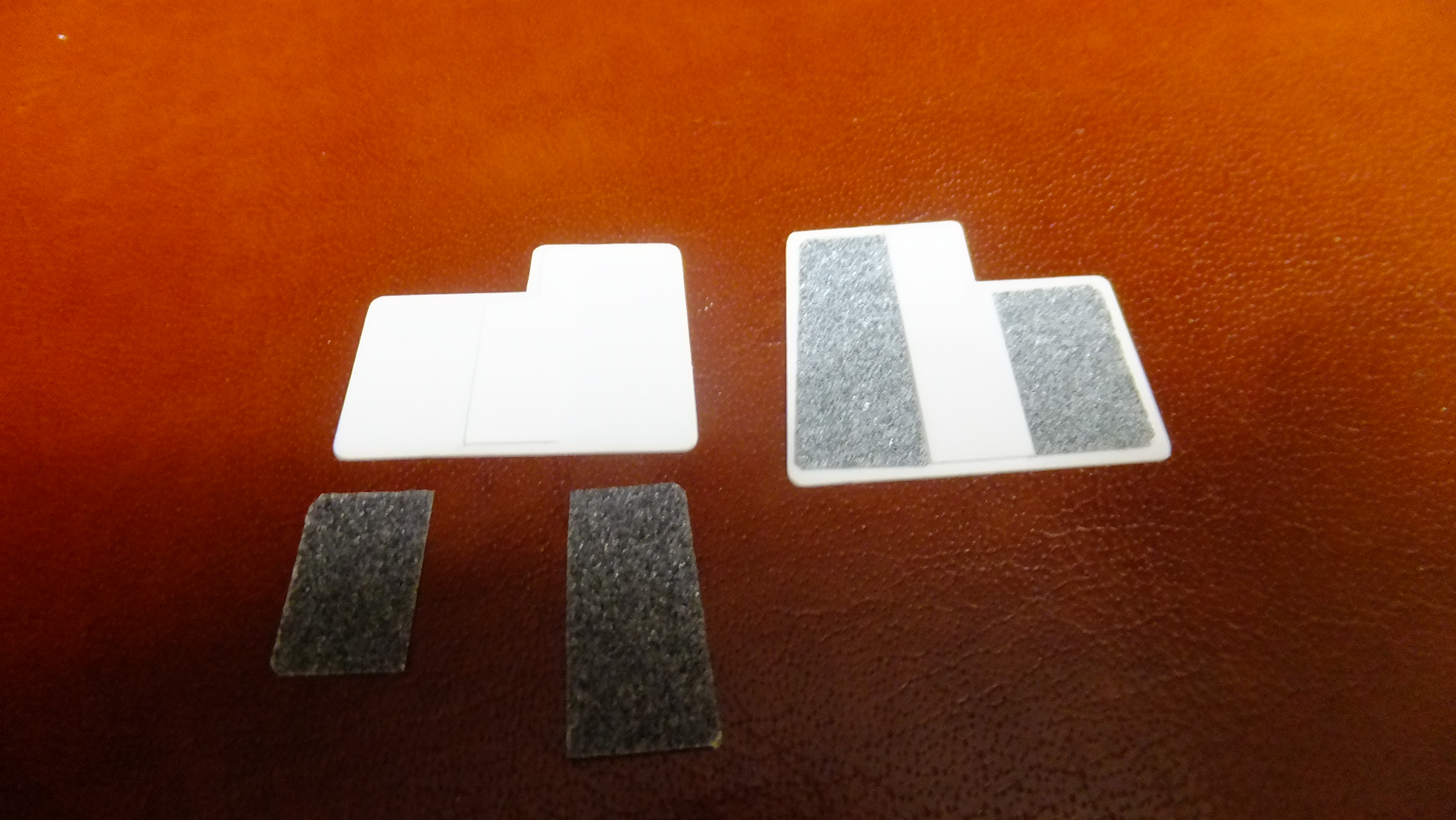

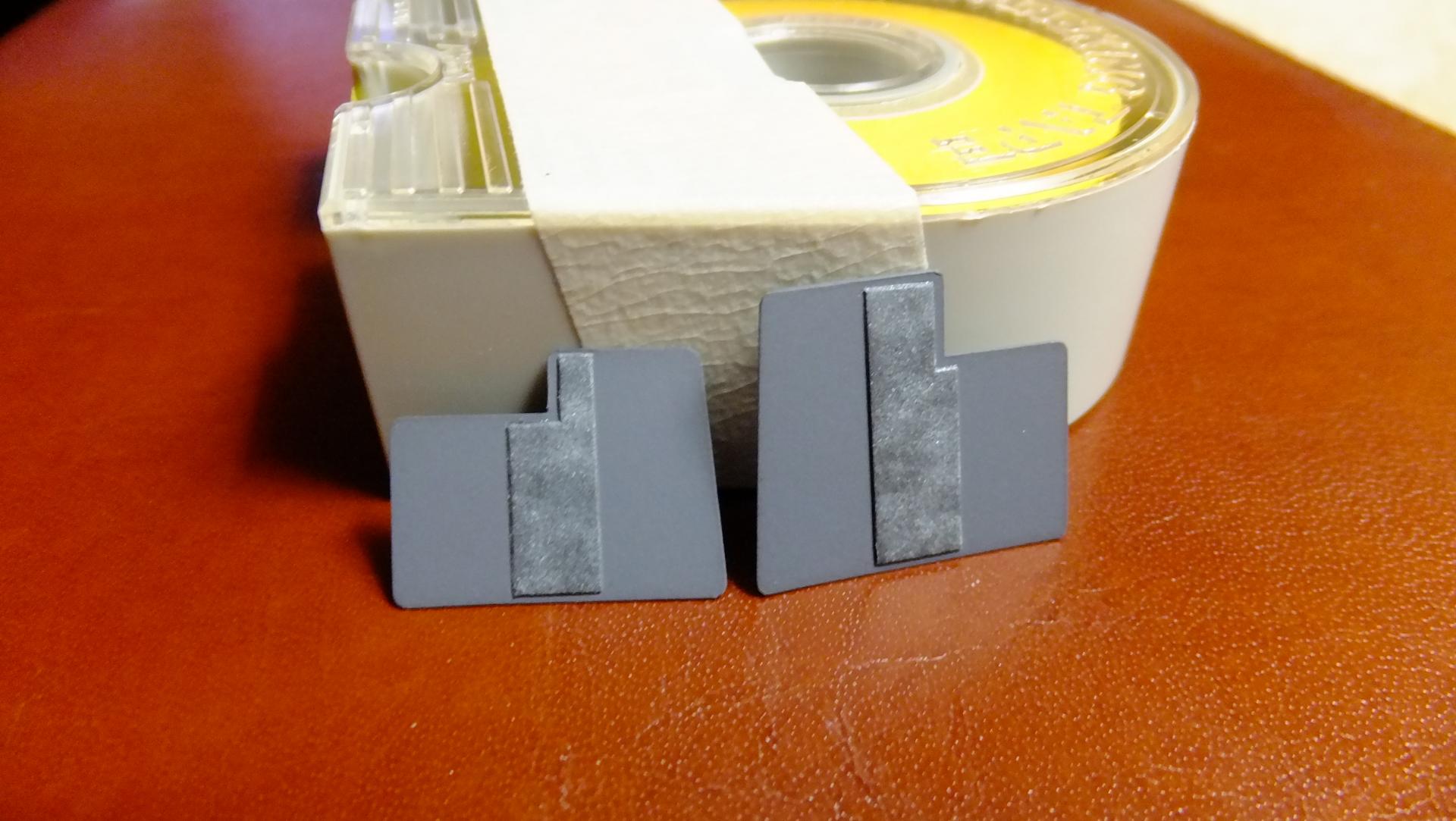

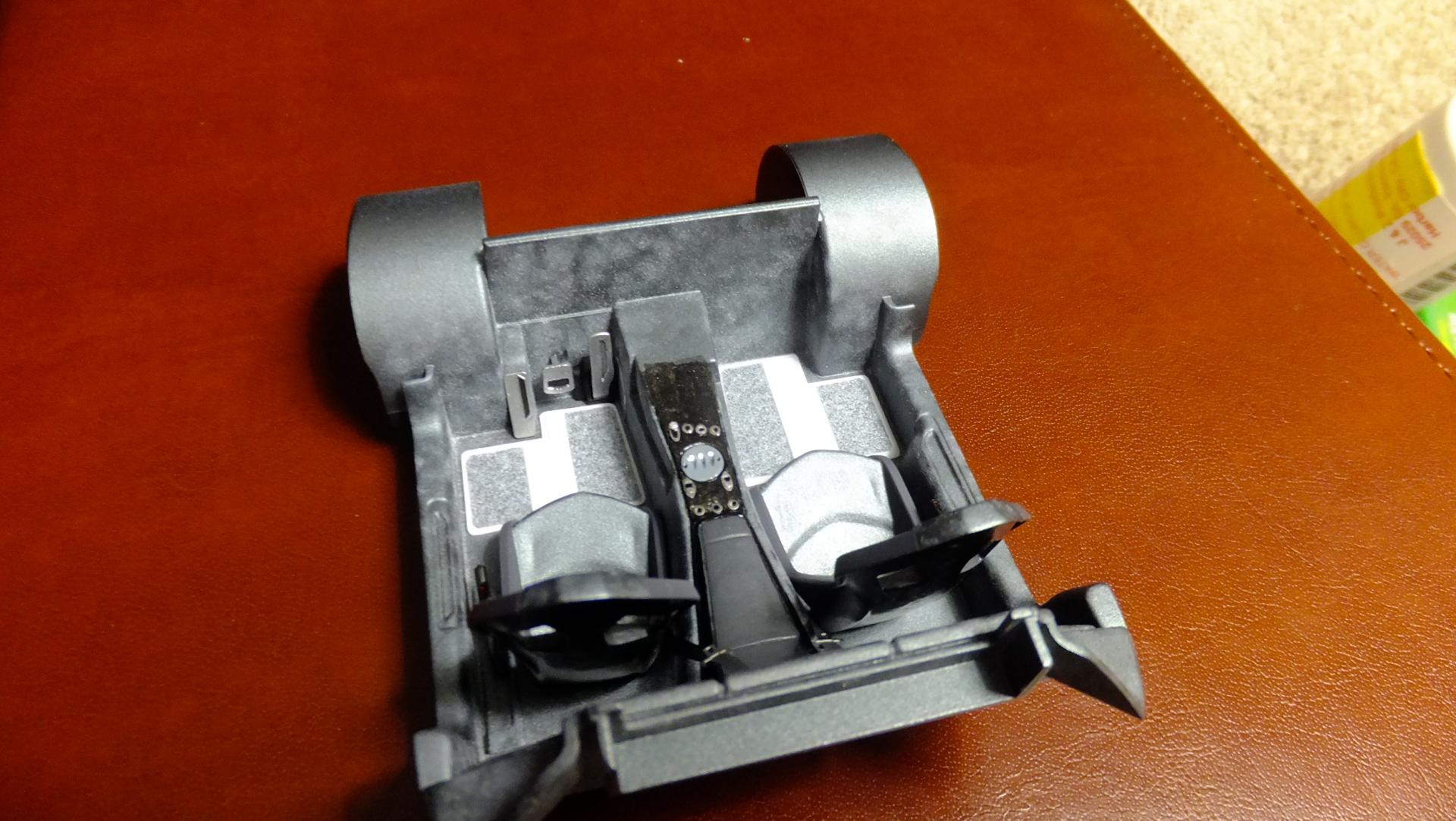

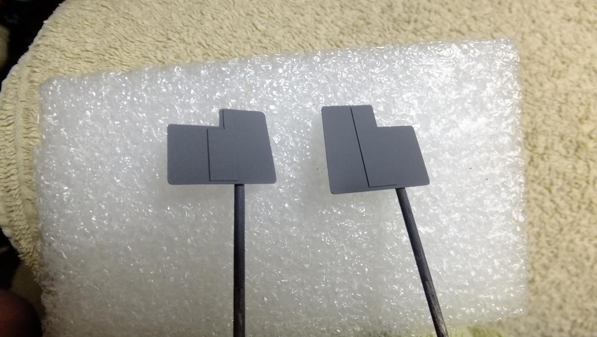

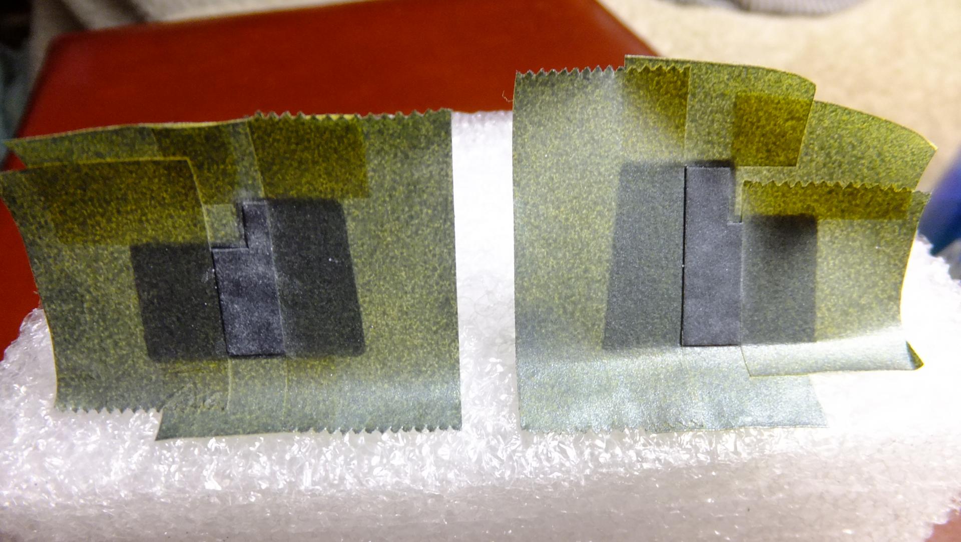

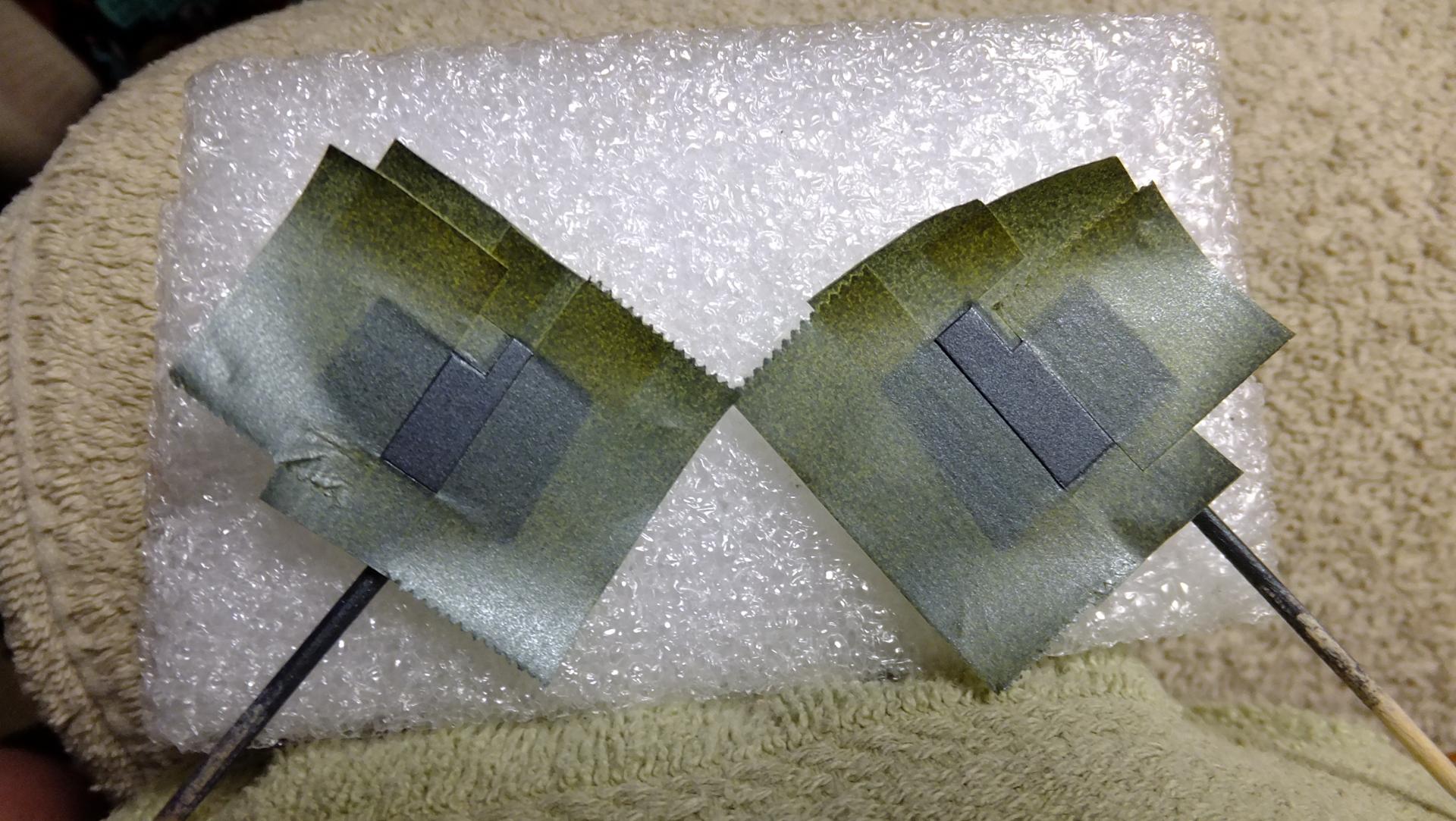

Dann Tier Posted January 18, 2019 Author Posted January 18, 2019 I decided to replicate the floormats that I saw in a photo of the actual car. I used the thinnest styrene I had, layered it in the middle, then finished them off with strips of coarse sanding film shaped to fit. I also managed to get the seatbelts in, and SB the shoulder bracket covers. They will now be painted along with the mats, and installed tomorrow.

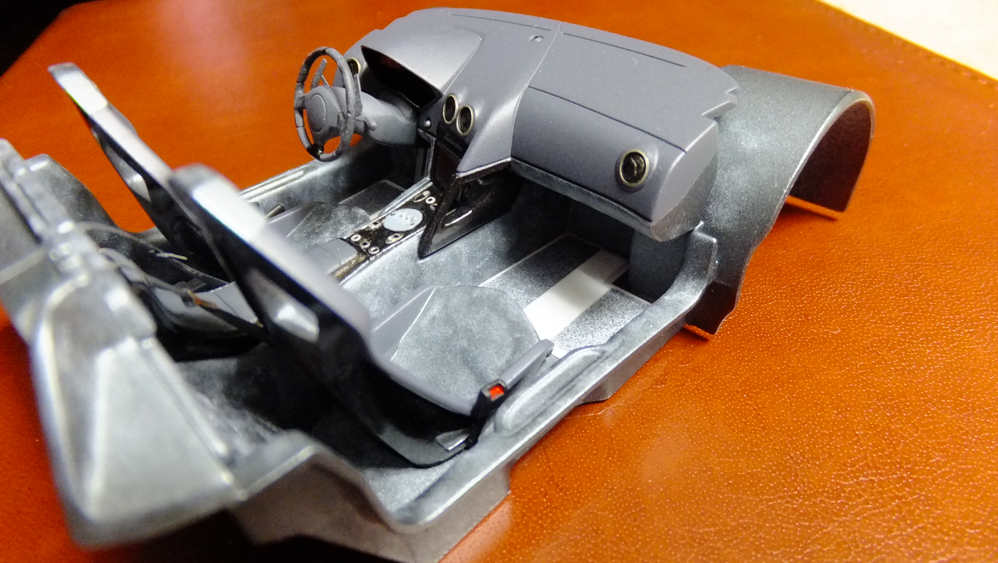

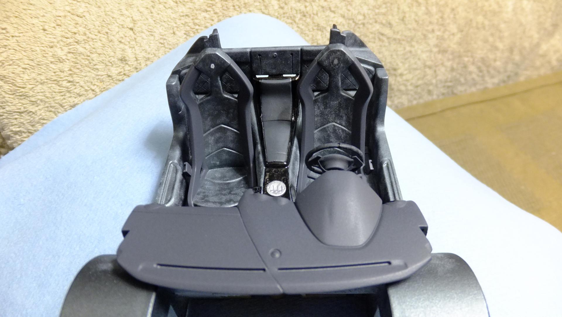

Dann Tier Posted January 19, 2019 Author Posted January 19, 2019 (edited) Here they are finished....worked a treat!!. All I have left to do, is to paint the PE bulls on the Headrests. I used Coarse sanding film for the foot-grip material...I painted it with black primer Edited January 19, 2019 by Dann Tier
Gt fan Posted January 19, 2019 Posted January 19, 2019 love the way that you did the interior, it hits the tonal look spot on. Great job on this build.
ATHU Posted January 19, 2019 Posted January 19, 2019 Wow that interior looks the part Dann, very well done!!
