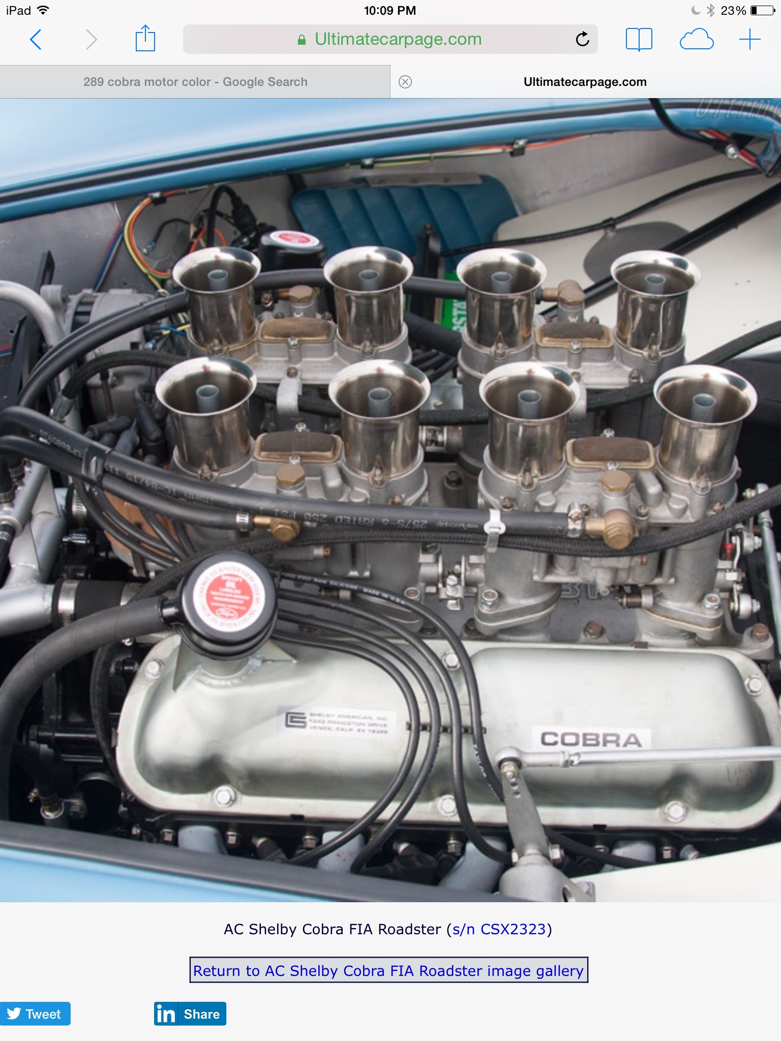

It may be a notch above but at 3-times the cost of the HRM kit the MFH should be better.  I hate to nit pick someone else build thread and if it bothers you Tim please let me know and I will delete the post.  However the MFH cylinder head based on the exhaust ports looks more like a 427 than a 289.  I doubt it will be noticeable on the finished build with the headers and spark plug wires in place and is certainly no reflection on you Tim and your building skills.
289:
 Image result for ford 289 heads
427:
Image result for ford 427 heads
Edited by afx
All comments are welcome. Mfh does make a 427 kit. I bought the kit for 200 about 2 years ago. It could have a bit more detail. I just hate drilling all the holes. You have to test fit everything.

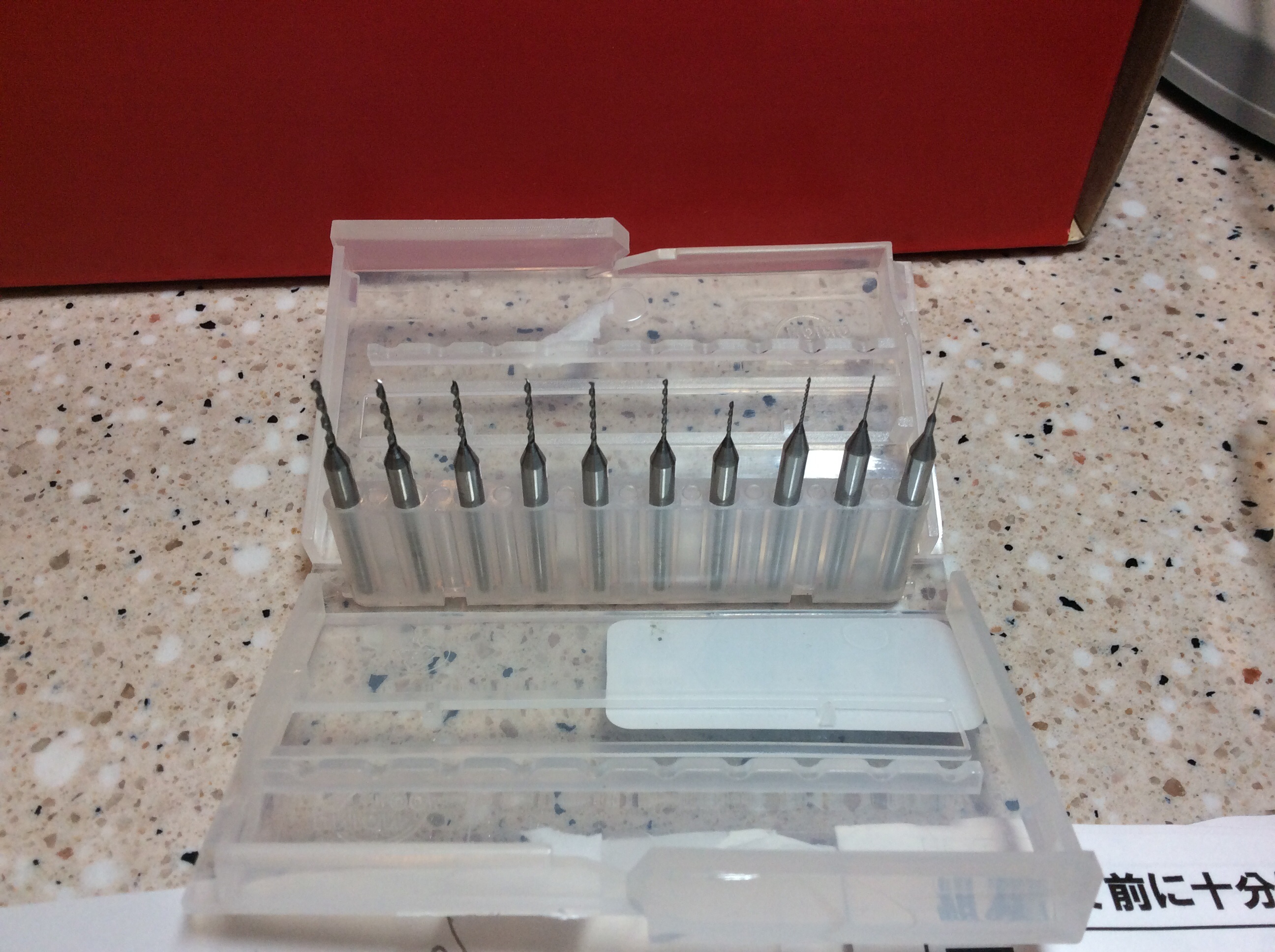

Found these on amazon. 15.00 . Well worth it. They have a bigger shank. Works fantastic in the Tamiya pinvise. There labeled CNC engraving bits
5 hours ago, Mr. Metallic said:
Thanks for the heads up on those bits. I put some in my Amazon cart ^_^
There well worth the money. I have used them in a Dermel as well.
