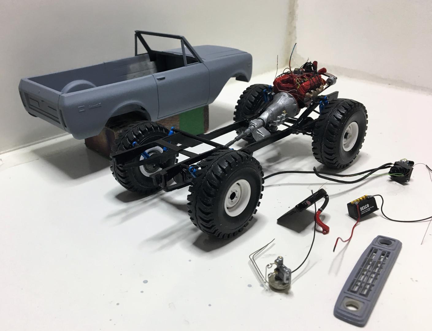

dino246gt Posted August 6, 2018 Author Posted August 6, 2018 (edited) I've started making some of the "stuff" for under the hood, the kit has nothing for that. I hollowed out the underside of the air intake, then added a bottom. I drilled out a battery (kit does have one, I like this one more) and added details Also added a radiator, but I had to cut the rad wall because the kit rad was molded in, now I have a separate rad. I scratch built a heater. So here are some of the parts I intend to add under the hood to fill it out a bit better. (again though my stuff is NOT totally accurate, I just like the look) Edited August 6, 2018 by dino246gt picture arrangement

dino246gt Posted August 15, 2018 Author Posted August 15, 2018 Not much progress on my Scout, it's just such nice weather, I feel bad sitting inside! But I managed to dirty up the tires! They were looking too new, and now they're maybe too dirty, but I'll tone them down eventually. I don't want to dirty up the whole build, so the tires look wrong all dirty on a clean undercarriage.
THORDOOR220 Posted August 15, 2018 Posted August 15, 2018 A light black wash would probably do the trick, and then just a little sanding on the tread. Though I'm sure you have your methods figured out

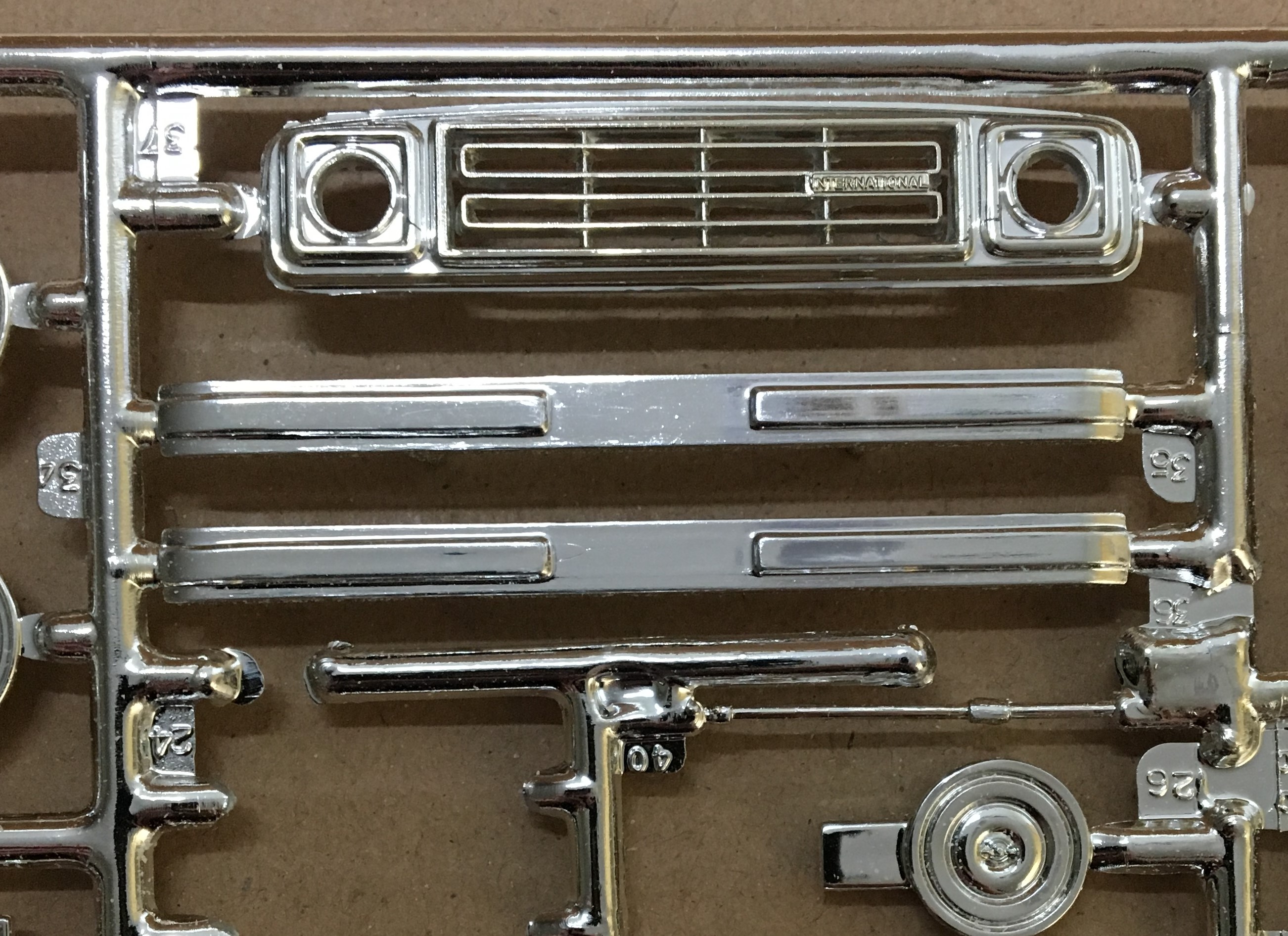

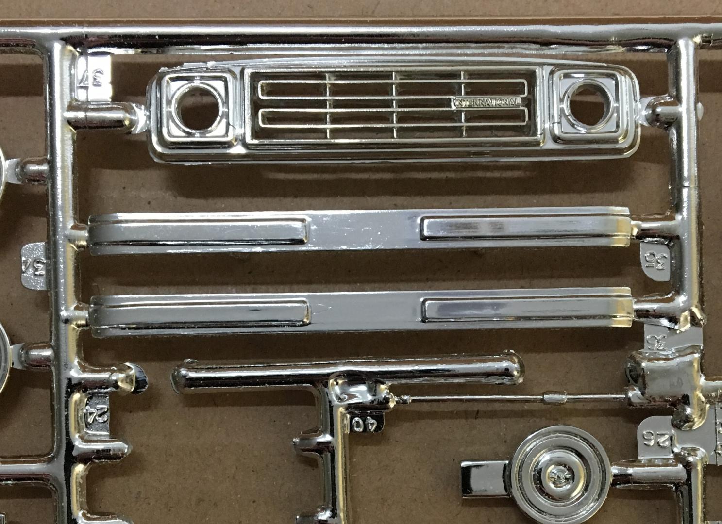

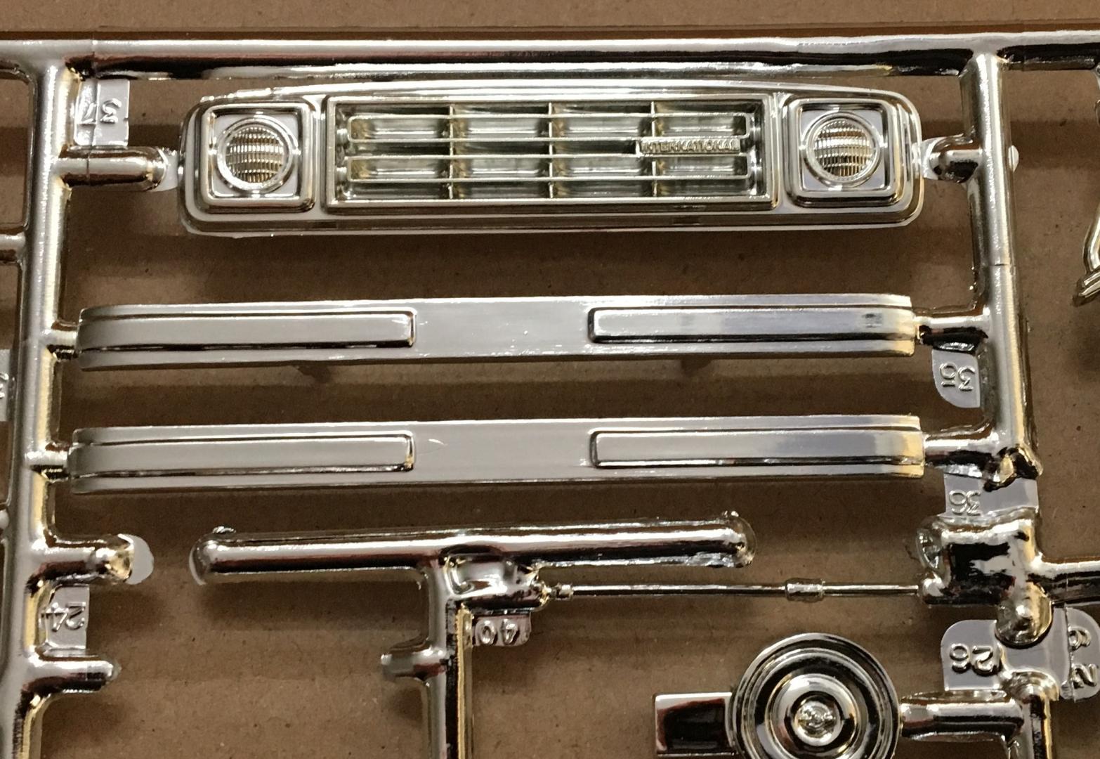

dino246gt Posted August 16, 2018 Author Posted August 16, 2018 (edited) Here's the kit grill still on the tree. And opened up. Dechromed and primed. I've glued the interior tub to the body, removed the lower body trim and added the cut line of the front fenders down to form rocker panel lines. I foiled the side marker lights, front turn signals and Scout ll emblems, just to prevent paint from hiding the details. I'll remove that and put fresh foil then clear red and orange for the lenses. Edited August 16, 2018 by dino246gt added more info
Scalper Posted August 16, 2018 Posted August 16, 2018 that grill looks way better now.. with is did that to mine

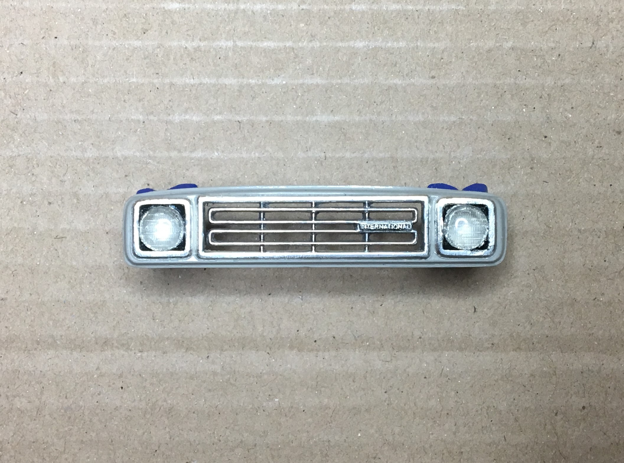

dino246gt Posted August 16, 2018 Author Posted August 16, 2018 Here's that grill with some larger headlight lenses, foil and paint. I've mixed some Tamiya racing white with khaki green nail polish for the body color.

Jordan White Posted August 17, 2018 Posted August 17, 2018 (edited) Before you go any further with the grille, you should flatten out the top of it (since you're trying to make the kit more accurate) since it's too rounded. Edited August 17, 2018 by Jordan White
dino246gt Posted August 17, 2018 Author Posted August 17, 2018 I know, well I do now! ha ha, that the front needs to be flatter but it's too late and I've hinged the hood with that grill hiding the hinge, so it won't be made more accurate. I'm just not a real sticker for accuracy, just trying to make it look "cool" AND have fun doing what I enjoy most, which can be summed up as cutting, chopping and creating. I've only built one model totally "out of box" and it was difficult for me to restrain from flocking and seat belts or wires, hoses and cables! Following instructions just takes the fun out of it for me! 1

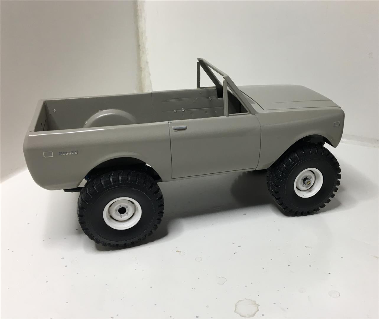

dino246gt Posted August 25, 2018 Author Posted August 25, 2018 I mixed Tamiya Racing White with khaki nail polish and air brushed it. I foiled the Scout ll and the marker lights and parking lights before primer or paint. I'll remove the foil from the lights and re-foil so those little ribs are still crisp before I drop clear red and clear orange acrylic paints for lenses.

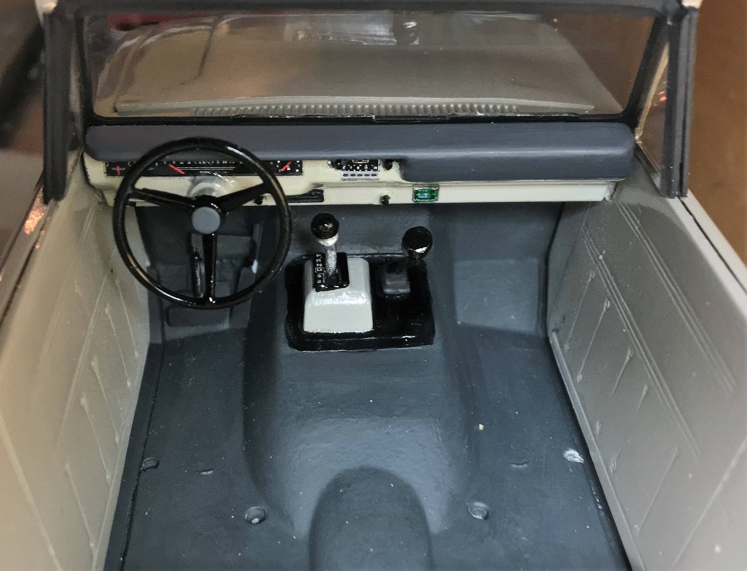

dino246gt Posted August 28, 2018 Author Posted August 28, 2018 (edited) This kit has all the glass in one piece, because I removed the roof, I had to cut the windshield and vent windows out, which turned out okay. I easily could've made my own as they're flat, but why not at least TRY to use up the kit's stuff, right? I'm working on painting the rubber around the "glass", it takes me a few tries at that! (not there yet) I made some basic pedals, kit ones are molded on the floor, at least these are hanging, but they can't be seen once a seat is in, still fun and easy to do! I detailed the dash, not accurate but looks cool enough to me. Made a turn signal from guitar string and styrene rod. Edited August 28, 2018 by dino246gt spelling

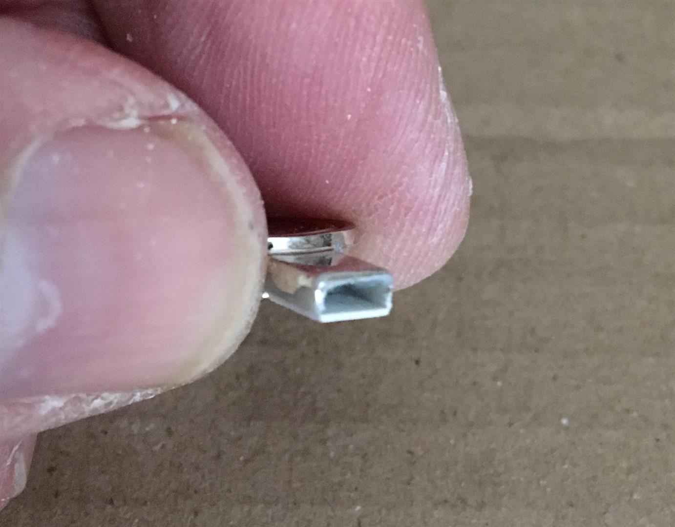

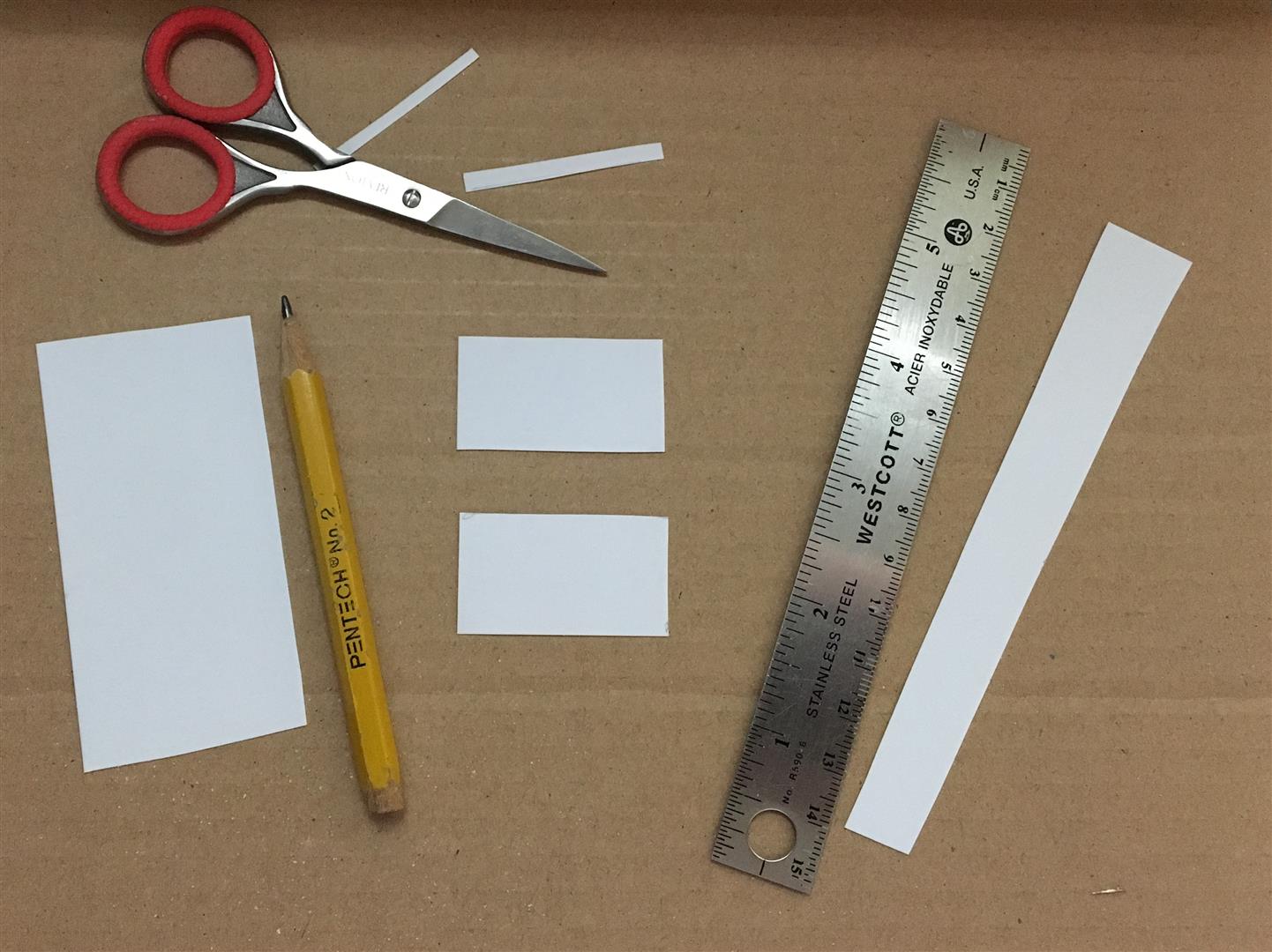

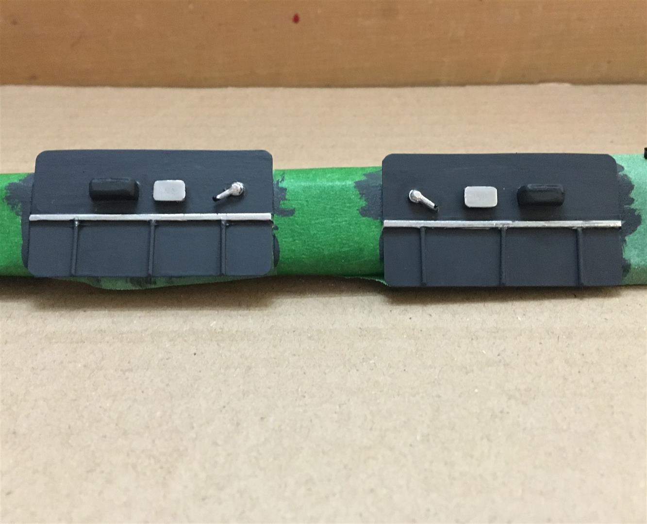

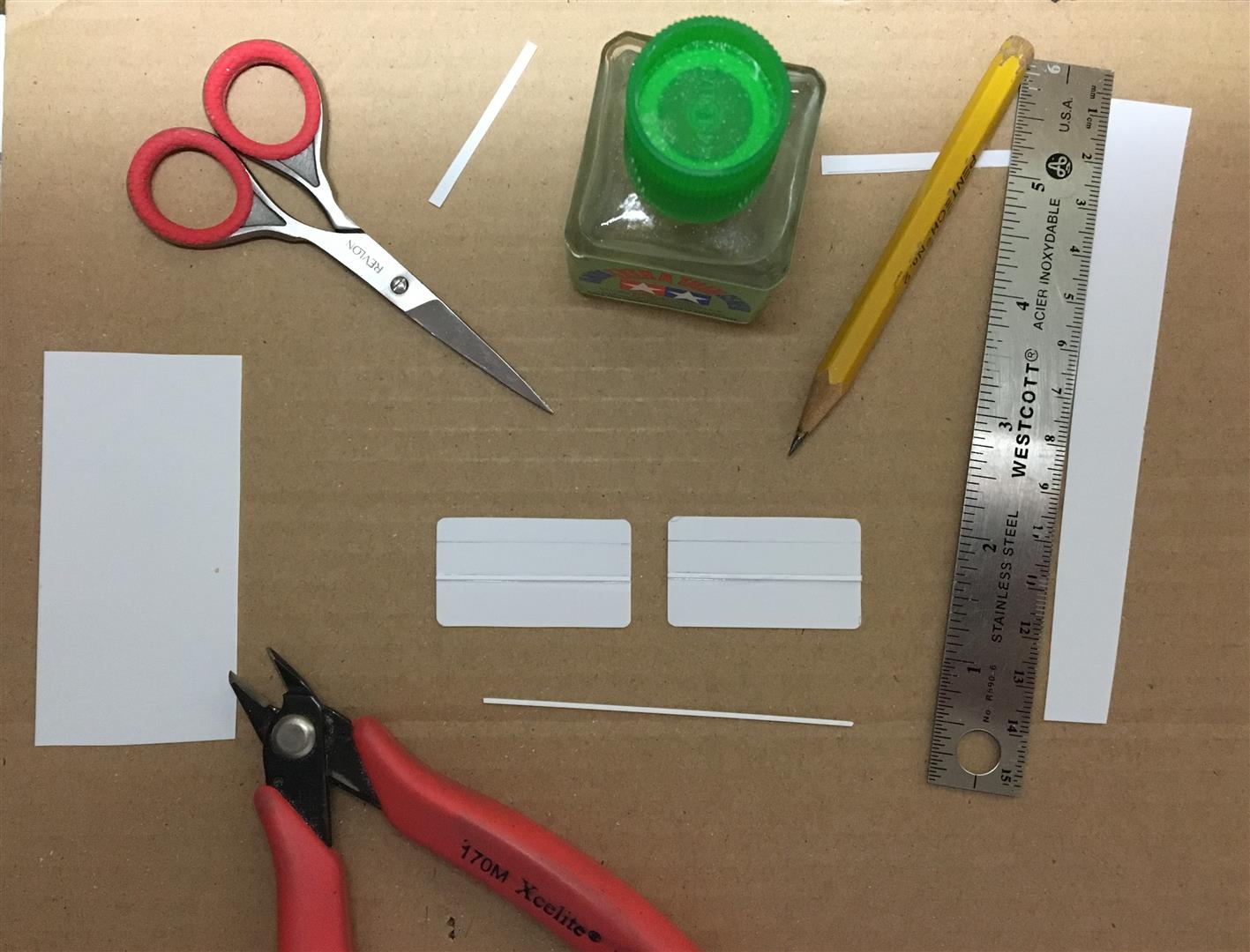

dino246gt Posted August 28, 2018 Author Posted August 28, 2018 So I made up some inner door panels, somewhat representative of the actual ones, but as usual, I take liberty with my builds, it's easier that way! LOL First I cut thin styrene sheet into the size that fit. I added some thin trim strips about 60% from the top. I made 2 piece arm rests. I cut cranks from a spare '62 Catalina interior and mounted them on thin slices of styrene rod. I made up some 2 piece door pulls as well. After a bit of foil, I brushed painted them in Tamiya "German Grey" and did the arm rests in "Nato Black"

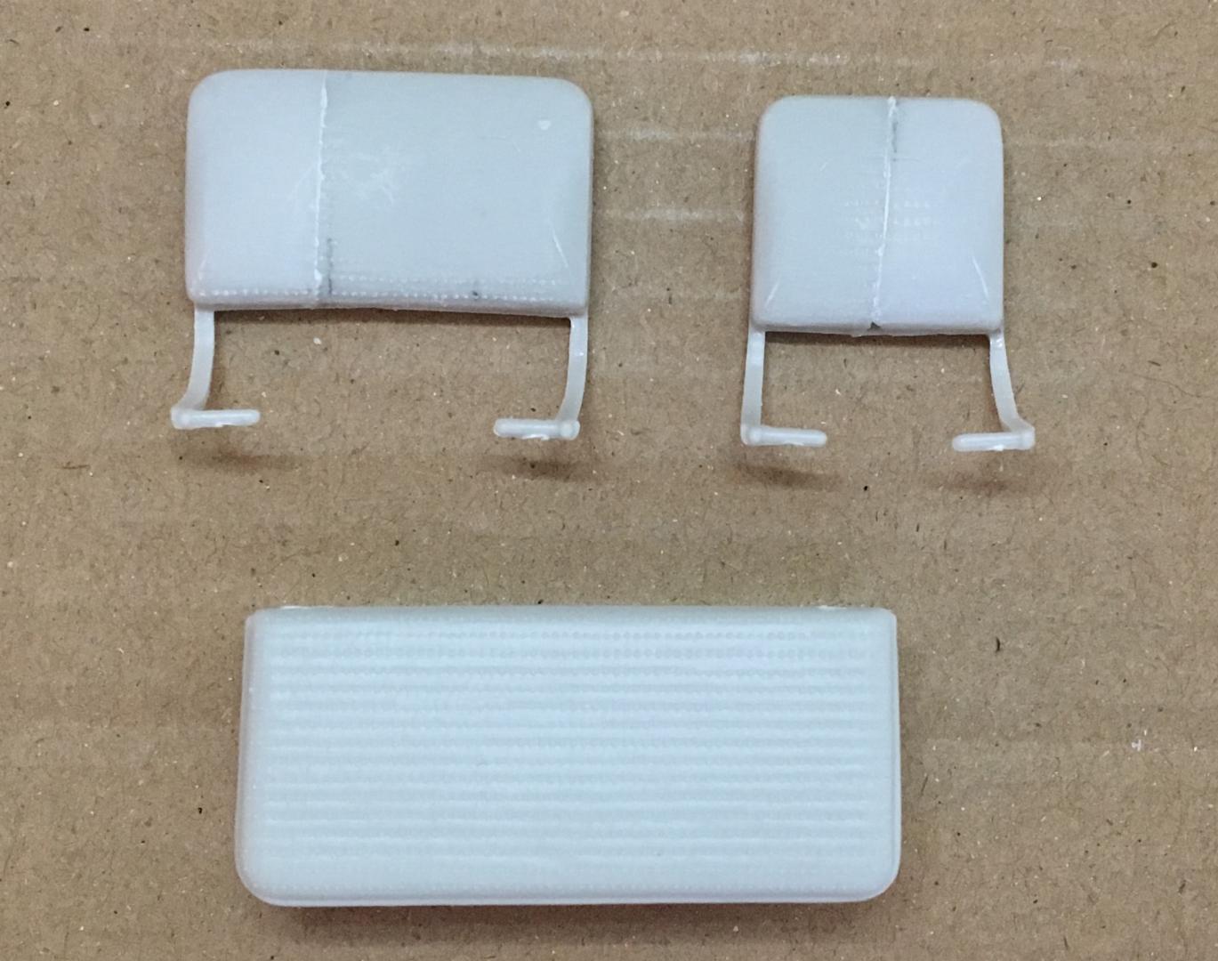

dino246gt Posted August 28, 2018 Author Posted August 28, 2018 I'm trying to make that bench seat that Tom Geiger showed on page 1 of this thread. Thank you for that tip Tom, I do have 2 of the Chevy pickup kits, 2 that won't have original seats!
