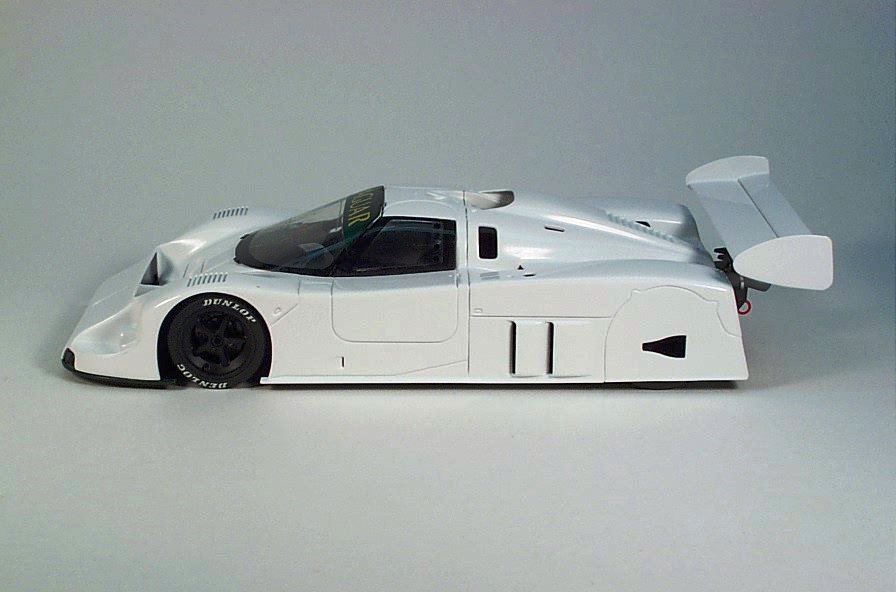

jchrisf Posted September 3, 2018 Author Posted September 3, 2018 (edited) LOL.. I meant for the same can of Rustoleum Dann. Dann, what do you use for flat, gloss and semi-gloss black and white? The Duplicolor I have from the Auto Parts store only had flat and gloss black and it was Acrylic Enamel. Goes on nice and dries fast but I'm always afraid a lacquer on or around it will hurt it. I have some Rustoleum Maxx satin black that I also got at the auto parts store since they didn't have a satin Duplicolor and it looks really nice but it goes on thick as you described and takes a few days to completely dry. Edited September 3, 2018 by jchrisf
mikemodeler Posted September 3, 2018 Posted September 3, 2018 On 9/3/2018 at 4:48 PM, jchrisf said: LOL.. I meant for the same can of Rustoleum Dann. Dann, what do you use for flat, gloss and semi-gloss black and white? The Duplicolor I have from the Auto Parts store only had flat and gloss black and it was Acrylic Enamel. Goes on nice and dries fast but I'm always afraid a lacquer on or around it will hurt it. I have some Rustoleum Maxx satin black that I also got at the auto parts store since they didn't have a satin Duplicolor and it looks really nice but it goes on thick as you described and takes a few days to completely dry. Expand Check a NAPA or Bennett Auto Supply store, they have the Duplicolor lacquers in semi gloss, gloss and flat blacks. Fast drying and won't craze the plastic.
jchrisf Posted September 4, 2018 Author Posted September 4, 2018 On 9/3/2018 at 8:27 PM, mikemodeler said: Check a NAPA or Bennett Auto Supply store, they have the Duplicolor lacquers in semi gloss, gloss and flat blacks. Fast drying and won't craze the plastic. Expand I found the Acrylic Lacquer Mike.. is that the one you meant? I haven't used the blacks yet but did use the white and it doesn't cover well and bubbles up. What is a good white? The Duplicolor Acrylic Enamel flat black is really nice. It dries fast and looks great but is a little fragile because it scratches and chips easy on a chassis.
935k3 Posted September 4, 2018 Posted September 4, 2018 (edited) For white cars you cannot find any thing better than Krylon White Lacquer Edited September 4, 2018 by 935k3
jchrisf Posted September 4, 2018 Author Posted September 4, 2018 On 9/4/2018 at 4:28 PM, 935k3 said: For white cars you cannot find any thing better than Krylon White Lacquer Expand Hey Dale, where is the best place to get this? I know Walmart doesn't carry it.
Dann Tier Posted September 4, 2018 Posted September 4, 2018 On 9/3/2018 at 4:48 PM, jchrisf said: LOL.. I meant for the same can of Rustoleum Dann. Dann, what do you use for flat, gloss and semi-gloss black and white? The Duplicolor I have from the Auto Parts store only had flat and gloss black and it was Acrylic Enamel. Goes on nice and dries fast but I'm always afraid a lacquer on or around it will hurt it. I have some Rustoleum Maxx satin black that I also got at the auto parts store since they didn't have a satin Duplicolor and it looks really nice but it goes on thick as you described and takes a few days to completely dry. Expand Hey, Chris! For a Flat black, I use their Black Sandable Primer. For a semi-gloss black, I use their Universal Flat black, which ISNT flat...lol, and for a gloss black, I use their Universal Gloss Black. If for some reason I cant get ahold of these Duplicolors, I go with Tmiya sprays, and lets say you need a flat black, but you only have Duplicolors semi-gloss, and gloss blacks, I would pick one of them to spray first, and then use Tamiyas Flat Clear over it. You can do this with their semi, and gloss clears as well...
jchrisf Posted September 4, 2018 Author Posted September 4, 2018 On 9/4/2018 at 5:14 PM, Dann Tier said: Hey, Chris! For a Flat black, I use their Black Sandable Primer. For a semi-gloss black, I use their Universal Flat black, which ISNT flat...lol, and for a gloss black, I use their Universal Gloss Black. If for some reason I cant get ahold of these Duplicolors, I go with Tmiya sprays, and lets say you need a flat black, but you only have Duplicolors semi-gloss, and gloss blacks, I would pick one of them to spray first, and then use Tamiyas Flat Clear over it. You can do this with their semi, and gloss clears as well... Expand Thanks Dann.. great ideas!
935k3 Posted September 4, 2018 Posted September 4, 2018 (edited) On 9/4/2018 at 5:12 PM, jchrisf said: Hey Dale, where is the best place to get this? I know Walmart doesn't carry it. Expand Try Amazon. Do use primer under it. It has very solid pigments, drys fast and can be recoated any time. I usually put a few coats on let dry, then sand it down with 2400 or 3200 grit and then put a few final coats on then polish. Edited September 4, 2018 by 935k3
