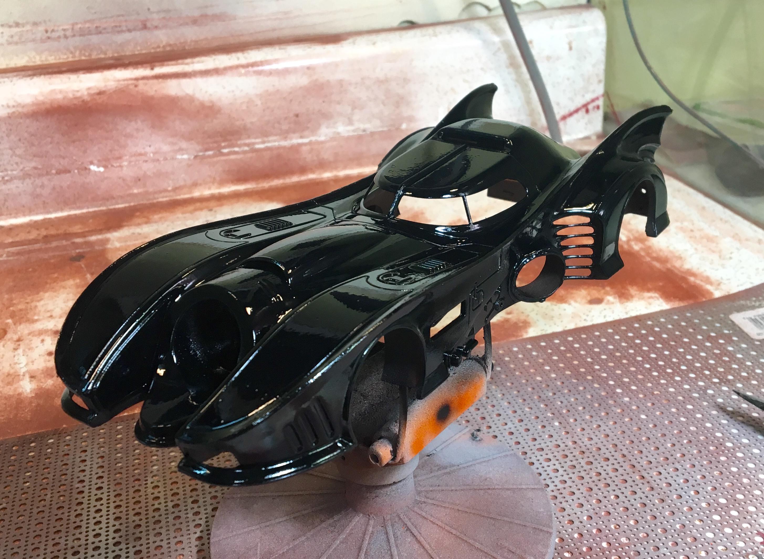

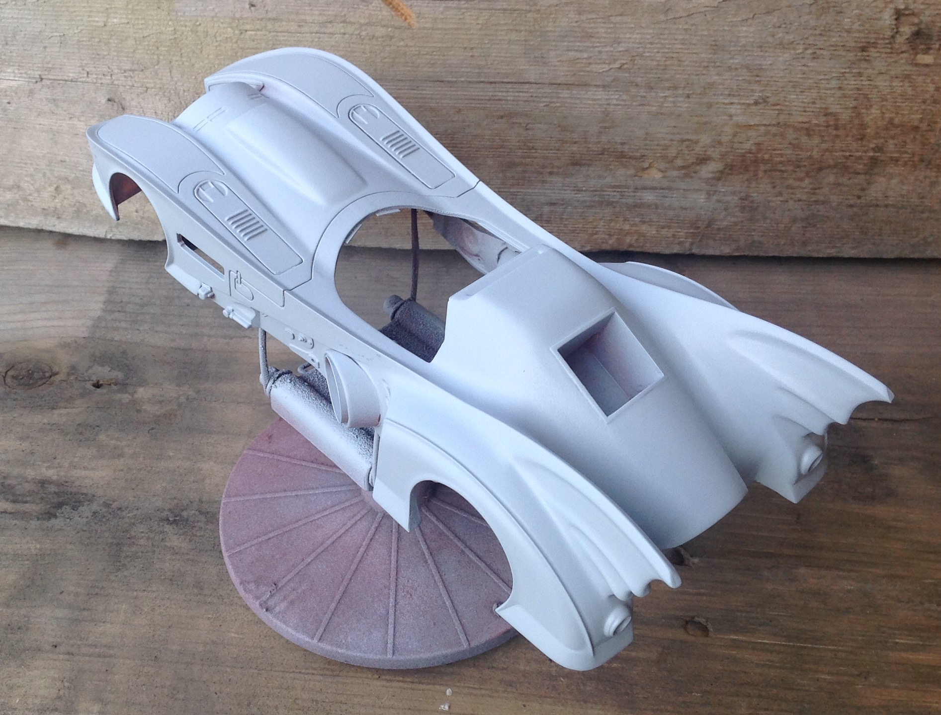

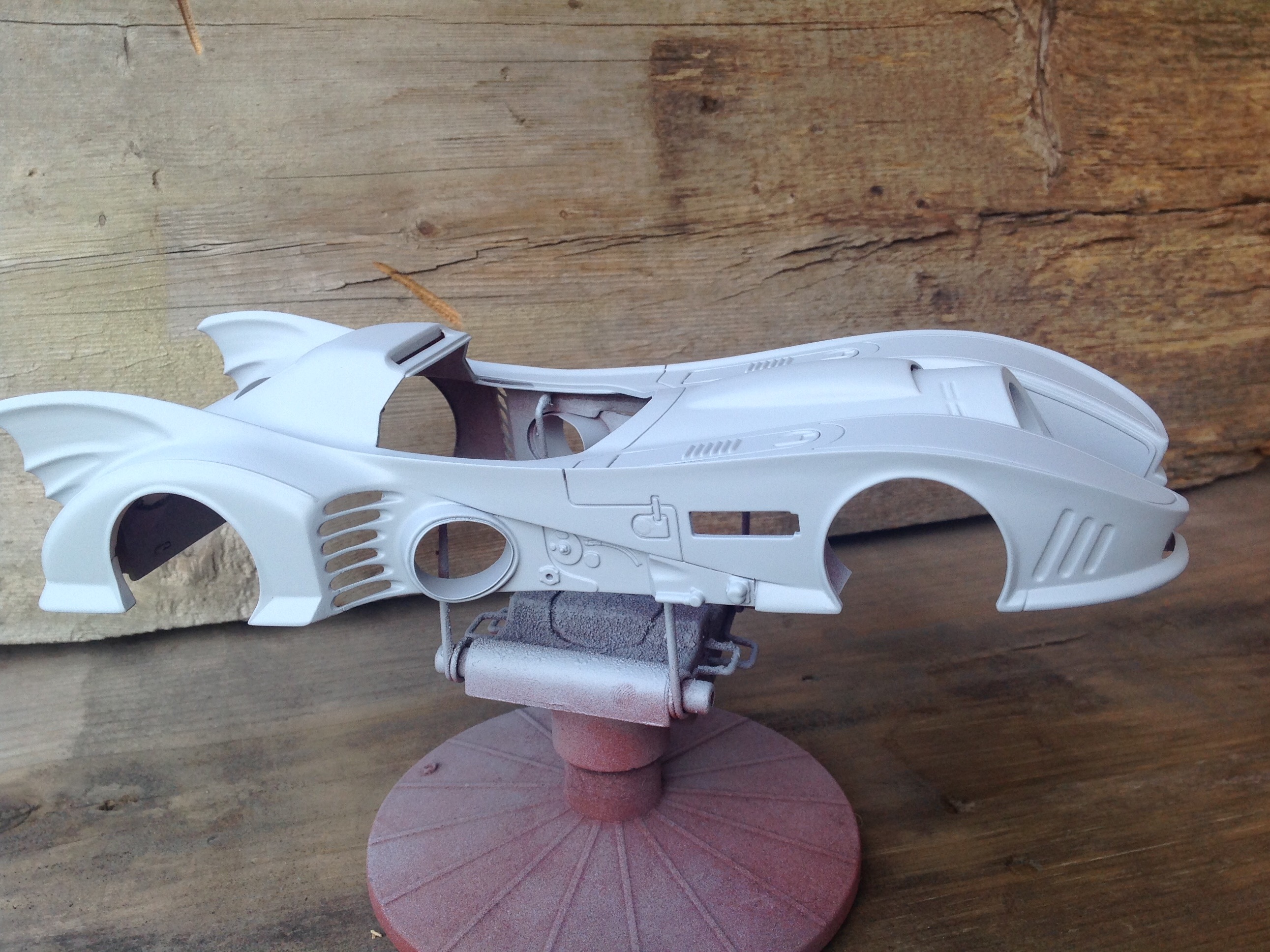

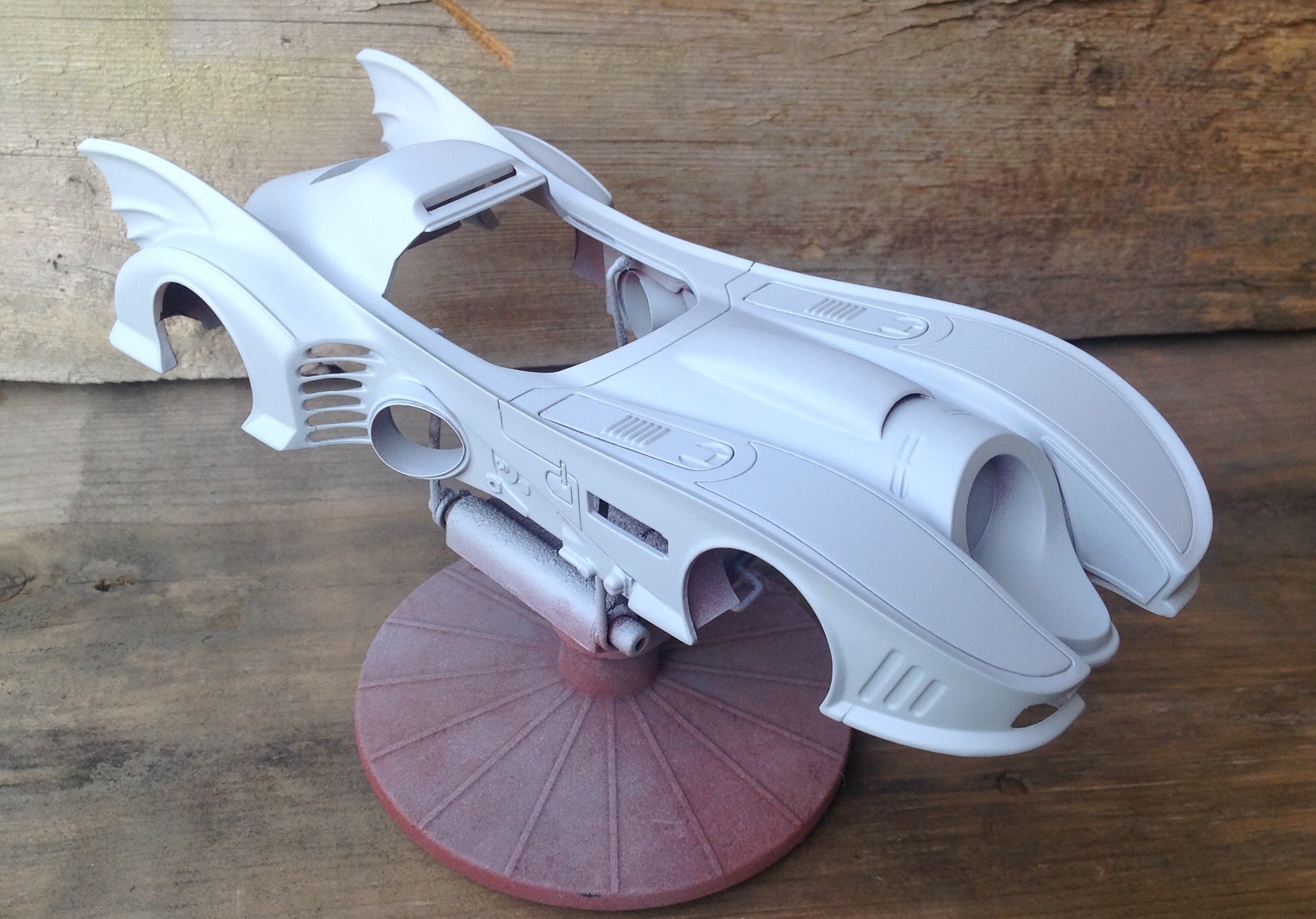

One step closer to paint. I shot a few coats of filler primer, now to let it cure for a few days. So far so good, perhaps some white will go down Monday.
Thanks for checking in on the progress guys.

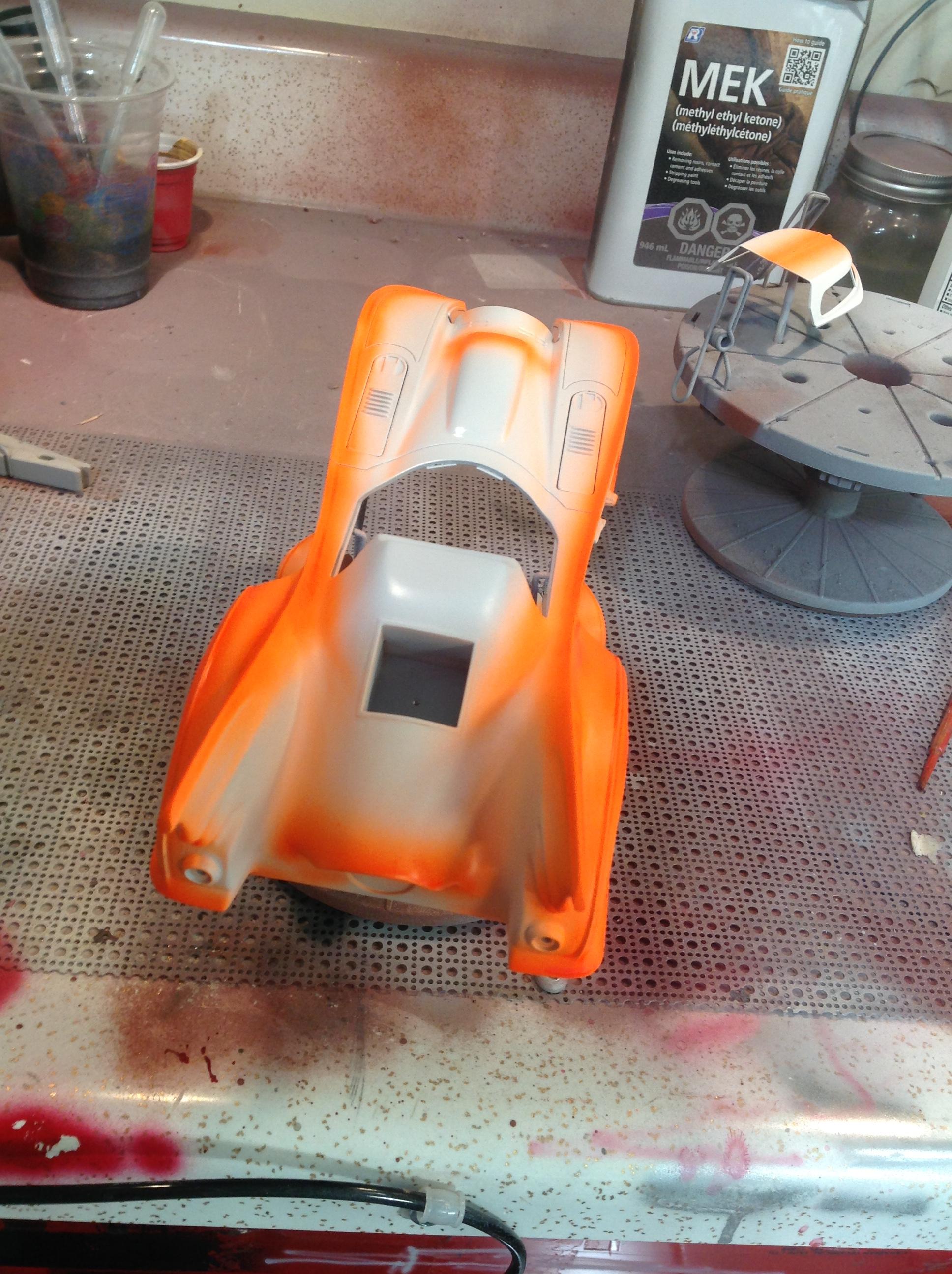

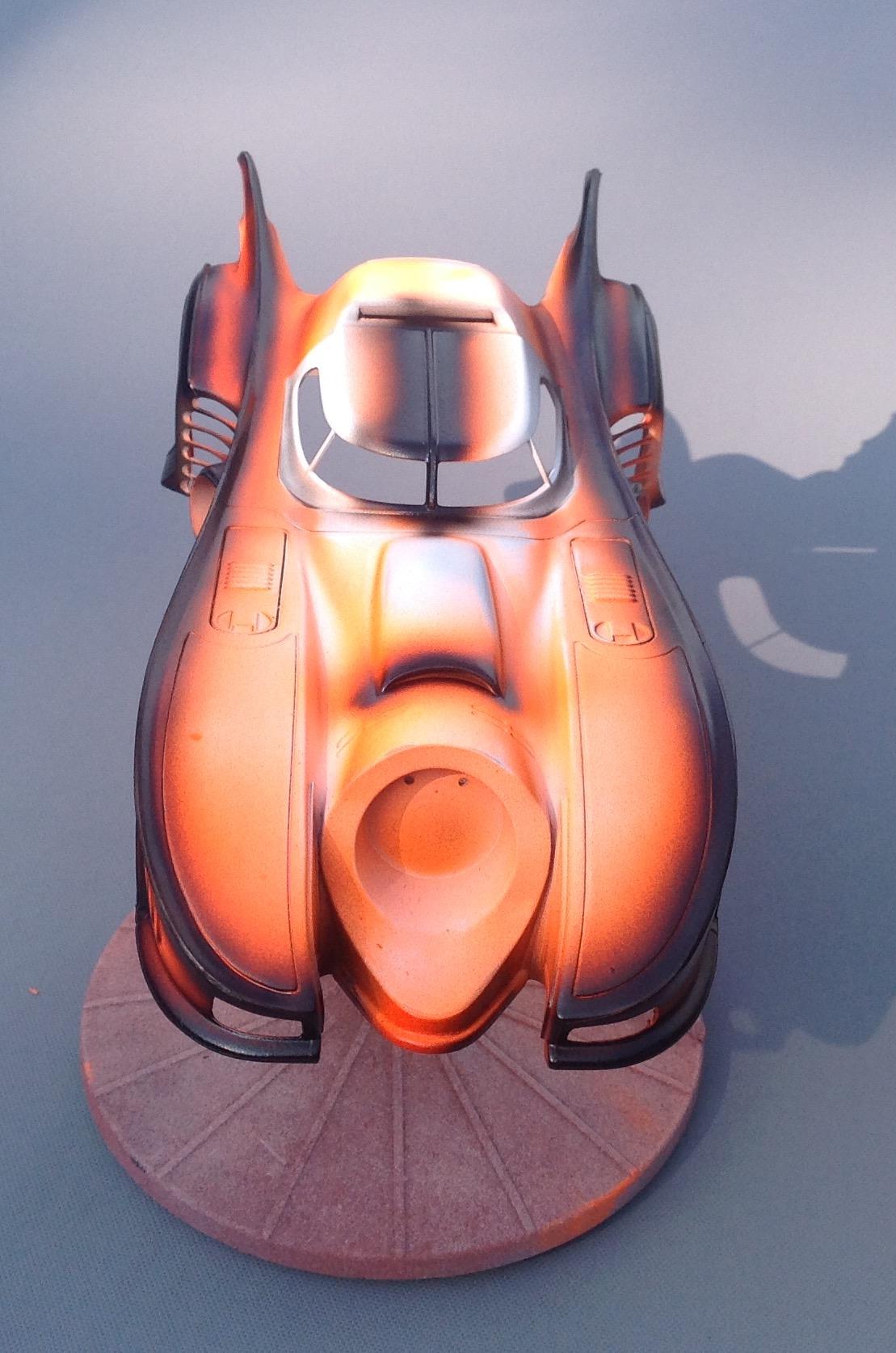

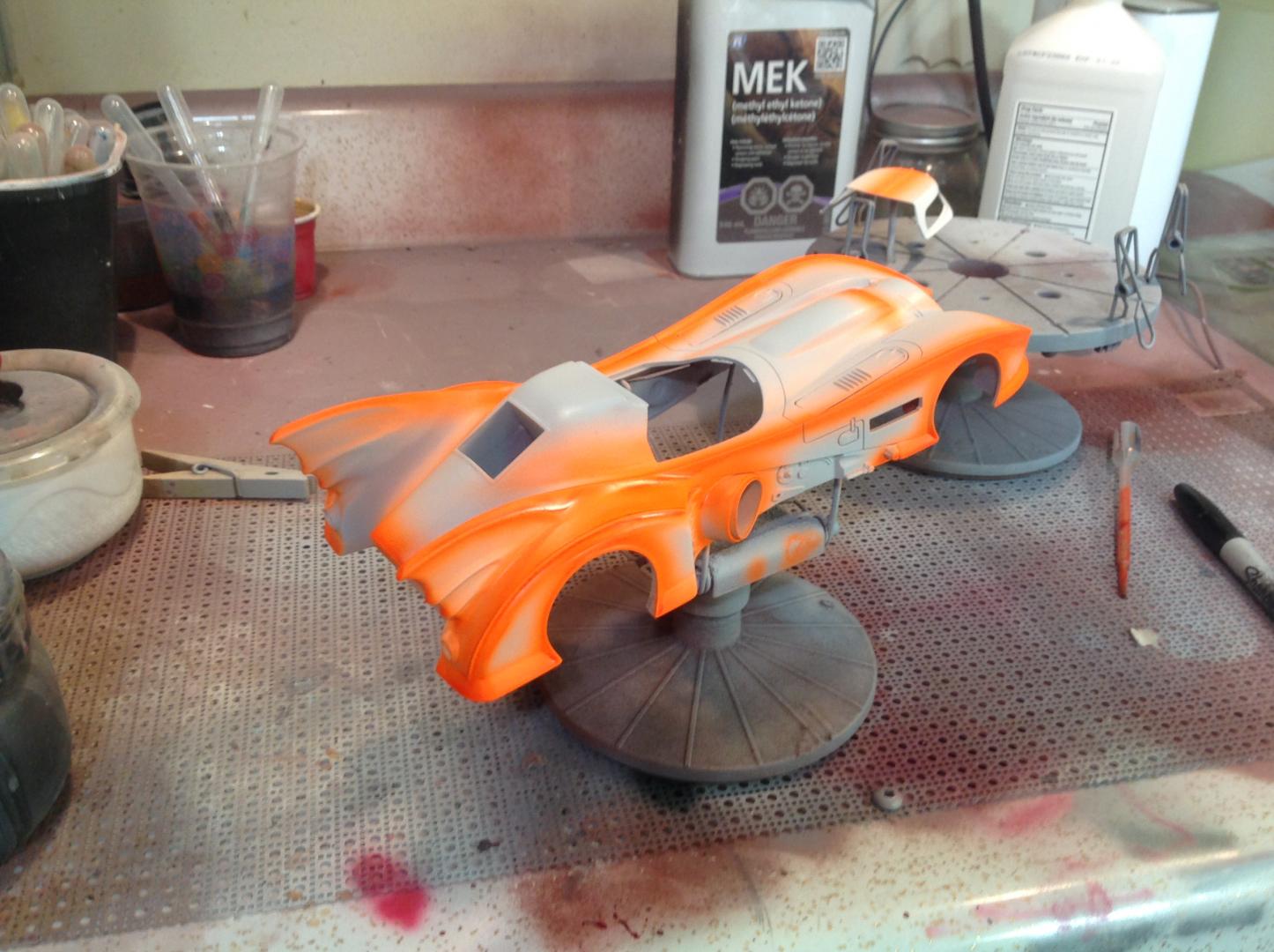

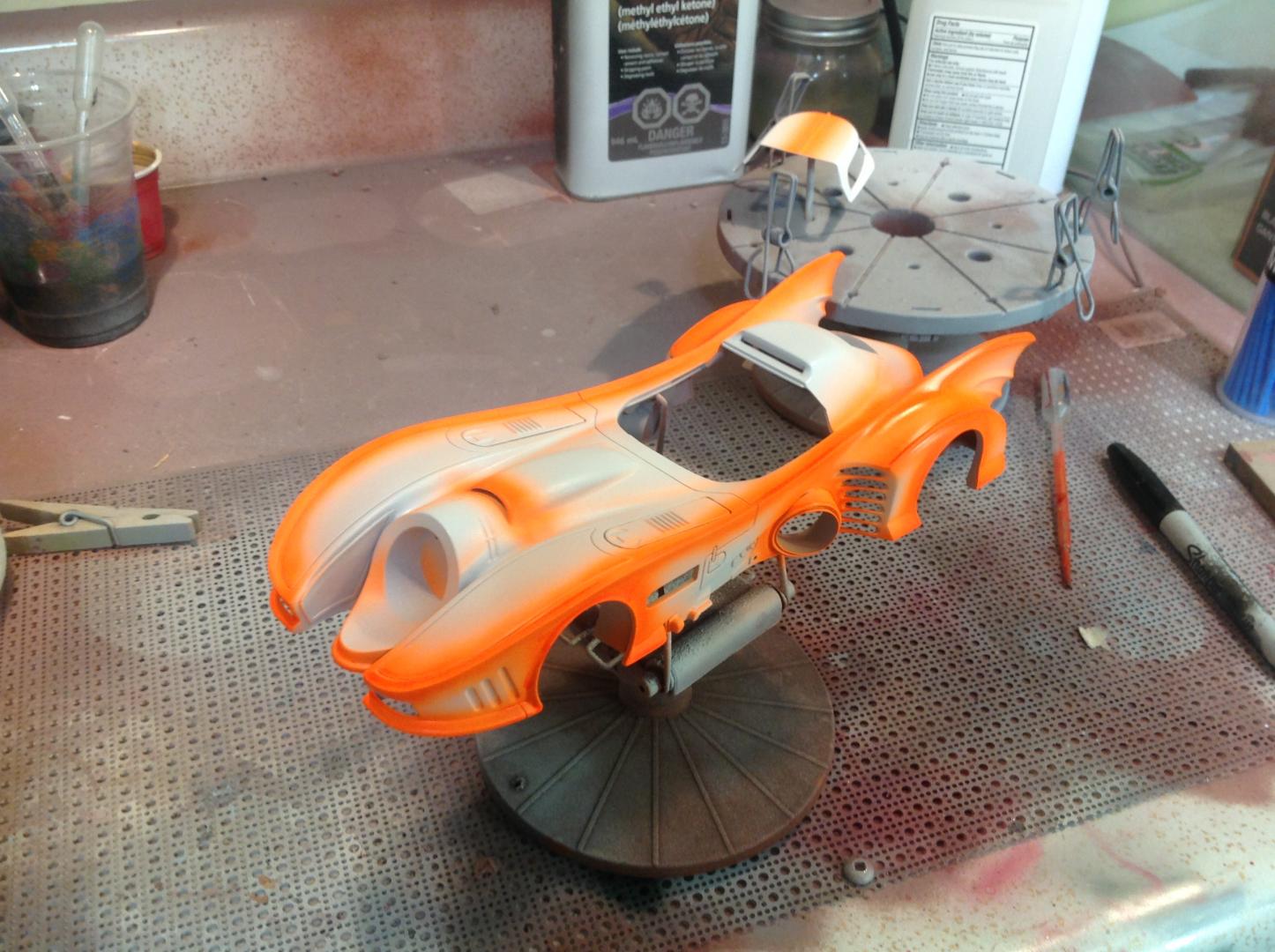

First colour down.
My limited experience with Fluorescent colours shows here. This stuff is super tranlucent and requires multiple layers to build up the right shade. It bleeds like a stuck pig and runs like a runaway train down  hill.
 I'll have a few spots to wet sand before I mask the pin strips, oh well all part of the learning.
The black might be down this week.
Thanks for looking in.

The orange is laid down over a light great, which was laid down over Duplicolor primer. The grey was matt, it will provide good mechanical bond for the orange. Most builders don't understand the reason for the window set out in the paint  instructions of the time line between coats and why you have to wait the 24-48hrs before you can recoat.
The time line/window for repeated coats is to provide a chemical bond between layers. If you recoat out side that window you have to wait for the previous coat to gas off, then a scuff is needed in order to provide the next layer with a mechanical bond.
This is part of the reason primers are a matt finish.
If you have another concern I am happy to hear it. ?
 This isn't my first painting rodeo, ?.

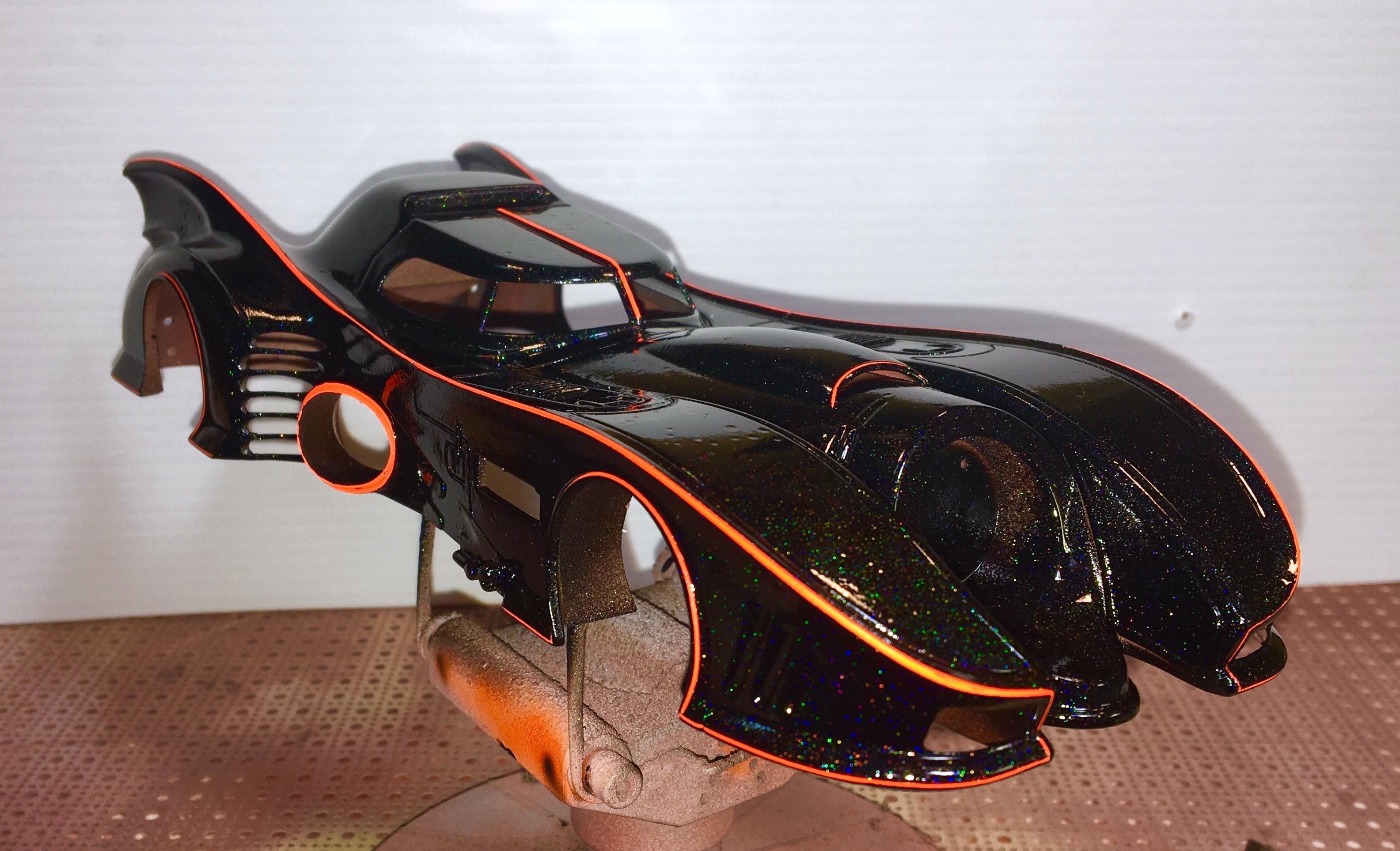

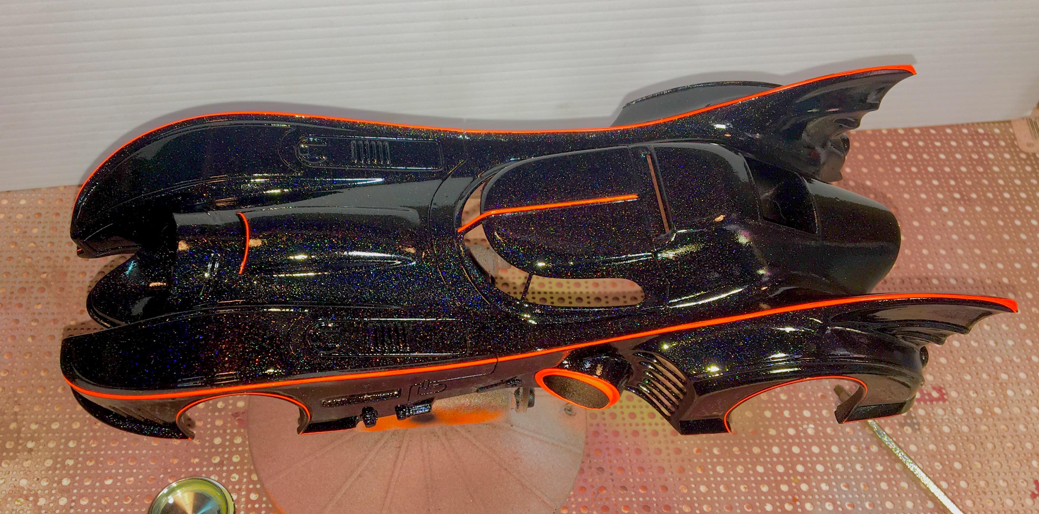

Hi guys, pin strip masking complete and partial painting started.

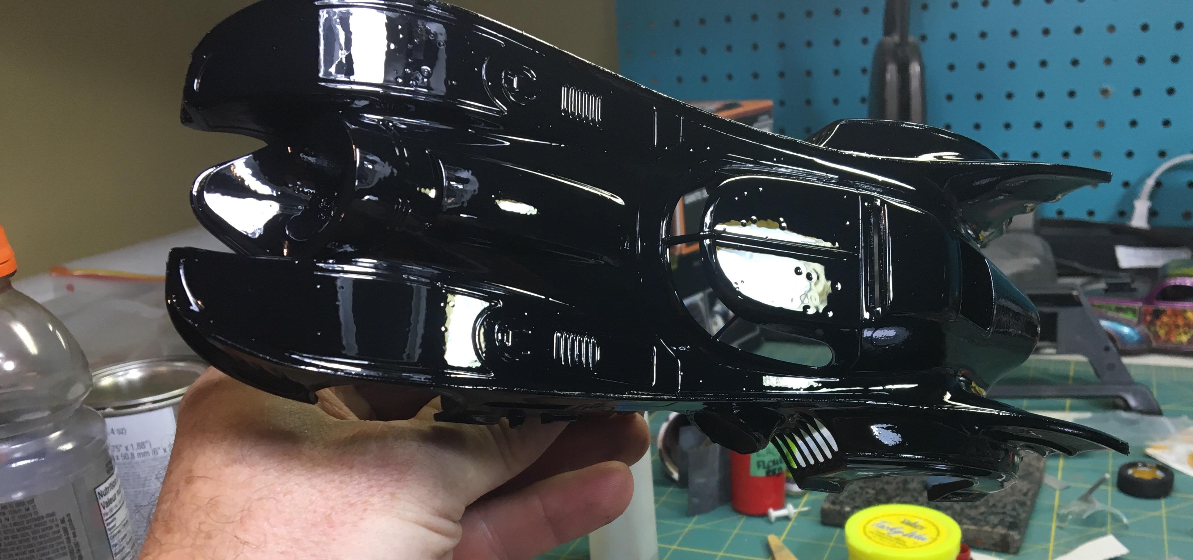

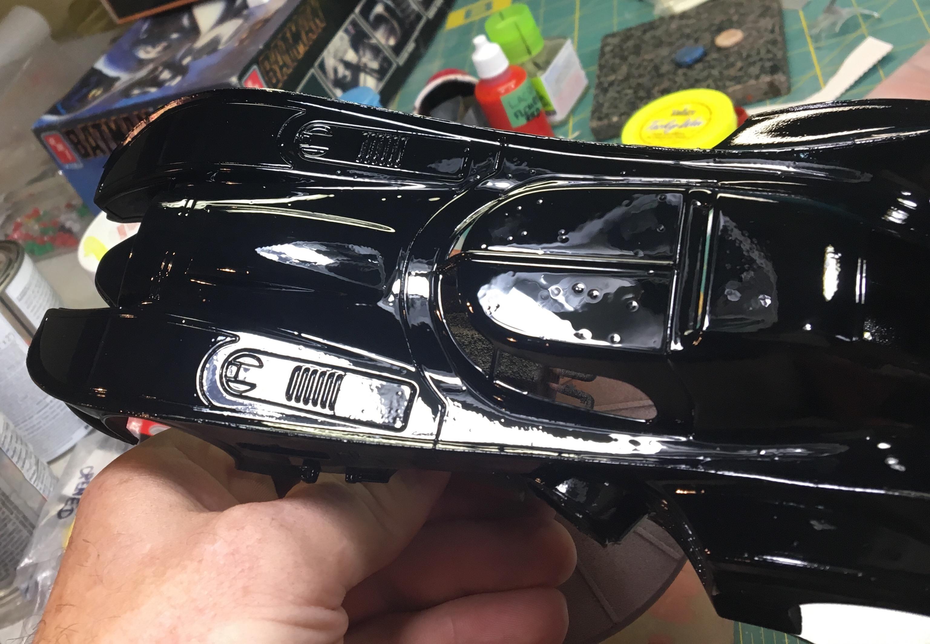

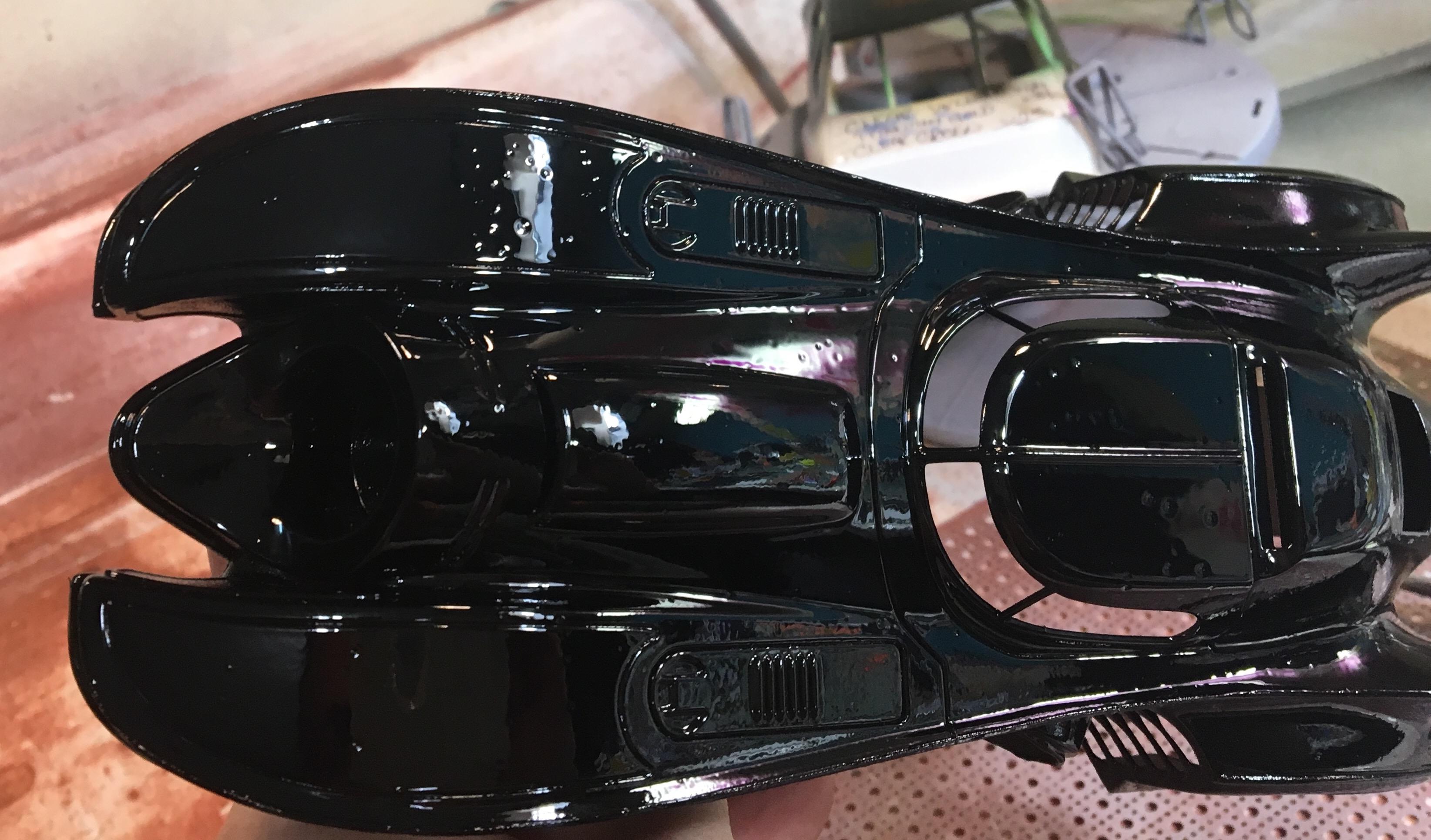

Well this has taken a turn for the worst. ?
In all my years of building and painting I have NEVER had an issue with fish eyes in my paint. This paint job has an accumulation of fish eyes that could be called a school of fish eyes. I know what causes fish eyes in general but this is ridiculous. I must have washed my hands in oil or silicone before I did all the masking.
I am really hoping the two wet layers of polyurethane I laid down will allow me to wet sand them out. If I can't wet sand them out the checkered pattern might be a moot process.
Edited by Rider
Thanks for the confidence and encouragement guys. I will figure out something. I have an idea for a dio that may include the fish eyes into bullet holes, so far a hand full of others including myself also think they could pass as gun shot.

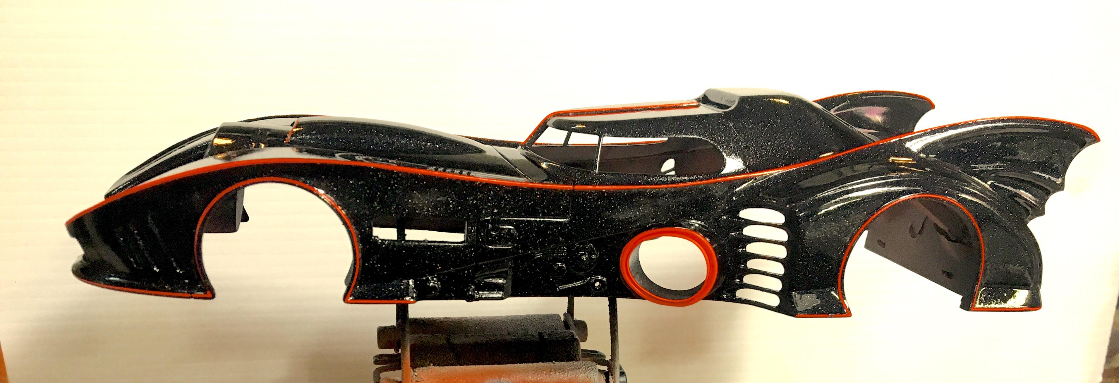

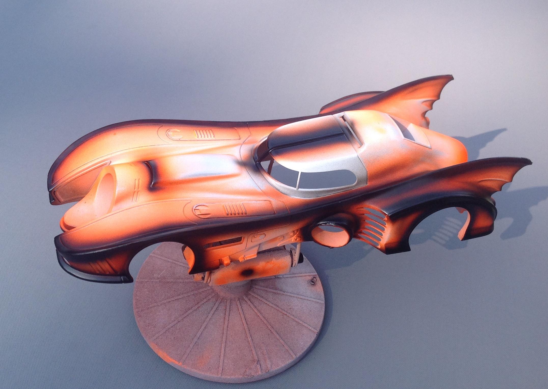

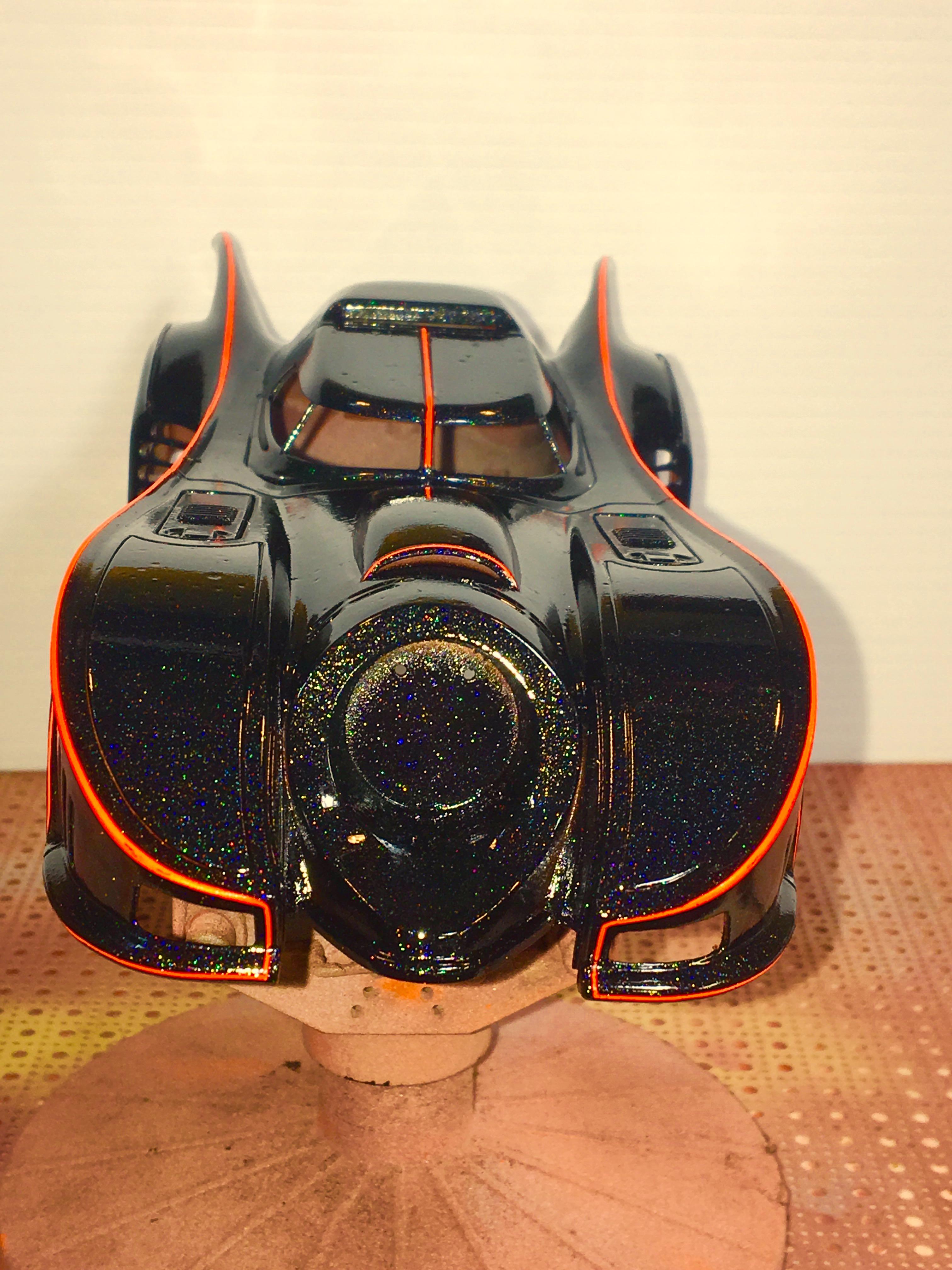

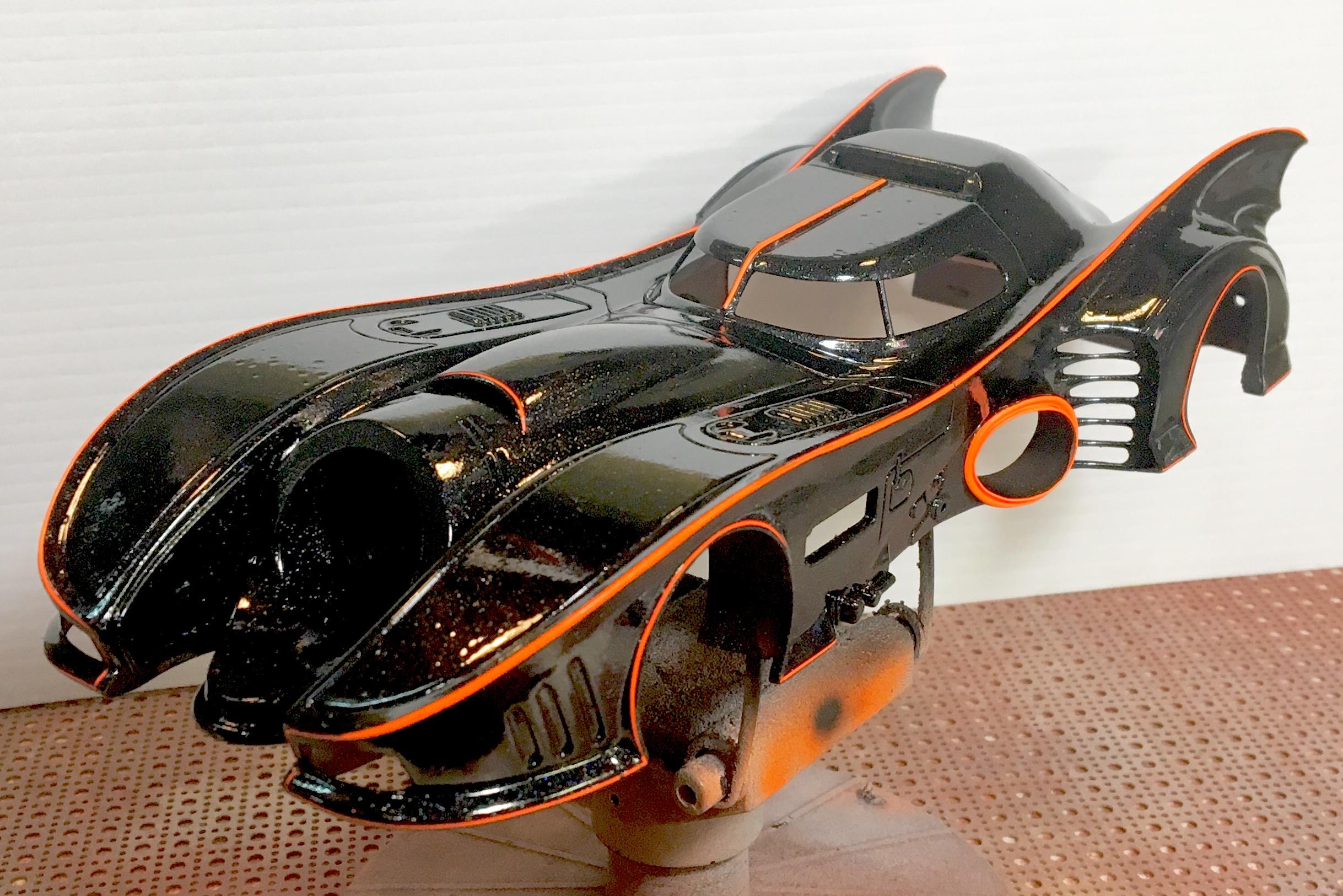

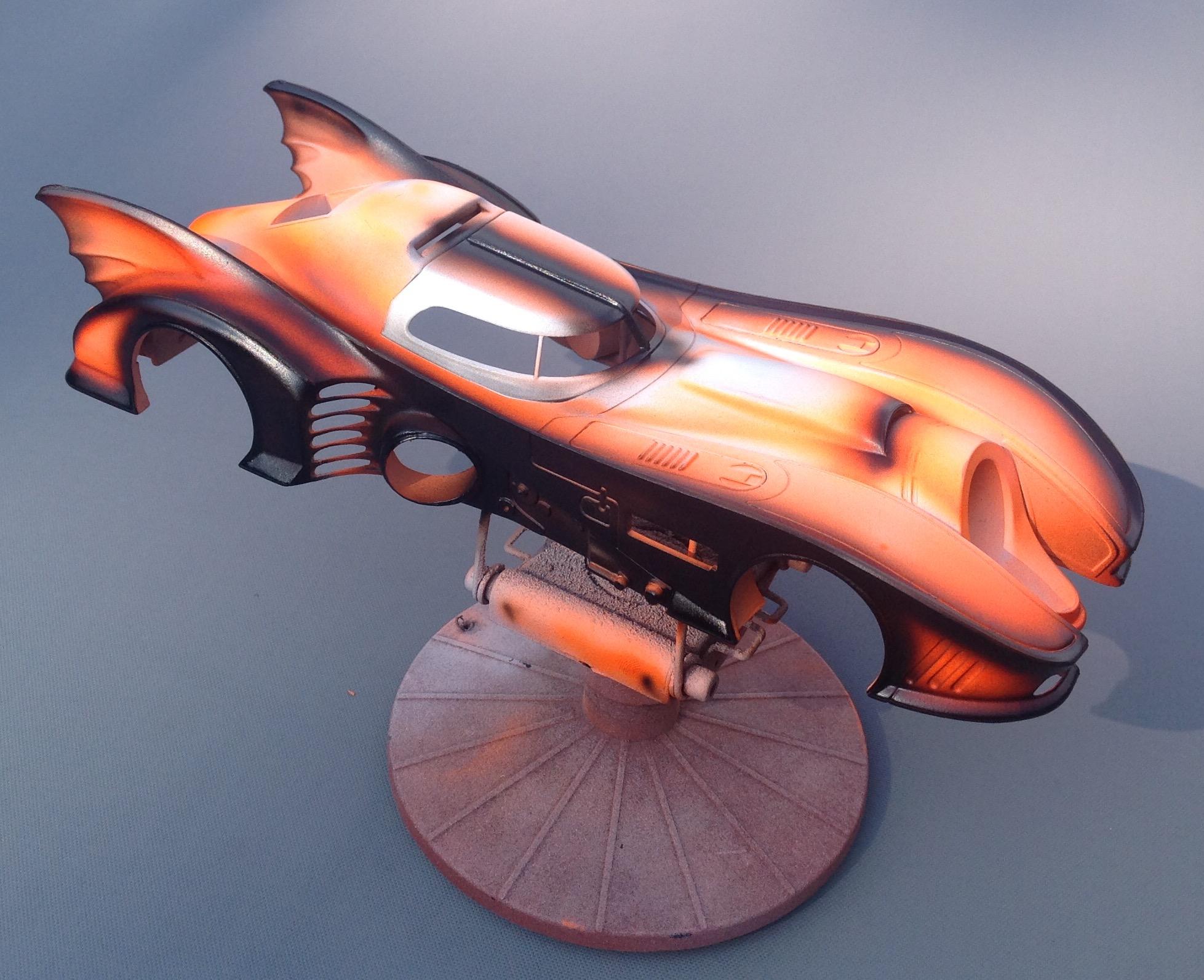

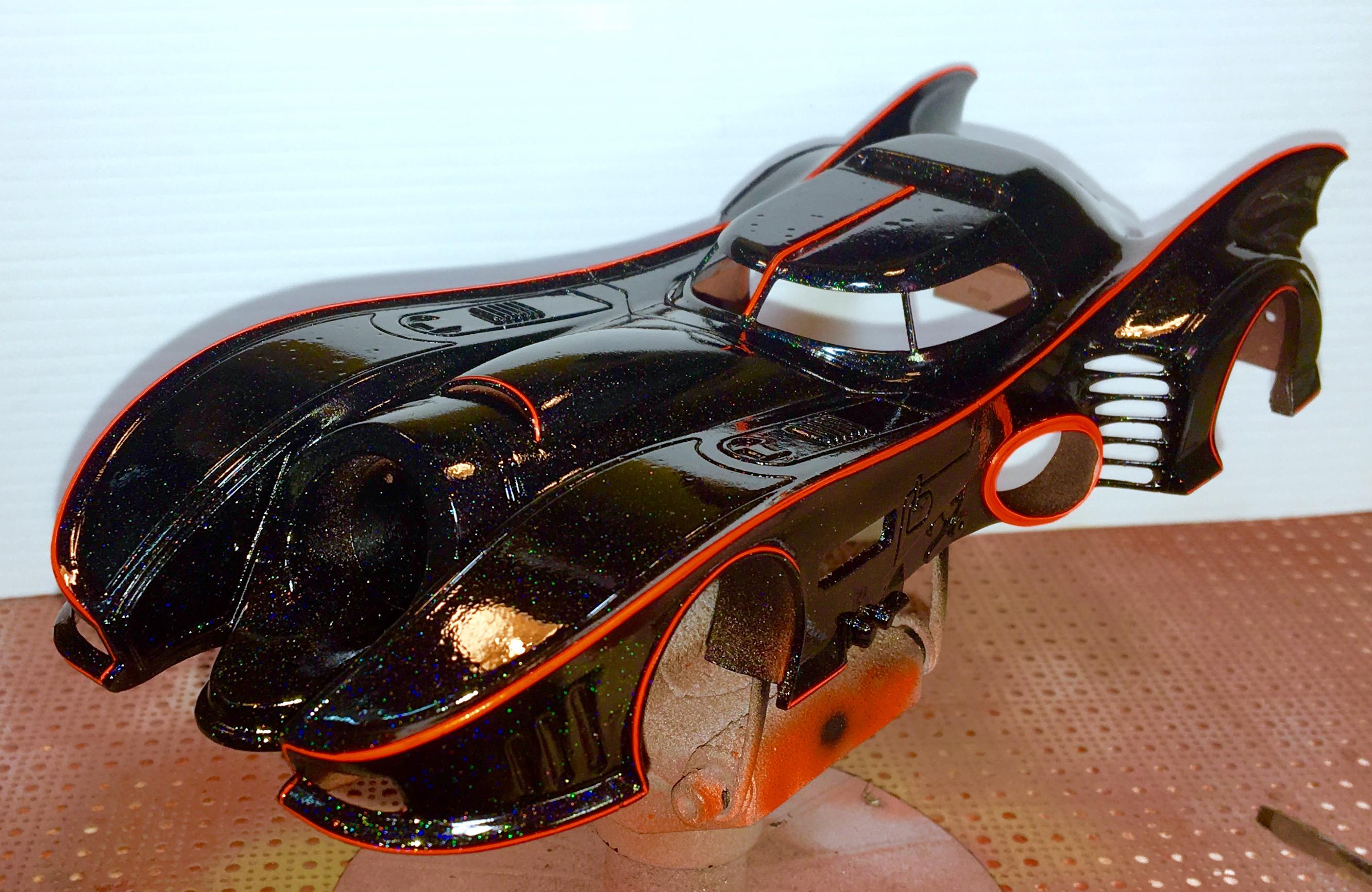

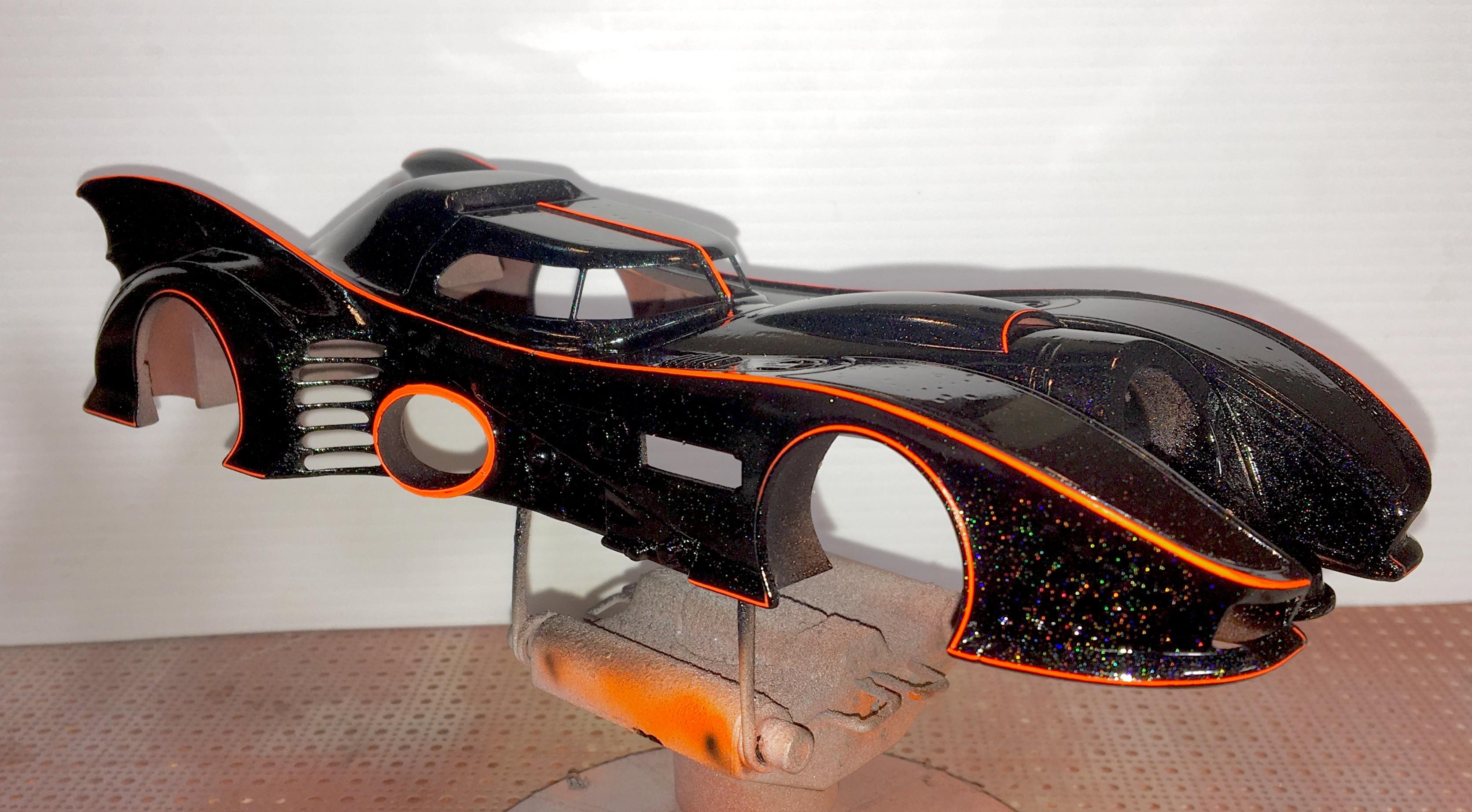

Given the paint is a disaster waiting to get worse I decided to shoot a holographic clear then a dusting of colour change paint.
The car is going to get a good battle scare treatment, I just have to figure out how to go about doing that.
Here are some shots of where we are now with the paint.
I have had similar problems before....
It's a real shame about the "fish eye" problem. Do you think you had moisture in the compressor?
Are sure there is no chance to redo the paint?
?I would agree with your assumptions about moisture i the tank, however I sprayed a test shell 20min earlier with no issues at all, plus I have a moisture trap at the AB.
I could possibly redo the paint but not going to bother. The fish eyes look enough like bullet holes that I am going to weather them to fit the part.
Thanks for checking it out.
Sorry to hear you've had some paint issues. Like your plan for making the fish eyes work as bullet holes.  I've never been a fan of stripping paint particullarly when so much body work is involved.  Looking forward to seeing more.
