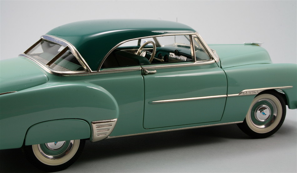

Some possible information sources for your fathers '51 Chevrolet. First autocolorlibrary.com should give you an idea of the colors that were available. For a little additional information try oldcarbrochures.com. There you can view some of the dealership brochures that will better show you how the cars were presented. Also the Resin/After market section on the forum lists several suppliers for true reproduction paint, MCW comes to mind but there are others to consider. I may be close to your fathers age and one of my high school friends had a '50 Chevrolet hardtop that was a light Green with a Black roof that looked good. I also have a neighbor who still owns his first car, a '51 Chevrolet convertible in Maroon with a light Tan top. Most of the colors at that time were still a little somber and not real bright. Detroit didn't really start with many interesting colors until the '54's . You can Google '51 Chevrolet and get a lot of pictures of 1:1 cars but remember most of these will be restored or modified cars and owners tend to take liberties with color choice depending on the era that the car is redone in. Please show your build on the forum, I'd like to see it if for old time sake if nothing else. You could always add some of the speed parts from the kit or find an old AMT '53 Corvette kit and add the 3 side draft carbs for a little fun. Those Corvette hub caps were also a common addon years ago. Don't forget the wide whites just not to wide.

But searching online I found this one  painted in non original sky blue with white top that looks very good.

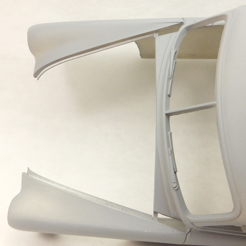

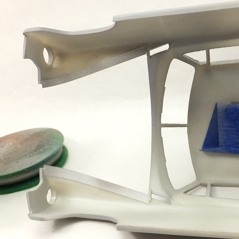

The hood fit is terrible (typical AMT). So after fiddling around with the body and the hood, I added these strips to help the hood sit properly. After all they are in the 1:1 anyways.
The fit of the hood is getting better but it still needs a ton of work, especially at the back.

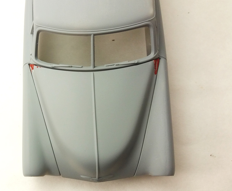

First coat of primer reveals some mold lines that still need attention.
Dear Lord! The hood fit is so terrible. I can't live with that.  I have to address it.

You might consider adding material to the cowl area to fill the gap with the hood. The 1:1 has a very narrow strip between the Windshield and the back side of the hood. The sides where the hood meets the front door there is only a seem so material might have to be added to that edge of the hood. The thing that always put me off on this and the Convertible and Fastback body styles has to do with the Windshield and rear window.  The moldings around the window are very thick compared to the 1:1. The way the kit's glass is mounted it's as if it's to deep set into the body. A thought, and I don't want to make this any harder, you might consider looking at the Revell '50 Olds. kit. In reality they shared a common body structure. A common styling change in that era was to get an Oldsmobile Windshield and moldings and put them in a Chevrolet giving you a one piece Windshield. Short of switching roofs making this a coupe which may not be want you want, you may want to look at thinning the mounting for the windows from the inside of the roof so they don't look so deep set.  The rest of the body looks very smooth at this point.
Izzy, before you get too far into that, I'd take another look at those front fenders and how the inner fenders attach to them.
I did the same thing you did on one I was working on years ago and had to remove the strips. They interfered with the inner fenders. The top edge of them sit against the hood opening and form a lip very close to the same width as the strips you added.
Granted, mine was the Fleetline and the BelAir may not be exactly the same.

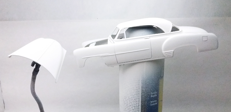

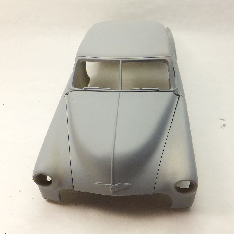

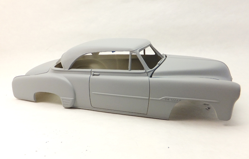

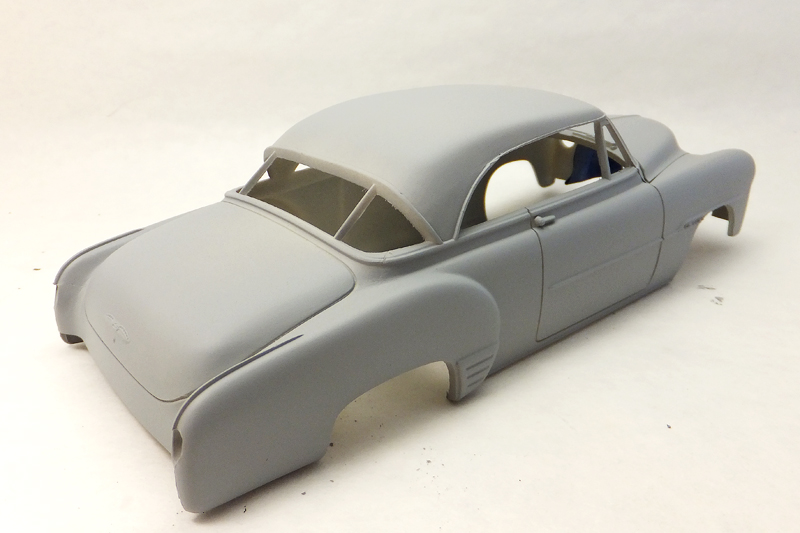

Hello,
  After dealing with mold lines from hell, she is now in white primer.  Not shown but started working on the box stock engine as well.  Sorry but AMT quality doesn't cut it for me.  It didn't 10 years ago and it doesn't now.

Espo makes an excellent point about the depth of the window openings. I like these AMT Chevy kits a lot, but what's always driven me to distraction about them is the toylike thickness of the material surrounding the windshield and rear window.
It takes some careful effort with a Dremel and files to correct it, but in my opinion, it makes the model much more realistic.
As the front and rear glass on these cars is a single curve (as opposed to compound), it's easy to make much more real looking "glass" from clear soda bottle stock, too.
Ismael, if I were to build this kit again I would do what you're doing with the hood, but also fix the windows front and back. In particular, the rear window looks pretty funky:

I'm glad to see you're back on this build. You mentioned the hood fitment, and you may have already set what you're going to do there, but as I recall the 1:1 Chevy hoods had a different alignment between the back edge of the hood and cowl just above the front fender. The kit has the back edge of the hood coming to a point at the corner where the hood, cowl, and fender all meet. I think this may be wrong. On the 1:1 the hood ends in a much straighter  up and down line instead of a point.  As I recall the hood meets the front door edge and covers the cowl in that area above the fender. If you google the '49 thru '52 Chevrolet you can see in the pictures what I mean. The back edge of the hood follows the door opening from the fender to the top of the cowl. Most would never notice this but I'm one of the fly ### in the pepper guys and have owned a '51 many many years ago.

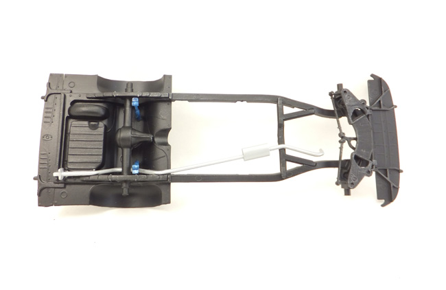

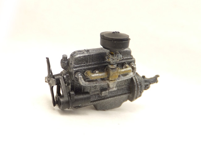

Hello gang,
  I've been away for a while as I've been very busy at work.  Time is running out if this is to become a Christmas present.
This is the farthest I've been to my comfort zone in a long time.  Not because of the subject but because it is a box stock build (what a concept!)  of a pretty bad kit of my least favorite kit manufacturer.

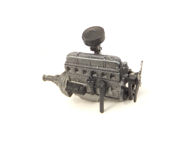

Box stock inline 6 engine. I used metallic paints but nothing factory stock.
Box stock chassis and suspension. Semi gloss black with drybrushed silver to give it some life.

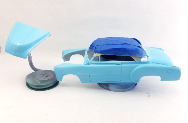

Roof has been painted white.  First coat of 1956 Nassau blue.  Again, not factory correct but a popular color in the late 50's
Still a long way to go.  I think I'm missing the Christmas window.  This could be either my last of 2018 or my first 2019. :)
I think he'll understand and love it anyway.
Looks good, don't rush it!
