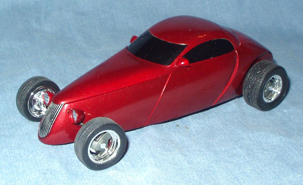

Snake45 Posted September 26, 2018 Posted September 26, 2018 (edited) I used Duplicolor red on an Alumicoupe. I had moderate blushing but it polished right out and looked great. Tried the same can on another project, spraying it over Rustoleum red primer. Didn't have any crazing at all and it went on fairly smoothly but the blushing was moderate to heavy. I spent a LOT of time polishing it out and it looked great except for a few areas where I polished through. I decided that there was no way to touch up the burnthroughs and have it look good (sometimes you can get away with it), so, sadly, ended up stripping the paint (Easy-Off took off both the Duplicolor and the Rustoleum, no problem at all). It's awaiting a repaint now. I won't be using Duplicolor again. Edited September 26, 2018 by Snake45
