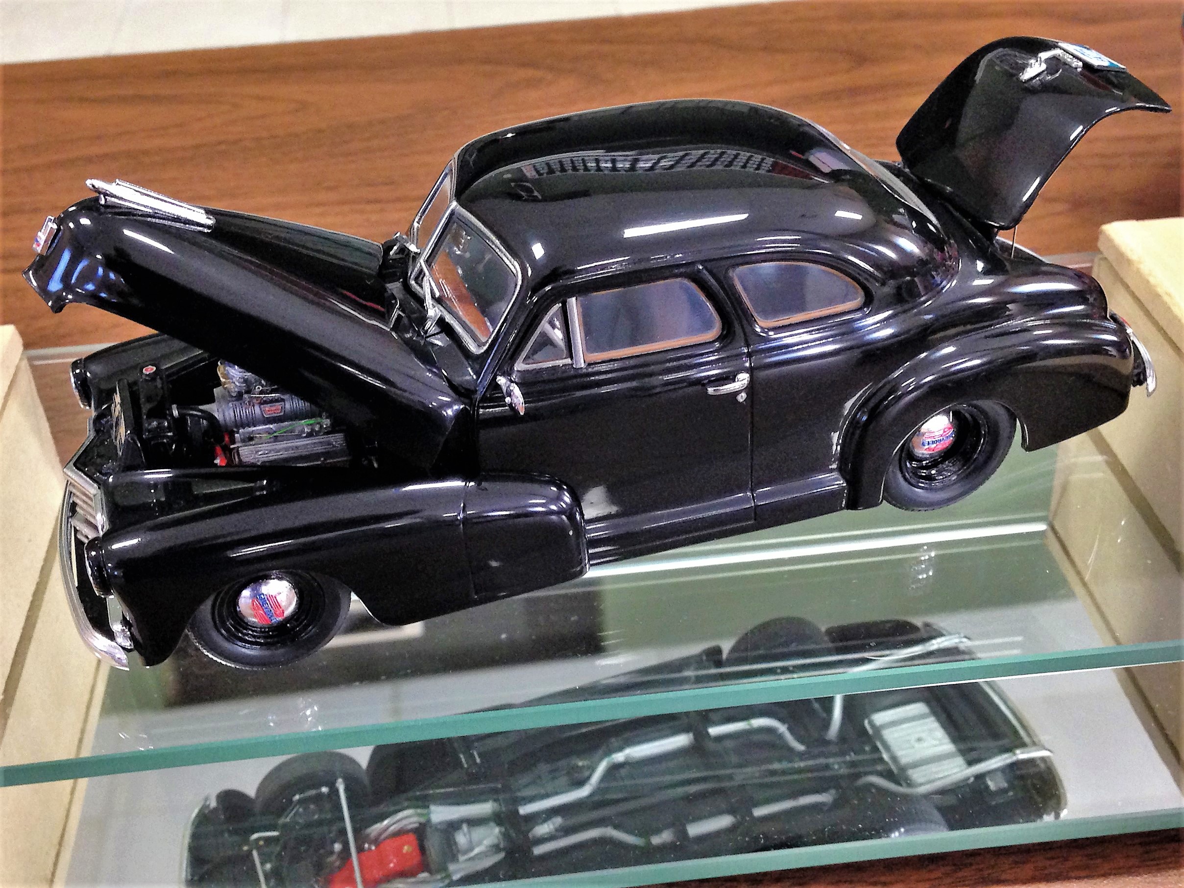

Ace-Garageguy Posted October 8, 2018 Posted October 8, 2018 (edited) 2 hours ago, fumi said: ...The "ridge" on the bottom of the body went up 3 scale inches too high... Yes, there is that, and getting a good glossy paint job tends to make it stand out. You can see the problem in Dennis' fine looking black model immediately above this post. HOWEVER (and I just checked a kit to verify this), a less intense way (than what fumi describes) to visually correct the initial appearance is to simply soften the convex "roll" as the lower panel turns down. Easily done with files and sandpaper. There is sufficient meat at that location to achieve a worthwhile improvement in the appearance. Edited October 8, 2018 by Ace-Garageguy

Ace-Garageguy Posted October 8, 2018 Posted October 8, 2018 56 minutes ago, Mr. Metallic said: Is this issue present on the Aerosedan and Sedan Delivery, or just the new coupe body which was first released a few years ago? It's on all of the Galaxie kits, but it's not going to bother a lot of people. You'll notice that too-high crease shows on Nick's great looking model too. The real car has it, but slightly lower, and it's always more noticeable when you don't use the rocker trim. Again, IF IT BOTHERS YOU, it's easy to file and sand the area just enough to drop the crease a little lower, or just round it off a bit so it LOOKS like it occurs lower. The convex crease should be almost level with the door cut-line, just a tick above it.

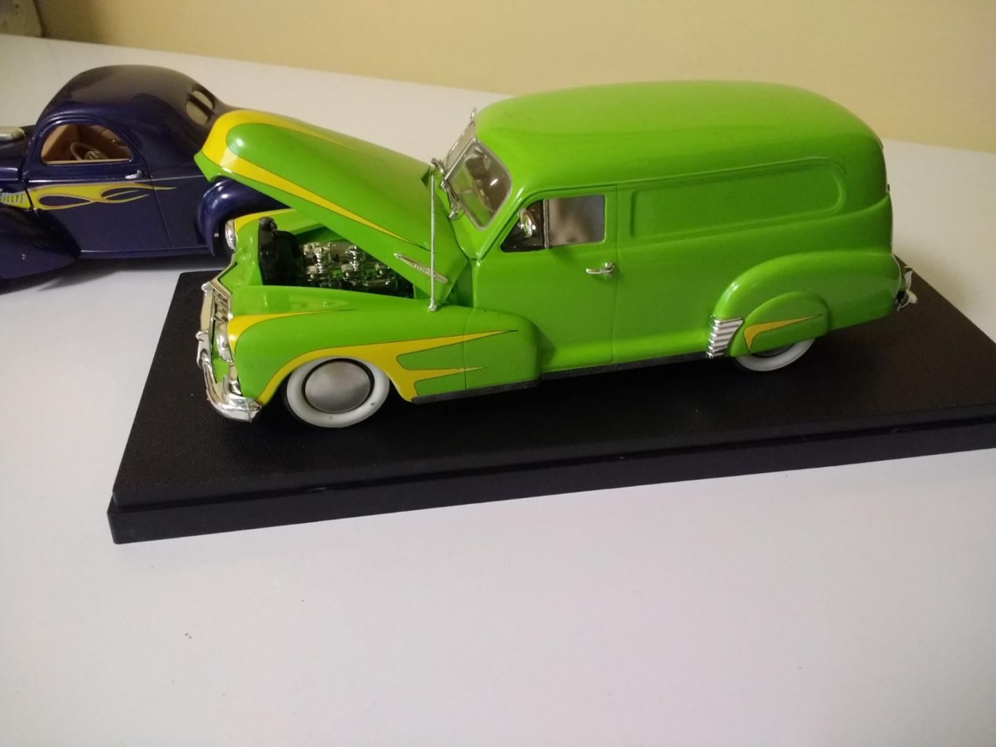

randyc Posted October 9, 2018 Posted October 9, 2018 Here's the sedan delivery I did when it was first released. Nothing extra except the moons. I think.
