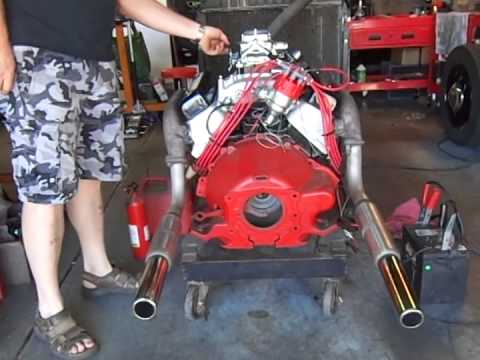

Lovefordgalaxie Posted October 23, 2018 Author Share Posted October 23, 2018 6 hours ago, Dave Darby said: I'm sure it'll be another home run. Couple of tips when it comes to that Y block. The T bird valve covers in that kit aren't the best. The 57 Fairlane and T bird kits have better sets. That and don't forget that Y Block distributors aren't mounted straight up and down. Y blocks have an external oil pump on the driver side rear of the block. The distributor has a driveshaft to run it. Thanks Dave. My Galaxie daily driver has a 292 Y from the factory. Love those engines. Won't be using the Thunderbird valve covers, I'll use the steel valve covers from the '57 Ford kit. 292 Y-Block 4V High Performance by CCCP Digital Studio, on Flickr Quote Link to comment Share on other sites More sharing options...

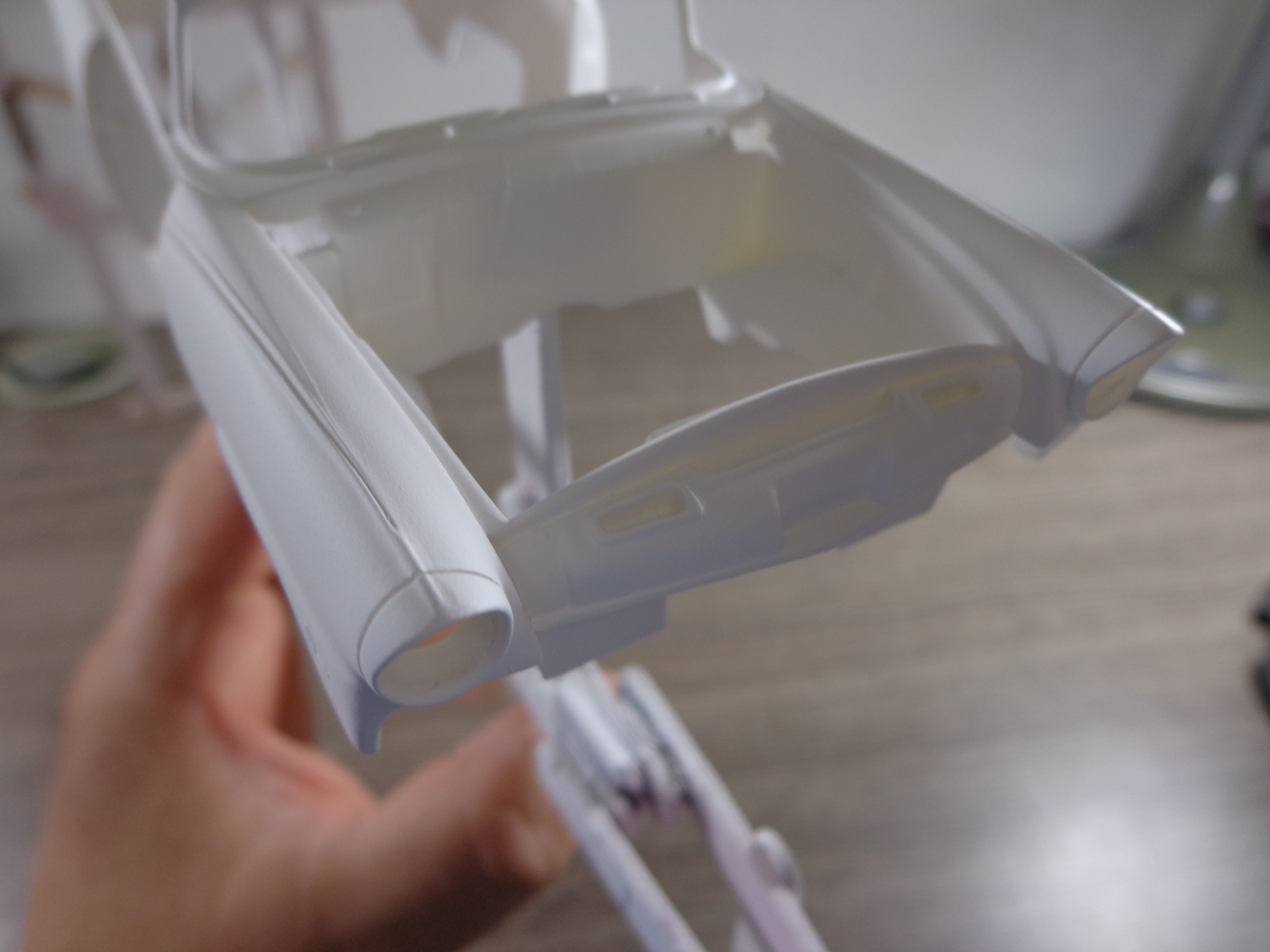

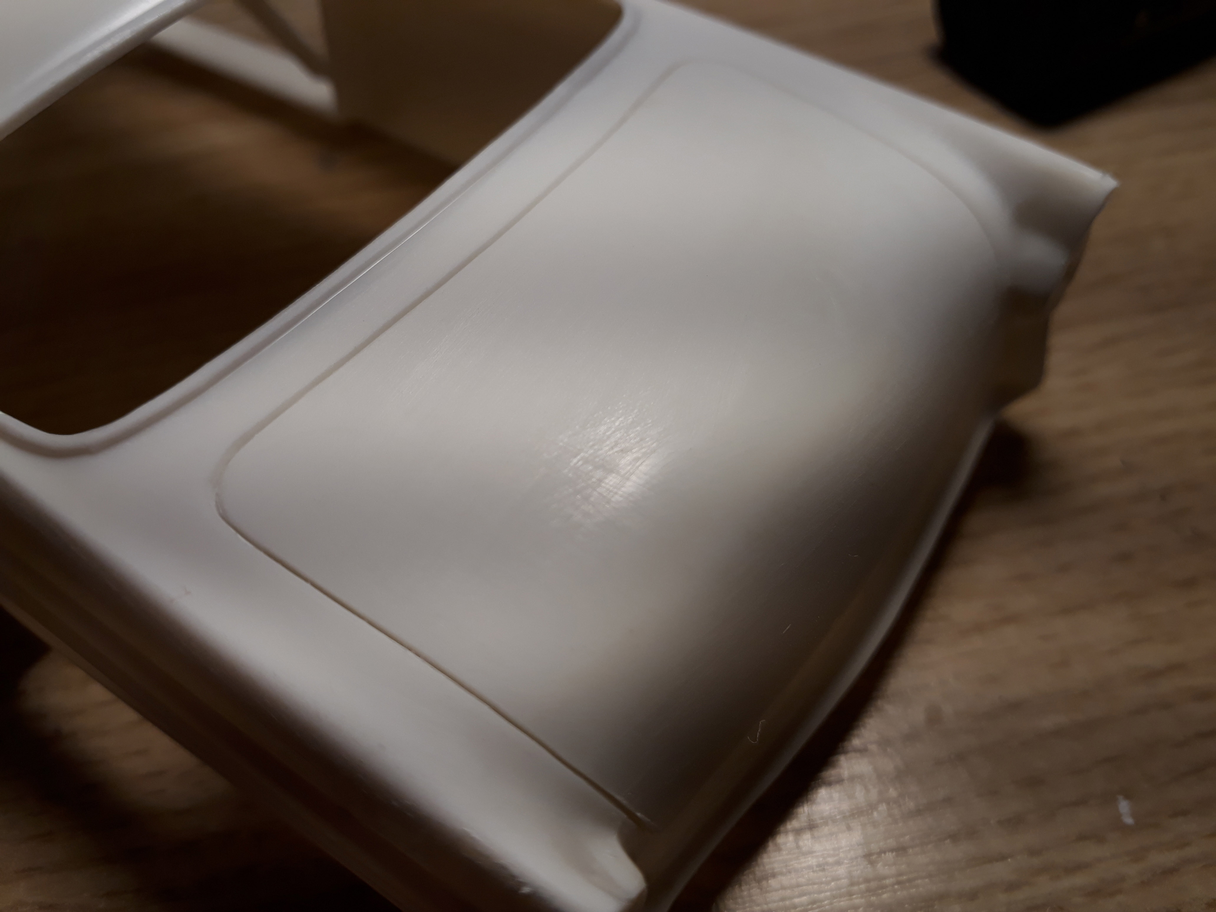

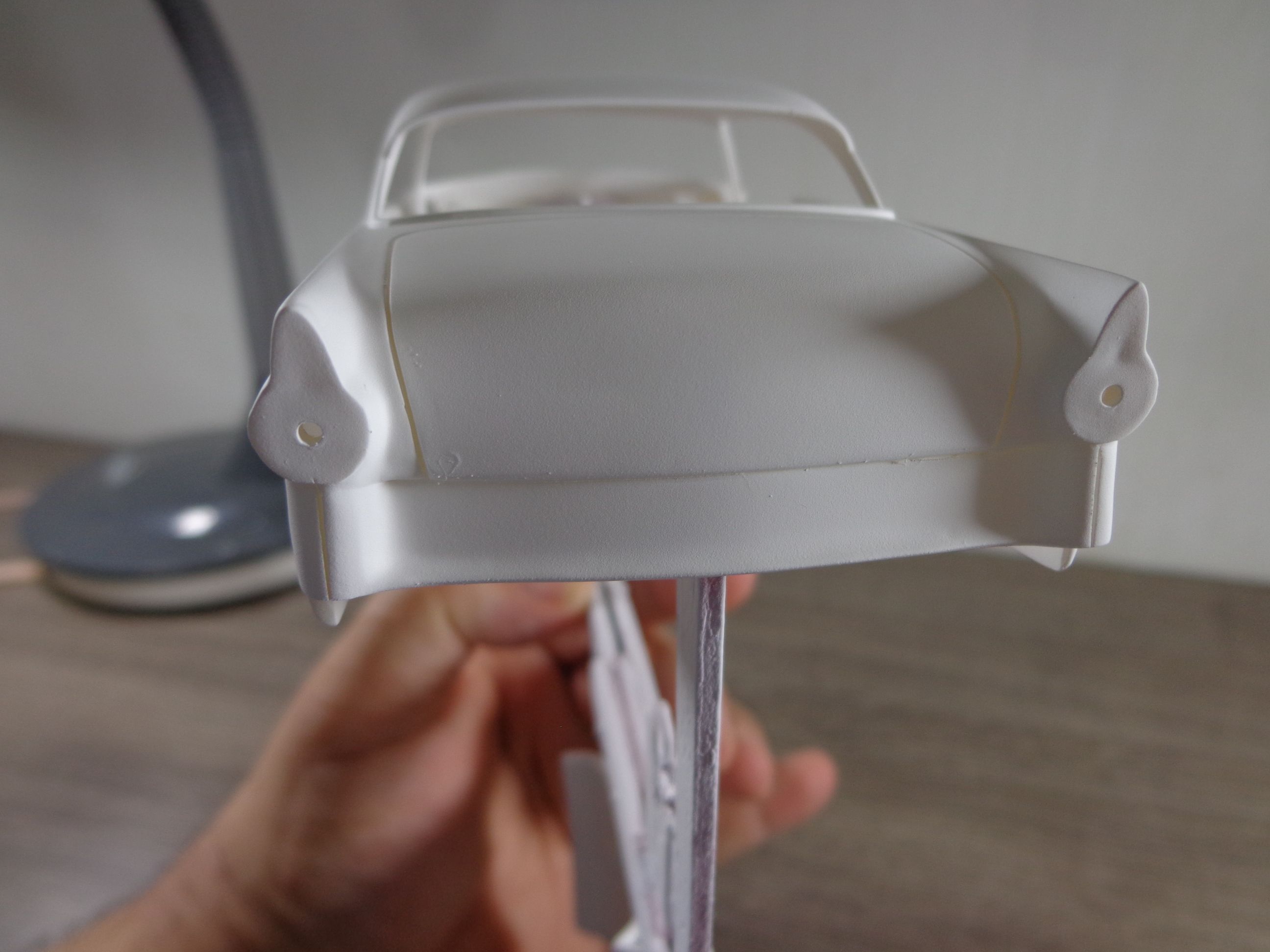

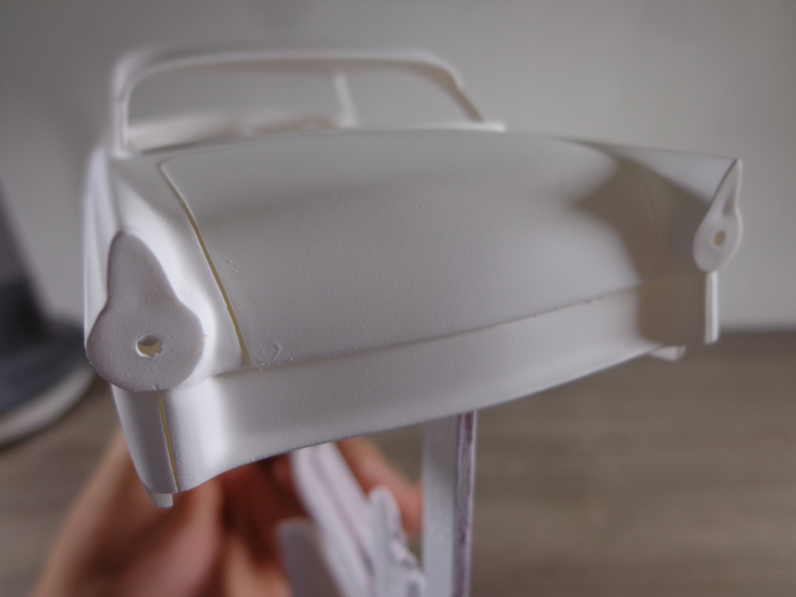

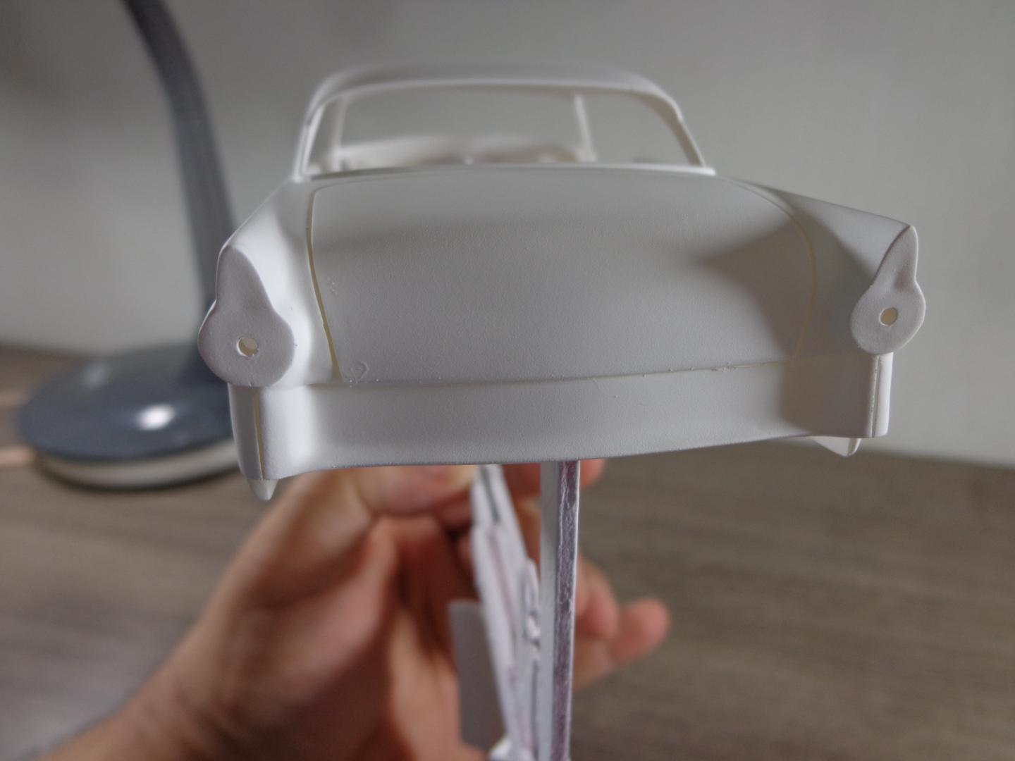

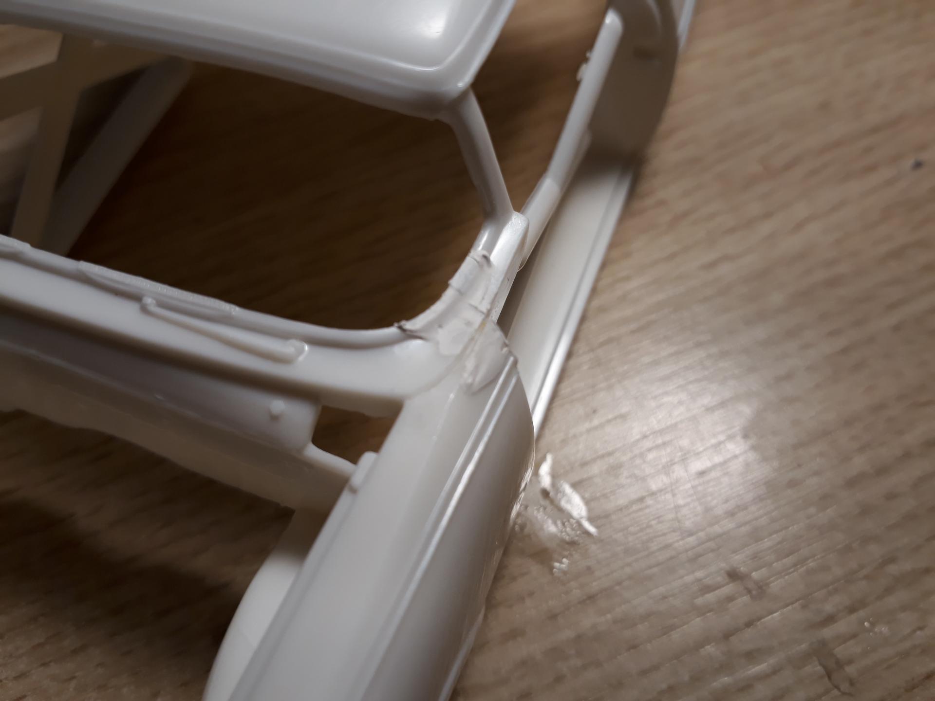

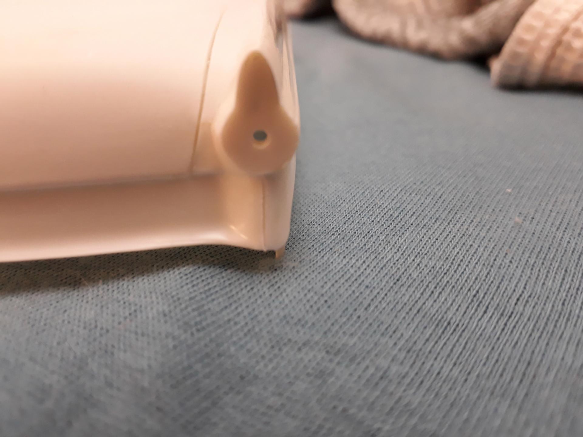

Lovefordgalaxie Posted October 23, 2018 Author Share Posted October 23, 2018 Stating body work on the Fairlane. Started sanding the mold lines, since I built a few of those, I know where to find them. Also deepened the trunk panel line. Added the front fender panel lines, on top of the fenders, separating them from the cowl, and on the bottom, separating the fenders from the rockers. Also, on the back of the car, there are two visible sheet metal joints between the quarters and the rear valance. This line is actually close to a mold line so you have to sand the mold line off, and scribe the body panels separation line. A little putty was needed on heavier mold lines, and on the classic spot on the rear fins, where there are sink marks just above the side trim. Quote Link to comment Share on other sites More sharing options...

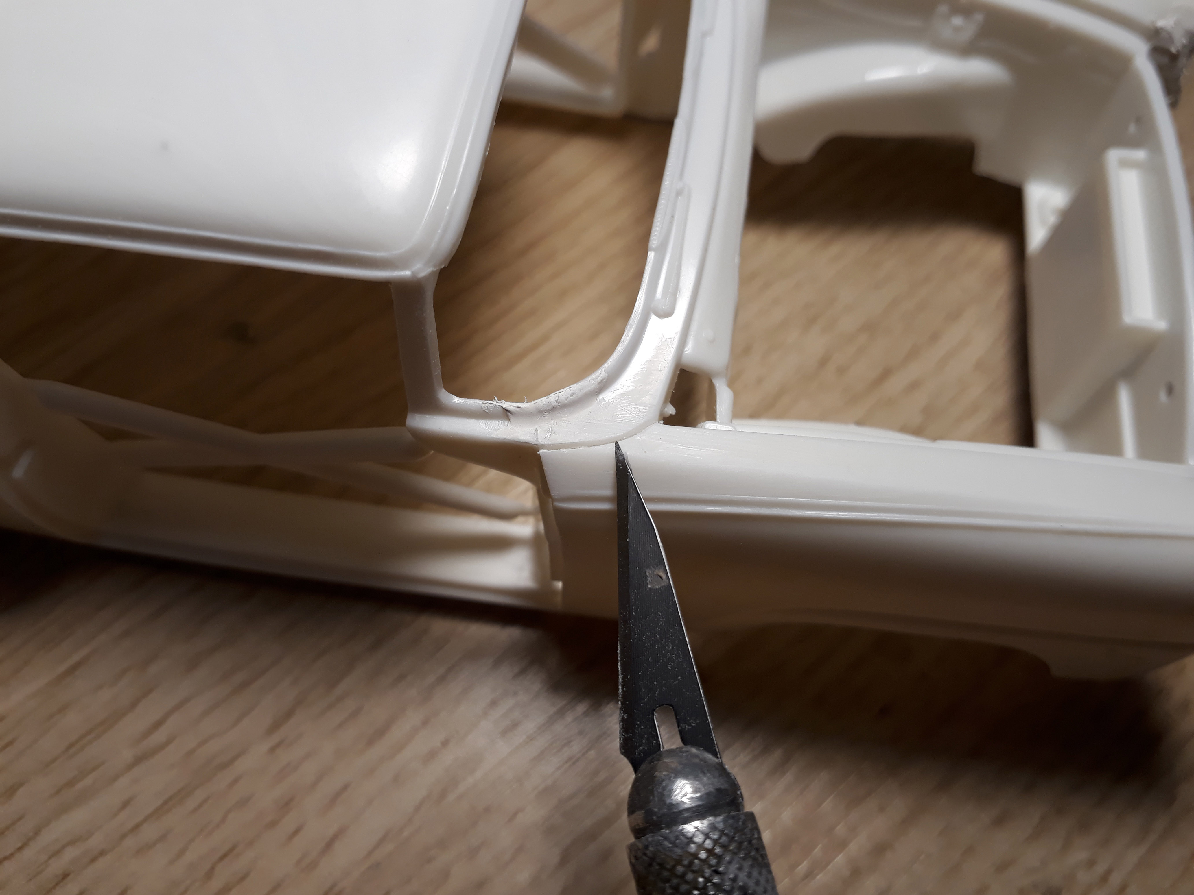

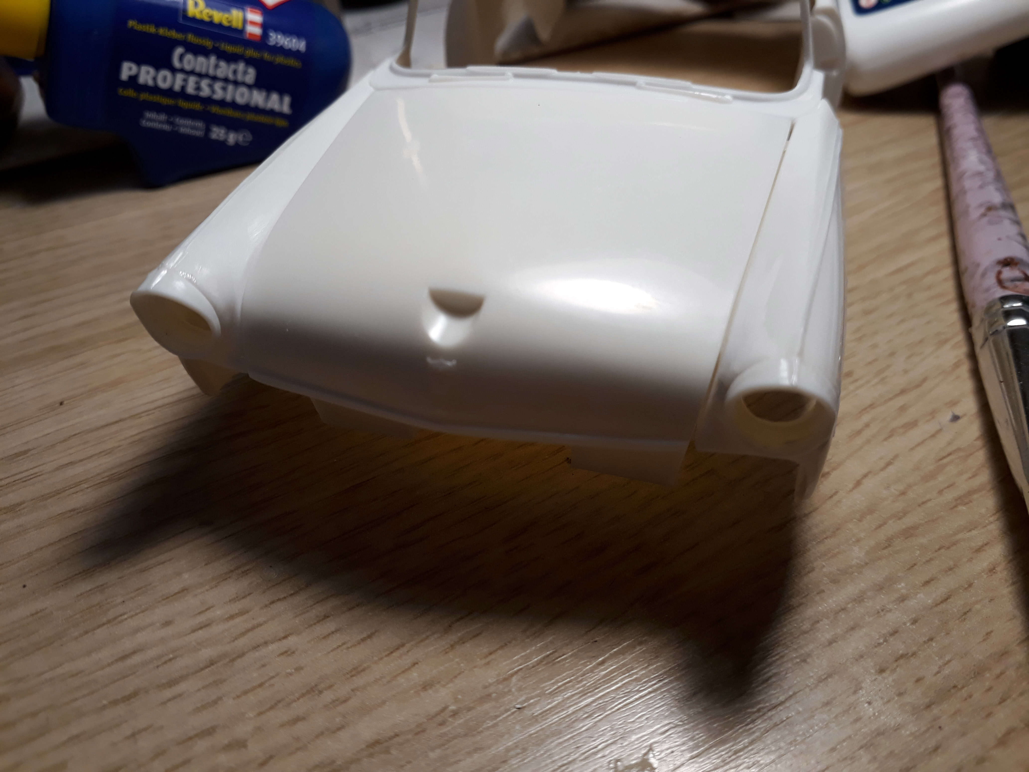

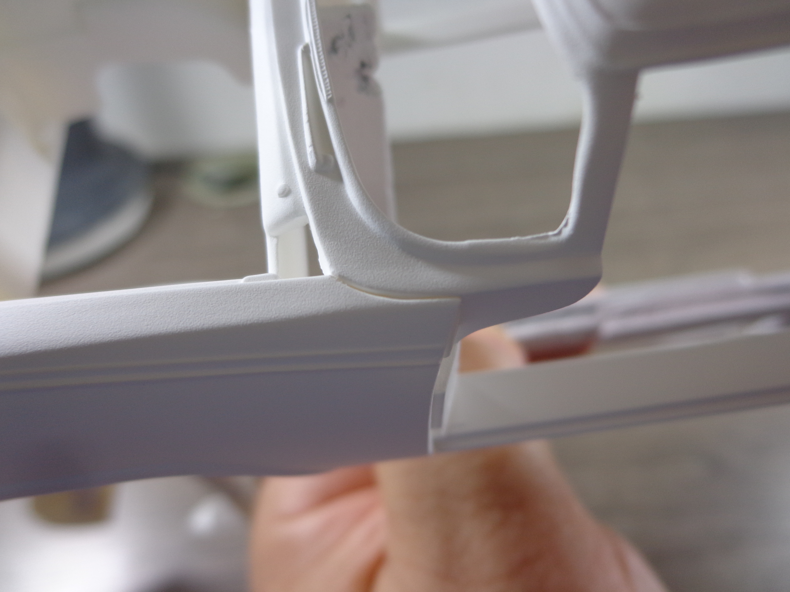

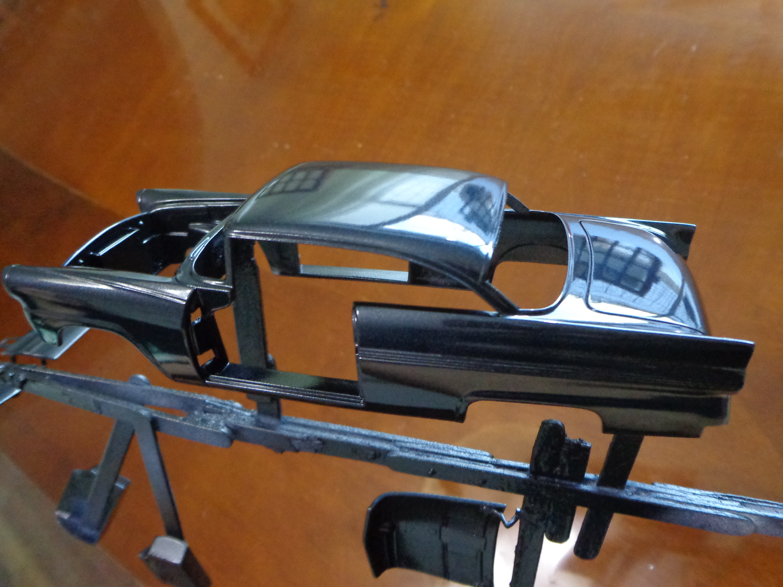

Lovefordgalaxie Posted October 23, 2018 Author Share Posted October 23, 2018 Almost done with the body. I take my time doing this, as it's in my opinion the most important phase of building a kit. No paint job will look good on a body full of mold lines, flash, and small defects. Once in a while something escapes, but I try to avoid it. One of the more fiddly parts of this kit, are the headlight doors, or trim pieces. The area around them on the body have some deep mold lines to help. Since this will be a single tone car, the work is a little bit less complicated. I glues the headlight doors in place on the body, and will have to use some putty to make them to conform with the fenders. After that, I'll have to re scribe the separation line between the headlight doors and fenders. Did the same thing on the other '56 Fords I built, and also on the '57 Thunderbird. Quote Link to comment Share on other sites More sharing options...

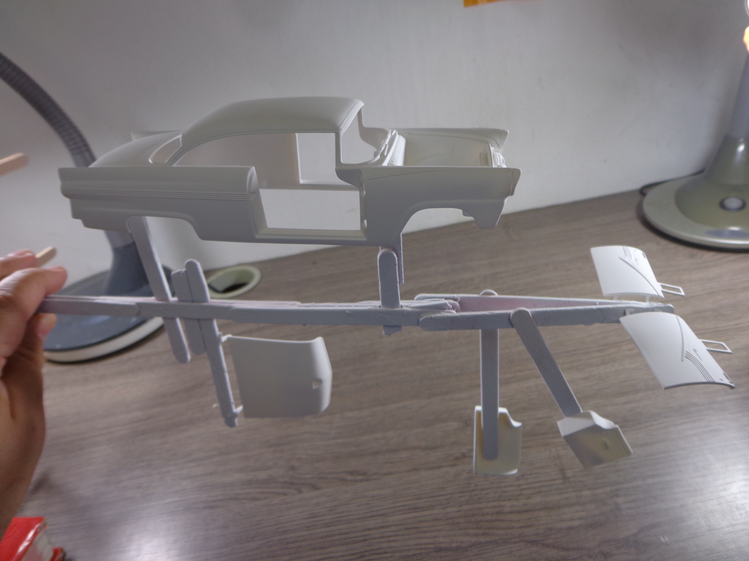

Lovefordgalaxie Posted October 26, 2018 Author Share Posted October 26, 2018 Body all in primer. Next step is foiling the emblems, and Paint!!! Have to have a sunny day to paint. Tamiya spray paint is not much fond of humidity. Quote Link to comment Share on other sites More sharing options...

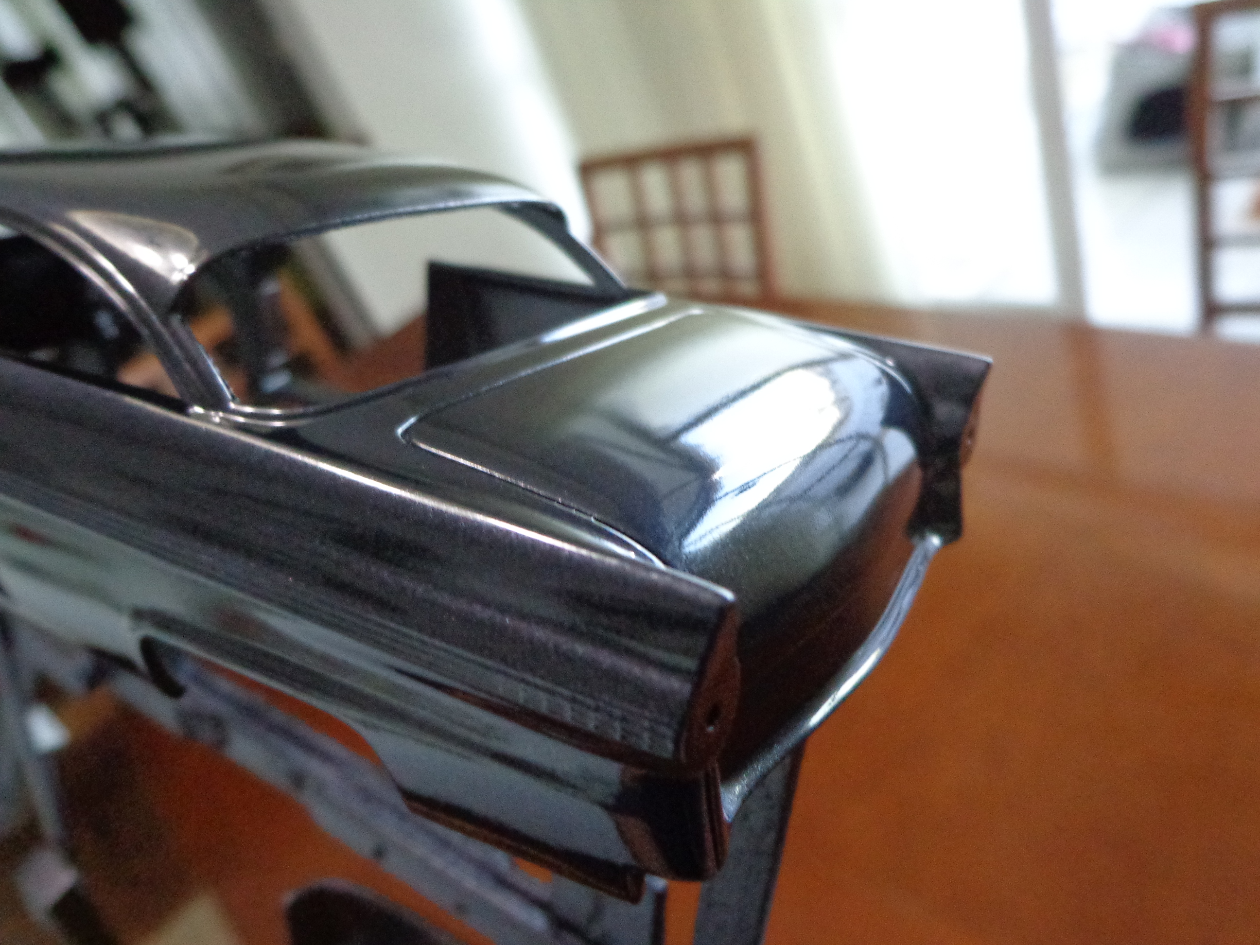

Lovefordgalaxie Posted October 27, 2018 Author Share Posted October 27, 2018 Body is in color. Painted with the Tamiya spray can. I'm on the fence about using clear. Think the shine is quite enough. Even when I'm building a non stock, it looks like I end choosing colors next to stock. The Tamiya TS-64 could pass as Nocturne Blue Poly. A factory color for 1956... Quote Link to comment Share on other sites More sharing options...

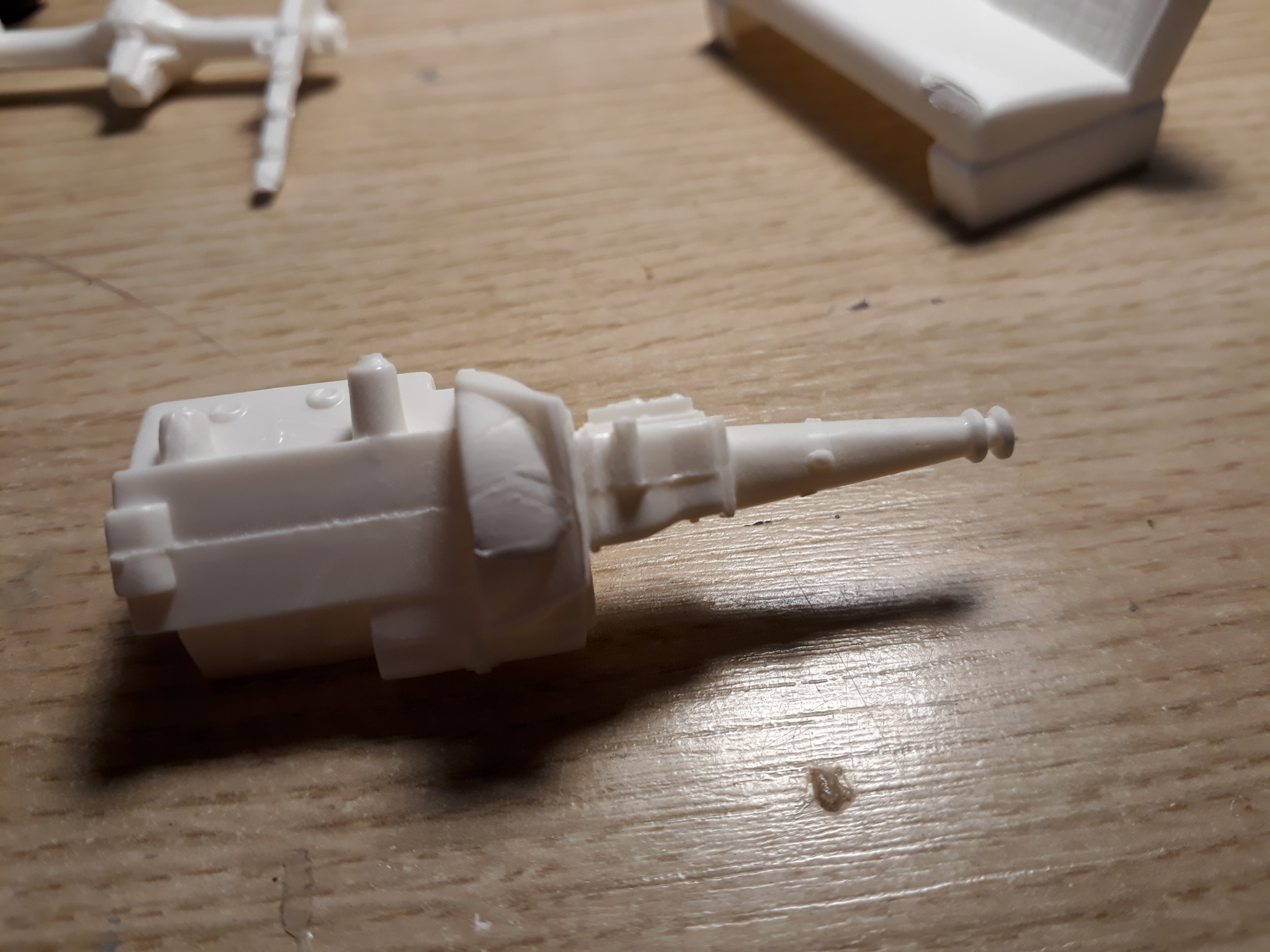

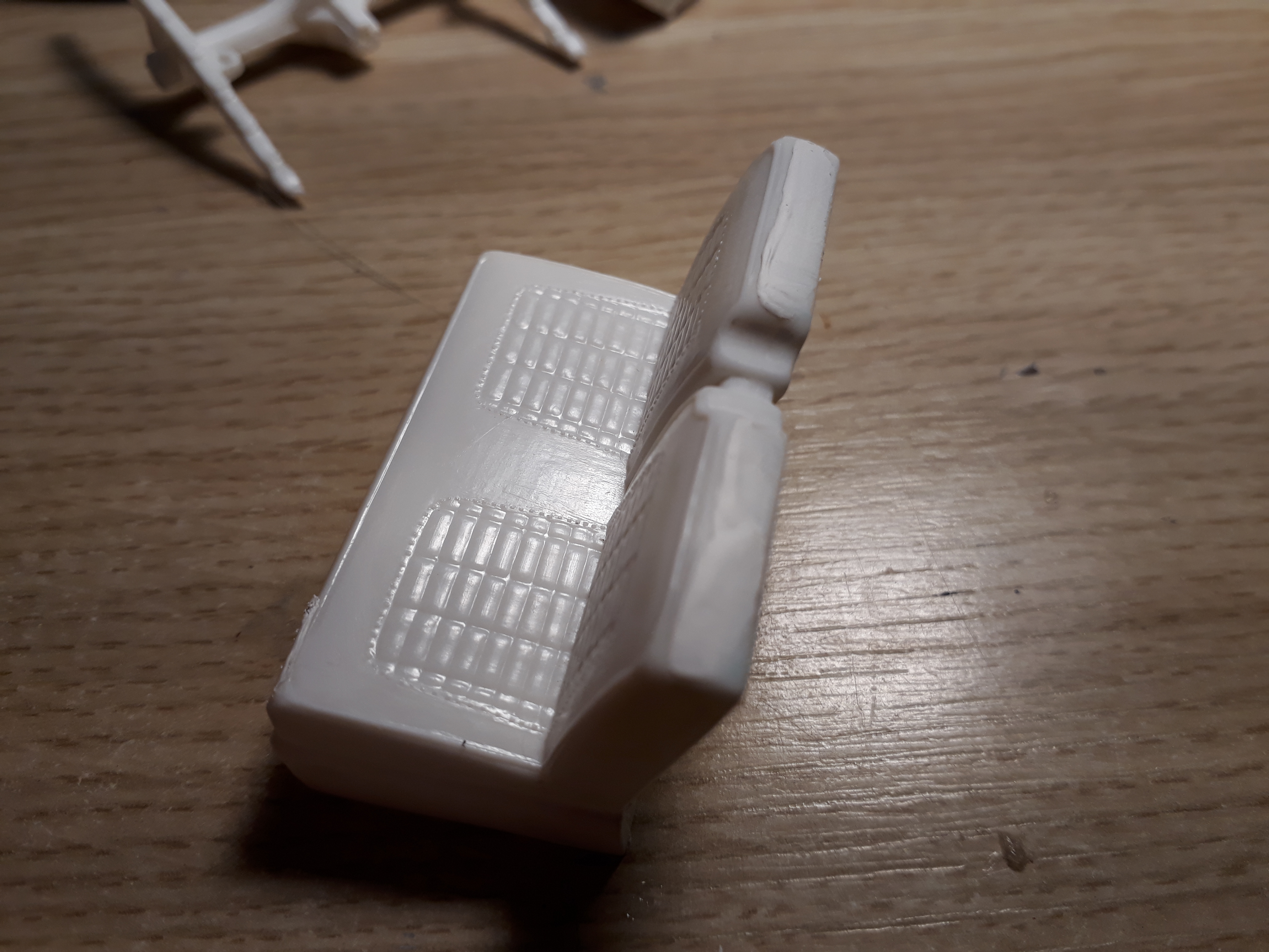

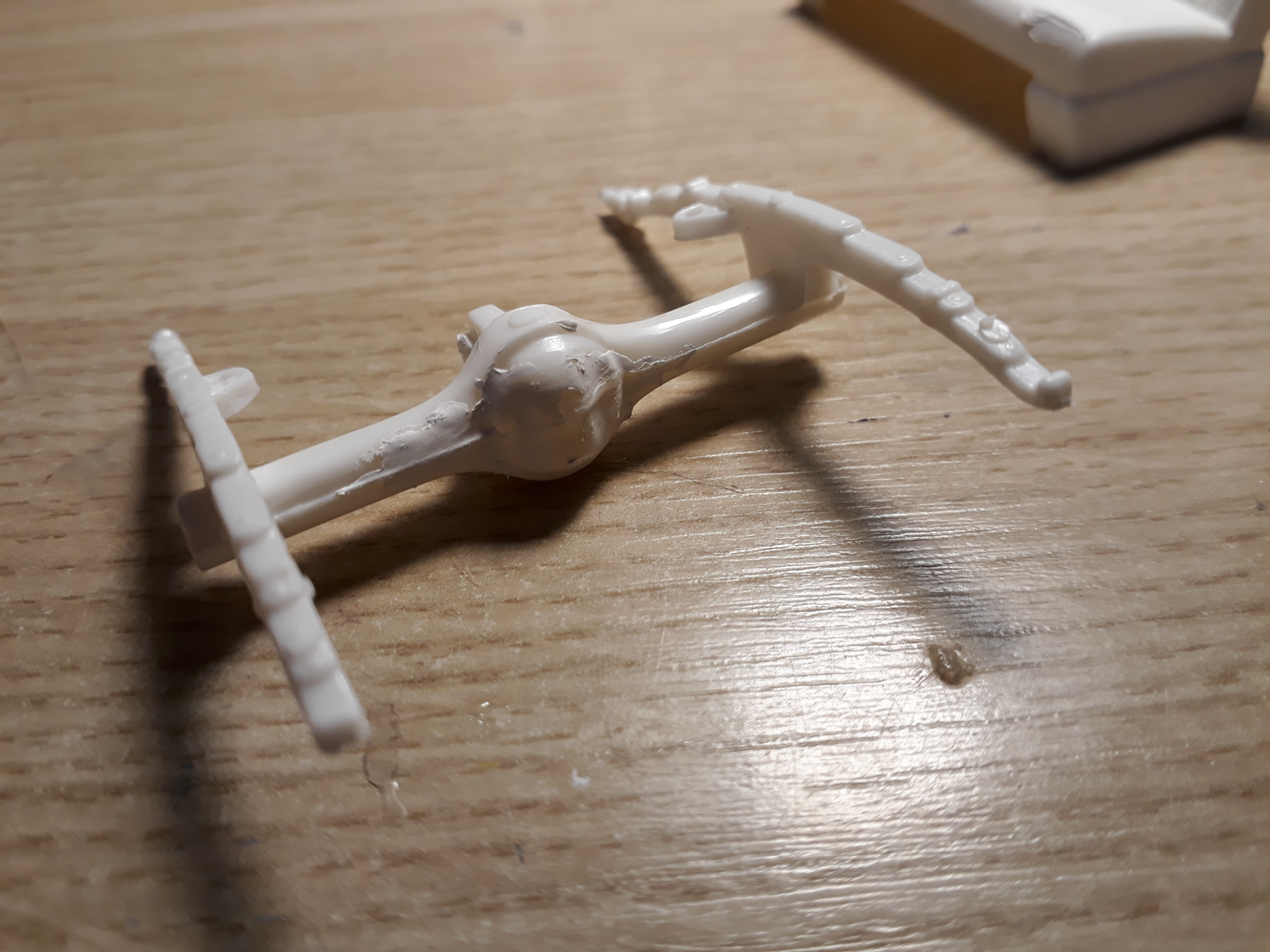

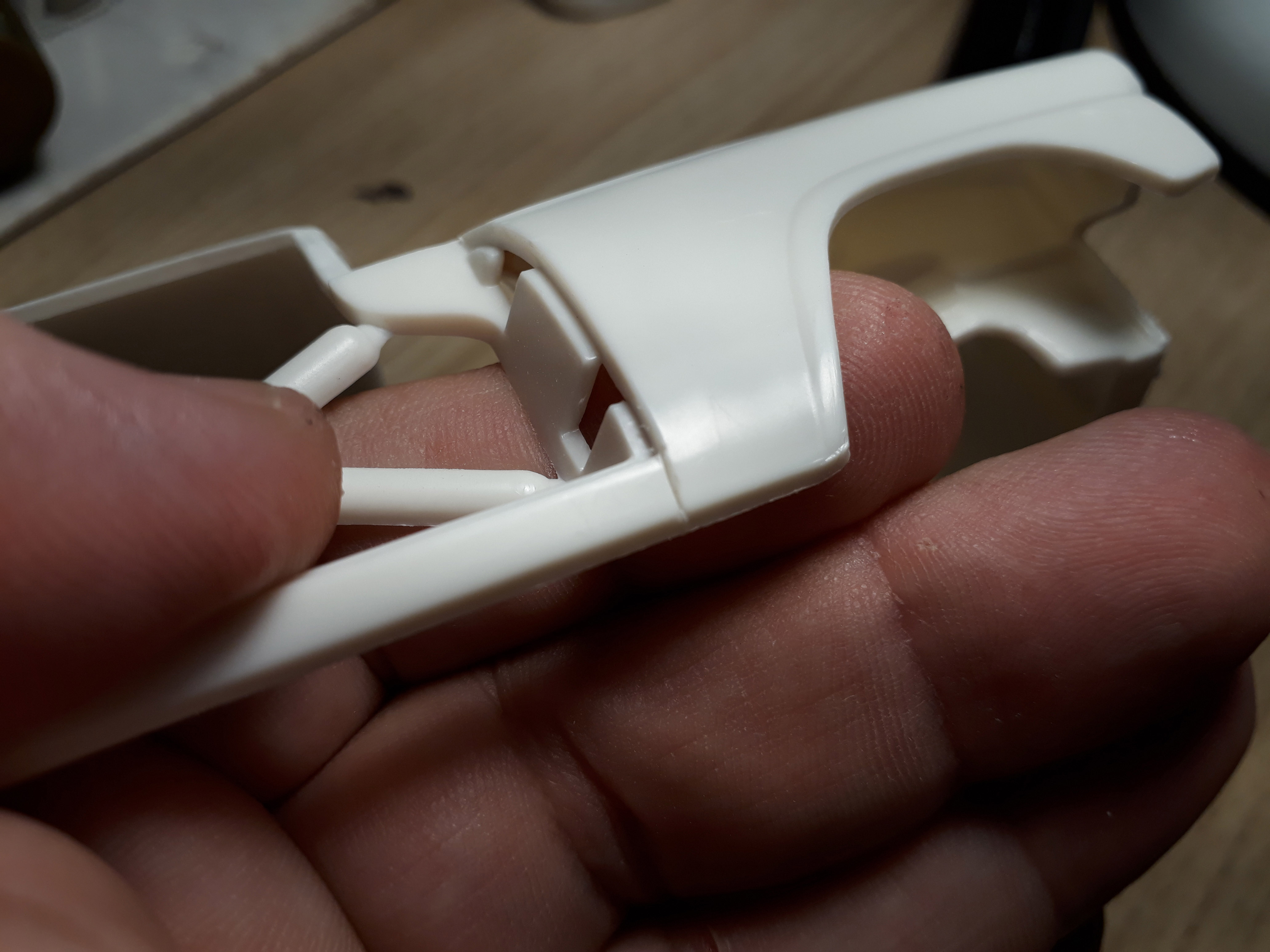

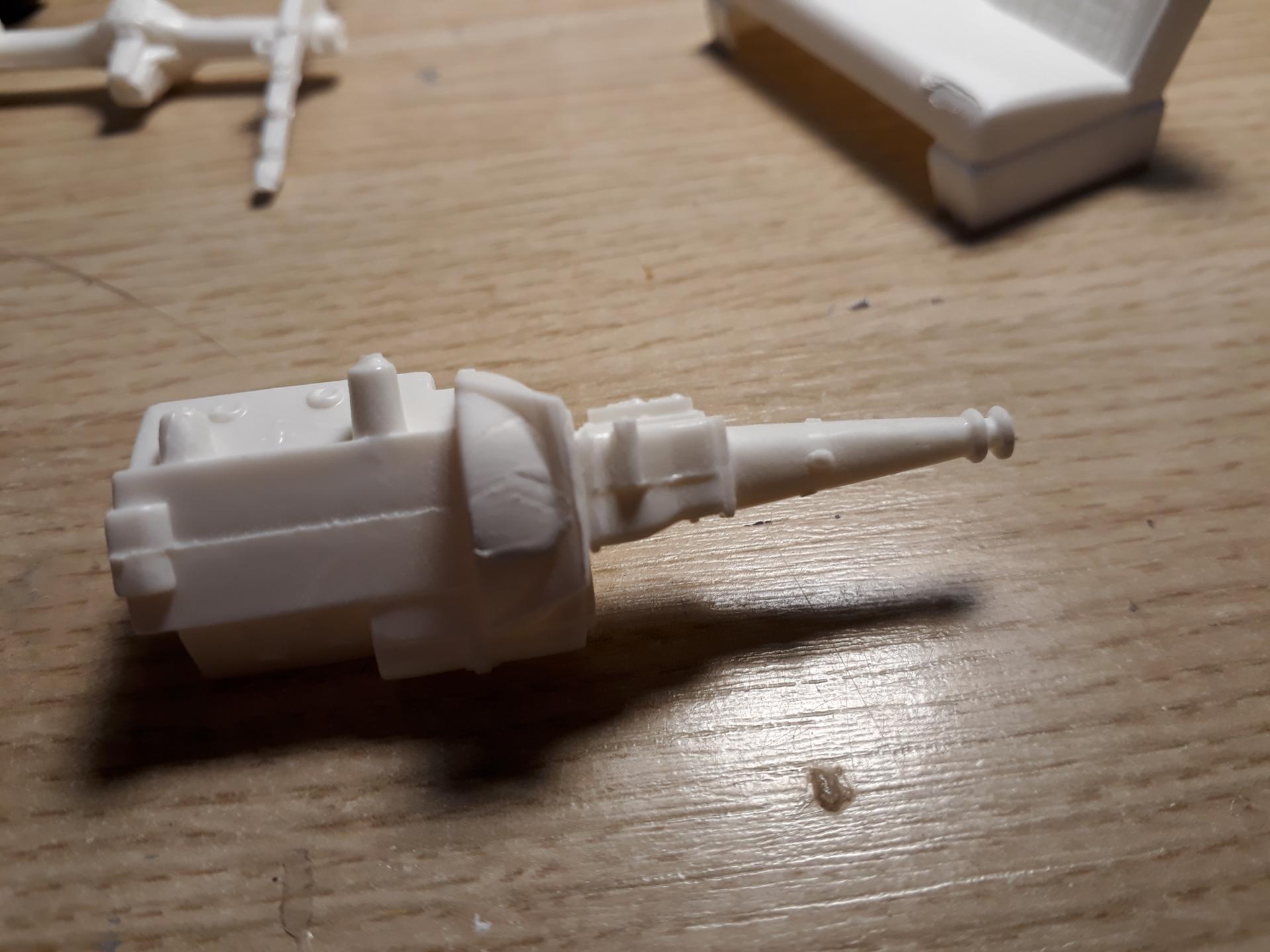

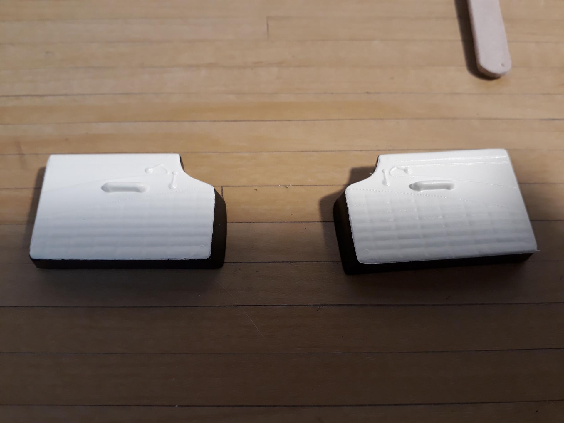

Lovefordgalaxie Posted November 9, 2018 Author Share Posted November 9, 2018 After a couple of weeks off, I resumed work on the '56 Ford Fairlane. The rear end was assembled, and some putty needed to smooth things up. The engine halves were glued together, and again some putty was necessary. The glue line on the transmission casing will stay, as the real transmission had a casting part line right there. The front seat needed a second putty application, as the sides were kind of hard to make smooth. Quote Link to comment Share on other sites More sharing options...

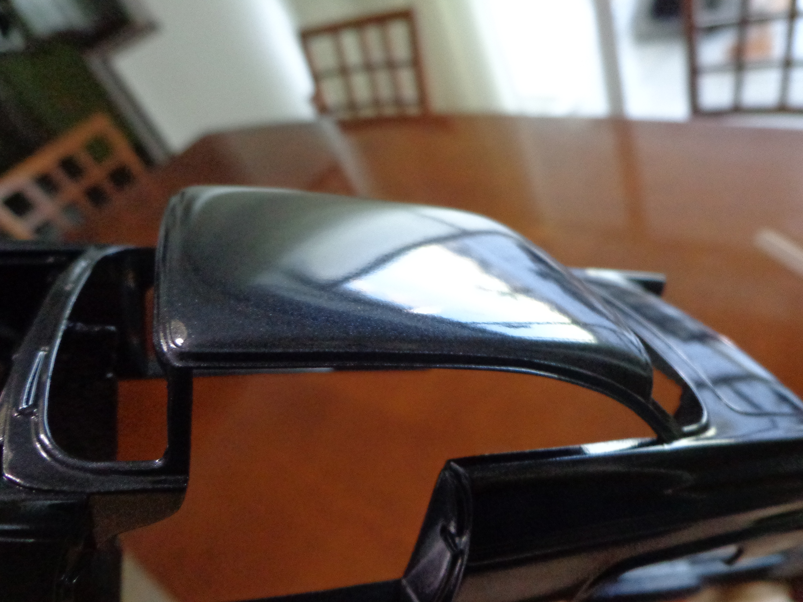

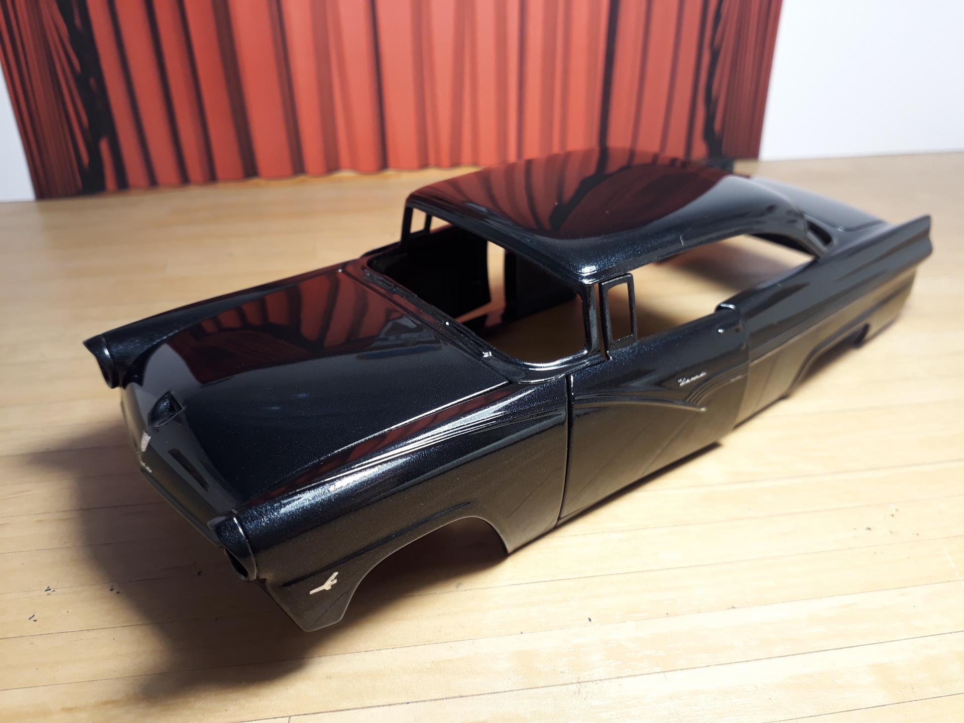

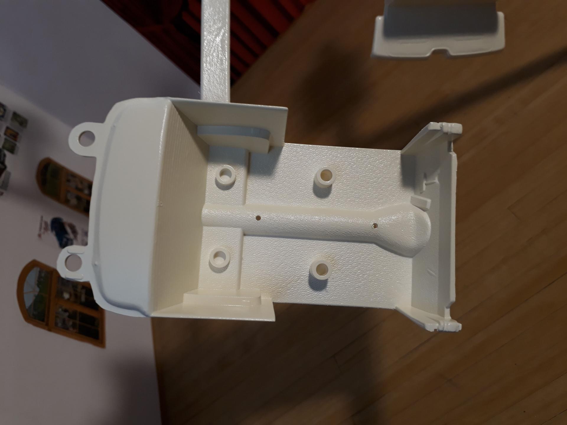

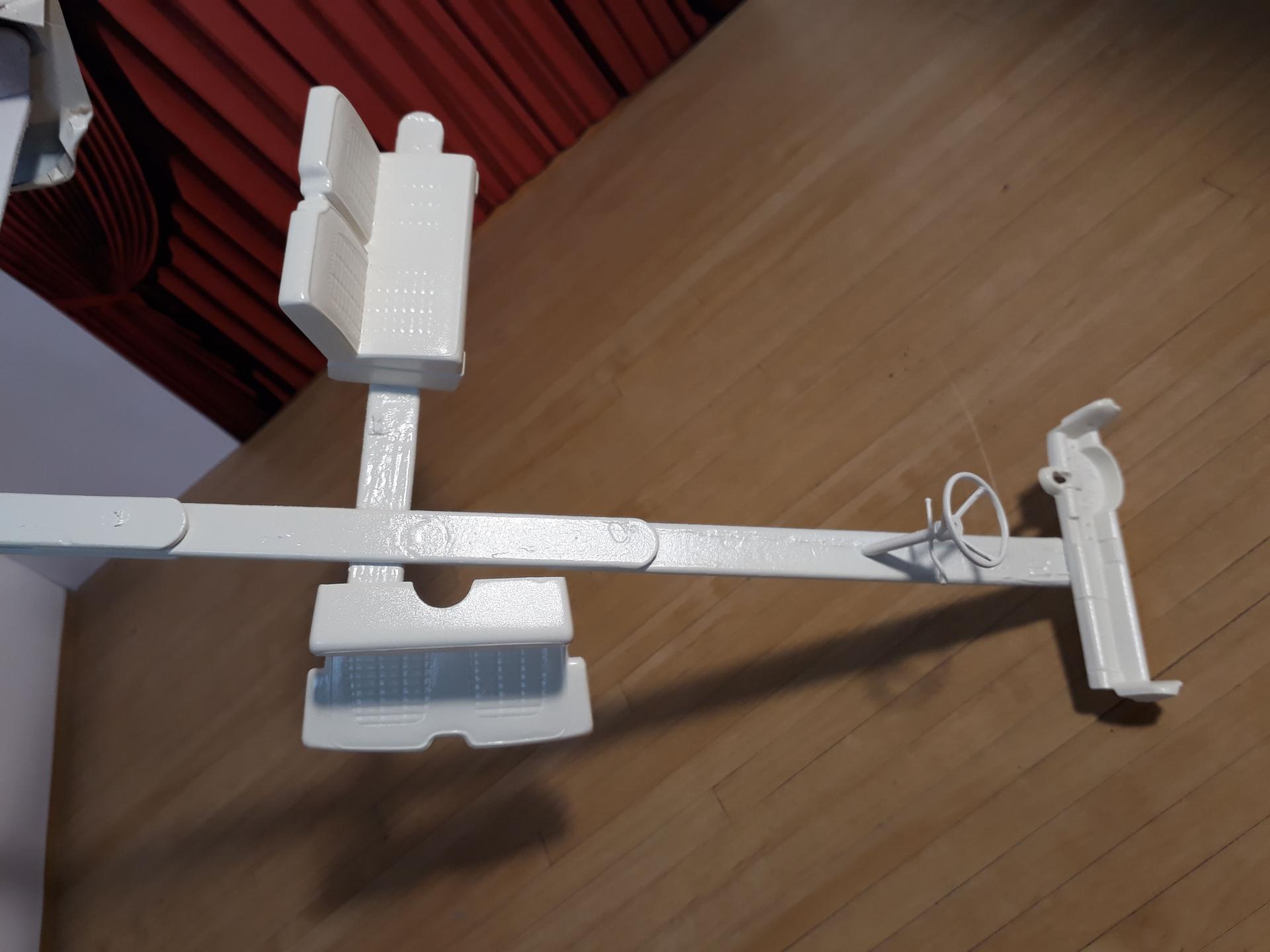

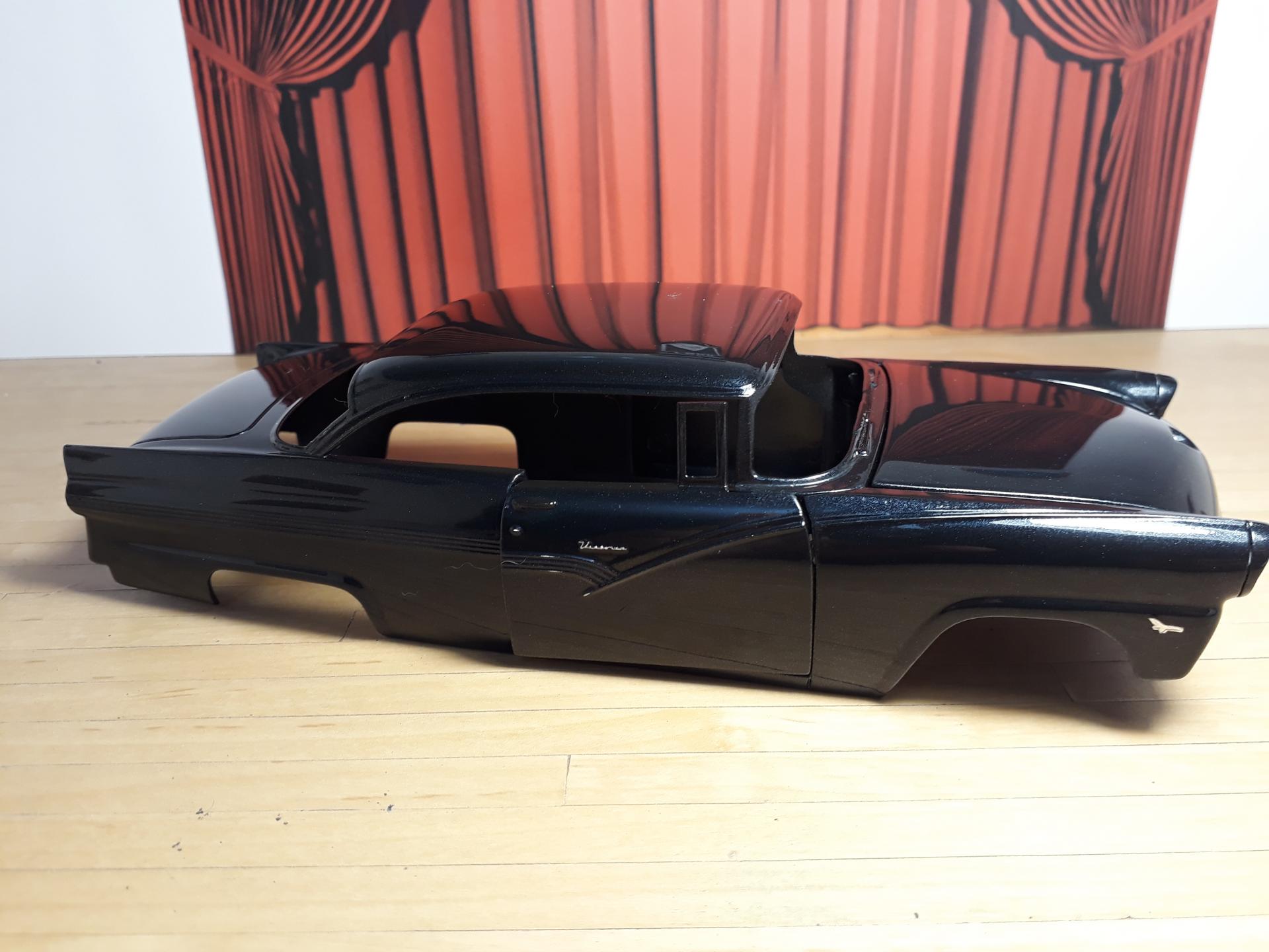

Lovefordgalaxie Posted November 23, 2018 Author Share Posted November 23, 2018 Ok gentlemen, I'm baack!! Hadn't much time to work on this car, but did some more progress. Decided to give the body a coat of clear. Used Sherwin Williams 2 part clear, and also gave it a polish after dry. After dealing with the body, I finished the seam treatment on parts composed of two components, like the rear and, engine and front seat. Gave the interior, a coat of white, that will be the basic color. Will wait for it to dry, and mask to paint the black bits. Also finished the making of a custom pressure boot for the dual four barrel carburetors, and will be using the supercharger from the AMT '57 Ford. Also, found a great set of Cragar wheels on my 1950 Ford convertible kit, and will be using them, along with a set of Firetone Wide Ovals. Quote Link to comment Share on other sites More sharing options...
