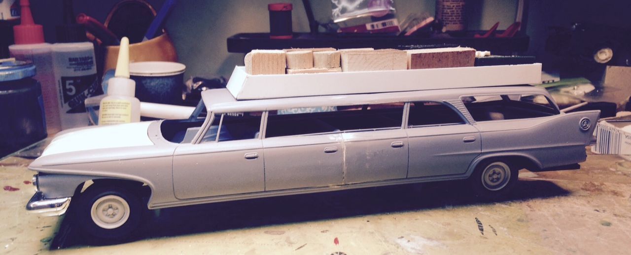

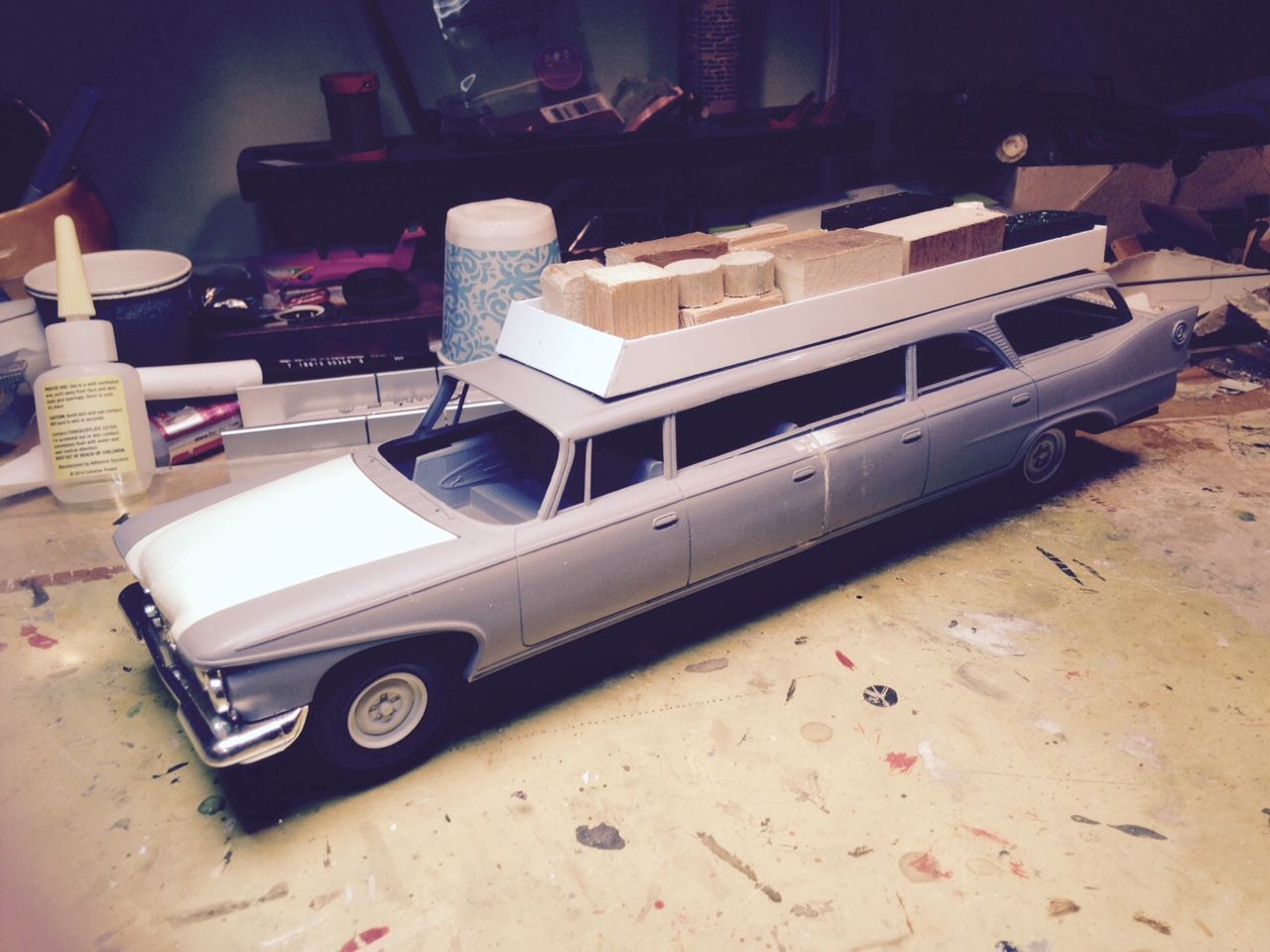

Okay! As I work my way through my ancient projects, I am entering the 1960 Plymouth Airport Limo. My Fotki build album was started almost 19 years ago, so I’m sure it qualifies!
It’s been on the bench a few times over the years, but I’d like to see it done!  Hey, if I can get through that Studebaker, I can do anything! ?
Looks like an interesting build Tom.

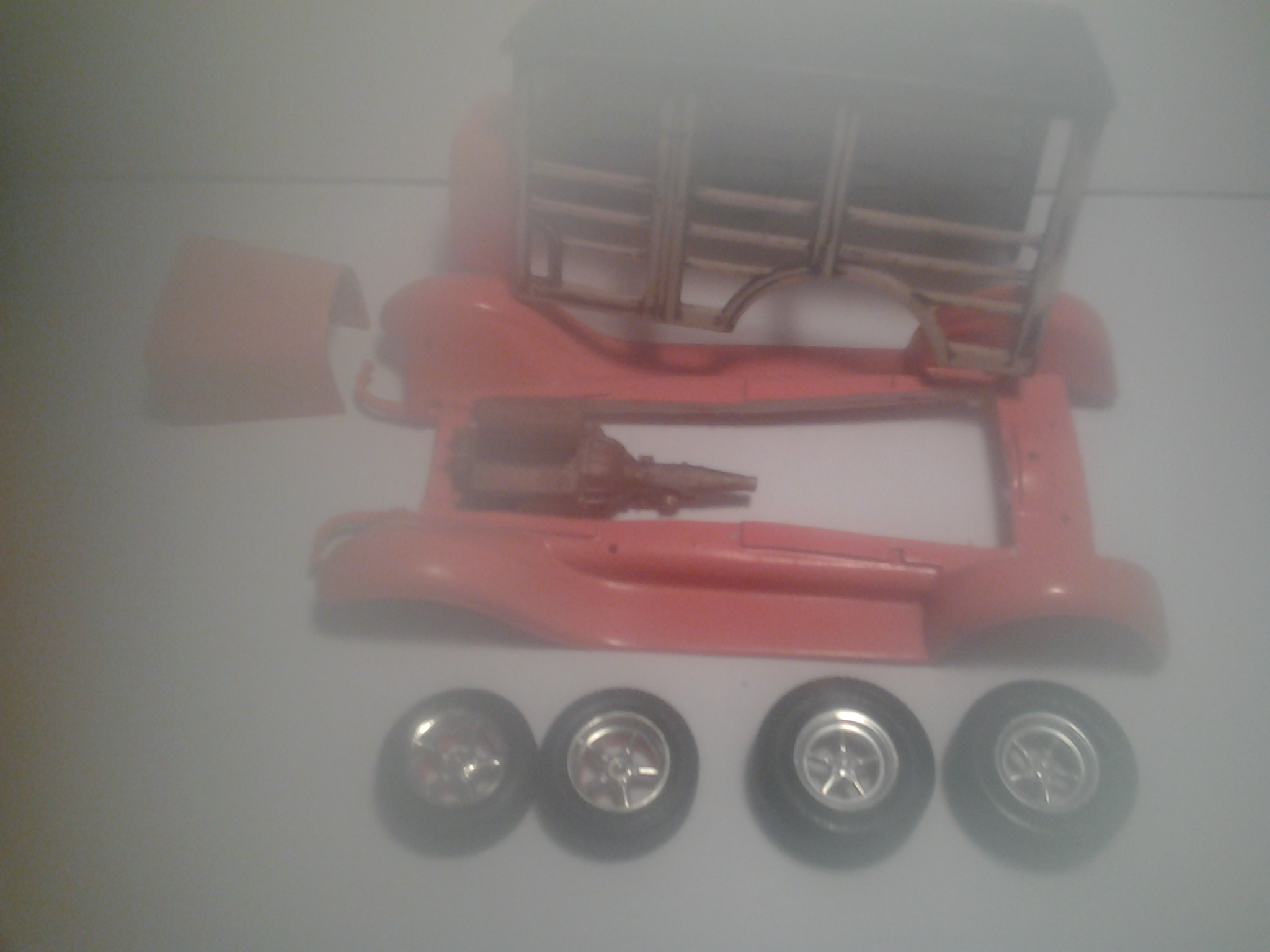

Sorry for the bad picture but I wanted to make my entry official.
Its a Mpc 1929 woodie. Smoothed running boards, chopped top, buttera ford engine. Started years ago. Time to finish.

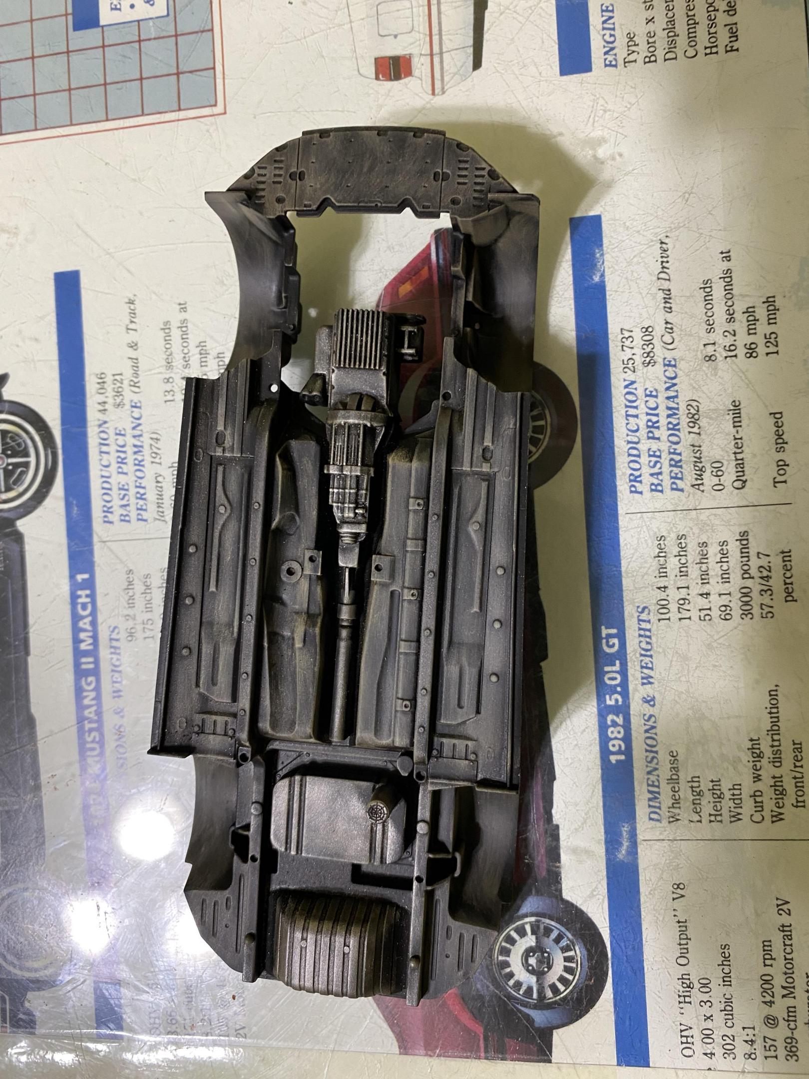

Dave, that's one of the nicest chassis weathering jobs I've ever seen! Respect! Now, don't forget to weather your tire treads to match. B)

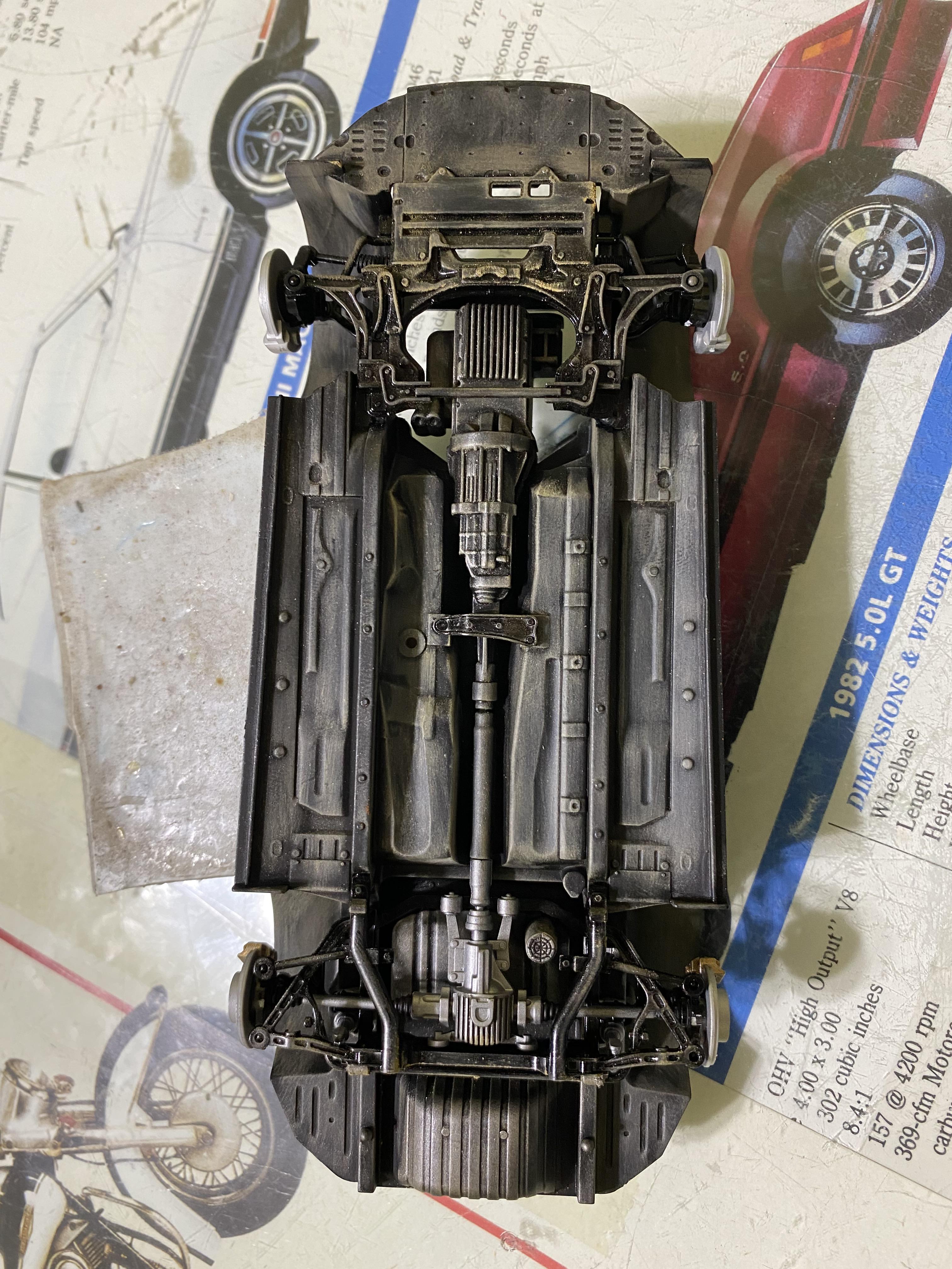

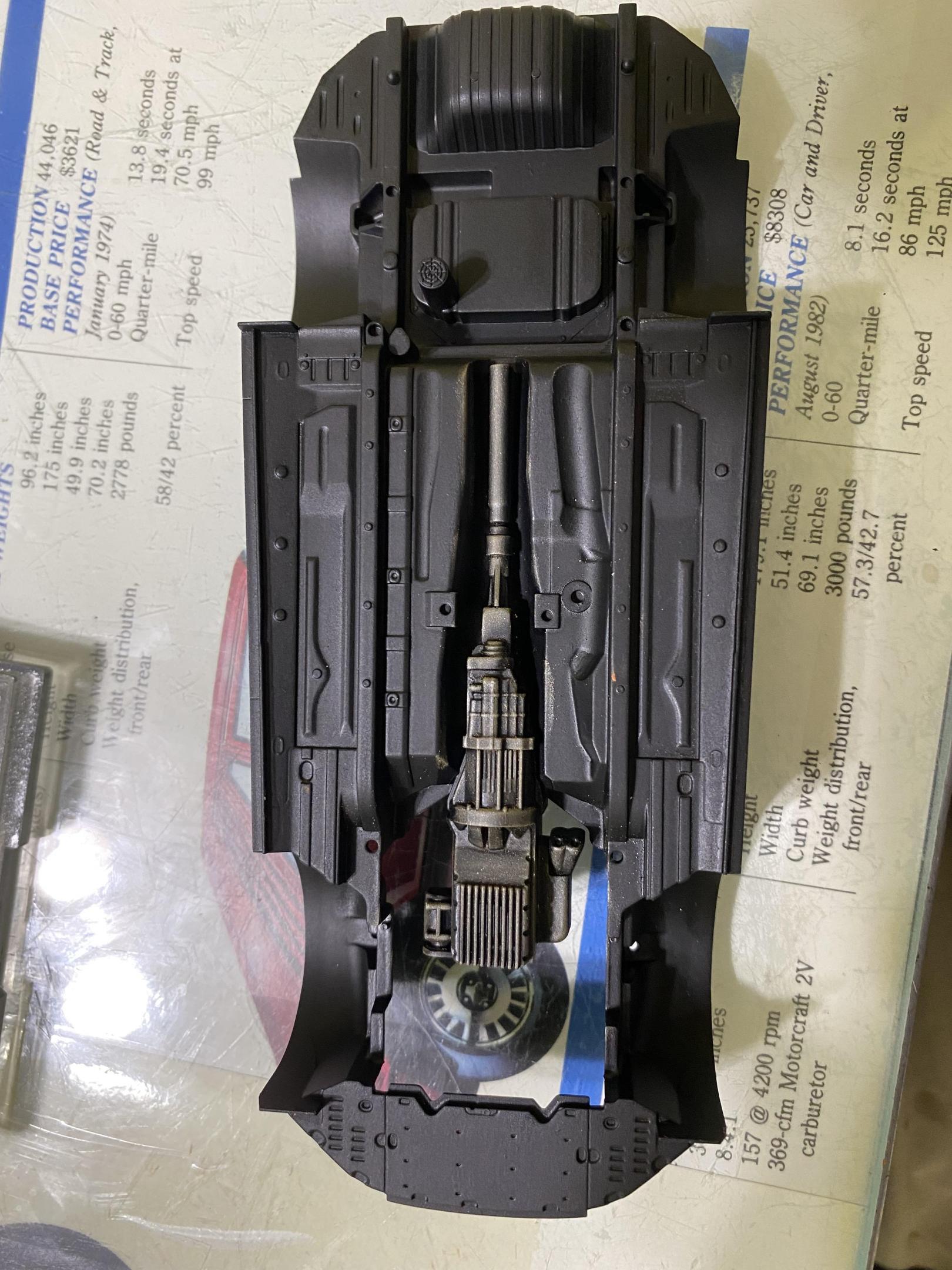

Built the chassis for the Honda S2000 this weekend. I use the Tamiya Weathering kits.

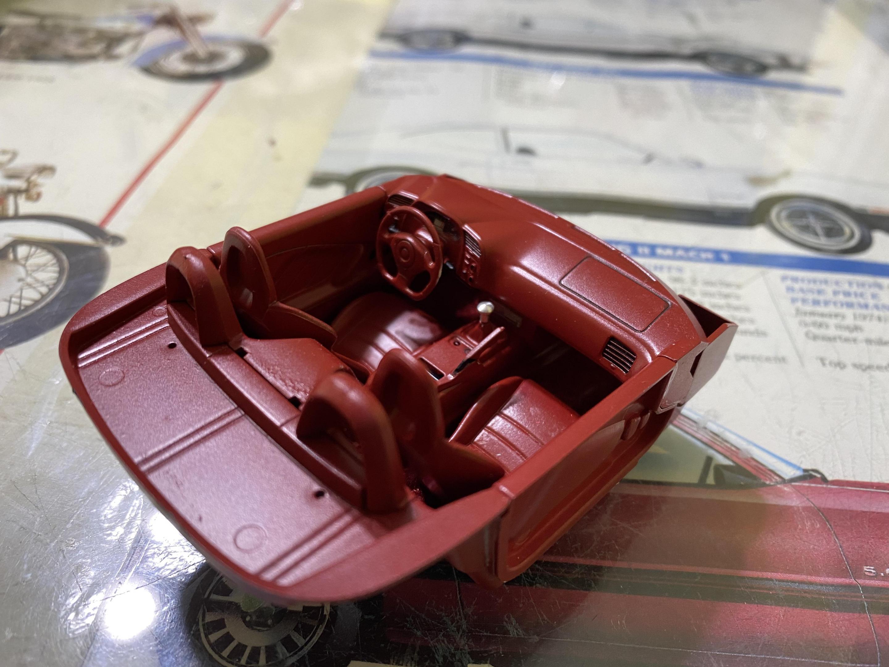

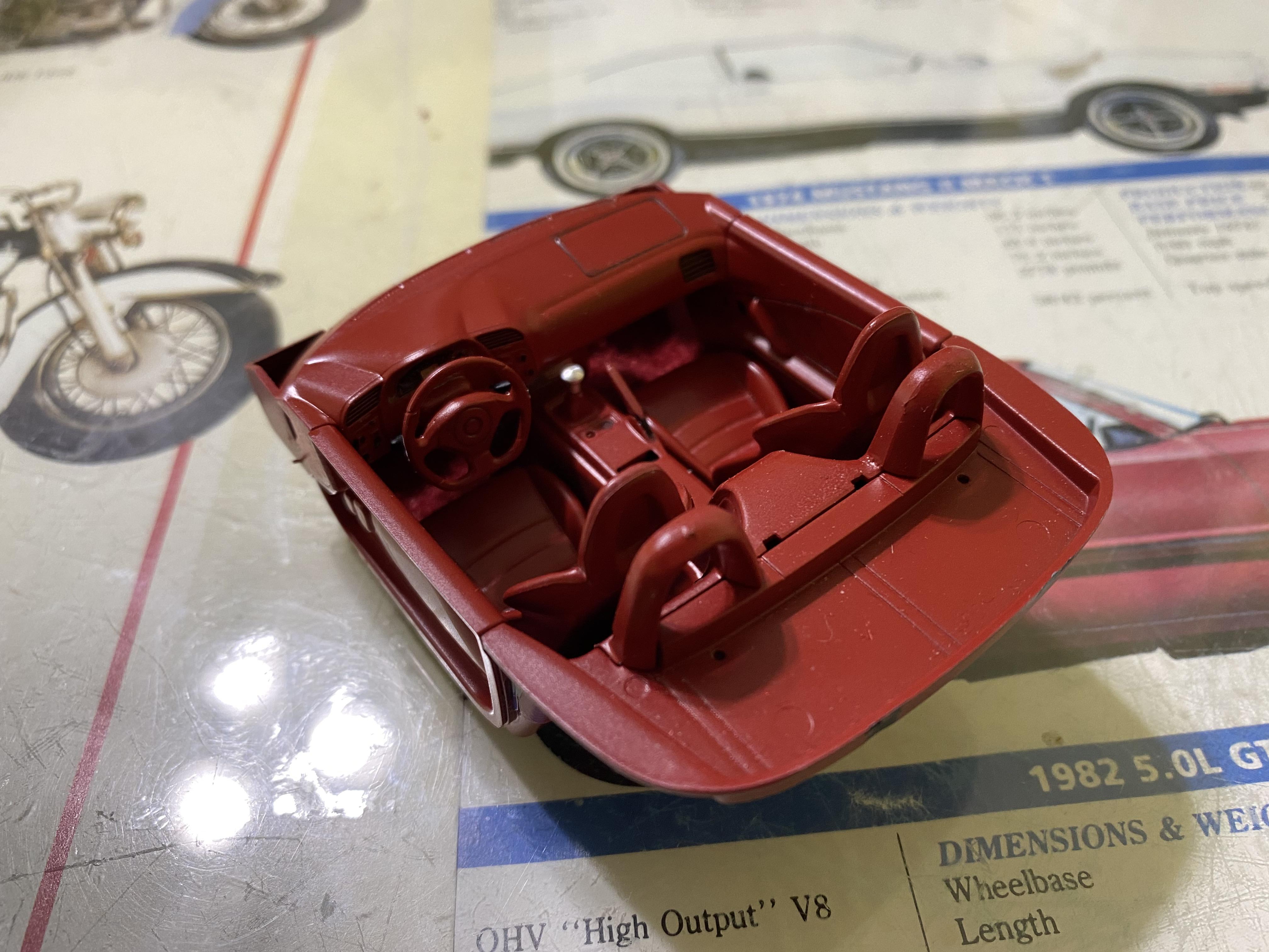

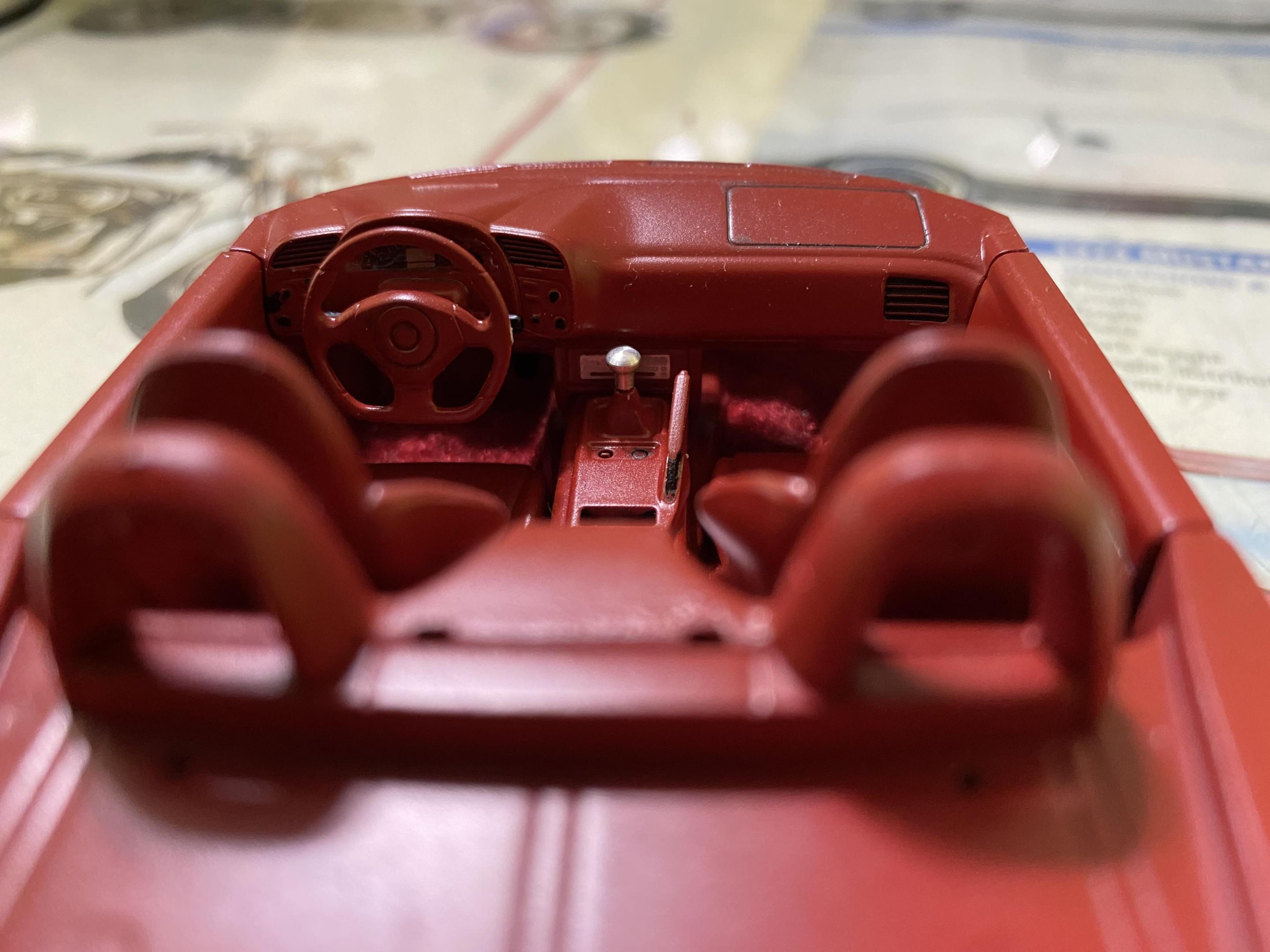

Alright finally got the interior finished. used Detail Master photo etch stero plate, and aluminum gear shifter  here is some pics

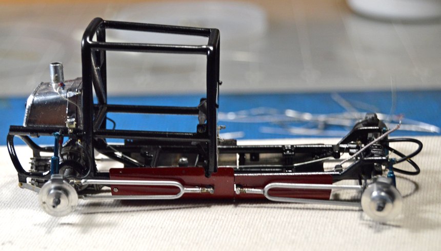

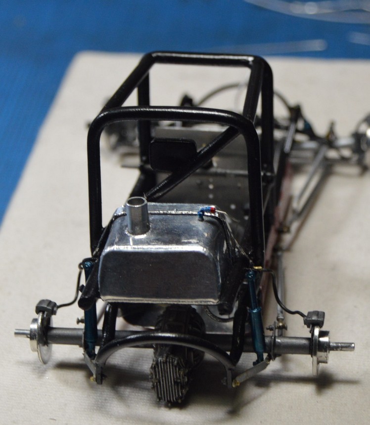

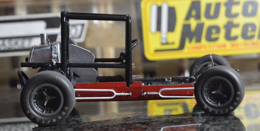

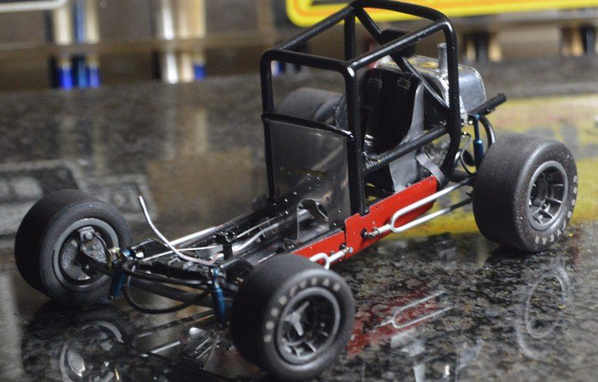

Fuel Lines are run. Throttle linkage is sorted out. Firewall is installed--it wasn't completely in its final location, yet, when I took the photos. I'm about to get started on the engine, after a couple of more little items...

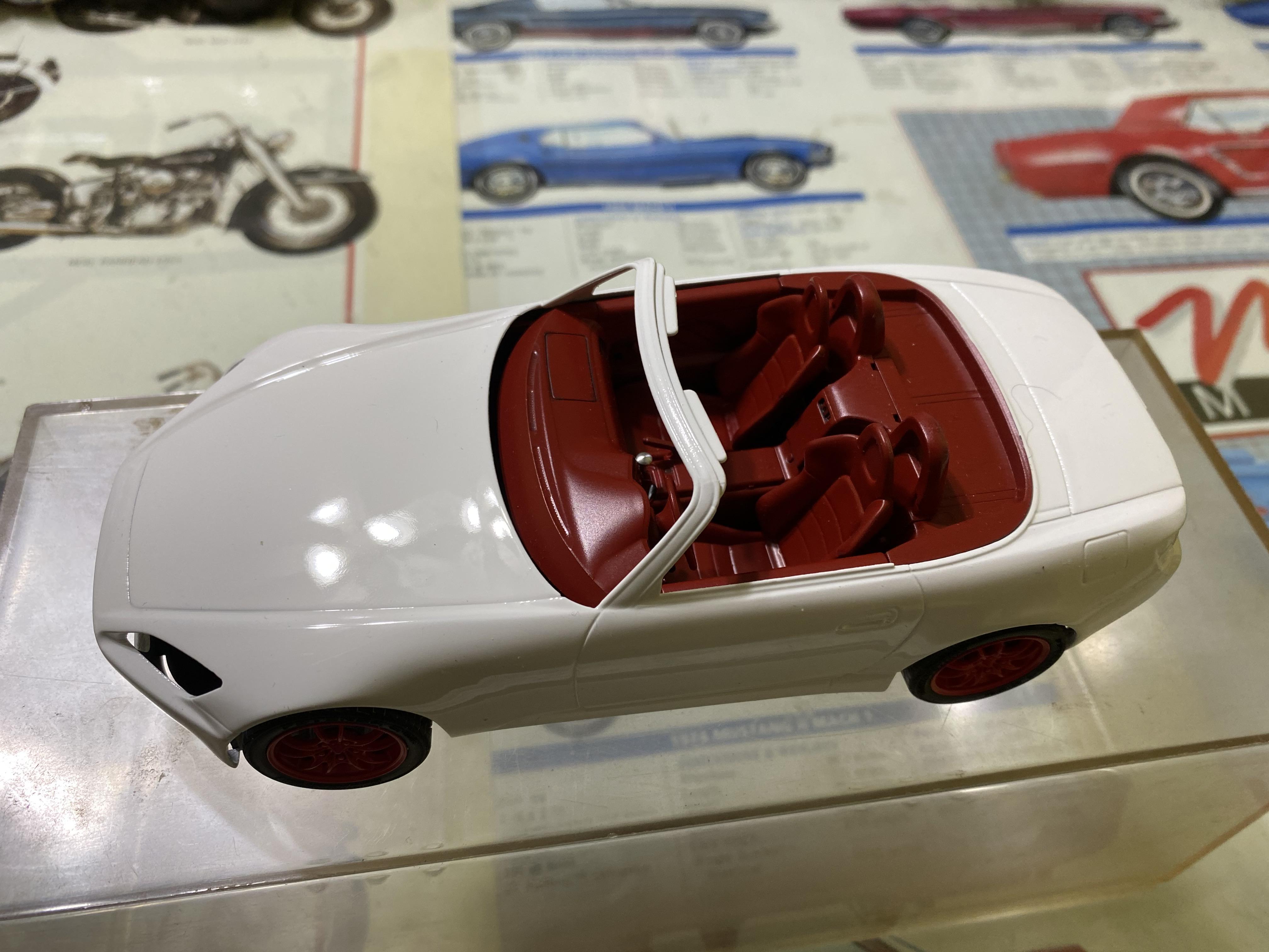

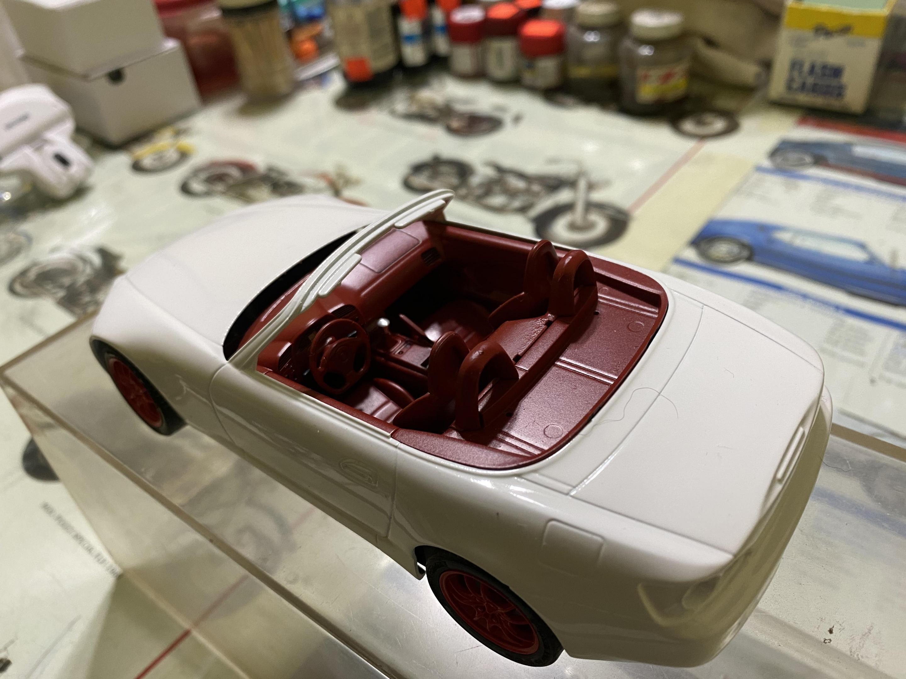

well I got some paint on the Honda here is some pics.  Hopefully will finish this weekend. Already have my next build ready to go.

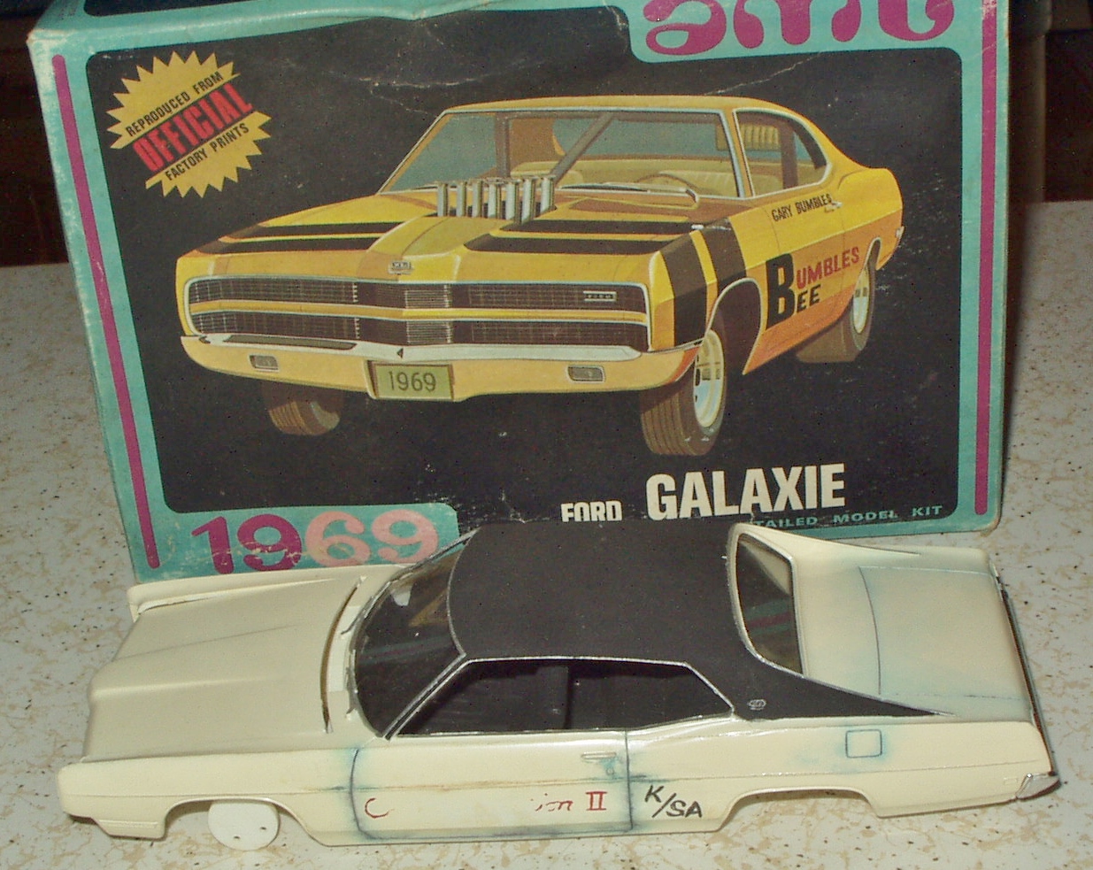

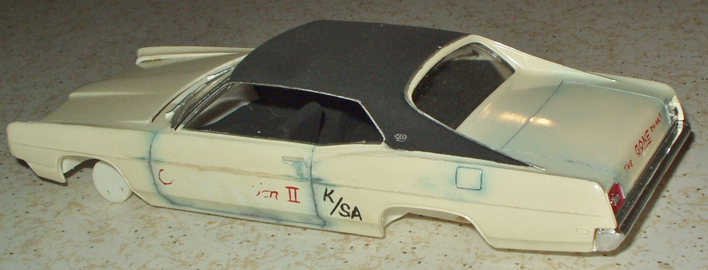

Okay, I finally decided on a project for this round: The original annual AMT '69 Ford Galaxie I started in 1969 (52 years ago, probably this round's record).
I'd have never bought this kit, but I won it as part of a case of 12 AMT kits in a national magazine contest. Inspired by the badass box art, I thought I'd build it as a lower Stock class drag racer. Painted it white with a black vinyl top, did some hand-lettering, apparently had second thoughts about the whole idea, and put it back in the box. Until now.
I was greeted by a much bigger mess than I remembered/expected. Evidently I'd named it some word or phrase that started with a C or O and ended with -ion, and then tried to polish that off (probably, in those days, with toothpaste). Looks like I ran the numbers and discovered it would run in K/Stock Automatic. Also, I'd run black ink into the left door and trunk lines, and then changed my mind and tried to wipe it off. That apparently didn't work too well—there was dark blue-black staining all around these lines.
At this point (yesterday) I decided that the first step would be to see if I could get the ink-staining off, and then the lettering (I'll just be building it factory stock); if I couldn't make that happen, it would go back in the box, as a strip-and-repaint would kind of violate the spirit of BOYD in my eyes. I couldn't use alcohol for cleanup, because I'm pretty sure the white paint is AMT lacquer, which alcohol could ruin, so tried Windex. This took off about 90-95% of the ink staining but of course on white, that's not nearly good enough. So I tried polishing the stained areas with Wright's Silver Cream silver polish, and this seems to have taken 99.7% of it off; you can still see it if you know it's there and are looking for it, but, “Good enough for BOYD.” If you haven't already guessed, this will not be a Grade A build; I'll be treating it like a “rescue” of one of my toy-show-find glue bombs.
The ink cleaned up, I polished off the hand lettering (no doubt Testor enamel) with the Wright's. This went better than I expected, and I managed to pull it off without “burning through” the old white lacquer. It seems to be pretty tough stuff, and shines up nicely with polish!
So that's where I am right now; this is my starting point. I painted the interior black in 1969 but might get seized by a Fit of Industry and repaint it blue, green, or tan. We'll see what happens. As I said, this will be factory stock. The kit's custom/race wheels & tires and nice engine disappeared long ago, no doubt pirated for other projects, but all the stock stuff seems to have survived. Wish me luck!
