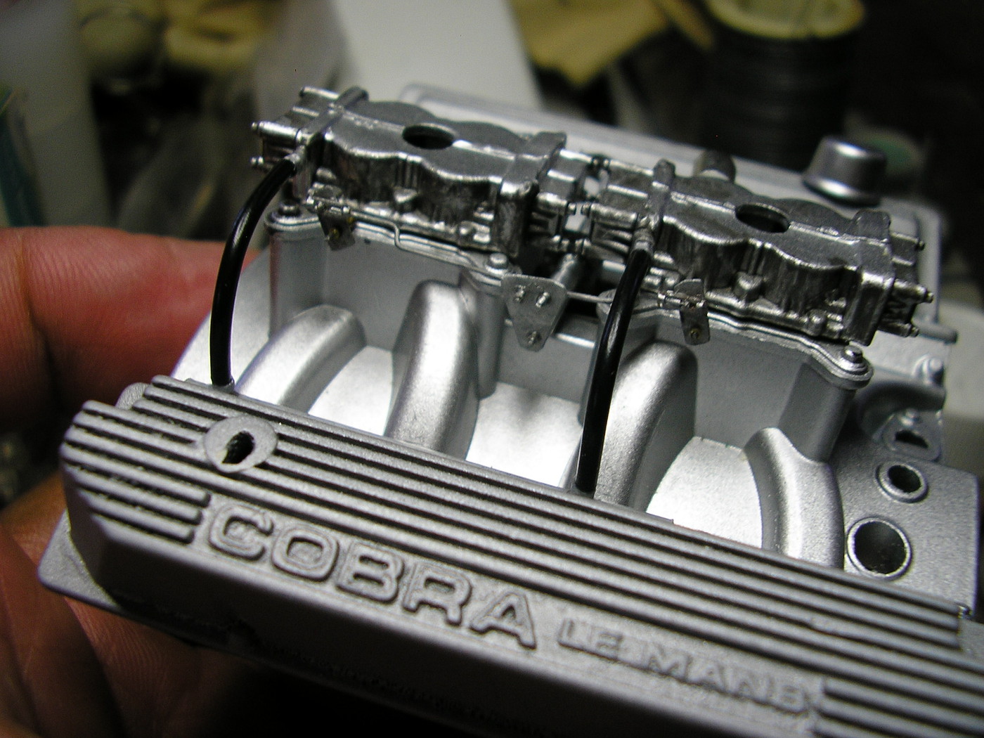

The engine intake manifold for what they give you is quite sparse to my eyes, Some kind of detail is definitely needed as far as the carbs and while I won't add every nut bolt and fitting to them, some linkage is better than none at all, especially in this scale.
The carbs represent the Holley double pumpers that were in the 1:1. At first I was going to hollow out the carbs and do sort of what I did to the 1/25 '67 Mustang I built with that carb. Then it occurred to me that if I stray too far from what they give you, it might affect the fit of something else down the road and lead to more frustration.
Some fuel line hoses added along with linkage tying the two carbs together. Trying to get things to look in scale is a bit hard for this one as it's not a scale I normally build in. I wanted everything to look "right" without being overbearing.
I drilled a hole in the manifold (a bit tough as its solid diecast) and make a bracket for the return spring. Later on as the rest of the engine gets built, I'll add the throttle rod along with making a possible bracket on the rearmost part of the manifold to hold it per the 1:1.

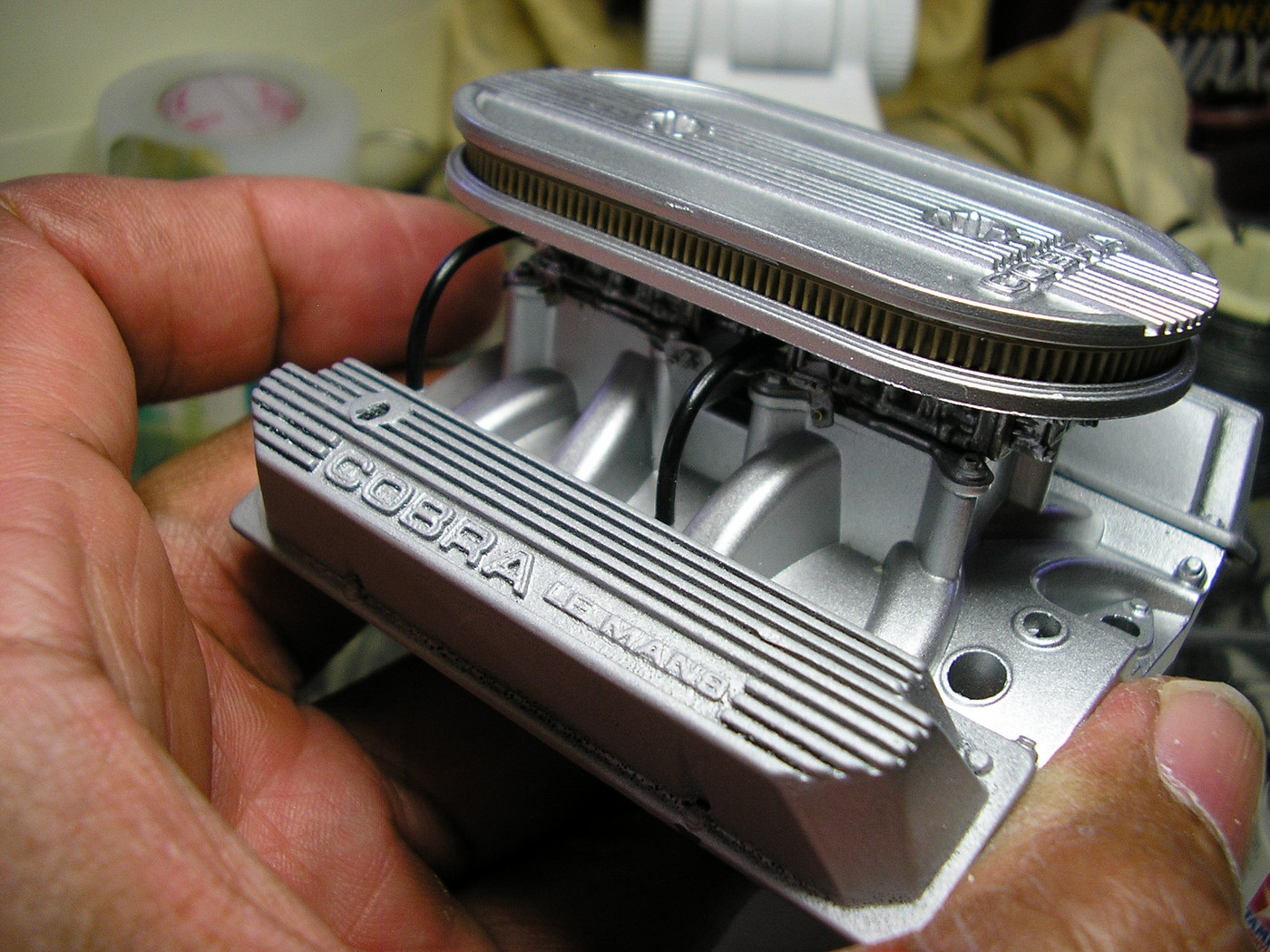

The air cleaner element was painted silver along with everything else......I wanted to change this and paint that more of a tan to represent what you'd see if the air cleaner was taken off.

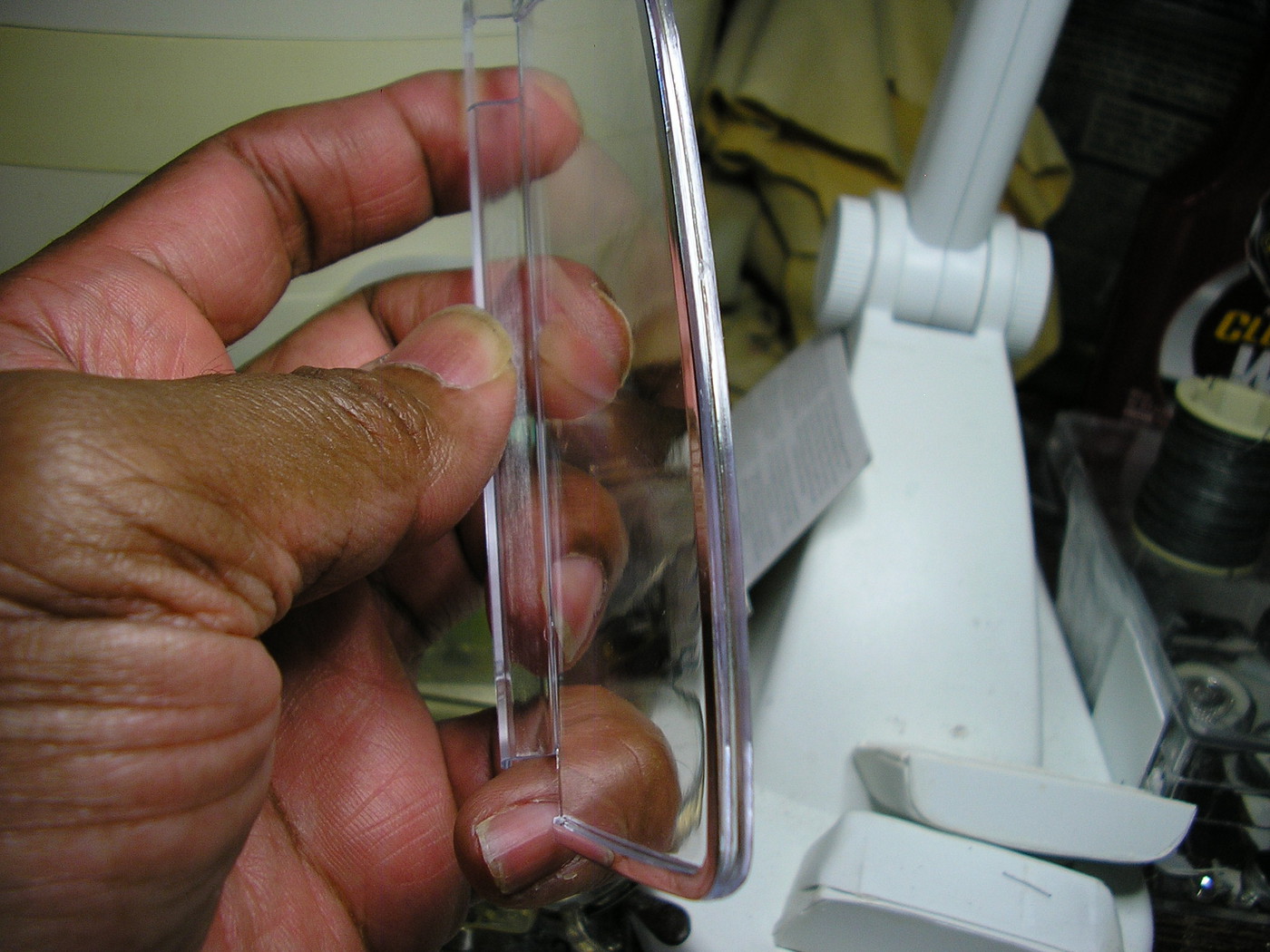

The models windows "open" because they attach to the door via this frame and of course they're going to open along with the door.
So, instead of going through a lot of changes re-engineering the door to take a roll up setup AFTER it's all painted, I decided to let that go and build it as is.
One annoyance though is that they chromed only the one side of the frame, leaving the rest clear. No.......I got out the BMF and decided to foil ALL of those areas that would be seen especially if the doors are open.

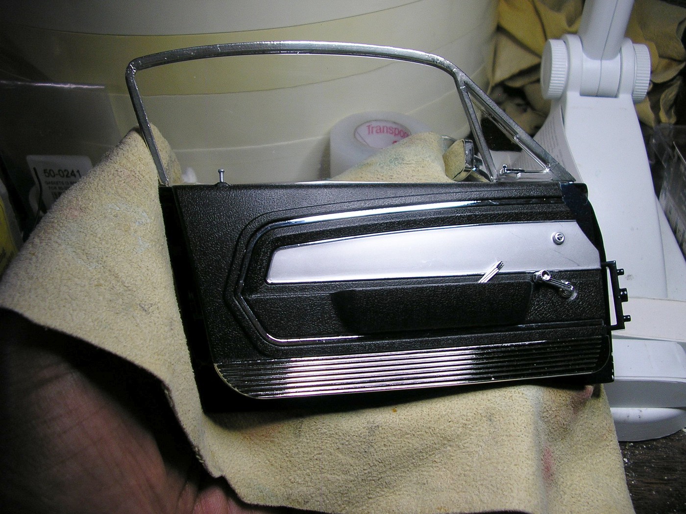

Here is now the finished door with glass, handle and mirror in place. There is some slight distortion with the glass, but nothing to get too crazed about and nowhere near as bad as some kits I've seen with terrible optically distorted glass.
The kit gives you the aluminum inset, lower trim panel and handles as separate pieces. The upper trim panel was quite tricky as it snaps into place, but you have to be careful slipping it in behind the one handle and you have to make sure the door panel is attached to the outer door before putting it on.

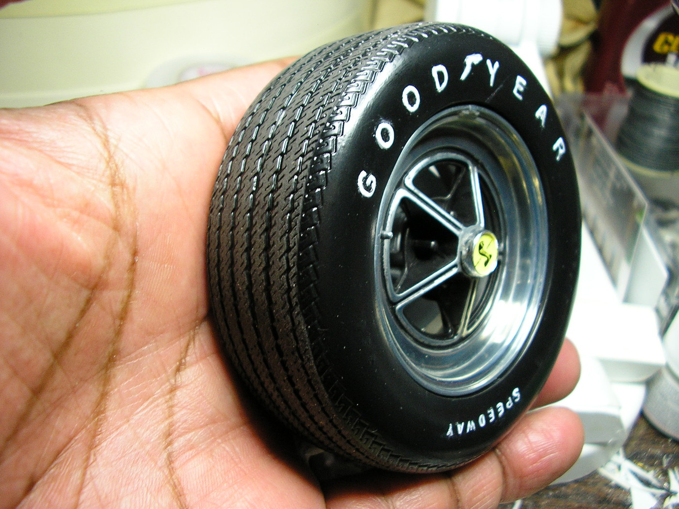

Got another wheel and tire done as seen here. Like the other wheel, I dunked the entire thing in a can of lacquer thinner and stripped the silver paint off. Every Magnum five star wheel I've seen on a Shelby has always been "chromed" and not painted aluminum. Looks more realistic than what's originally in the kit.
I wanted to scuff up the tread just a bit. A big model like this to my eyes would not look right sitting there with "shiny tread".

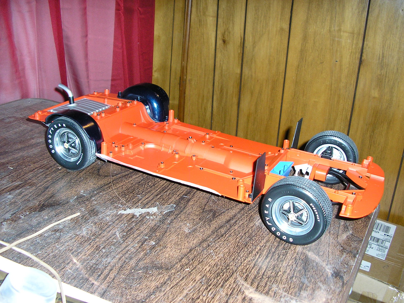

Just a mini update this time around. I'm on vacation until the 12th, so hopefully I can get more done on this.
Some of the chassis and rear end done. At first, I thought about adding fuel lines and such, but my better sense told me to let that go as a lot of this chassis is hard diecast although, part of the middle is painted plastic.
Just the same, there's no way I'm going to be turning this thing over to display the underside. This will be one heavy model once it's all built!
DeAgostini cheated a bit with the rear suspension. As you can see there are leaf springs (one for the time being) per the 1:1, but the axle has "helper" coil springs if you look closely.
I believe they did this to keep the ride height level as this will be hefty, and also to take some of the stress off of the leafs as they are indeed steel, albeit very thin.
I did overspray the rear part of the chassis and once I get to the forward part, I'll overspray the sides lightly to represent the 1:1 as they would have been painted coming down the assembly line.
This also takes away the "too clean" look that the chassis has, even though I won't be displaying this roof down. ;)
The upper side of the gas tank shown which did include the filler neck. You can see here all the attachment screws and I sure hope the kit gives you some kind of mat for the trunk. The trunk lid opens and that would look so unkempt with all those screw heads showing through each time the trunk is open. There were so many boxes, I can't remember if there was a mat or not.

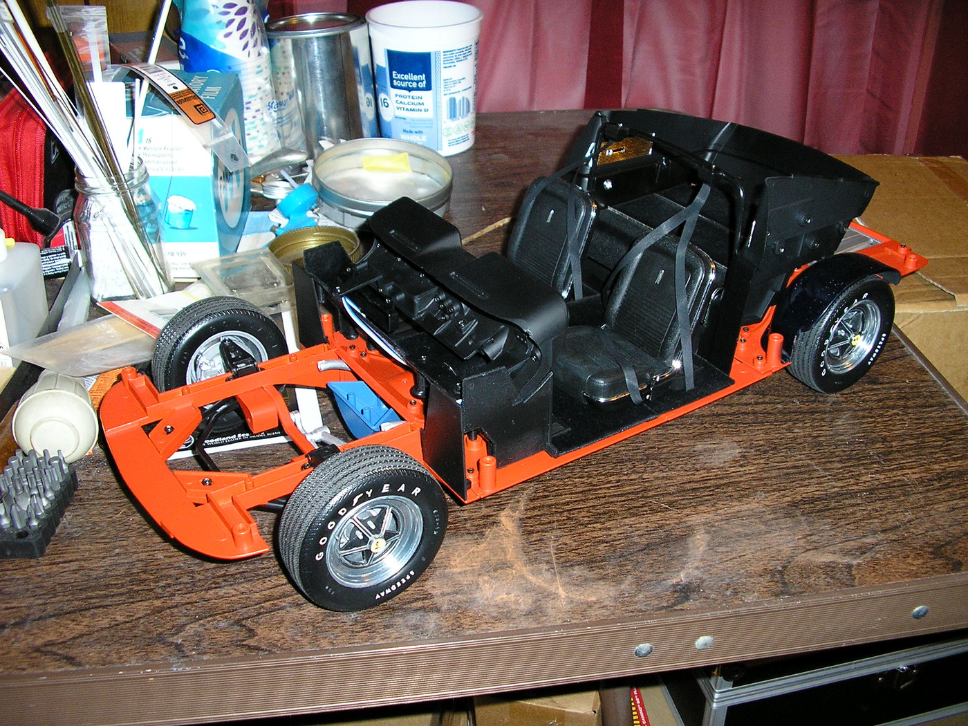

Some more progress. I gotta tell you even though this kit is mostly screw together, there are some tricky bits and one suggestion I have for anyone that's going to be building one of these is to "pre screw" the holes before putting your parts on. Doing that saves the hassle of getting the thread started and makes for a more positive location for things.
Finally down to the last wheel to strip and get mounted on the tire. I have to say this is one of the more annoying parts of this build. Thank goodness for the dehydrator as I was able to turn the wick up to high and let the tire sit for maybe 10 minutes to soften it up enough to get the wheel in.
After a bit of a struggle (still) I got the wheel in the tire and went ahead to scuff up the tread like the other ones.
Here it is now mounted on the rear axle.
More of the chassis now attached with some overspray, along with rearmost part of the exhaust.
Driveshaft and "transmission" now in the car with its brace. I kinda wish they would have made an entire transmission casting....but as I've mentioned before, I'm going to be loath to turn this thing over to show the underside. Each step I go makes this that much more heavier.
Front wheels/tires now on with front suspension and steering linkage.
She's finally on all four tires!
Chassis pretty much done with exhaust in place now. You can see definitely see the size of this thing as it's literally taking up all the space inside my paint booth.
Dashboard partially done..............

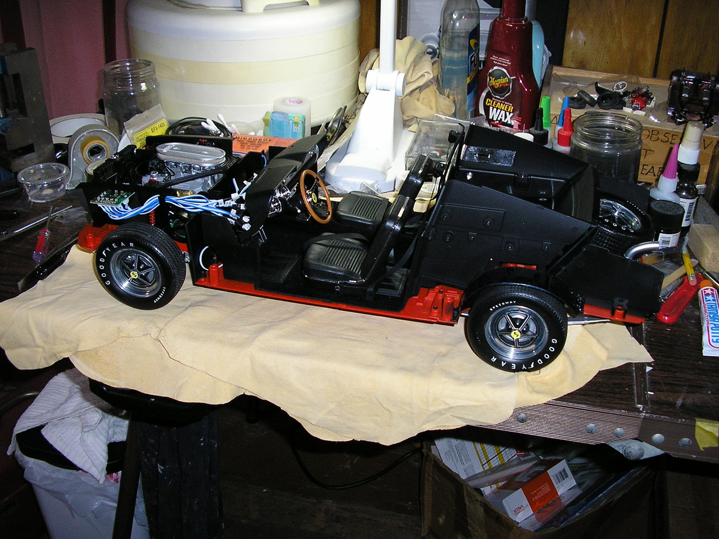

For grins, I decided to take the main body shell out of its box and rest it on the chassis to get an idea of how it'll sit. Far from the final fitting, it's looking pretty neat. ;)
This won't be the final display place. There's no room in the bookcase for a display case which this ultimately needs to be in .
The driver's side door I have just placed there for the moment. I don't think the hinges get fastened in until pretty much at the end.
Interesting enough, there must be some sort of magnetized material in the door jambs as the door literally "grabbed" shut when I put the door in.
Interior all done now. That was a bit tricky as everything had to be built in sections and then attached with the screws in a sequence.
Now it's time to get the steering wheel and shaft together with its pinion gear for the steering linkage. There's wiring involved as the horn is supposed to blow after it's all said and done. :D
I forgot to take a pic, but the rear seat does flip up and down like the 1:1 and the front seats move forward, but you have to move the seatbelts first as they don't move with the seats.
Thanks for looking!

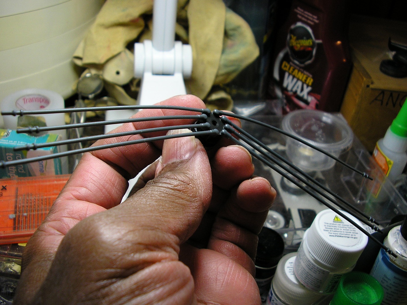

Now on to detailing the engine a bit and these ignition wires are WOEFULLY incorrect.
No.
This simply will NOT do. I ended up cutting off ALL the wires on the distributor and found some wiring which to me looks better.
I did save the ends of their wiring which I can use as "spark plugs" and I had some wiring which had large enough insulation to make the boots.

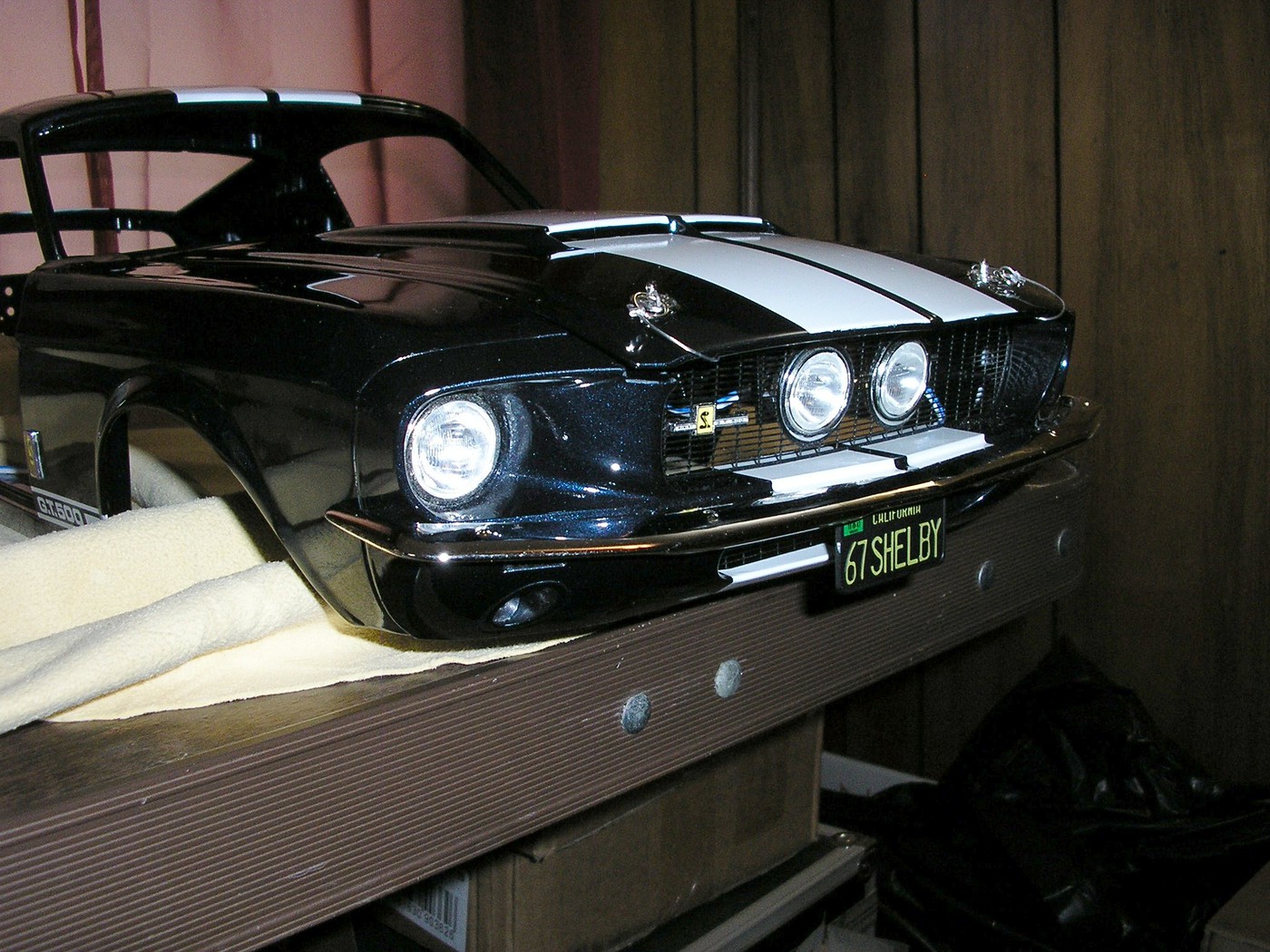

Now on to the front end. After a quite long rubbing out and polishing session with both fenders, I got the front bulkhead now mounted to them.
At this point, I'm about to mount the front end on to the main body shell. Not long ago, I got a HUGE length of chamois cloth to use for this purpose. They recommend using some soft cloth (or towel) to have underneath the body during this phase.
I like the chamois cloths as they won't leave any scratches when polishing and they'll last almost indefinitely.
I will have to spend some time and rub out/polish the body. While the paint job isn't bad, there's still a bit of orange peel to the clear coat and a model of this size to my eyes it's more than noticeable.
One of the things I wish DeAgostini had did was to make the rear end out of solid metal and not plastic. Just before I posted the pics to Fotki, I was trying to take a pic of the bolted on front fenders to the body and had that mounted on the chassis/interior. I'll be darned if the driver's side rear wheel snapped COMPLETELY off the axle! The part that broke off I have that setting with thick super glue and shouldn't be anymore problem later on.
Just one of those things you have to keep in mind as the weight of this thing is NO JOKE.
I also highly stress that anyone attempting to build one of these, make sure you got PLENTY of room. This sucks up a LOT of space as it's being built and I literally had to clear off a quite a bit of things on my table just to get this to not be in the way and have more issues.
That's it for now..............next update I hope to have the body totally on the chassis and fully screwed on. On my issue #85 out of 100 so this is definitely nearing its end. Thank goodness! :D

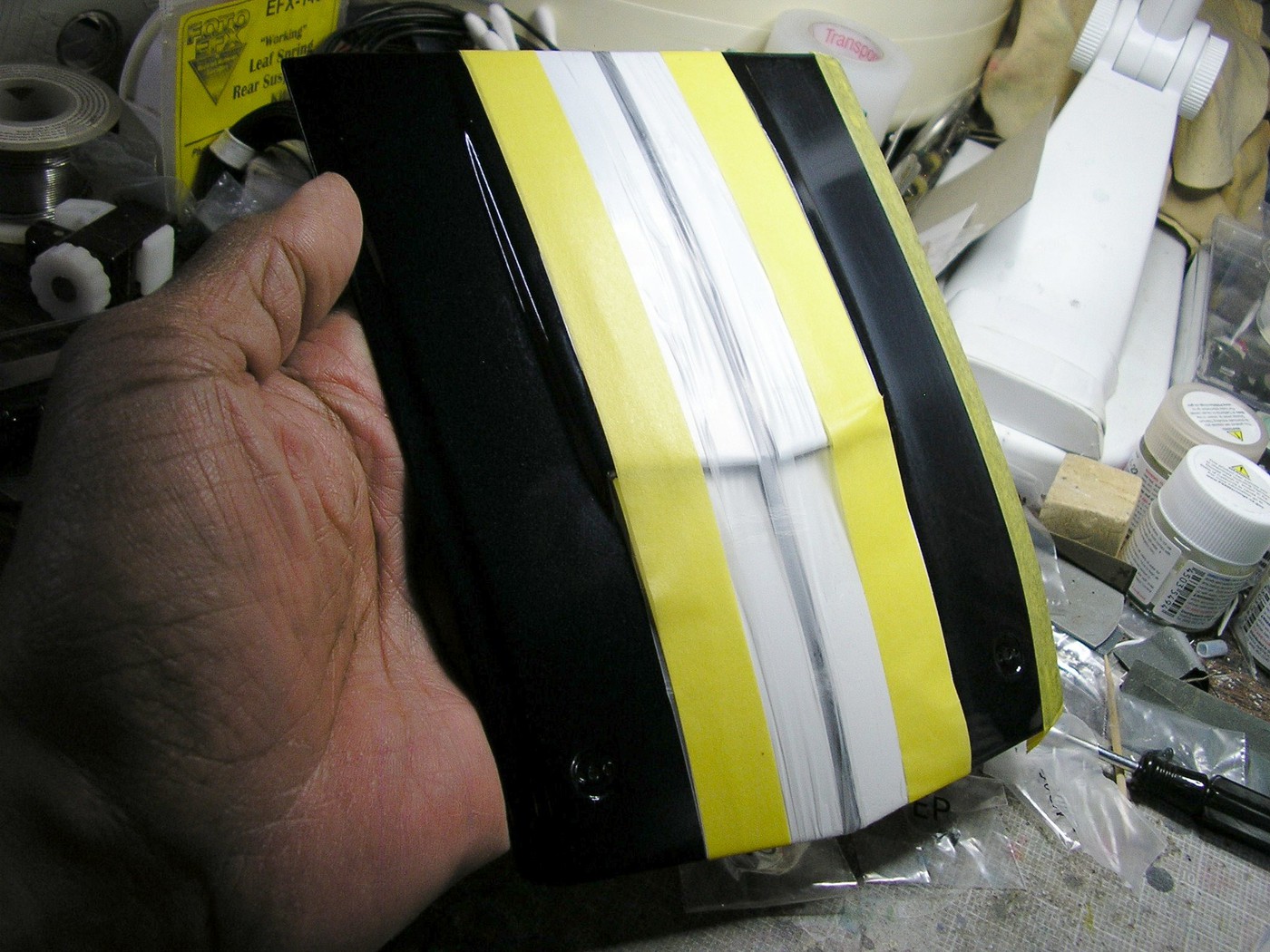

I've had to spend a considerable amount of time rubbing out and polishing the body as while the paint job is not bad..........just a bit too orange peeled in spots and there's too much real estate in my eyes to just let that go.
Especially for a car of this type. Race cars, you might be able to get away with that because, well......they're race cars.
Street cars are another matter and the paint jobs should be as smooth as possible.

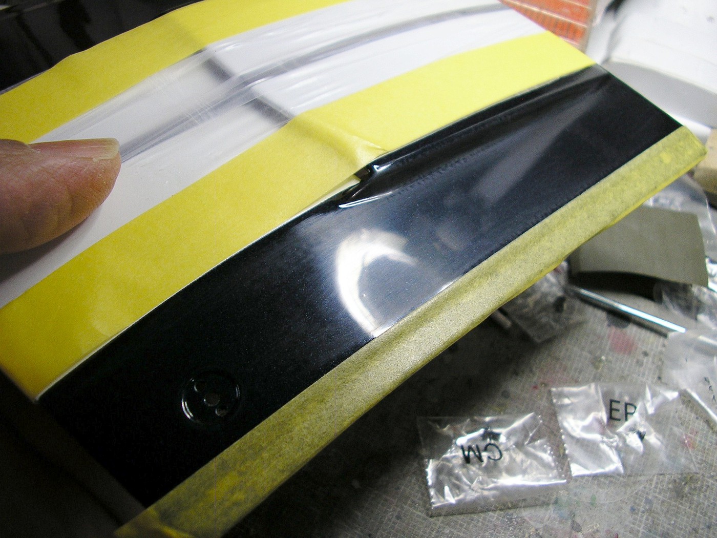

You'll notice I've masked off the stripes......very early on when I got the body panels I tried to rub out the stripes in a hidden area on the nose. Very quickly the stripes began to "run" which told me that either those stripes were not clear coated, or they were some sort of decal.
I decided to let them be as I didn't want the hassle of repainting stripes and the mess that would make. You can see here I've laid down first some Parafilm, then some Tamiya tape on top of that. I also like to cover up creases and whatnot as it never fails to rub through a corner, creating yet more work to fix it.
LOTS of rubbing out/polishing I had to do on this hood. Finally got it to the gloss I wanted......this was not the final result. Forgot to take a pic of it after.........the orange peel is gone though which bugged me a lot.

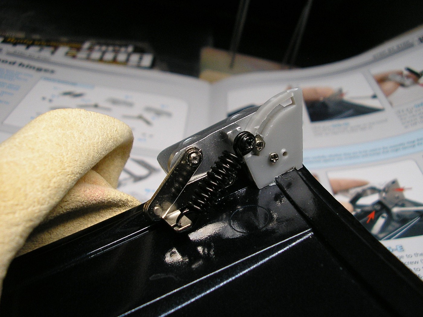

Here's where the teeth (in my case denture) gnashing came in! DeAgostini gives you the parts to do semi scissor hinges for the hood. Well, I forgot to pre drill the hole to make it easier for the screw to go in once I needed to attach the part. Sure enough, the screw head BROKE OFF leaving the bulk of the screw INSIDE the bored hole. Cursing then took place!
At first I thought about leaving the hinges off altogether, but I searched around and found a drill bit that was very close in size to the original hole that was drilled.
VERY CAREFULLY I drilled a new hole and then I was able to attach the hinge guide as seen here. It's a good thing they do give you extra screws to use. Something like this was bound to happen.
Here's a semi-beauty shot with the body attached (not permanent) and the hood now attached with its proper hinges.
I'm not crazy about the hinge guides being plastic. I don't know how long that'll hold up. On the other hand this won't be "played with" like a toy, so they shouldn't be too bad in holding up.

Just a real quick update. Since I'm snowed in and no work overnight, I figured what a good time to get some done on this thing. ;)
Got pretty much the entire front end done now.............
The hood pins were a bit of a challenge as the pins themselves are plastic, but the clamps that go through them are solid metal. Well, one of the pins broke off while handling the body trying to work with it upside down, so I ended up pinning it back in with brass and some epoxy.
That should be the way ALL small parts are mounted. Drill a hole for brass rod, cut it, then epoxy the part in. Makes for a MUCH stronger part down the road.
One nit I have here is I notice the hood stripes don't overlap the leading edge of the hood.......instead they stop right at the edge. All pics I have of '67 Shelby's including ones I've seen live and in person, the hood stripes are always overlapped.
This I'll remedy before it's all said and done.

I did have to put the tire in my dehydrator set at 130° for roughly 15 minutes at a time. After several tries I FINALLY got the wheel inside the tire, but this was NOT without some cursing along the way! :o
Here's the wheel and tire all nice lettered up........something I haven't done in a very long time. And to think I get to do this THREE MORE TIMES!
I can hardly wait.
I'll polish up the wheel just a tad more, but at this point I'm done with this pretty much till later this week. Just getting the wheel and tire done alone was a real workout and to me it was a real tail kicker.
It's back to the '68 Corvette for now as I can see the next instructions for the Shelby is putting the seat together and of course another wheel and tire!
I'm thinking about adding brake and fuel lines so I need to dig out my references to see just where the brake line fitting goes in the calipers for this vintage (I have a shop manual) and also to get the 'right size' so things don't appear out of scale. I have to keep reminding myself this is 1/8 scale.
Thanks for tuning in!
