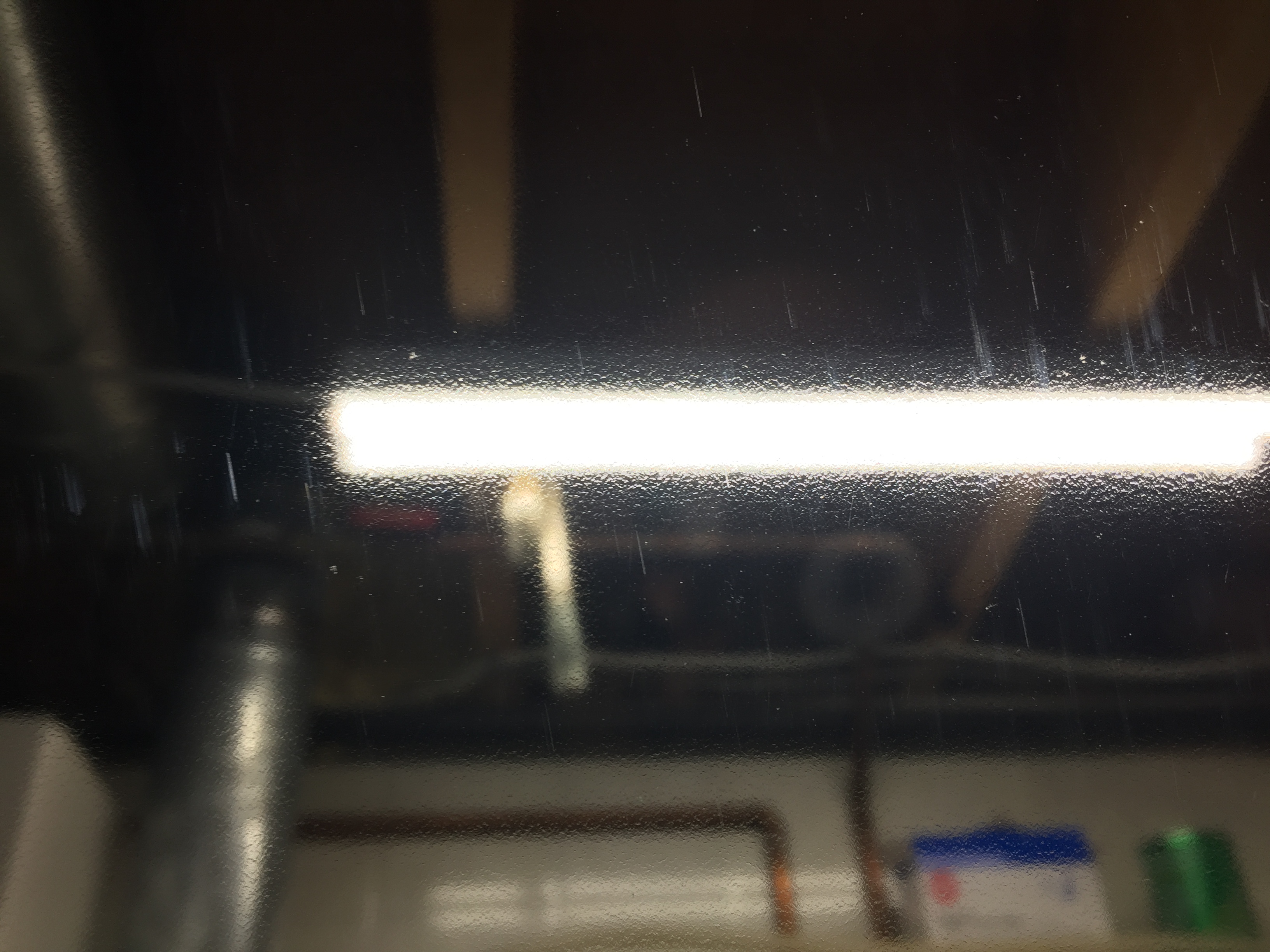

NOBLNG Posted February 5, 2019 Posted February 5, 2019 (edited) Just curious if anyone has used Evergreen clear styrene? I recently bought some that was not what I would consider clear. I called the toll free number and they offered to send me replacement sheets if I sent them a picture of it. However the HS where I bought it gave me a refund so I did not bother. I guess I will just use clear packaging if I need it! Edited February 6, 2019 by NOBLNG spelling
2002p51 Posted February 5, 2019 Posted February 5, 2019 I've been using it for years, never had a problem.
peteski Posted February 6, 2019 Posted February 6, 2019 What thickness was that? I think the 0.005" might have slight texture, but the thicker sheets should be perfectly clear. Another possibility is that instead of paper separator sheets they started adding a protective film over the sheet, which needs to be removed? It's been a while since I bought any Evergreen sheets.
NOBLNG Posted February 6, 2019 Author Posted February 6, 2019 It was .015" thickness, and there was no protective film on it. It did have the tissue paper between the sheets.

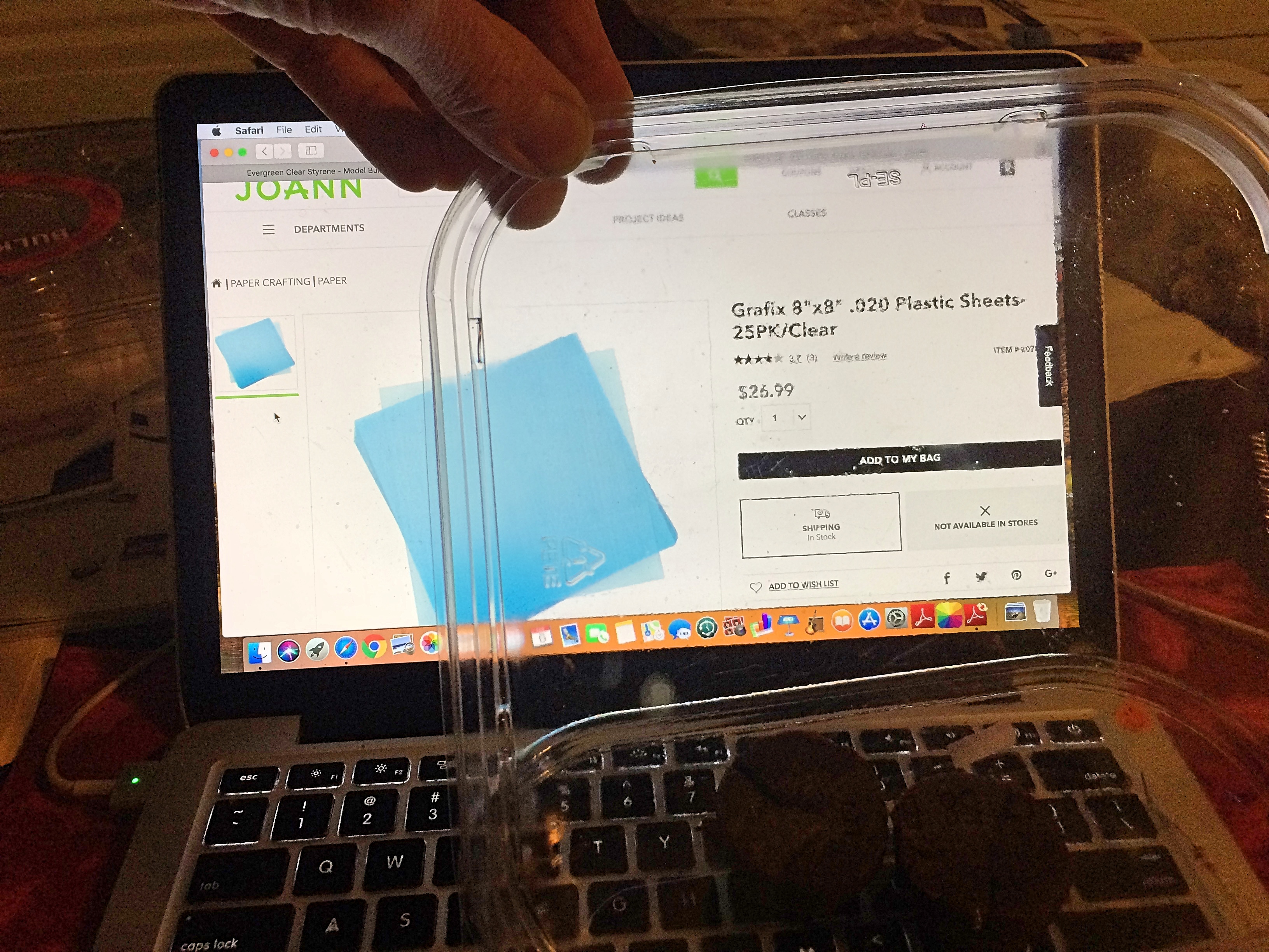

89AKurt Posted February 7, 2019 Posted February 7, 2019 15 hours ago, MrObsessive said: Greg, you may have to build up the dash a bit on the top pad to get it to mate up with the windshield. I have to do this from time to time where I don't want to use the kit glass (distortion) and yes, the stencil sheet is very thin. Roughly .005 to .010" thickness. I get mine from the Arts and Crafts store. When asking for it, let them know you're looking for clear stencil sheet and not simply acetate. They'll look at you funny and won't know what that means. Some of it comes in packs. Make sure it says 'clear' on the package and not the opaque kind. That's the foggy stuff that won't do any good. Hope this helps! I asked for this at Michaels today, nothing without pretty scrapbook junk printed on it. I ordered this Evergreen .015" the other day, got it yesterday and then saw this topic. Yea, looks terrible, now I'm ticked off. I will look in my stash, think there is just enough of something that is nicer, but I'll be lucky.Bill: This what you are talking about? [...] Heavyweight .020” film is available in 12×12” packs of 4 sheets also in 8×8” and 12×12” packs 25 sheets. [...]Grafix: Craft Plastic Film
89AKurt Posted February 7, 2019 Posted February 7, 2019 Since I can't find it on the Hobby Lobby, and Michaels websites, I see this store carries it: Jo-Ann 8"x8" .020 25 pack is $27.
MrObsessive Posted February 7, 2019 Posted February 7, 2019 That was it Kurt but it wasn't in that type package. Where I got mine you could buy it in single sheets and not in packs. It was something like 25¢ a sheet or in that range years ago. Make sure it's the 'stiff' type and not the super flexible stuff. That'll curl up in years to come like a potato chip!

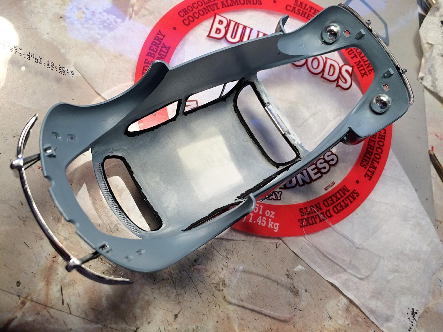

89AKurt Posted February 7, 2019 Posted February 7, 2019 Thanks! Wait a cotton picking minute! Check this out, I'm eating these brownies, and noticed the package.
MrObsessive Posted February 7, 2019 Posted February 7, 2019 That'll do......same stuff basically but more than likely PETG or Vivak.

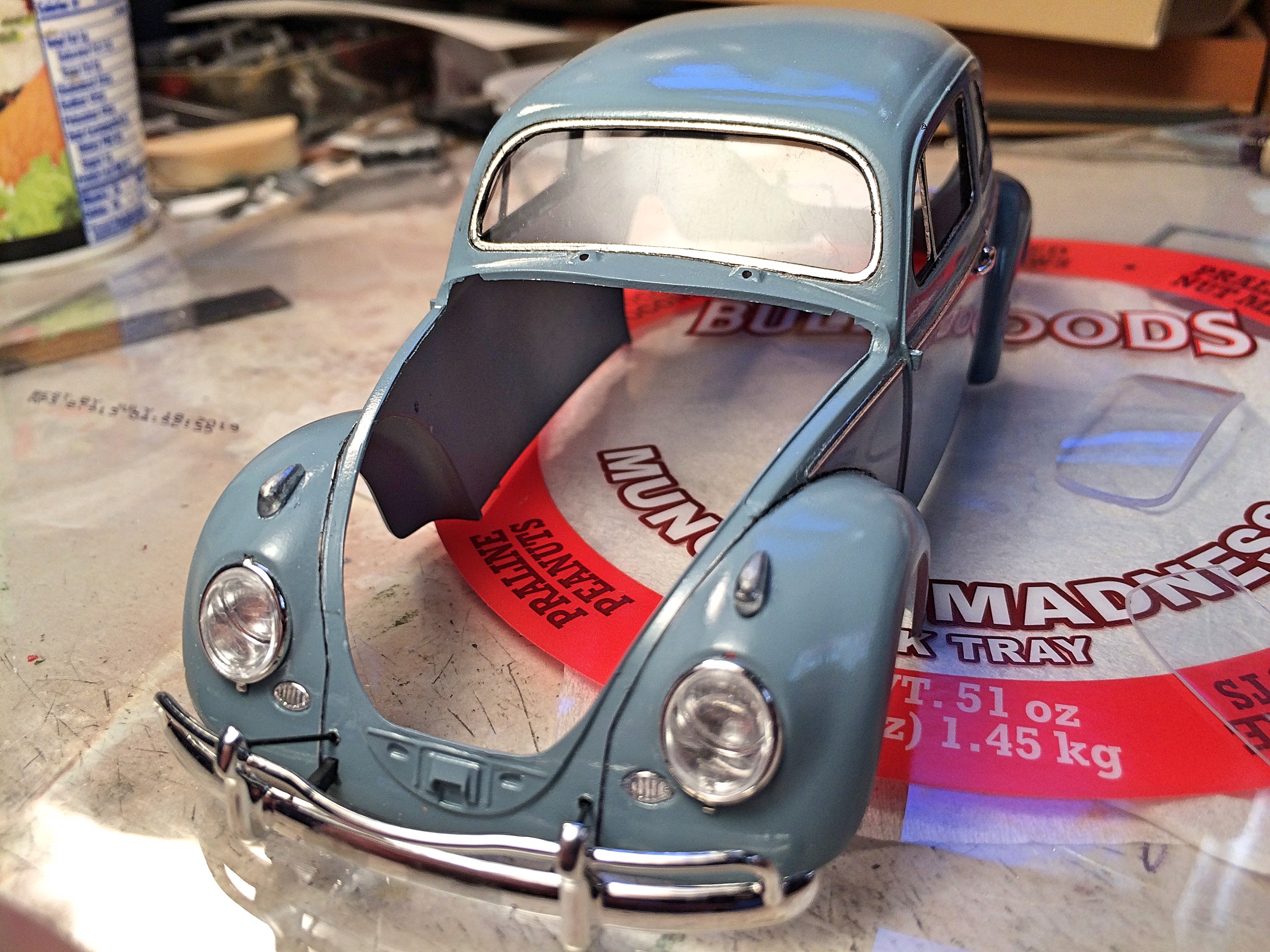

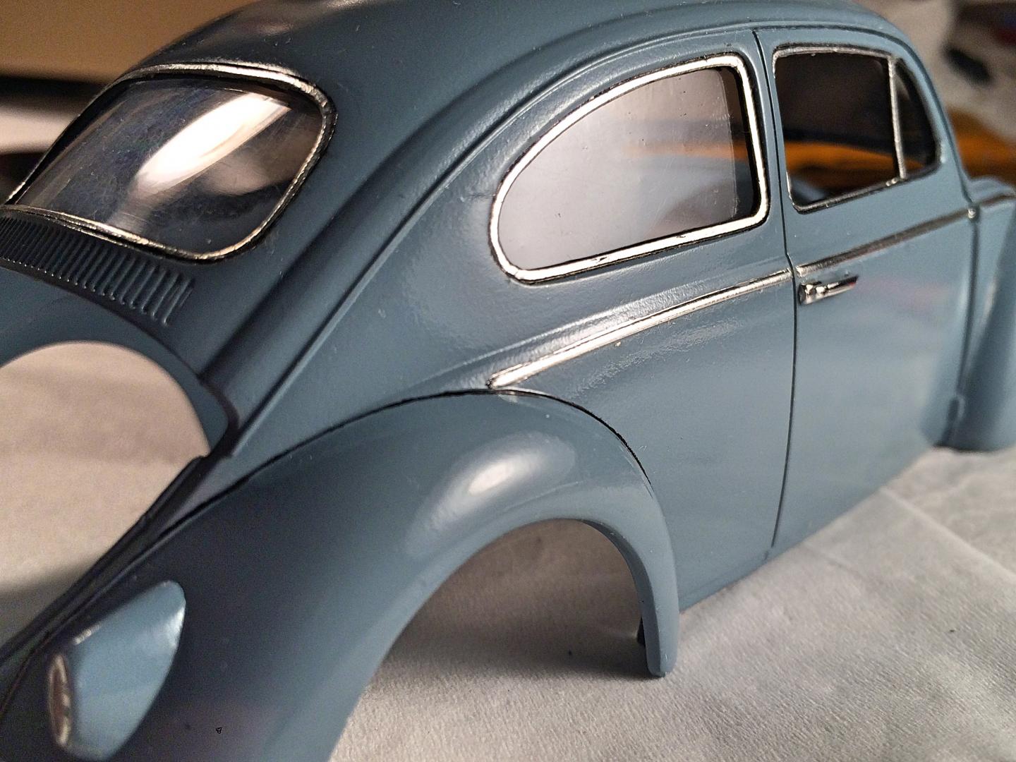

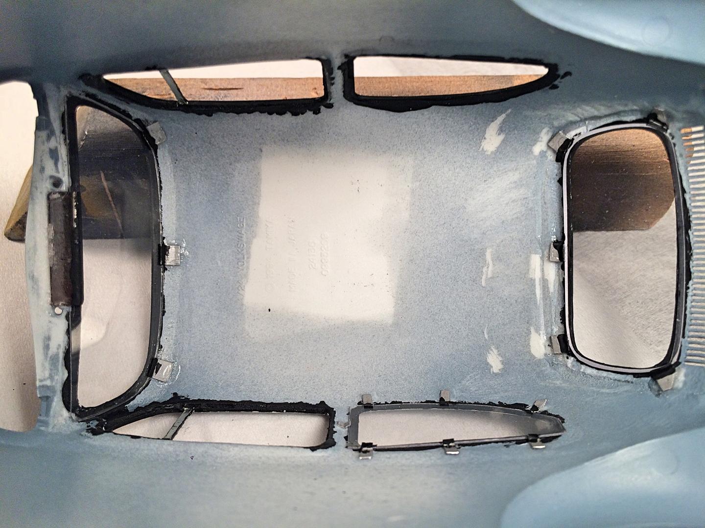

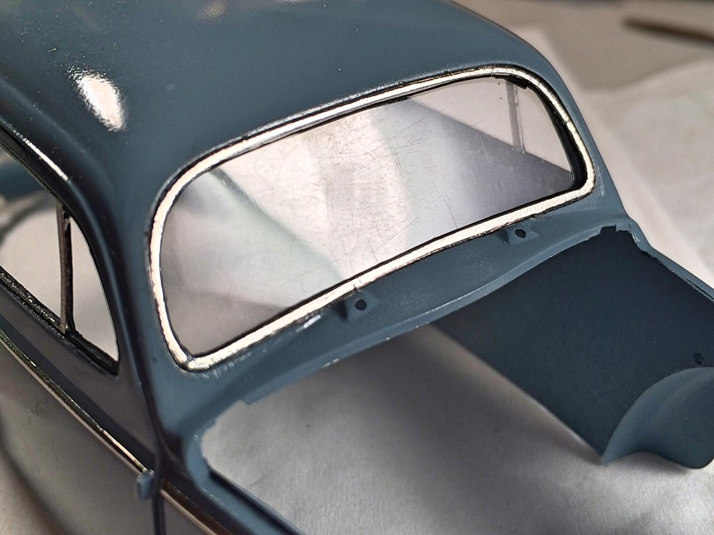

89AKurt Posted February 11, 2019 Posted February 11, 2019 Thought I would take over this topic. I am using another food package plastic, it's not as "dirty" from the vacuum-forming process, used a clean area to cut out the glass. I also didn't want to risk gluing it in, and have it pop off after buttoning up, made aluminum retainers.

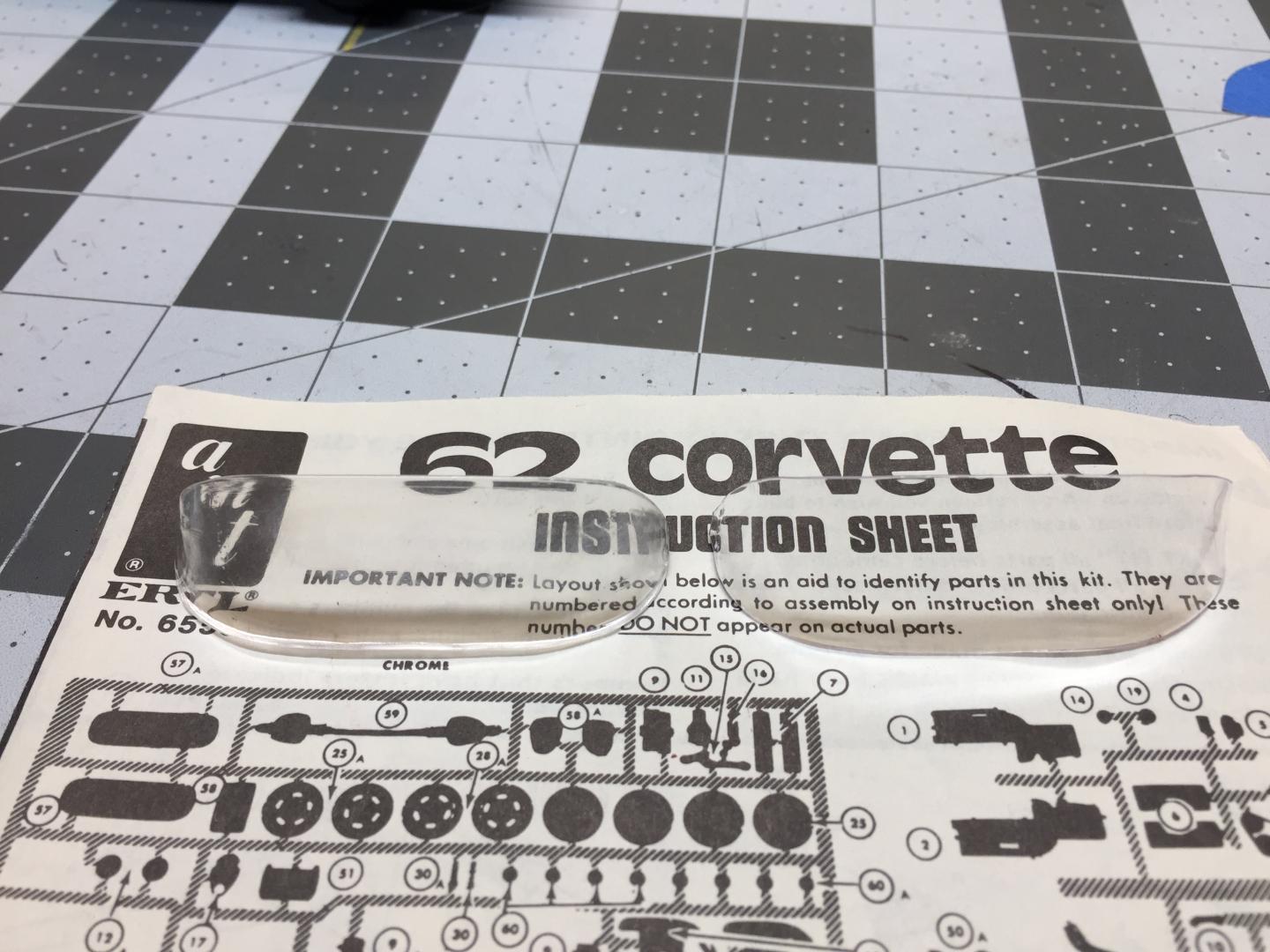

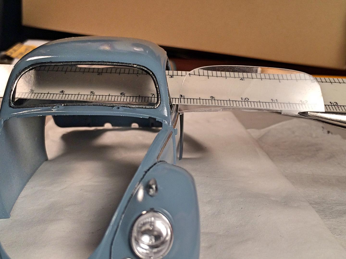

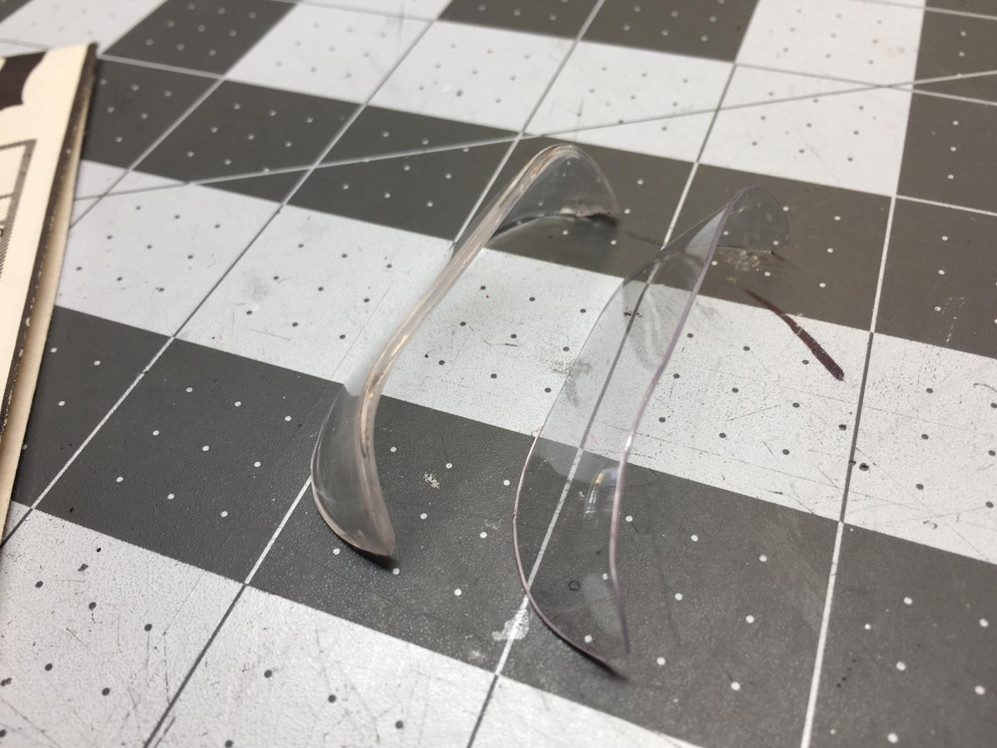

NOBLNG Posted March 18, 2019 Author Posted March 18, 2019 Now this stuff is clear! The original kit windshield is on the left. I was able to form it with a little heat from a hair dryer, and it kept it's shape. LePages superglue does not seem to cloud it and neither does MM liquid cement. My first try at forming the windshield doesn't quite conform to the frame, but for $5 a sheet, I can make a few attempts to get it right!

Len Woodruff Posted April 9, 2019 Posted April 9, 2019 On 3/18/2019 at 1:01 PM, NOBLNG said: Now this stuff is clear! The original kit windshield is on the left. I was able to form it with a little heat from a hair dryer, and it kept it's shape. LePages superglue does not seem to cloud it and neither does MM liquid cement. My first try at forming the windshield doesn't quite conform to the frame, but for $5 a sheet, I can make a few attempts to get it right! Thanks Greg. What heat source did you use for this? Did you just lay it across the kit windshield and hit it with the heat?
NOBLNG Posted April 9, 2019 Author Posted April 9, 2019 27 minutes ago, Len Woodruff said: Thanks Greg. What heat source did you use for this? Did you just lay it across the kit windshield and hit it with the heat? You're welcome! I used a hand held hair dryer and I bent it around the handle of my bench vise.
