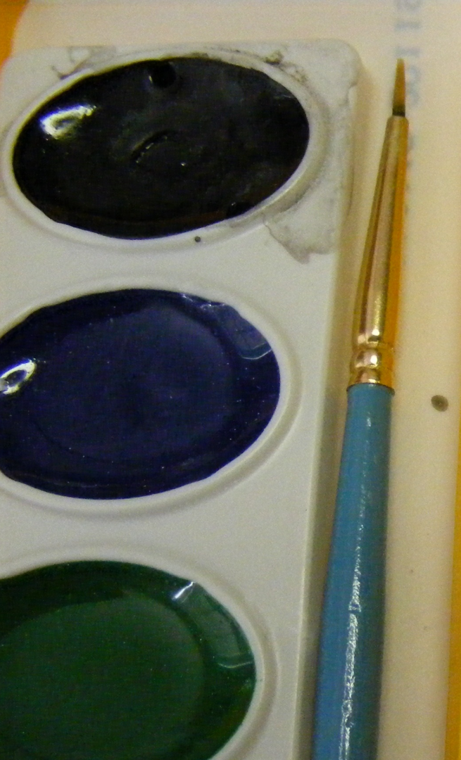

BigTallDad Posted February 10, 2019 Posted February 10, 2019 Instead of foil, take some watercolor paints made for kids and add chunks to Pledge with Future. Apply a coat with a paint brush, let it dry, then decide if another coat is needed.

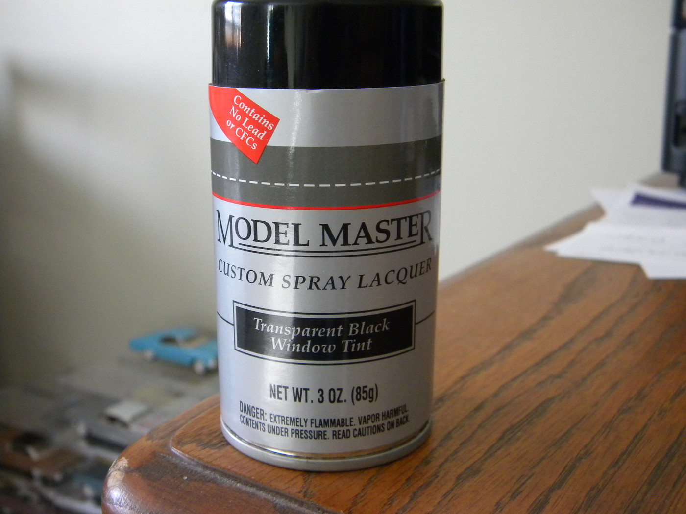

StevenGuthmiller Posted February 10, 2019 Posted February 10, 2019 Testors makes an aerosol #2949 "Transparent Black Window Tint" in it's "Custom Lacquer" line that works very well. Clean your glass well and spray light coats on the inside of the glass until the desired darkness is reached. Steve

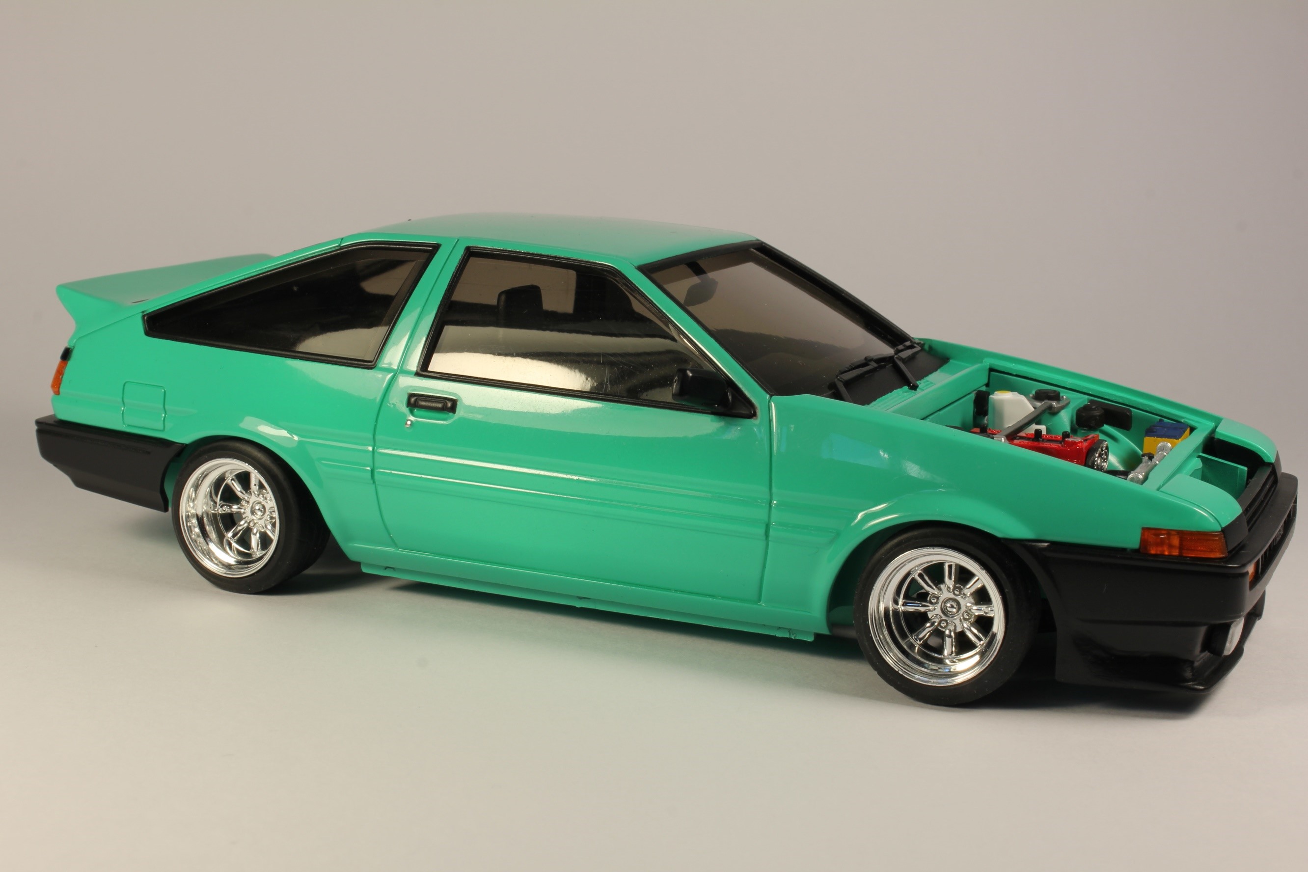

Michael jones Posted February 11, 2019 Posted February 11, 2019 I have used window tint film on this AE86. It was some stuff I bought from Aliexpress. Came rolled up and crinkled. Went down with a few small bubbles. I tried my best to get rid of them. The stuff is quite sticky which is great. I think the best idea is to go to a window tinting business and ask for some off cuts. At least they will be flatter then... This idea came from the Nascar modellers who do this all the time.
Intmd8r Posted February 12, 2019 Posted February 12, 2019 That Toyota looks great! I purchased a vinyl headlight tint off of eBay a while back. Its self adhesive, has the right look, no mess. Cost me roughly $10 delivered. Being self adhesive vinyl, it performs well around curves too.

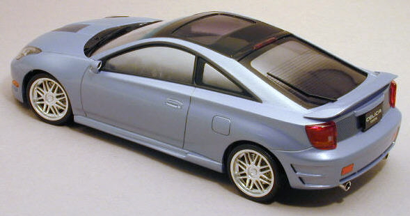

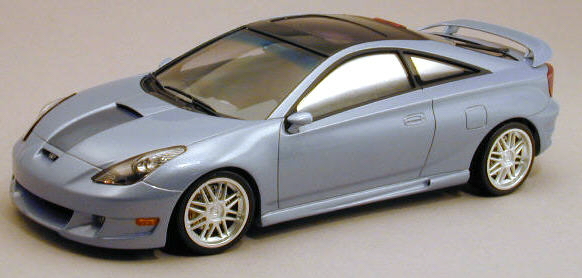

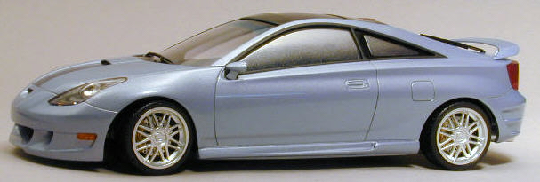

Zoom Zoom Posted February 12, 2019 Posted February 12, 2019 On 2/11/2019 at 4:15 PM, 89AKurt said: I wanted to try a mirrored type of tint, but it's flat, and don't see how it can form to curved windows without getting crinkled up. Expand That's where Alclad Chrome works. These old photos are grainy and it looks perfect in person, but since Spaz Stix mirror chrome (similar to Alclad but will stick to a black lacquer base) was intended to be shot inside of clear R/C bodies, I tried Alclad II chrome inside this Kaminari Celica's windows. It looks great in person. Just shoot it through an airbrush in a couple light coats, followed by some smoke tint. You can get a nice fade too.

Zoom Zoom Posted February 12, 2019 Posted February 12, 2019 On 2/12/2019 at 7:05 PM, 89AKurt said: That's the look I'm talking about. The project I am thinking about, the BMW Nazca, the greenhouse is gold tint. I got the Alcad gold, tried on a parts box window, not thrilled. Did you thin the Alcad to do that? Expand I doubt I used any thinner, the chrome is very thin itself and goes on in very thin coats. Their gold doesn't have the plated/reflective qualities that the chrome does. Aren't the Nazca kit windows molded in smoke tint? You might want to try a test by replicating the smoke tint on spare kit glass using one of the transparent smoke colors. First see how the Alclad Chrome looks under the smoke tint. If it's still not gold enough, apply a thin layer of transparent yellow to the glass on the outside. Or try it inside the glass before applying the Alclad. It might get you a lot closer.
89AKurt Posted February 12, 2019 Posted February 12, 2019 On 2/12/2019 at 8:59 PM, Zoom Zoom said: I doubt I used any thinner, the chrome is very thin itself and goes on in very thin coats. Their gold doesn't have the plated/reflective qualities that the chrome does. Aren't the Nazca kit windows molded in smoke tint? You might want to try a test by replicating the smoke tint on spare kit glass using one of the transparent smoke colors. First see how the Alclad Chrome looks under the smoke tint. If it's still not gold enough, apply a thin layer of transparent yellow to the glass on the outside. Or try it inside the glass before applying the Alclad. It might get you a lot closer. Expand That's what I thought, seems no different than Testors gold. Yes on smoked clear plastic. Someday will experiment on parts box glass, thinking of adding some gold to the chrome now.
Zoom Zoom Posted February 12, 2019 Posted February 12, 2019 On 2/12/2019 at 11:13 PM, 89AKurt said: That's what I thought, seems no different than Testors gold. Yes on smoked clear plastic. Someday will experiment on parts box glass, thinking of adding some gold to the chrome now. Expand Adding Alclad gold to their chrome likely won't work. The chrome metal particles are a much finer grind than the gold, it gets reflective look by how each molecule lays down flat on a surface and reflects light. The gold is just regular gold flake, it won't have any reflective quality, the metal pigment doesn't work the same way the chrome does because it lays down in more 3D particles. That's why I suggested using clear yellow (or perhaps orange, or a mixture with orange, or perhaps smoke) to fine-tune the tint/look of the chrome to more of a gold appearance.

StevenGuthmiller Posted February 17, 2019 Posted February 17, 2019 On 2/17/2019 at 5:37 PM, Jon Cole said: Thank you all for your suggestions! I may try the Tamiya smoke on clear spoons. Expand He says in the video, "If you screw it up, there's no way to fix it"? I don't know about the Tamiya paint, but if you use Testors #2949 "Transparent Black Window Tint" you'll get the same results, and if you're not happy with the results, an alcohol swab will take it right off so you can try again. This stuff is very forgiving. Steve
