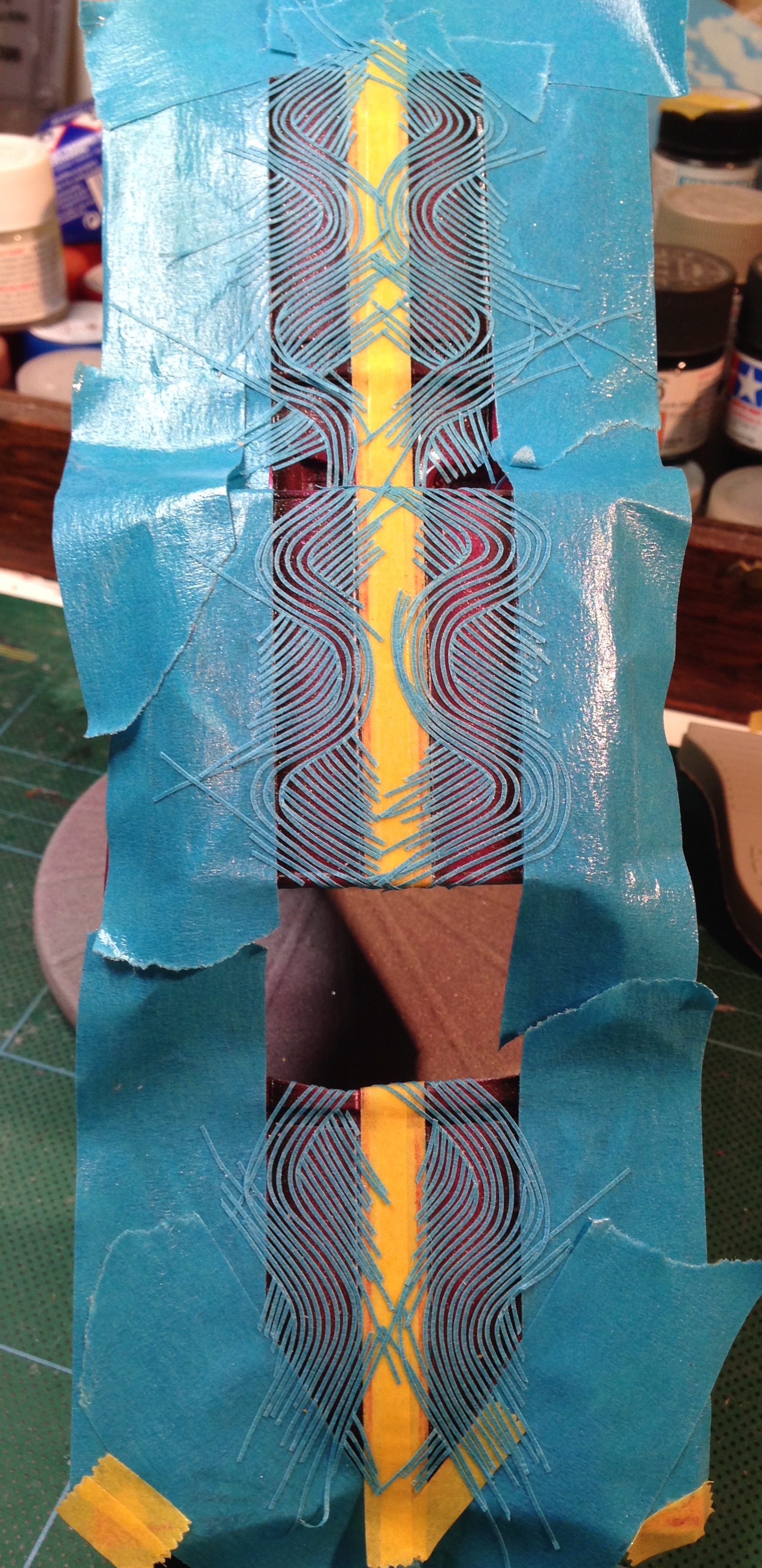

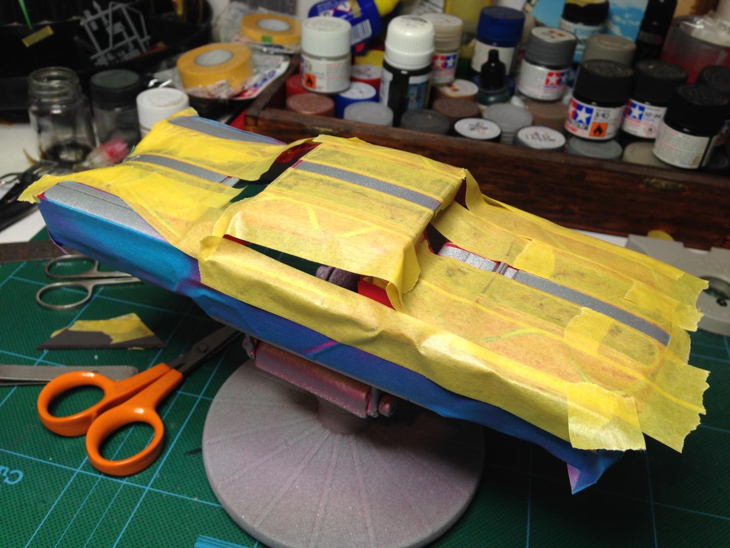

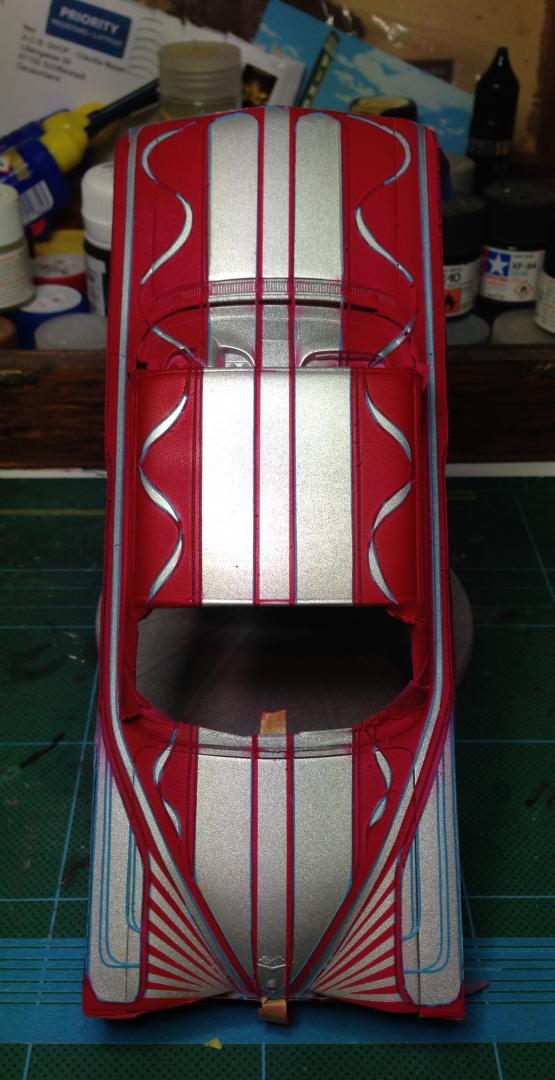

Peeled off some tape, ready for more patterns..
 I'm pleased with how the twirling ribbons look. They'll receive shading to make them look 3D (I hope)

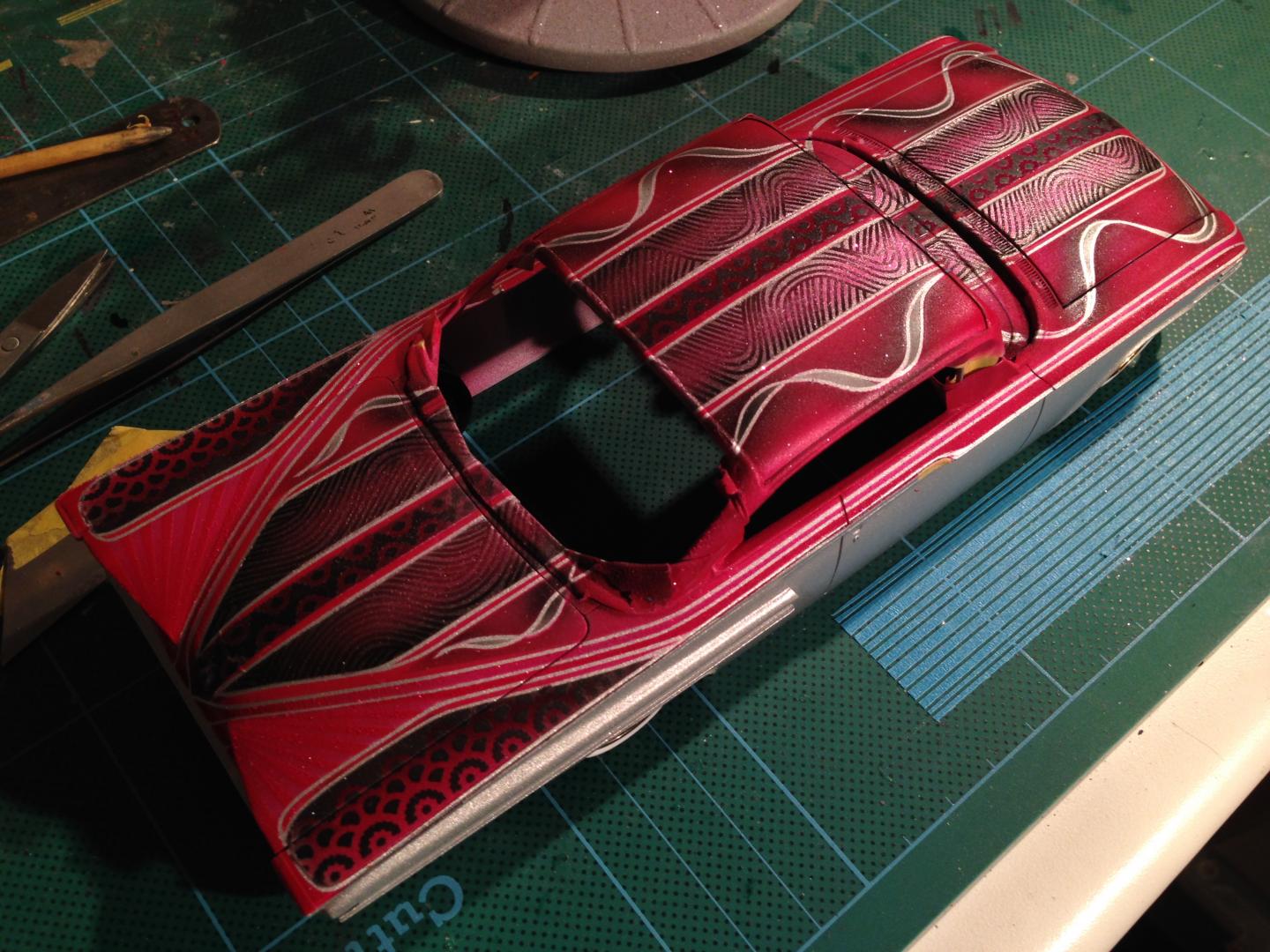

Had a lot of trouble with my airbrush. It's played up ever since I used Vallejo acrylics in it. Spent most of my valuable bench time, cleaning the bloody thing. Could not get it to spray smoothly.
eventually, I managed to get a fade done.

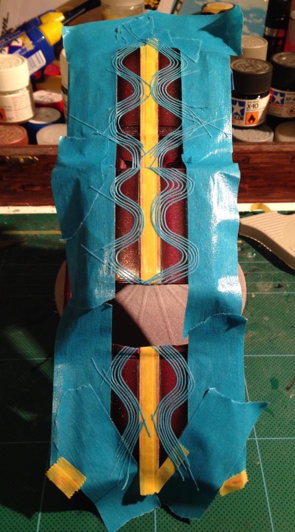

I began the fingerprint pattern tonight..

just finished the fingerprint pattern. Going to have a cuppa and think about what colour to spray through this pattern. I'm considering silver, for a higher contrast, to make the background colour look like it's about a foot below the silver. ?

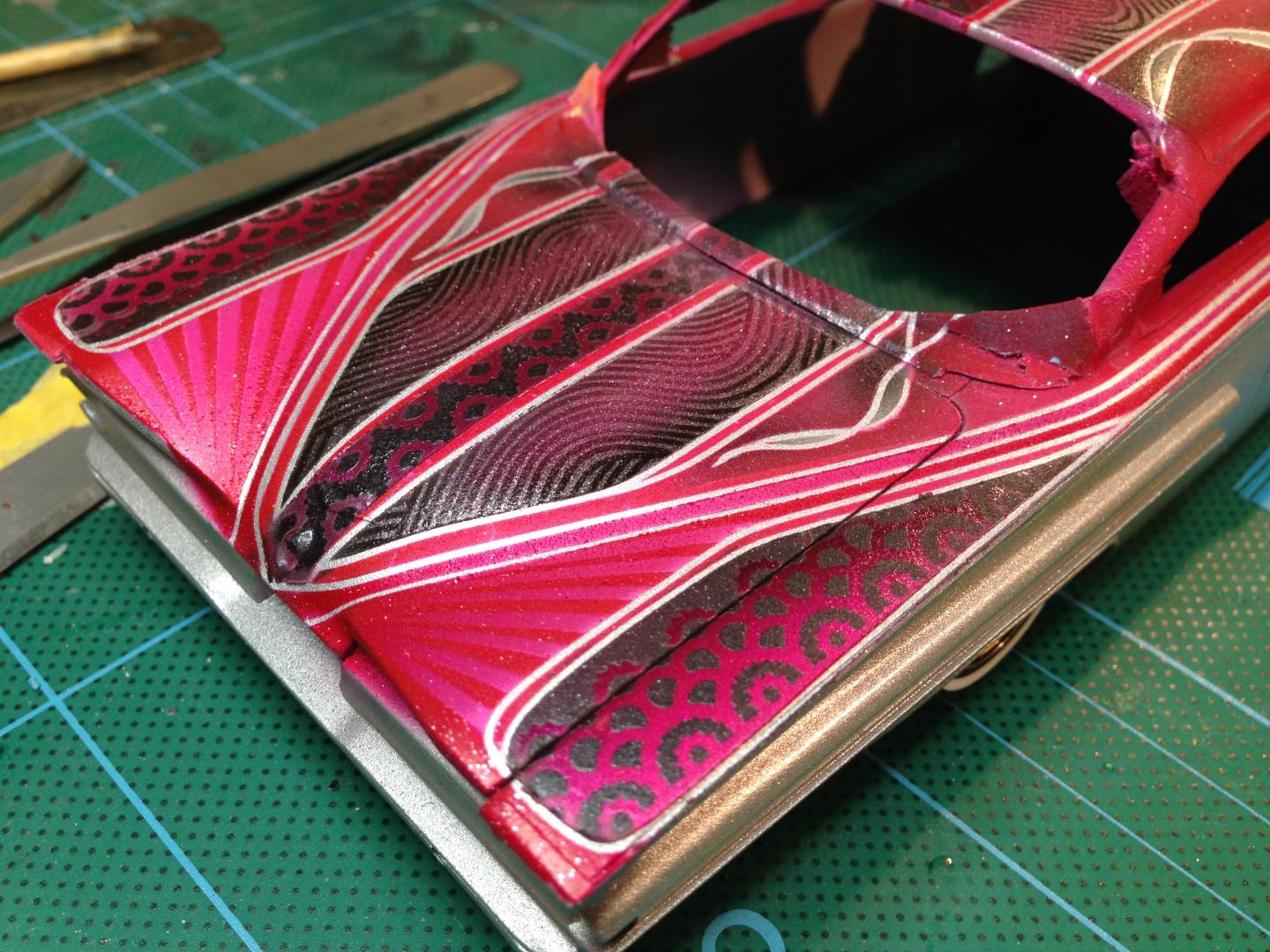

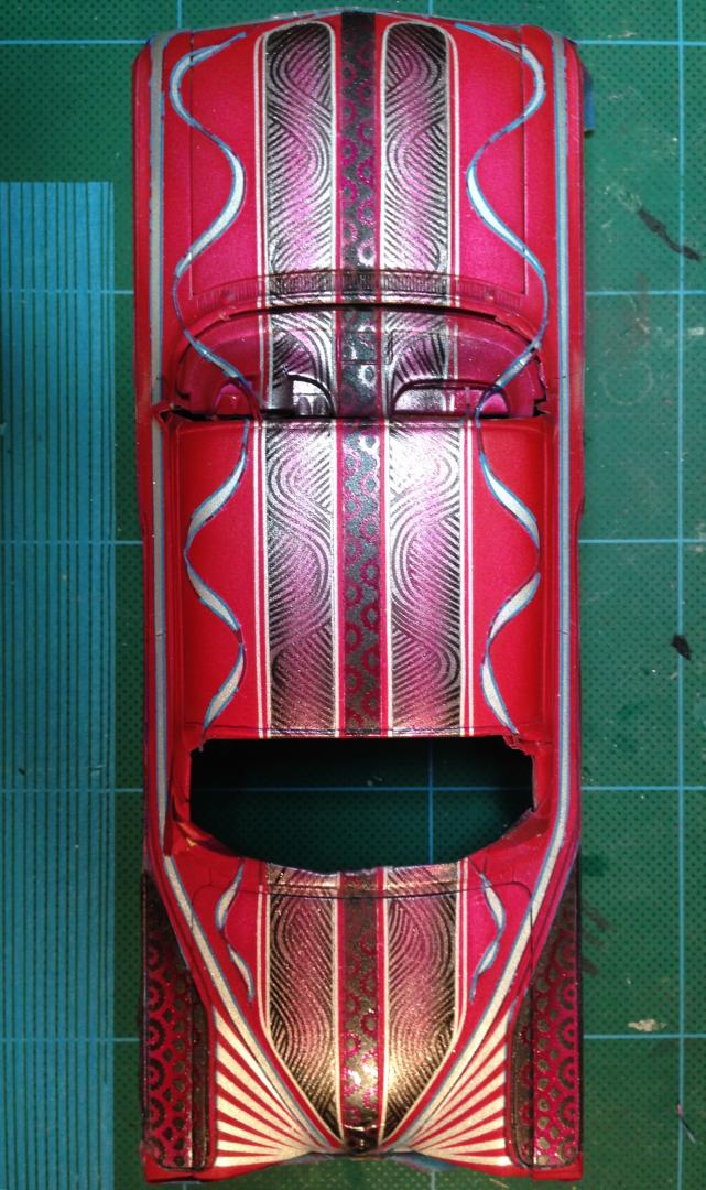

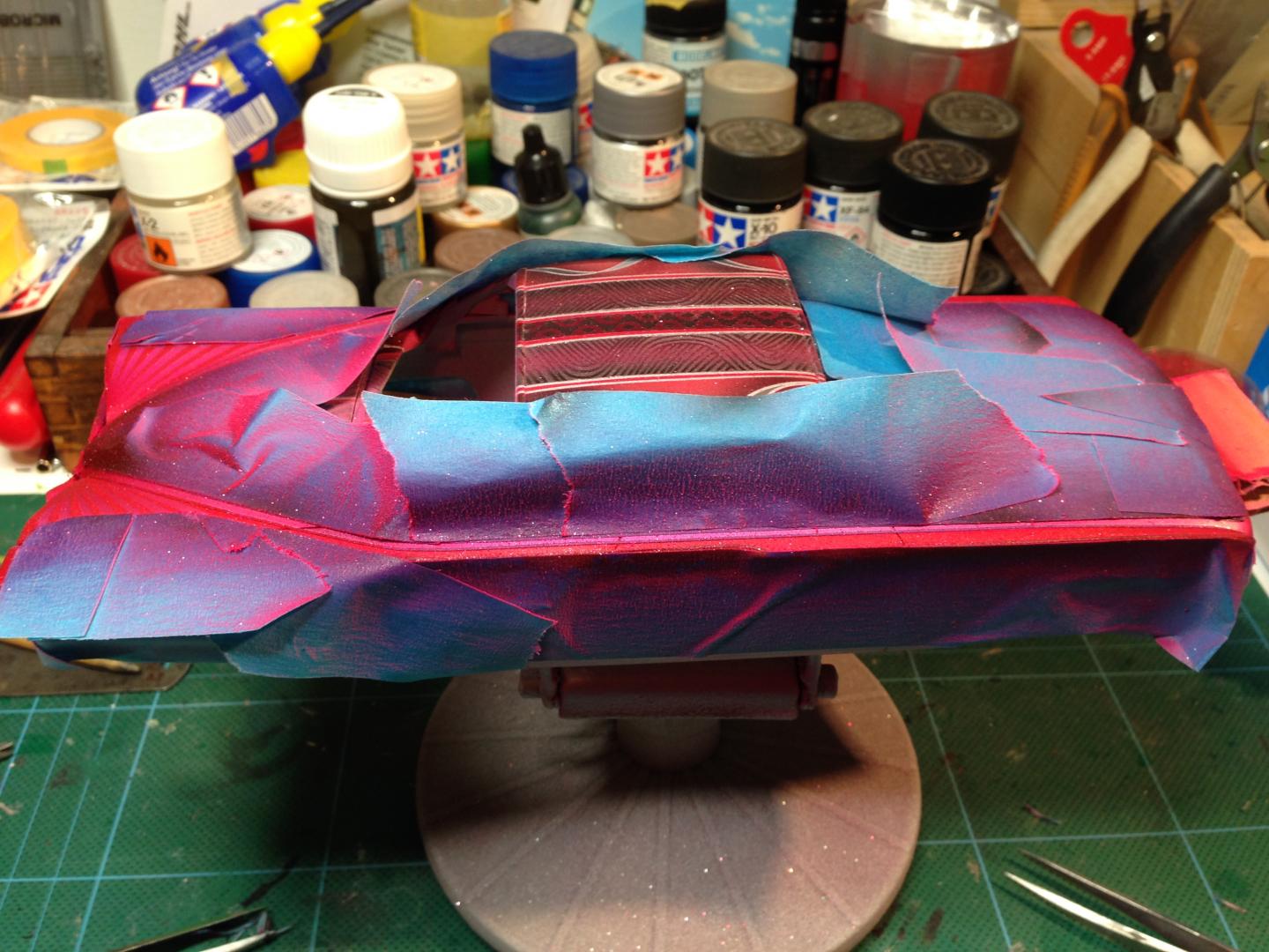

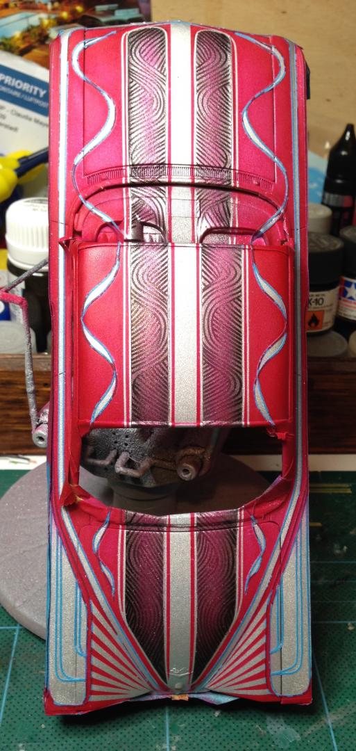

just finished painting the pattern with silver and red flake. The red flake particles didn't seem to come out of the airbrush and kinda collected in the bottom of the cup. As a result I got something more like a raspberry candy, which is fine, cos I can add flake to the topcoat if it isn't sparkly enough.

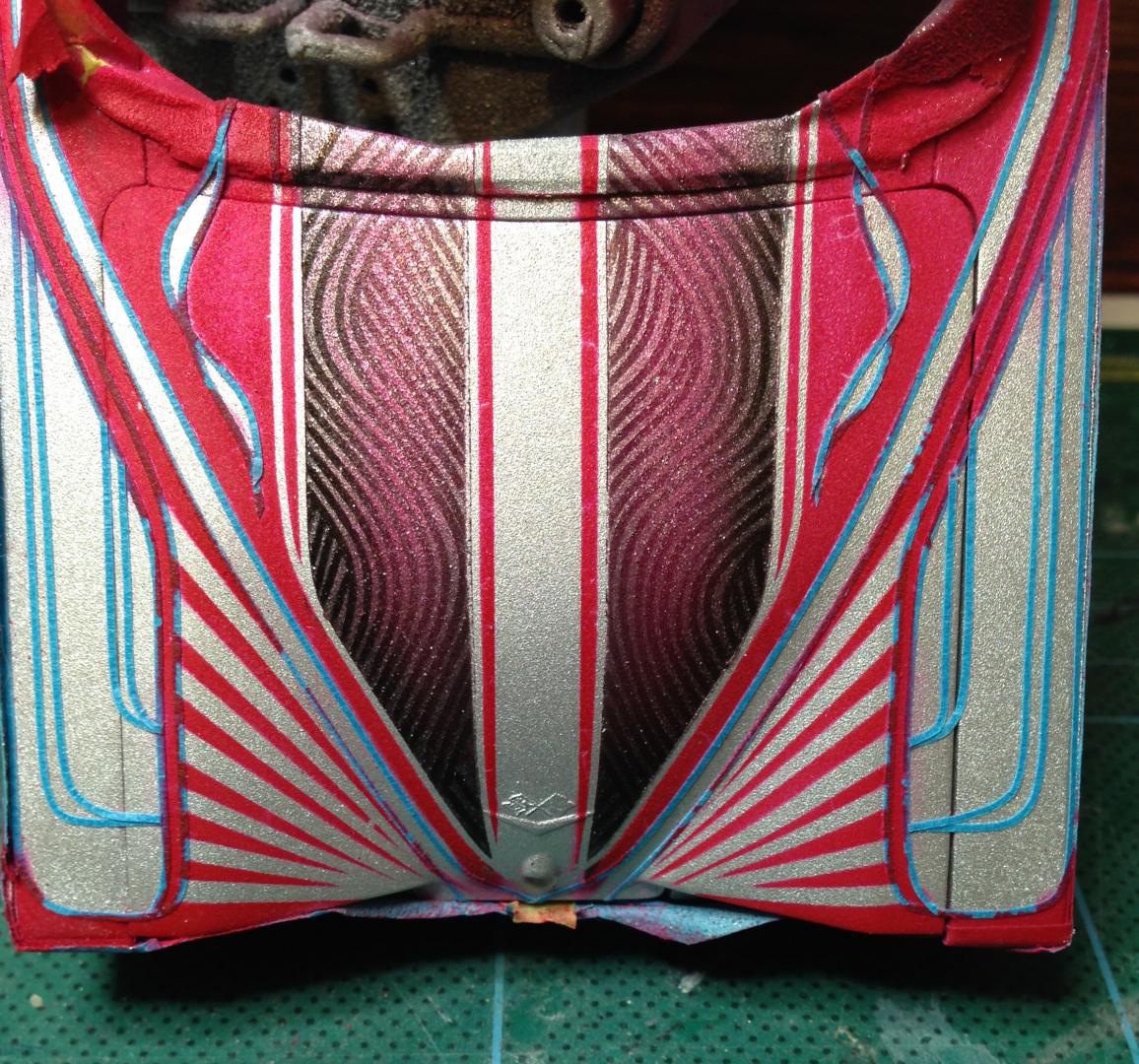

I've removed some more tape. The patterns are starting to gain clarity and I can see if it's anything like I imagined... glad to say it is ?
  • Like 1
That is looking great Guy! Lots of inspiration here. Thanks. I may end up getting back on to my 65 Impala because of this. I had made a mistake in the pattern and rather than strip it I set it aside. Now I think I may be able to cover it with a darker color or another pattern to hide it. Thanks for posting your progress.

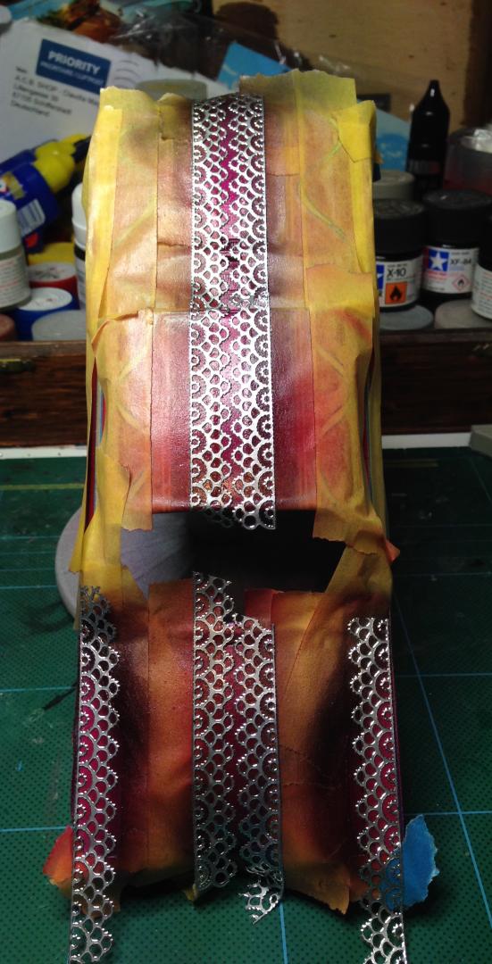

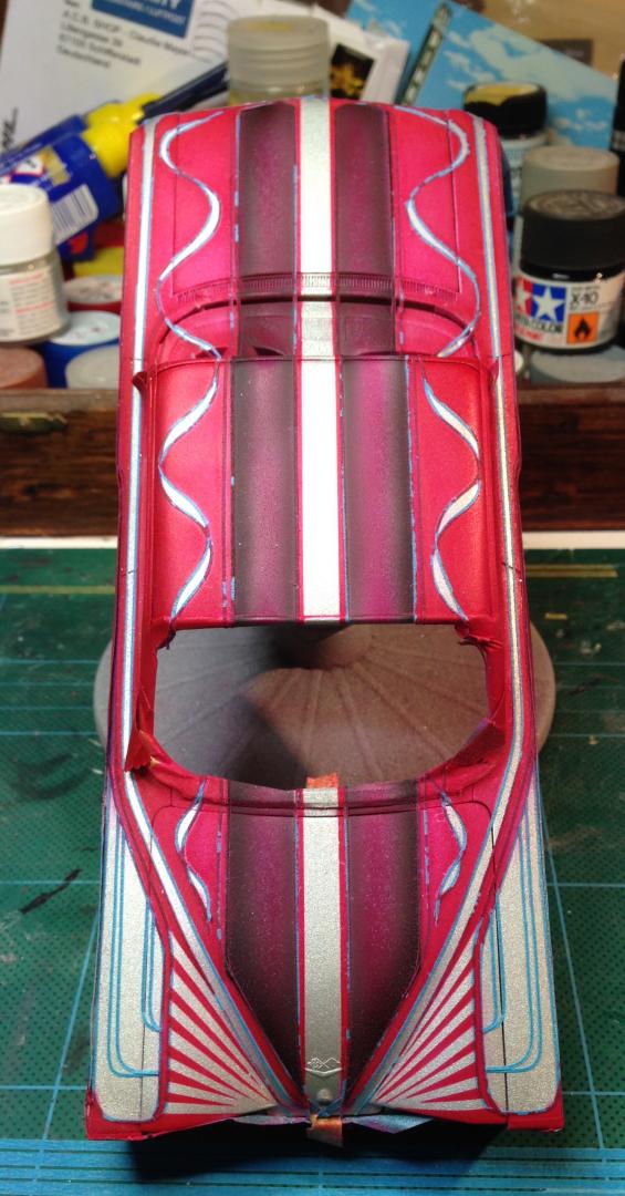

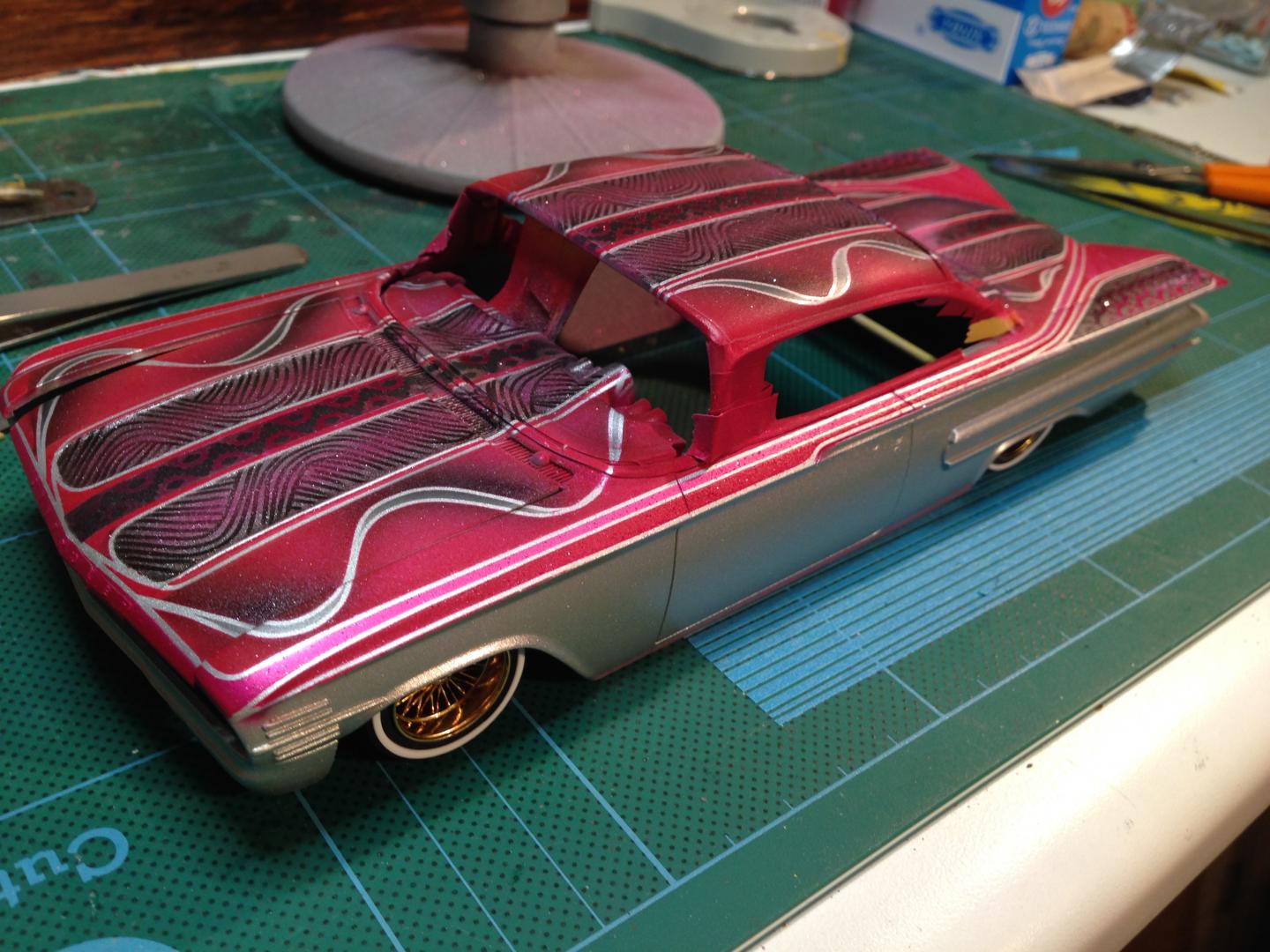

got a lot done today. Changed my mind about what to do on top of the fins. I found some self adhesive border pattern (for greeting card hobbyists). Some careful placement rendered a nice lace-style pattern. I used the same in the centre line.

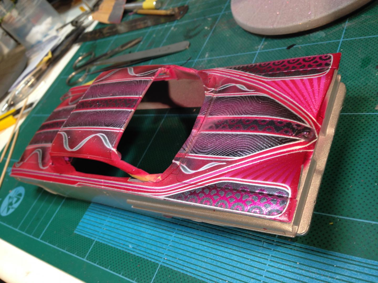

 I added shading to the twirling ribbon and finally shot raspberry glitter nail polish over the remaining silver areas.
when the tape came off, I'm glad to say it looked as it did in my mind's eye ?
I was going to go for mica white with silver pinstripes on the sides, but I like the way the silver pinstripes in the red areas tie in with the sides. Kinda makes the whole design more cohesive, I reckon.
