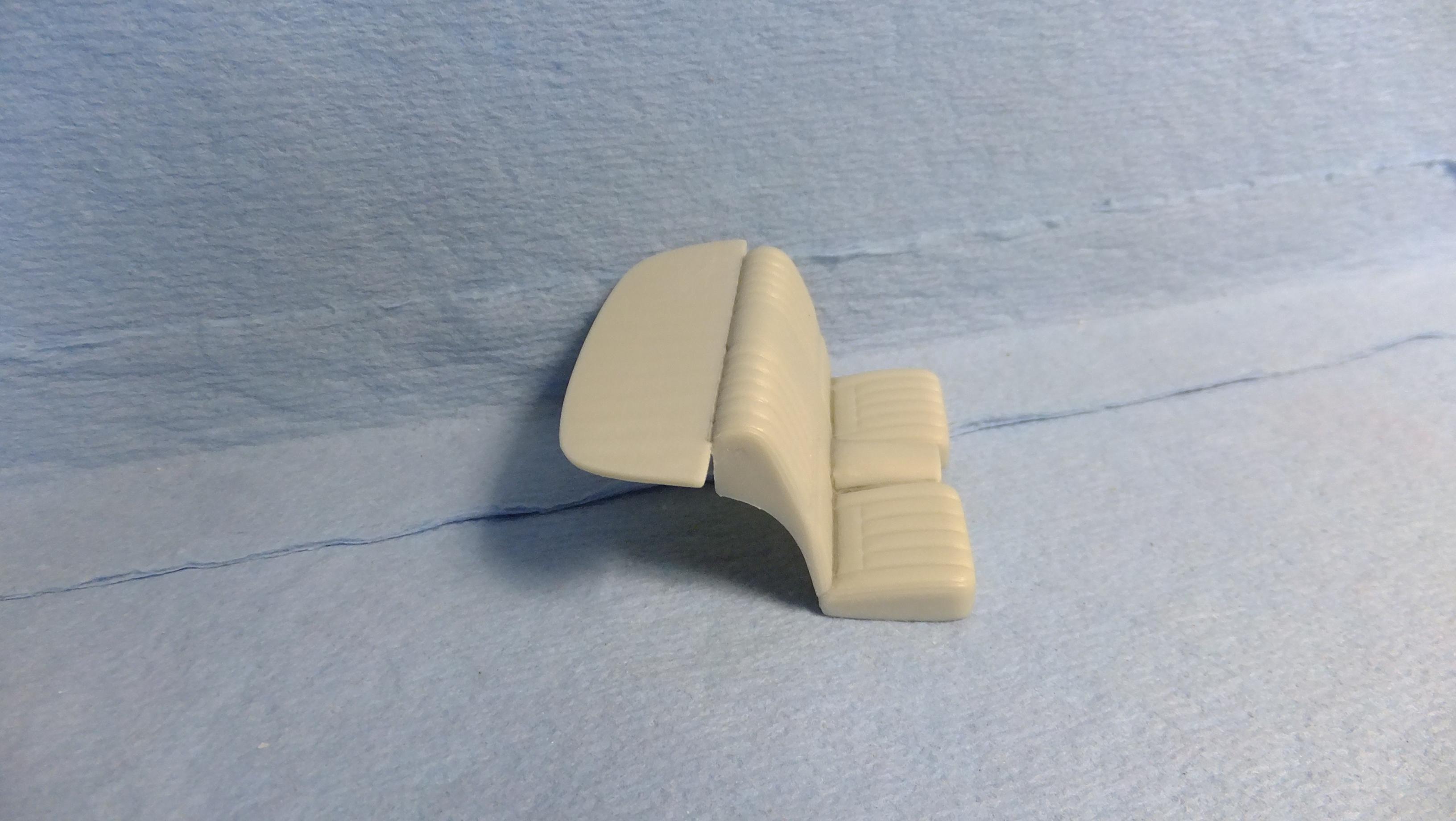

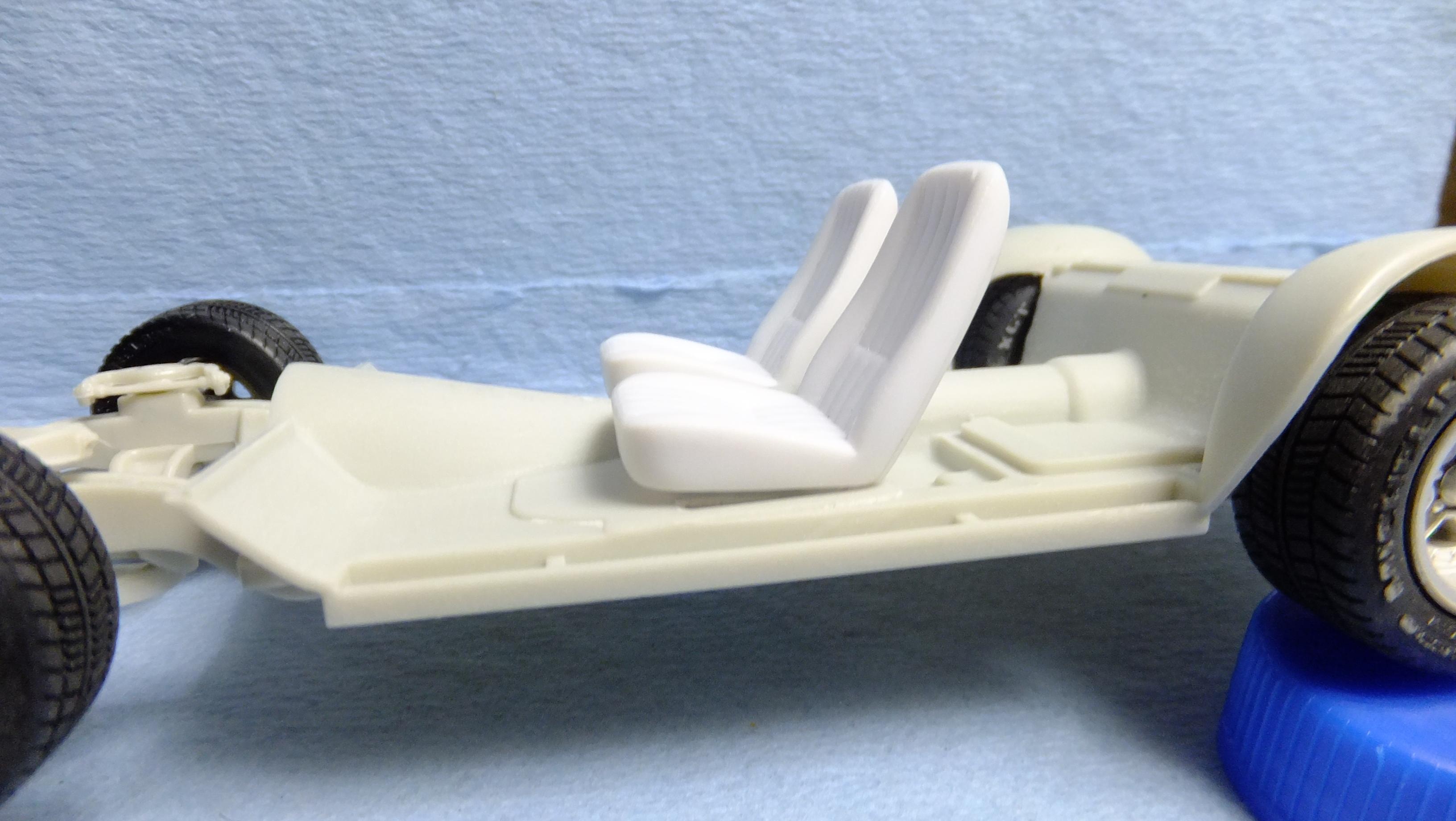

Heres a little bit of an update...the start of my custom guage cluster, and other interior bits.

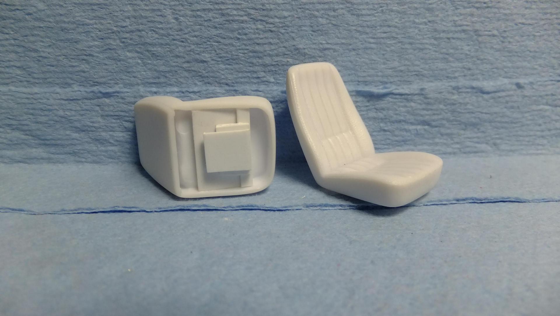

-Photo 3&4; After rounding off the Corvette seats for a more realistic cushioned look, i had to get them off the floor, so i used styrene to do this.

Hmmmmm. I thought i was the only one elevating front seats to slightly above the carpet. My method much simpler, though. Maybe i should make a post in Tips..........
BTW, nice work so far.
Edited by Slick Shifter
Thanks, i hate seats on the floor, lol

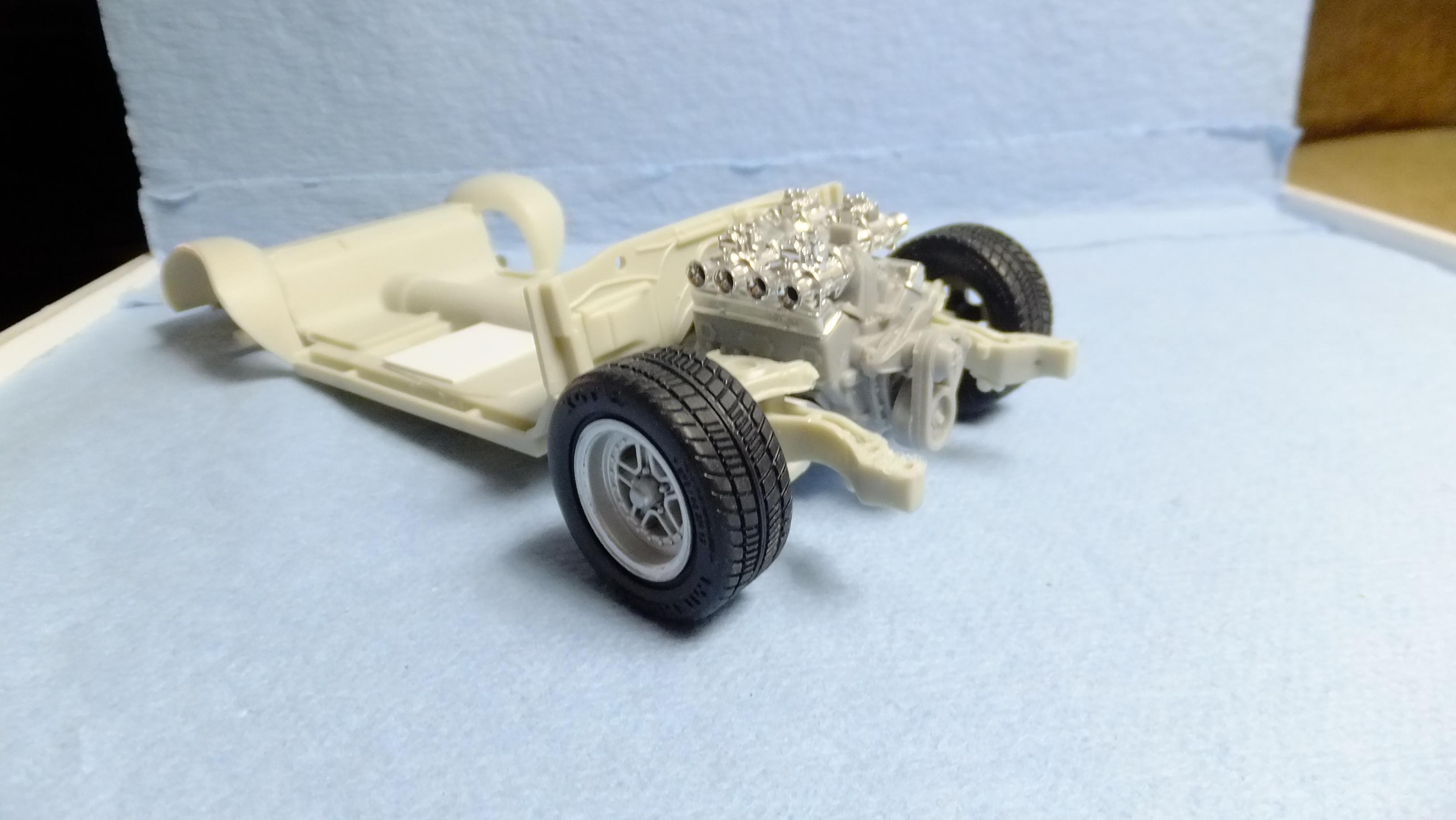

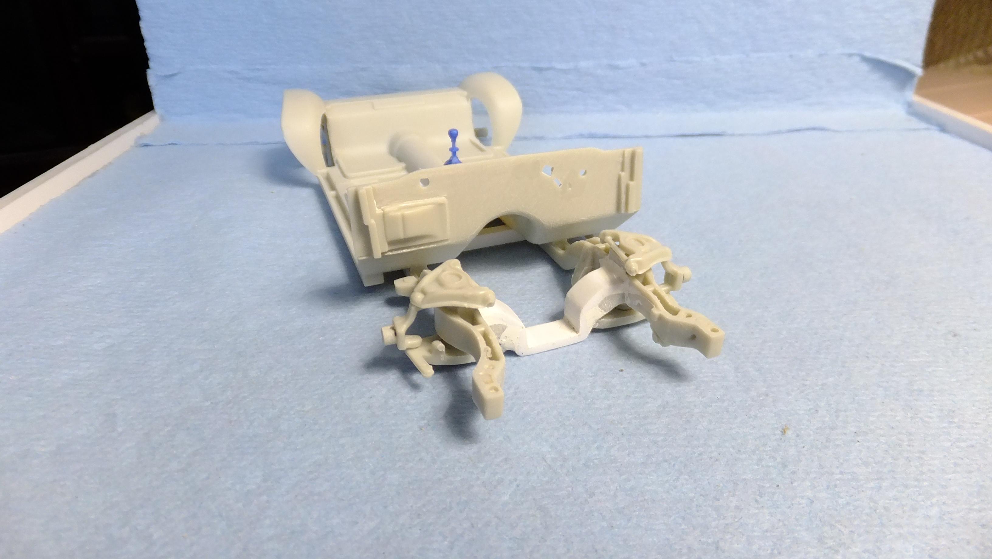

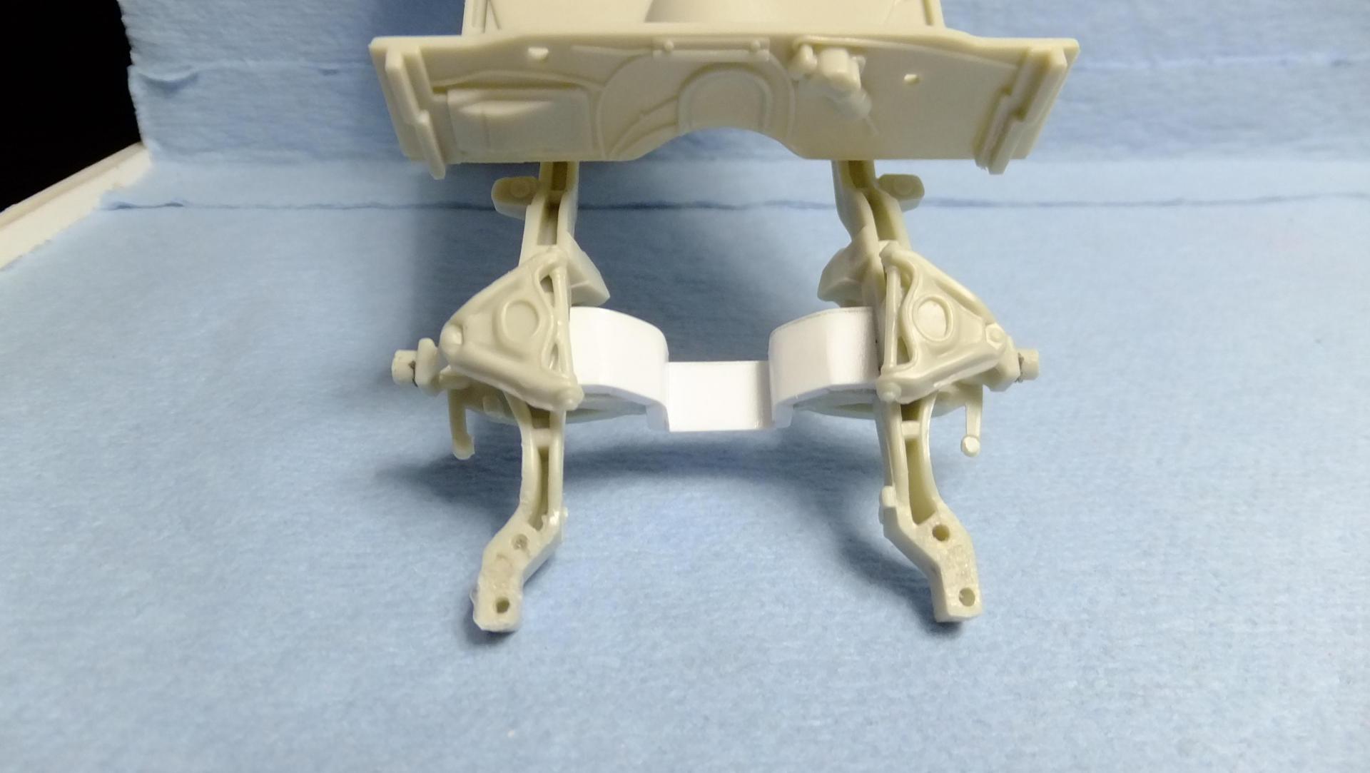

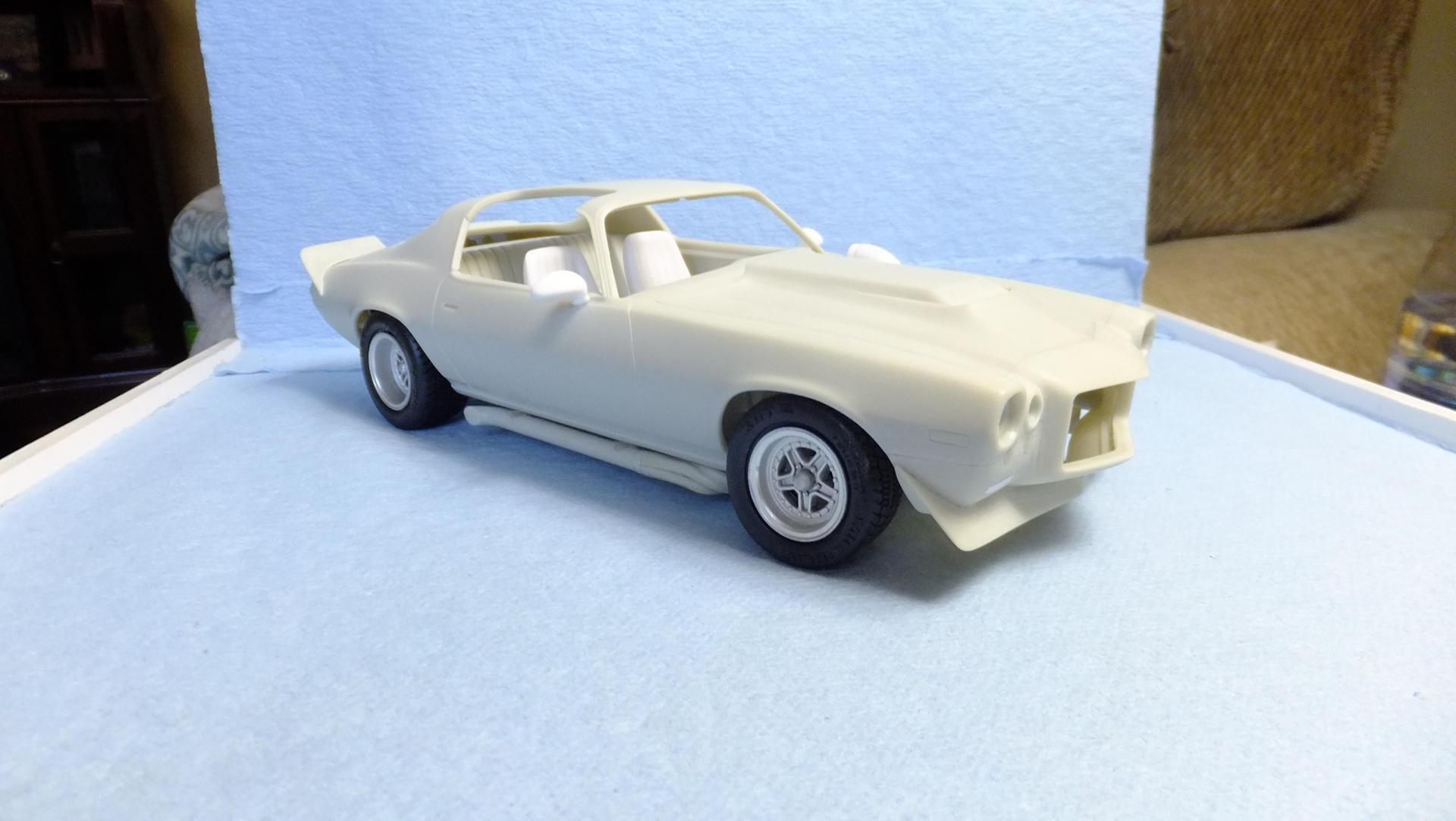

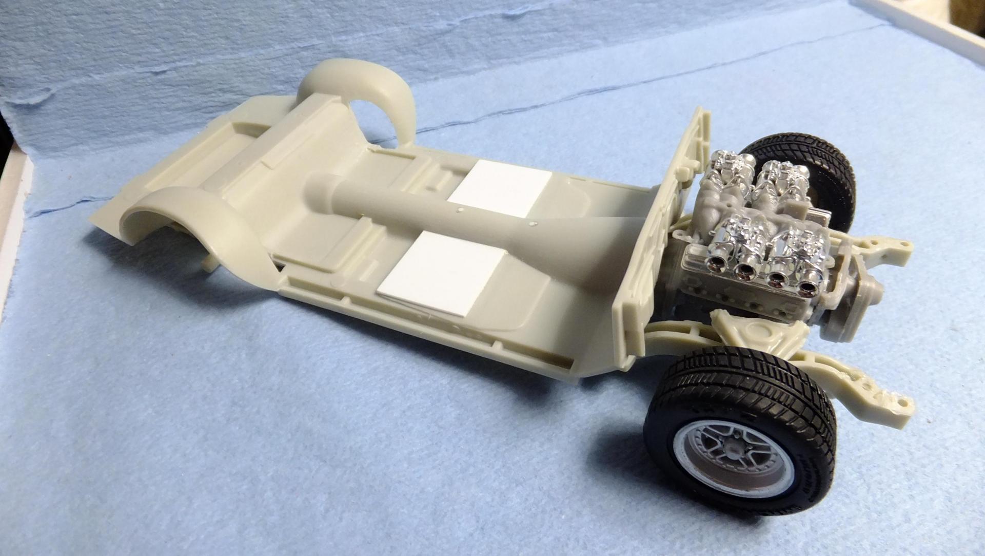

Moving along with this build as well....got a bunch of rough work in, now its time to sand it all....painting should be right around the corner!

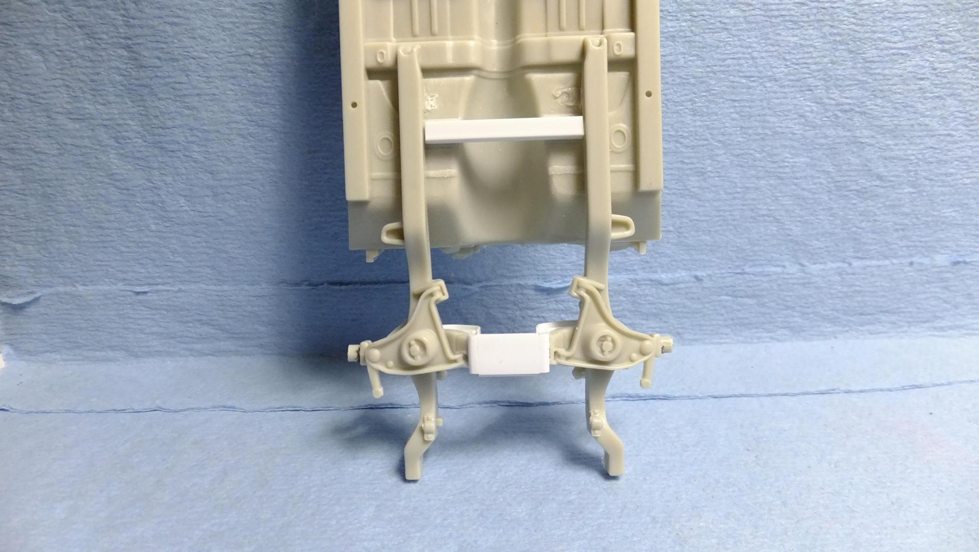

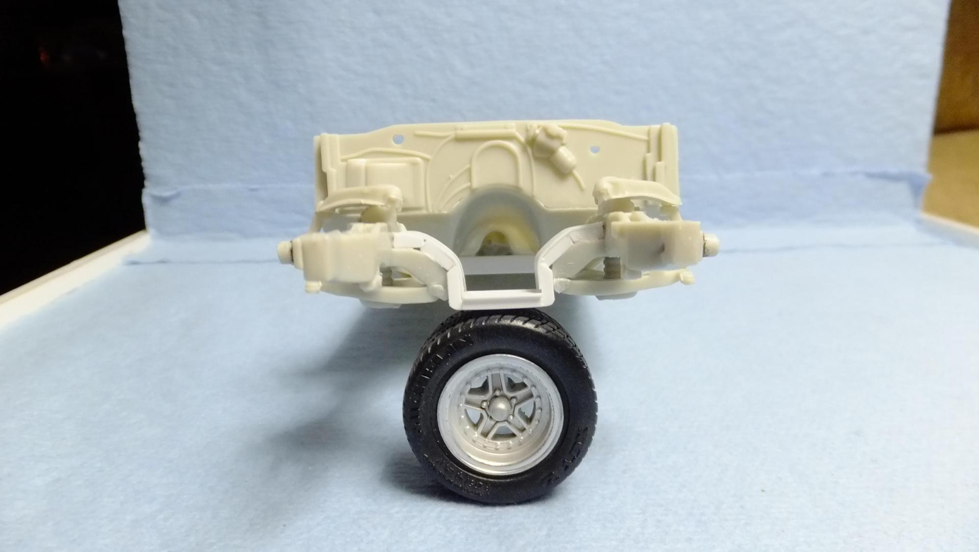

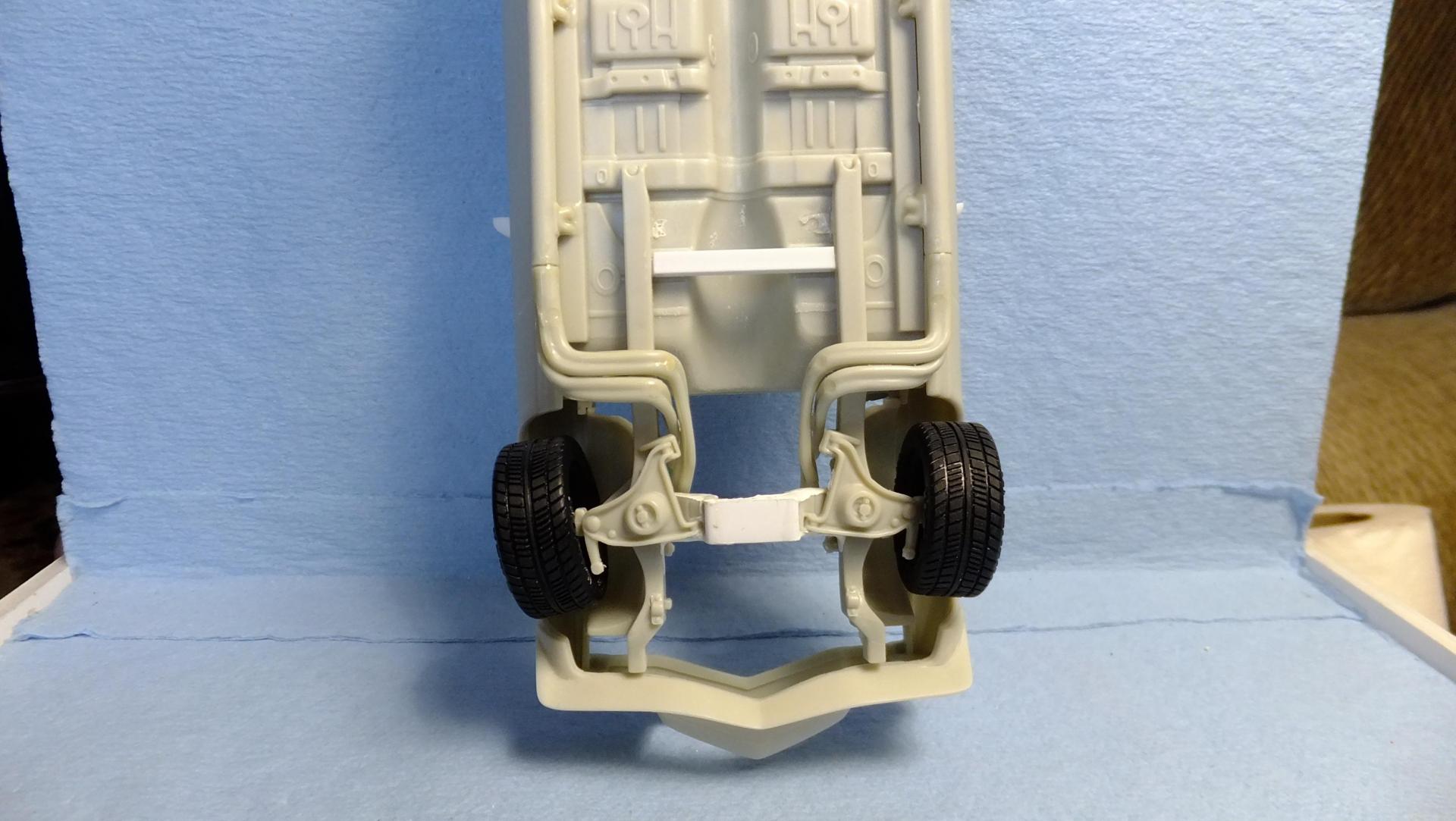

-Photo 1; In order to fit the Grand Sports motor, i had to get rid of the existing tranny mount, and engine cradle. Then with strips of sheet styrene, i began to make new ones...I also removed the tie rod, and sway bar for now.
-Photo 2&3; For strength, as well as a nice finished look, i added a strip of Uber-fine styrene to cover all the joints on the top side. You can see from the straight on photo what it looked like before i added putty.
-Photo 4; The engine fits great!!

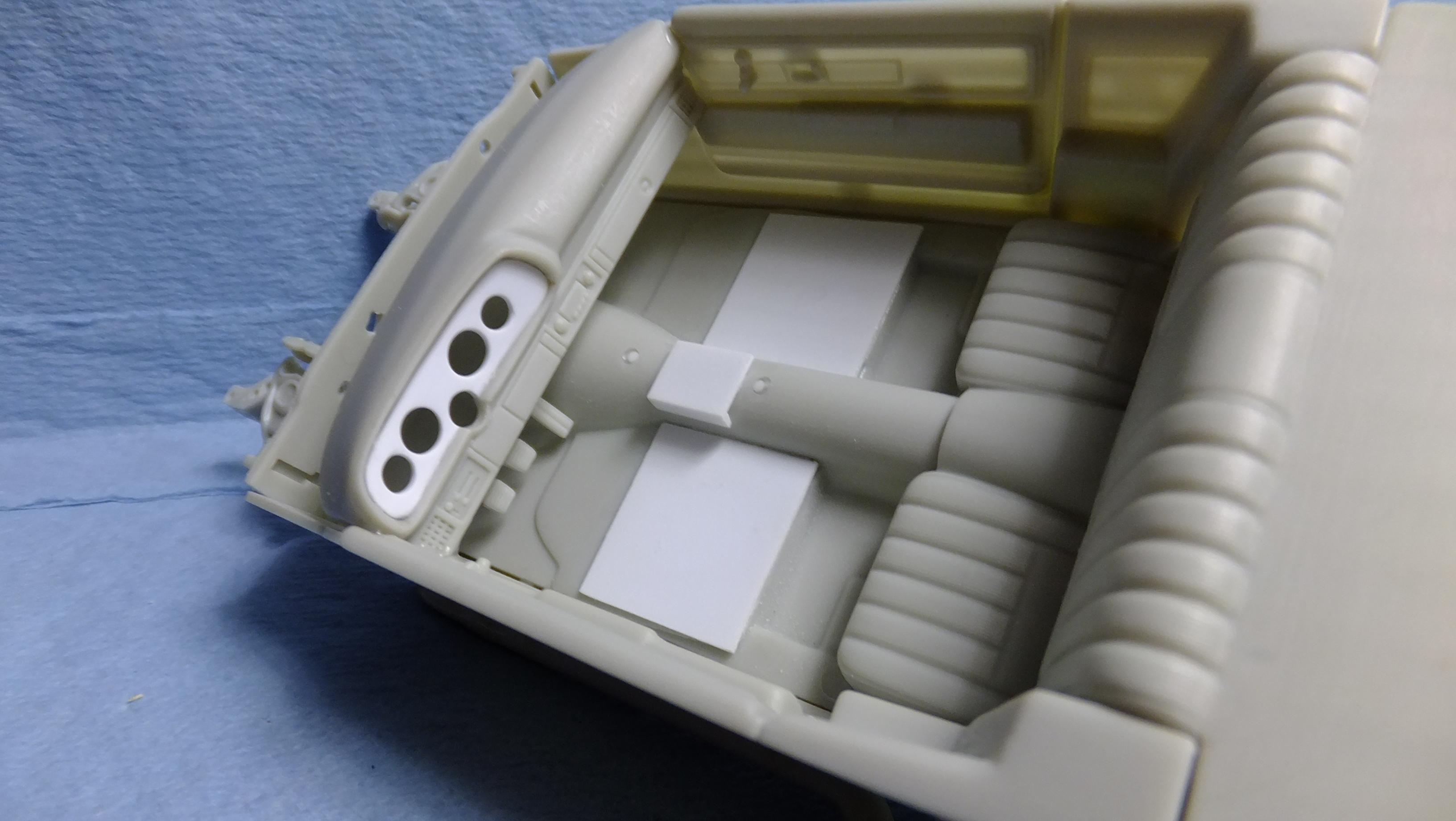

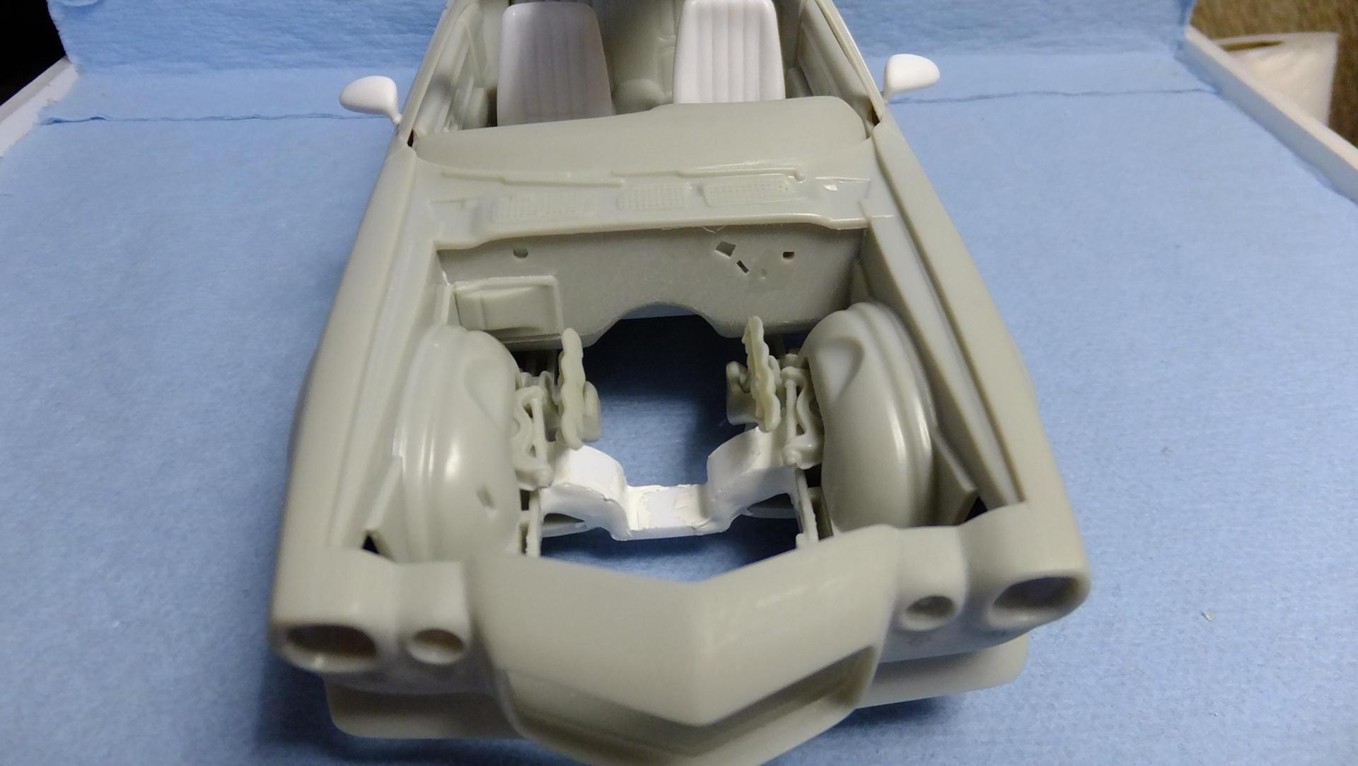

-Photo 5; I found that i needed to add styrene to the floor under the seats. The seats wouldnt set right for me without it.
-Photo 6; A quick mock-up...its looking just as i hoped!
-Photo 7; I sanded off all the molded in firewall detail.
-Photo 8; Although this is one of AMT's best kits, the interiors side panel fitment isnt that great...notice the gap between the door card, and door itself -unsightly....sometimes i dont mind gaps...especially before the painting proccess adds its thickness, but this gap isnt even even with the body....i will have to tweak something....Hmmmm.
-Photo 9; Here i temperarily attached the side pipes to the chassis, so that i could perminantly glue the headers to them in the proper position.

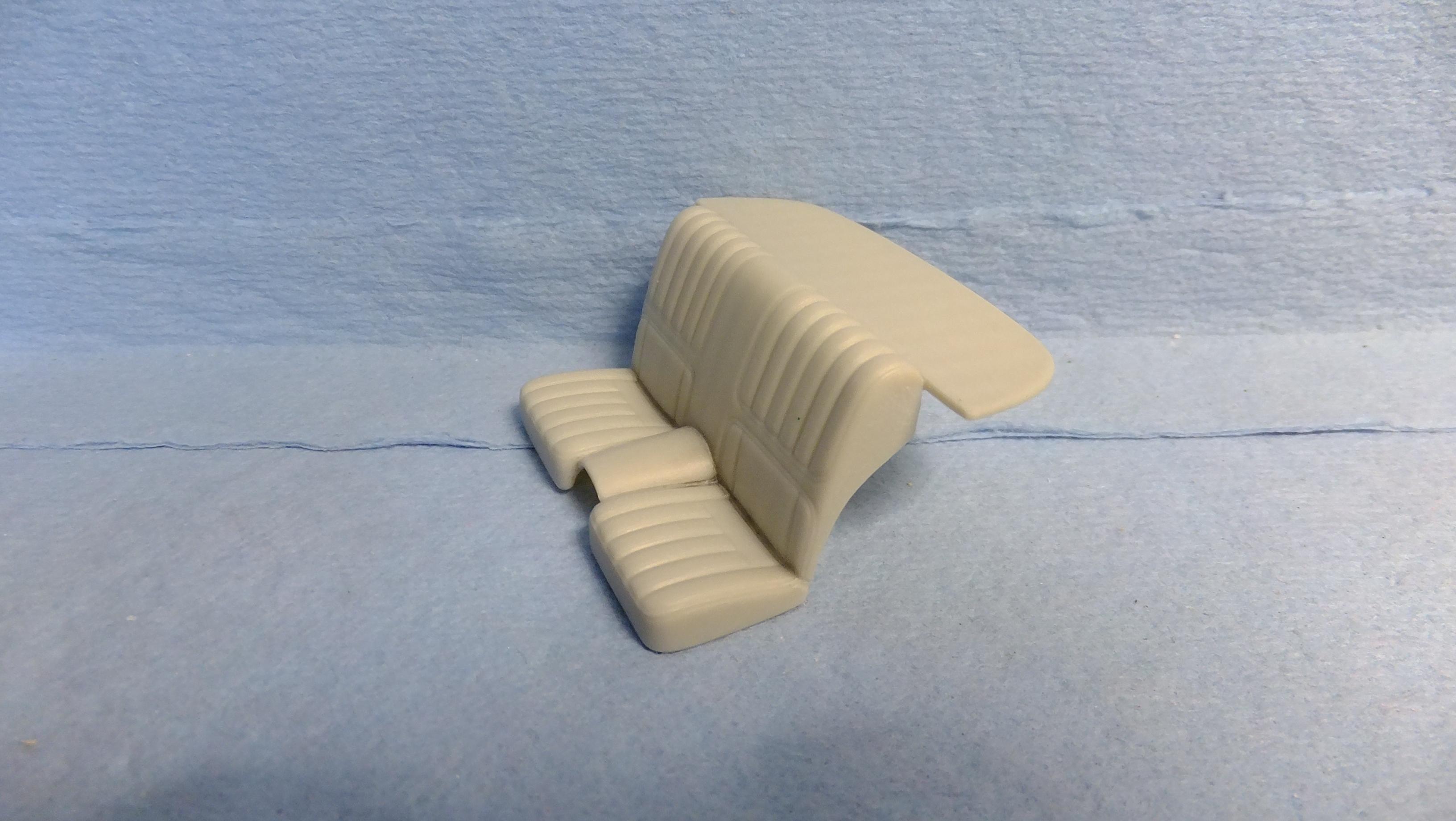

-Photo 2; In order to move along on the interior work, i needed to add a shifter base. Next will be adding vents to the dash top, re-scribing the door card seams, and making the rear seat look like its NOT part of the parcel tray.

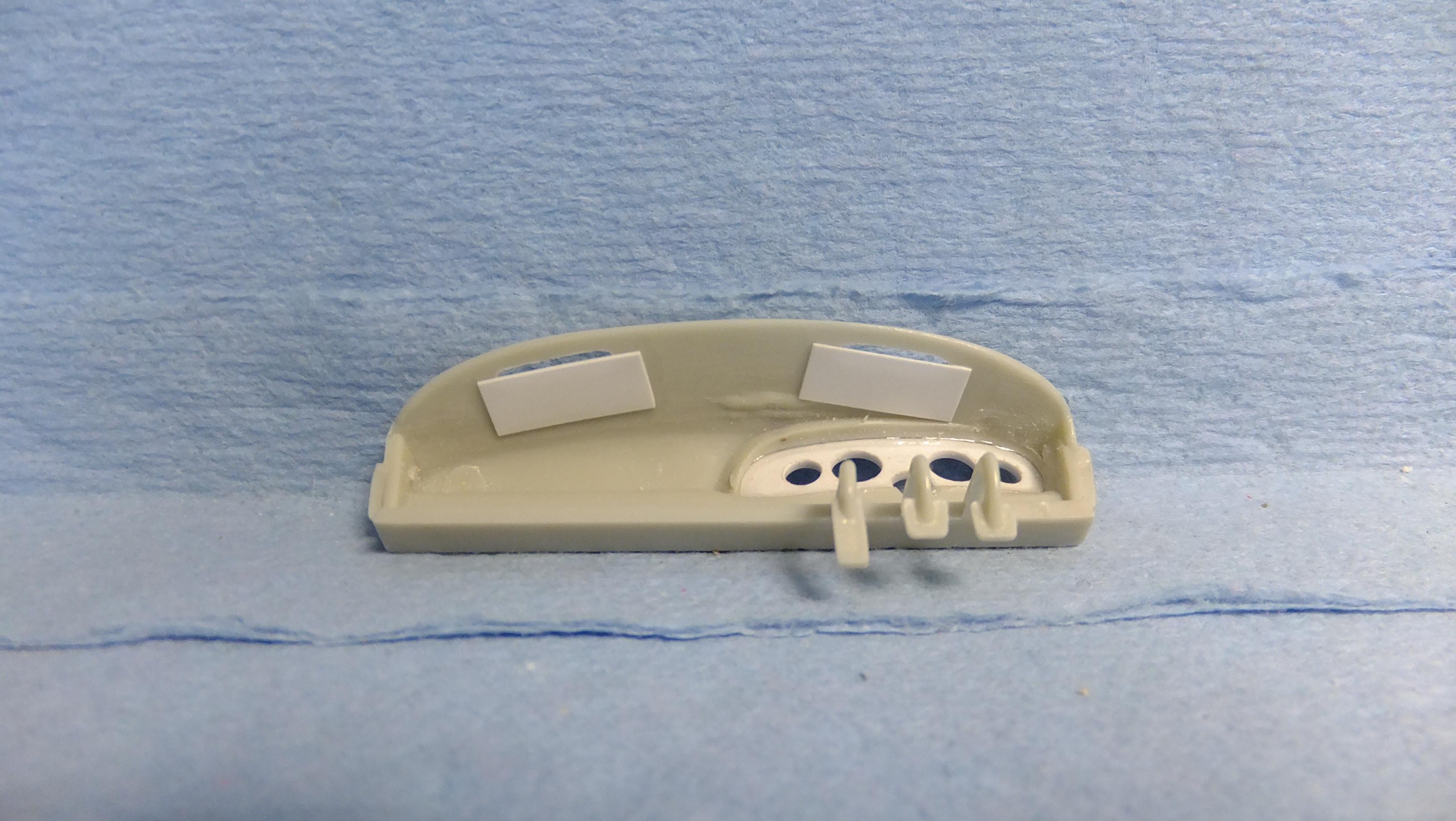

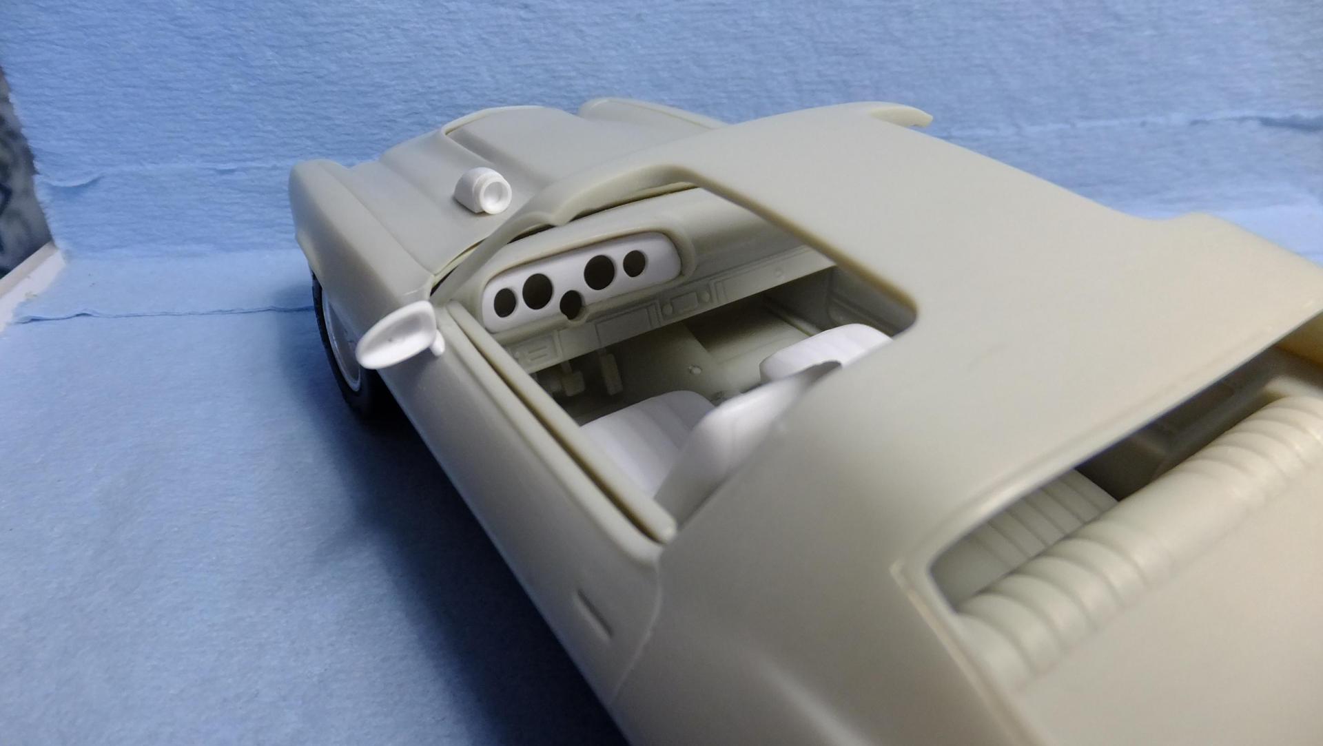

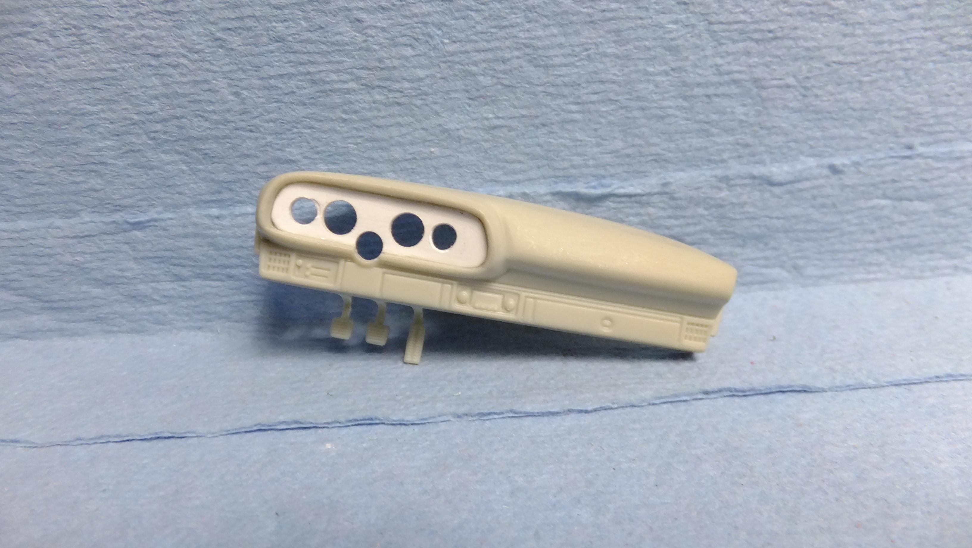

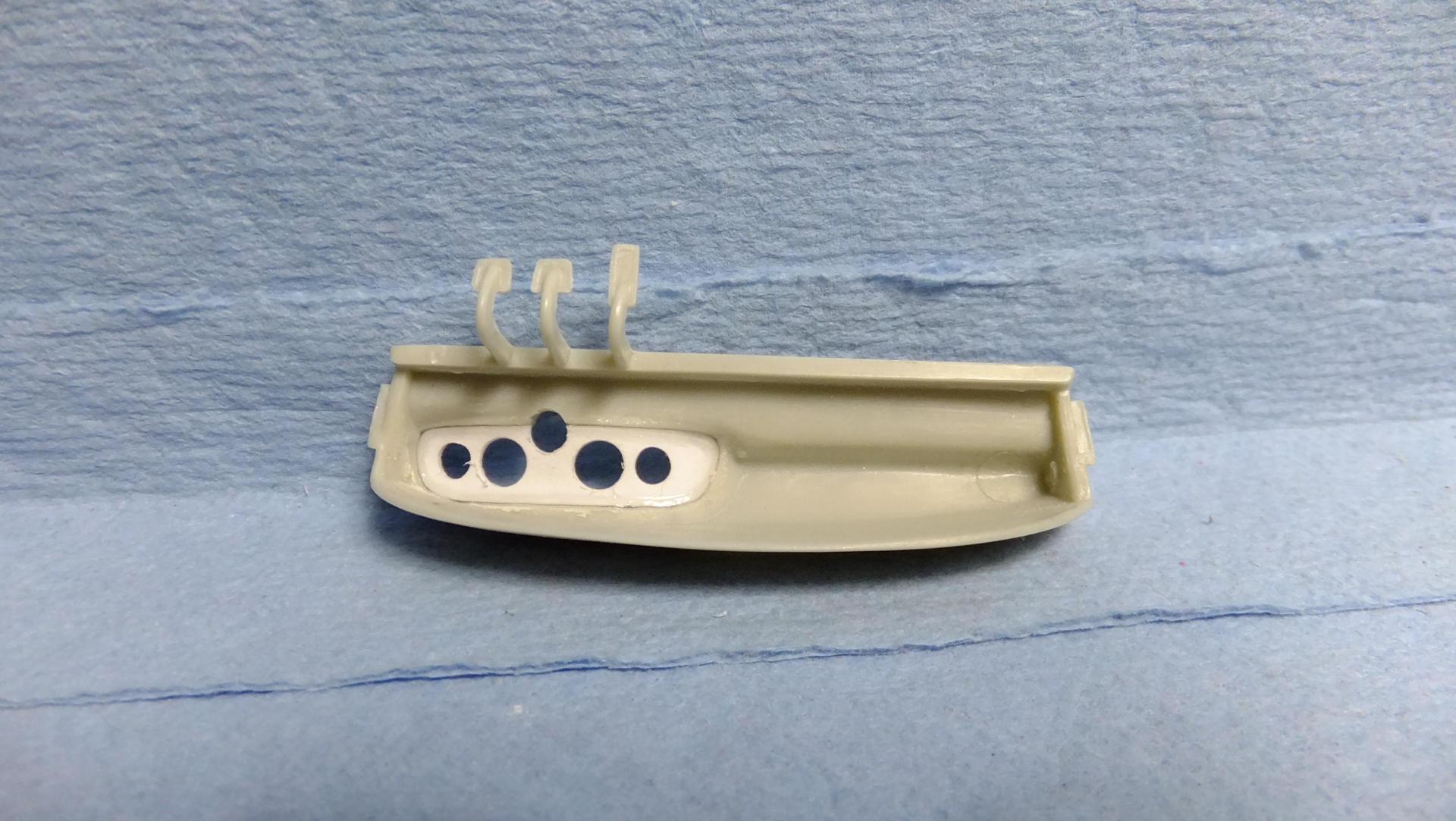

-Photo 1&2; Not sure why the speaker, and vents werent on the dash top, but they needed them...here are the vents...the speaker is on its way.

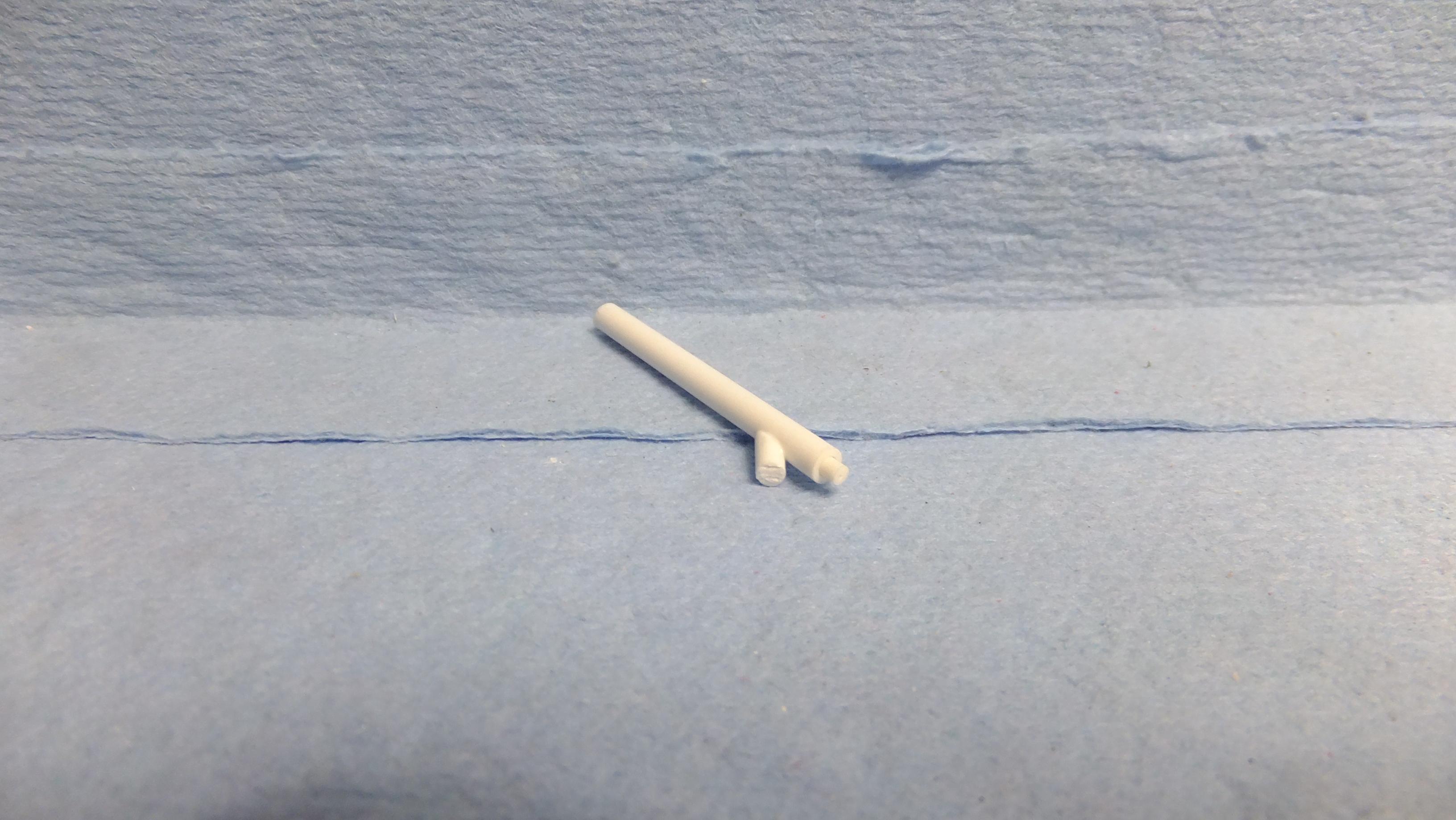

-Photo 3; Styrene rod column...Fujimi Ferrari 288 GTO steering wheel, and a turn signal stalk that i had laying around.
-Photo 4; Its gonna do the job...
-Photo 5; Its hard to tell i guess, but i scribed the door seams deeper.
-Photo 6-10; Scribing the seats to help convey separate cushions, and to give a more realistic look, really does work well!

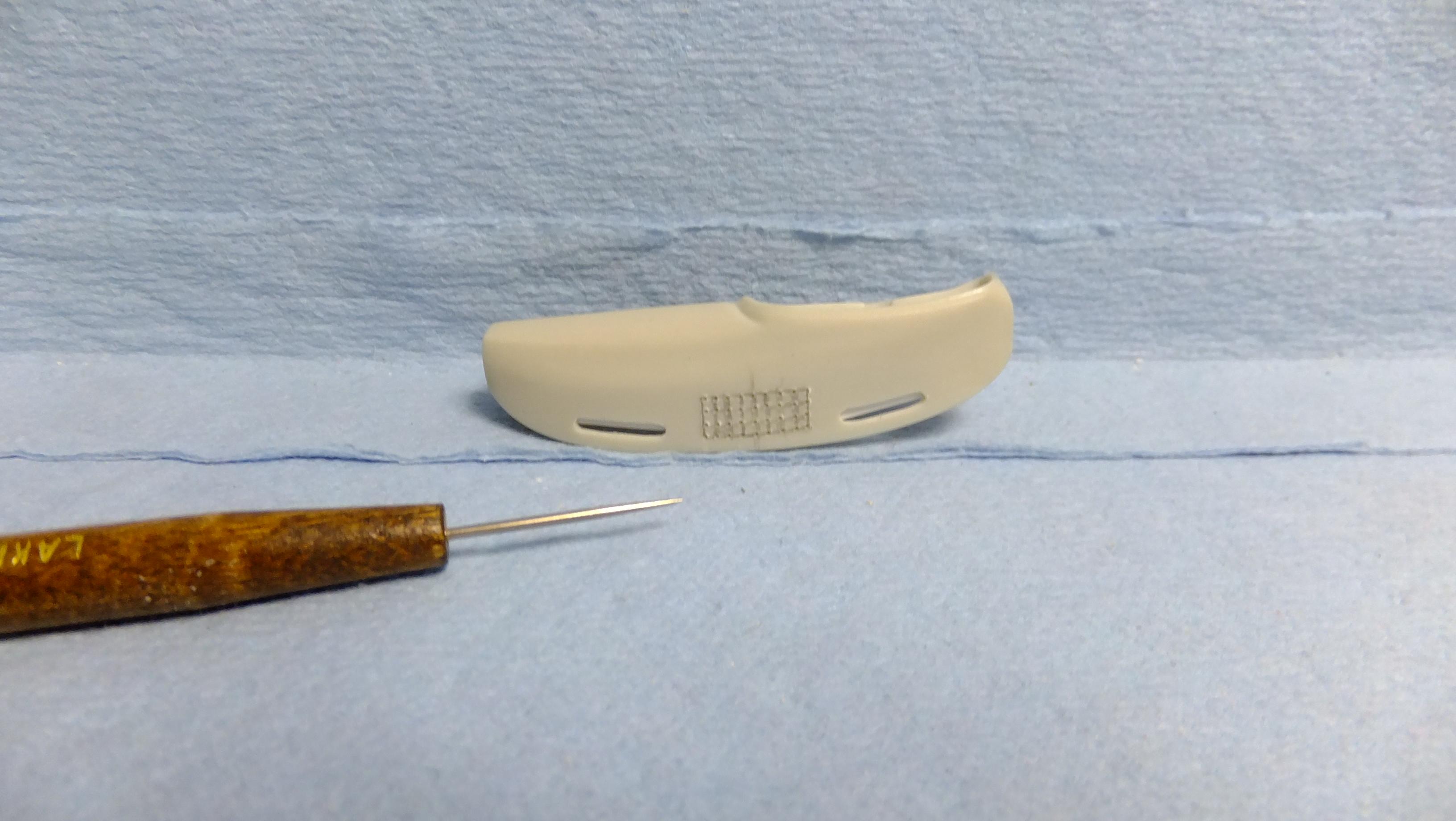

A bit more done on the dash here. To make the speaker, i drew out a grid, then used a poker to make the holes. this is the first time trying this method, and i think it turned out okay, but i may fill it and try something different -still thinking on it. Next i will add some trim around the guage cluster for visual interest.

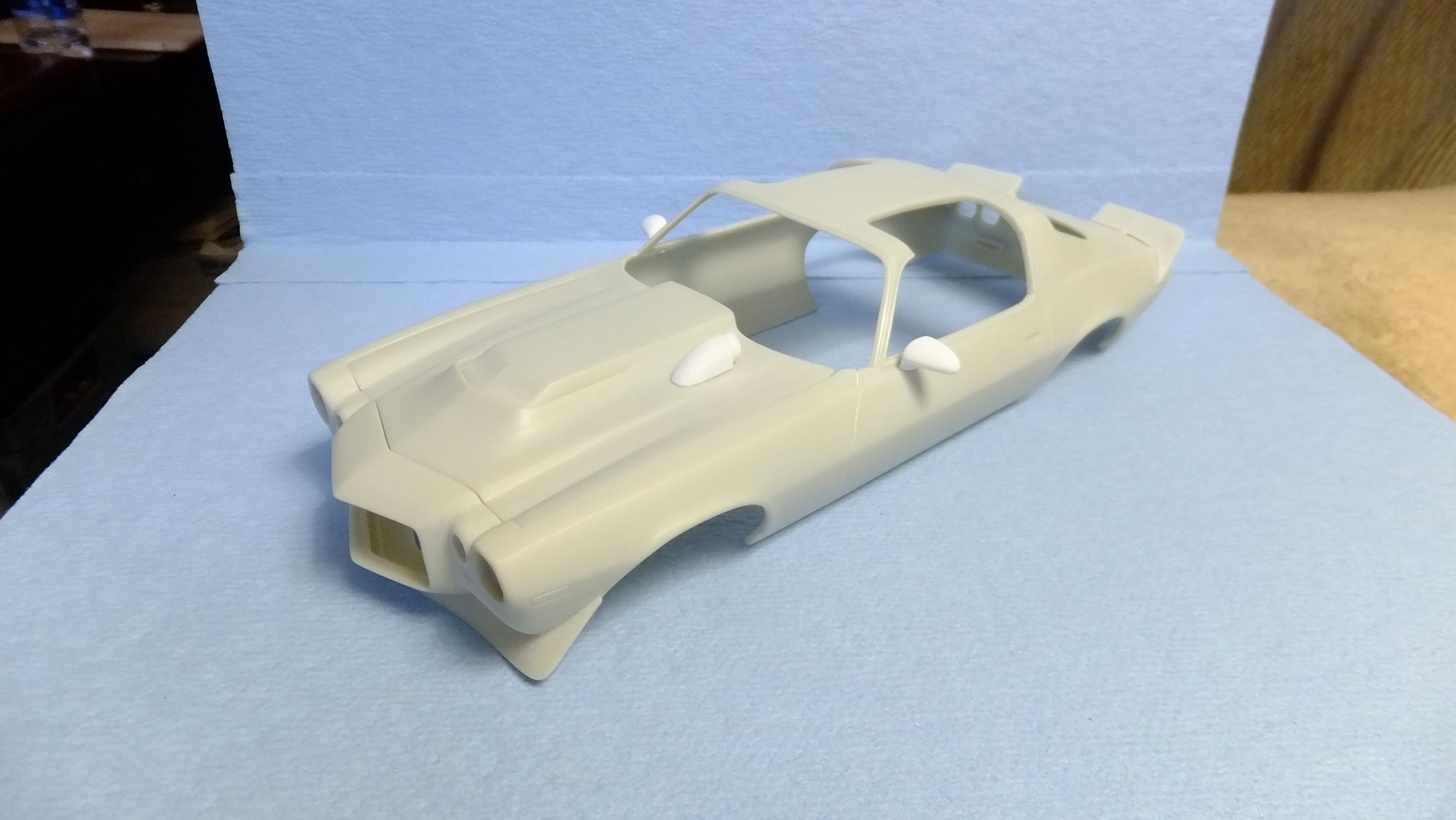

Great build as always! First time I se a early 2gen t-top. Have only seen the face lift version with It. And trans am of course, but I have believe they open more than yours.
Thanks, Anton!...yes they do open wider, i wanted shallow openings.
