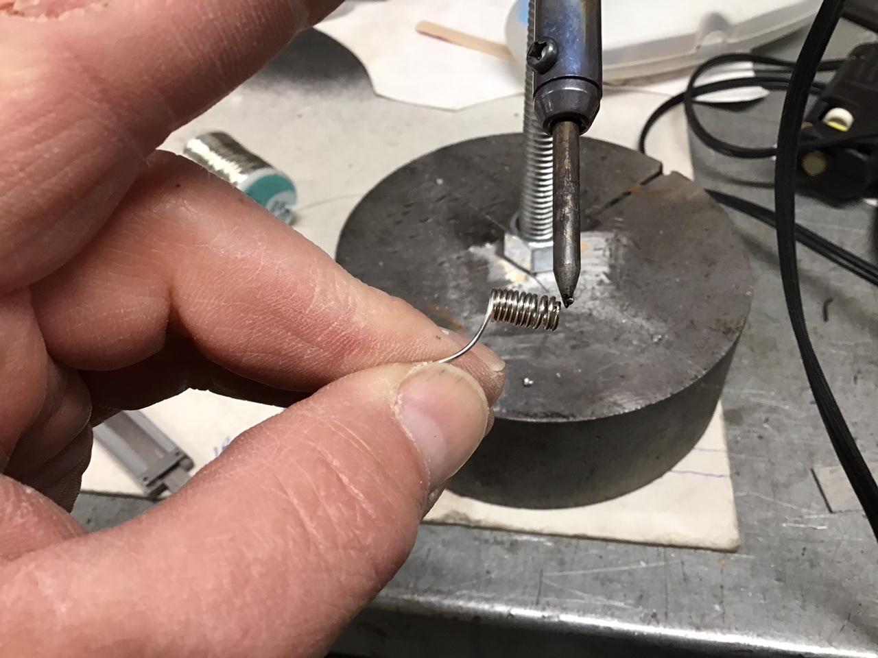

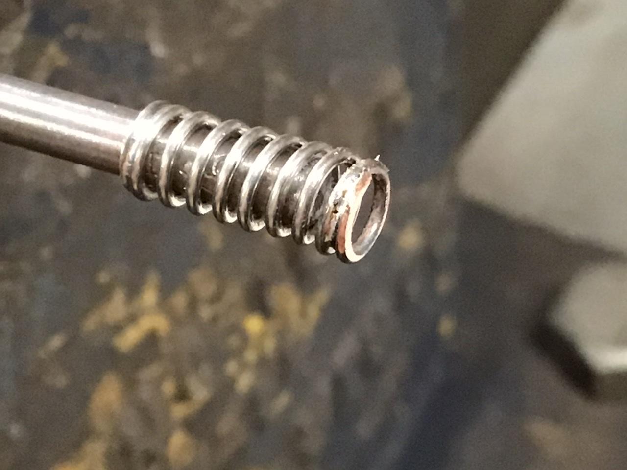

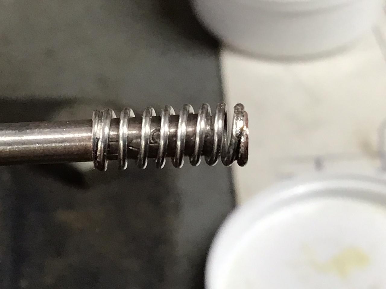

NOBLNG Posted May 6, 2020 Posted May 6, 2020 (edited) This is how I am making them now. I used 20 ga. Copper wire, which is .033” diameter. At 1/25th scale this works out to 13/16” diameter in 1-1 scale. As described above, I wrapped it tightly around a drill bit. Then, starting one full wrap in I spread the coils by rolling it along a putty knife as a spacer. Then I soldered the cut tip to the next full wrap. Slide it back on the drill bit and file the end flat. Decide how many coils you need, cut and repeat the soldering and filing. Then length can be fine tuned by stretching or squashing it. Edited May 6, 2020 by NOBLNG

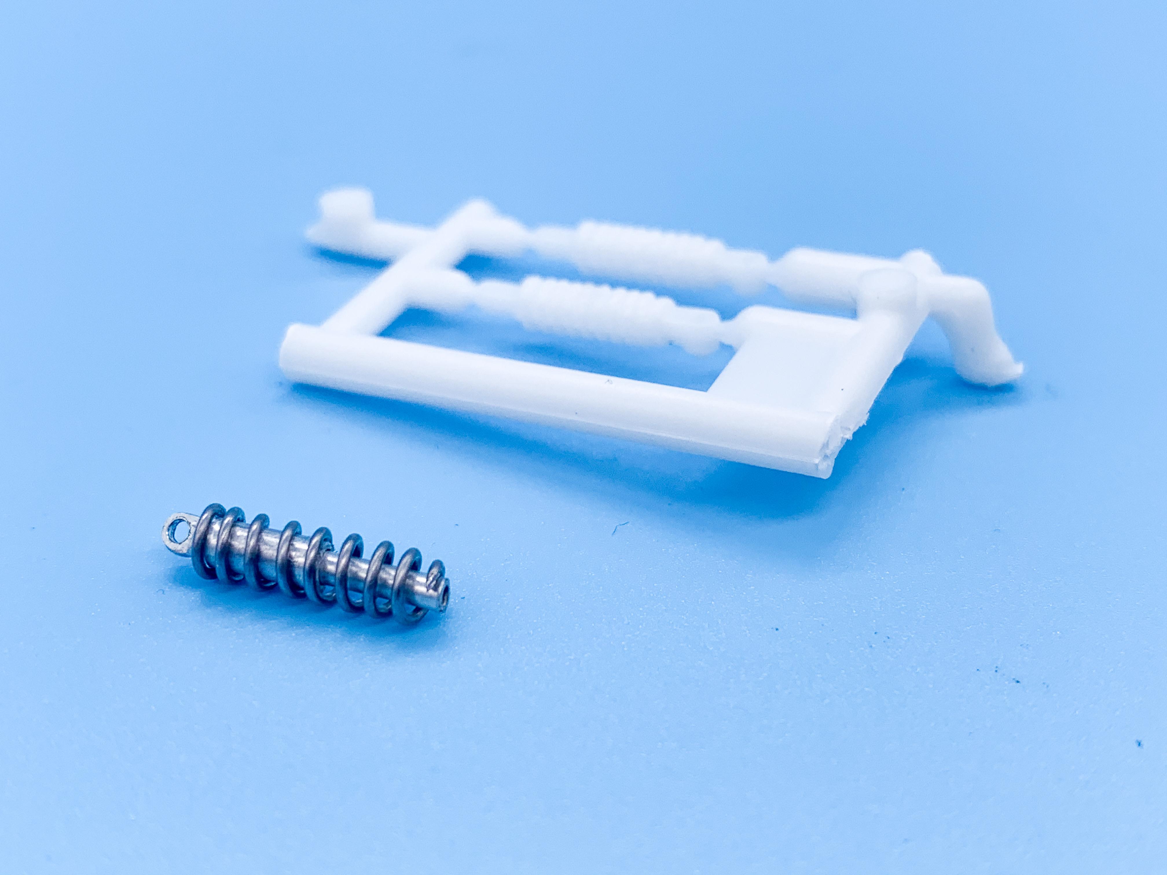

OldNYJim Posted May 7, 2020 Author Posted May 7, 2020 I forgot that I posted this...but I did spend most of yesterday trying to make a low-tech pair of coil-overs for my Deuce that I’m working on. I guess some of that advice above actually sank in! The ‘wrapping around a screw’ method worked best for me...I tried a few different materials and settled on a thin-gauge solder. It needed to be handed carefully but was easier to work with than any of the craft wires I had here for sure
