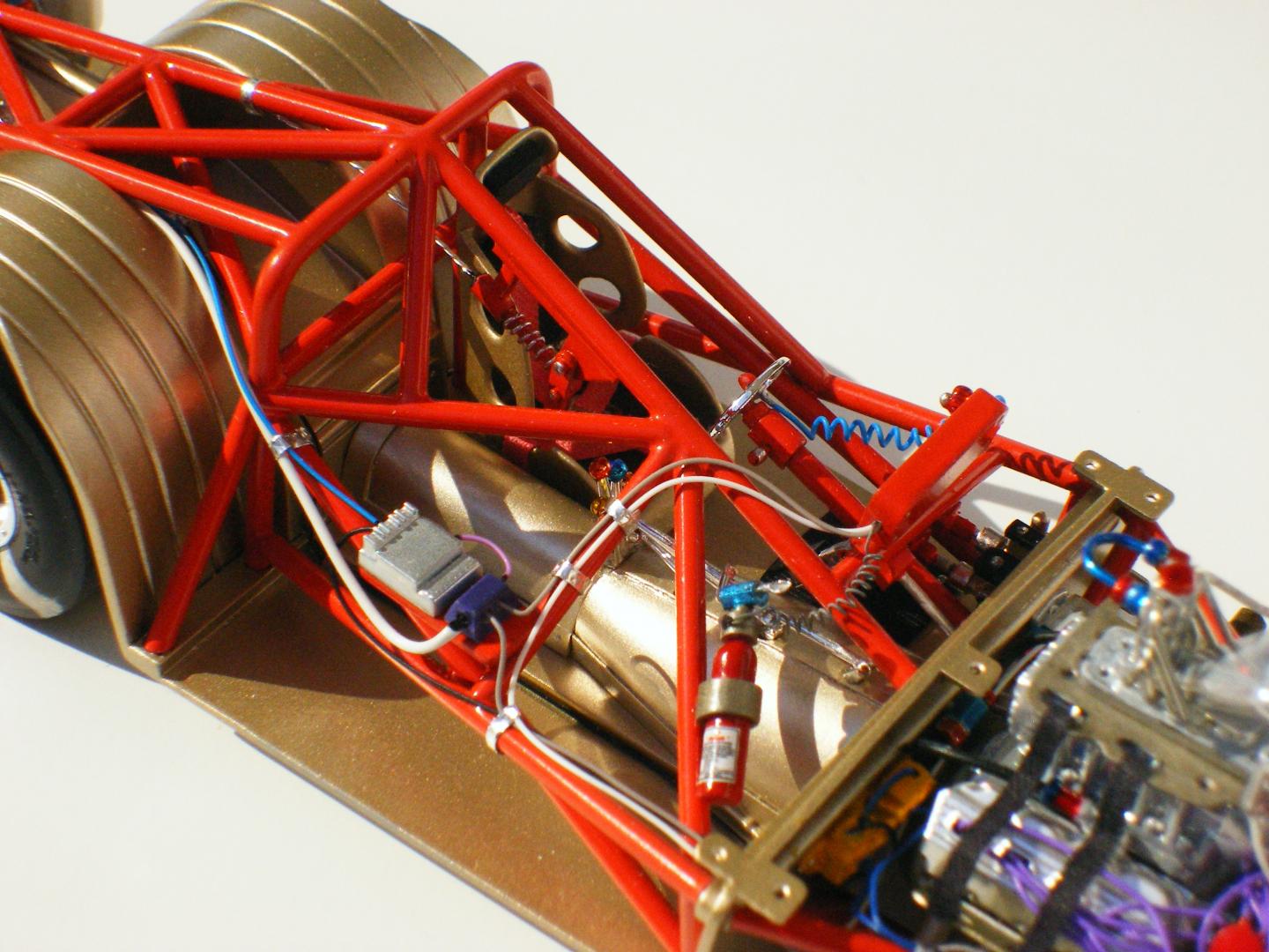

TarheelRick Posted May 12, 2019 Posted May 12, 2019 I built a "semi" pro-mod chassis for my Ford Escort using styrene rod rather than tubing - tubing seems to crack too easily. I also use MEK as a solvent. One word of CAUTION is to allow plenty of ventilation around your work area, MEK is some pretty nasty stuff and can cause 'drain bamage'. I used the Revell '55 Chevy Scott Carpenter knock-off as a pattern, just reduced the measurements to fit within the body of the Escort. Here are a couple of photos:
