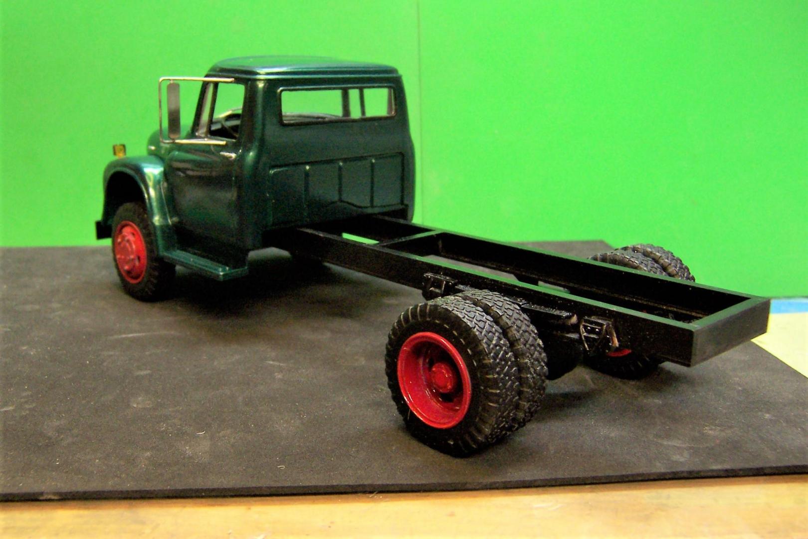

Rainy day today so got a little bit done. Got the rubber window gasket roughed in on the windshield and the roof window.  Made up a set of new doors that overlap the opening the proper way. Mounted the transfer case/transmission. Made and installed the driveshafts and installed the drivers compartment floor and roughed in the instrument panel. Also installed diamond plate on the fuel and hydraulic tanks. The window gasket looks so-so.  Lots of fine tuning to do.  I am almost tempted to build this without the optional cab but the crane operator would be very upset with me with the cold snowy winters here in Vermont!
