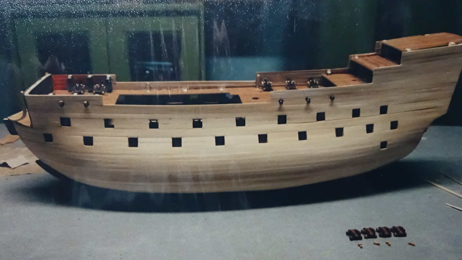

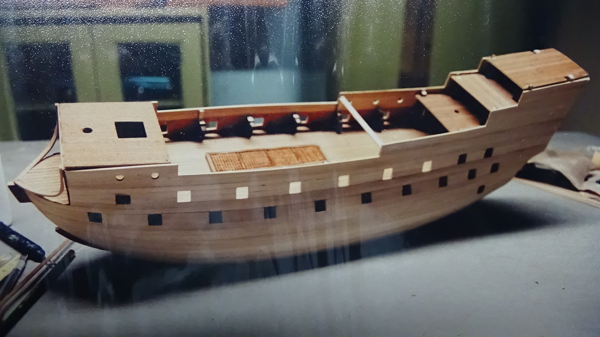

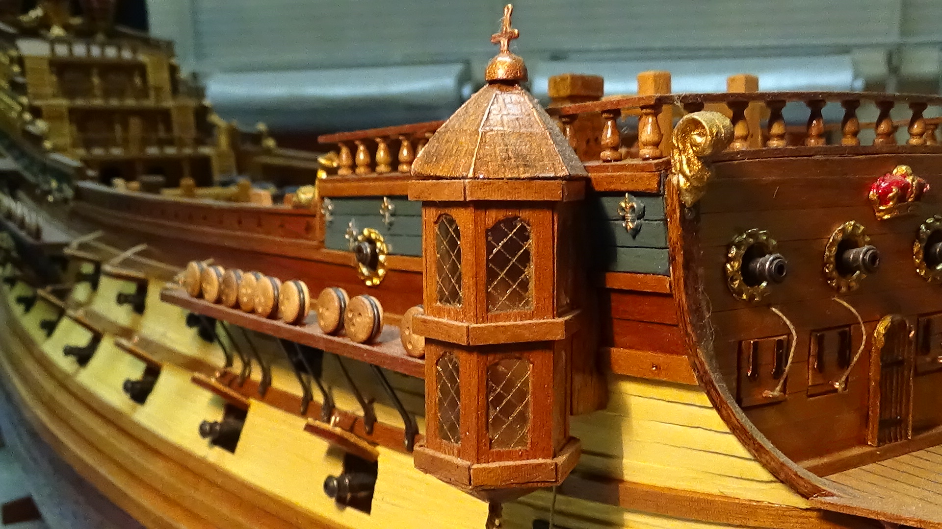

Ken Gilkeson Posted July 9, 2019 Author Posted July 9, 2019 first layer of planking about done. openings for windows in rear being worked on. top row of cannon openings laid out and stained. at this point the bottom floor has been planked and varnished. thanks all for your interest, more to come.

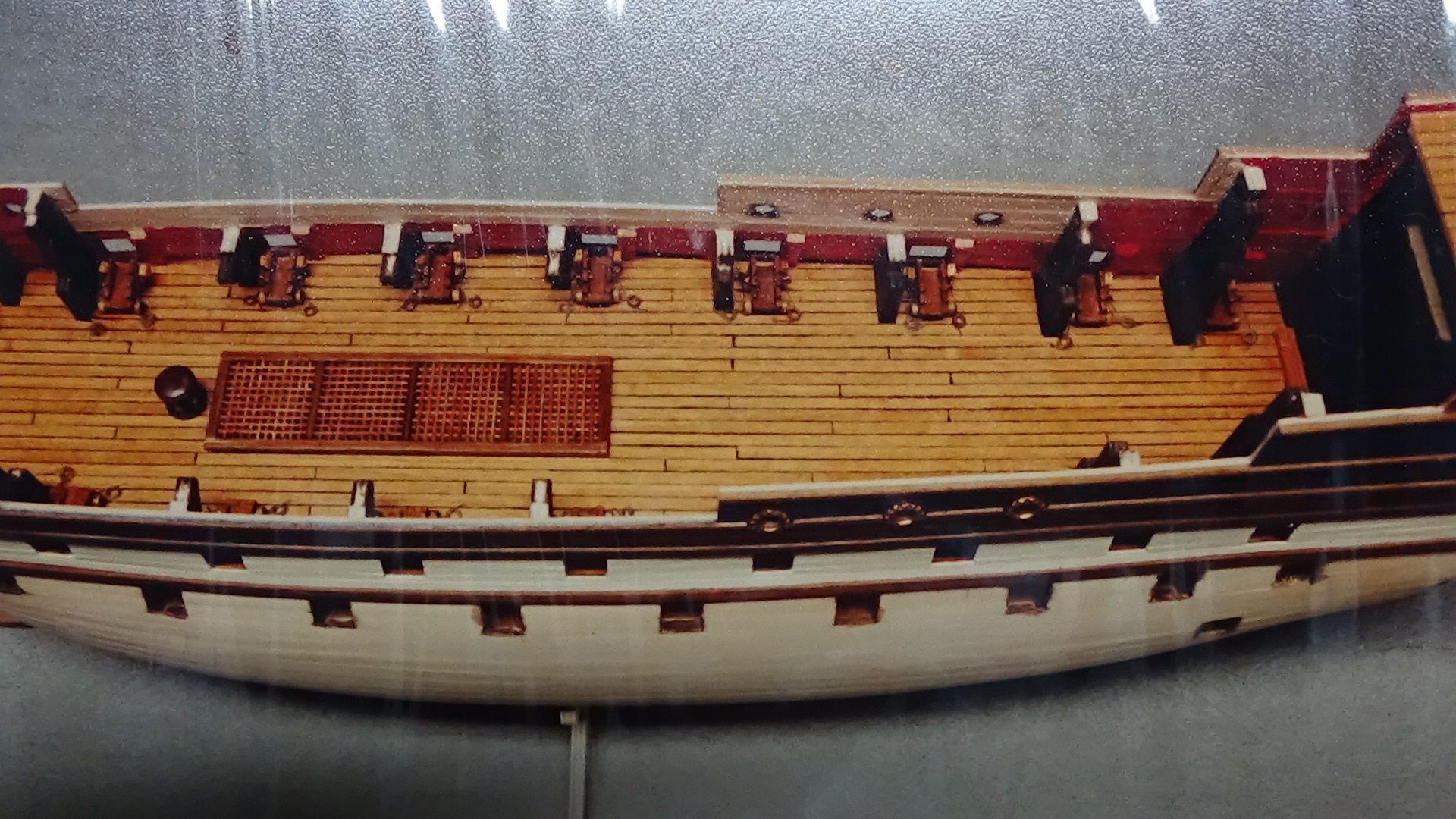

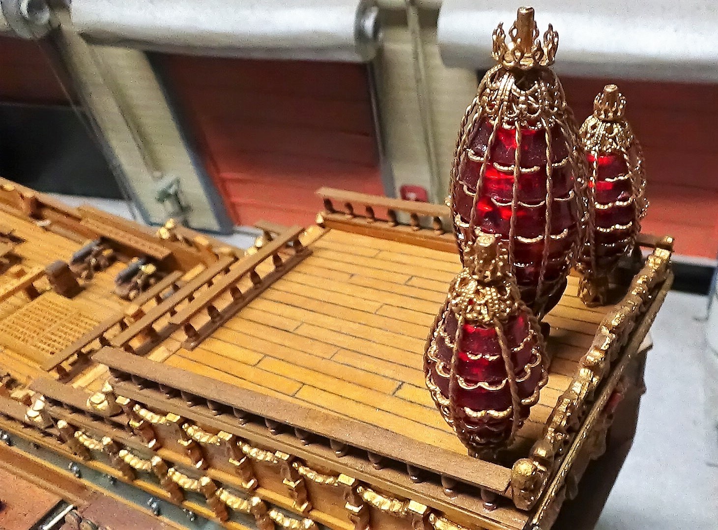

Ken Gilkeson Posted July 11, 2019 Author Posted July 11, 2019 finished gun deck, final planking started.

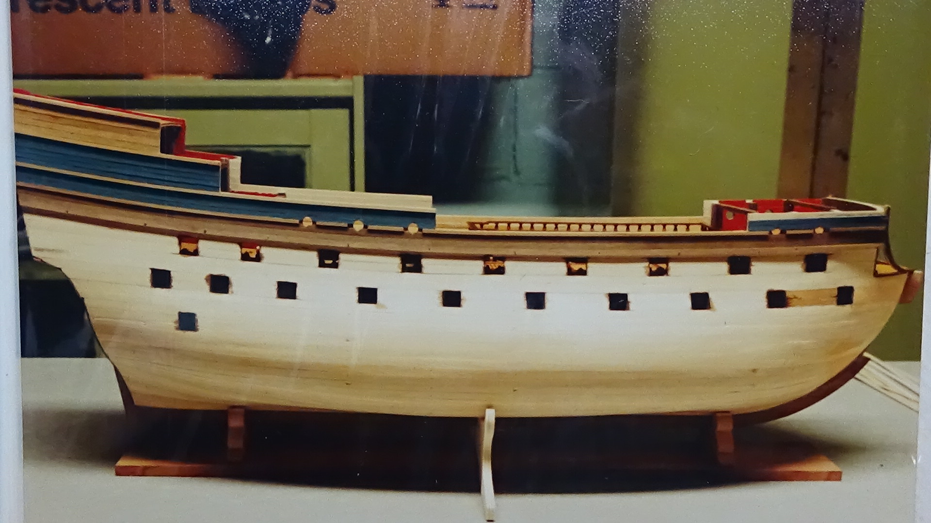

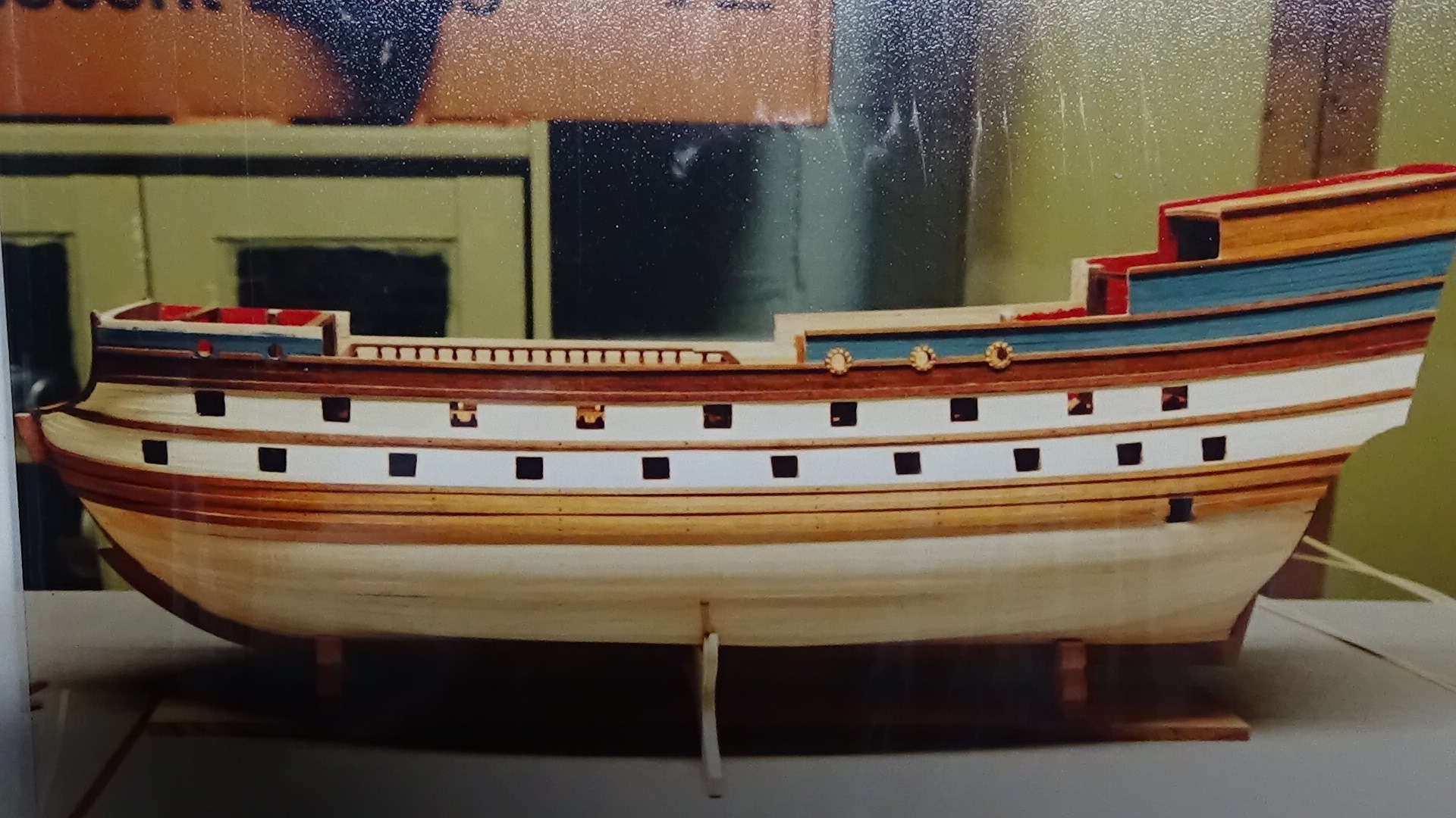

Ken Gilkeson Posted July 12, 2019 Author Posted July 12, 2019 thanks. gun ports completed, 2nd planking going on.

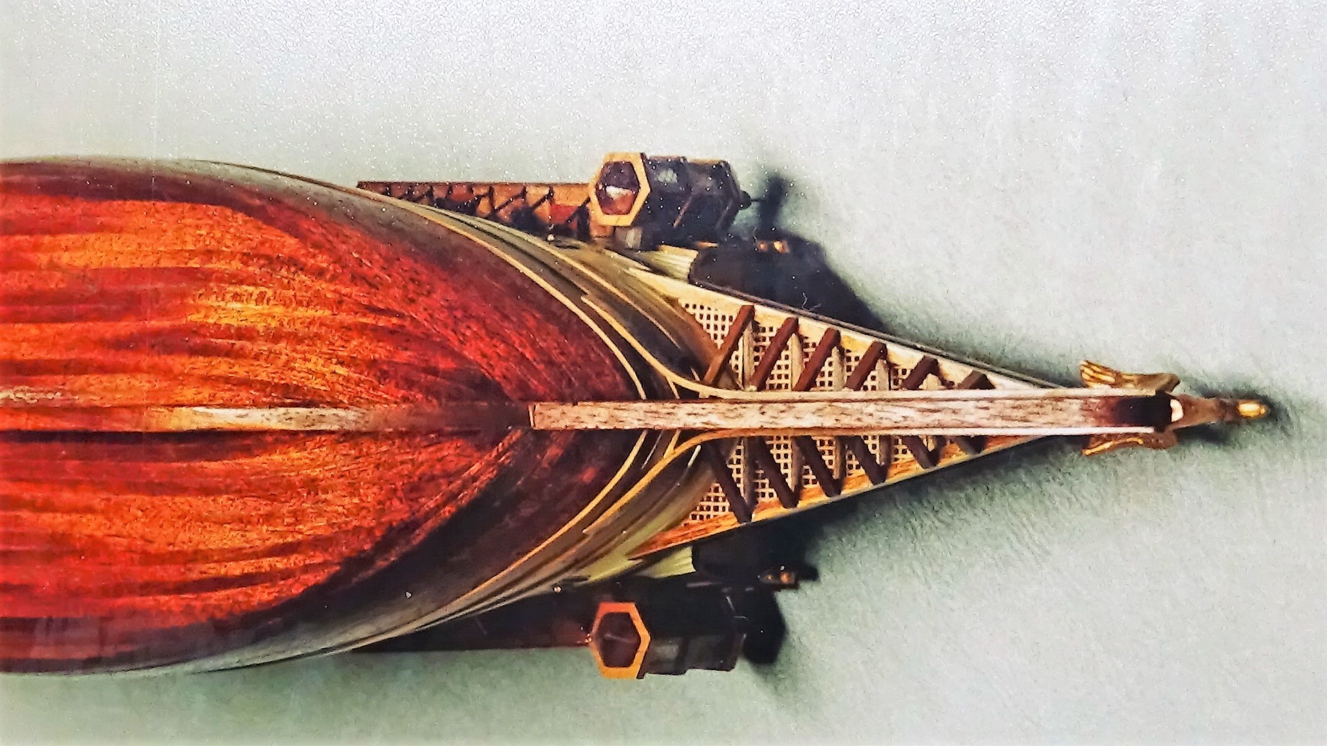

Ken Gilkeson Posted July 21, 2019 Author Posted July 21, 2019 measure twice cut once, planking finished. mahogany hull, walnut and tanganika wales. walnut bow.

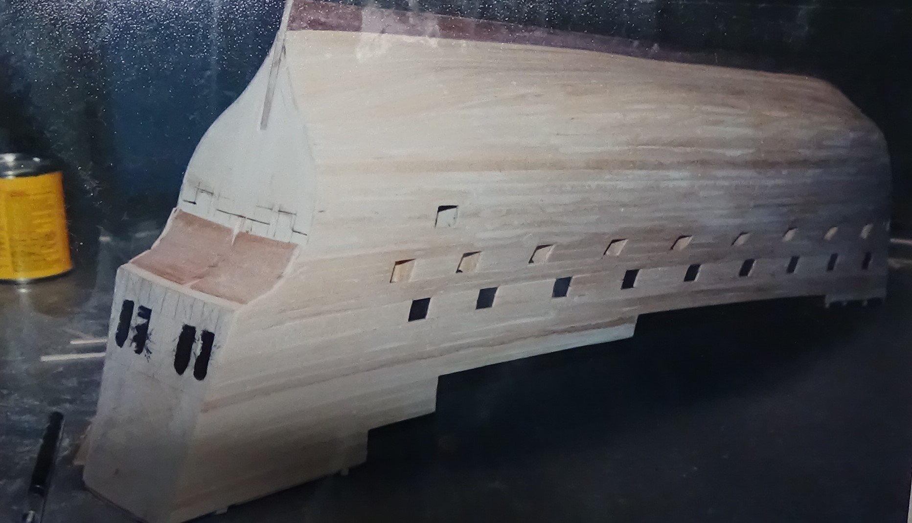

peteski Posted July 22, 2019 Posted July 22, 2019 Ken, I'm really enjoying the build progress photos. I also noticed that those look like scans of paper prints. How long ago have you started this build?
Ken Gilkeson Posted July 22, 2019 Author Posted July 22, 2019 this ships hull was built between about 2000 and 2001 and have about a year in it so far. rigging will take about 3 mos if I decide to put it on. a lot of details are hidden with rigging in place, so I'm undecided. there is quite alot of scratch building that has been done that slowed the build down. I'll post more pictures of that in the future. so yes these are photos from a photo album I created along with the build. thanks for your interest and comments are welcomed.

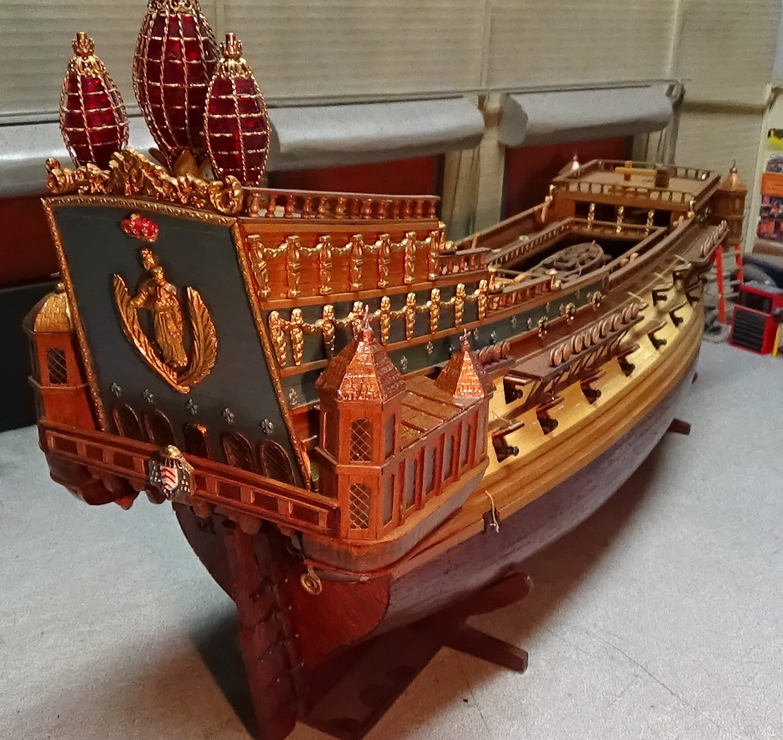

shoopdog Posted July 22, 2019 Posted July 22, 2019 Ken this is amazing work you have going here. I have to ask what are the three sphere things on the upper deck on the stern?
Richard Bartrop Posted July 22, 2019 Posted July 22, 2019 That is pretty amazing. Thanks for sharing!
Ken Gilkeson Posted July 23, 2019 Author Posted July 23, 2019 13 hours ago, shoopdog said: Ken this is amazing work you have going here. I have to ask what are the three sphere things on the upper deck on the stern? lanterns

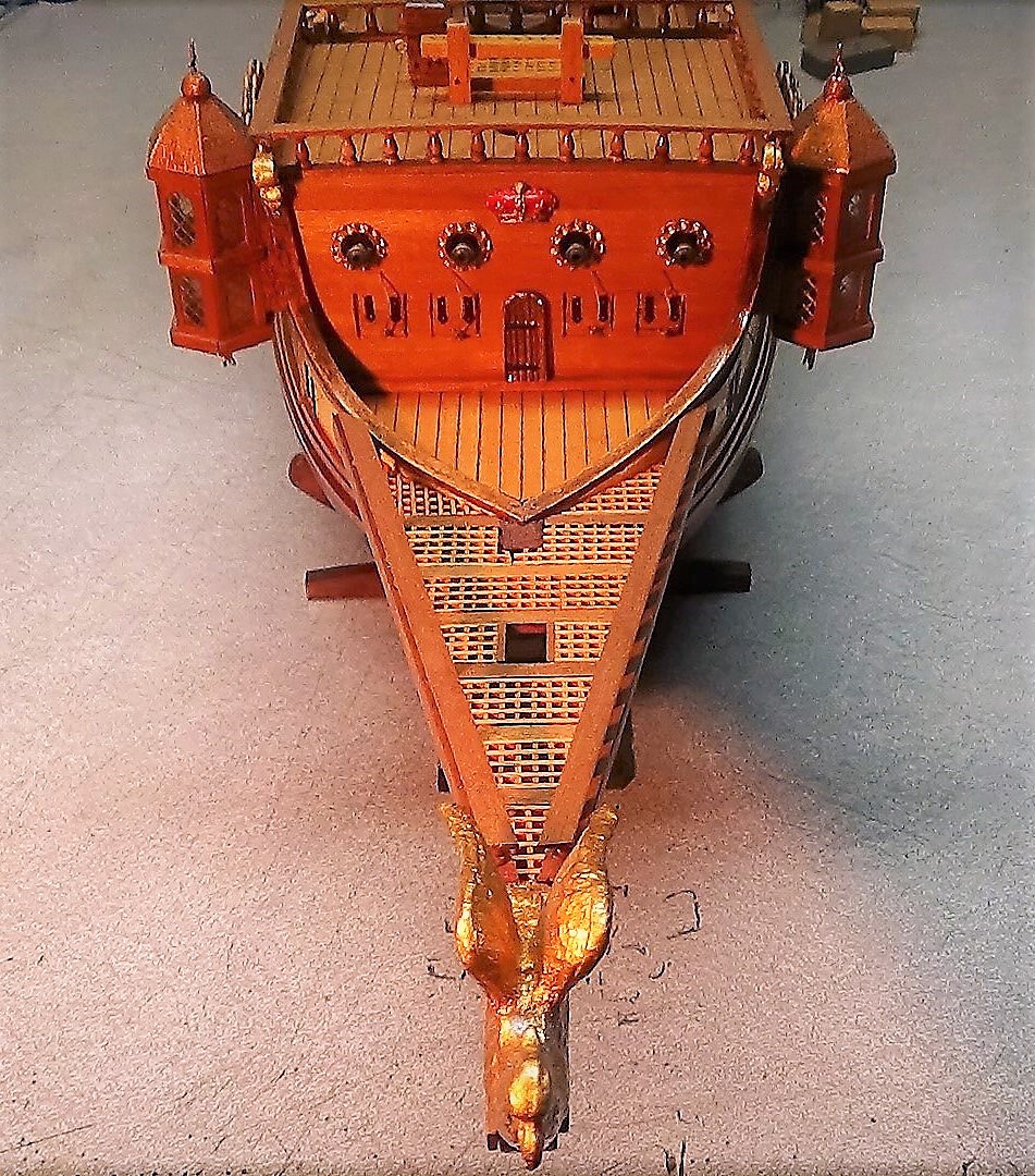

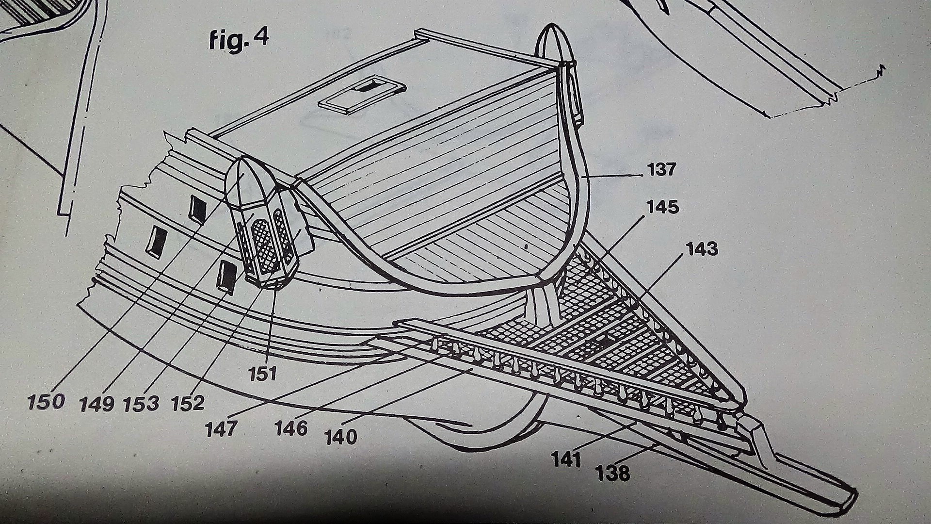

Ken Gilkeson Posted July 26, 2019 Author Posted July 26, 2019 the beginning of changes has the bow reworked so the grating 145 is the same elevation as the planking instead of what is shown in the drawing. changes are tricky and tedious due to the kit being 1/100 scale. 1/75 and larger are much easier to build. at this scale you would need a ladder for this large of a step down, and I think it looks more correct raised. thank you everyone for following and input.

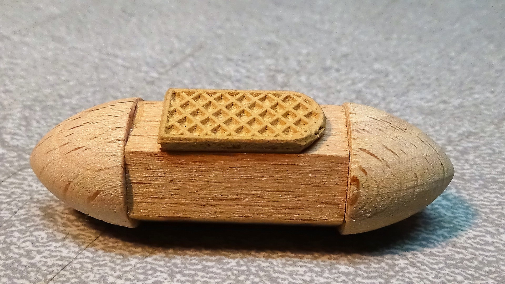

Ken Gilkeson Posted July 28, 2019 Author Posted July 28, 2019 the decorative pieces for the bow are disappointing as they come out of the box, so I scratch built them. there are over 45 pieces in each one, but well worth the effort. ( the decorations were the reason I bought the kit ) hehehe. comments are welcomed as usual.
