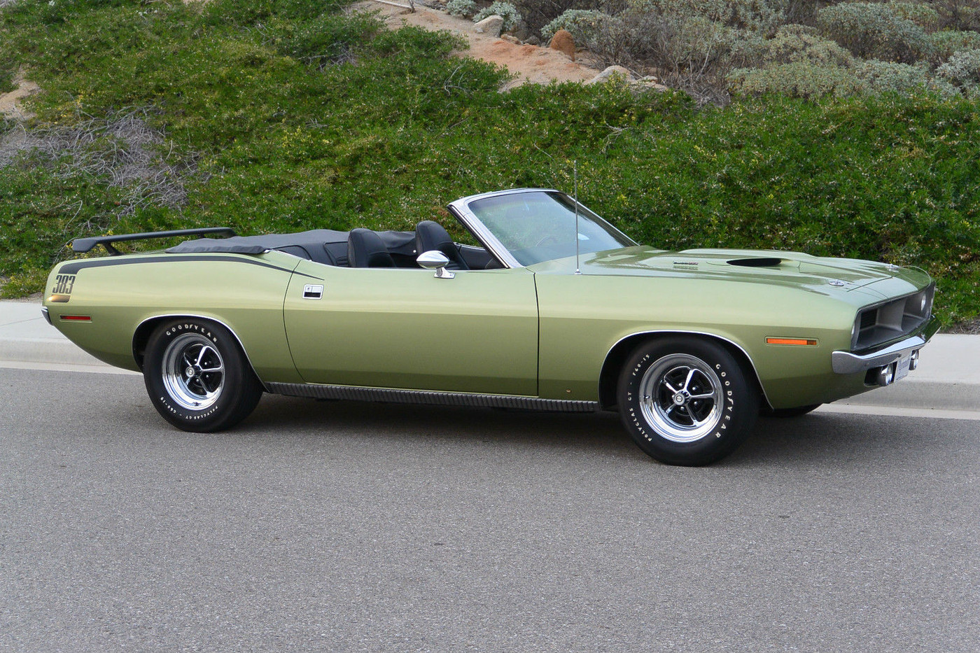

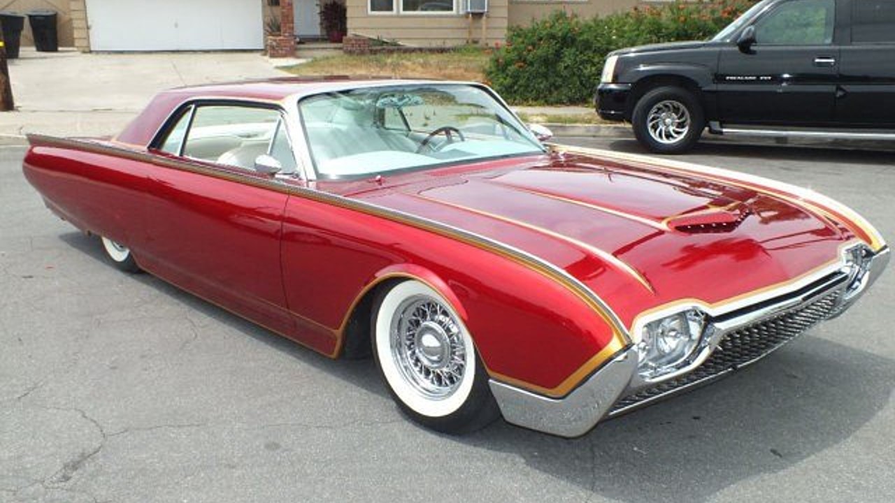

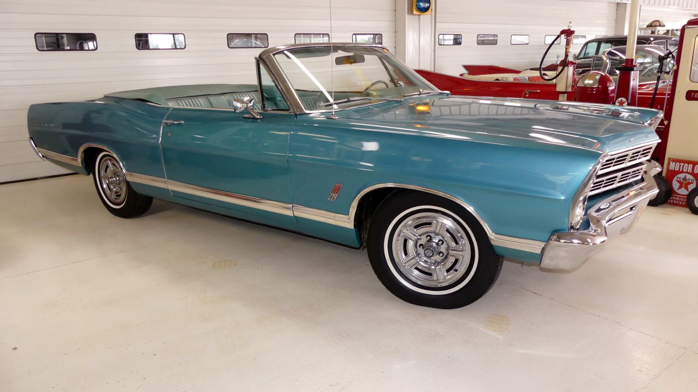

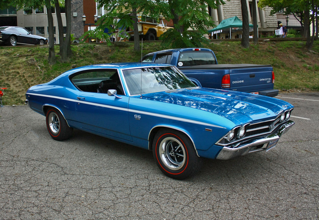

Bucky Posted August 4, 2019 Posted August 4, 2019 Tell the truth, Steve.....these are all models you've built....right??
