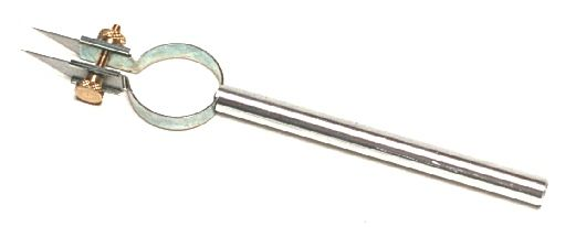

You're over-analyzing the situation. K.I.S.S. principle is in effect. All you need to do is to cut the decal using a double bladed stencil cutter
removing enough so it can be applied with the proper space (for the body color to be visible) between the two stripes. End of story. If you don't have one, I suggest that you purchase one.

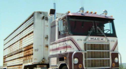

Sorry it's been so long, things were just hectic.  Here's a pic of what I'm doing, Pigpen's Mack from Convoy.  I have the decals from Model Truckin but they don't have the body color stripe in the middle.  I'm trying to figure out how to do the paint stripe and end up with the top and bottom decals in proper alignment.
Your description isn't very....well...descriptive. It'd be a lot easier to offer the correct information if you'd post a picture of the actual decal sheet. Are the stripes separate?
Are both stripes on the same piece of carrier film? Is there a color/clear between them?  Seriously, just post a pic and we can go from there.

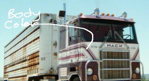

in the attached photo, the white line points to the darker body color stripe that I have to paint.  The stripes below are a seperate decal as are the stripes above the line I have to paint.  The problem is that the painted stripe needs to be perfectly located and it would appear easier to apply the decals first, leaving a gap where the painted stripe will go, mask it off and shoot it.  This presumes the decals don't come off with the mask.  It's a very risky task even without the prospect of the applied decals peeling off.
Tough one....think I would paint the white first. Scan/copy the decal sheet 1:1, then use the copy to make masks on Tamiya tape. Eyeball placement, once again using the copy to help get placement. Make a few copies of the decals, paper is easier to sacrifice than rare decals. Have had to do this in the past, won't be the last time. IIRC there is a Sillhouette Vinyl cutter that can be used to make masks with. Looks good. https://www.uscutter.com/Silhouette-Cameo-Paint-Mask-Sign-Stencil-Kit  Think there are different machines to do this. Little pricy, but gives you the capability to make most any mask(s) you may need. HTH.
I have one of these and am not really thrilled by it.  I am having some difficulty keeping the blades from closing together.  What are your suggestions?
IF I was approaching this paint scheme, I'd say that the  body gets painted in the colors... bottom maroon, center white.  Then everything on top of the white section should be a decal. I don't see you being able to mask and paint that maroon stripe with other stripes so close to it.    Show us the decal sheet you have.
Interesting, Ricky. The blade holder is essentially a spring and is constructed to provide tension to keep the blades separated. You could remove the adjustment screw and gently spread the arms to increase the tension. I have one I bought in 1991 and haven't any blade alignment problems. Yet.

That is a poor set of decals.  As Ricky is attempting to paint, that dark burgundy stripe should be part of the decal, as well as the thin line below it.  No excuse for a decal source to get it that wrong.
short of going through the ordeal of attempting to mask over the decals to paint that pinstripe, that pinstripe decal set is the only logical alternative.
