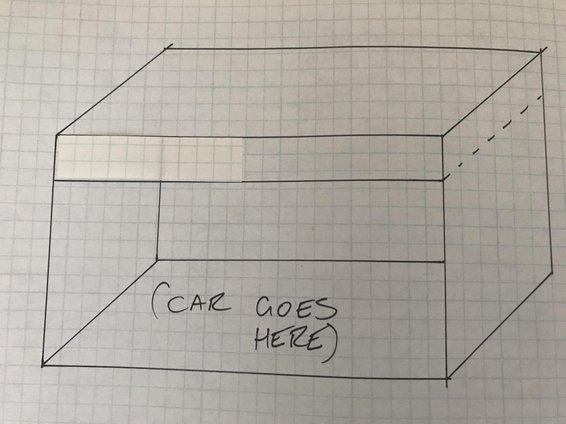

OldNYJim Posted September 3, 2019 Posted September 3, 2019 So, I had an idea for a little display with a model inside a plastic case - something like the pic attached (excuse my poor technical drawing skills ?). It would probably be similar size to a regular kit box I guess - but I’d like to build something into the top part of the box to light the model nice and bright. I’m a pretty competent solderer so rigging up some LEDs to a little battery pack doesn’t worry me too much - but I’d be interested if anyone knows of any suppliers who sell something ready-to-use along the lines of what I’m thinking. Does anyone have any experience with this kind of project? i did a search of the forum and found some useful info about lighting kits for particular models but not so much about lighting a display case like this...
Ace-Garageguy Posted September 3, 2019 Posted September 3, 2019 (edited) Google "battery powered LED under-cabinet". Hundreds. Edited September 3, 2019 by Ace-Garageguy
Ace-Garageguy Posted September 3, 2019 Posted September 3, 2019 Here's a nice selection...https://www.lampsplus.com/products/under-cabinet-lights/type_battery-operated/
OldNYJim Posted September 4, 2019 Author Posted September 4, 2019 You know how sometimes a solution is so simple that you don’t even think of it? I guess this was one of those. I looked up LEDs for model lighting, lighting kits for sci-fi models, lighting kits for RC stuff...I absolutely should’ve just thought about under-cabinet lighting like these. Brilliant, thank you Ace! Embarassadly yours, Jim ?
espo Posted September 4, 2019 Posted September 4, 2019 I'm not an expert in this area, but. I have seen very small lights on what looks like nothing thicker than a strip of masking tape. I would mount this inside the top or cover near the front edge and hide this from view with some sort of black out treatment also on the inside of the cover to hide it from view. This way the light would shine toward the viewers side of the display model. The batteries could be hidden under the display floor.
peteski Posted September 5, 2019 Posted September 5, 2019 (edited) 13 hours ago, espo said: I'm not an expert in this area, but. I have seen very small lights on what looks like nothing thicker than a strip of masking tape. I would mount this inside the top or cover near the front edge and hide this from view with some sort of black out treatment also on the inside of the cover to hide it from view. This way the light would shine toward the viewers side of the display model. The batteries could be hidden under the display floor. Yes, LED strip lights. Micro Mark sells them, but a huge variety is available on eBay and Amazon, much cheaper. Many come with a wall-wart power supply. I used those in my photo tent. Edited September 5, 2019 by peteski

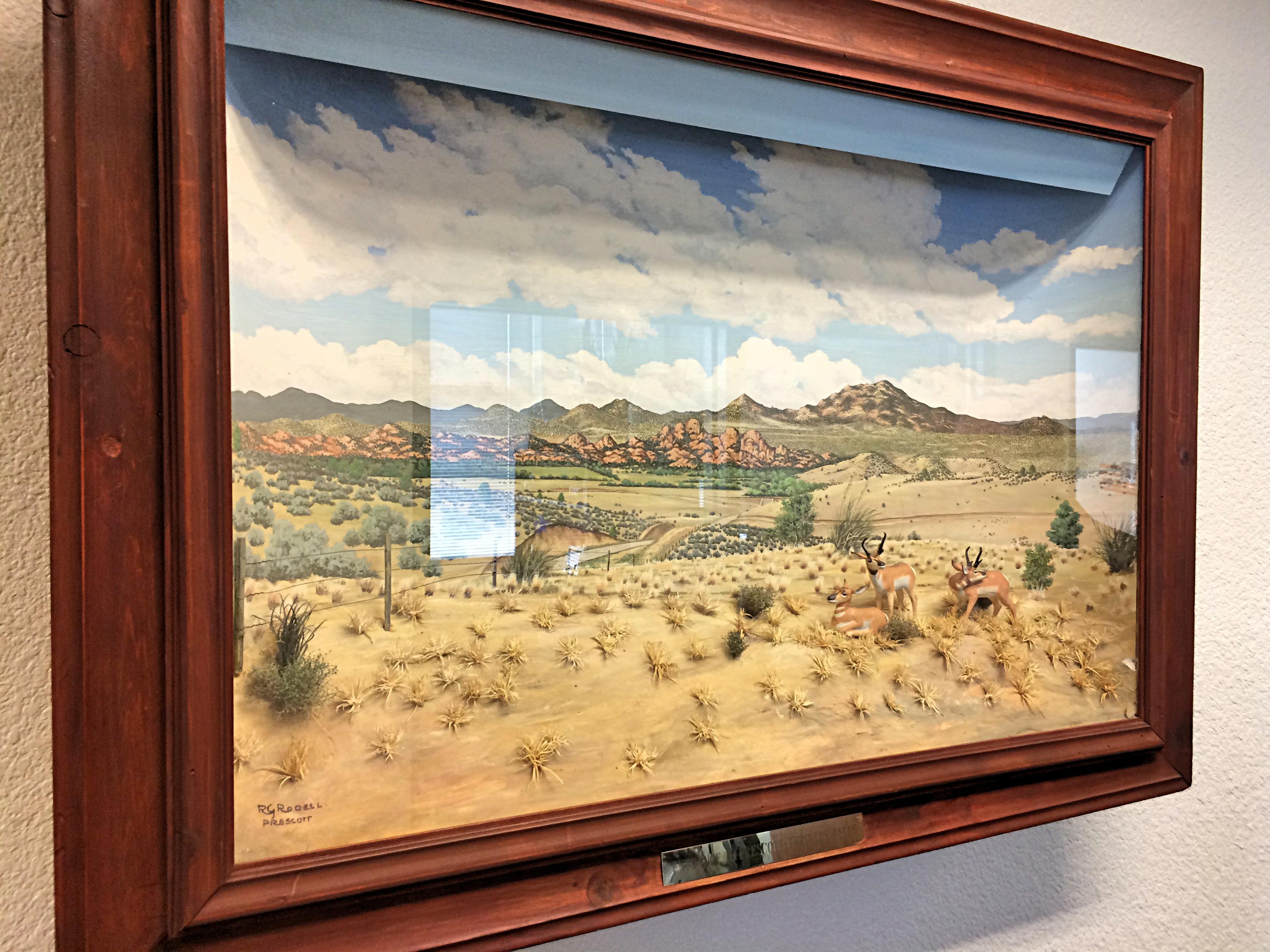

89AKurt Posted September 5, 2019 Posted September 5, 2019 Good thing you started this topic! Bill helped a bunch, I looked further into the tape lights, bookmarked. Once you get them, should test in various size cardboard boxes. I'm betting that if the box is too small, the lights would drown/flood the car and be too much glare. I'm posting this shadowbox diorama, last century there was an artist in Prescott who was famous for these, Bob Hope had some. He had to do with the incandescent tube light bulbs behind the blue shield at the top, which I assume washed down the sky background nicely. Hope this helps.
espo Posted September 6, 2019 Posted September 6, 2019 18 hours ago, 89AKurt said: Good thing you started this topic! Bill helped a bunch, I looked further into the tape lights, bookmarked. Once you get them, should test in various size cardboard boxes. I'm betting that if the box is too small, the lights would drown/flood the car and be too much glare. I'm posting this shadowbox diorama, last century there was an artist in Prescott who was famous for these, Bob Hope had some. He had to do with the incandescent tube light bulbs behind the blue shield at the top, which I assume washed down the sky background nicely. Hope this helps. Beautiful looking shadow box. This person is a great artist. The background looks somewhat like a painting and the animals and plants in the foreground look like a diorama.

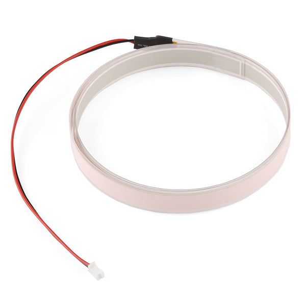

SfanGoch Posted September 6, 2019 Posted September 6, 2019 Consider EL tape. Mount it around the upper inner perimeter of the display case.

SfanGoch Posted September 6, 2019 Posted September 6, 2019 EL panels, tape and wire emit almost zero heat. For certain hobby applications, like sci-fi spacecraft, it can't be beat. I'm going to use EL panels and tape in my Moebius Jupiter 2 kits.
89AKurt Posted September 6, 2019 Posted September 6, 2019 14 hours ago, Ace-Garageguy said: That's just freakin' cool. I didn't know that existed. Guess I'm a little behind the curve on some things... ? No way! ? Me too, I bookmarked this! 16 hours ago, espo said: Beautiful looking shadow box. This person is* a great artist. The background looks somewhat like a painting and the animals and plants in the foreground look like a diorama. Was*, I have a friend, when he was growing up in Prescott, saw his shop. I would need to learn how to paint, and he carved the animals from wood. I do a better job on vegetation, he just cut paper. http://www.askart.com/artist/Runar_Rodell/129956/Runar_Rodell.aspx

peteski Posted September 9, 2019 Posted September 9, 2019 (edited) On 9/5/2019 at 10:44 PM, SfanGoch said: Consider EL tape. Mount it around the upper inner perimeter of the display case. I wouldn't use it, and don't recommend it. Compared to white LEDs, it has much shorter usable life, it is nowhere as bright as LEDs, and it requires high voltage (the last point is not really bad, but I rather deal with 5 or 12V than 100V AC). LED strips also run quite cool (unlike the old incandescent rope lights). Electroluminescent material was all the rage in the late '80s and '90s (before white LEDs became widely available). I used it back then,and it was good at that time, but I'll never go that route again. That is not to say that it is totally useless. Far from it. If one needs a thin and very evenly illuminated area, which doesn't need to be very bright, the EL material is perfect. Like Joe said, perfect for some ScFi models. But I just wouldn't use for illuminating a display case, where I would want a brighter light source. Edited September 9, 2019 by peteski
