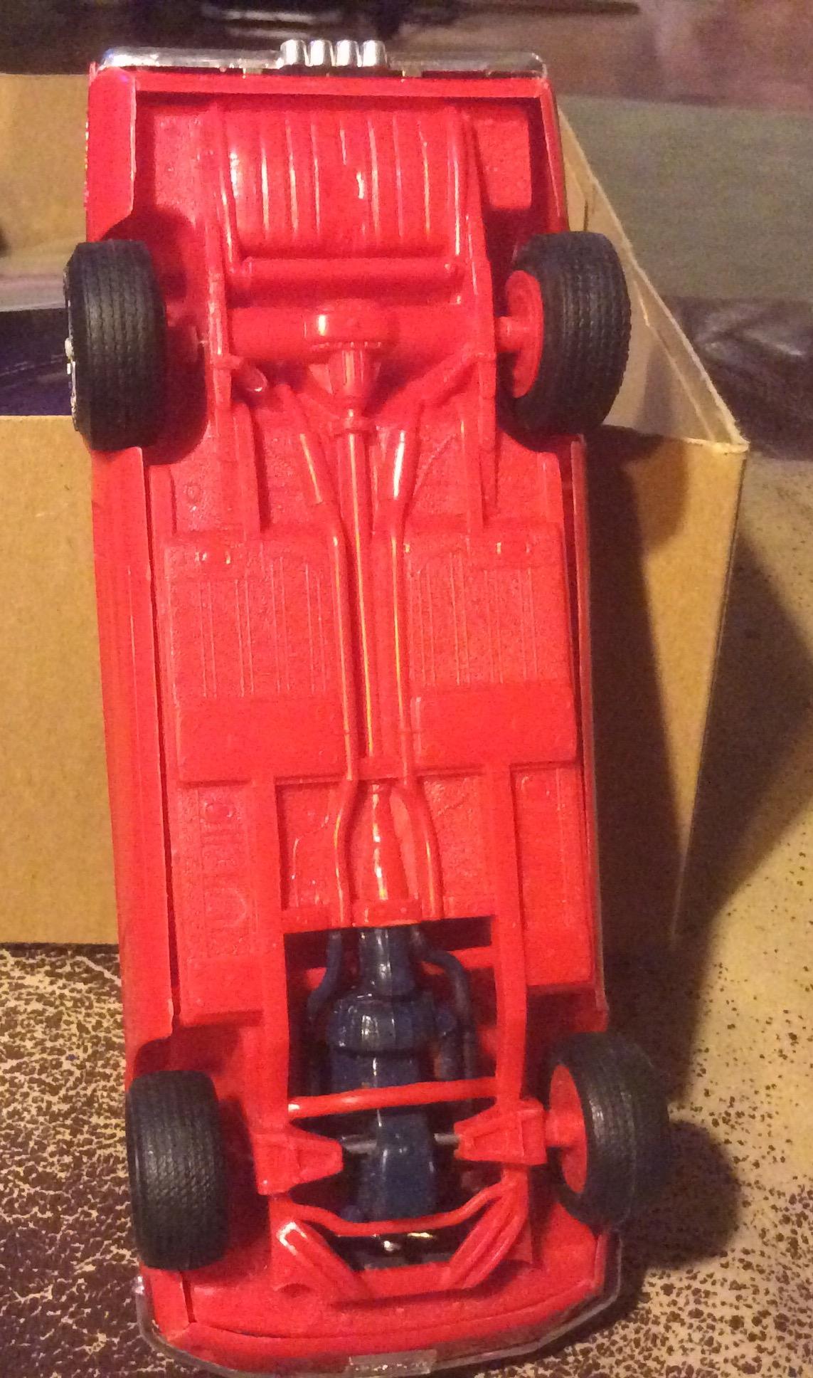

vamach1 Posted September 4, 2019 Share Posted September 4, 2019 Not sure about hte first question. See the picture. The 65/66 chassis is molder in so the 68 Shelby GT500 is a better choice since it has a separate exhaust system and front roll bar and rearend. I have not tried the conversion but it should be pretty easy. Quote Link to comment Share on other sites More sharing options...
STYRENE-SURFER Posted September 4, 2019 Author Share Posted September 4, 2019 7 minutes ago, Plowboy said: Don't know about the hood fitting the funny car. But, the '66 hardtop has a molded in chassis. The best donor would be the chassis from the Monogram '66 fastback. While it's 1/24 scale, it should take very little to make it work. Another may be the one from the AMT '67. But, it's quite a bit more narrow than the hardtop body. I was thinking that was the case. What I'm trying to do is get rid of the "Tear drop" hood on the funny car. Was hoping that these two kits shared enough similar dimensions that would enable me to create a A/FX car w/stock hood. As well as building a decent Hard Top version. Quote Link to comment Share on other sites More sharing options...

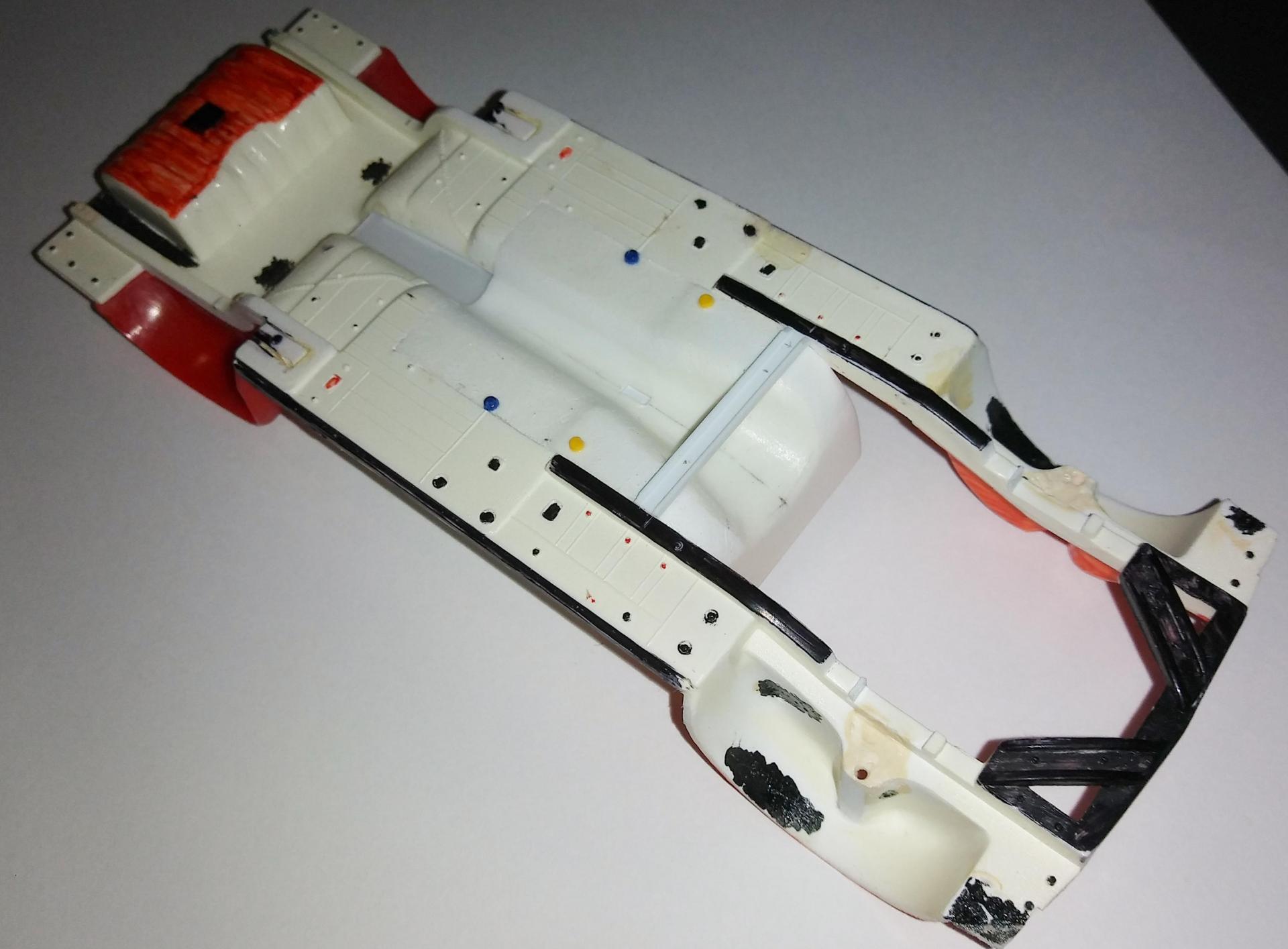

'70 Grande Posted September 5, 2019 Share Posted September 5, 2019 (edited) I'm in-the-middle of a '66 AMT Mustang chassis-swap project right now, and I can tell you that I originally thought the AMT/Ertl/Round-2 1968 Shelby Mustang GT500 kit's chassis would be a quick-n-easy drop-in replacement, but it's more challenging than I originally thought. Had to add rear wheel wells, cut-out a section of the center of the chassis and replace it, fabricate-in the rear portion of the driveshaft tunnel, add a new transmission-mount brace and I'm still in the process of getting the firewall and chassis to mate to each other properly. I expected a few hours of work, but that's increased to 20+ hours and I'm not done yet. Edited September 5, 2019 by '70 Grande Quote Link to comment Share on other sites More sharing options...
vamach1 Posted September 5, 2019 Share Posted September 5, 2019 (edited) 9 minutes ago, '70 Grande said: I'm in-the-middle of a '66 AMT Mustang chassis-swap project right now, and I can tell you that I originally thought the AMT/Ertl/Round-2 1968 Shelby Mustang GT500 kit's chassis would be a quick-n-easy drop-in replacement, but it's more challenging than I originally thought. Had to add rear wheel wells, cut-out a section of the center of the chassis and replace it, fabricate-in the rear portion of the driveshaft tunnel, add a new transmission-mount brace and I'm still in the process of getting the firewall and chassis to mate to each other properly. I expected a few hours of work, but that's increased to 20+ hours and I'm not done yet. Good to know it's not easy as I thought. I wonder if the opposite is true because the Mach1 show car used the 66 style chassis. Edited September 5, 2019 by vamach1 Quote Link to comment Share on other sites More sharing options...

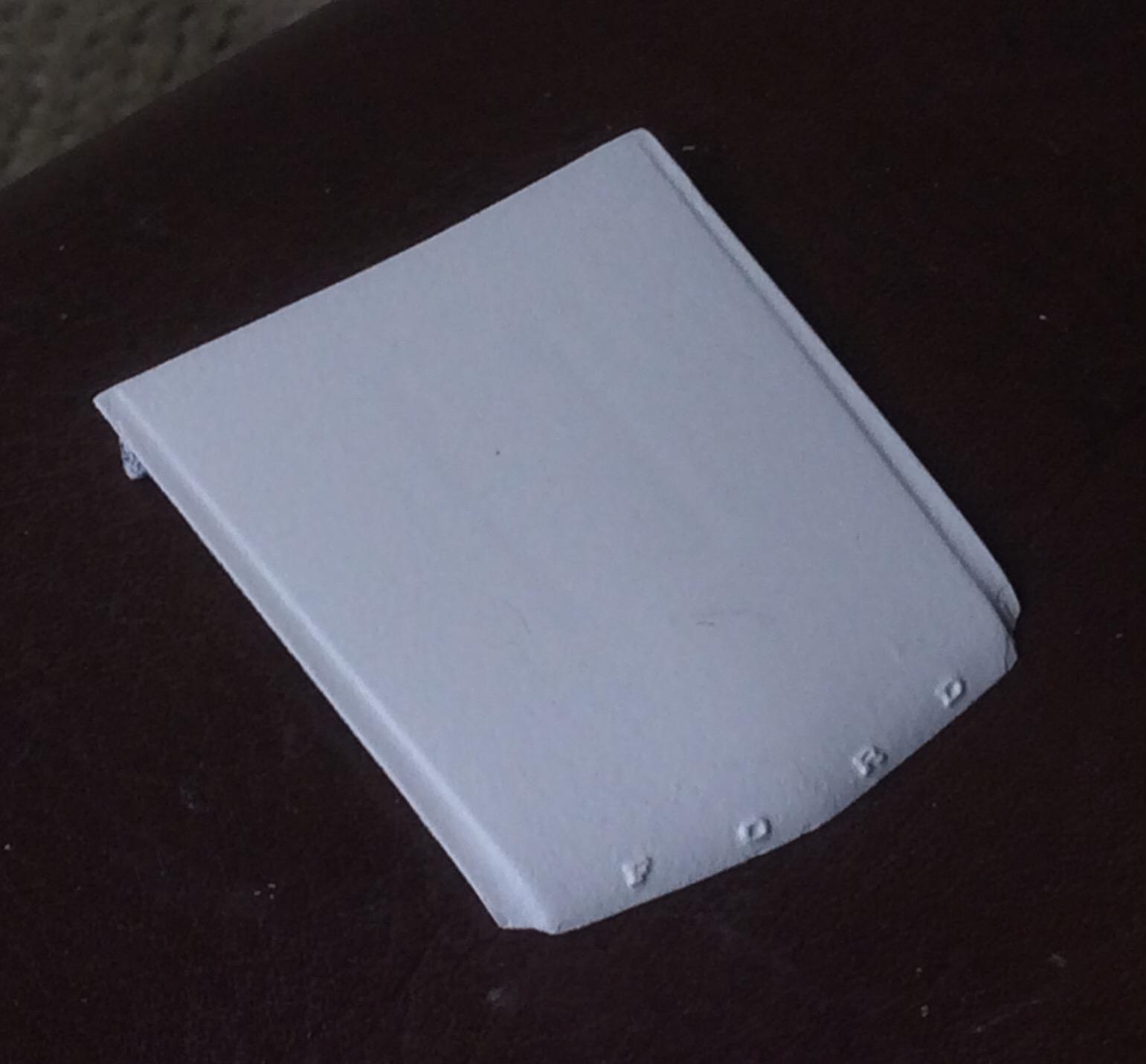

STYRENE-SURFER Posted September 10, 2019 Author Share Posted September 10, 2019 On 9/4/2019 at 4:49 PM, Casey said: Casey, I had forgotten about that thread. Thank you for reminding me, will go over it again. On 9/5/2019 at 4:42 AM, afx said: The Trumpeter '64 Falcon chassis is nice place to start a drag car. I used it under my '61 Falcon Gasser project. Another option is the Moebius '65 Comet A/FX chassis which I have installed under my '65 Falcon A/FX project. J.C. That is most likely the way I would attack it. Tho the 66' AMT Mustang body is probably a good deal narrower than the Falcon's. At least thats how things look from the pictures Ive seen here. On 9/4/2019 at 7:27 PM, Snake45 said: I'd be willing to bet a fair chunk of change that the AMT '66 hardtop hood is a direct fit for their AWB body. Snake, I think this kit looks as if it would only be useful to me for the hood and body. Chassis looks like what I was afraid of.? I don't think I will spend money for one of these kits but will try to find just the hood from one. Thanx all for you're input, sorry for the late response. Quote Link to comment Share on other sites More sharing options...

Snake45 Posted September 12, 2019 Share Posted September 12, 2019 (edited) 2 hours ago, boss 302 mustang said: The hood from the '66 hardtop does not fit the AWB fastback body Huh. I'll have to check that out. Back to add: I just did. The hood from the latest repop fits the AWB fastback body fine. The gap on each side is a little more than I'd like, but not much if any worse than many other kits on the market today, and certainly less than the gaps in the hood of AMT's '55 Chevy kit. Styrene Surfer, I KNOW you have the Mad Skillz to make it work. Shouldn't be a problem at all. Edited September 13, 2019 by Snake45 Quote Link to comment Share on other sites More sharing options...
boss 302 mustang Posted September 13, 2019 Share Posted September 13, 2019 I'll agree it will fit but it is a lousy fit. Too narrow in my opinion. And since the original poster wanted to build an A/FX car with a flat hood, I wonder if that hood would clear a 427 with 2-4 barrel carbs. Quote Link to comment Share on other sites More sharing options...
STYRENE-SURFER Posted September 13, 2019 Author Share Posted September 13, 2019 19 hours ago, Snake45 said: Huh. I'll have to check that out. Back to add: I just did. The hood from the latest repop fits the AWB fastback body fine. The gap on each side is a little more than I'd like, but not much if any worse than many other kits on the market today, and certainly less than the gaps in the hood of AMT's '55 Chevy kit. Styrene Surfer, I KNOW you have the Mad Skillz to make it work. Shouldn't be a problem at all. Thanx Snake. 16 hours ago, boss 302 mustang said: I'll agree it will fit but it is a lousy fit. Too narrow in my opinion. And since the original poster wanted to build an A/FX car with a flat hood, I wonder if that hood would clear a 427 with 2-4 barrel carbs. Boss, It's going to have opening for a blown engine Well that is the plan anyway. (plan B. or C. lost count) ? Quote Link to comment Share on other sites More sharing options...
