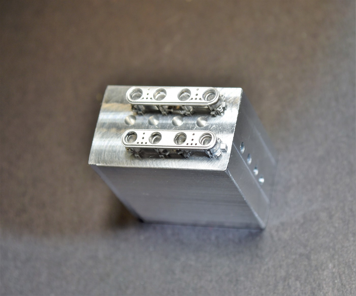

Codi Posted July 13, 2020 Author Posted July 13, 2020 Thank you as always fellas. The pair are done. What's left on them, fuels bowls, accelerator pump side detail, venturi's and final assembly / detailing them. The biggest part of these are done and to think it only took me a couple months to get to this point. Got a lot of ideas on how I want the manifold to look and how to make it. Cheers, tim The pieces are not assembled, the pics are just for mock-up purposes. There is still some clean-up to do as well before final assembly.

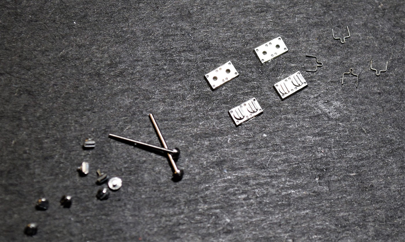

Codi Posted September 4, 2020 Author Posted September 4, 2020 Dave & Joe......thanks for checking in. Longest break from the bench since I took up modeling again. That "life" thing..........This week I did get the 4 accelerator pumps done and finally I have the fuel bowls to do. In total , each carb will comprise 61 parts (122 total) give or take a few parts. The pump is comprised of the machined plates (I did those in steel) and the round portion you see with the twin flanges in the center started as R.B. Motion rivets. I decked each, cut a groove down the middle (.010") and then cut the sides of each. I made extras as I know I'm going to drop and lose some during assembly. The last pic is of the fuel bowls that will comprise 7 parts each. Making these last 2 components of the carbs has been as challenging as the oil pump I made earlier for this engine. fyi, the length of the acc. pump plate itself is less than 4.0mm. I can't wait now to get these done so I can try out my ideas for the manifold. Cheers fellas, Tim The pump bases need a little clean-up on the edges yet...........thought I got it all, apparently not. Taking pics of these tiny parts is difficult.......I've included 3 pics of them in total even though they seem redundant.....some of the parts are in better focus 1 pic versus another....... The fuel bowls that will be on deck.

AmericanMuscleFan Posted September 5, 2020 Posted September 5, 2020 Glad to see you back Tim! The things of life are unfortunately the priority... Your update with these ultra small accelerator pumps is amazing. Very good idea to achieve the basic parts. Can't wait to see them installed on the side of the carburetor. Lots of work but it was worth it! Well done sir!!!
