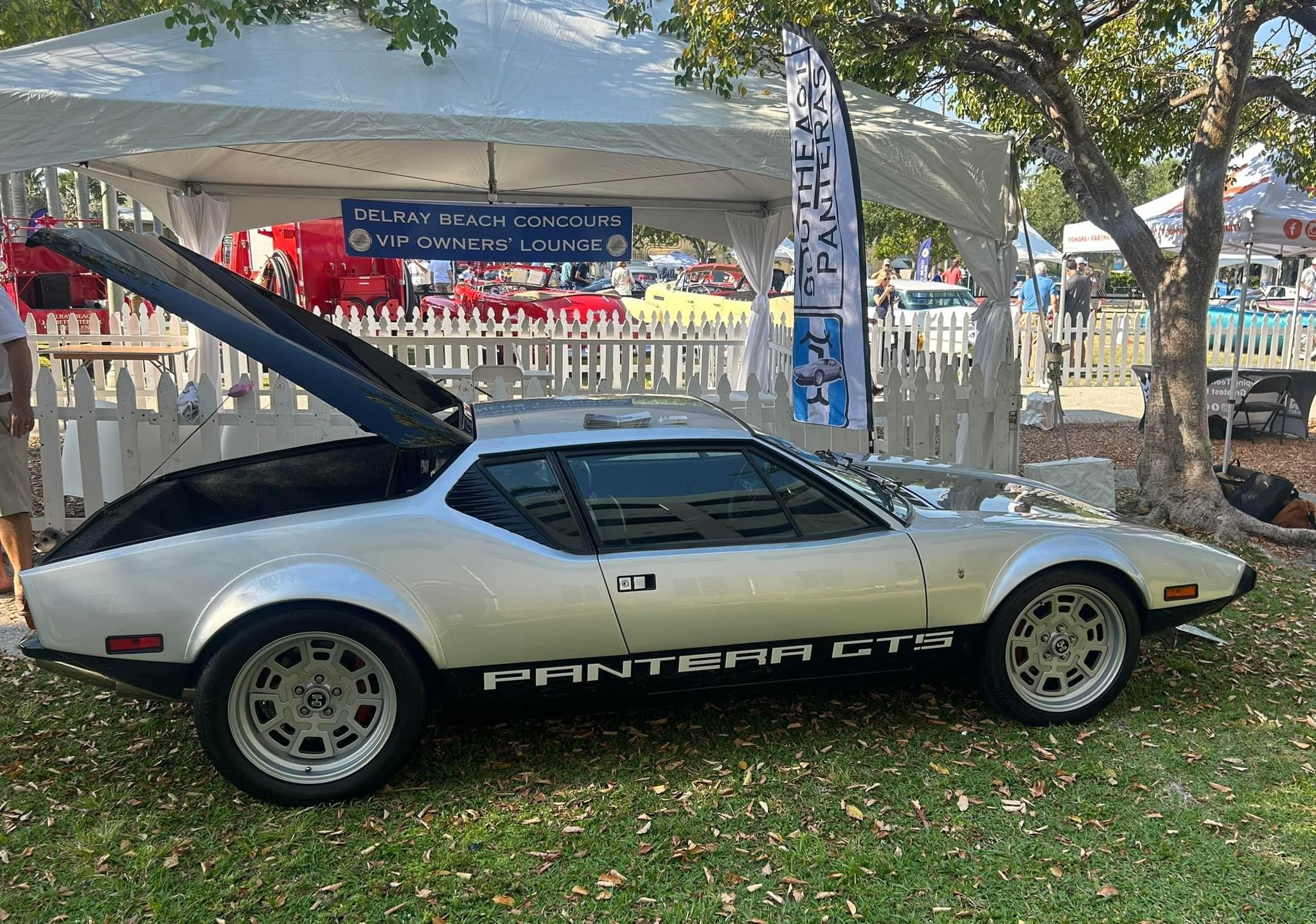

bytownshaker Posted May 15, 2022 Share Posted May 15, 2022 The Ford Dealer I worked for serviced 3 different Pantera's. Only thought to take only a picture of one. 2 Quote Link to comment Share on other sites More sharing options...

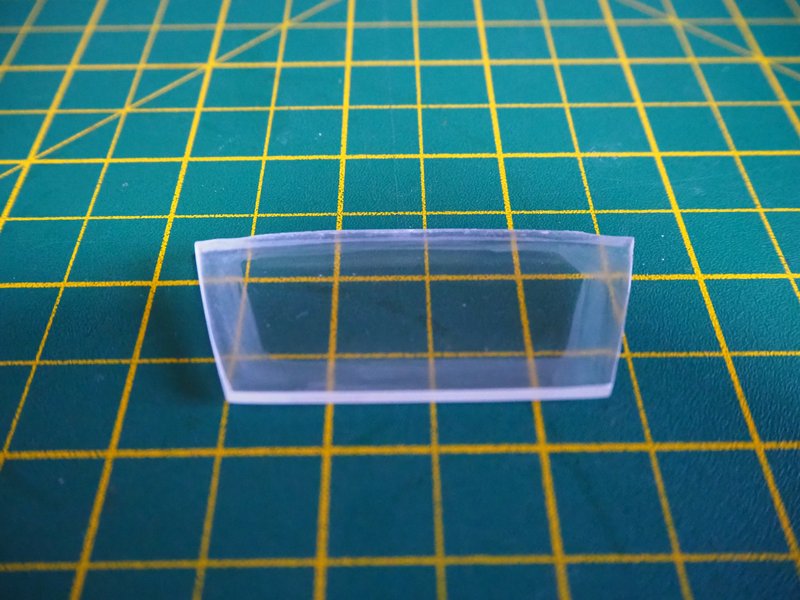

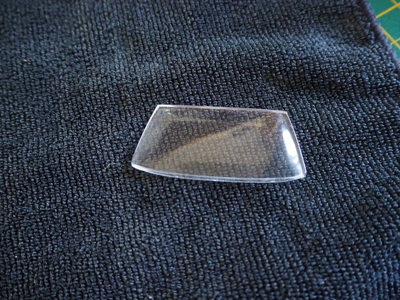

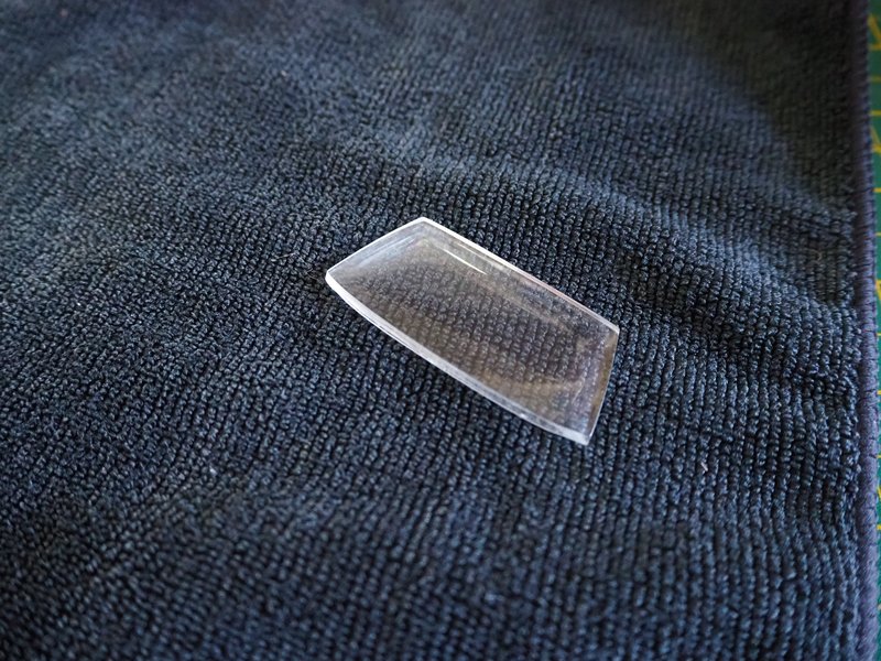

beeRS Posted July 23, 2022 Author Share Posted July 23, 2022 The one sticking point for this build has been the windscreen. It's not the sheer thickness of the plastic - its the variation in thickness that makes the screen look so distorted once in place. It's a shame as Fujimi engineered the piece to fit flush into the aperture, so the outside surface is correct to the 1:1 car. It's the inner surface of the screen that is too curved. To fix this, I literally scraped plastic thickness away around the outer edge of the screen using a curved Xacto blade. Once scraped away, the entire screen was sanded progressively through grades ending with a micro polishing kit. It's one of those things that really shows up well in the flesh, but difficult to photograph. Anyway, here's the pics... So, despite still being a thick plastic screen, it is at least a uniform thickness across it's surface now. I think, with this annoying job out of the way, I can finally crack on with this build. 3 Quote Link to comment Share on other sites More sharing options...

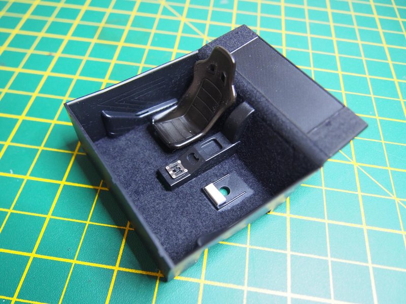

beeRS Posted November 22, 2022 Author Share Posted November 22, 2022 Time for a long awaited update. The wheels have been stripped of their chrome using oven cleaner, and airbrushed with Mr MetalColor Aluminium. I really like this paint! I did think about changing the wheels for a more 'modded' look, but I rather like the 70's vibe of the GTS and the kit tyres have good sidewall detail. I'm not going too mad detailing the interior. I flocked the carpet using Zero Designs black flock. I'm quite new to flocking. In the past I've always used matt paint. This is only the second time I've tried flock. The first time was on my 68 Dodge Dart and I used white glue which dried too fast. This time I've used clear enamel paint as an adhesive, and I'm much happier with the way it came out. The seats fit in an odd way. They seem to lean too far forward. If I glue them straight to the floor, as intended by the instructions the seat base is horizontal and the seat back is almost vertical. To correct this, I used a small piece of plastic card as a wedge under the front of the seats. The PE gear shift gate is from the Studio 27 fret, and the seatbelts are Detail Master. This Fujimi kit is an odd thing. In true curbside style, the top is fine, but there is no detail underneath to speak of. What detail there is, is just plain wrong! It's like someone at Fujimi just made it up. Have a look at the exhaust. It looks like the kit designers were able to research a car at standing height but never knelt down to look under the rear. The rear antiroll bar (sway bar?) is moulded as part of the exhaust. That's just odd! The first Pantera kit I ever built was by Imia - that was extremely basic. It had a compartment for a battery and electric motor - very toy like! As a 10 year old kid, that didn't bother me. Although the Fujimi kit is miles better, the exhaust does kind of remind me of that old Imia kit. I won't worry about correcting it, for fear of falling down the rabbit hole of adding detail and never finishing. The chrome looked too 'toy-like' so its been removed with oven cleaner and will be painted satin black with chrome tips. The body masked and ready for the trim to be airbrushed satin black. Thanks all for watching. I'll post more updates soon - I promise! 2 Quote Link to comment Share on other sites More sharing options...

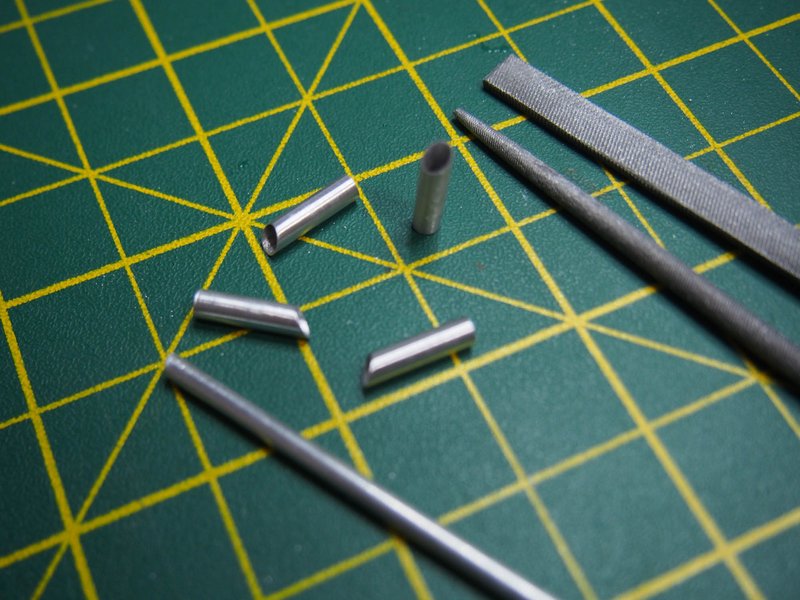

beeRS Posted December 18, 2022 Author Share Posted December 18, 2022 This will be my final instalment of work in progress for the Pantera. I've blitzed through the last few stages without pausing for too much photography. I sprayed the exhaust (and anti-roll bar) in black and tried chrome tape for the tail pipes. I was NOT happy with this. So, I cut off the tips, ordered some 3.2mm (1/8") aluminium tube and made new exhaust tips. I'm actually really glad I did this, as the aluminium tube came out better than expected once profiled and polished. Whilst polishing, I did the mirror glass whilst still on the PE fret. That would be impossible once cut off. Rear window masked and painted Thin acetate sheet cut to size and glued in with white glue. That's it! The next pictures will be under glass. 1 Quote Link to comment Share on other sites More sharing options...
