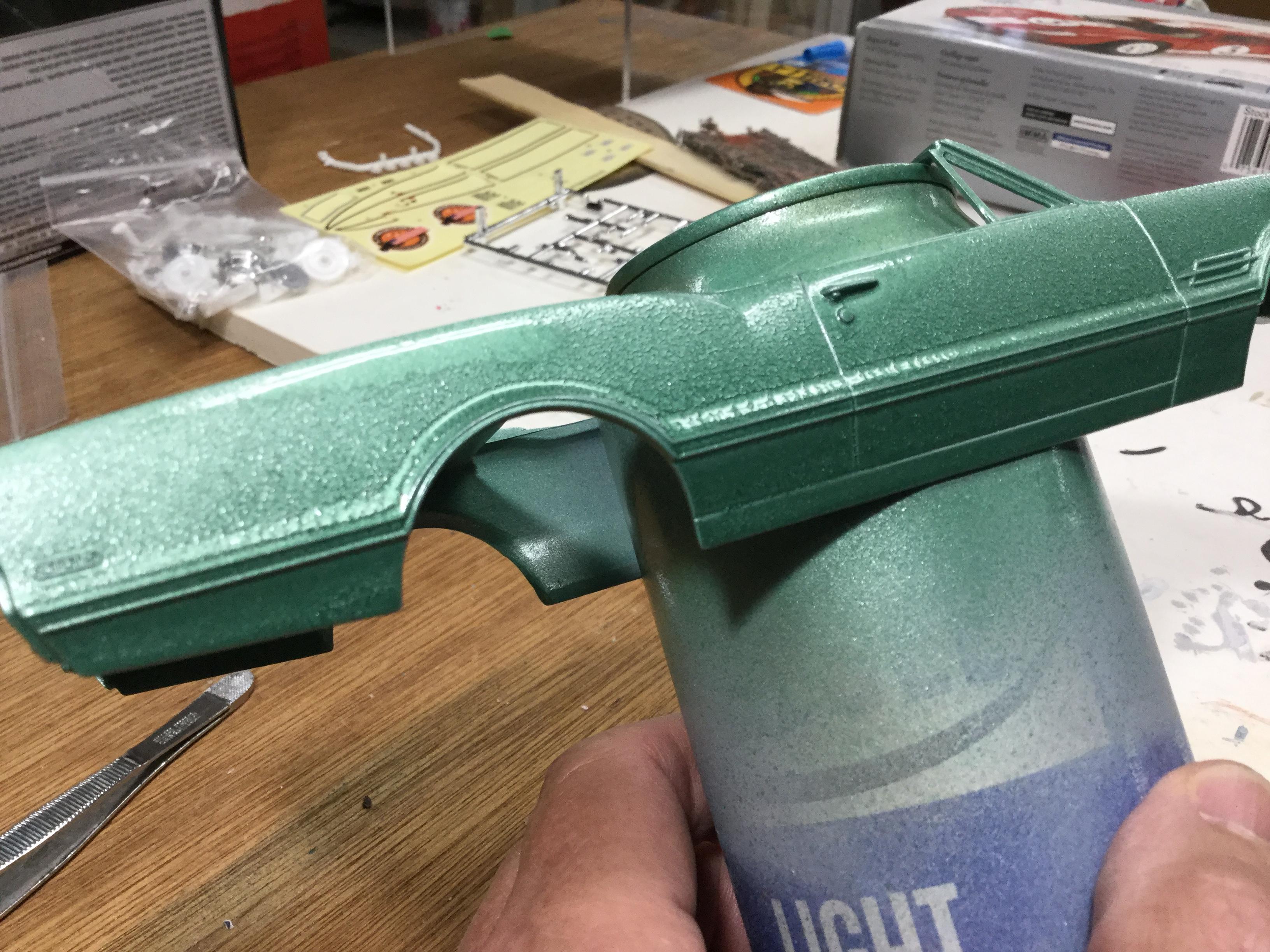

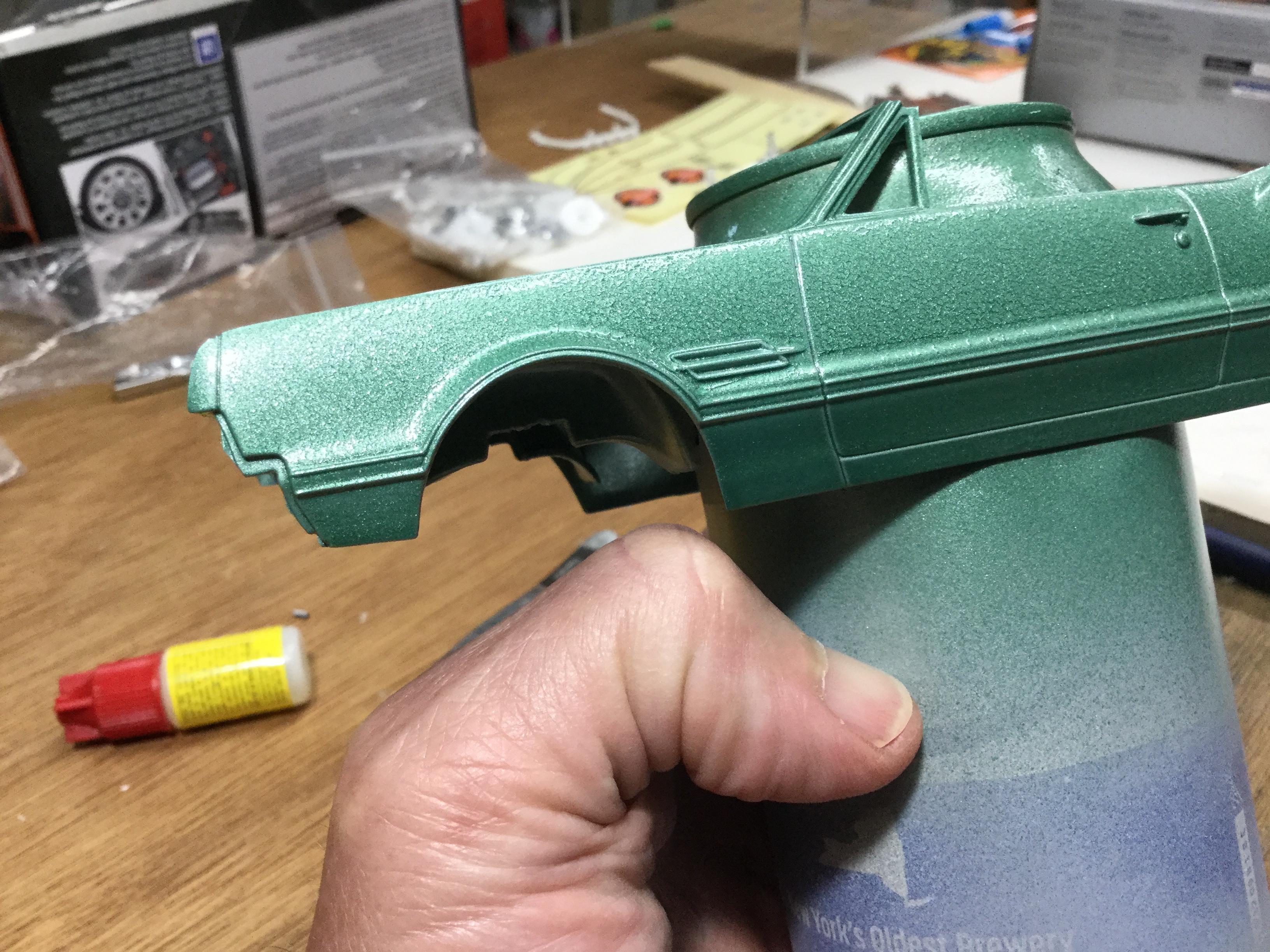

ewetwo Posted October 2, 2019 Posted October 2, 2019 This was a kit I bought that was started. Stripped it. Primed it with Duplicolor sandable primer. Painted one coat of special order Duplicolor GM Cascade Green Poly ($25 plus tax a can). My grandmother’s 1966 Delta 88 was that color. Loved it. First spray looked OK but I didn’t spray it too heavy figuring to light sand and spray on a second coat. Wait aa week and spray on second coat. Disaster hits. Don’t know why. It’s a mess. I should have been happy with the first coat. Now. How long do I wait before it goes back into then purple pond? A week so it’s totally dry first?

Bucky Posted October 2, 2019 Posted October 2, 2019 I agree with those two chaps. I'm wonderin' what happened to cause the mishap?
StevenGuthmiller Posted October 2, 2019 Posted October 2, 2019 17 minutes ago, Bucky said: I agree with those two chaps. I'm wonderin' what happened to cause the mishap? Sprayed the last coat too heavy? Obviously the previous coat lifted. Steve
ewetwo Posted October 2, 2019 Author Posted October 2, 2019 (edited) I always had a problem of spraying too heavy. So the first coat was light. I thought being the same brand primer and paint. It wouldn't be an issue. Edited October 2, 2019 by ewetwo
StevenGuthmiller Posted October 3, 2019 Posted October 3, 2019 5 hours ago, ewetwo said: I always had a problem of spraying too heavy. So the first coat was light. I thought being the same brand primer and paint. It wouldn't be an issue. Light coats are almost always better than heavy. When you're dealing with lacquer paints, there are a lot of things that can go haywire if you spray too heavy. Steve

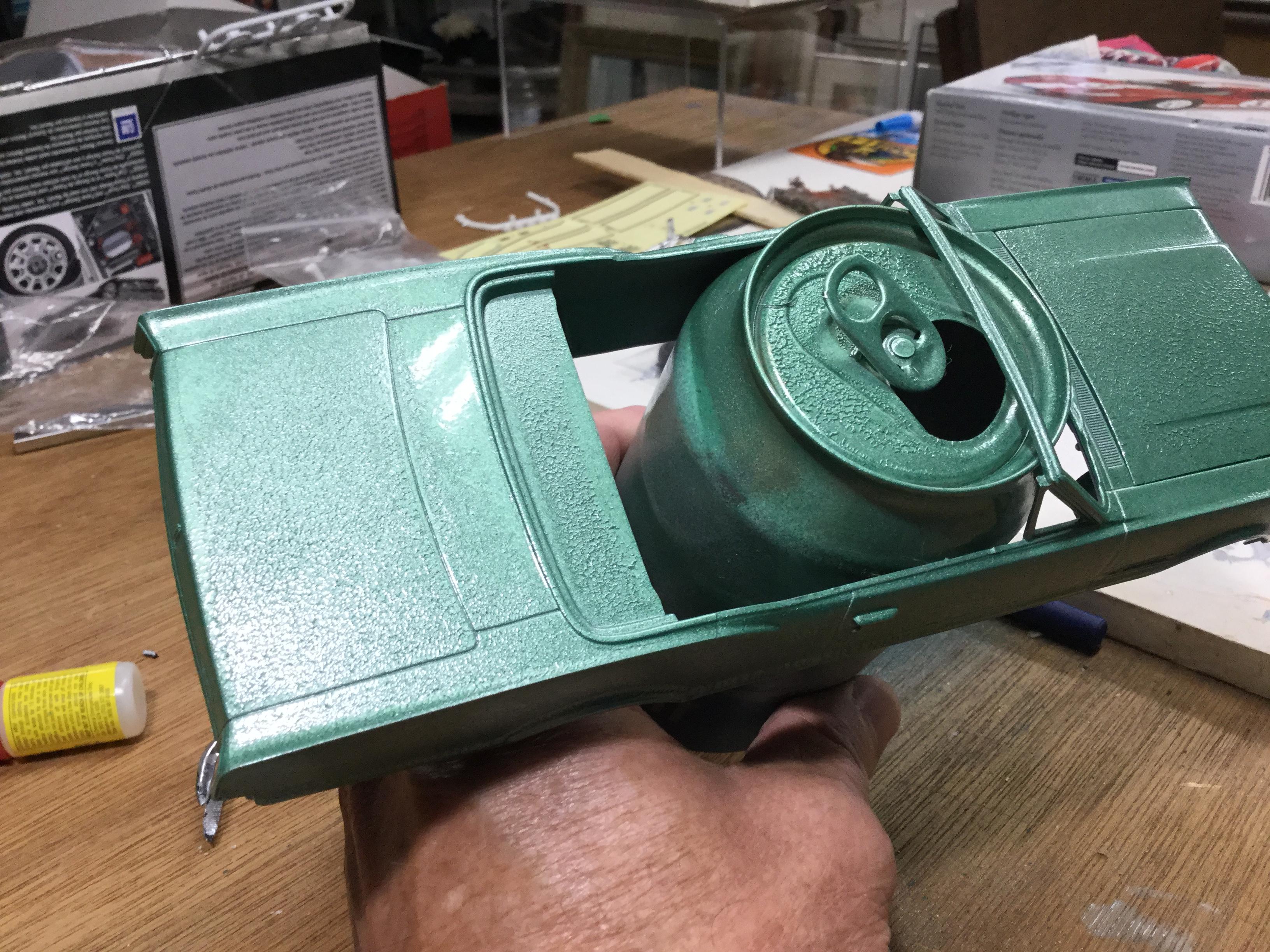

Snake45 Posted October 4, 2019 Posted October 4, 2019 I think there's something wrong with this paint. Notice how it's done exactly the same thing on the metal can. It almost looks like one of those "hammertone" or textured paints they sell. If you want this color, try a can of Duplicolor Hampstead Green at any auto parts store. Shouldn't run more that about $8.

ewetwo Posted October 4, 2019 Author Posted October 4, 2019 Thanks for the input. And Snake. I didn't even notice that the paint on the can crinkled also. So I would assume the paint is bad? I just bought it for $25 at O'Reilly's auto parts store 2 weeks ago. I have looked for light green paint at all the auto parts stores and there isn't any. Mostly dark colors except for silver and gold tones.
randyc Posted October 4, 2019 Posted October 4, 2019 8 minutes ago, ewetwo said: Thanks for the input. And Snake. I didn't even notice that the paint on the can crinkled also. So I would assume the paint is bad? I just bought it for $25 at O'Reilly's auto parts store 2 weeks ago. I have looked for light green paint at all the auto parts stores and there isn't any. Mostly dark colors except for silver and gold tones. You're having issues like I am recently. Maybe. If it's bubbly, that is a different issue than if it's crazing or attacking the paint below and wrinkling. I think mine is weather (humidity) related. maybe not completely, but partially. I have painted cars for 30 years and never had as many issues as this year. I also suspect newer "safer" paint formulations have something to do with paints. that's my case and opinion. And maybe too much paint (too slow passes)? But on yours, a week between coats should have given the first coat time to gas out. Or maybe too much time and it reacted? What does the label say about recoats? I've had that cause problems as well. But a week??? Should have been fine. I always try to put on first coat of anything lightly to see if it's going to react with whatver is below, even if it's same brand/line. Maybe too wet a coat and the solvents attacked the paint below. I know it is very disheartening no matter what. It's bizzare that there are some completely shiny smooth places. Did you shake well? IDK but hope you can fix it - this will be a beautiful model in that color.
ewetwo Posted October 4, 2019 Author Posted October 4, 2019 Thanks for the input Randy. The can does't really give much info as to what's in it. It's a special order Duplicolor paint. The can says enamel, acrylic, lacquer and poly. I asked what poly meant and they told me it meant metallic. My first spray was light because as I was applying the first coat. I could see it begin to pool around the trim, door handles. emblems and the curves in the body. So I thought I was doing the right thing by stopping and then putting a second coat on later. Like I said. It looked beautiful for about 30 seconds. LOL
Shambles Posted October 4, 2019 Posted October 4, 2019 I've had this issue a few times over the years. Sometimes I'd forget to wash the body first to get rid of any remaining mold release agents (Dawn dishwashing liquid is good). Depending on the temperature, sometimes I'll submerse the spray can in warm water for 20 - 30 mins, then shake vigorously for a couple of minutes.
ewetwo Posted October 4, 2019 Author Posted October 4, 2019 (edited) 5 hours ago, Shambles said: I've had this issue a few times over the years. Sometimes I'd forget to wash the body first to get rid of any remaining mold release agents (Dawn dishwashing liquid is good). Depending on the temperature, sometimes I'll submerse the spray can in warm water for 20 - 30 mins, then shake vigorously for a couple of minutes. The body was painted when I bought it and I stripped it in the purple pond. Then washed. Primered. Waited 3 weeks before spraying the first coat. Waited about 2 weeks before adding the second coat. My hobby room is in the basement but it's heated and maintains the heat around 70 degrees. I shook it for quite a while. But I did notice that it didn't spray as heavy as say Testors canned paint. And it wasn't really covering well but pooling around the handles, side trim. Like it was really thin paint. Edited October 4, 2019 by ewetwo
