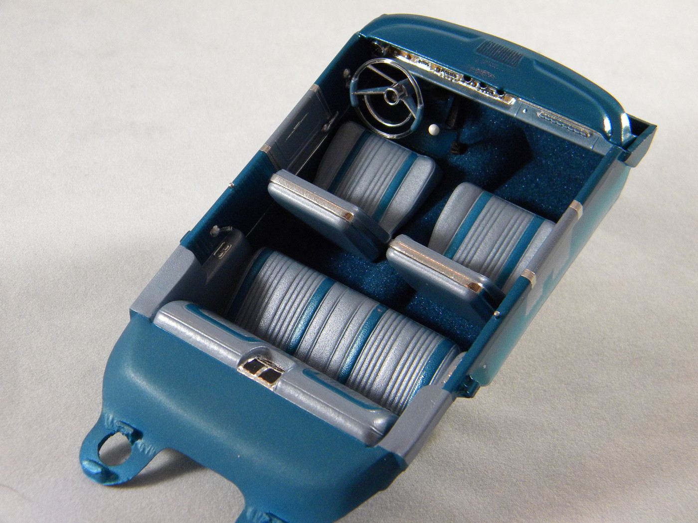

Can-Con Posted October 12, 2019 Posted October 12, 2019 I use metallics on interiors all the time. Sometimes I dull coat them with regular Testors dull coat bit not always, depends on the paint. Here's the last couple I did , you'll have to decide for yourself if it's the look you're going for.

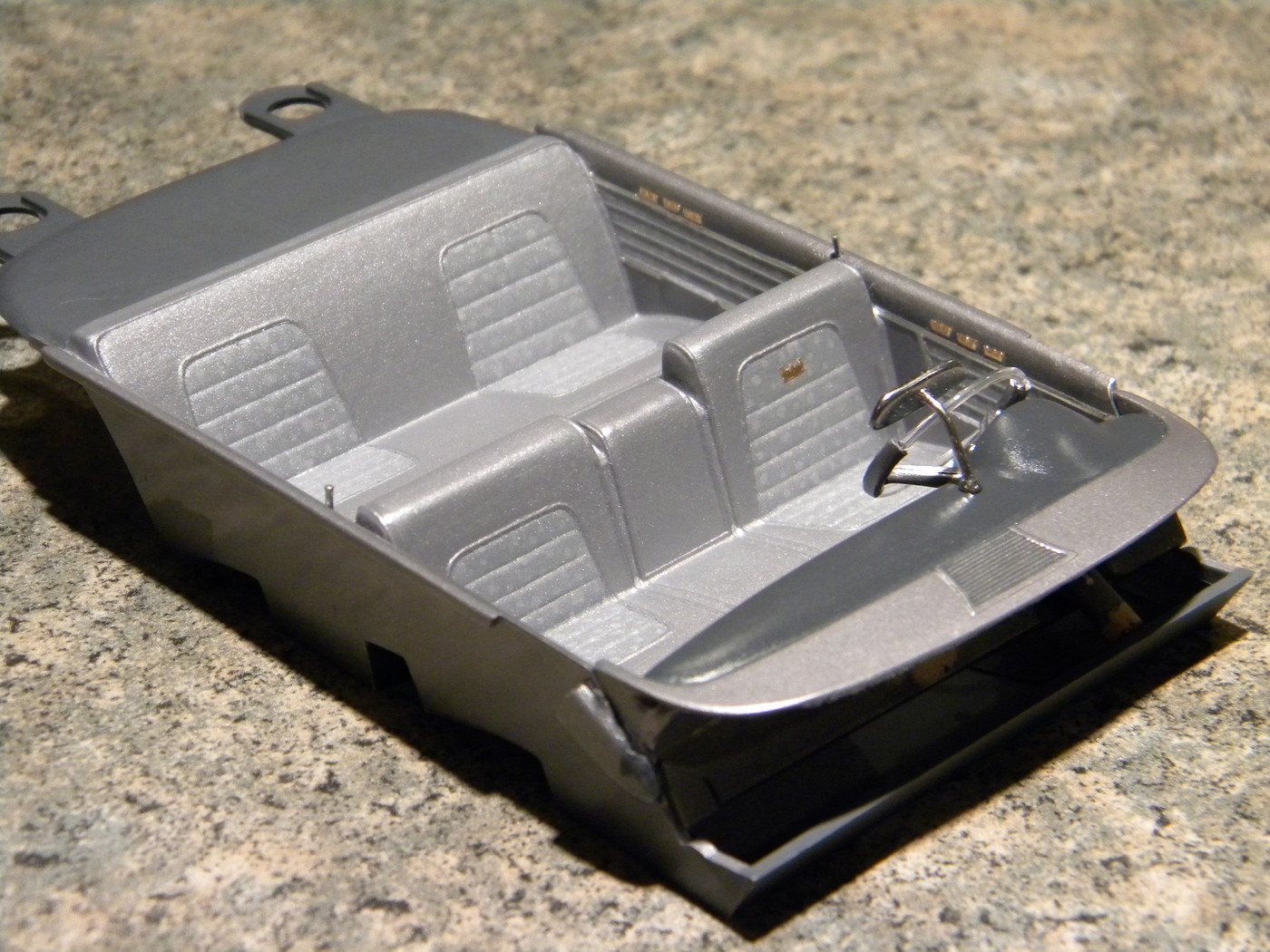

StevenGuthmiller Posted October 12, 2019 Posted October 12, 2019 In the case of this 1967 Ford Galaxie interior, I used Testors gold acrylic with a dab of green added for the lighter color and Duplicolor metallic dark green for the darker. The dark green was dull coated, but the light green was left alone. So you see, there are multiple ways to skin a cat. Steve

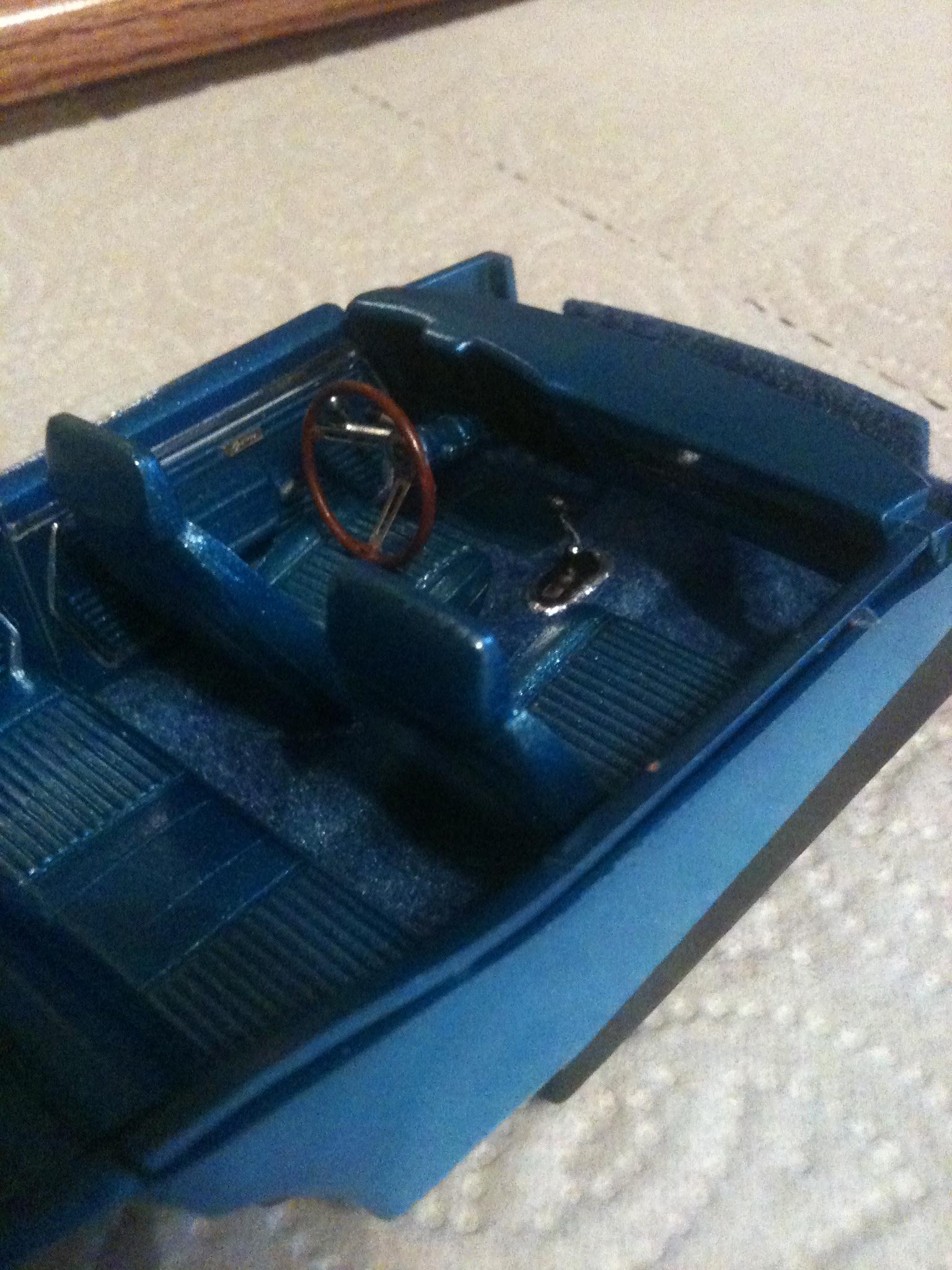

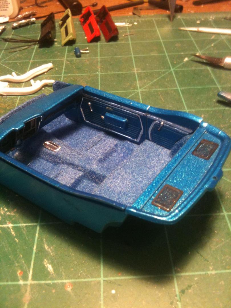

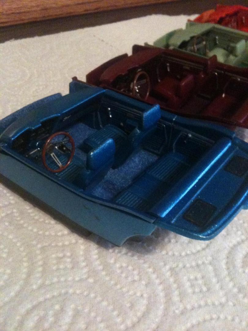

pack rat Posted October 12, 2019 Posted October 12, 2019 Just like Steve stated above, unless I'm doing a white or black interior I usually use metallics. If the look is a little too shiny, I'll apply a light coat or two of Testors dullcoat out of the can. On this '68 Camaro I used Testors Nassau Blue lacquer. I'm not sure how accurate it is when compared to the factory color; I was aiming for something that harmonized with the body color. Most of the Testors lacquers dry to a semi-flat finish that doesn't require any top coat.

Can-Con Posted October 12, 2019 Posted October 12, 2019 10 hours ago, crowe-t said: What paint did you use on this one? Is it lacquer? I really like how it looks. Is this one sprayed with Testors Dull Coat? Do you use the Testors Dull Coat in the spray can or the Dull Coat in the bottle for airbrushing? I never used Testors Dull Coat so I don't know if the spray can and the bottle are exactly the same stuff. This one is from Scale Finishes. I think it's lacquer but they sell both so I'm not really sure. ,, but it doesn't craze the plastic . It wasn't clear coated this time as it has about the sheen I wanted for a vinyl look. I usually use a flat dullcoat if I want a cloth look and a semi gloss clear for a vinyl or leather look. Testors spray from the can.

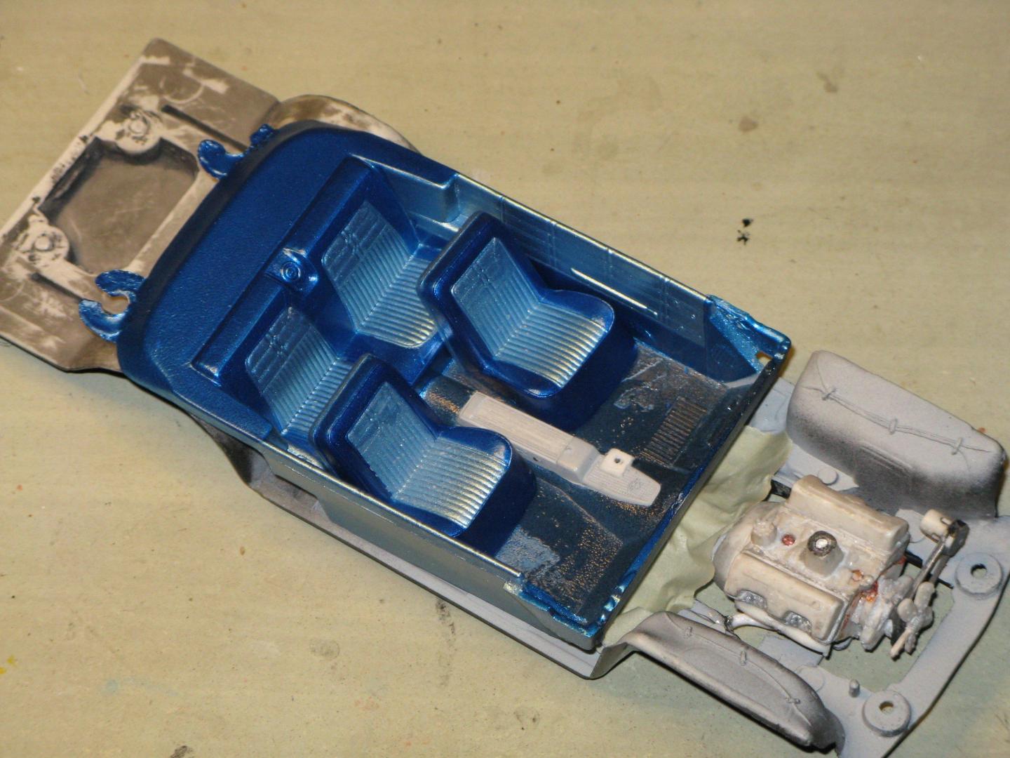

tbill Posted October 14, 2019 Posted October 14, 2019 That is testors icy blue over gray primer with no other clear coating. May help for visual reference.
