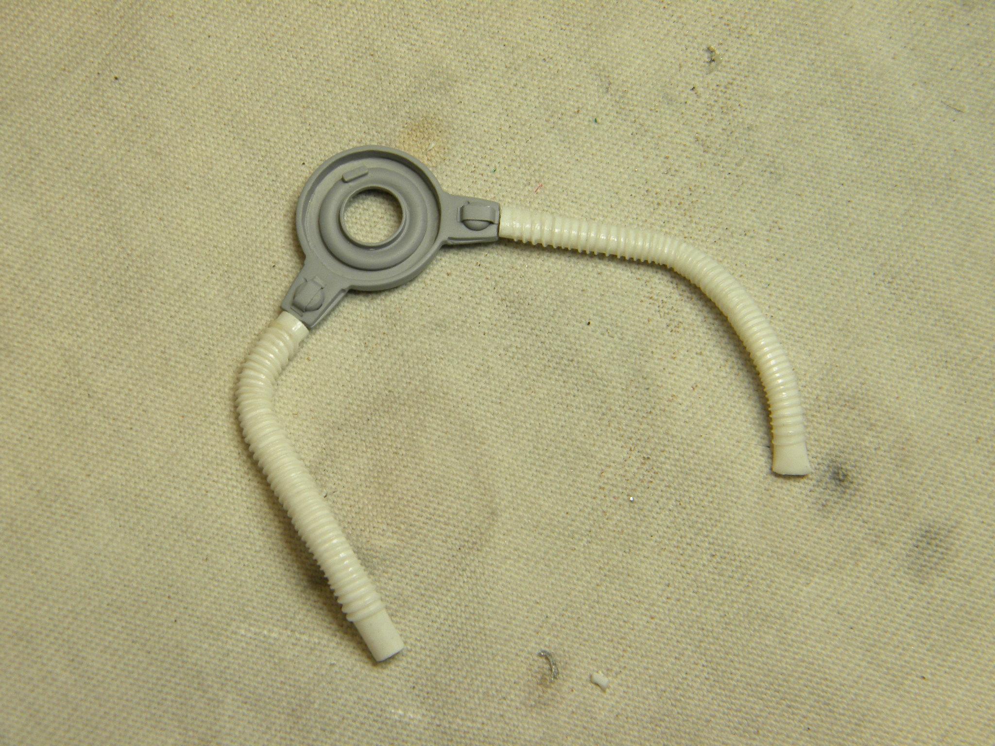

3 minutes ago, Ironman63 said:
It measures 1/4" outer diameter so it's larger than you'd want.  Lots of other good ideas of how to make them here though.
Thanks Mark.
That was my fear.
As you said, lot's of other things to give a shot. ^_^
Steve

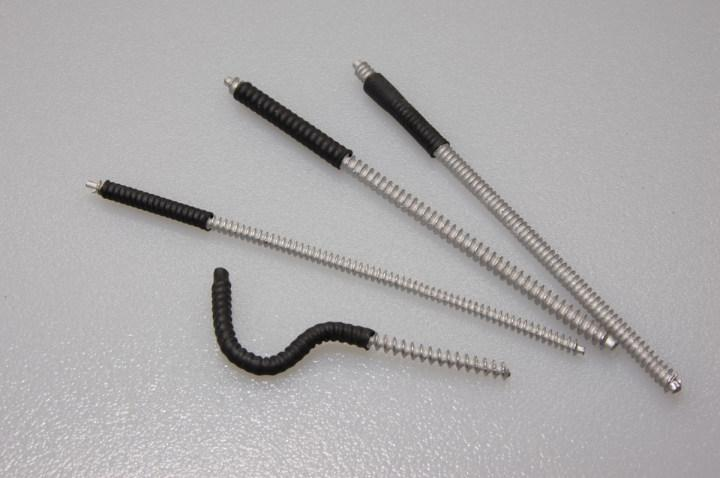

50 minutes ago, SfanGoch said:
From MFH, there's 1:20/1:24 Air Duct Hose - P965
Other than this, nothing from any AM companies.
Hmmm.
Now that's interesting!
You always seem to come up with the goods Joe!
I'll check into this.
Some people are extremely helpful.
Others have nothing else to do with their lives except be a PITA.
You're one of the good eggs Joe!
Thanks!
Steve
I figured that this one would pique your interest, Steve. :)
Being that it's flexible (soft), you should be able to flatten the end to match the snorkels on the air cleaners.
I was curious about that.
Do you know what material the screws are made of?
Steve
3 hours ago, SfanGoch said:
Looks like various gauges (6 to 12 AWG) of solid aluminum wire which was threaded.
Thanks Joe.
I might try my first thought of wrapping wire around some plastic tubing and see how that goes before I spend $20.00 on these.
I'll likely use only 4 or 5 inches of the stuff, so it would be more cost effective to try something else first.
But it's great to know that this option exists.
Thanks a million Joe!
Steve

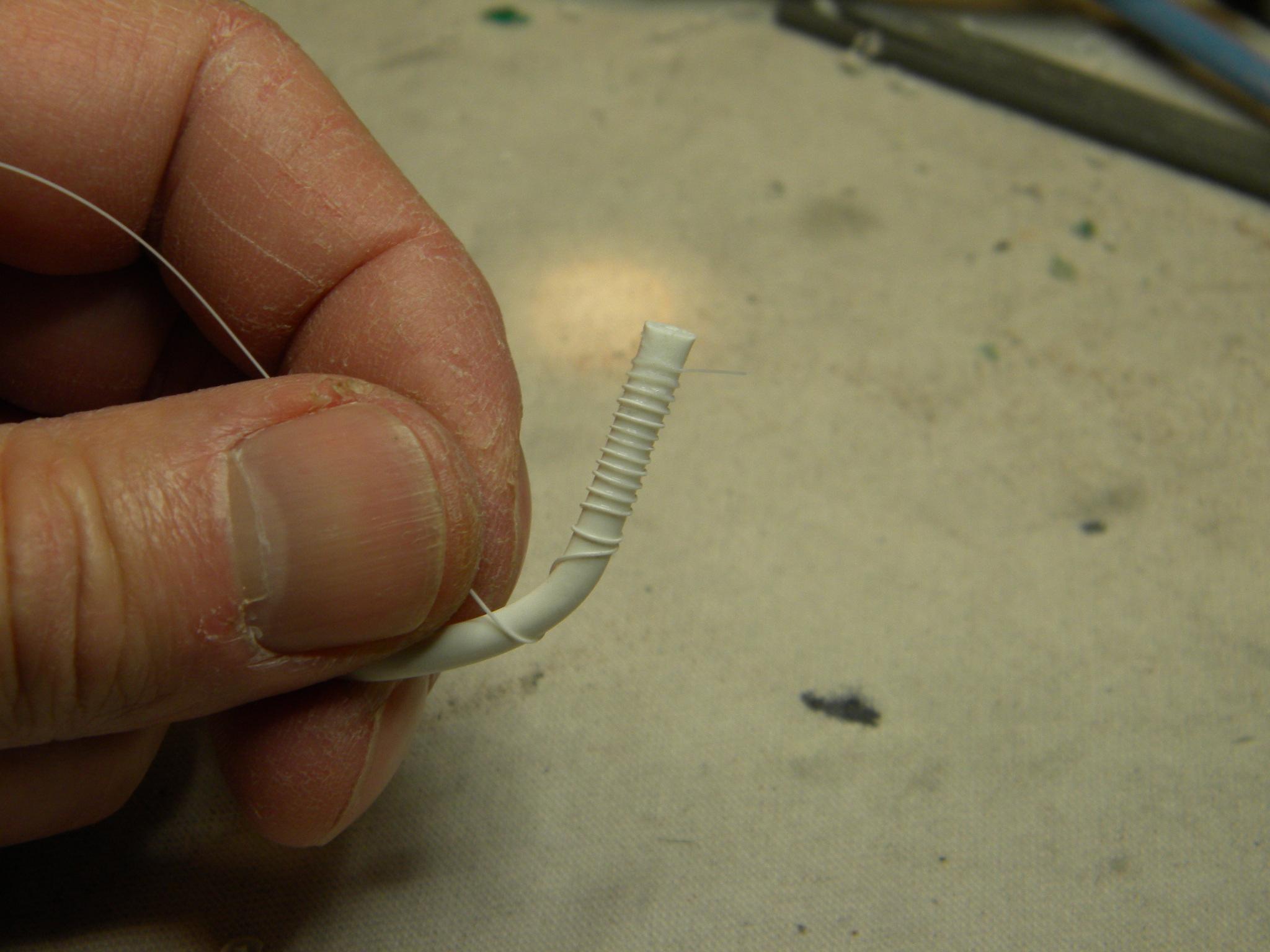

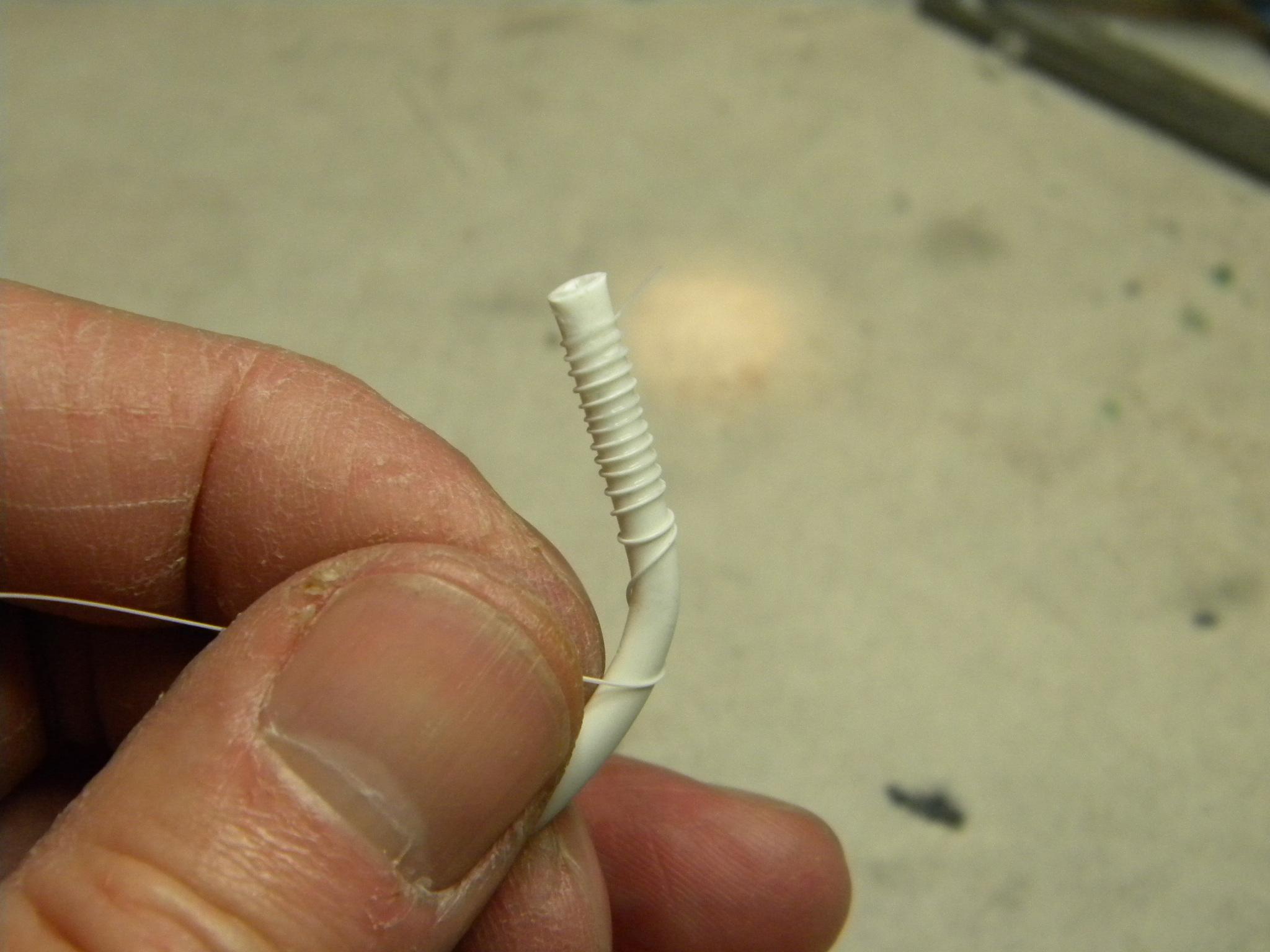

Plastruct makes some really thin styrene rod, so make  your basic duct shape out of plastic, wrap the rod around it and glue it in place, and a coat of paint should take care of the rest.
Gees Richard!!
Have you been hunkered down in a corner of my shop somewhere?! :D
This is exactly the approach I've been working on!
I thought I would at least give it a try with stuff that
I have on hand.
The only variation is that instead of investing in more thin rod, I just stretched some sprue very thinly to about the thickness of thread.
Started wrapping, checking spacing as I go, and welding it in place a few winds at a time.
So far, it's going well.
And as you stated, the sprue is thin enough that I believe a coat or two of fairly thick paint should soften the edges enough.
I do want to thank Bill profusely for his offer of the heat shrink!
I appreciate all of the great guys on the board who are so willing to lend a hand when they can!
Thanks guys!!
Here's where I'm at so far.
Steve
Edited by StevenGuthmiller
That looks pretty good, and the fact that the spacing isn't super precise makes it even more realistic.
If you're really feeling ambitions, you could probably use paint to build up the wrinkles seen on the original.
I tried not to get the spacing too precise, which really didn't take much trying. :D
The main thing that I wanted to do with the spacing was to "bunch up" the coils a little bit on the inside curve of the bends.
As far as the "wrinkles" go, I'm not certain how one would accomplish that.
Ideas?
Steve

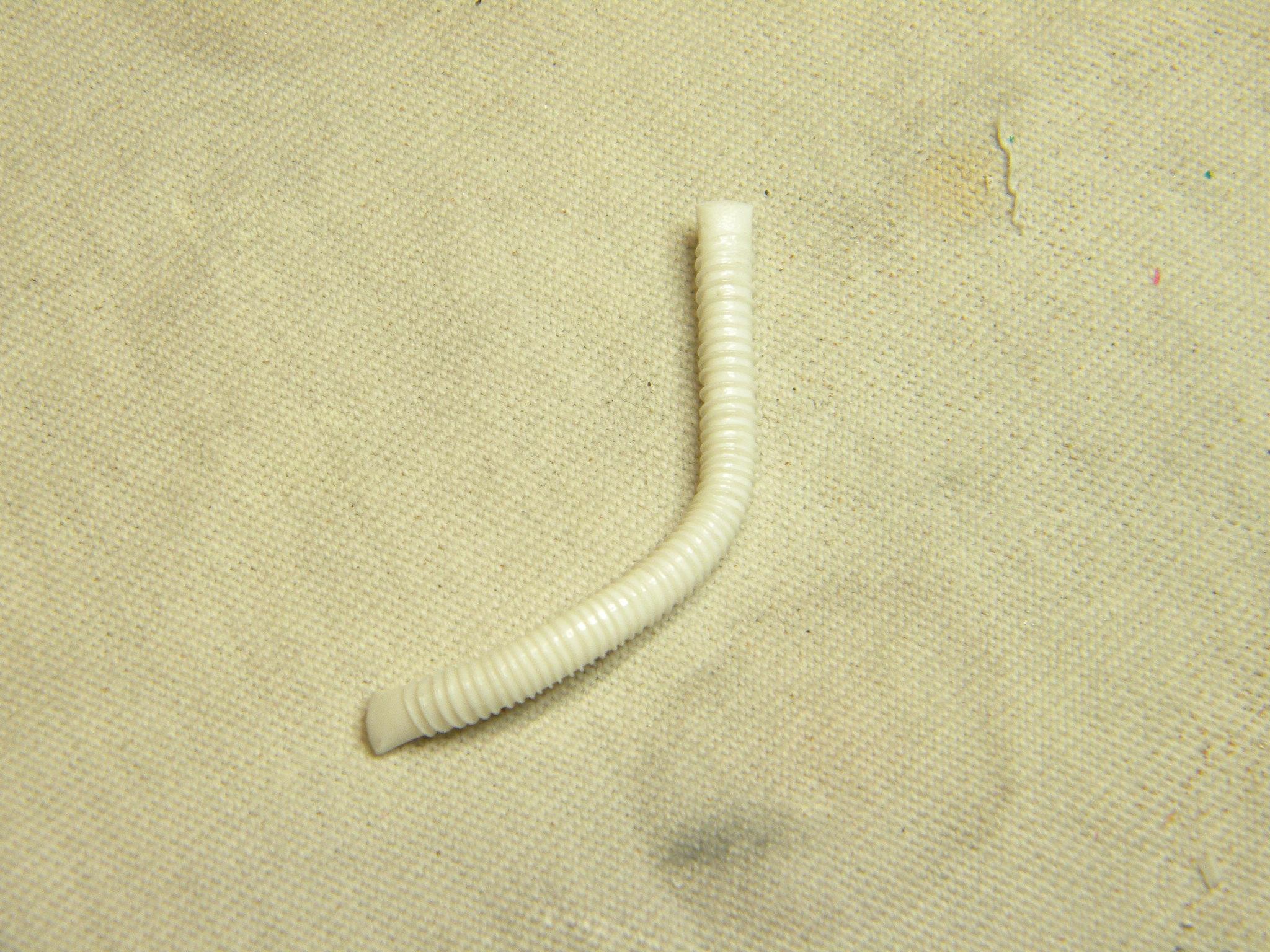

1 hour ago, StevenGuthmiller said:
Finished up the driver's side duct.
I'm thinking this will work just fine.
Steve
Looks good Steve.  I suspect that "painting" this duct's surface with some 5-minute epoxy would create a nice fillet at the base of the wrapped wire. Or maybe use some of the thick CREOS Mr. Surfacer liquid primer/filler the same way.
Thanks Peter.
I have some Testors enamel primer that I used on something else recently that seemed to fill pretty well.
Better than I wanted it to last time as a matter of fact. :P
A couple of coats of that followed by color might be all that it takes.
Steve
