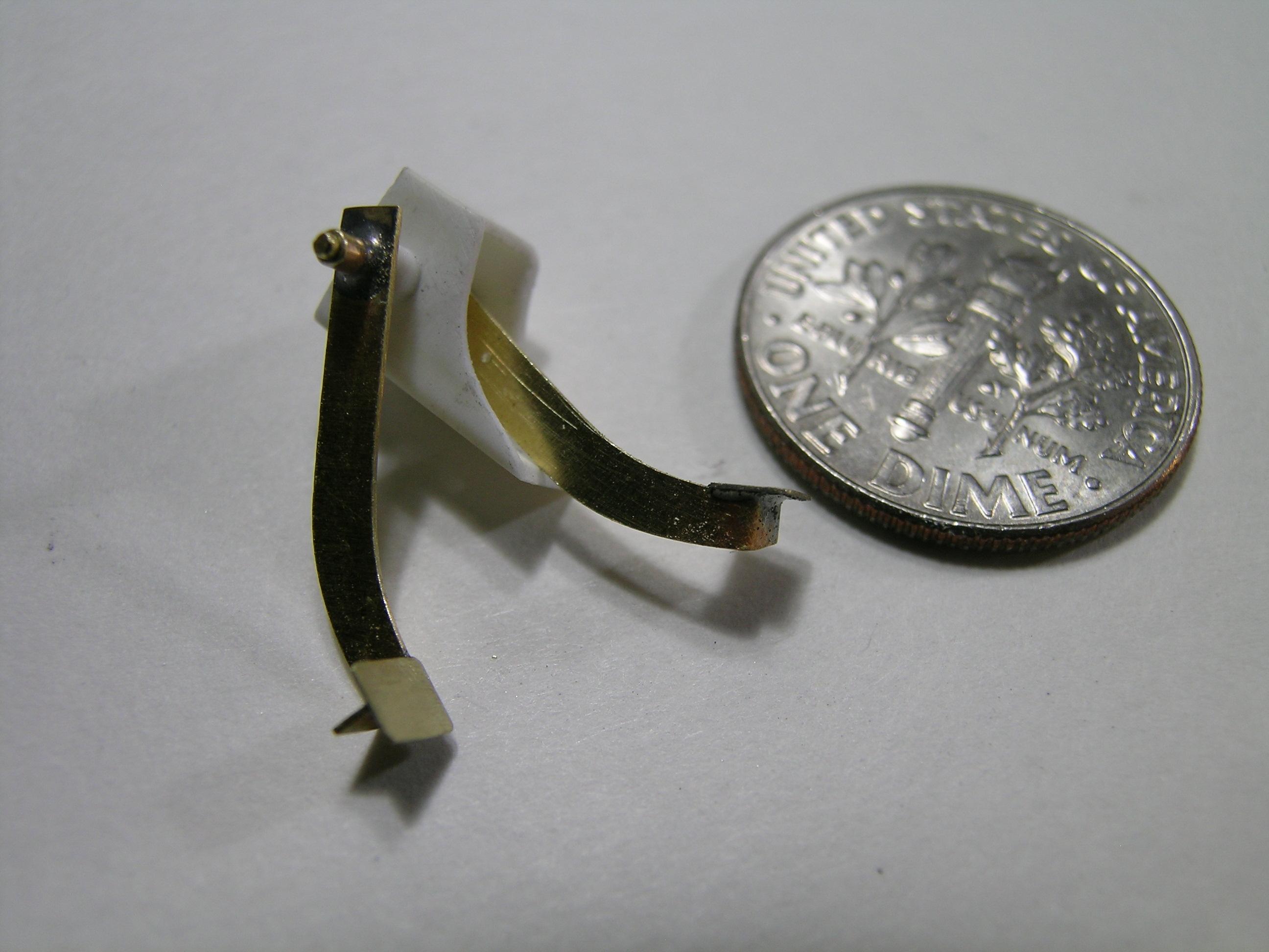

Pedal made with 0.010" brass.  The brass pin is temporary and will be replaced with a machined aluminum one.382_Pedal_Mount_Progress_1.JPG.bd879fcc9f5554e411f24bbaa9699ac3.JPG
I think this is the smallest I can do.  The rod is 0.020" and the hole is 0.013" hand drilled.383_Pedal_Mount_Progress_2.JPG.8737dd2258a8565660da8b41b3755b34.JPG
The plunger will fit the master cylinder.384_Pedal_Mount_Progress_3.JPG.95aa617ed808eab68000a261686afca3.JPG
Pedals folded to accommodate the footrests.385_Pedal_Mount_Progress_4.JPG.52b84d4f419b7f8f4b93f6840280b884.JPG
Footrests welded in place.386_Pedal_Mount_Progress_5.JPG.d737a35b4370aca4ab6ec387b6a38e01.JPG
Different view.387_Pedal_Mount_Progress_6.JPG.abe8be3724edbc117e28a32f9aff8fe9.JPG
Seen from behind.388_Pedal_Mount_Progress_7.JPG.8094f2ed19a7c1bc4e10b720f08197c3.JPG
A quick position test.389_Pedal_Mount_Progress_9.JPG.b481a82de0138a8b96dd9f98ef10ff76.JPG

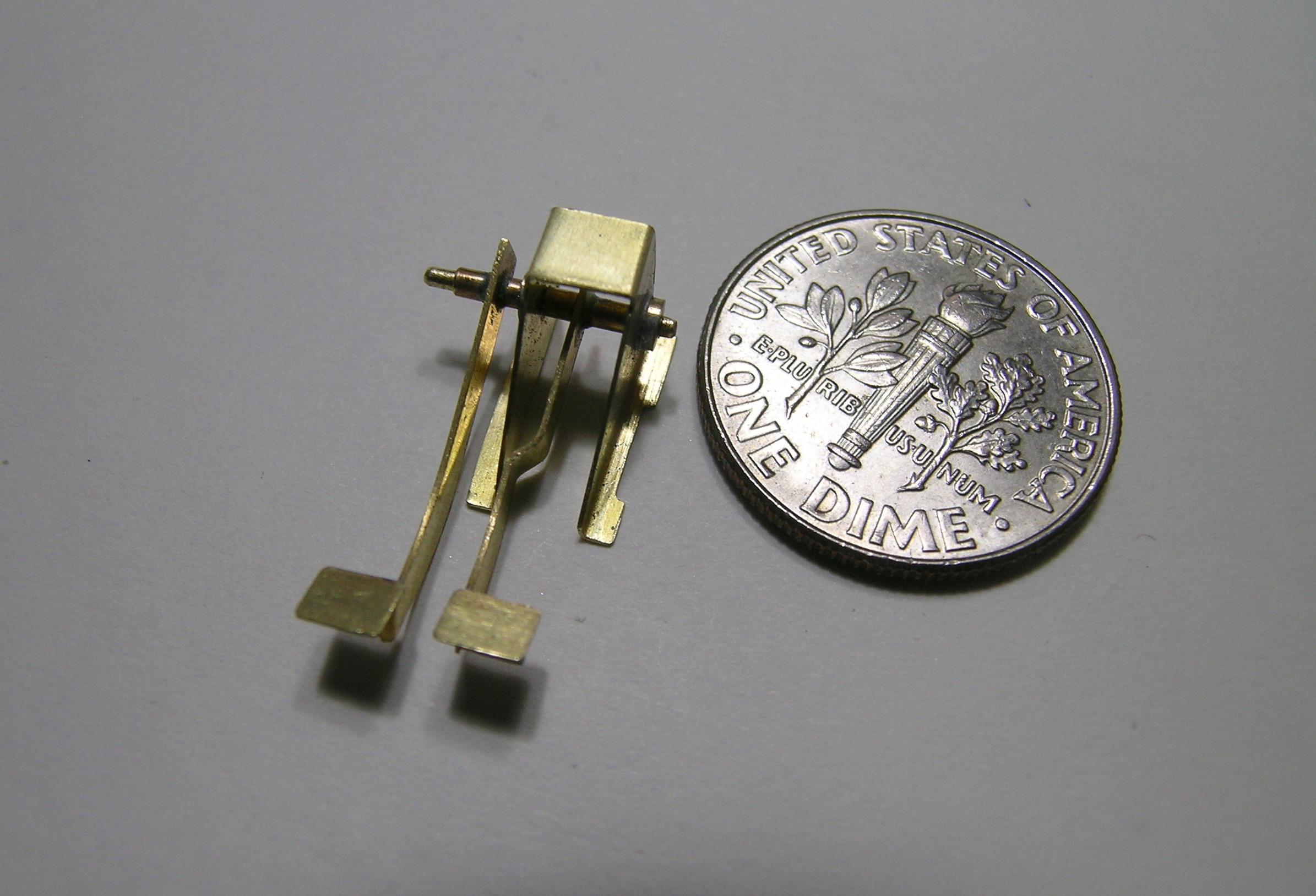

Mounting bracket redone in brass to be more to scale... sorry I couldn't resist...389b_Pedal_Mount_Brass_1.JPG.46655d8924fe2d95cef6bb6b606015e8.JPG
I think it was worth it... what do you think?389c_Pedal_Mount_Brass_2.JPG.97df226f347e96f98df9cf91a5cda356.JPG

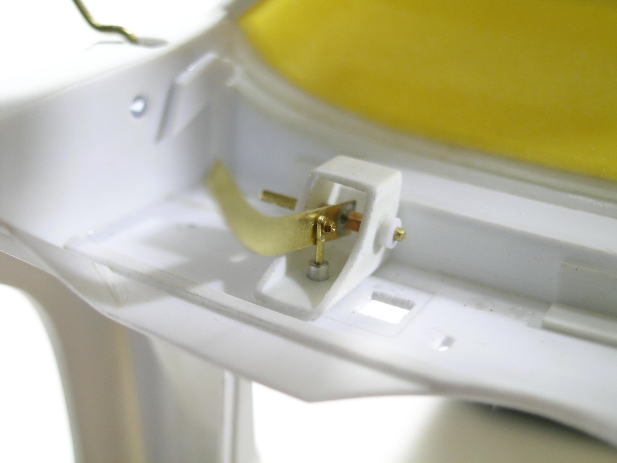

It fits like a glove and pretty close to the 1:1 part.389d_Pedal_Mount_Brass_Test_1.JPG.e8c6faed004026e0f209e02bd52b64a3.JPG
The part will still be clearly visible when the truck is displayed with the doors open.389e_Pedal_Mount_Brass_Test_2.JPG.59093f8b9eb17e05372200cf8fba145a.JPG

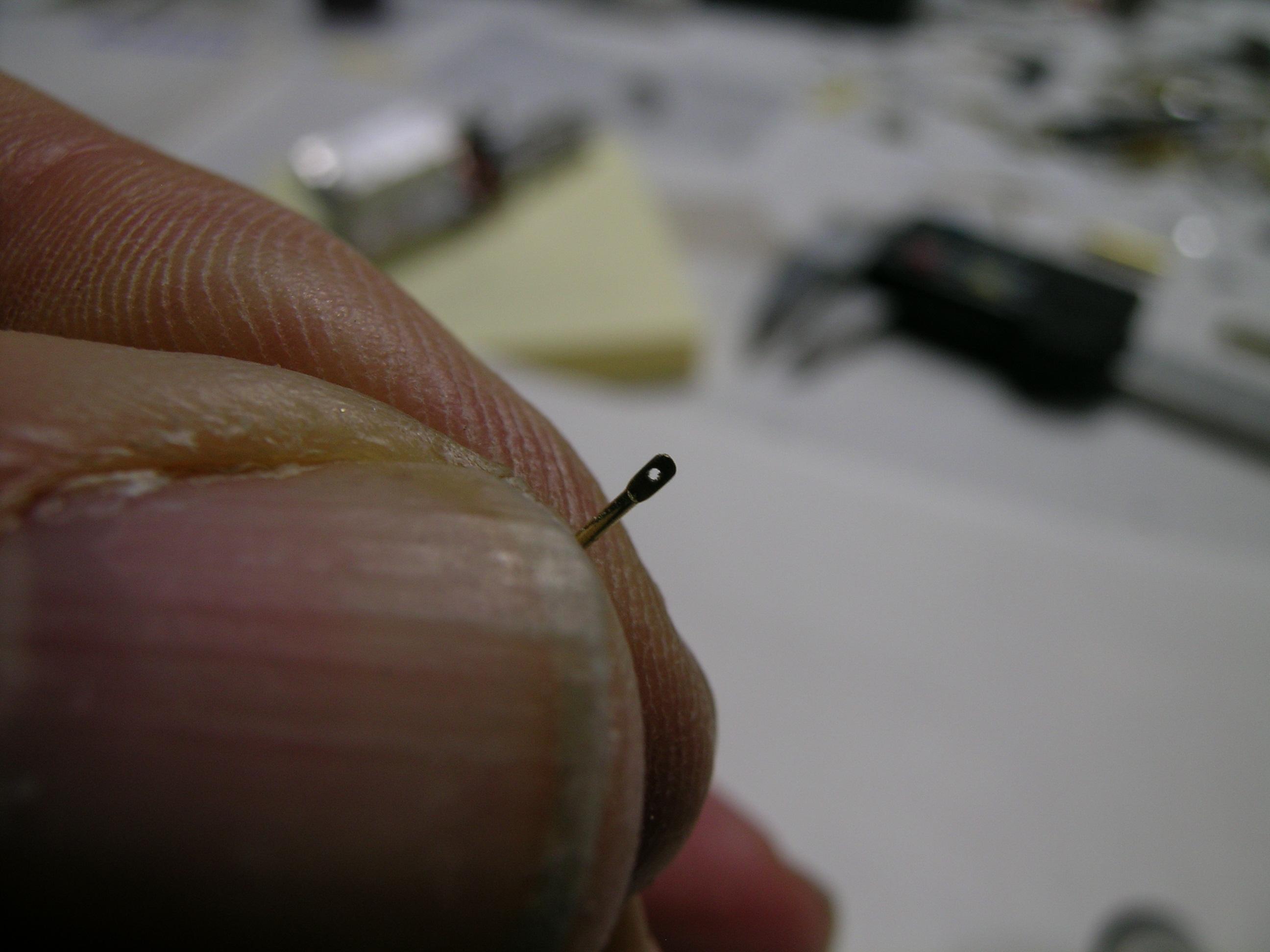

The throttle rod measures 0.020 "and is made of 2 rods welded perpendicularly to the pivot point. I wound up a 0.005" brass wire that came from a turn signal coil, this keeps the rod in place and centered.419_Gas_Pedal_Progress_1.JPG.0bc0fb1836e0dc18ba309f8ebd39697c.JPG
Finished part with the footrest welded to the rod.420_Gas_Pedal_Progress_2.JPG.a3c5eb000c06c90d6d16a21daf64d8eb.JPG
I drilled a small hole for the throttle wire but it won't move even if the assembly is functional.421_Gas_Pedal_Progress_3.JPG.6891dc6a10b0ffc6cc0a562e36c5df41.JPG
