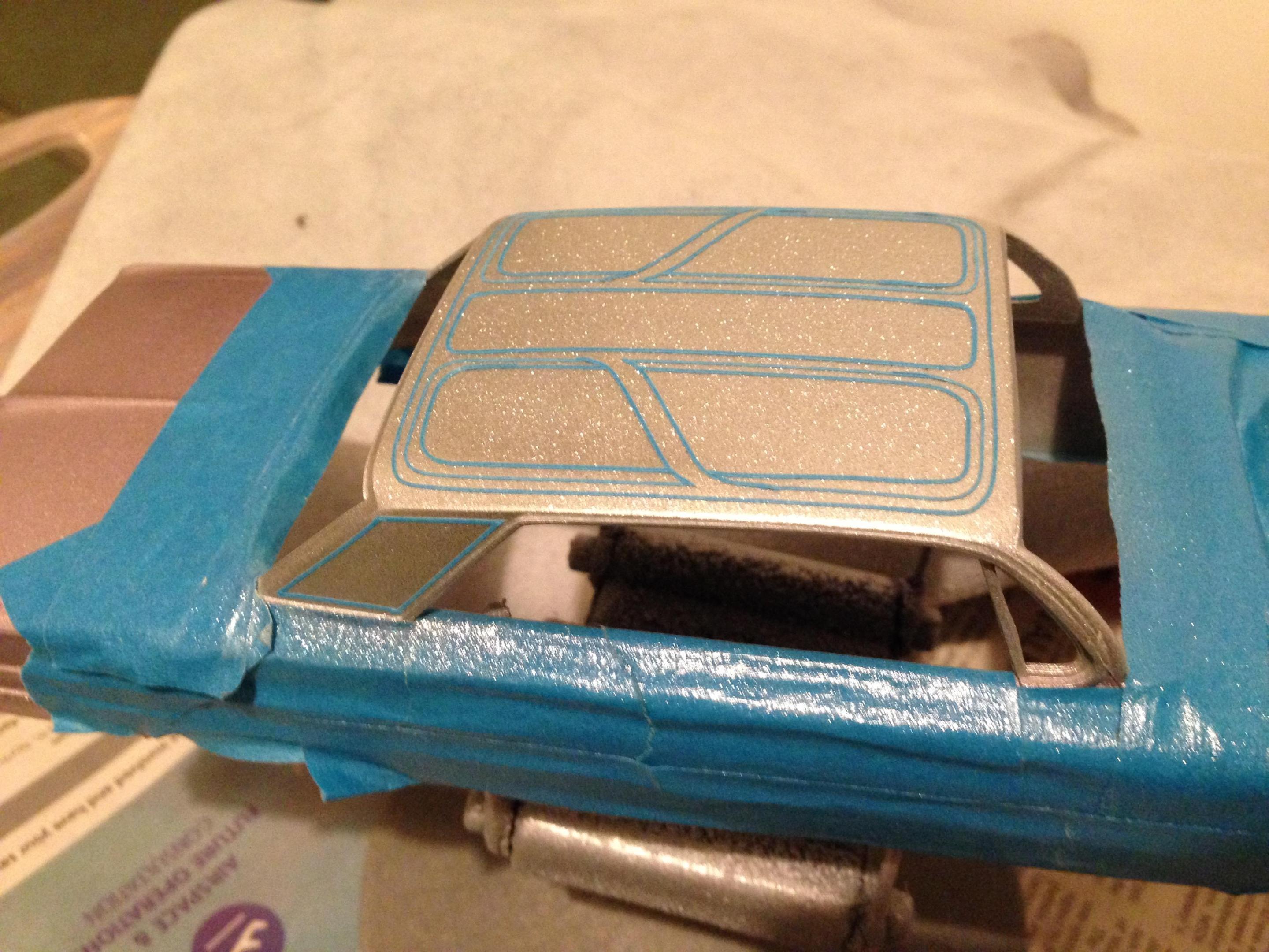

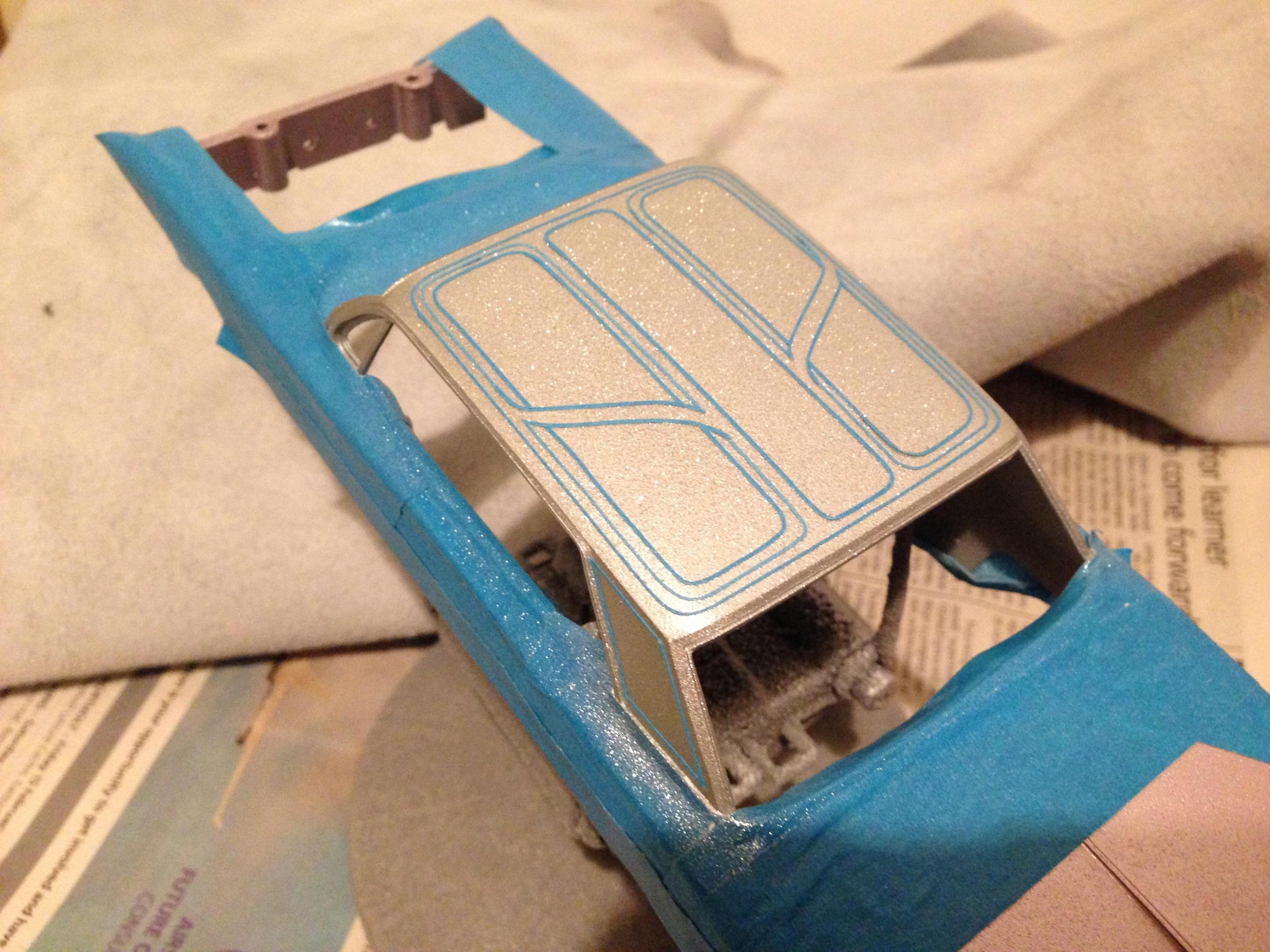

geetee66 Posted January 6, 2020 Author Posted January 6, 2020 21 hours ago, bisc63 said: Heck yeah! Old school metalflake look down to a T! 19 hours ago, Modlbldr said: Loving your work on this one! Simply beautiful. Later- 8 hours ago, Cool Hand said: Looking forward to seeing the result after the tape work. 6 hours ago, speedy5963 said: Looking good, can't wait to see how the pattern lays out! Thanks guys I finished the tape lines tonight:

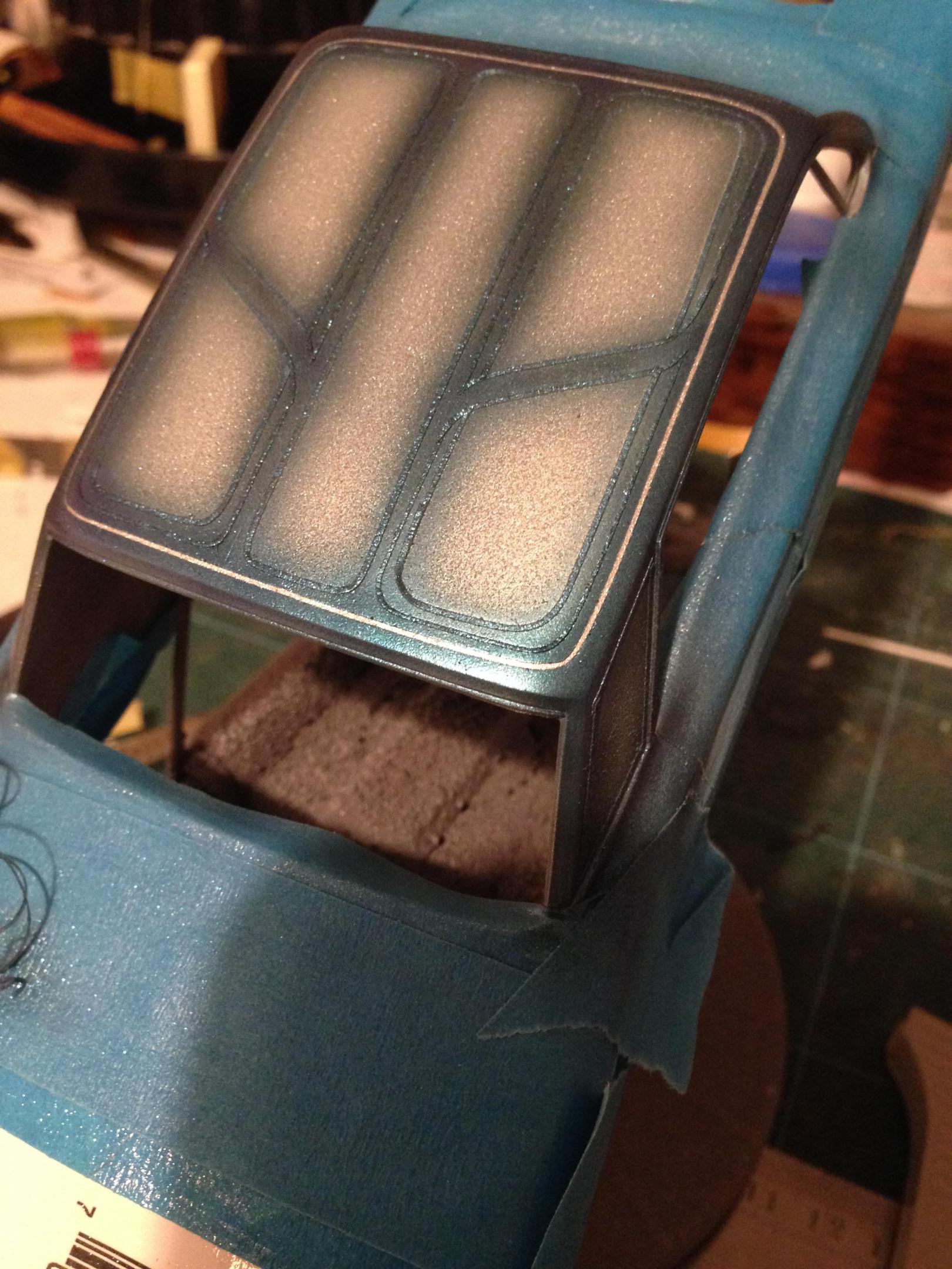

geetee66 Posted January 6, 2020 Author Posted January 6, 2020 (edited) As the fine tape likes to lift on the curves, I decided to go ahead and add some colour to the design. I removed the outer line to see how it looks. The blue shifts to purple and I reckon it'll look nice under the purple candy. The panels will have a black shadow fade, before lace decals are applied. Edited January 6, 2020 by geetee66

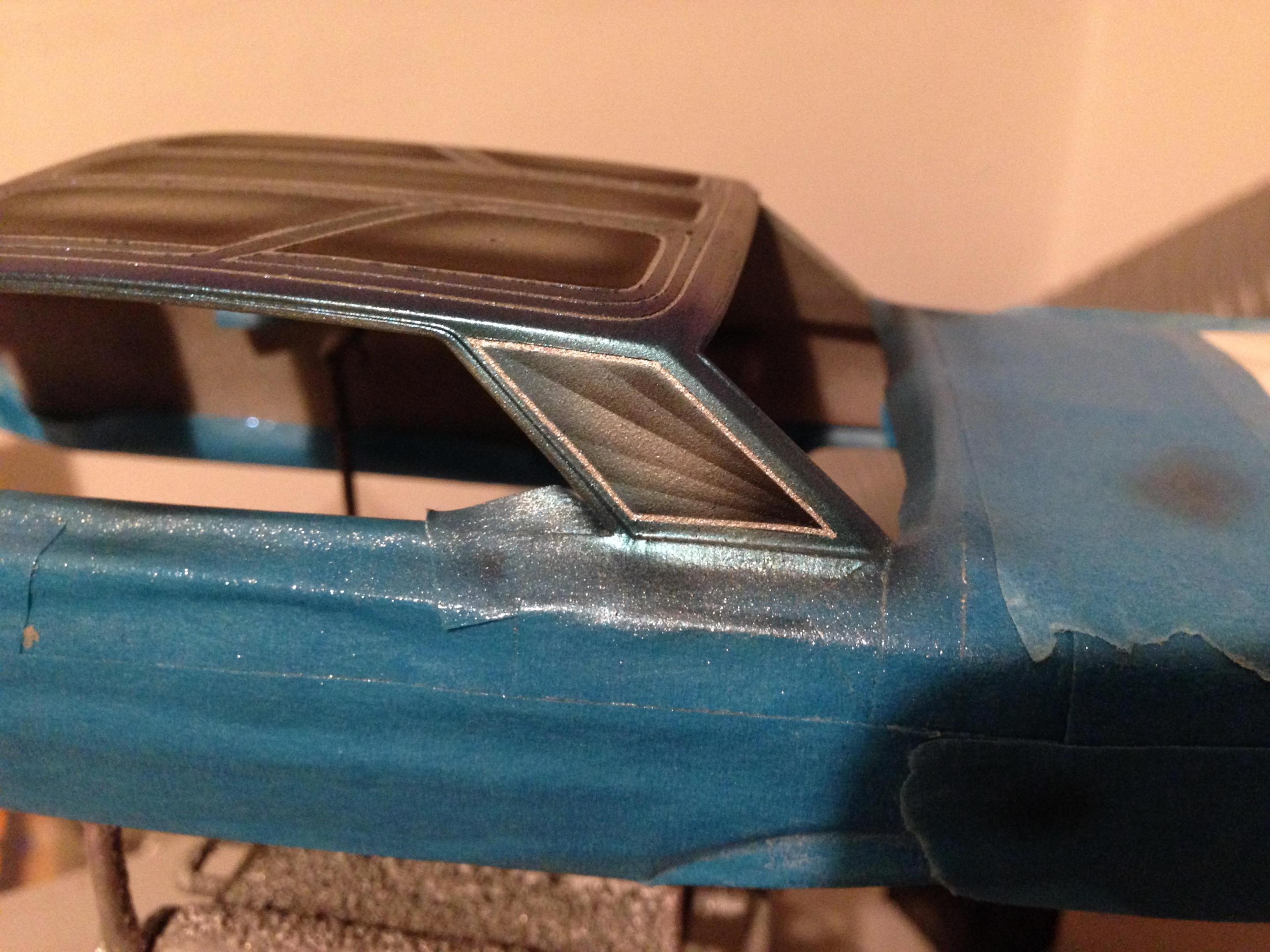

geetee66 Posted January 7, 2020 Author Posted January 7, 2020 Masked up the roof again and sprayed some black around the edges of the panels and did sunburst patterns on the C pillars.

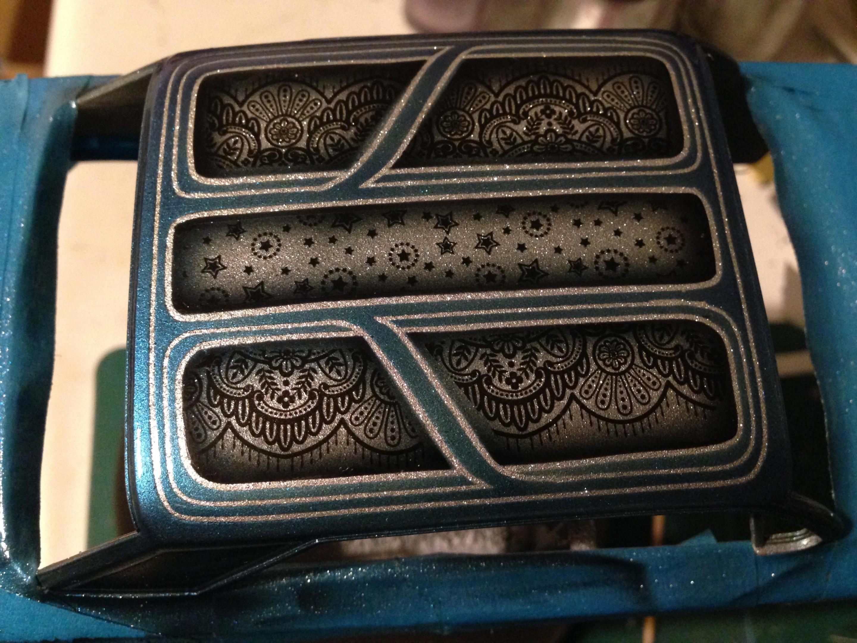

geetee66 Posted January 11, 2020 Author Posted January 11, 2020 Thanks for following the progress chaps. got the decals on last night. Gotta let them dry, then clear, followed by the purple candy, then more clear.

espo Posted January 11, 2020 Posted January 11, 2020 7 hours ago, geetee66 said: Thanks for following the progress chaps. got the decals on last night. Gotta let them dry, then clear, followed by the purple candy, then more clear. I have been enjoying watching your build and the paint work especially. You mentioned adding decals ? So the patterns on the roof are decals ? Do they come in black or other colors and what is the source of the decals ? When you lay the candy color over this it's really going to pop.
geetee66 Posted January 11, 2020 Author Posted January 11, 2020 3 hours ago, espo said: I have been enjoying watching your build and the paint work especially. You mentioned adding decals ? So the patterns on the roof are decals ? Do they come in black or other colors and what is the source of the decals ? When you lay the candy color over this it's really going to pop. Thanks Espo, I'm glad your digging it! Yes, the lace and the stars are nail art decals. £1.25 a sheet on eBay. Just search 'nail art decals' I've got a bunch of them now.. hibiscus flowers, skulls, roses, tartan, zebra.. The lace pattern decals seem to be mainly black, but there are some white ones around. They behave well, respond to setting solutions and don't seem to react to clearcoat. Thanks for your generous comments, everyone. It means a lot.

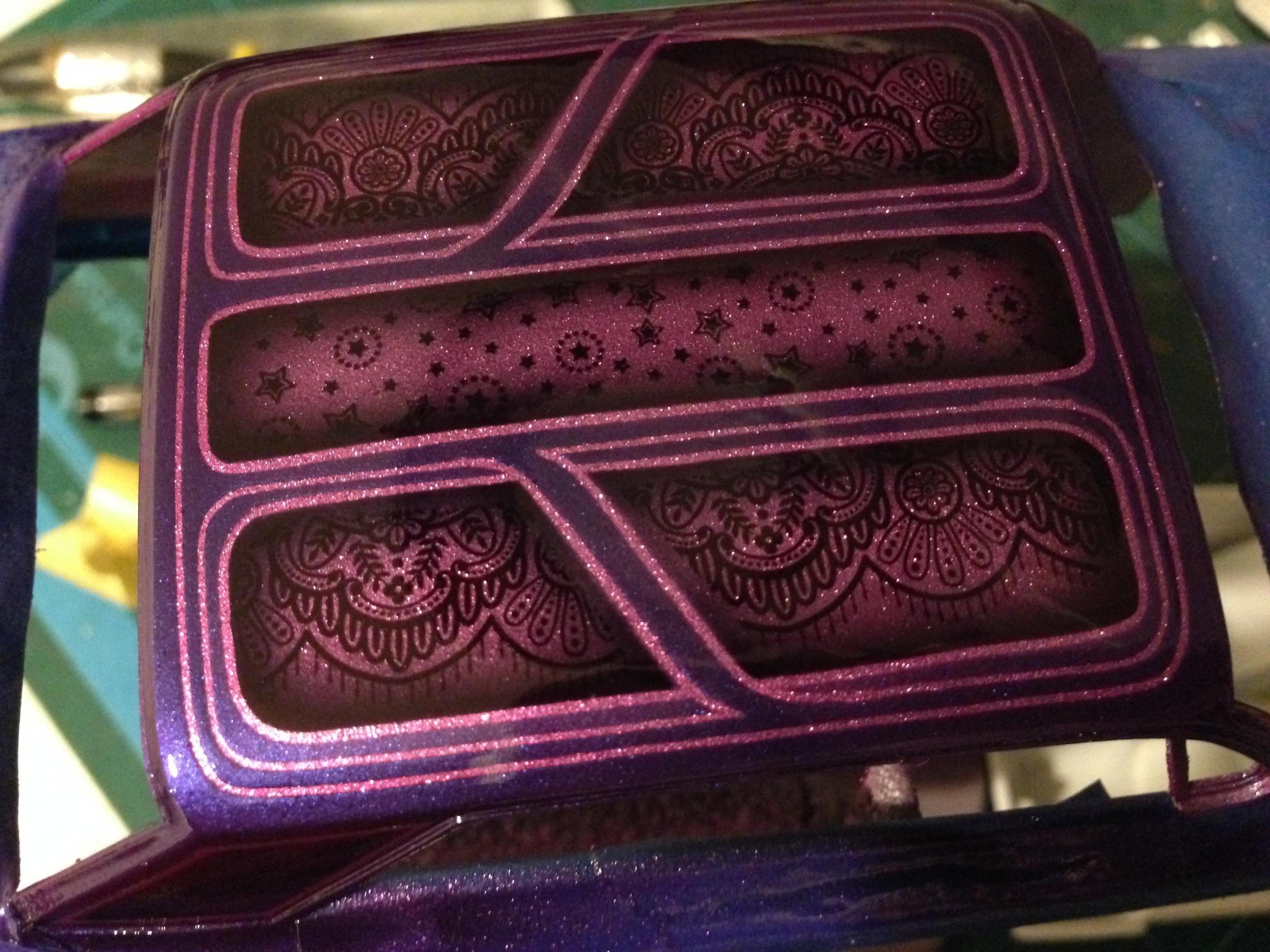

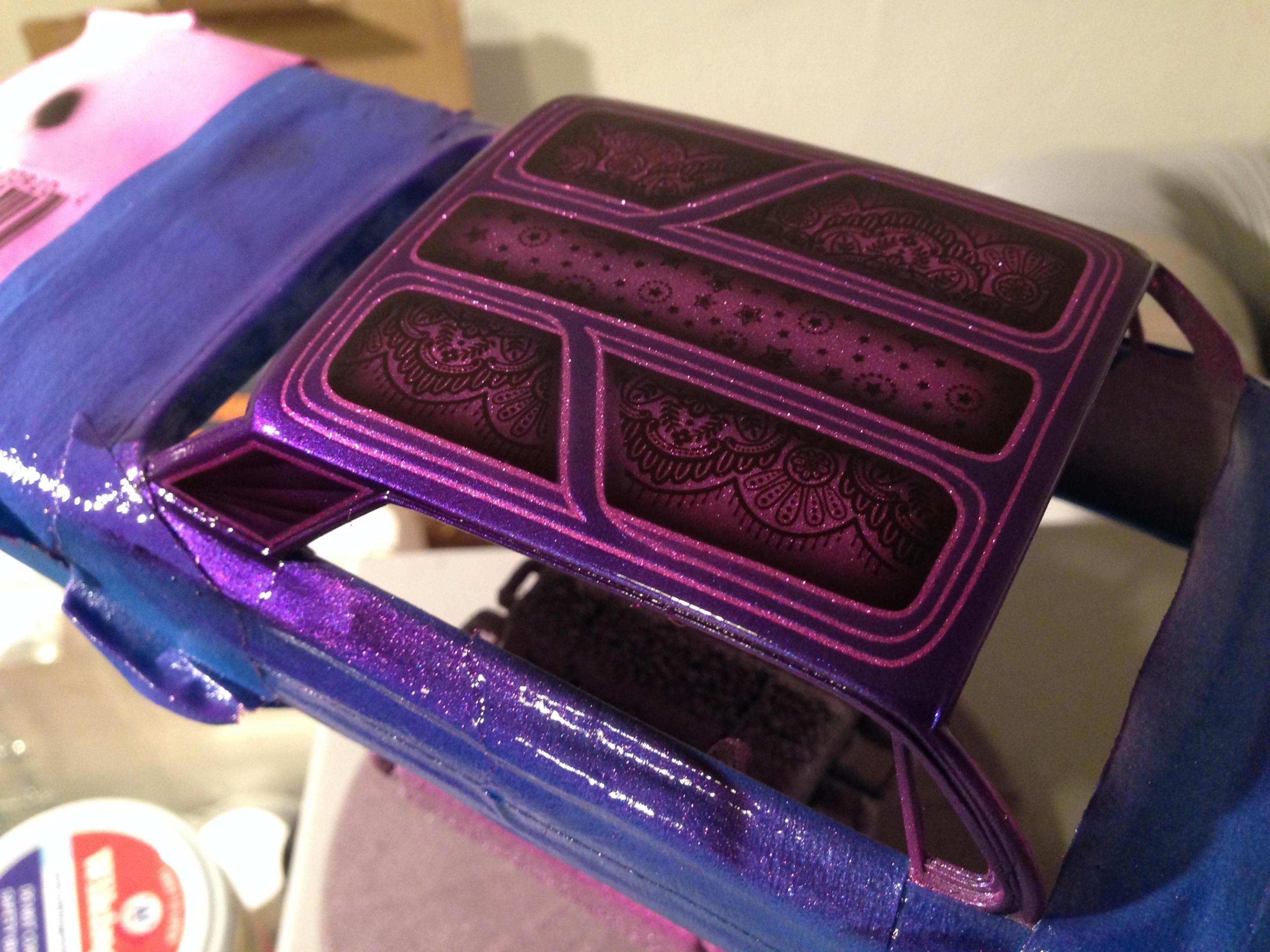

geetee66 Posted January 12, 2020 Author Posted January 12, 2020 Got the purple candy on. I think it worked out ok.

Cool Hand Posted January 12, 2020 Posted January 12, 2020 Very impressive Guy, few layers of clear to bring out the shine and it will certainly bling in direct sunlight. Well done.
