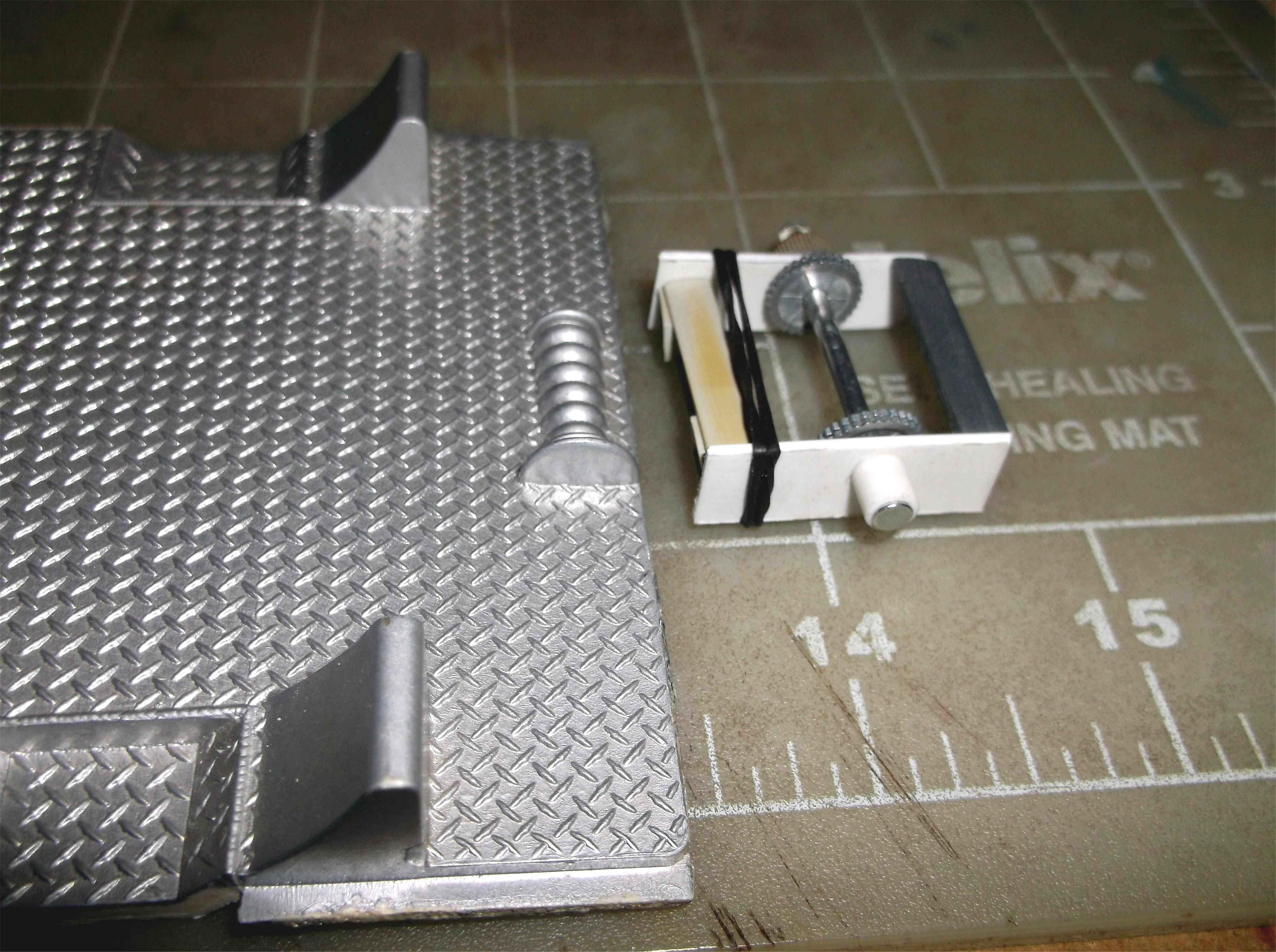

DPNM Posted January 4, 2020 Author Posted January 4, 2020 (edited) A car type hauler using the silver one. The red one and the frame behind it are from the Ford Car Hauler kit just for length comparison. And if anyone knows what kit the silver one is from I would be thrilled to know. I've had it for I do not know how many years. I must have been saving it for this build. Edited January 4, 2020 by DPNM
