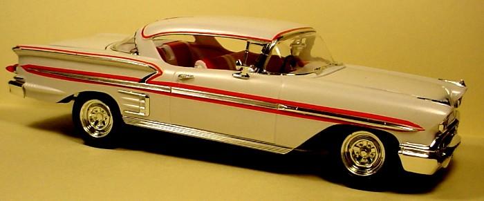

Dave Van Posted January 8, 2020 Posted January 8, 2020 (edited) I have built a few AG cars but not as many as planned......... Steve/Toad 58 from Revell kit.....it was going to be a die cast but Revell changed their mind. Modelhaus wheels and Caddy tail lights. For a more obscure AG car how about the T bucket Milner is talking to while sitting in the parking lot??? We never see it clearly so I did a best guess version.... Edited January 8, 2020 by Dave Van

57peppershaker Posted January 9, 2020 Author Posted January 9, 2020 21 hours ago, Dave Van said: I have built a few AG cars but not as many as planned......... Steve/Toad 58 from Revell kit.....it was going to be a die cast but Revell changed their mind. Modelhaus wheels and Caddy tail lights. For a more obscure AG car how about the T bucket Milner is talking to while sitting in the parking lot??? We never see it clearly so I did a best guess version.... I sure wish they had of released the 58 as a diecast Dave. I know its avail in 1;18 but they are too big for my display cabinets. Is that your build ?
