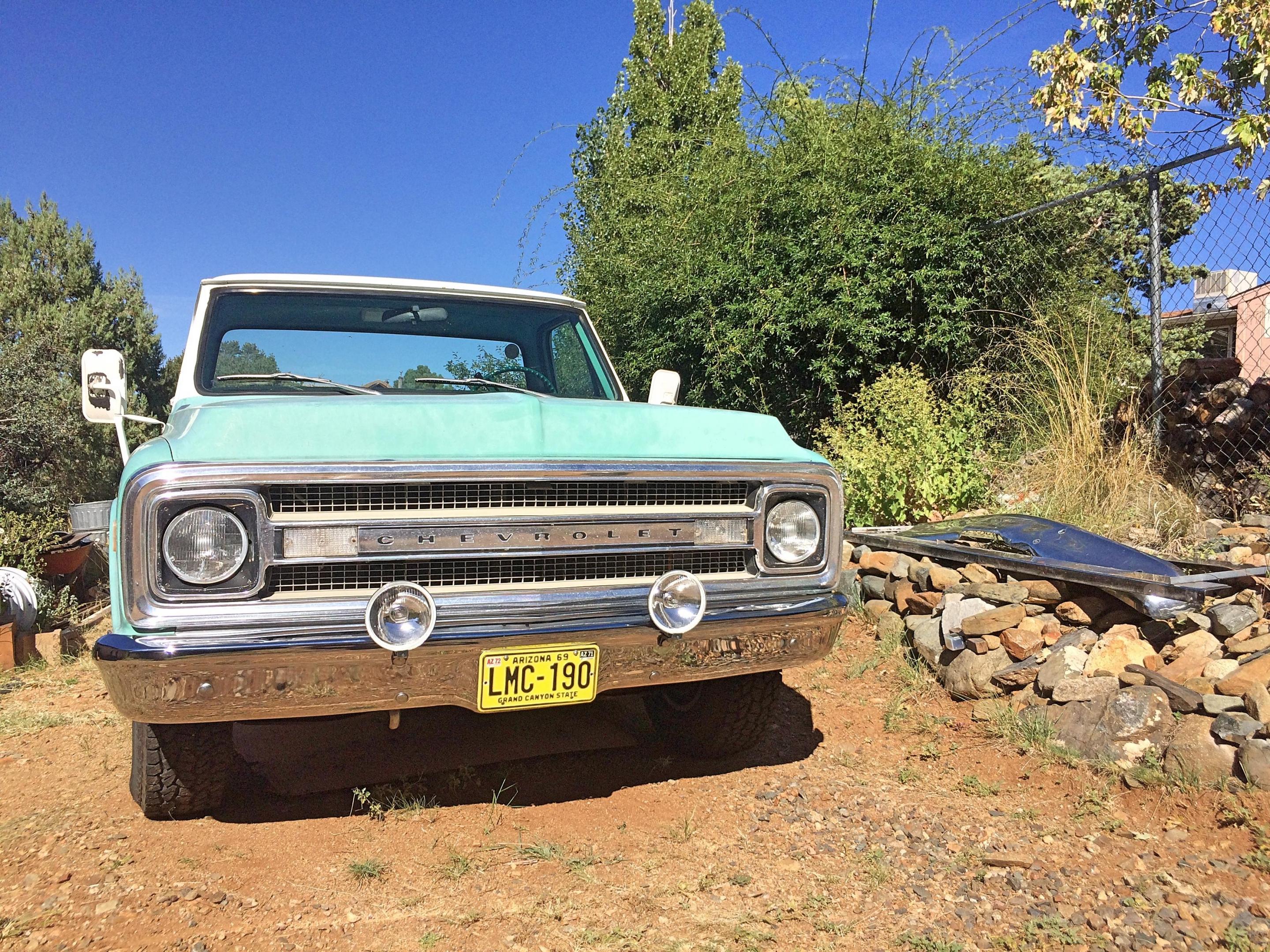

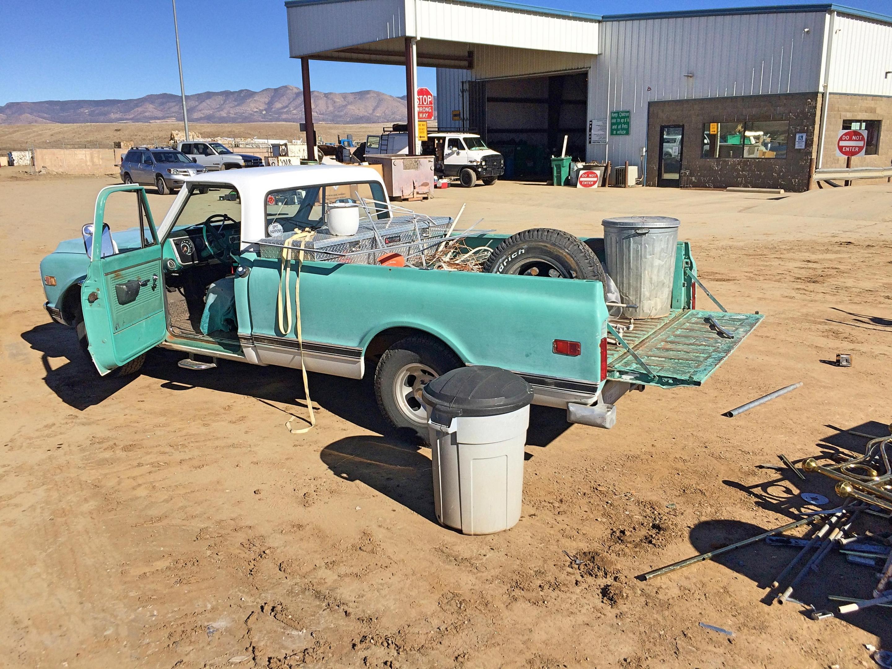

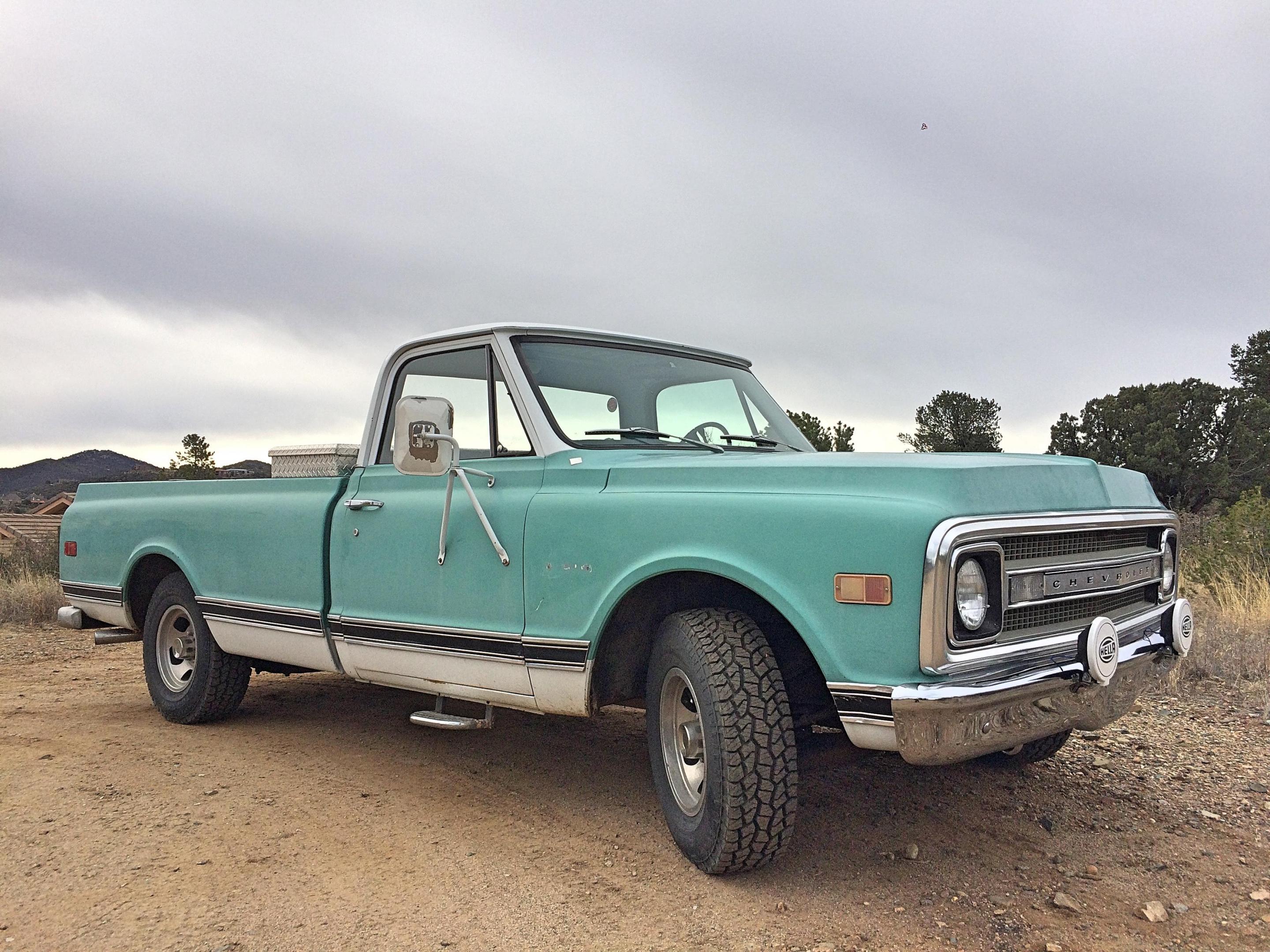

I owned this 1969 Chevrolet C-10, got from a friend who needed the money, died last year, nephew bought it because it was sold new in Safford (still had the service plate with the manual) to a relative.  It grew on me, found out why they are very coveted, much like the model kits! ?  I nicknamed it The Green Barge because a friend owned a nice motorcycle named The Green Monster.  Currently own a 1968 C-10, so can use for reference (which is the same blue this model was painted).
Going to build for a future diorama idea, so not going to scratch-build an accurate chassis, but will grind off the left exhaust to replicate this truck (I wanted to put on twice pipes).  Bought off Facebook Marketplace, it was built half decent, seller had stripped the body, I'm stripping and rebuilding the rest.  The plan is to improve some things, and modify to resemble the trim specifications.  The interior is going to be a major scratch-build: cut out the bucket seats and make a bench seat from Corian, dash will get gauges behind 'glass' (minus little auxiliary ones), add shift lever and turn signal, pedals, door panels were steel with simple arm rest.  Exterior will have the upper trim removed, the raised wood grain needs to be removed from the lower trim, tailgate will be a major change, drill stakebed holes, modify the front bumper, sidelights need to be basic, and fix the horrible taillights.  Scratch-build: the license plates, rear bumper, mirrors, toolbox, steps, driving lights (which came off my MINI).  Aftermarket details: gauge faces, slotted mags, and the big deal item is the '69 grill!
I took reference pictures with the tape measure in the picture when I sold it, will post them as I get to those parts.  Start off with these photos to give an idea.
Hauling flagstone:

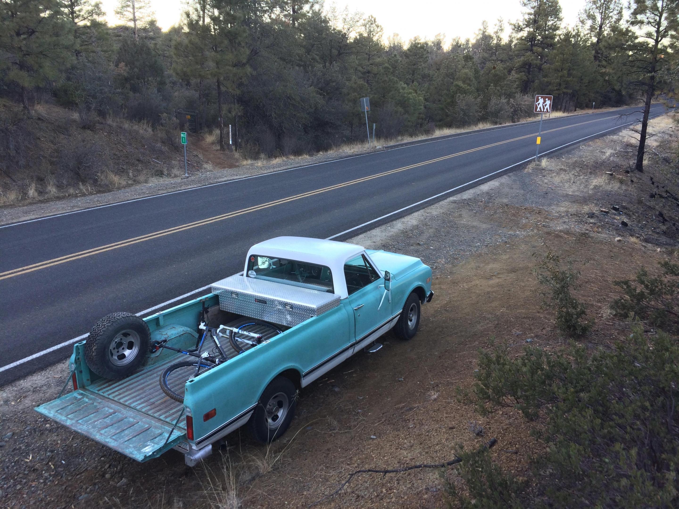

Hauling mountain bike:
Replaced the perfectly bumper that I snagged on the fence post:
Day that I said goodbye:

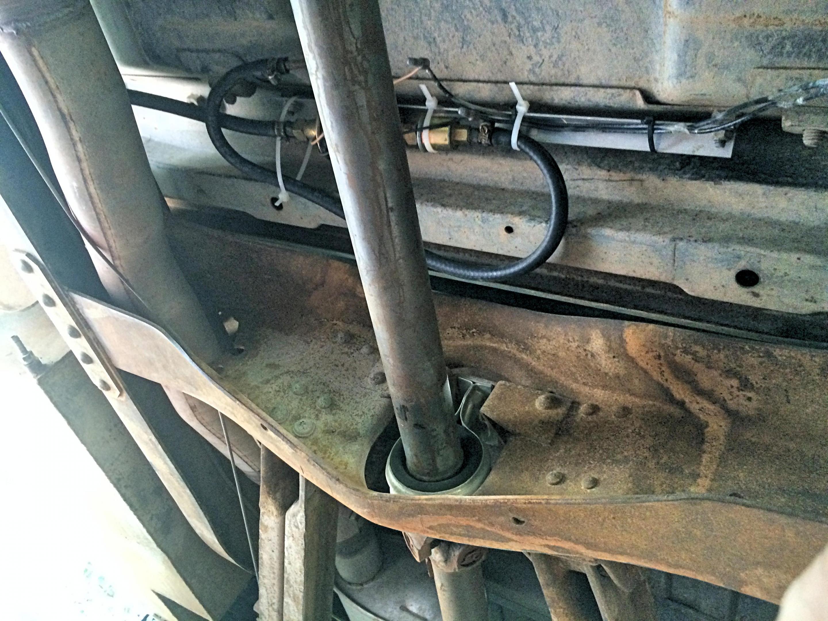

Usually everyone adds twice pipes, in this case the truck had one muffler and pipe to the back.  I'm not worried about accuracy or concours quality underneath, and was not going to replicate the pipe going through a torched hole in the cross member. ?  Used the Dremel to grind off the extra pipe, needed to fill where the muffler was with sprue, and superglue/baking soda other areas on top (not pictured).  Block is painted.  Also not doing the electric fuel pump, which was jerry-rigged on because it had saddle tanks, which I removed, and failed on me, which got the mechanical fuel pump put back on the engine!
Jumped on the other project to give some time for the orange to dry.  Masked and painted semi-gloss black, that truck had an aluminum intake, but I painted this orange too, it also had black valve covers because it was a crate motor, and I like that contrast.  Painted the transmission pan black too, instructions did not say so, but I recall it wasn't aluminum.  I modified the air cleaner to mimic the aftermarket unit that was on that truck (and the '68), painted Alclad chrome.
I recently got a set of scrapers from MicroMark, wish I got them years ago!  Made the rerouted exhaust pipe from solder.  Will put a longer stainless steel tip on after the chassis to body is assembled, that's a mistake from the other project.

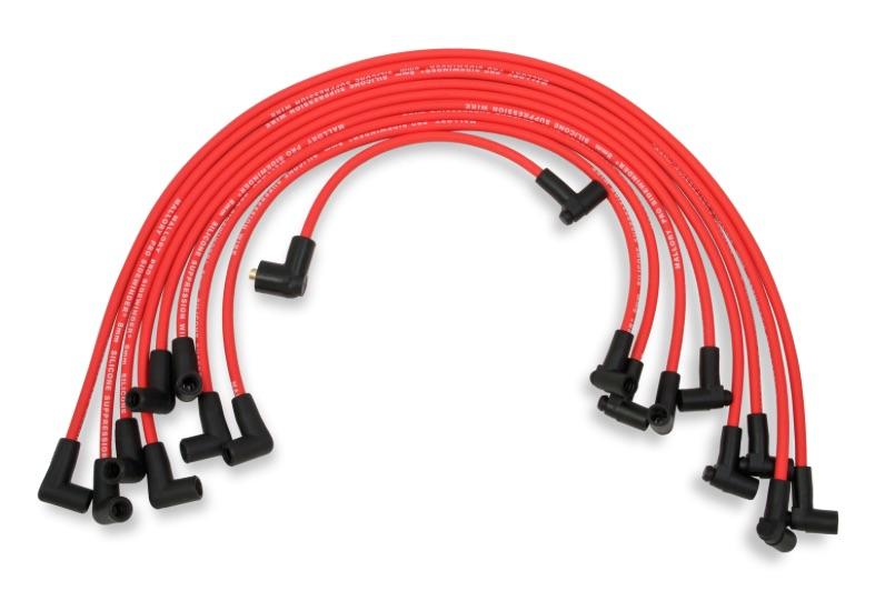

Start today with a picture of that first drive.  I'm taking liberty on this build, not doing the gas saddle tanks, the chrome bed rails (always blinded me every time I walked by), the windshield CHEVROLET was the first to go, the black triangles where the fender badges were removed, and the rusty chrome wagon wheels.

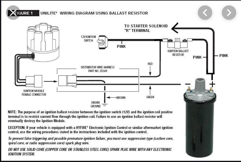

Needed pictures to go from:
Doing red wires, because I have the wire, looks cools, but not faithful, but like I said....

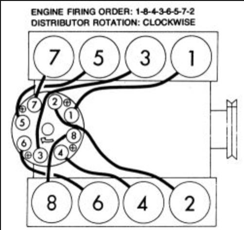

Firing order:
Redoing the coil, it was not sticking up like the kit:

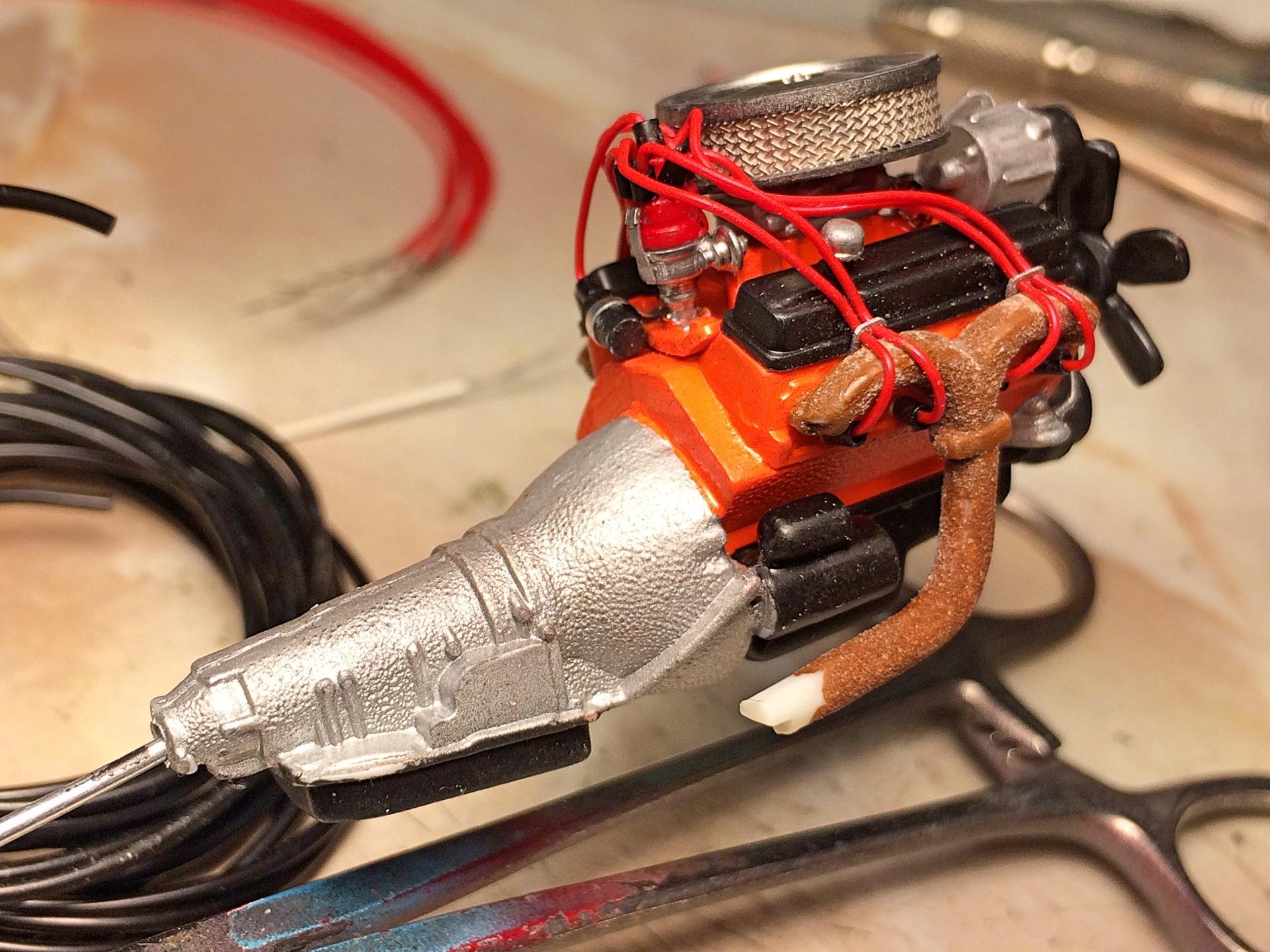

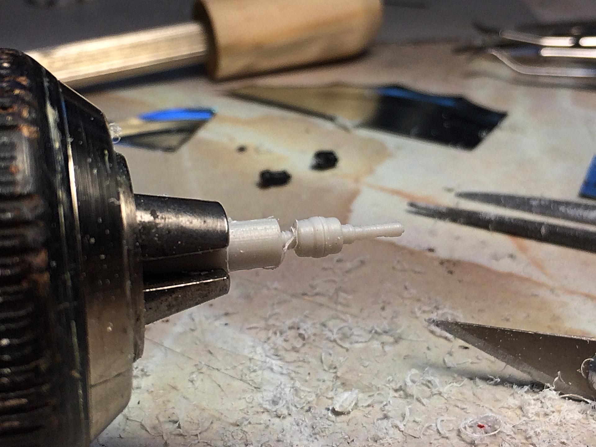

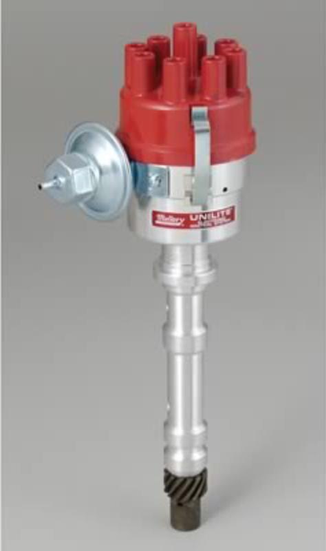

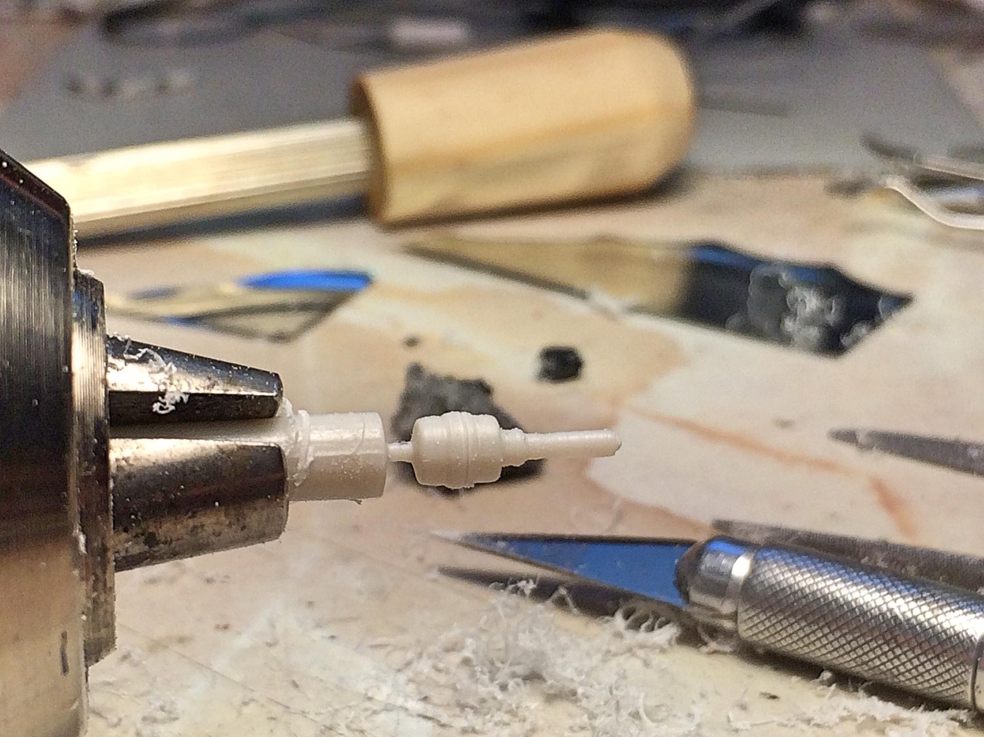

All I wanted to do... is make a distributor. ?  Used the cordless drill on high speed, with the Dremel to rough out.

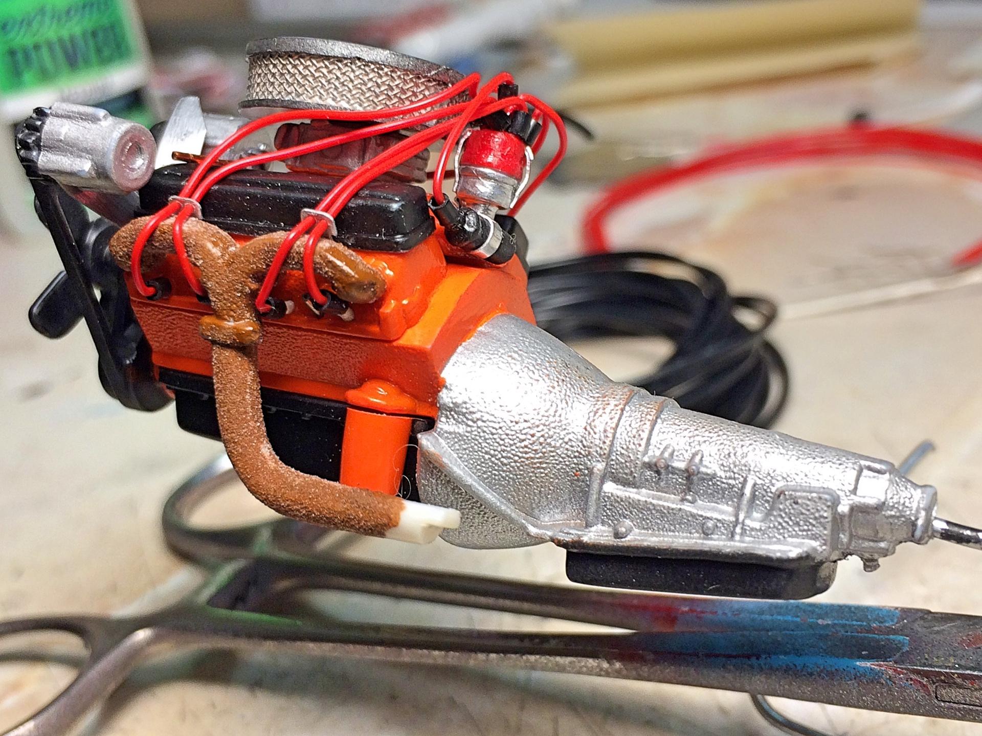

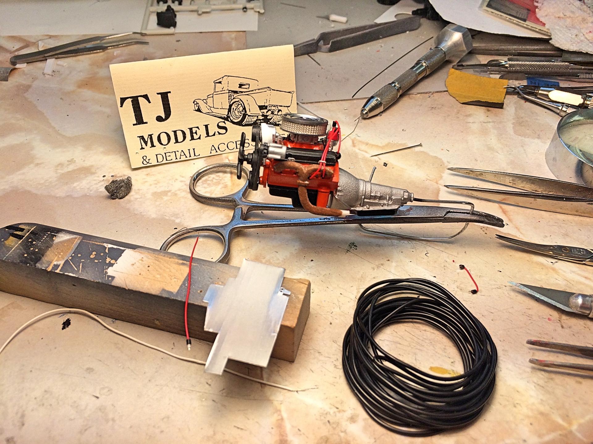

Read a tutorial yesterday about plug wires.  Used Tamyia hollow tubing for the ends, instead of wire insulation.  Did use white wire insulation at the plug end.  Made loom holders from aluminum printing plate.  Here is the cluttered bench with materials and tools used:
Had to glue the headers on, painted 'leather' and sprinkled baking soda on it.

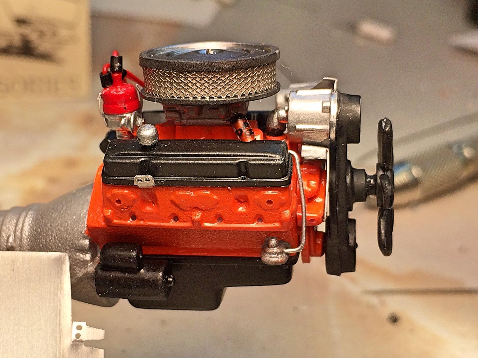

Made generic accessory brackets from the same aluminum, added some photo-etch nuts just because I have them.  Also made a thermostat housing, which aims the hose out correctly (copper wire is temporary), the kit hose is wrong.
Also turned the vacuum advance thingie, and oil filler cap.  Put two clamps on the distributor made from aluminum plate.  The last loom part is still on the plate.

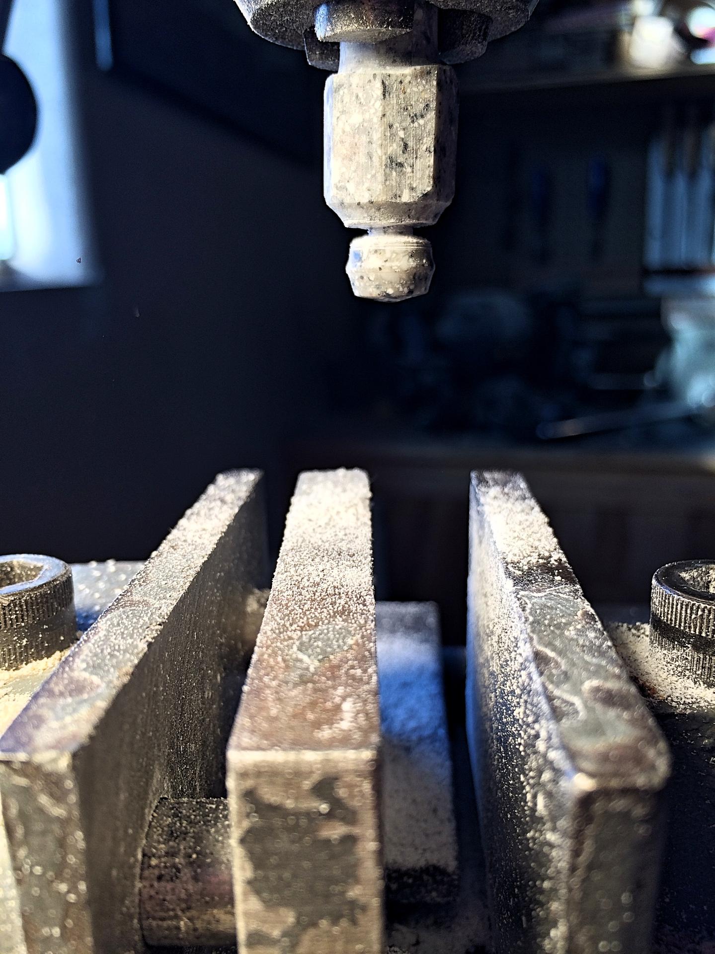

Used the drill press to turn the 1 ton brake booster out of Corian.  Roughed out with the Dremel, used a worn #11 blade, file, sandpaper, steel wool.  Airbrushed silver and set aside for much later.
Does anyone *really* like doing plugs wires?  ?  Even though it's on a stand, practically worn the paint off.  There is half-baked construction, but good enough for government work.  Good thing the wires are asbestos.  ?
Even though the rest of the engine bay, and especially the chassis, is hardly accurate or detailed, figured having the dolled up engine would juice up the build.  It was also rehearsal for the V-12 on the other project.

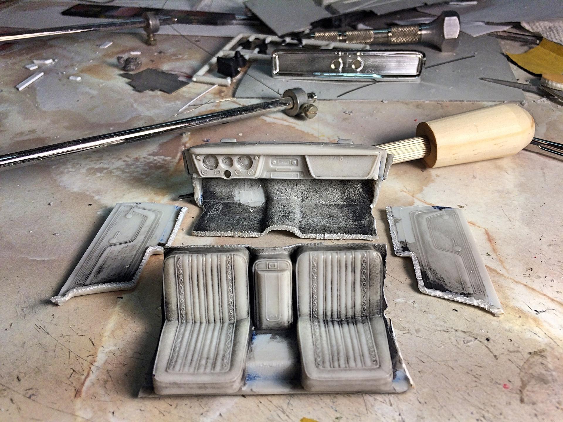

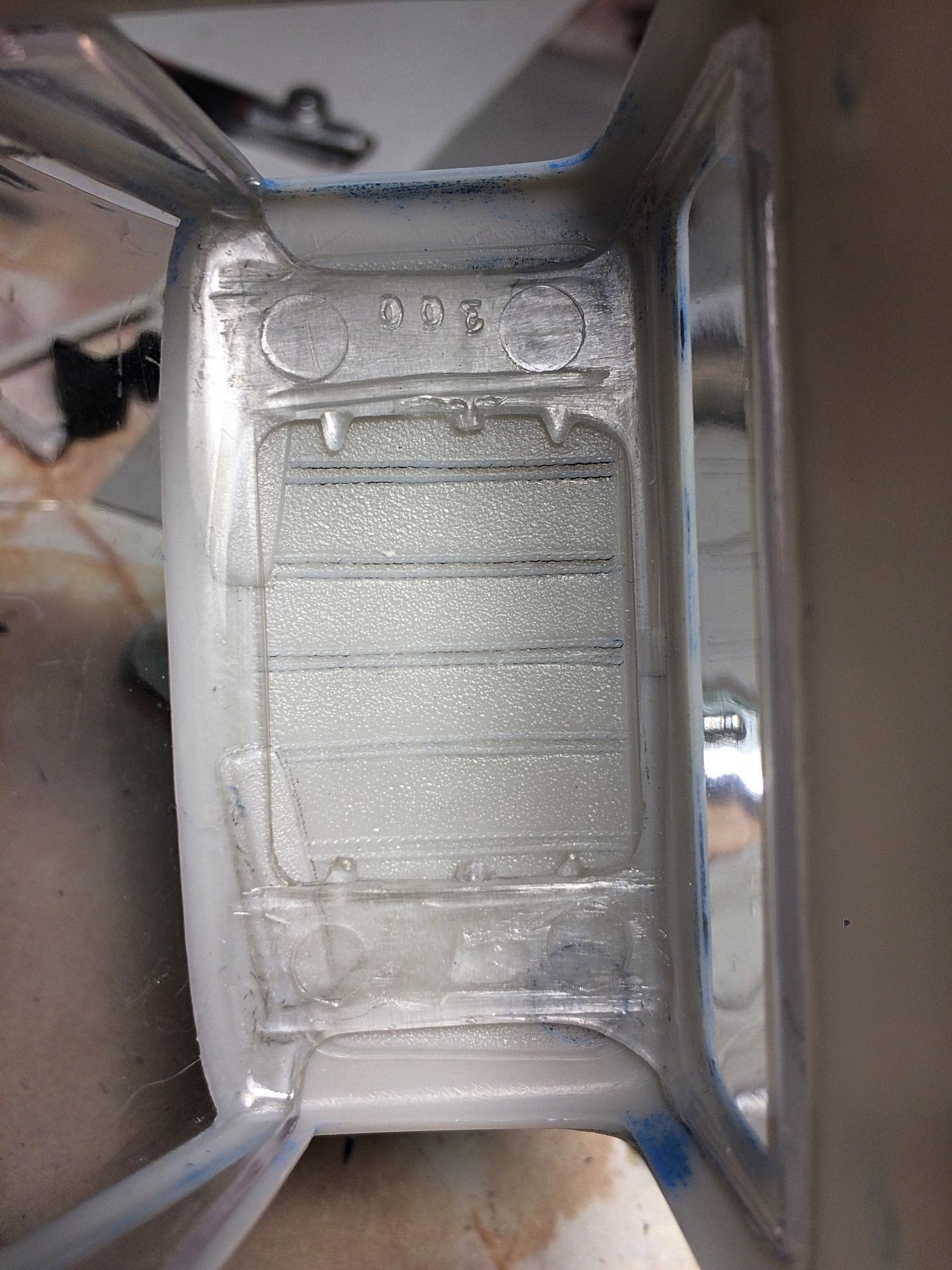

Started on the interior.  Seems to be snowballing......
Amusing to see there is detail on the ceiling, which is something that's never done now.  I think it's different than base level, but I'm not changing anything.  There are also sun visors.  Then the glass goes over it.  ?  Will cut that apart with the hot-wire.

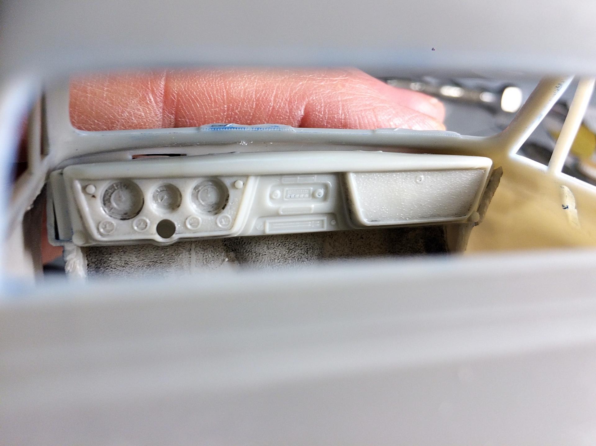

Dash is too low for my taste, needs to be raised over 1/16".  The Green Barge did not have the 4 lower gauges, and the glovebox was not textured.  I'm entertaining the idea of opening the glovebox, since it's missing the upper edge anyway.  There is a heater box under the dash that could be added.  The round vents on the ends, and top of dash could use detail.
Cut the interior apart with the hot-wire.  The plastic is super thick!  Ground off the molded on pedals.  The steel door panels could probably use the custom grill for the ribbed part.  The floor goes to the back of the cab, am planning to glue on a ledge in the cab behind the seat.  Anyone want those seats?
How do you make the exhaust manifolds look rusty?
Oh, thanks for noticing, forgot to say that I sprinkled baking soda on the wet paint.  When I weather everything, was hoping the Dullcoat/dust would subdue the white crystals.
Looks great!
I would call this break eggs to make an omelet stage.  Used the hot-wire to cut apart the custom grill, to use for the door panels, and the driving lights.
Also cut apart the glass with the wire cutter.  Started fabricating the interior.  Experimented denting the bed floor, which was pretty rough from working on a ranch.  The Corian brake booster is painted.  Cut out a window crank.

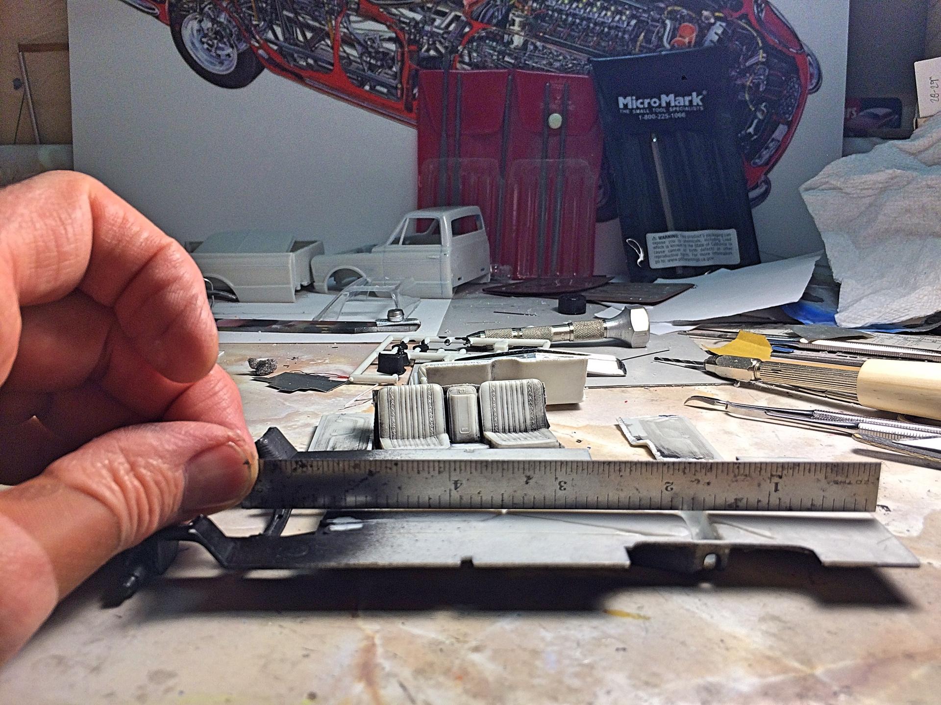

Well shoot, now I feel stupid. ?  *After* wrecking that custom grill, find out it's way too small, so now for plan B.  Measured my '68 today, while it's daytime (I've been going out at night to look at the engine ?), and made scale drawings.  Found out the tailgate is wrong, narrower and taller than the real thing.
Example of research photo, with the tape measure.  This '68 has mid-level trim across the top of the tailgate, which was not on the '69, and I replaced the taillight trim with "wrong" full surround (had only one that goes around the outside) because it was cheap, and looks better.  Otherwise, measured and drew out the CHEVROLET, which will be fun to replicate.  The taillights are completely wrong on the kit, which bugs me more than anything. ?
Cut out the seat (and heater not shown) from Corian, using the table saw.
