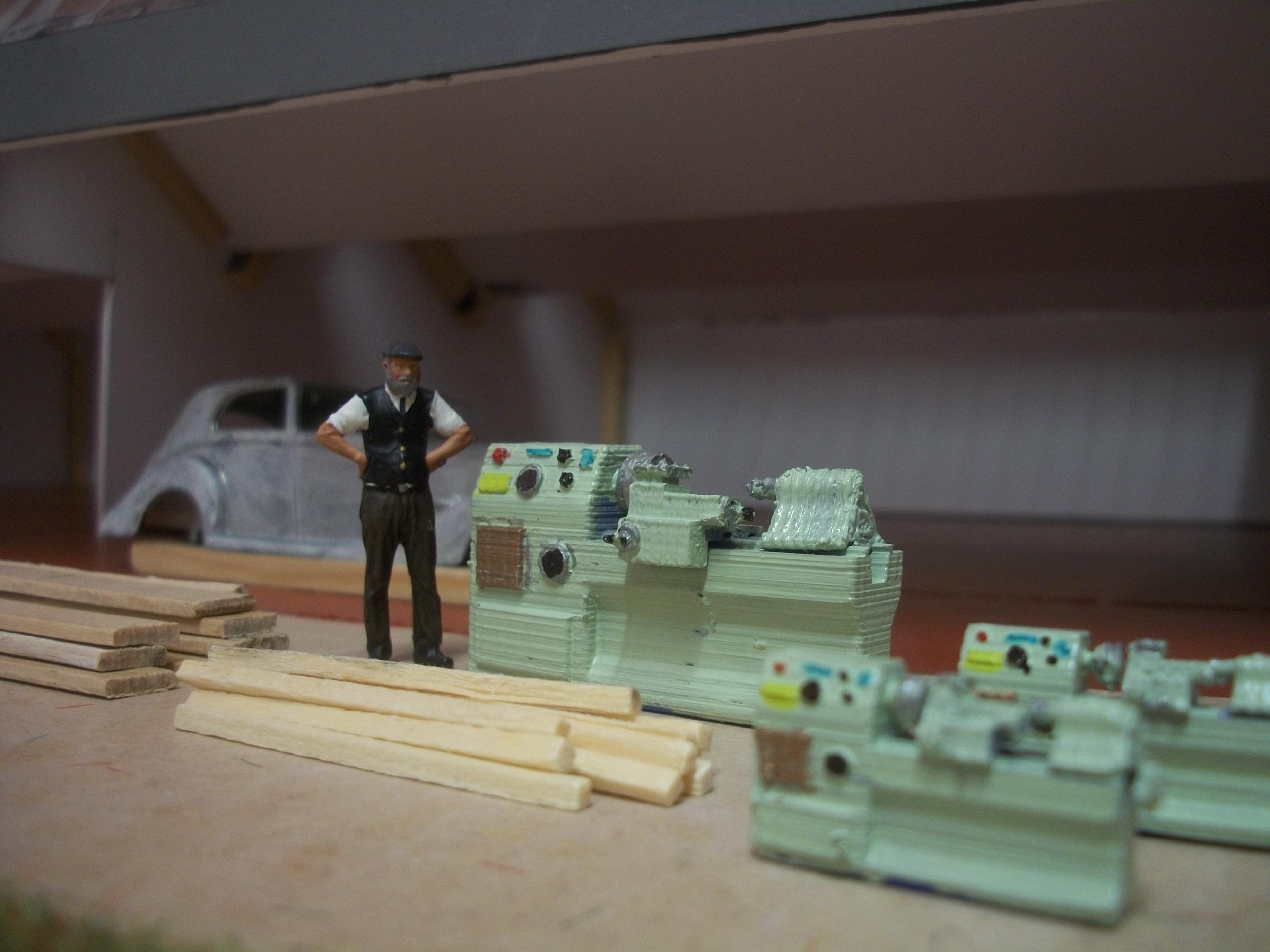

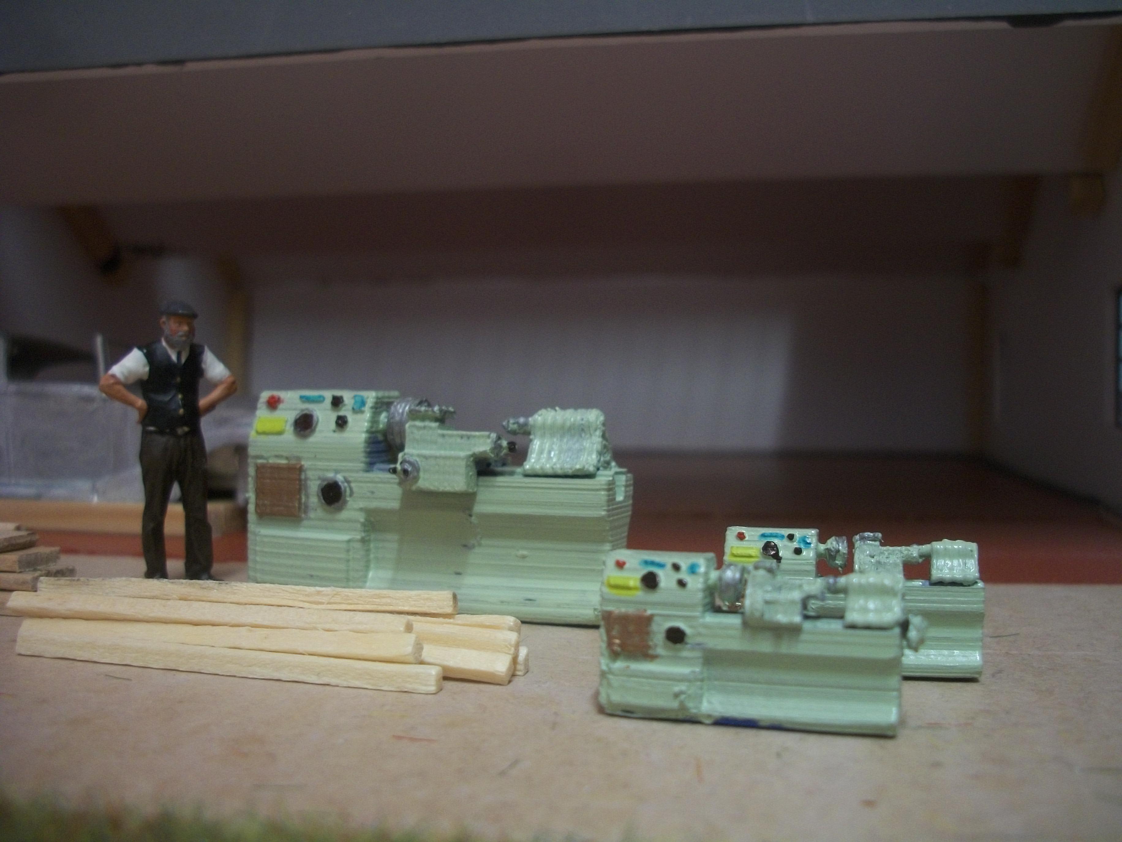

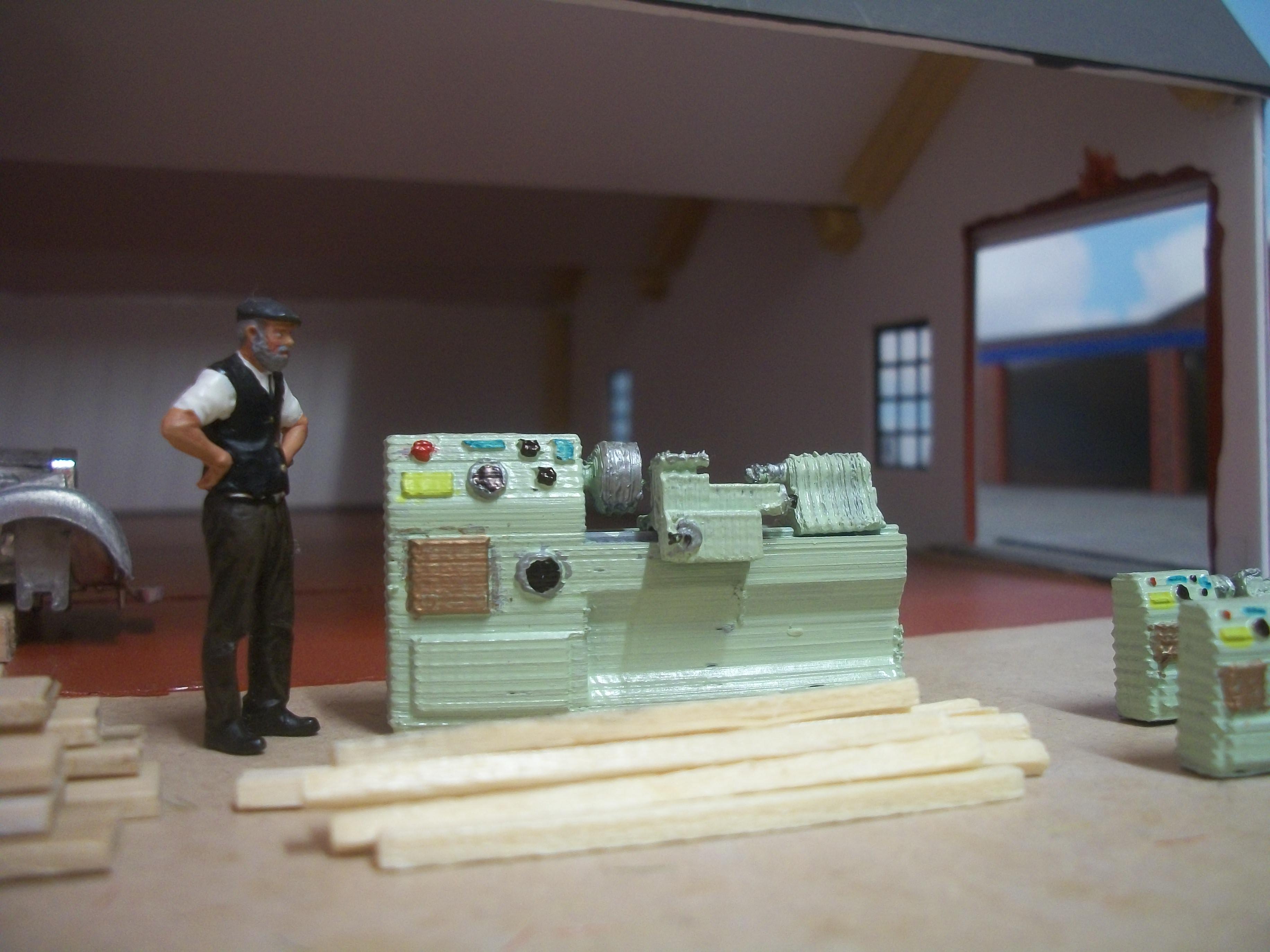

Hello Paul...... I am not wanting to hijack your thread or anything, but I can see that you are clearly knowledgeable when it comes to engineering equipment, so I was wondering what you think about this 3D printed lathe. The link takes you to a seller on Pinshape, and the price is in US $., which is a 1:10 scale lathe. I am wanting to 3D print some factory machinery for my 1:43 Hooper & Co factory, so that I can photograph some Rolls-Royce car bodies in production, with some machine tools displayed inside the factory building. I would have thought the 1:10 scale model could be scaled down to 1:43, before I print it. Does it look like the sort of machine that you would have seen inside a Rolls-Royce factory during the 1950's, in your opinion? Photos below this link...... https://pinshape.com/items/40054-3d-printed-scale-110-lathe
David
No sure how I missed this, sorry for the delay.
That would probably be  "cutting edge" technology for the early 50's, but I think it would be appropriate.
Link to comment
Thank you, Paul....... and no problem with the delay. I went ahead and reduced the lathe model to what I thought was 1:43 scale, but this turned out to be a miscalculation on my part. The lathe came out half size, so I doubled up the measurements and printed a larger model. Here are photos of all three lathe models. The two smaller lathes could be mounted on workbenches. Thanks for looking!

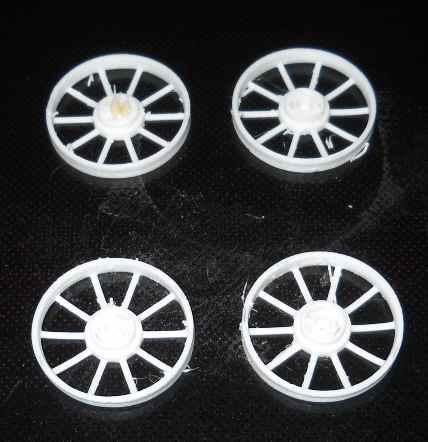

The rear wheels were about 90%.  Problem was the spokes.  The ones that printed directly on the print bed were fine, but the "top" ones didn't have enough support and didn't connect to the rims, along with strings everywhere.  Time for Plan B:
Re-did the wheels in halves so both sets of spokes printed on the print bed.  MUCH better.  A bit of sanding and we're good to go.  I'll clock them so the spokes alternate and glue them together

Took 4 tries on the rear wheels and 3 on the front to get results I was pleased with. I initially tried to print the wheels and spokes as a unit on the rear, but the spokes didn't always connect to the rim as they were unsupported during the print process. Then I attempted printing the wheels in two halves so the spokes were supported by the bed of the printer which worked, but gluing them together was problematic due to delicacy of the spokes and warping of the rims as they cooled.
Wound up printing the rims separately and printing 4 sets of spokes (inner and outer for two wheels) on the bed and printed the spokes bigger than I really liked so they weren't so delicate.
