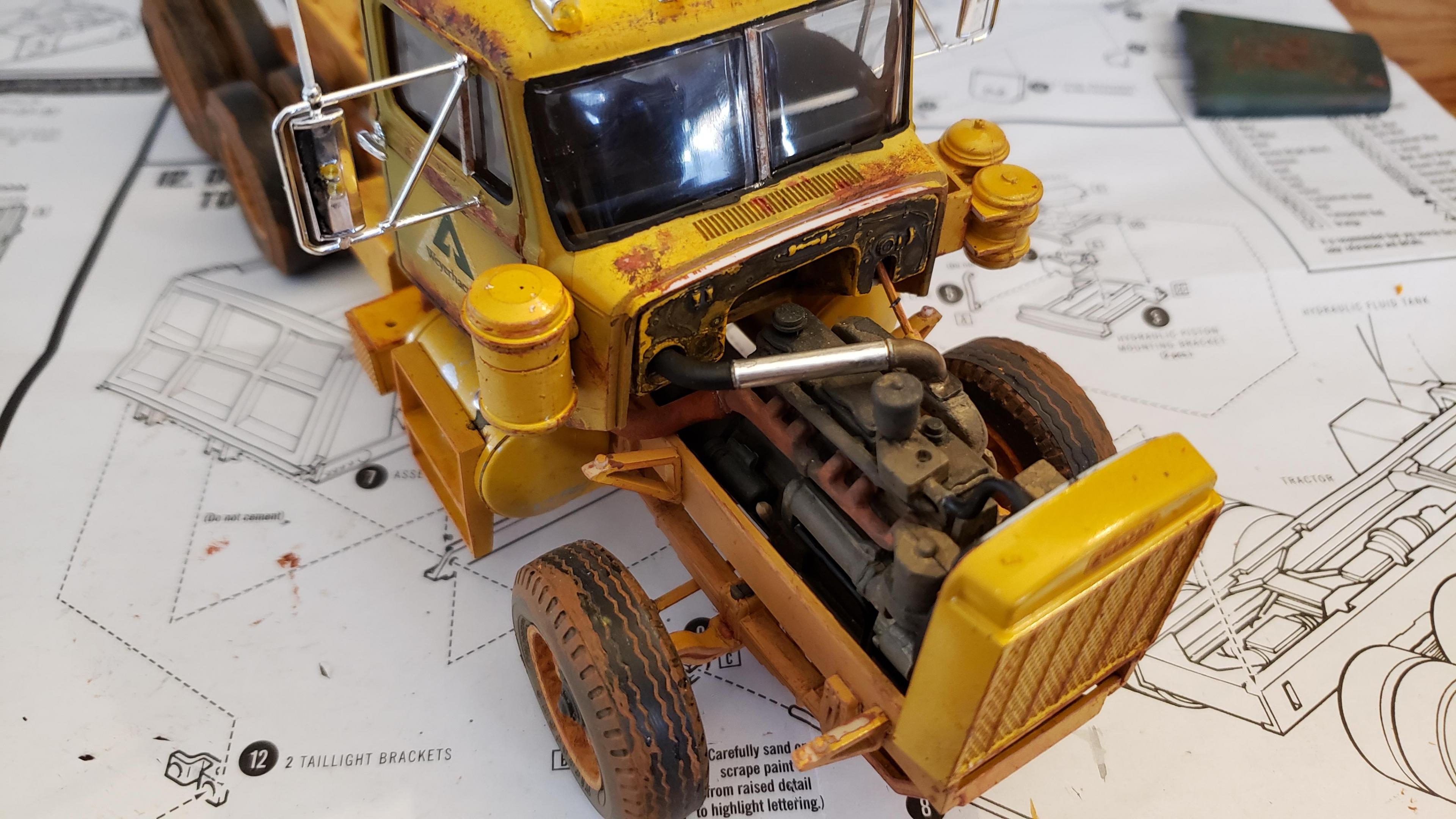

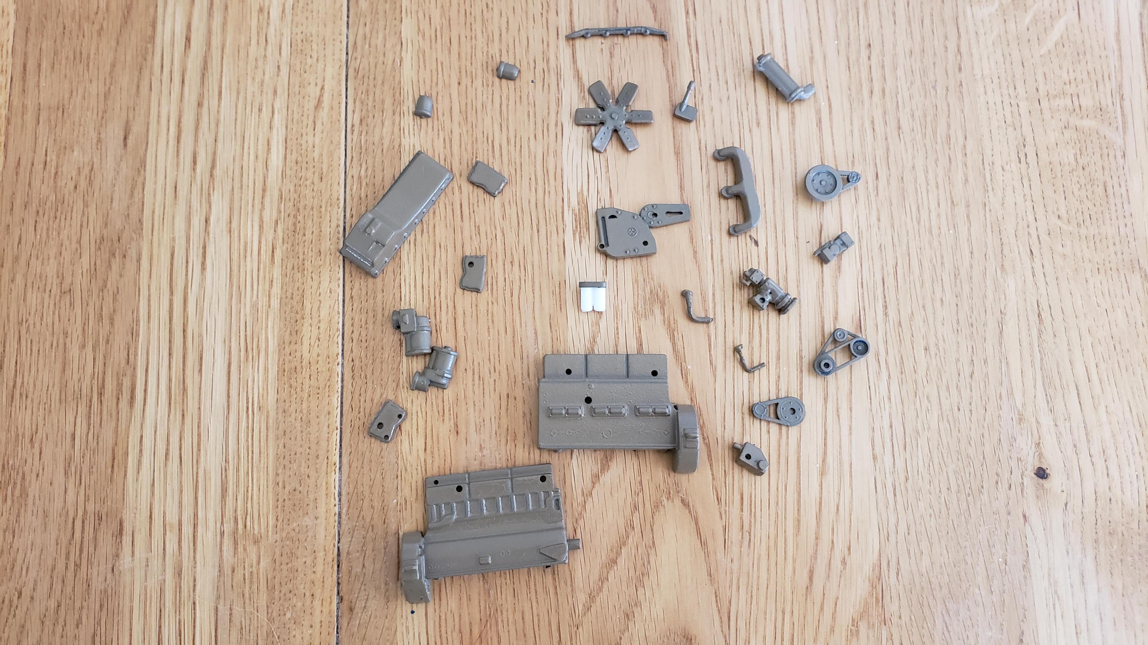

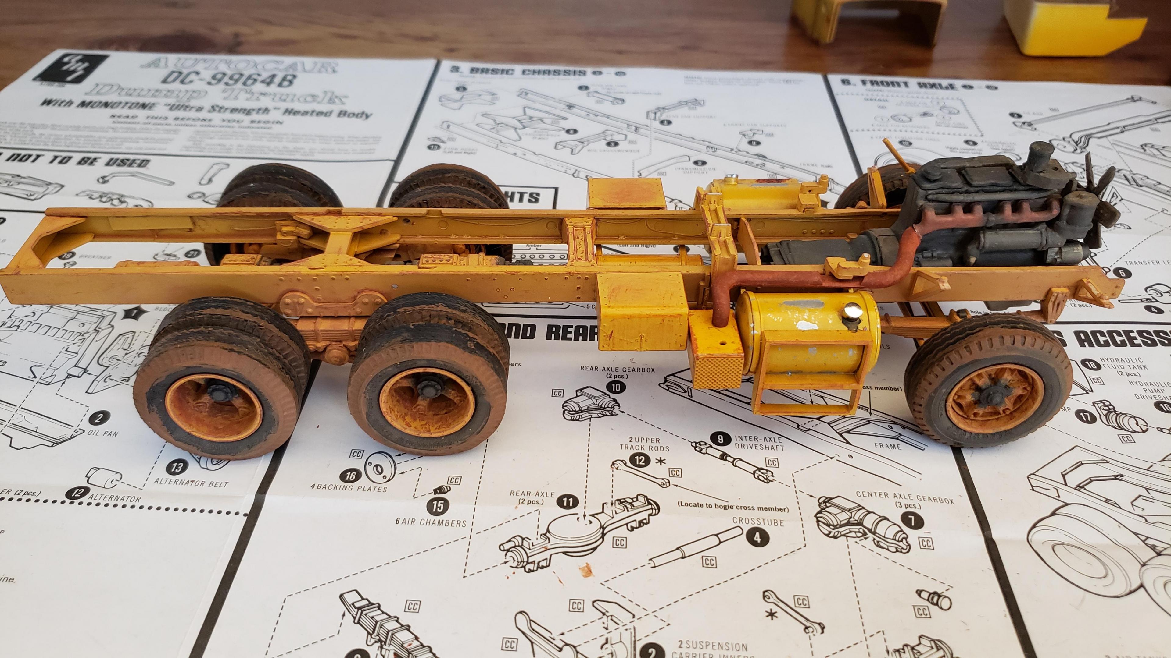

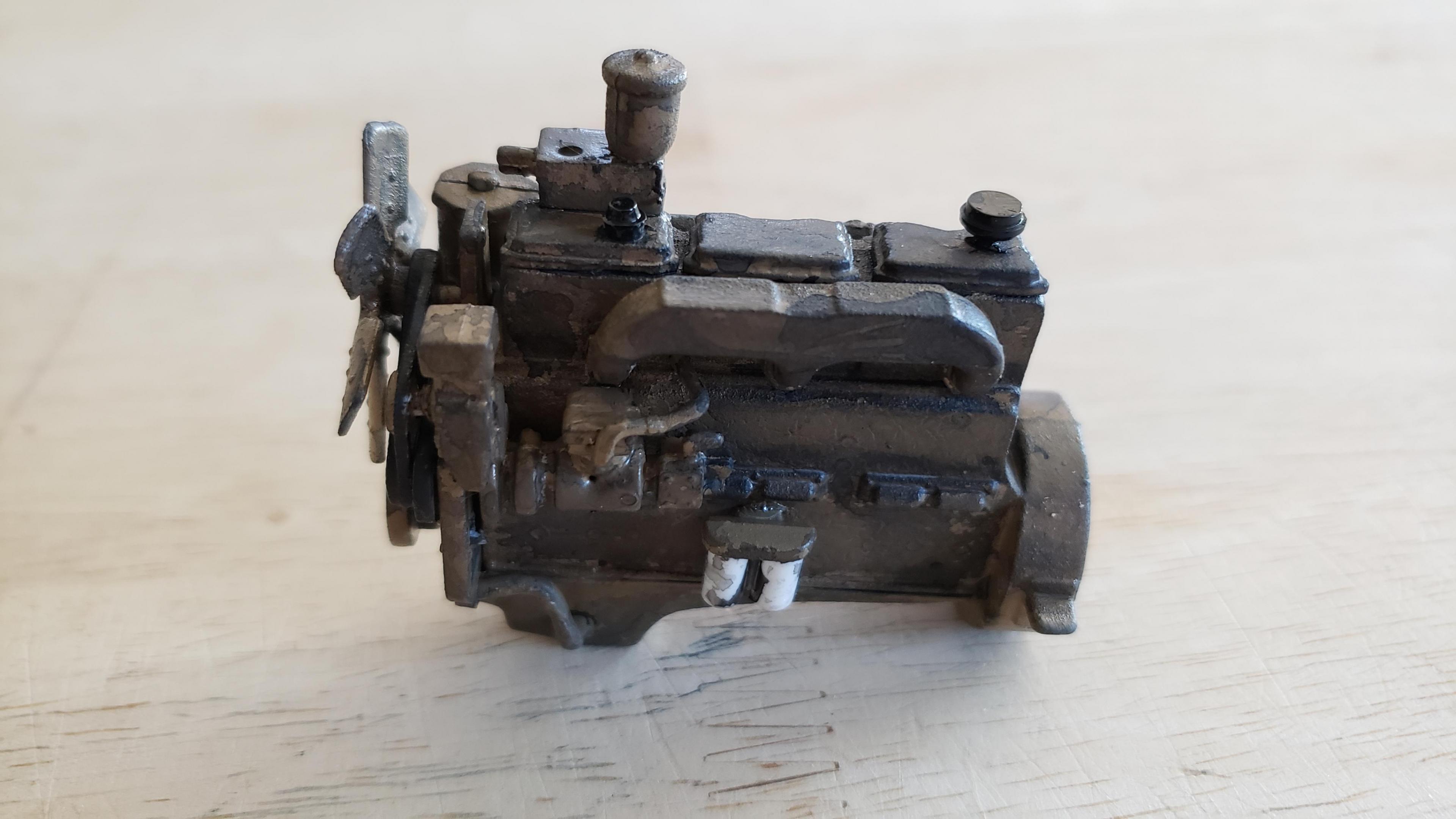

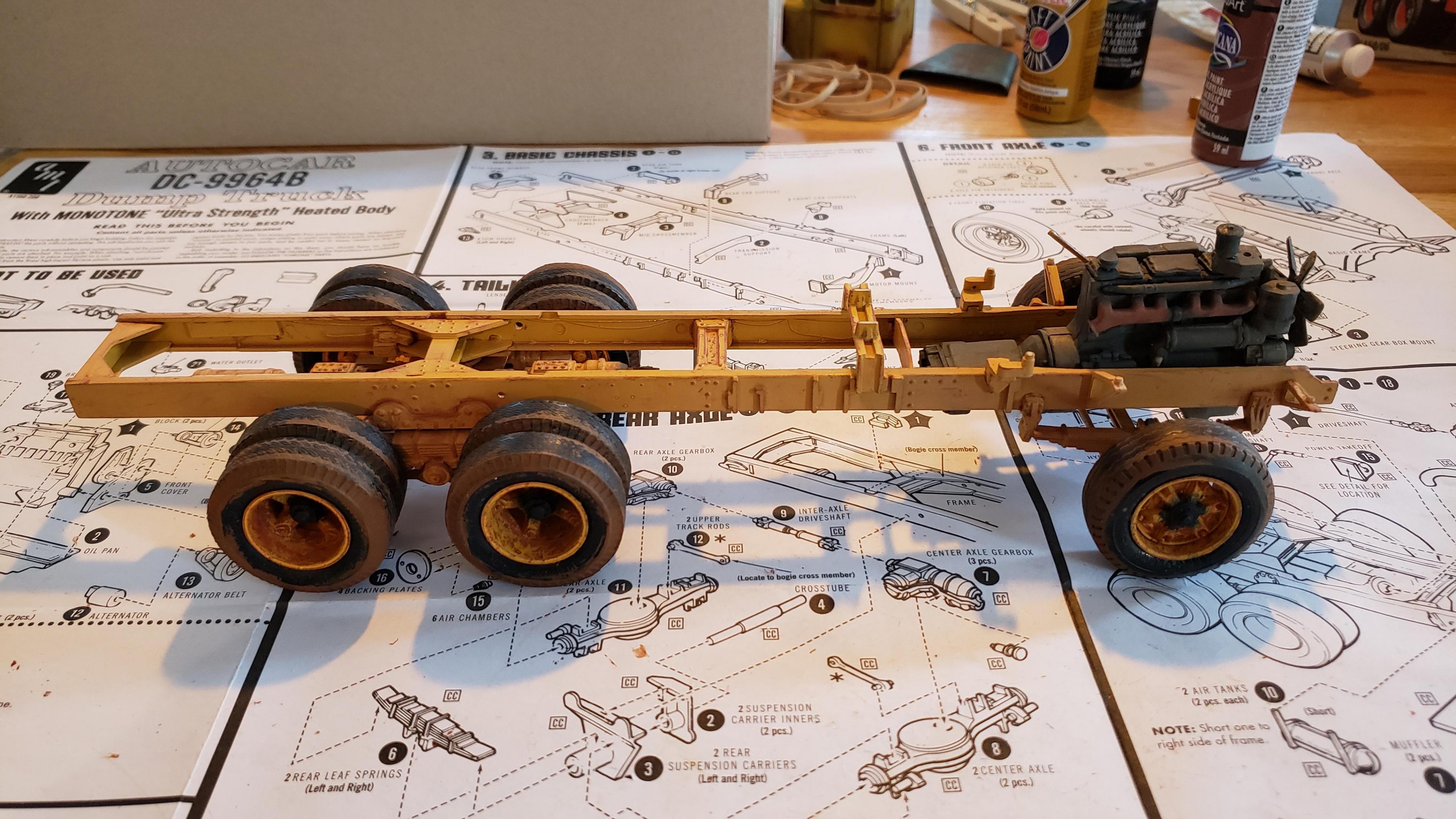

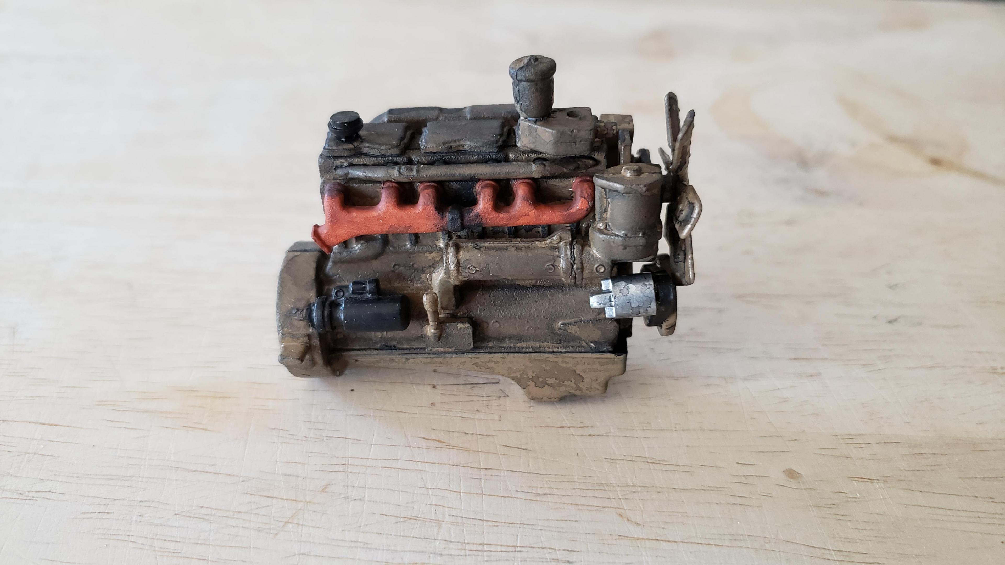

I started off with the engine. I went with Cummins beige. This is going to be a hard worked, tired looking truck. I grimeyed up the engine a bit

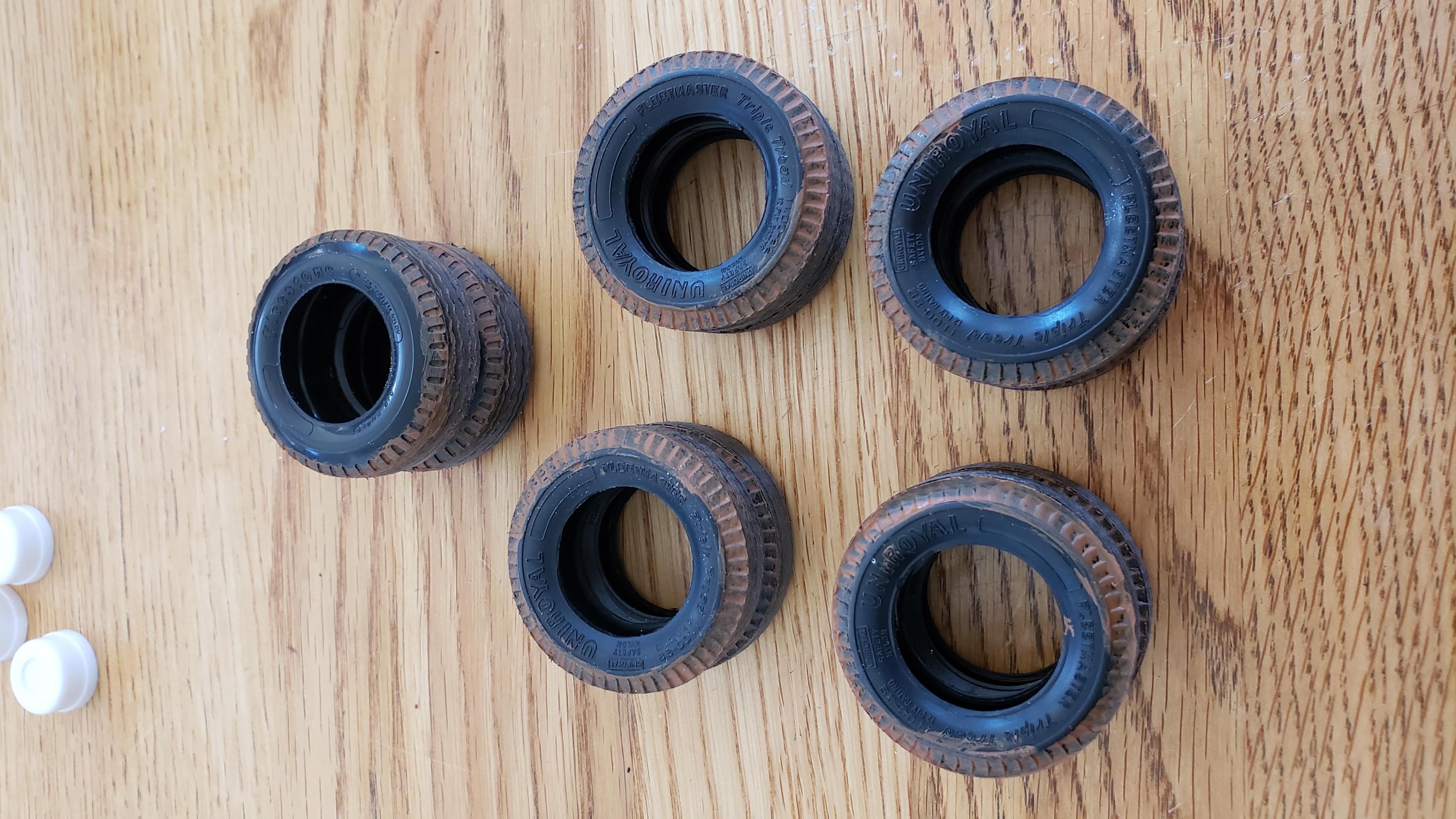

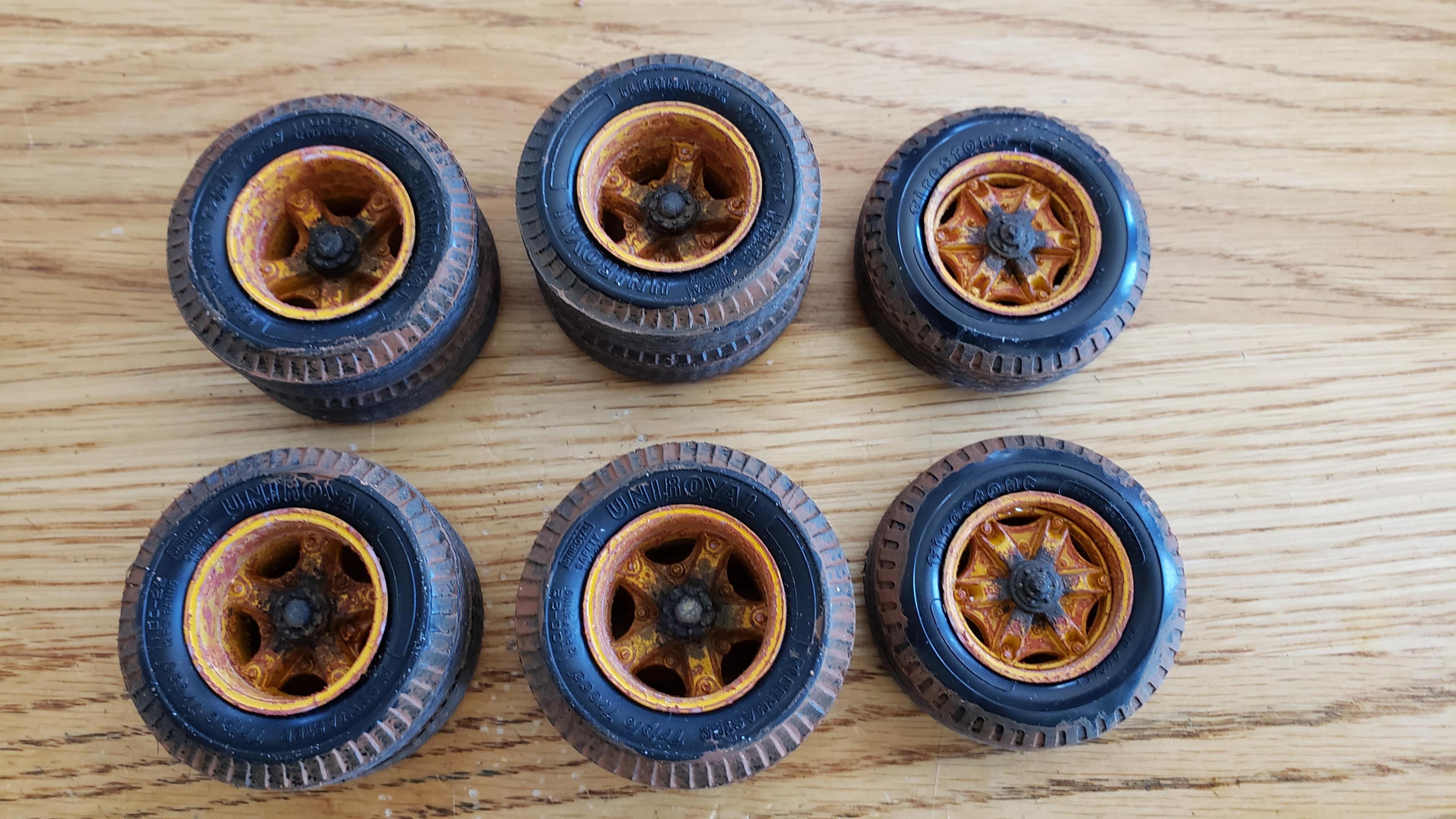

I made the tires muddy, and put some rust on the wheels. Looks like the hubs are leaking too. I'm going to work with the weathering some more, I'm not totally happy with how it looks. It's headed in the right direction though
That's all I did this weekend. Thanks for looking!

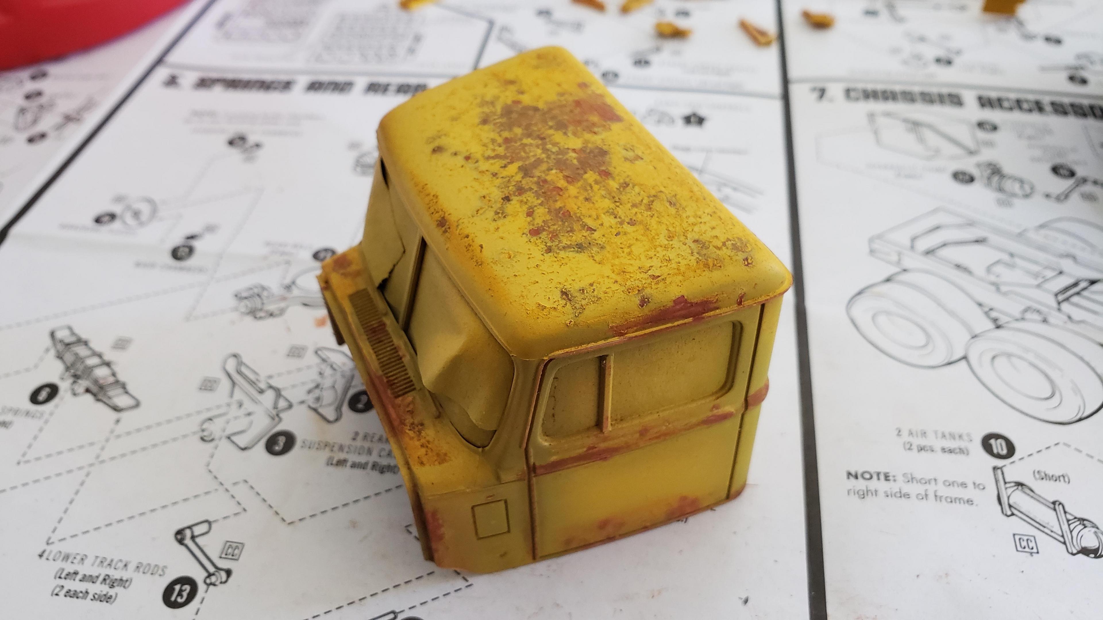

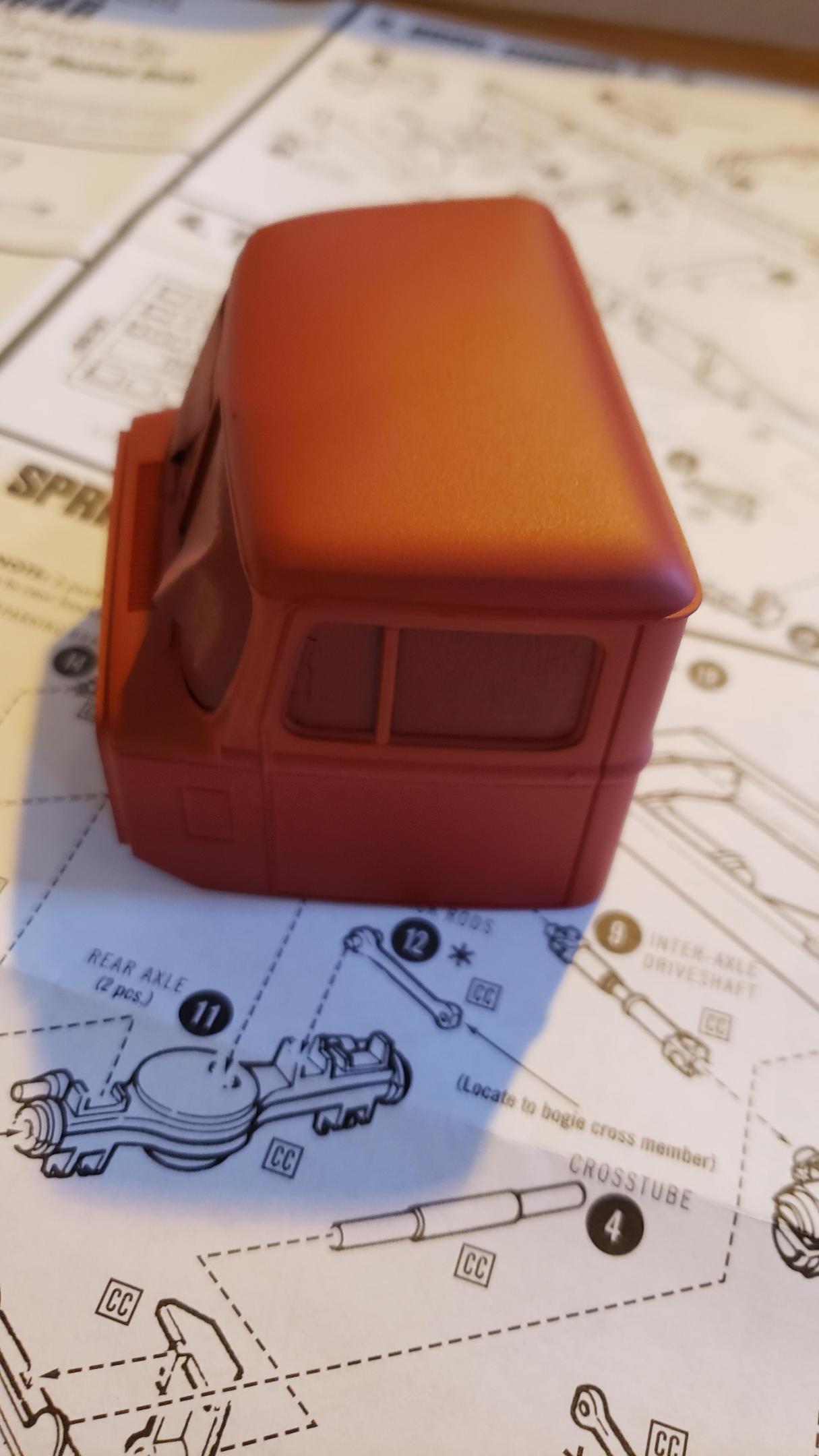

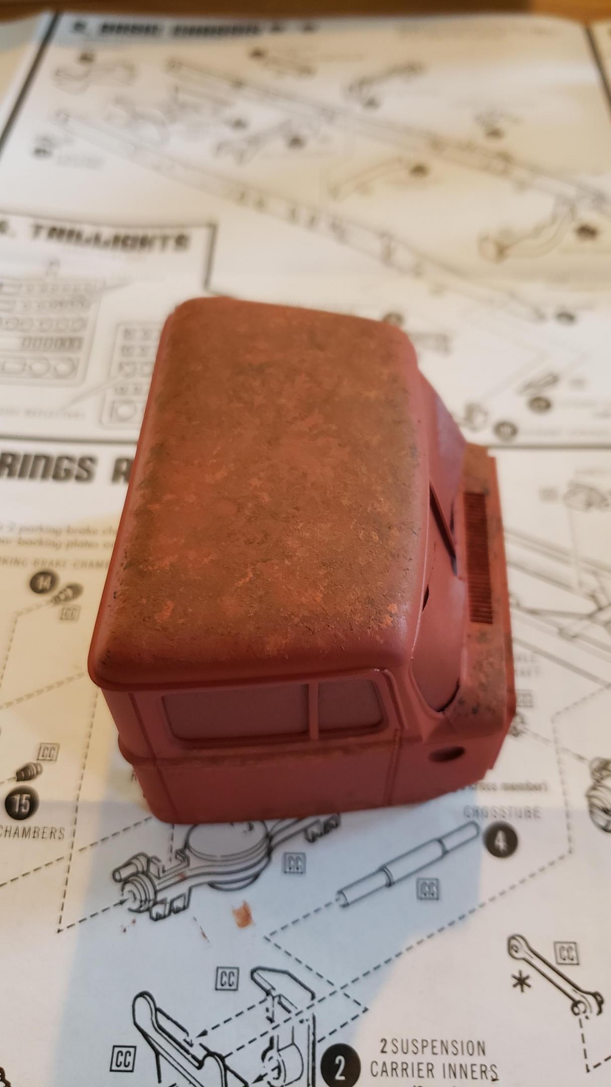

First I sprayed the cab in red primer
Then I dry brushed on some rusty color

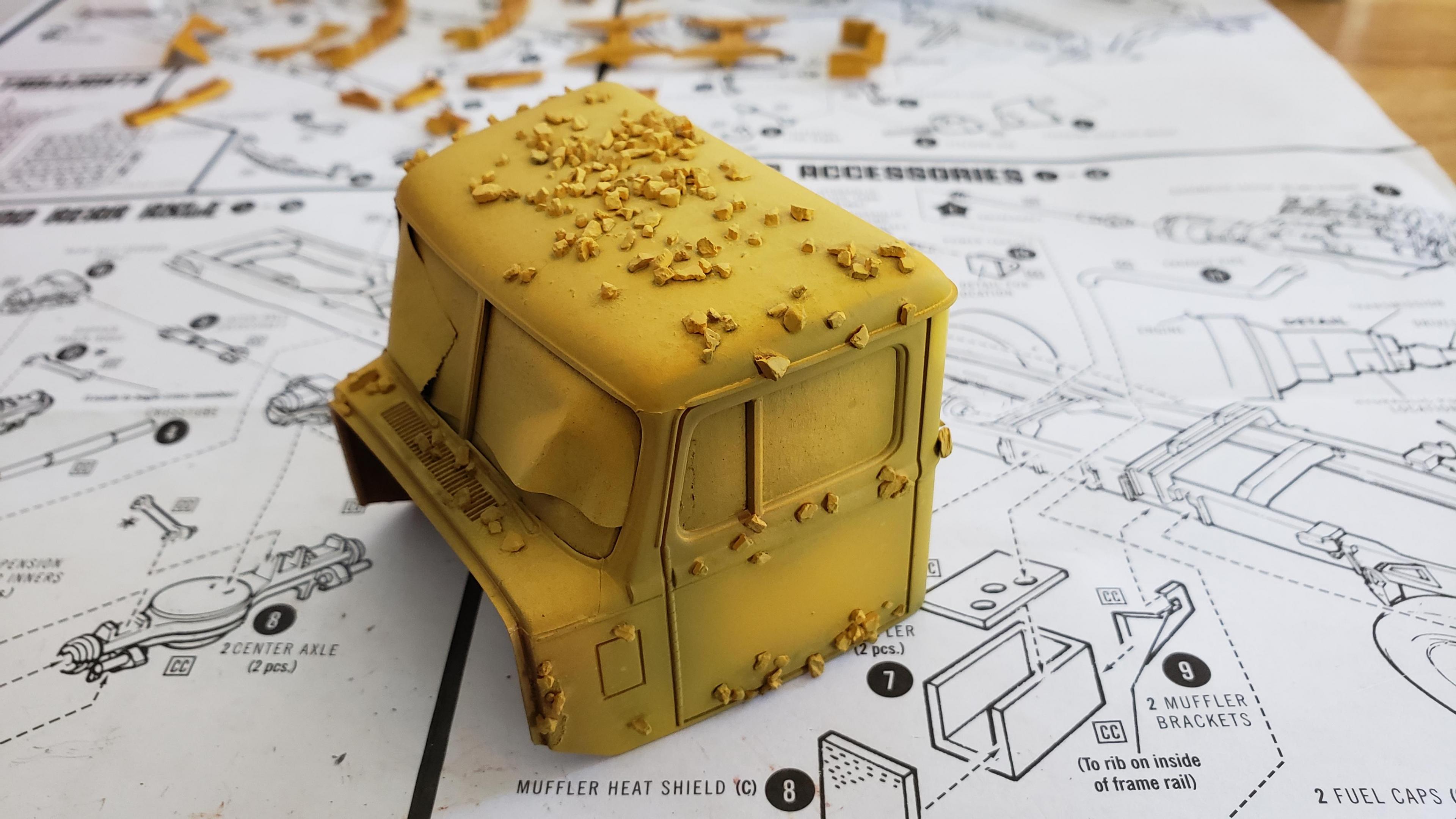

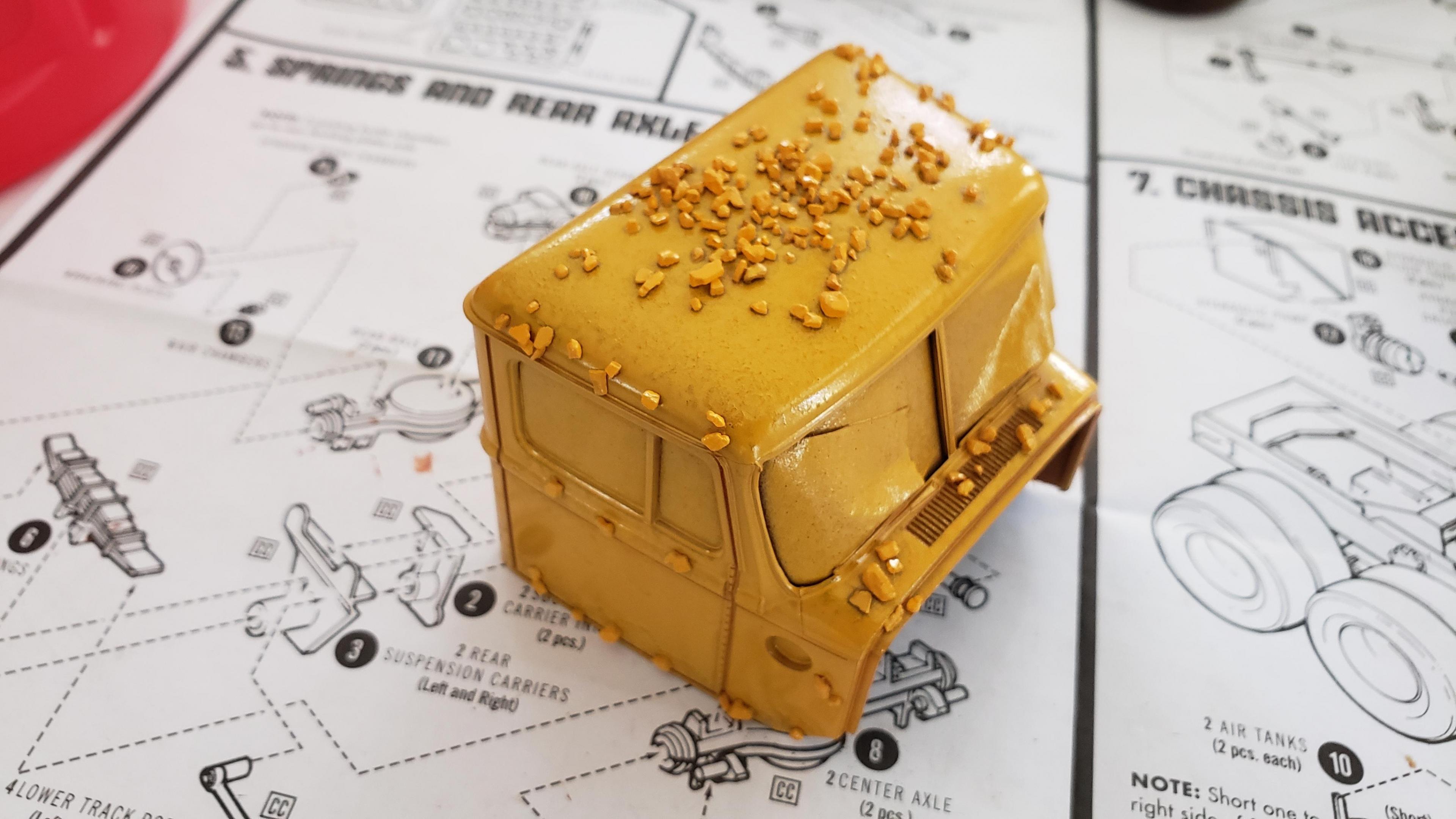

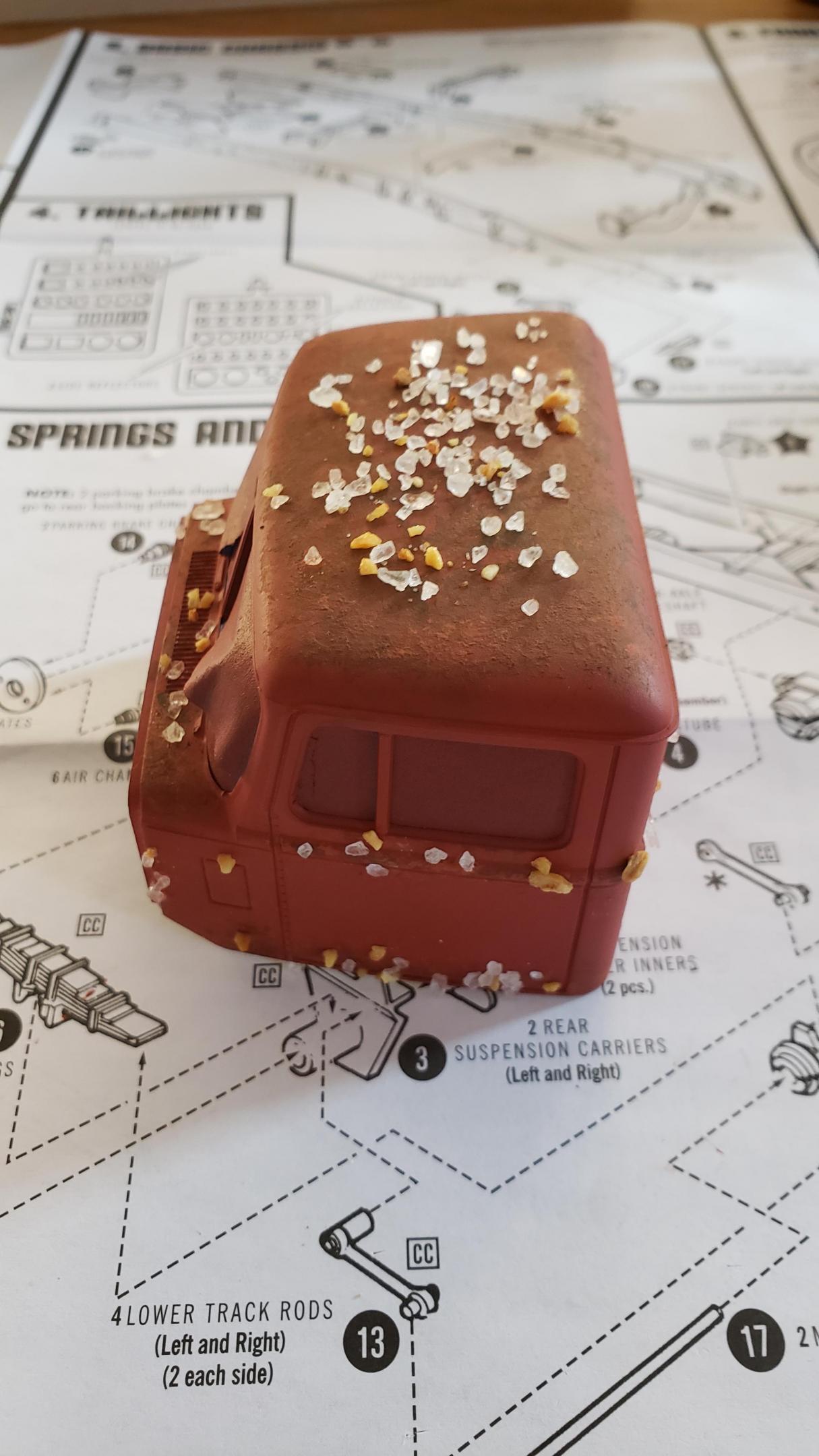

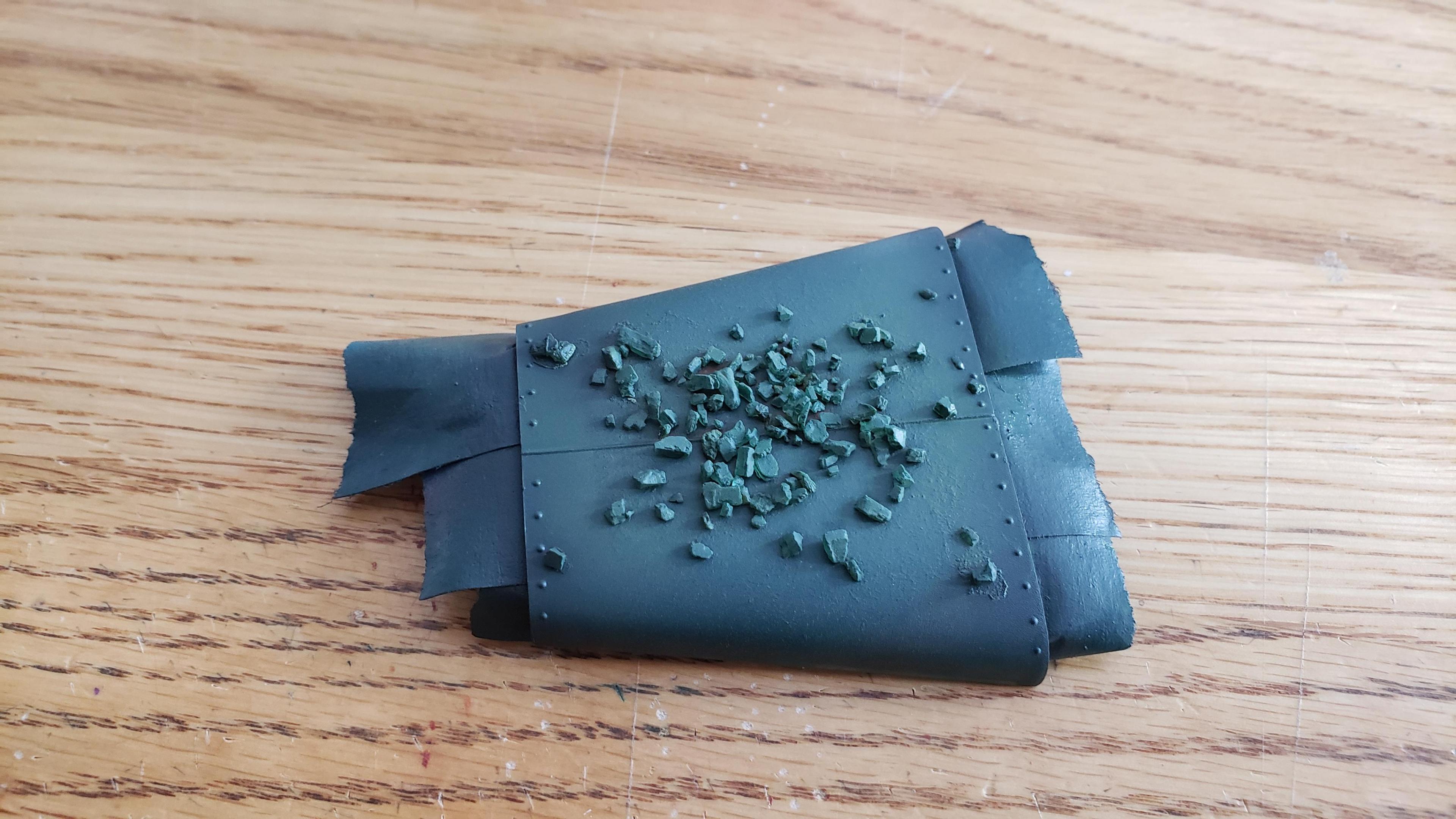

Then I did the salt masking technique. I applied some rock salt. All I had in salt that big was garlic salt, so there is some garlic in there as well, lol. It worked though

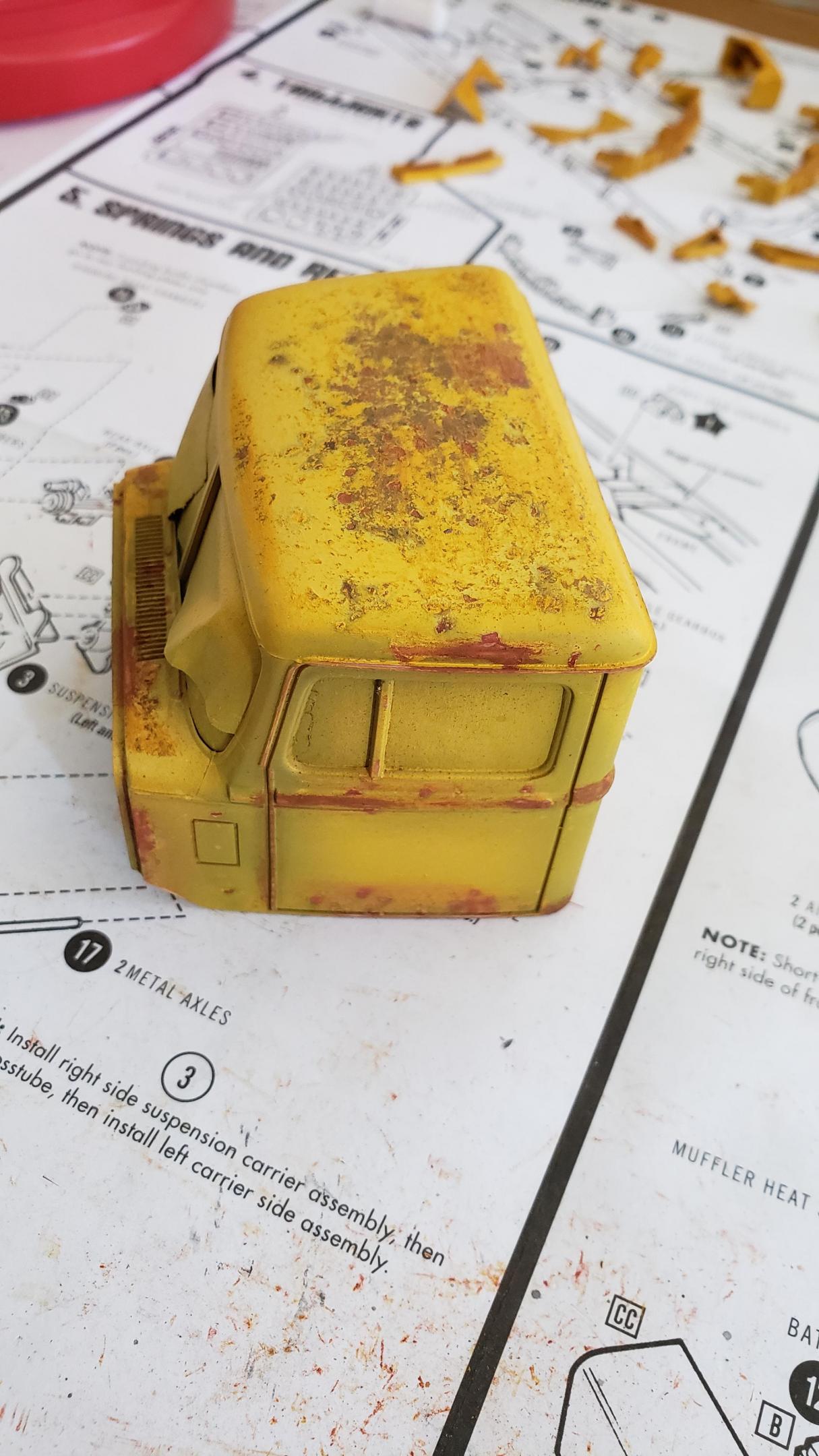

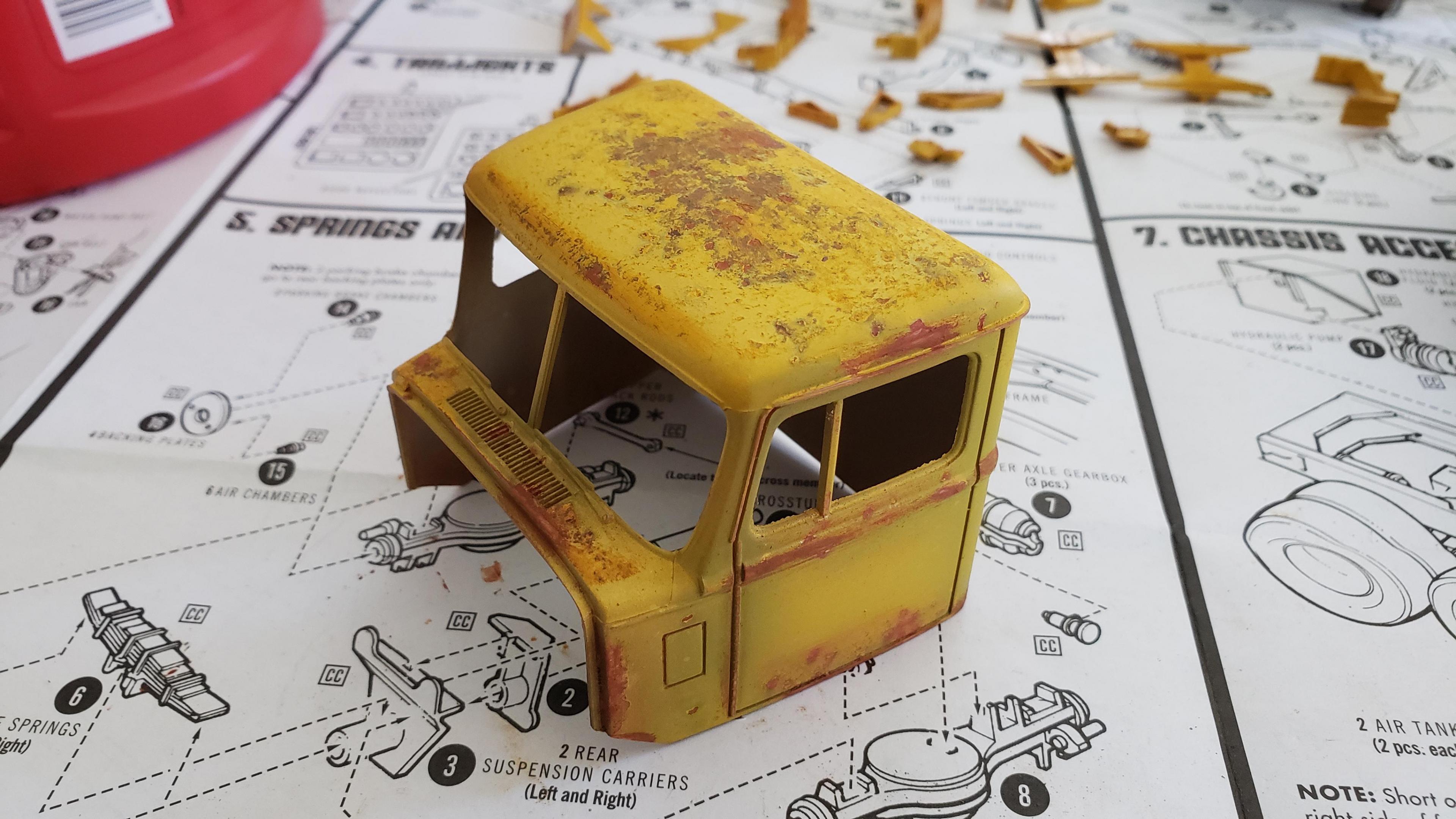

Then I shot some yellow
Then I air brushed in a bit darker detail
Then I sanded a little bit more rust in

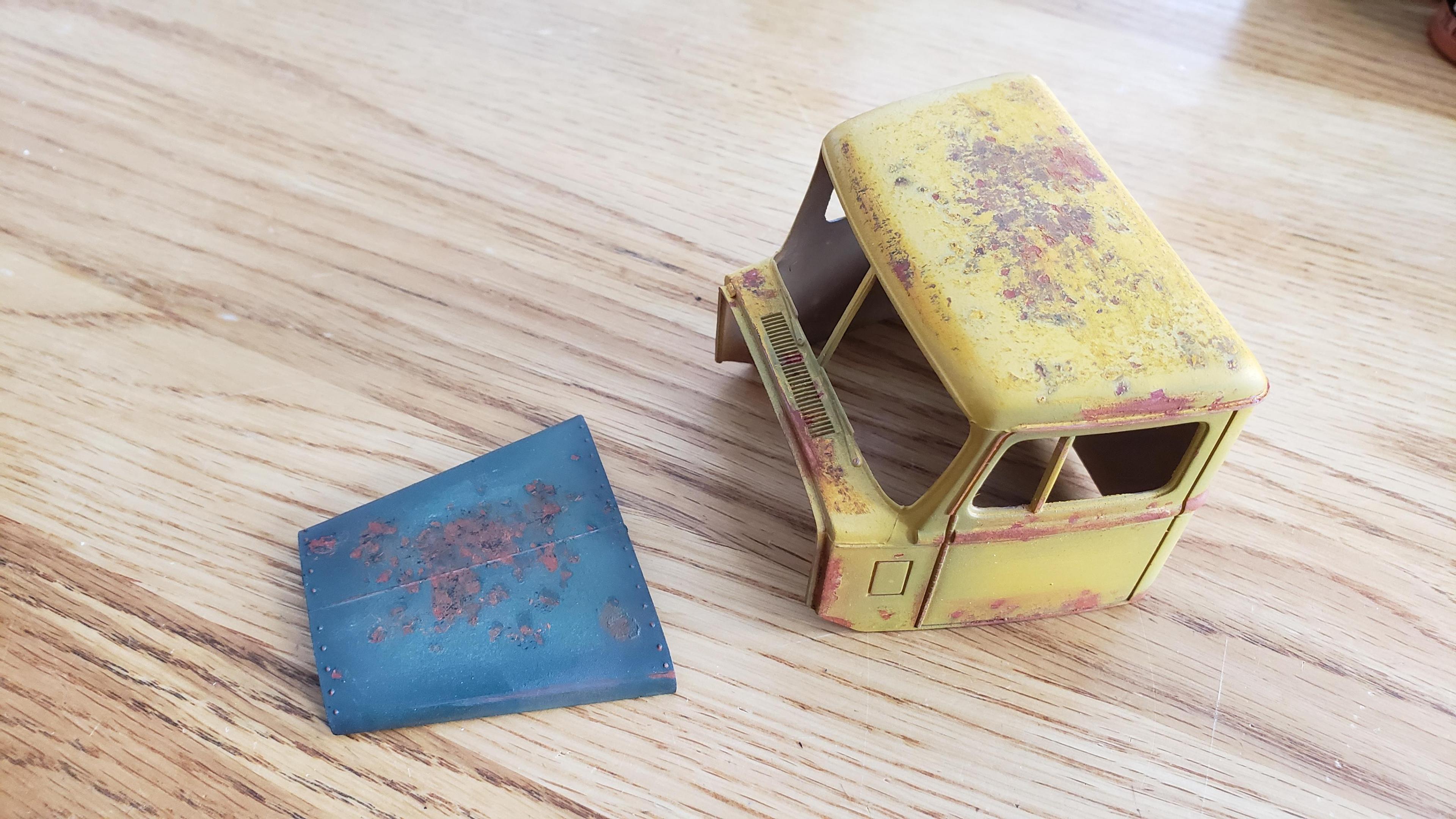

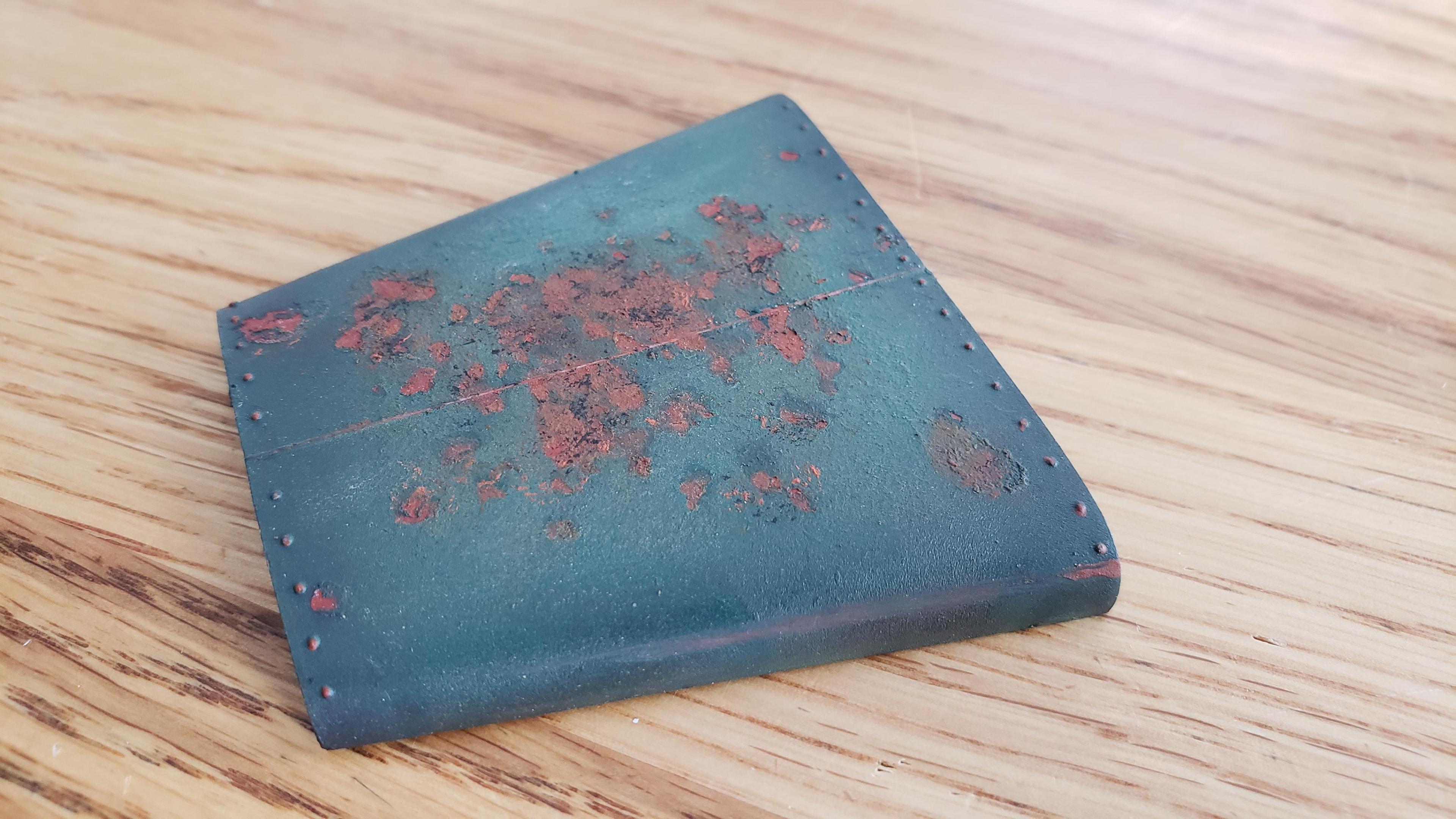

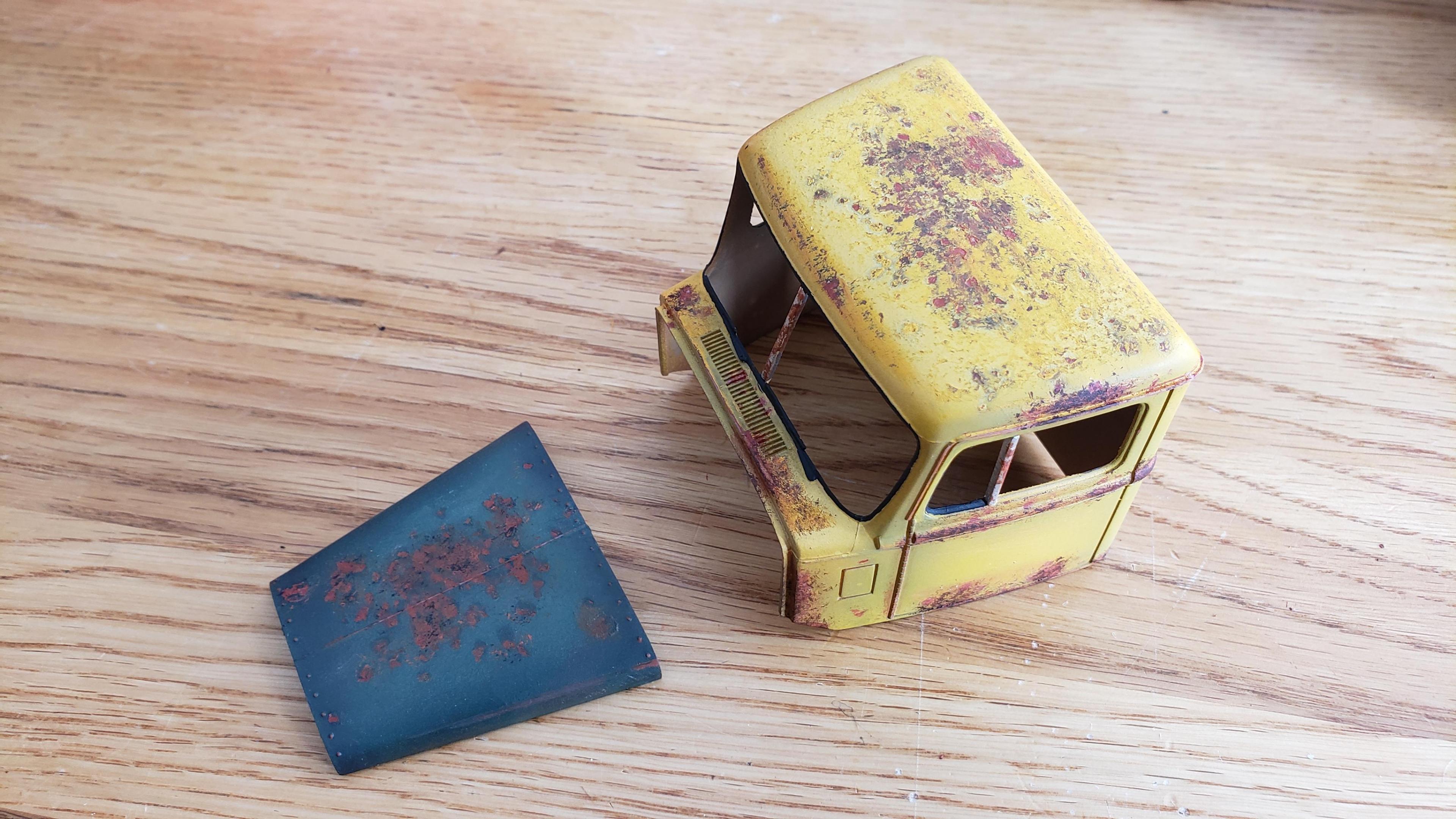

Then I worked on the hood
Some rusty dry brushing

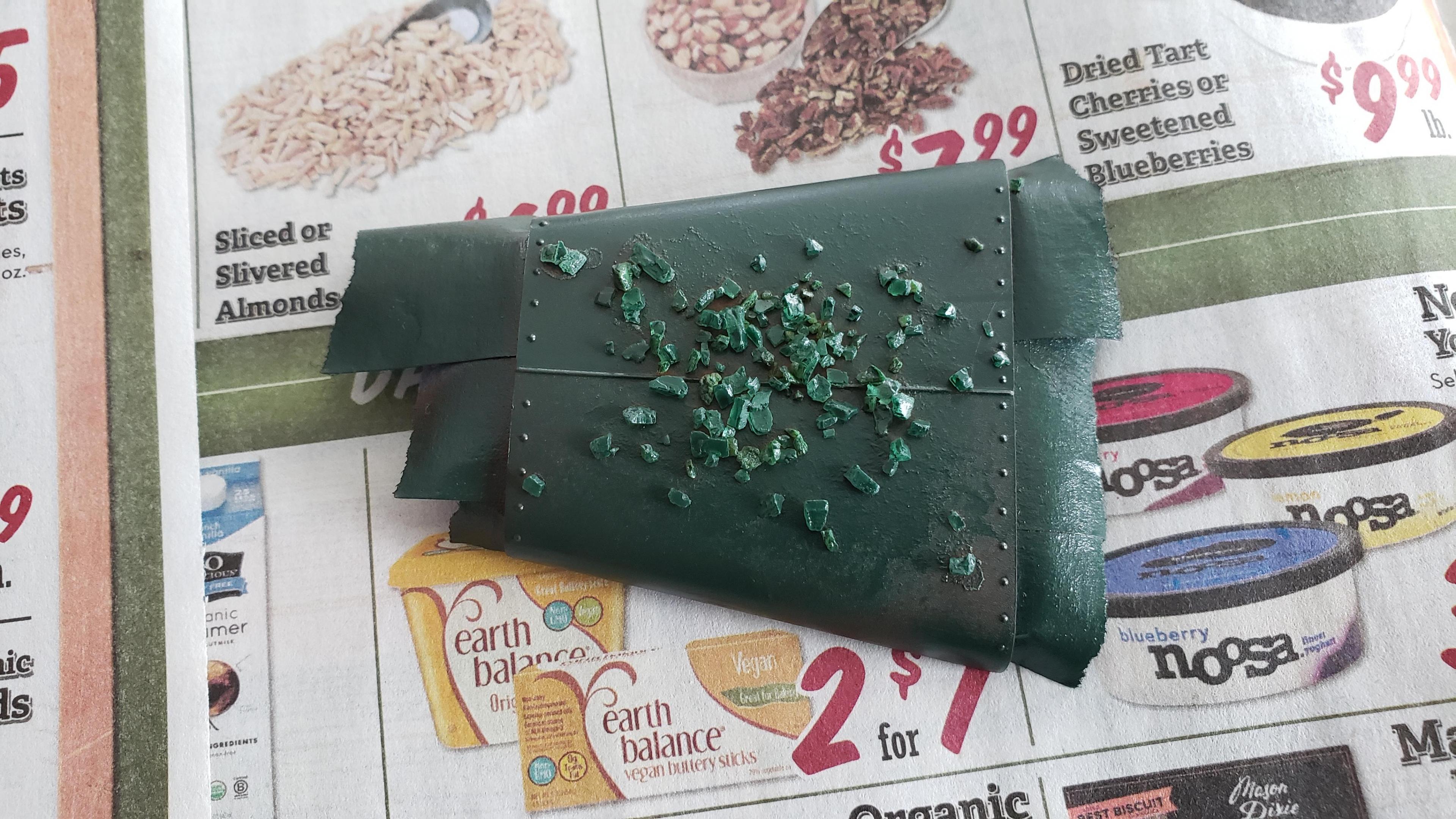

A little salt masking and shot some green
A little bit of air brushing some lighter green

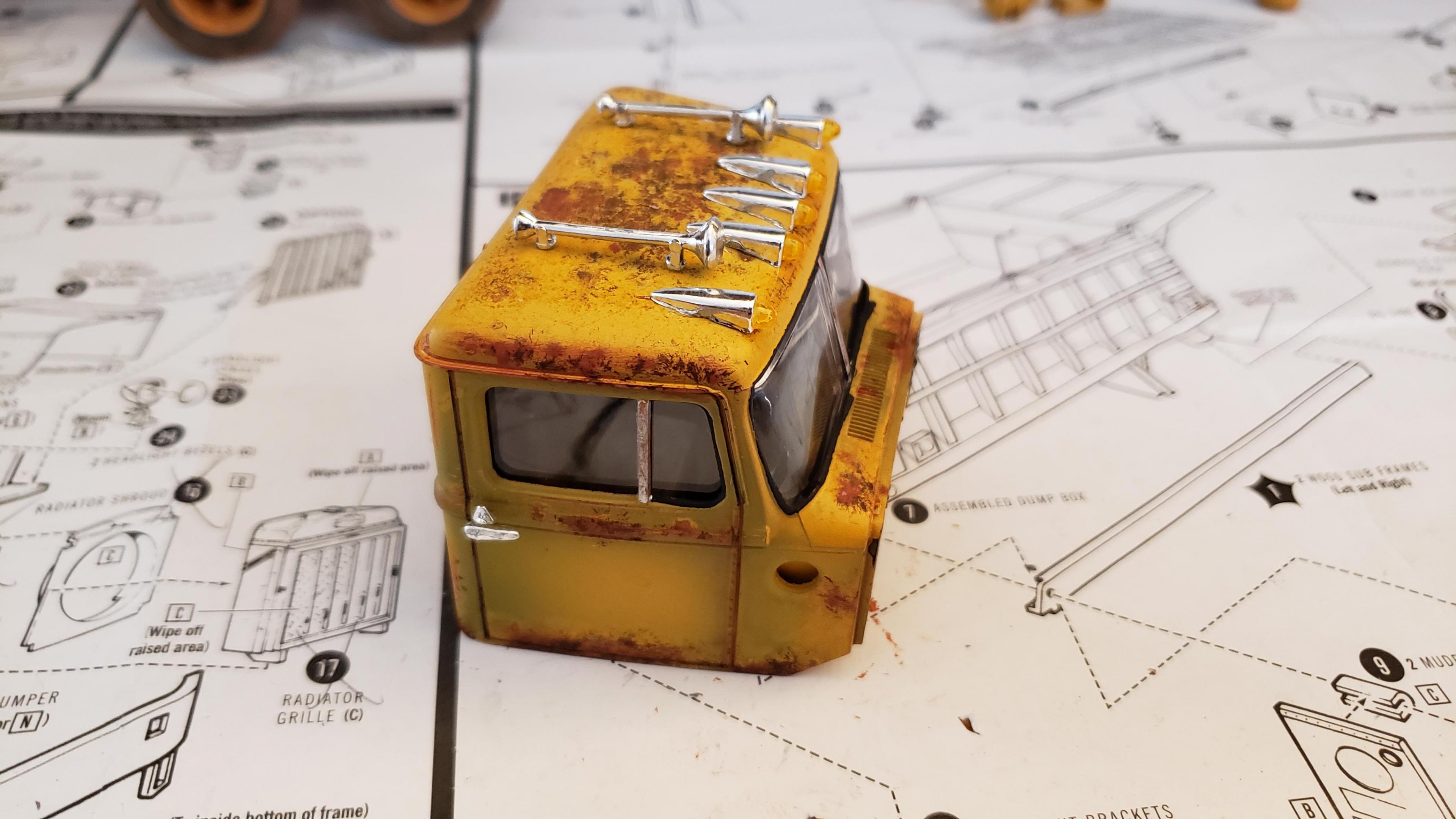

The hood
and some touch up work on the cab

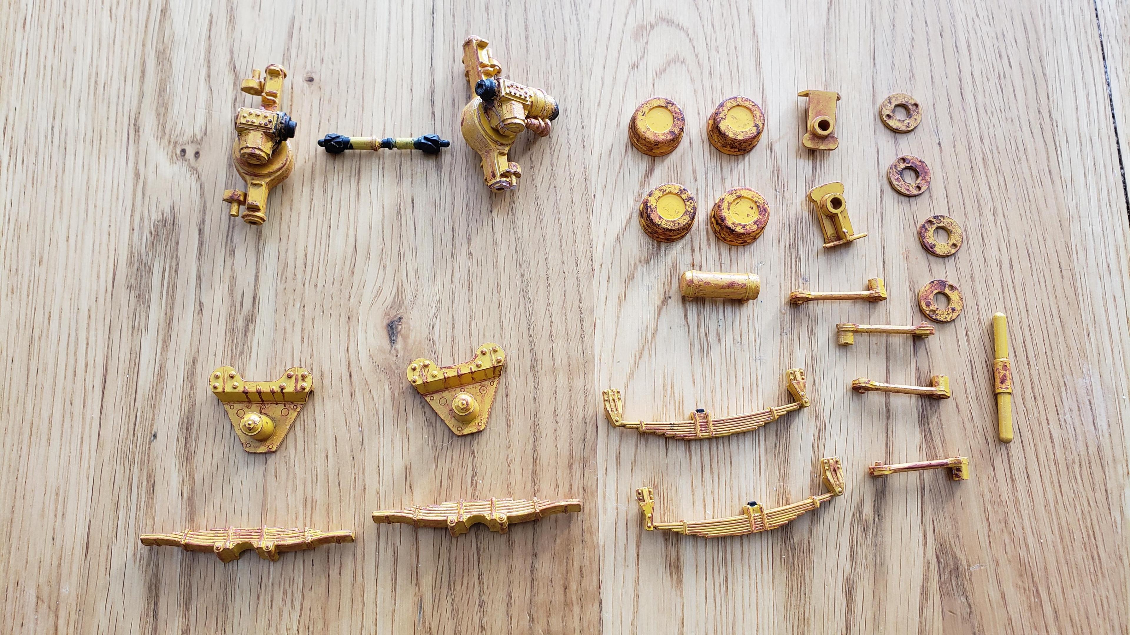

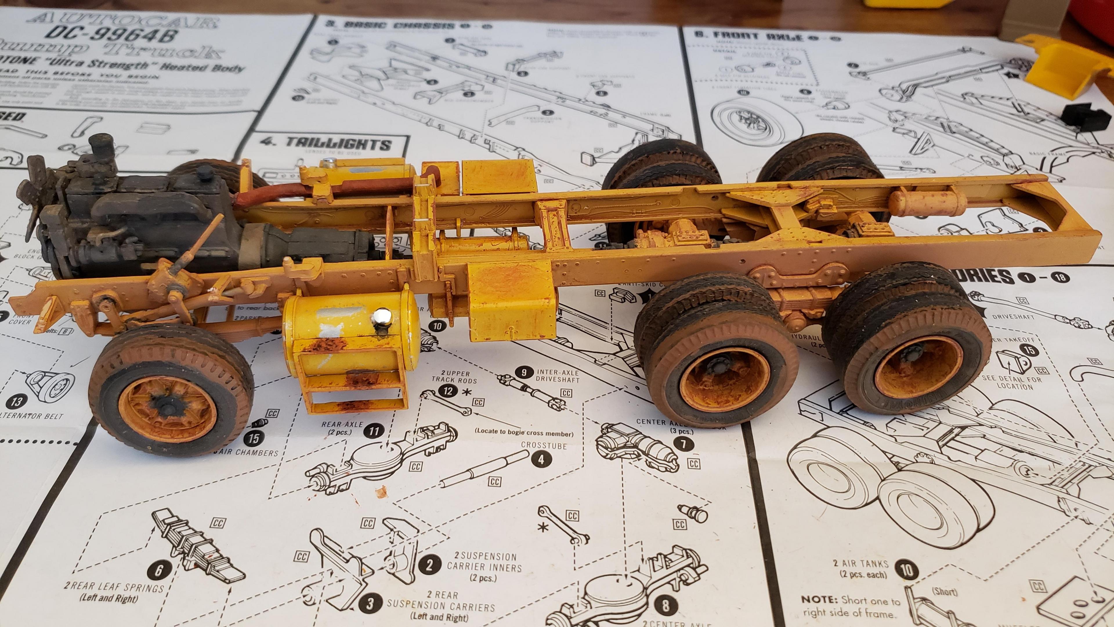

And I got some chassis pieces weathered

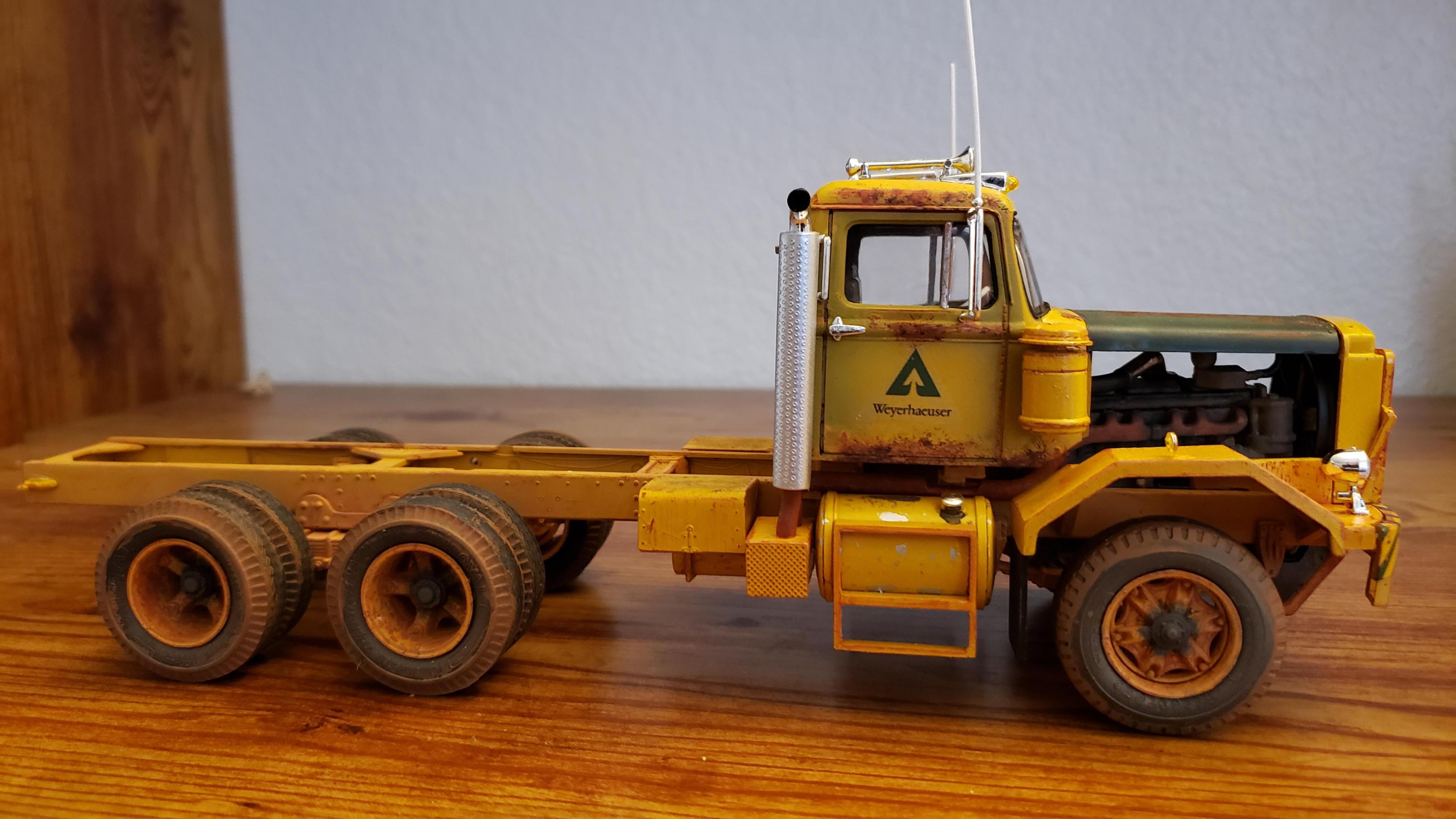

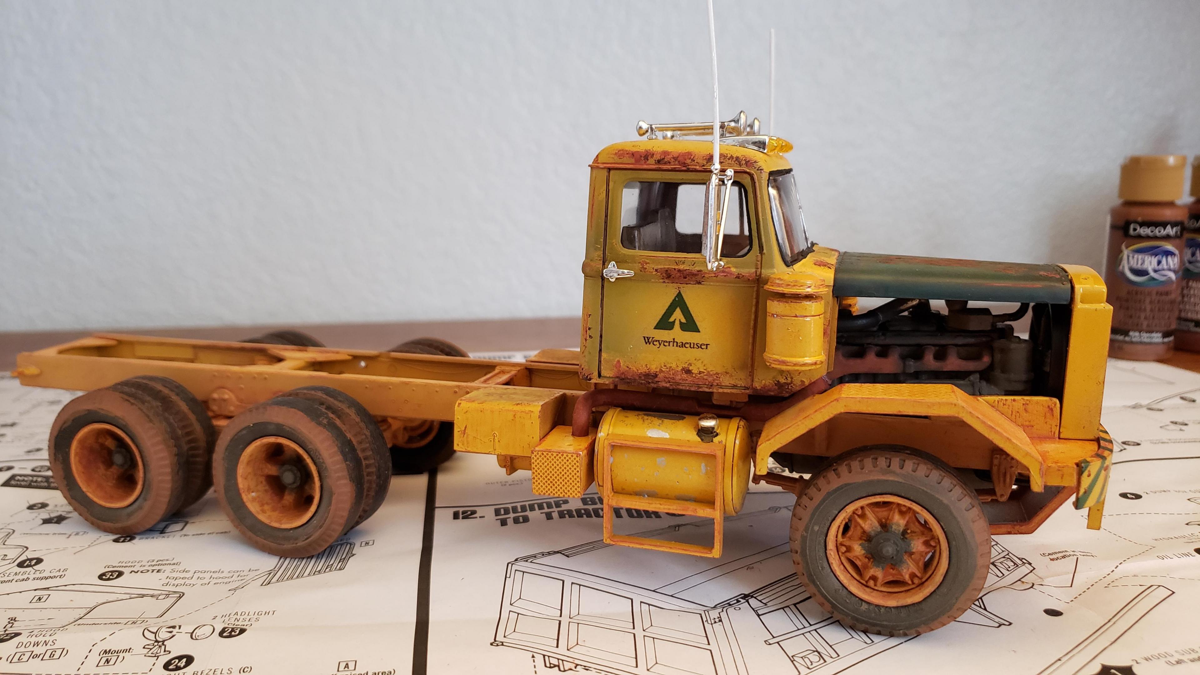

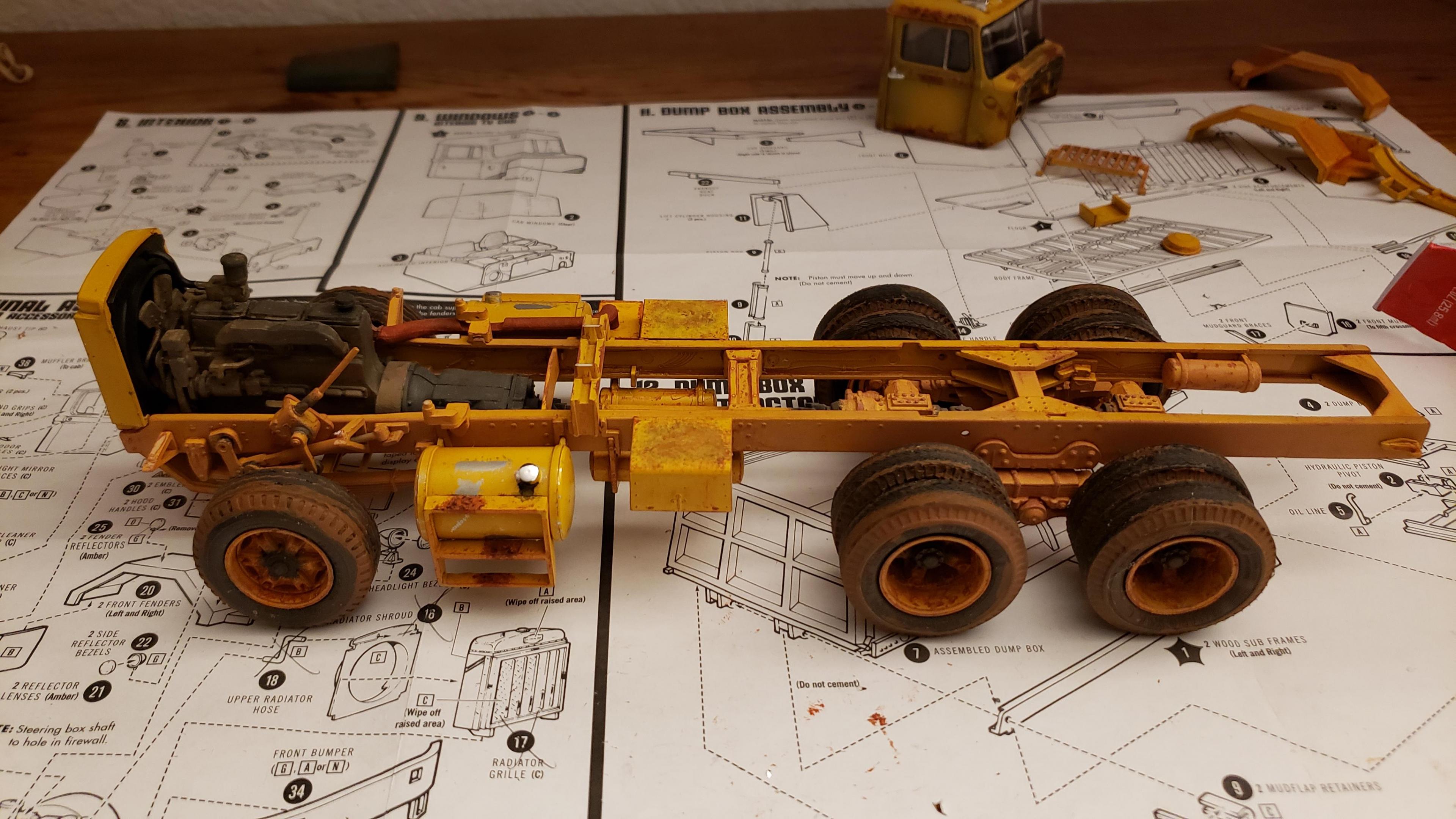

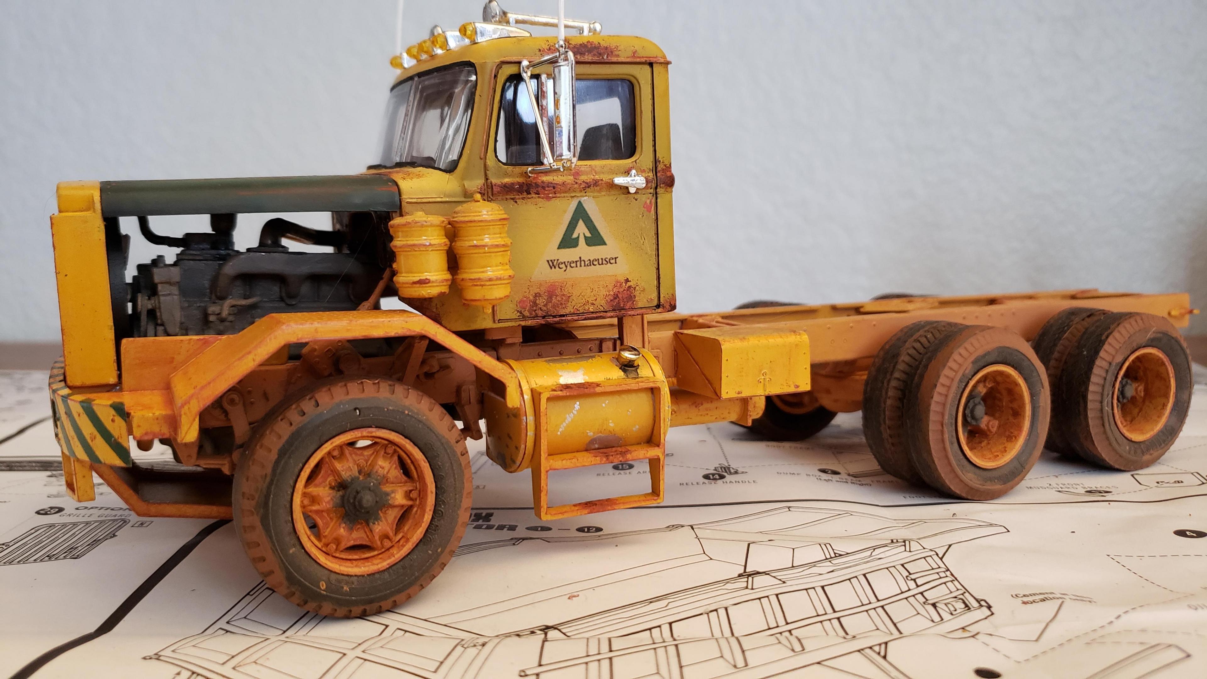

Here's how she sits now, thanks for looking

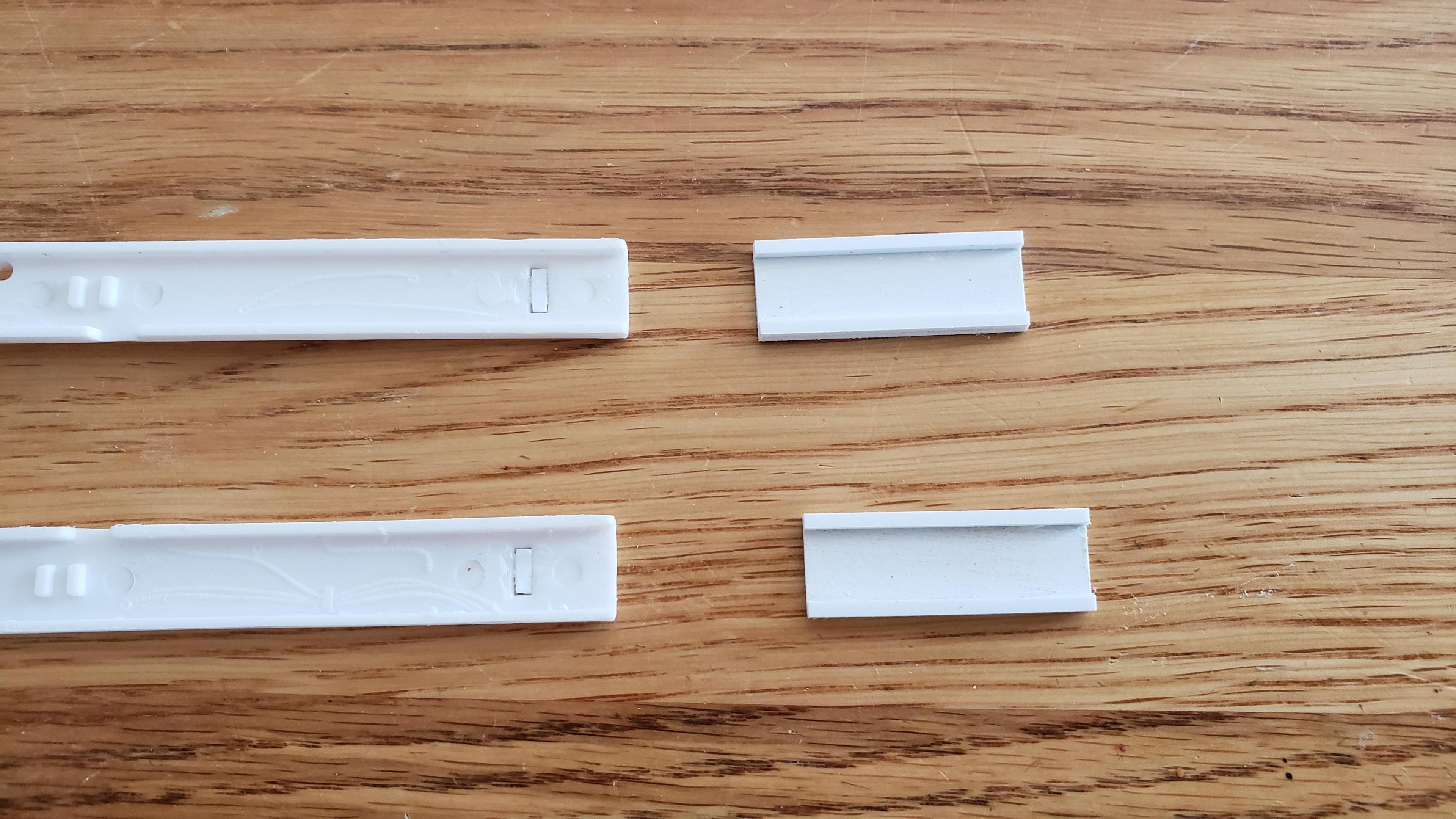

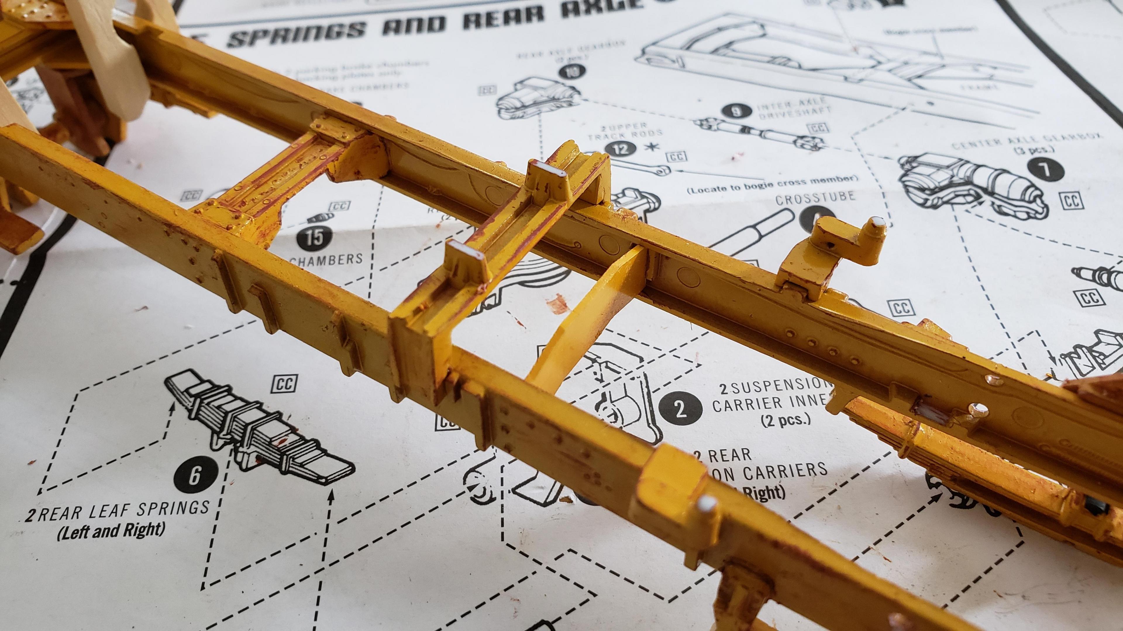

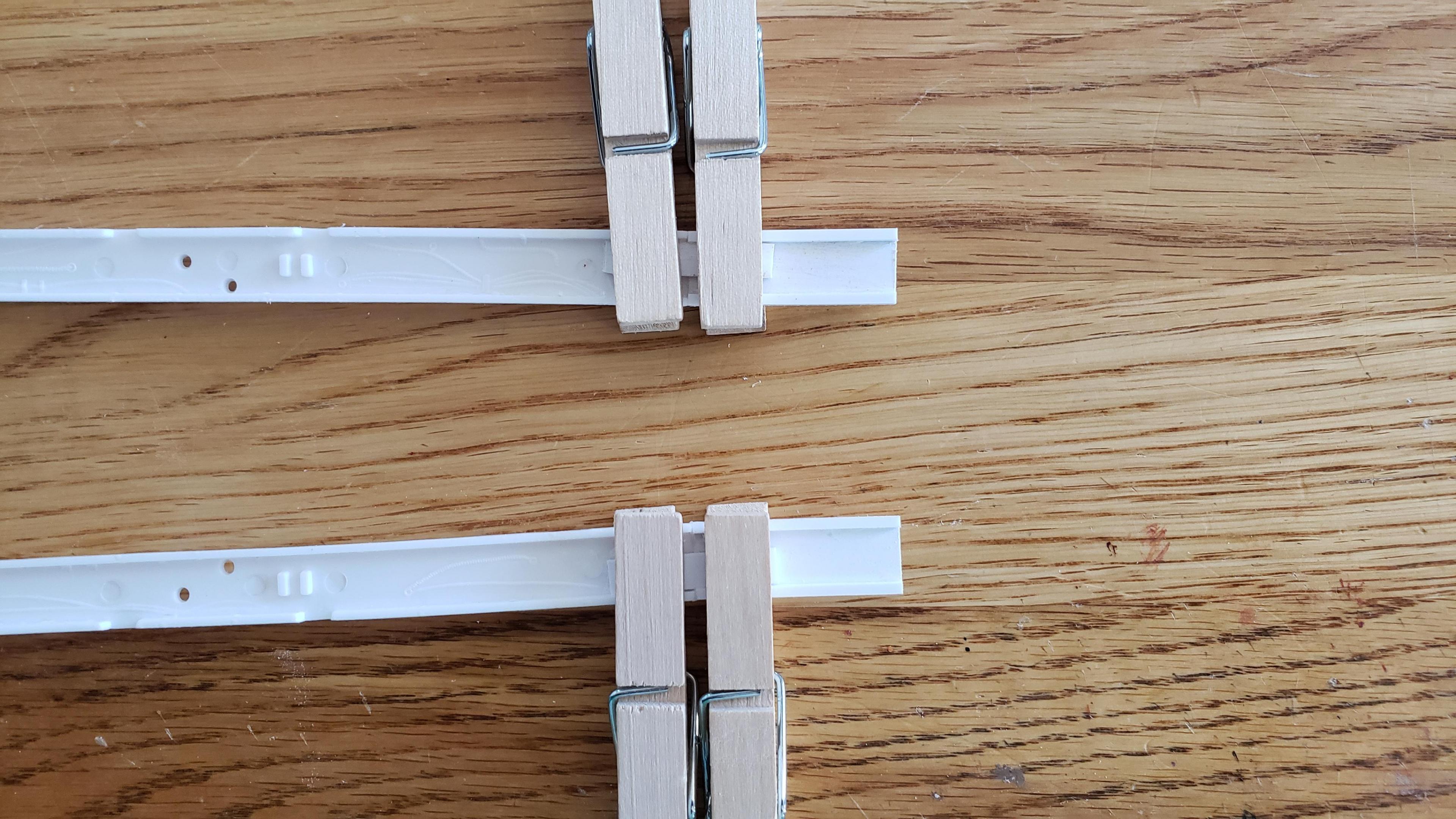

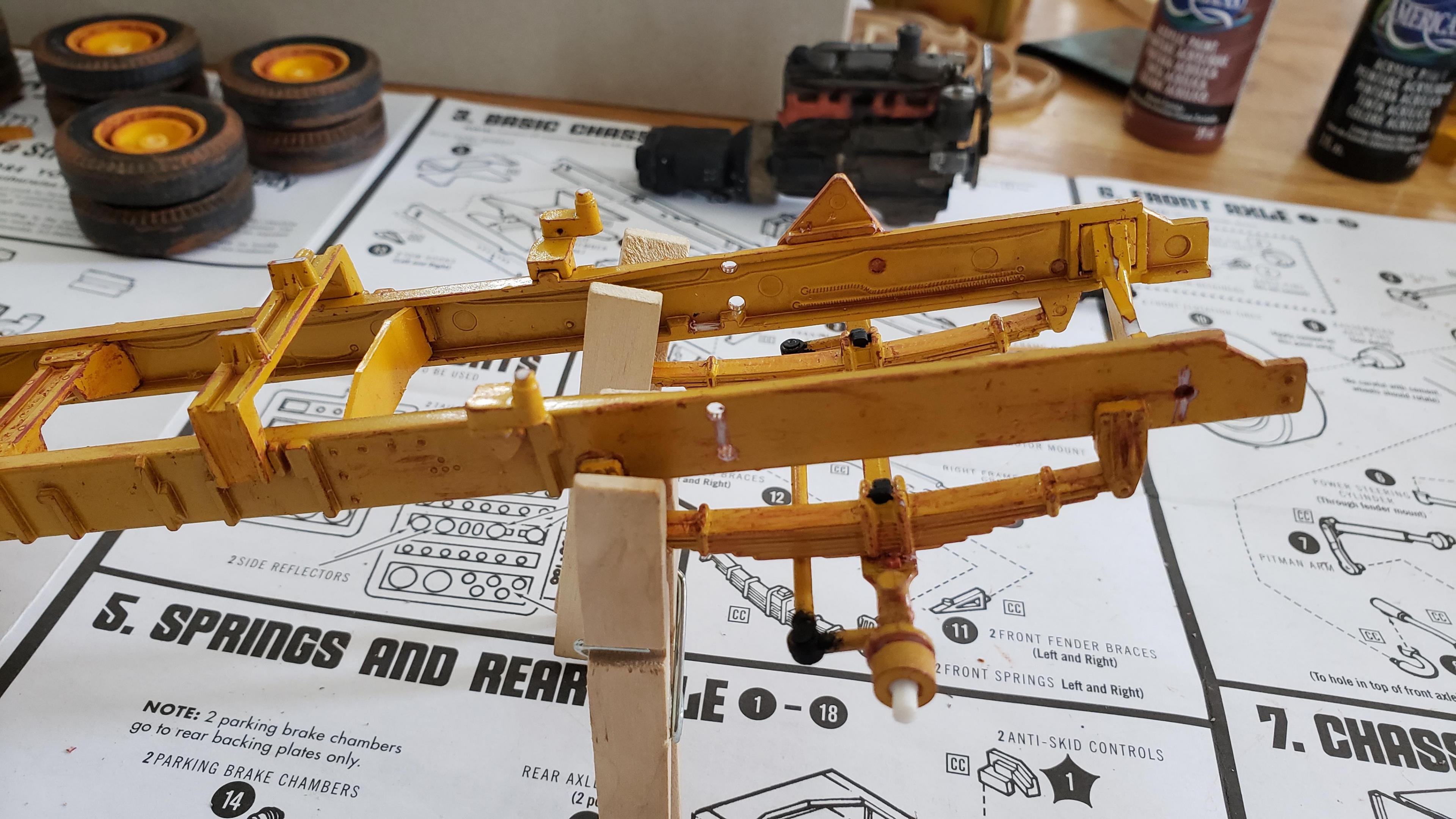

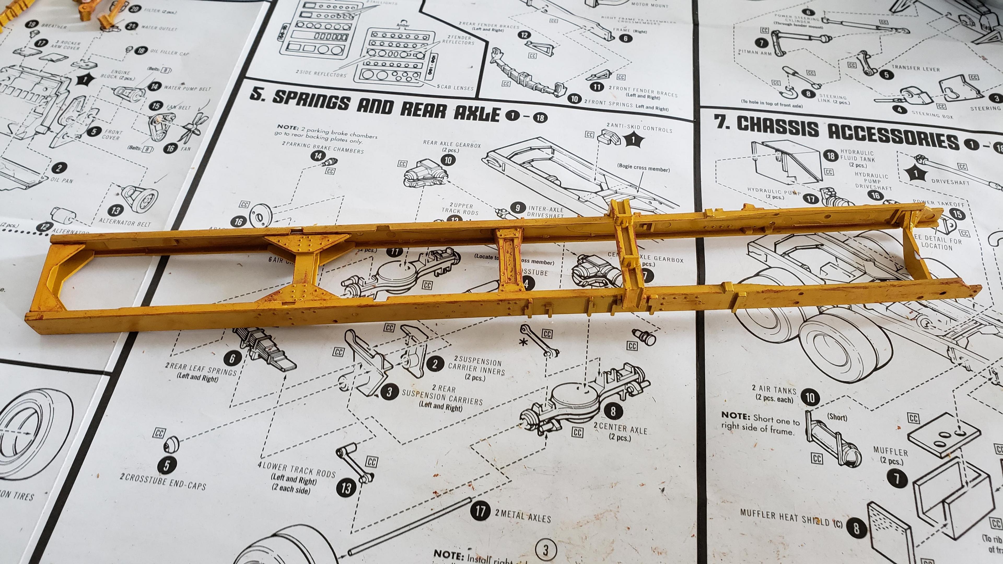

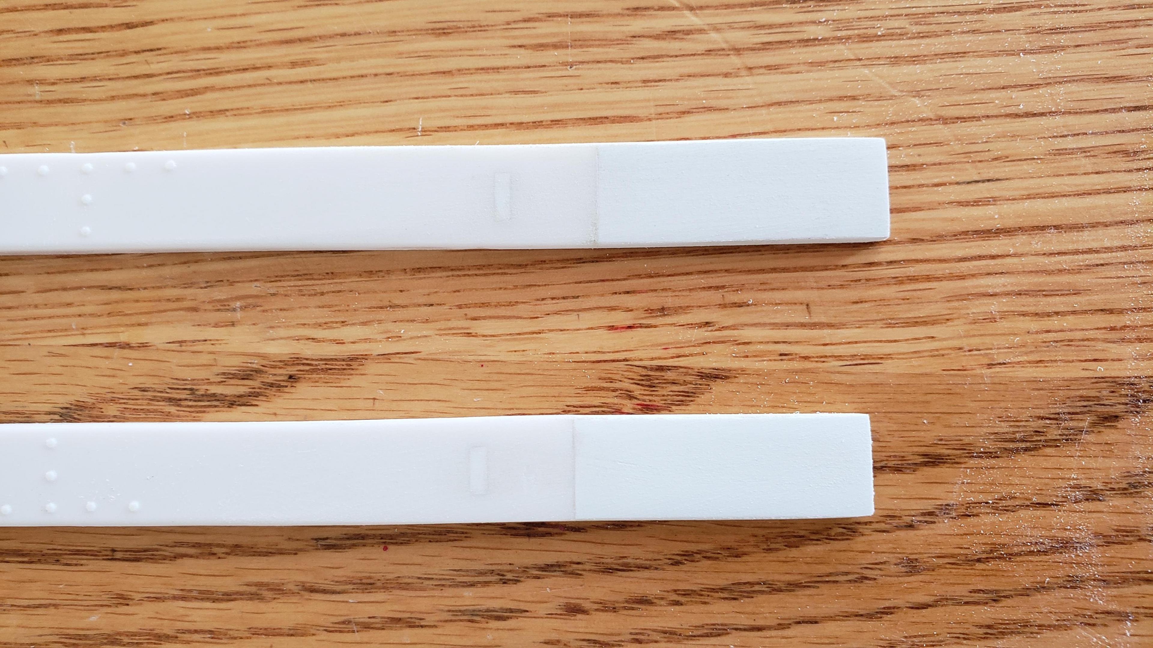

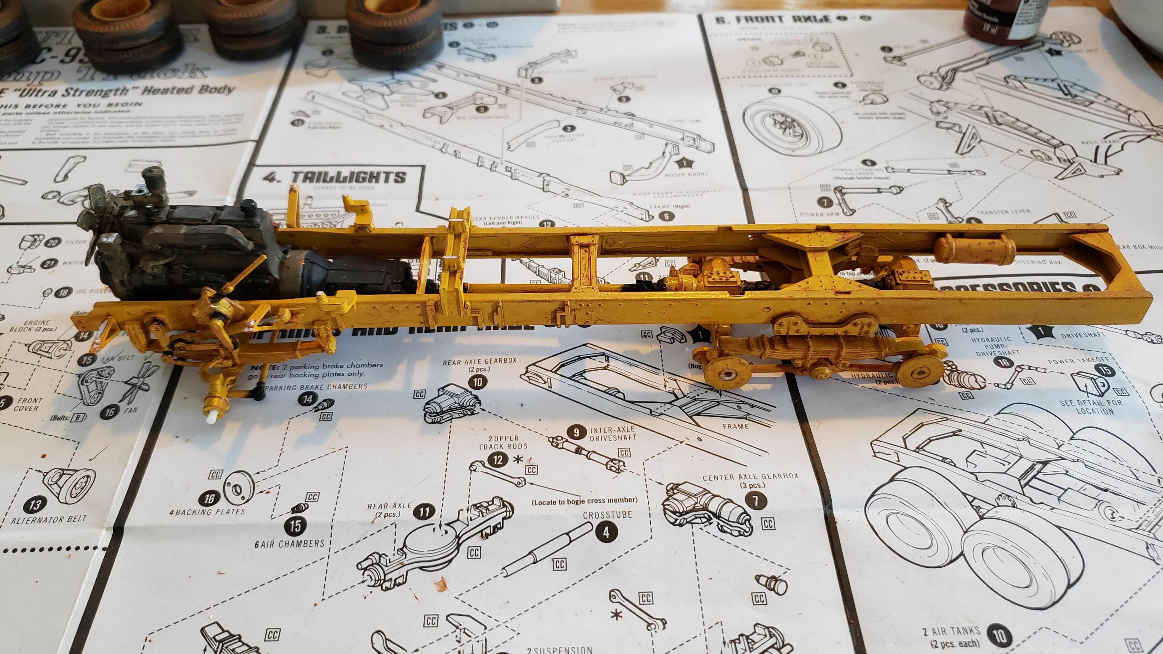

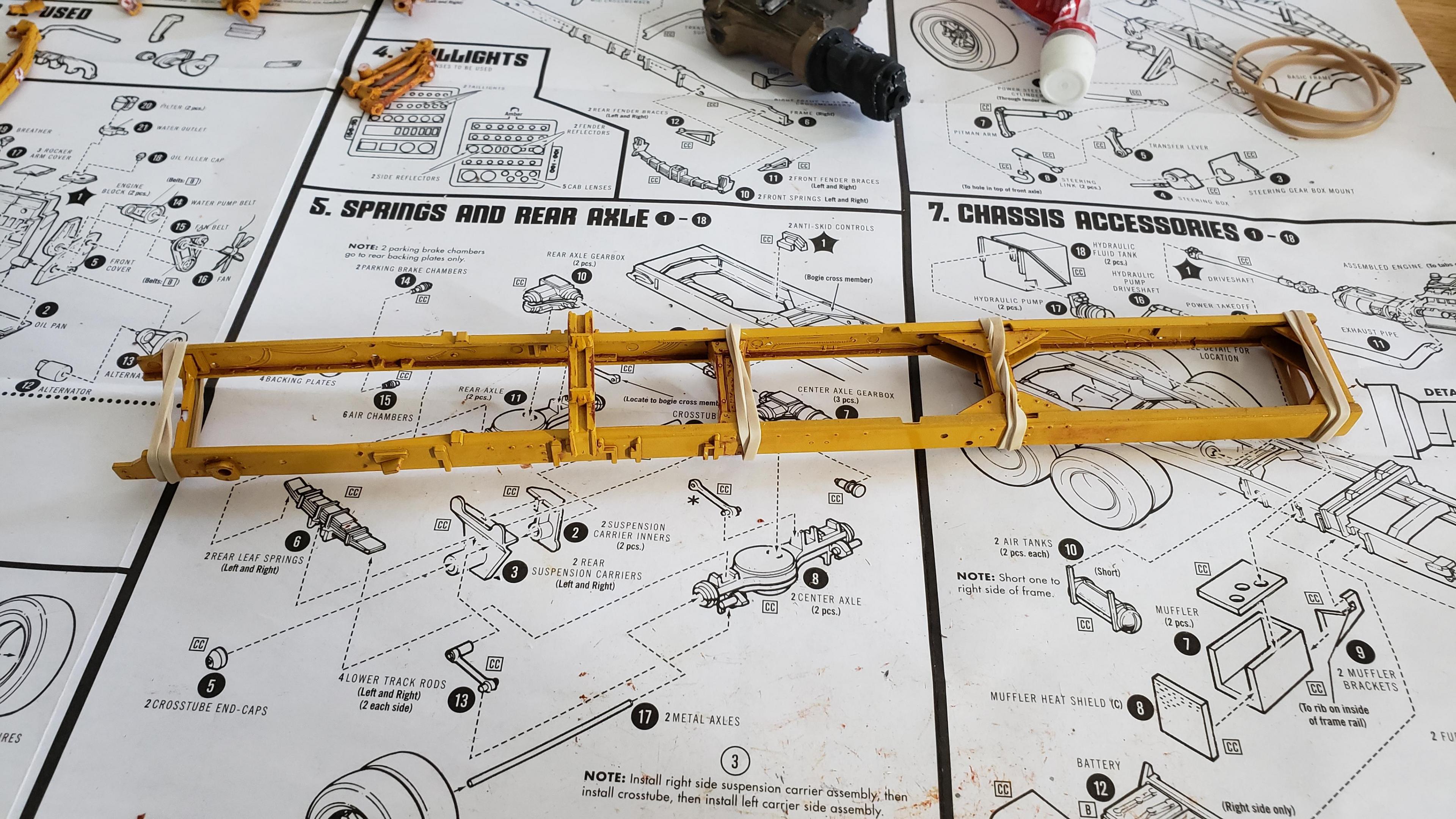

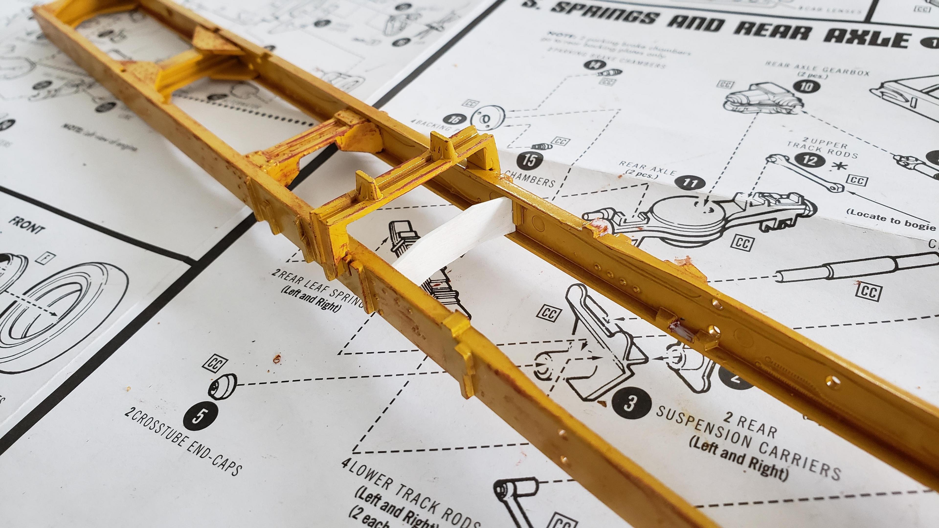

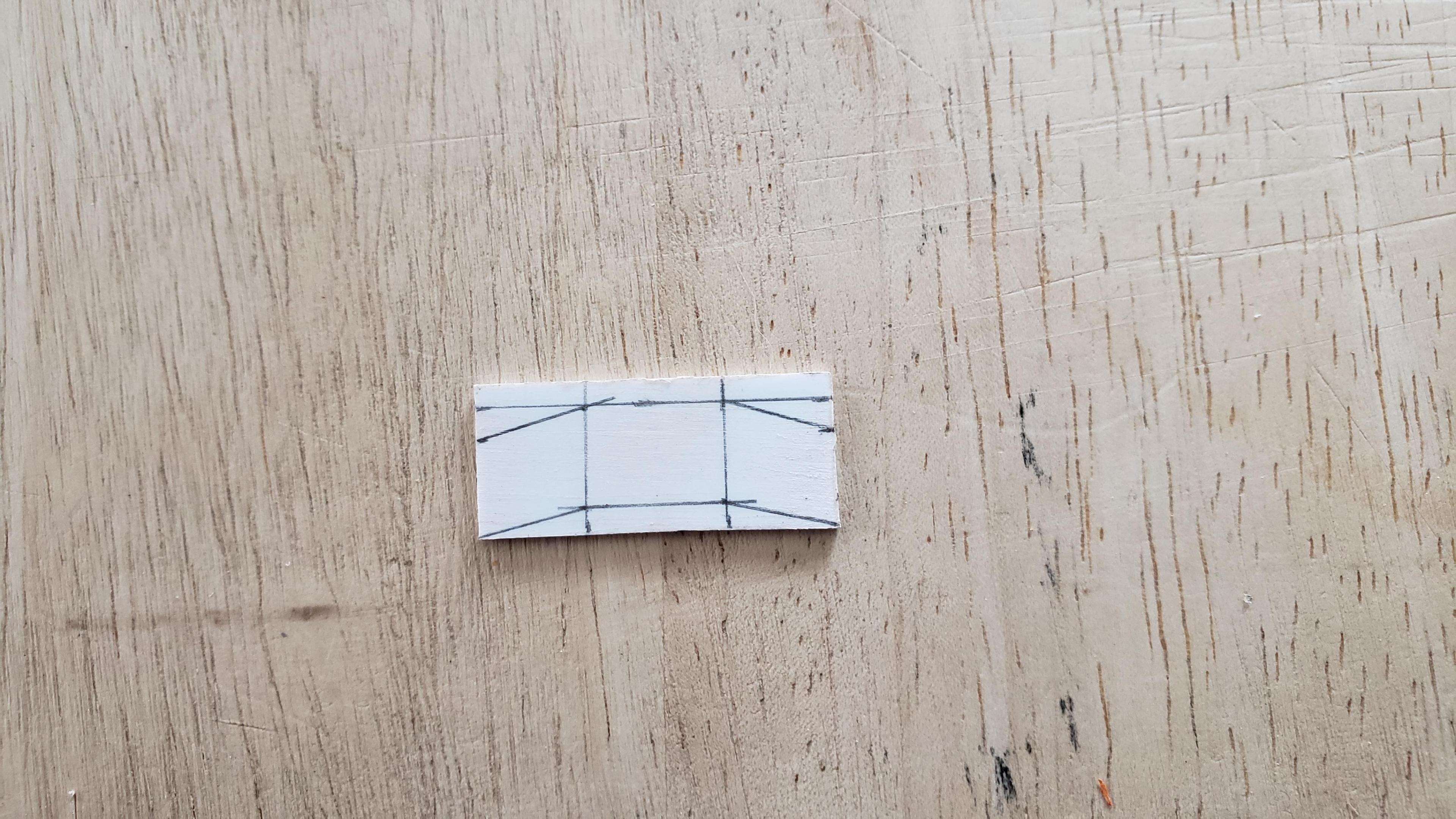

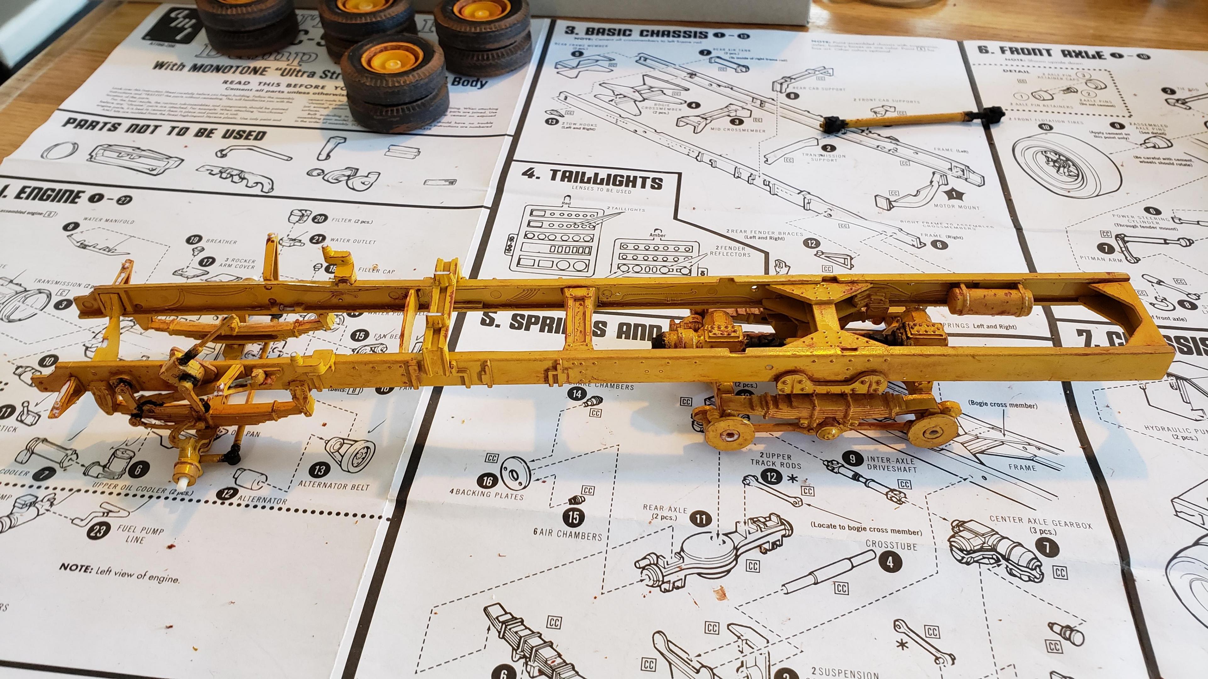

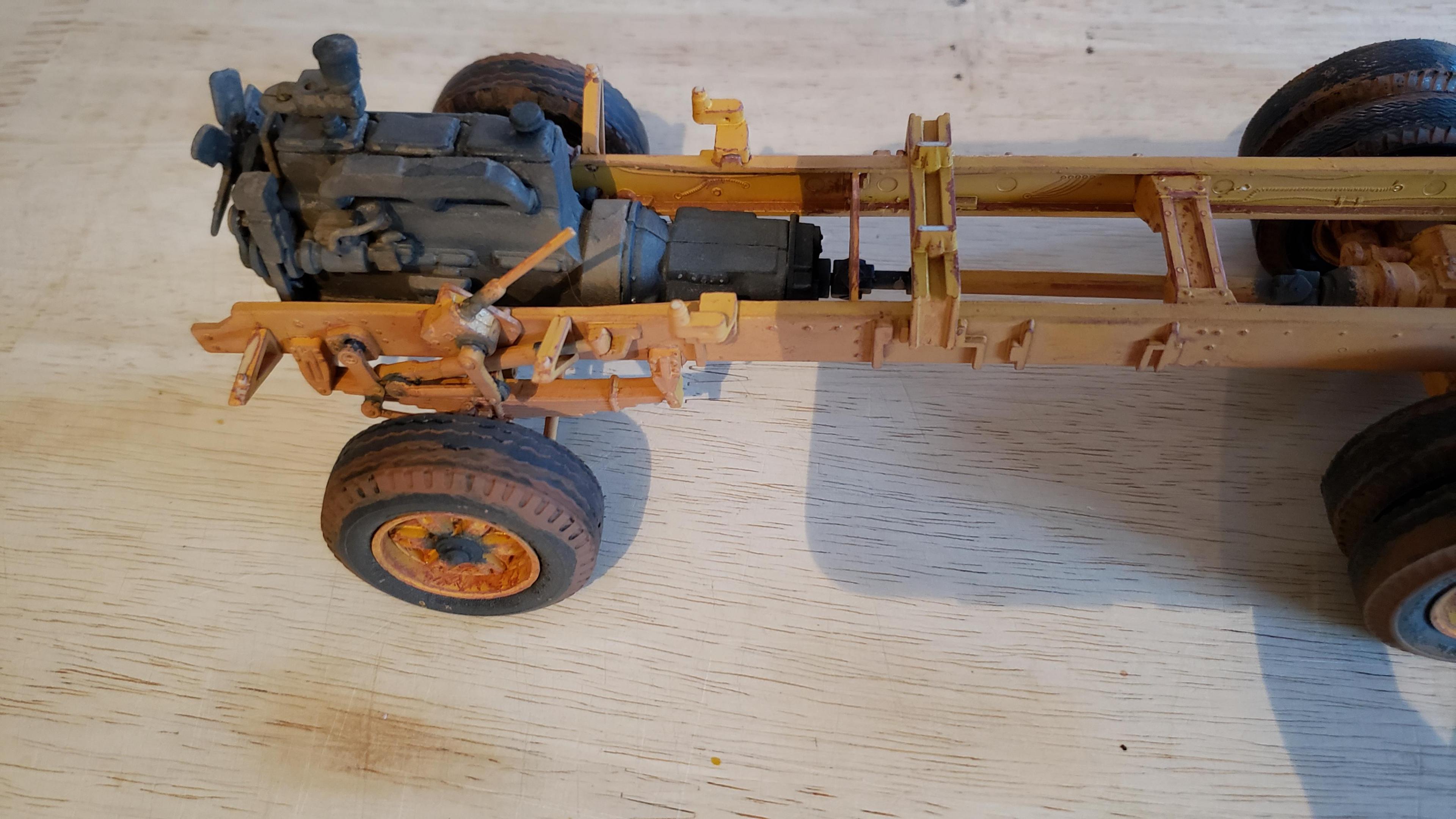

Got some more work done today. I'm on call at work tomorrow, so probably won't make any progress. I started out making some frame extensions for the rear stinger. I cut the sides from sheet, and attached strips for the top and bottom. I also filled in the weird vertical slots that didn't seem to correspond to anything.
I put together the frame, and realized that I had lost a cross member. Spent a long time looking for it. Wound up building a new one from scratch.
Once I was done for the day and cleaning up, I found the missing piece under the instruction sheet. Oh well (shrug)

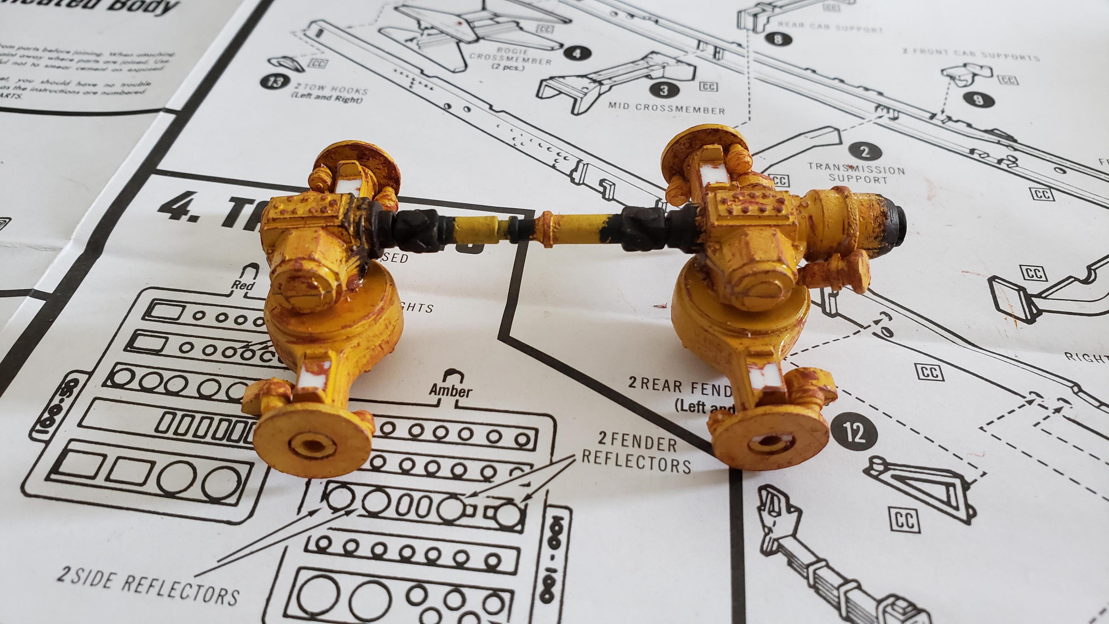

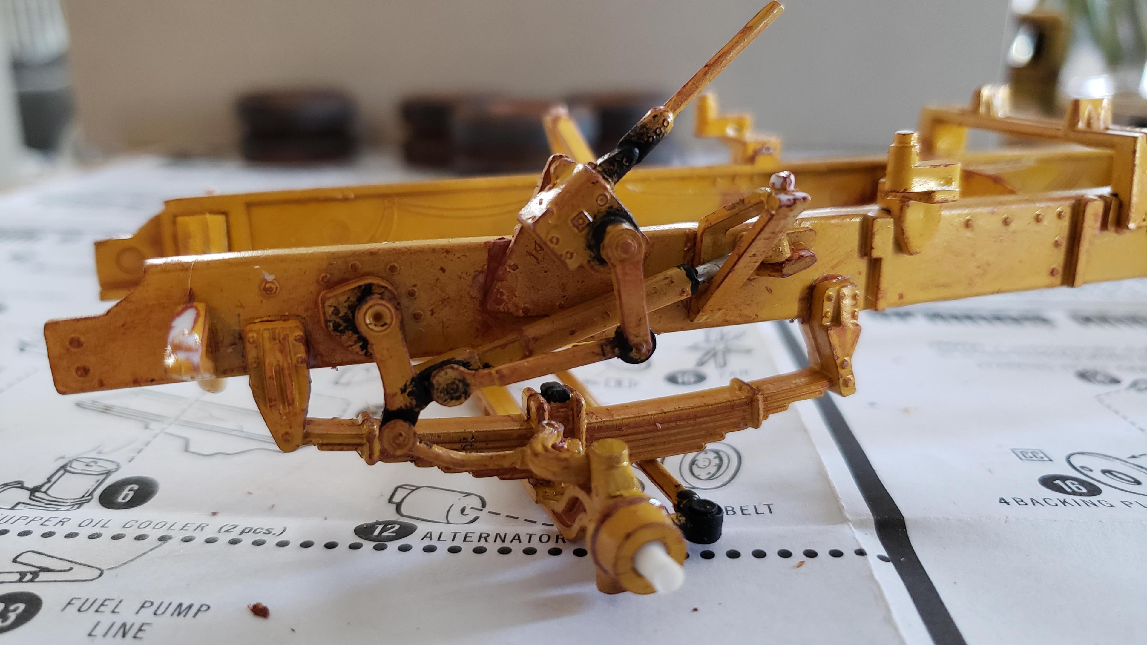

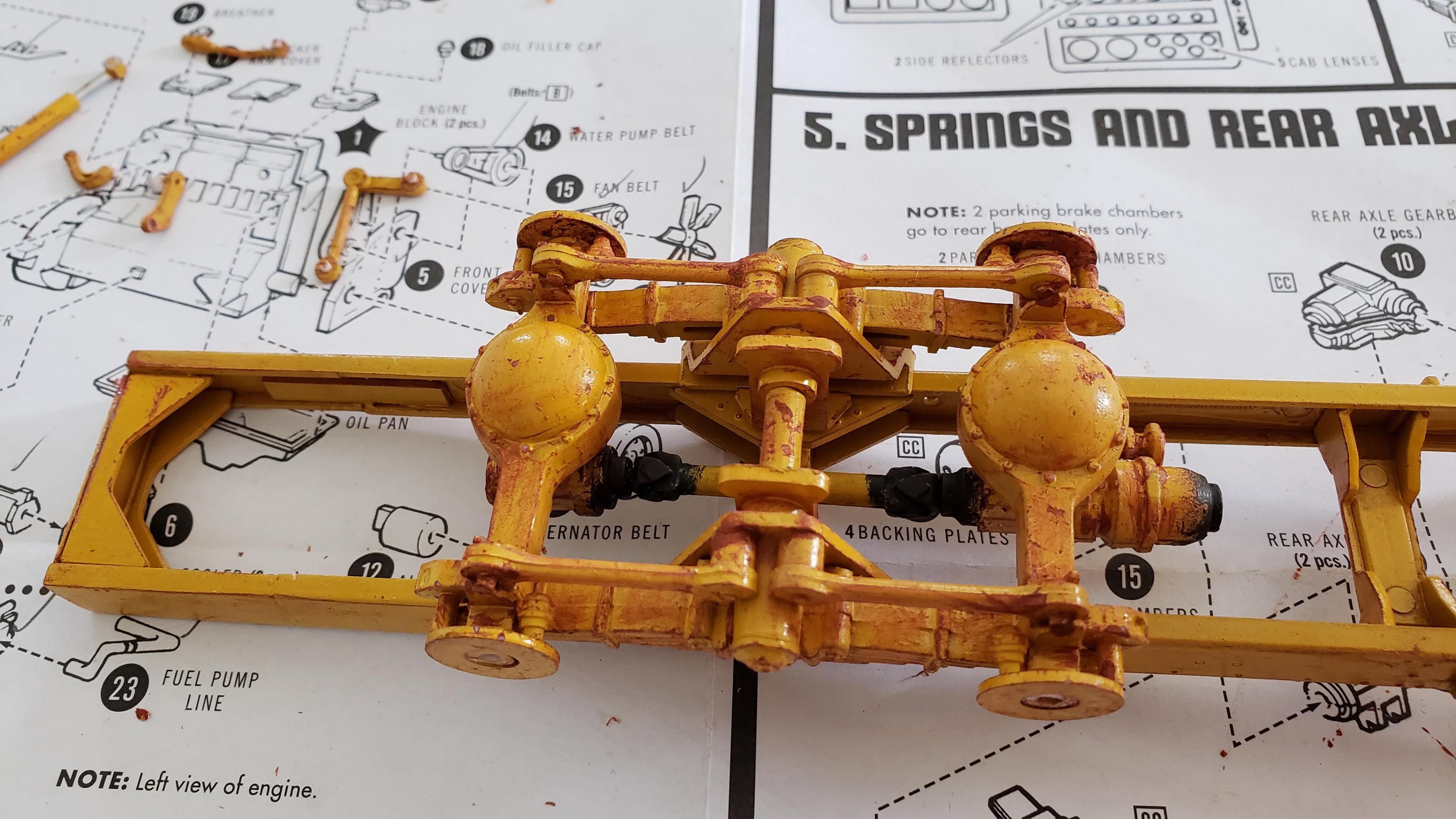

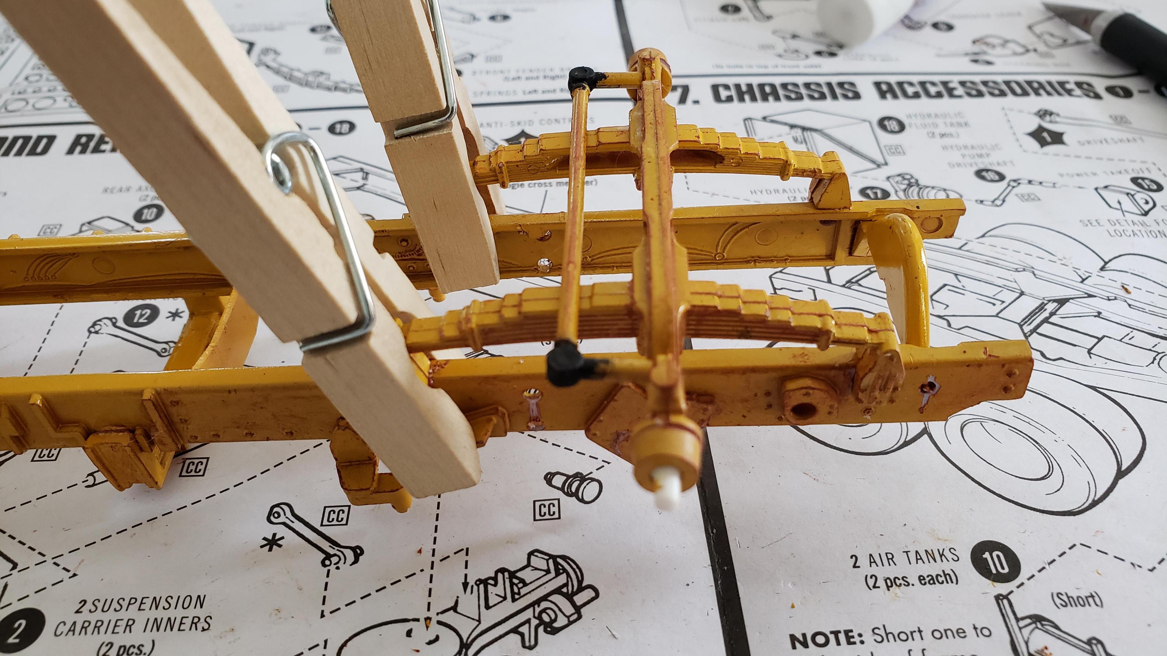

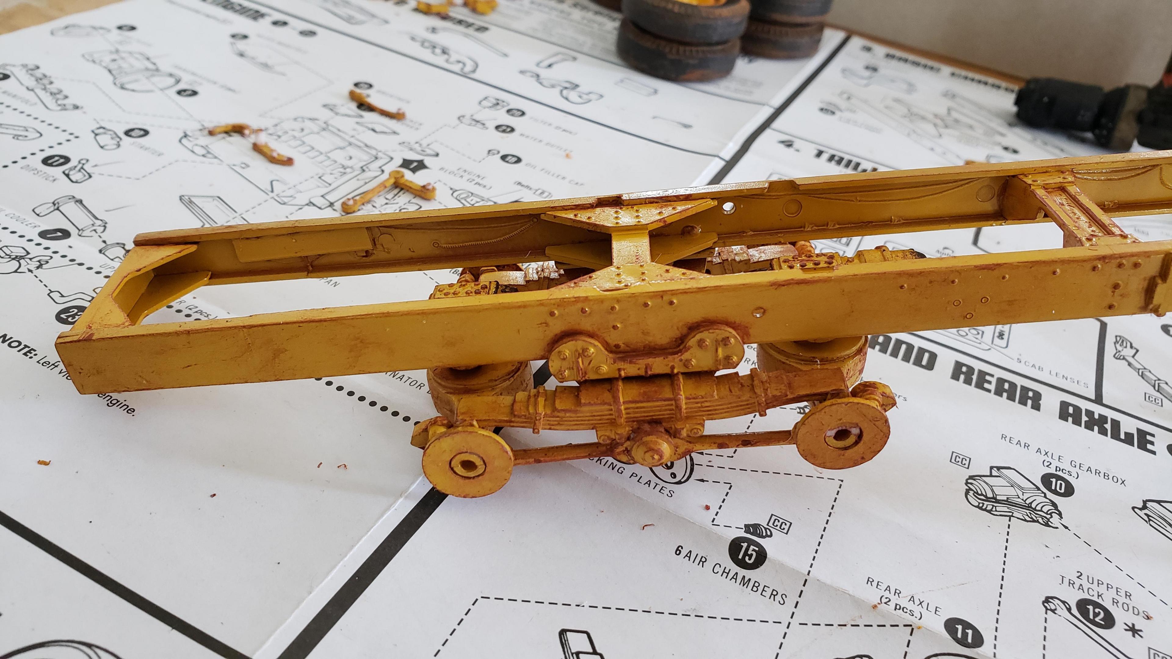

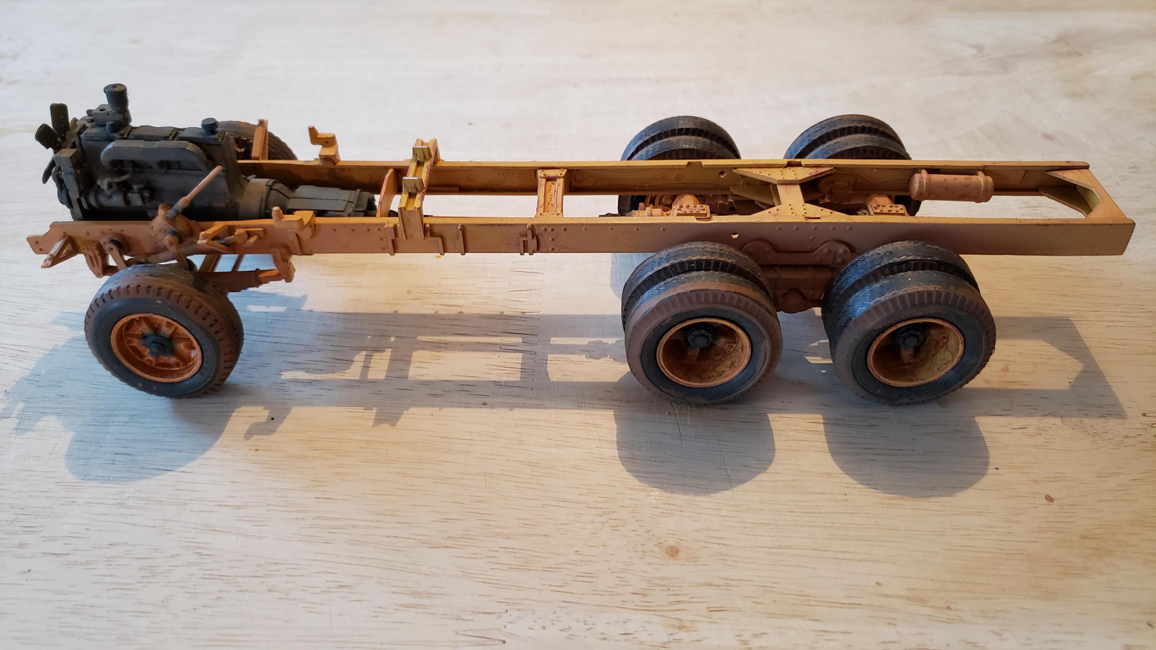

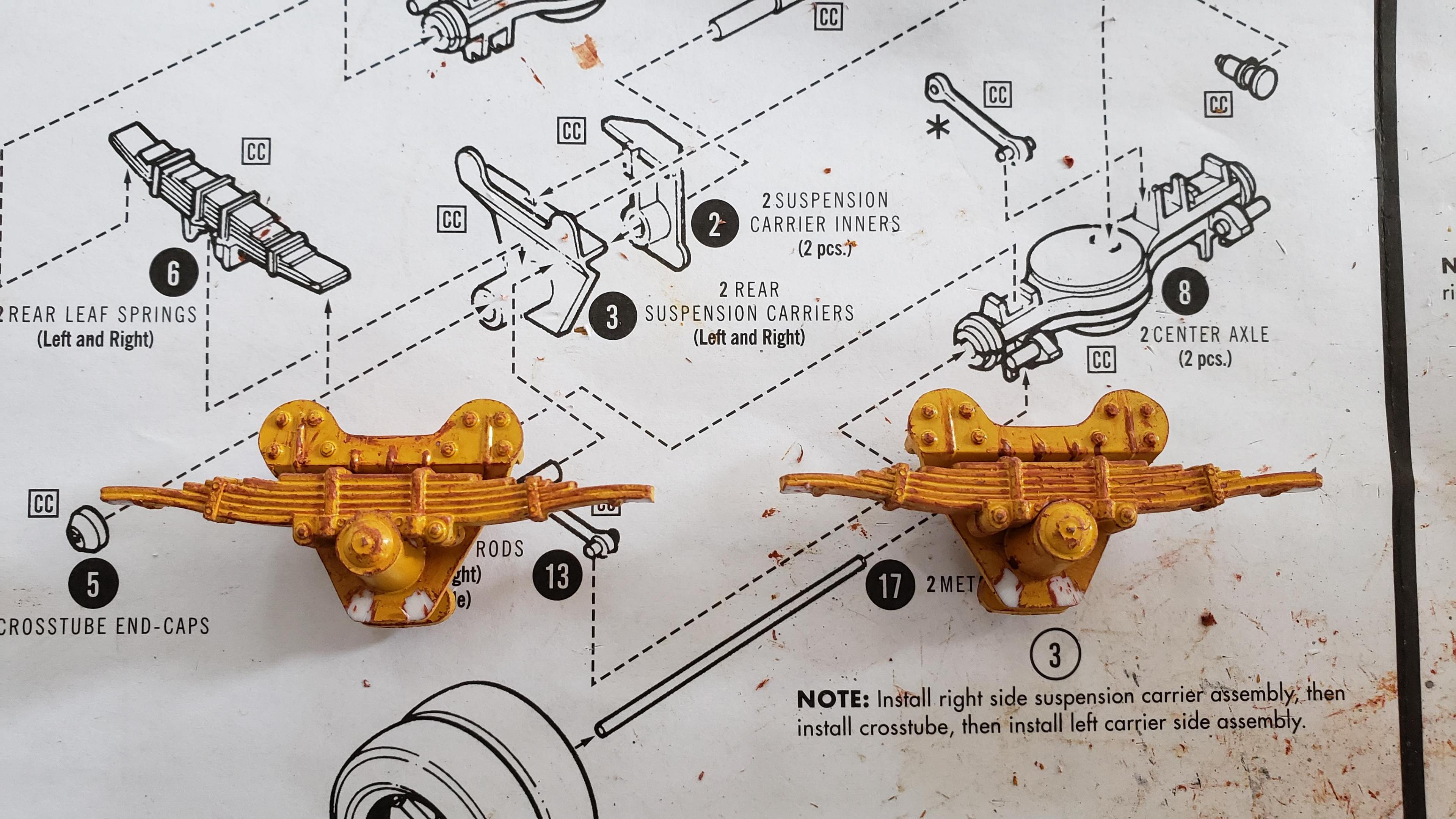

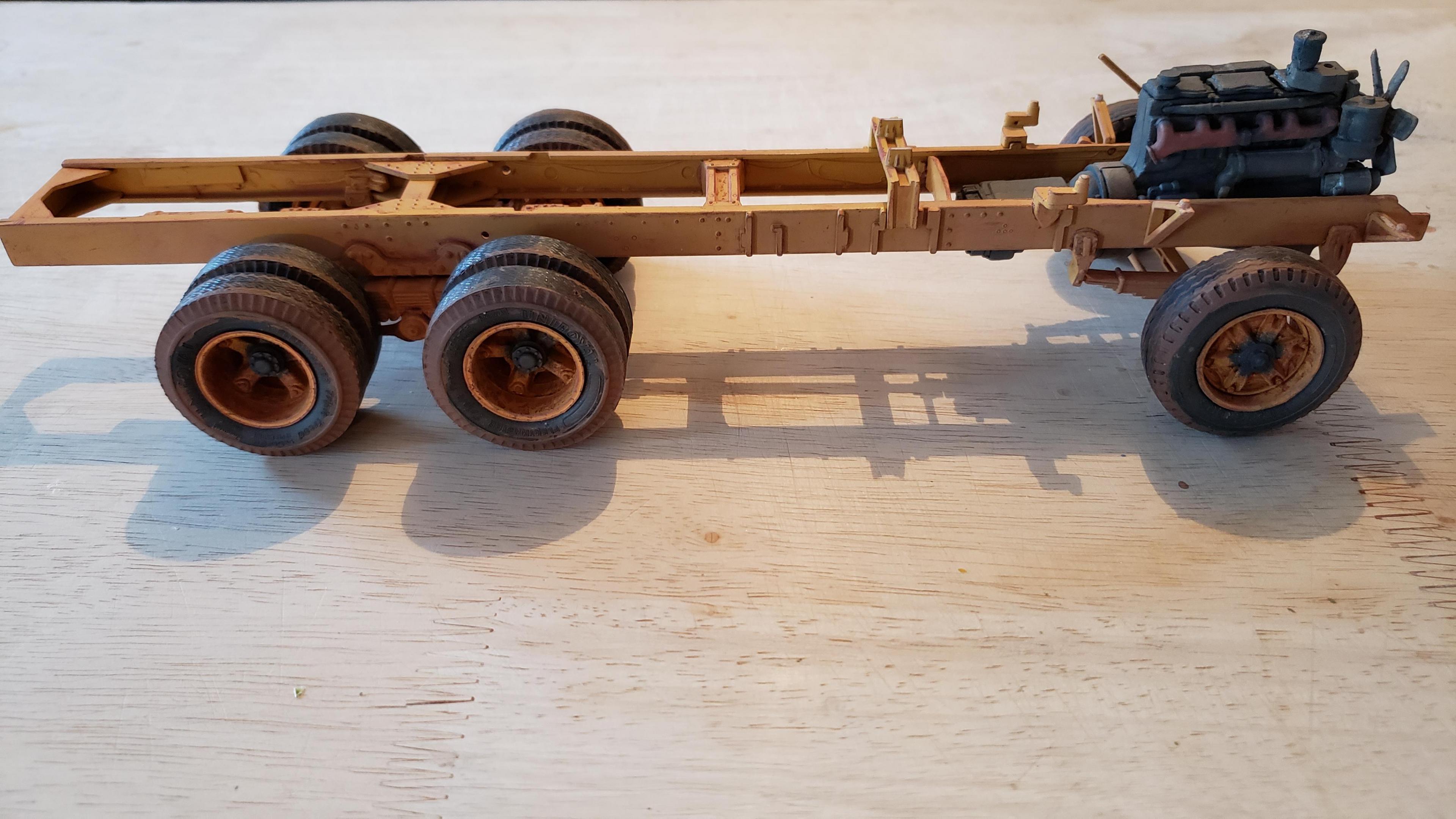

The instructions were pretty vague for the rear suspension, so I spent a while test fitting stuff. Finally figured it out

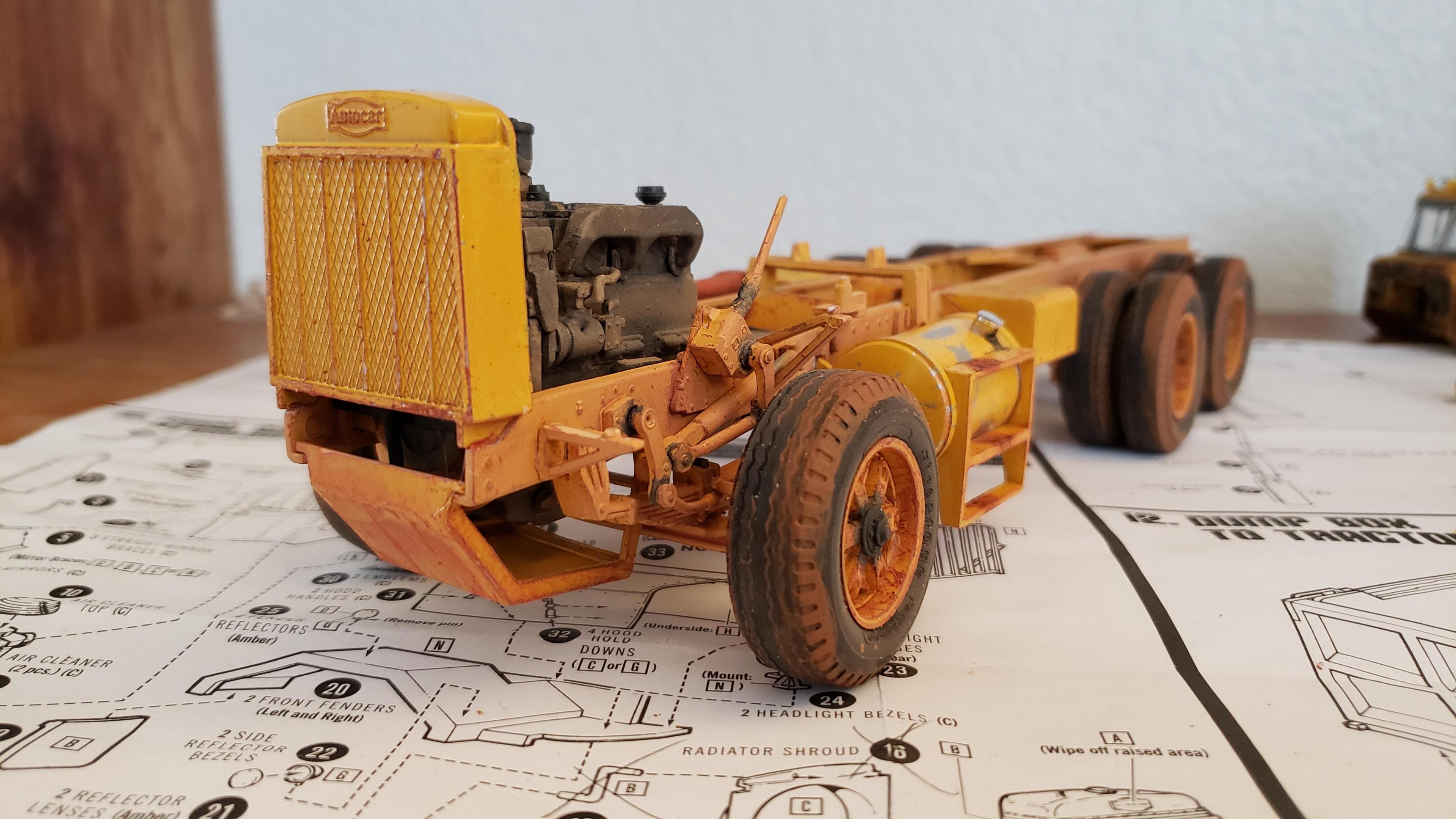

Then I got busy on the front suspension. The steering linkage was a bit of a challenge, but I got it all together.

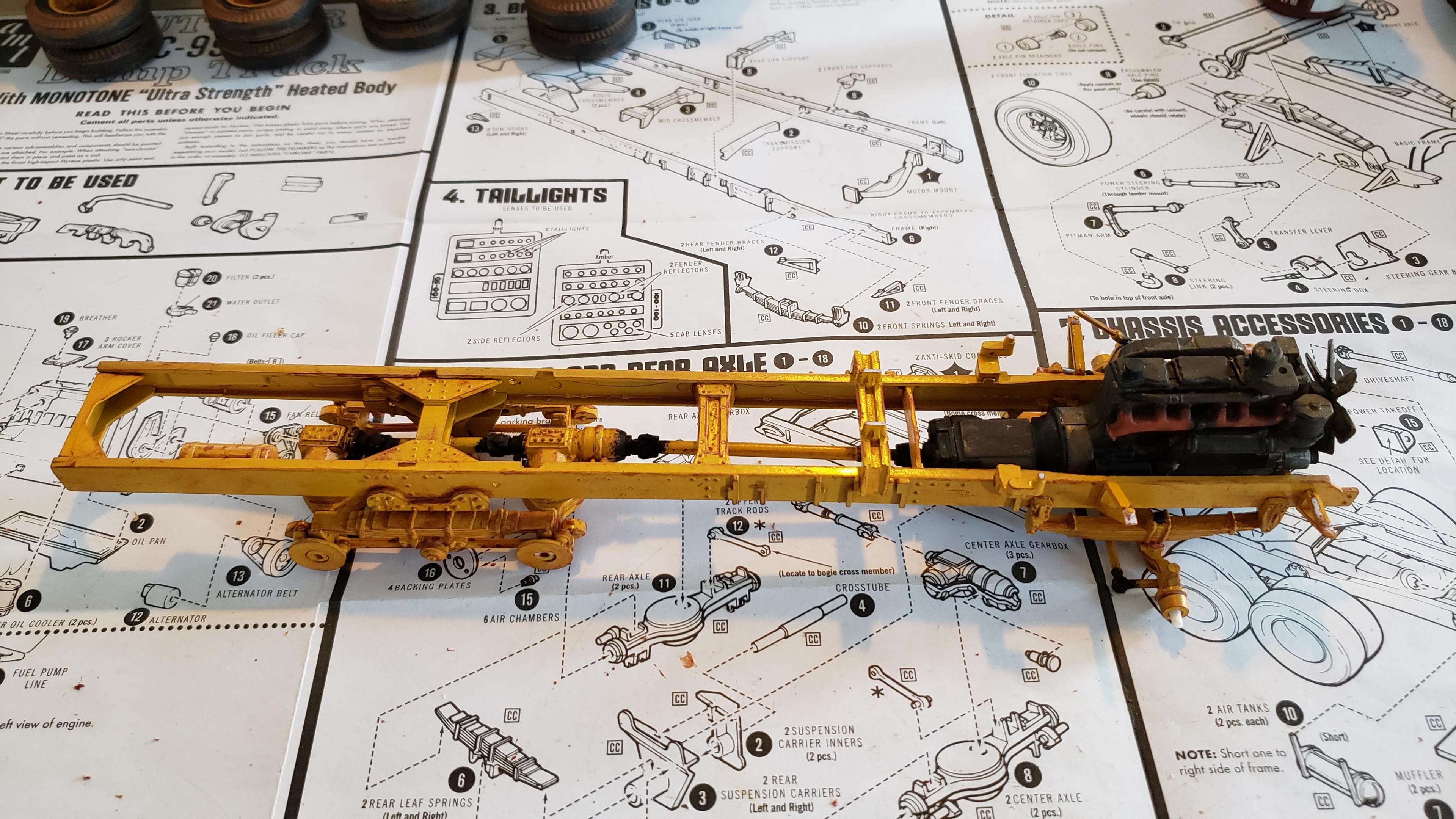

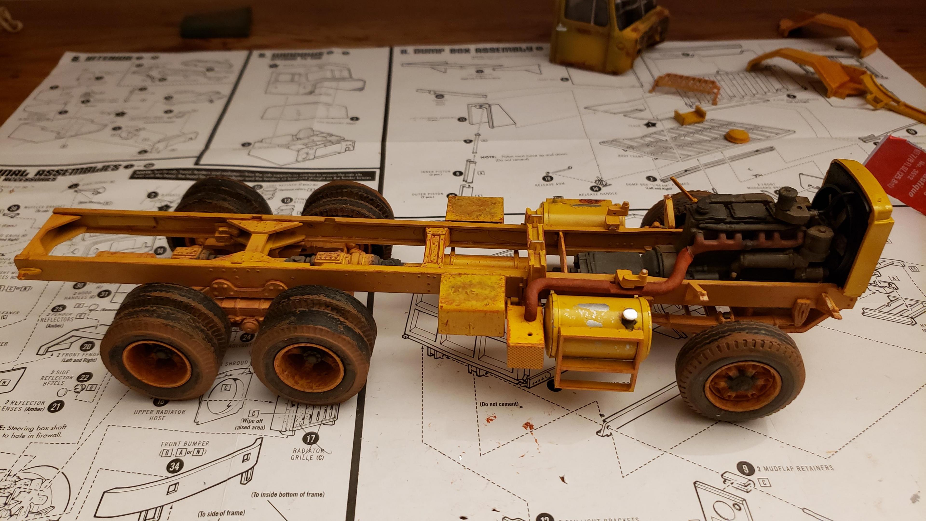

Then I got the engine mounted
Then I got the wheels on
Then I air brushed a light coat of dust. I will finish to dust coat up once the rest of the build is complete. It doesn't really look great at this point, but I don't want to over do it
 IIRC those slots are for the mudflaps.  The brackets have a hook shape on the end that fits into the slots.
On 2/22/2020 at 4:17 AM, Warren D said:
I think it's the same frame as the A-Car tractor which attach that way.
Oh ok, that makes sense

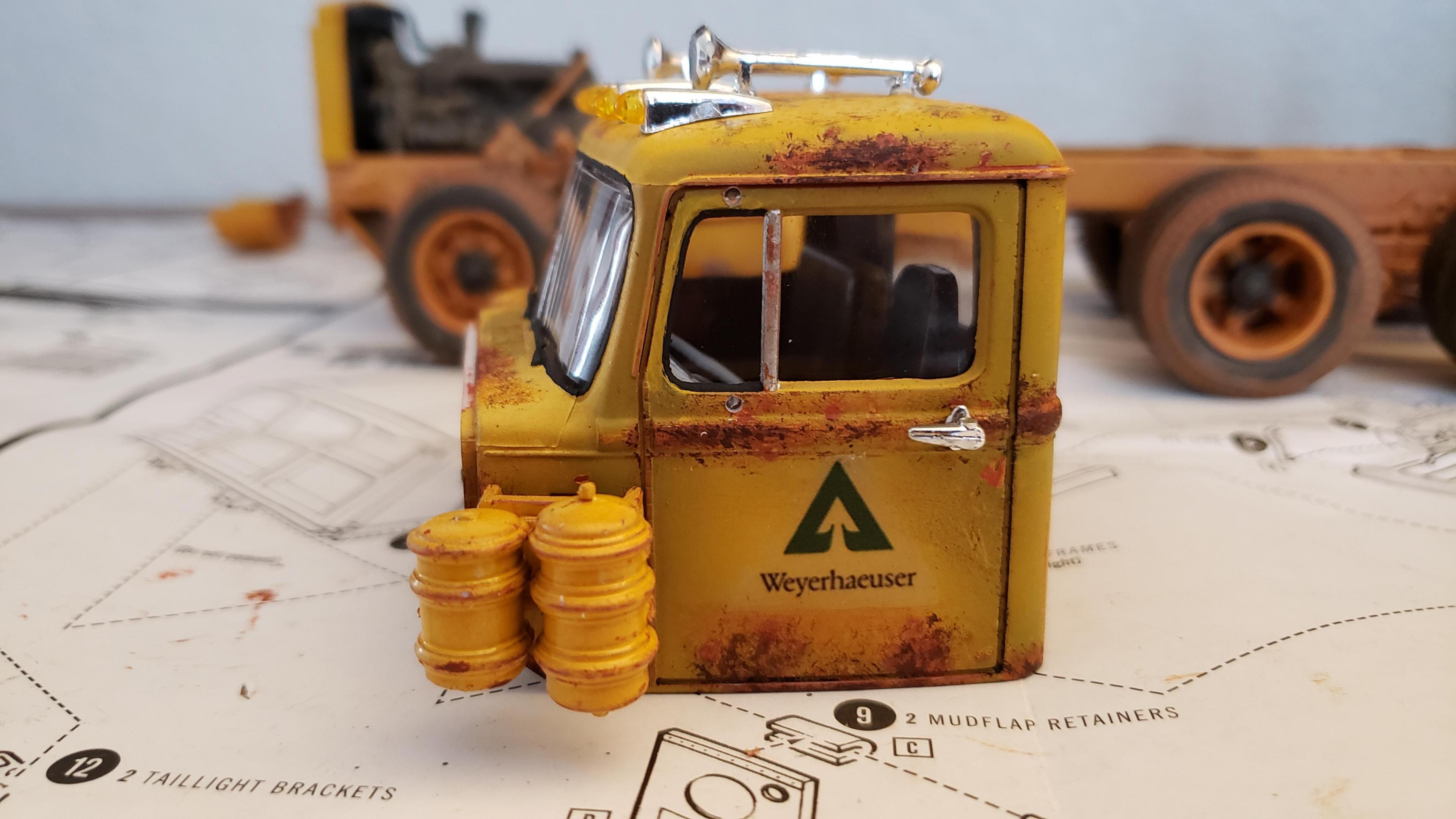

I'm now at the point of adding the fuel tanks to the frame. I'd like to weather them a bit. Does anyone know if the tanks were made of steel or aluminum? I don't know whether to add a little rust or maybe just some chipped paint exposing aluminum. How about the steps also. Can anyone help me?
 Andrew,
            I really like the weathering on the cab and chassis thus far . It is looking pretty from here .
 Be Well
  Gator

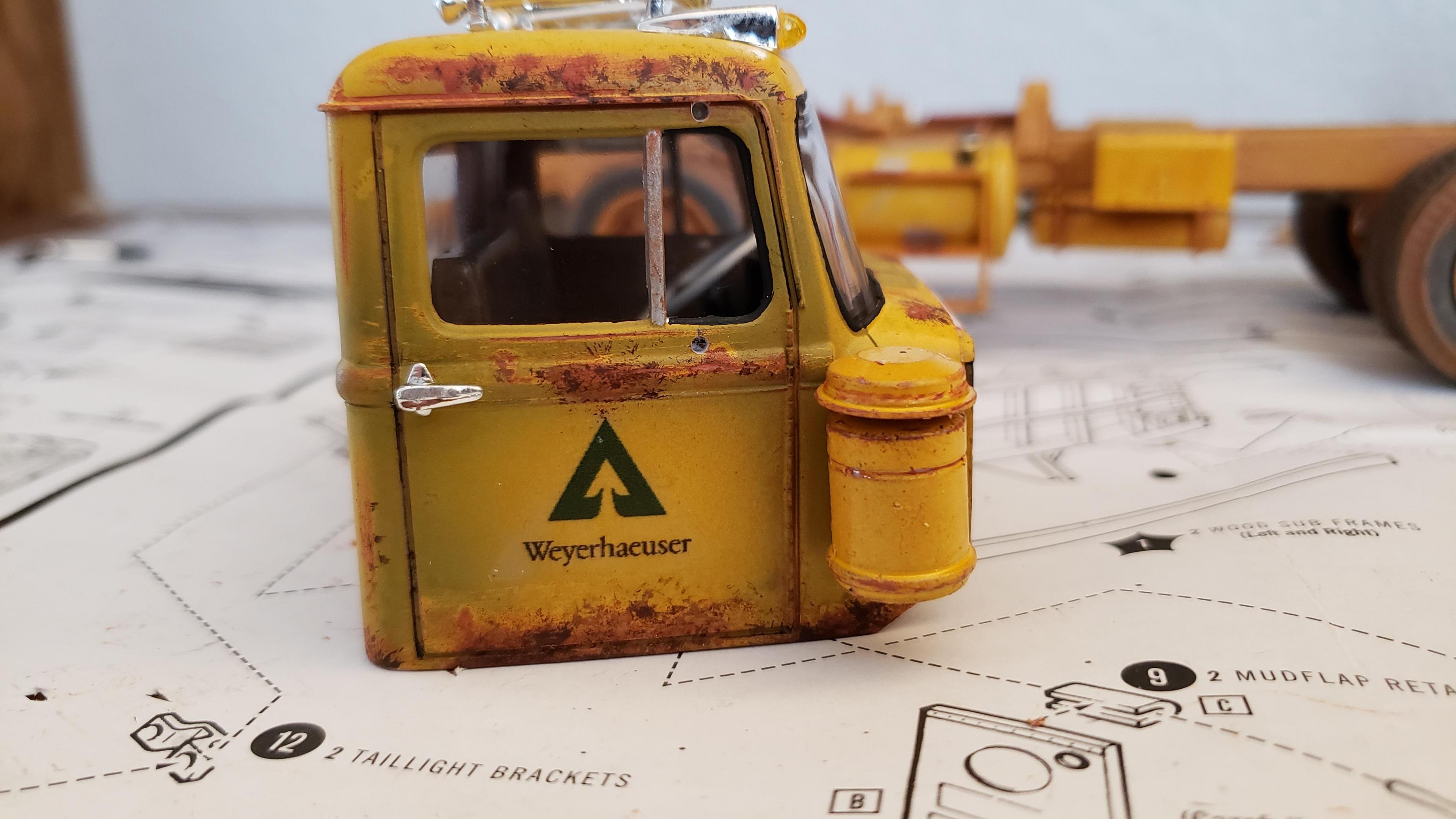

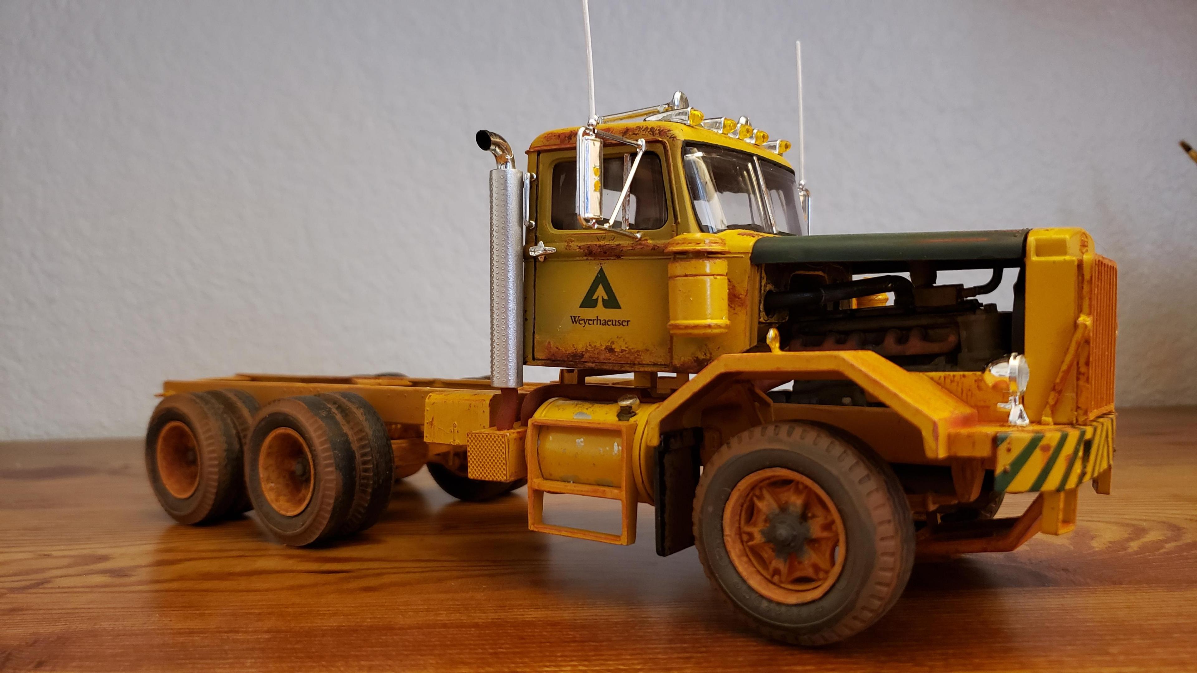

A bunch of progress made on this. First I got the fuel tanks and battery boxes mounted. And the weird muffler

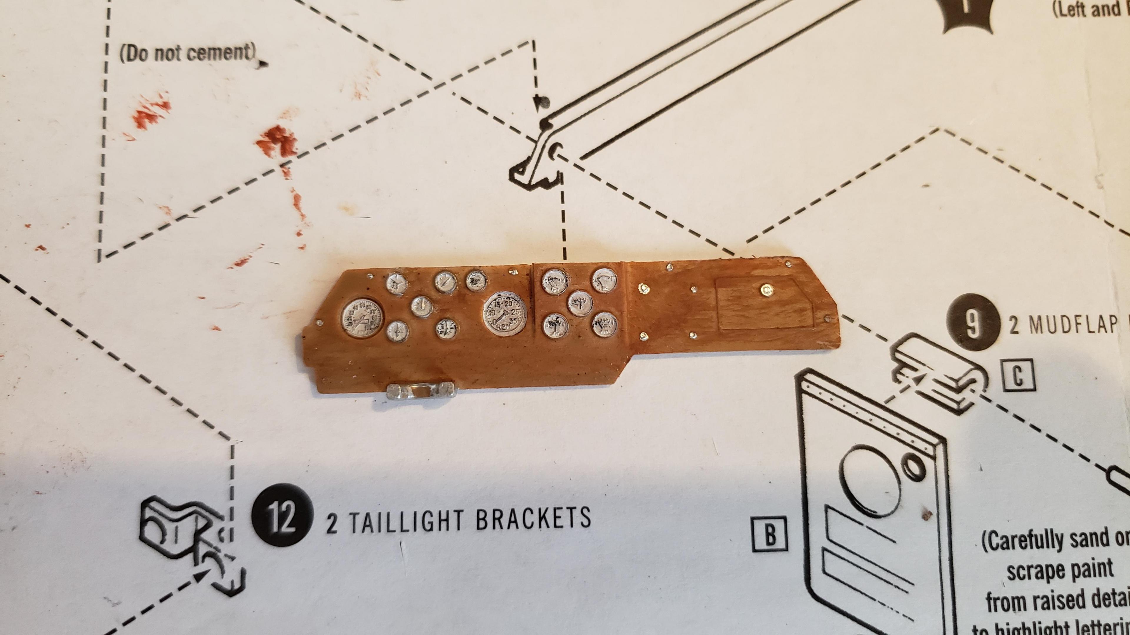

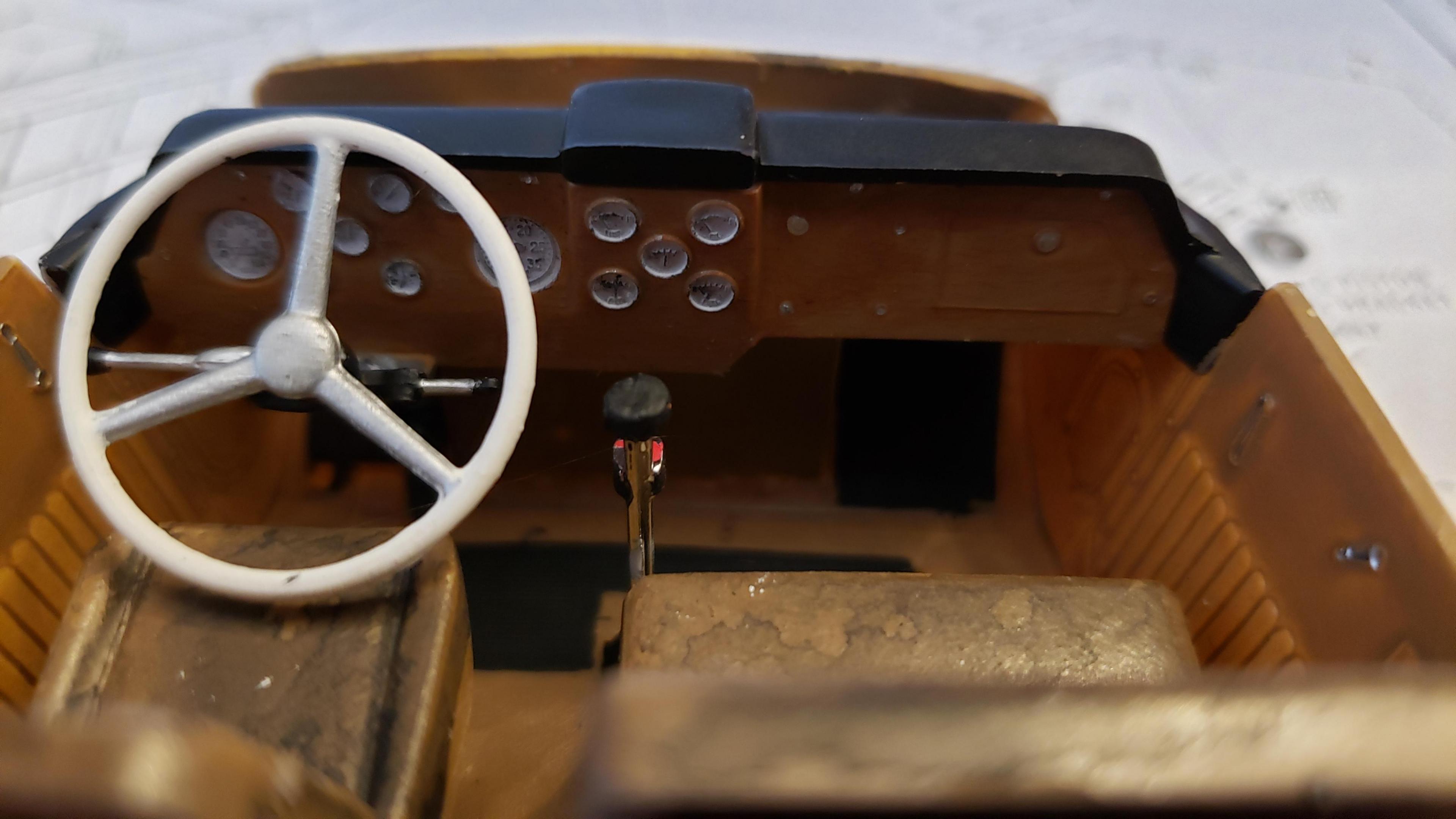

Then I worked on the interior
Next I got the radiator mounted
I got the roof accessories mounted

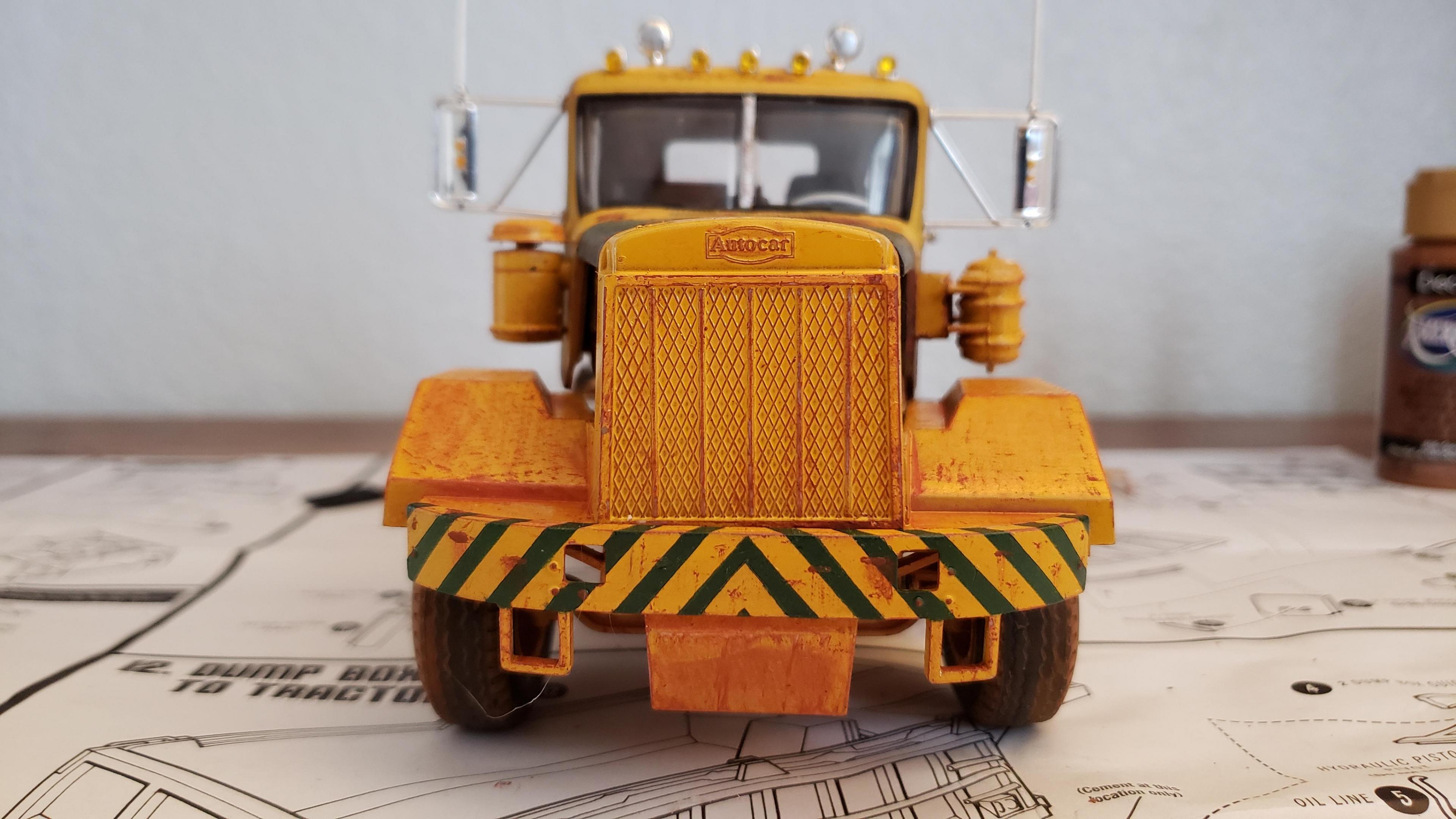

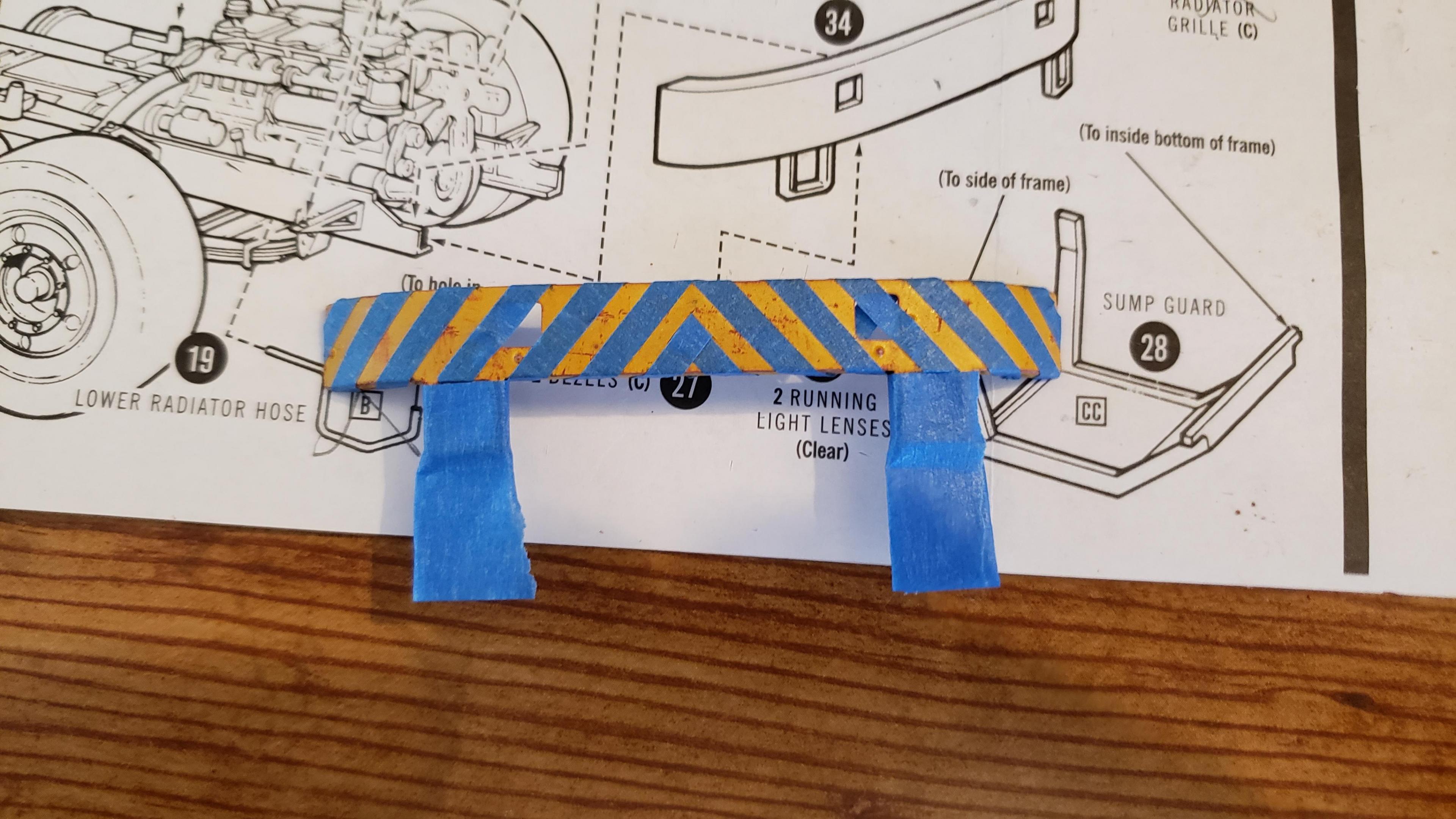

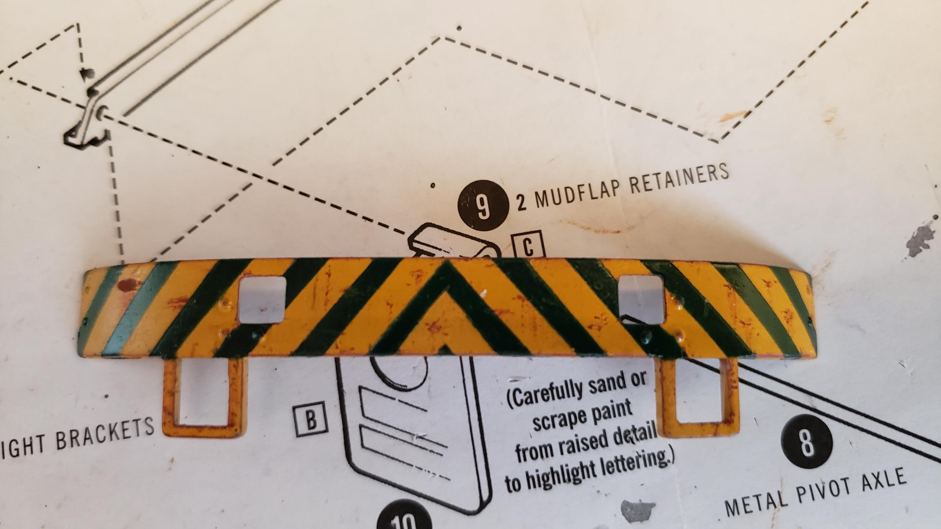

Masked off bumper stripes
Skid plate mounted

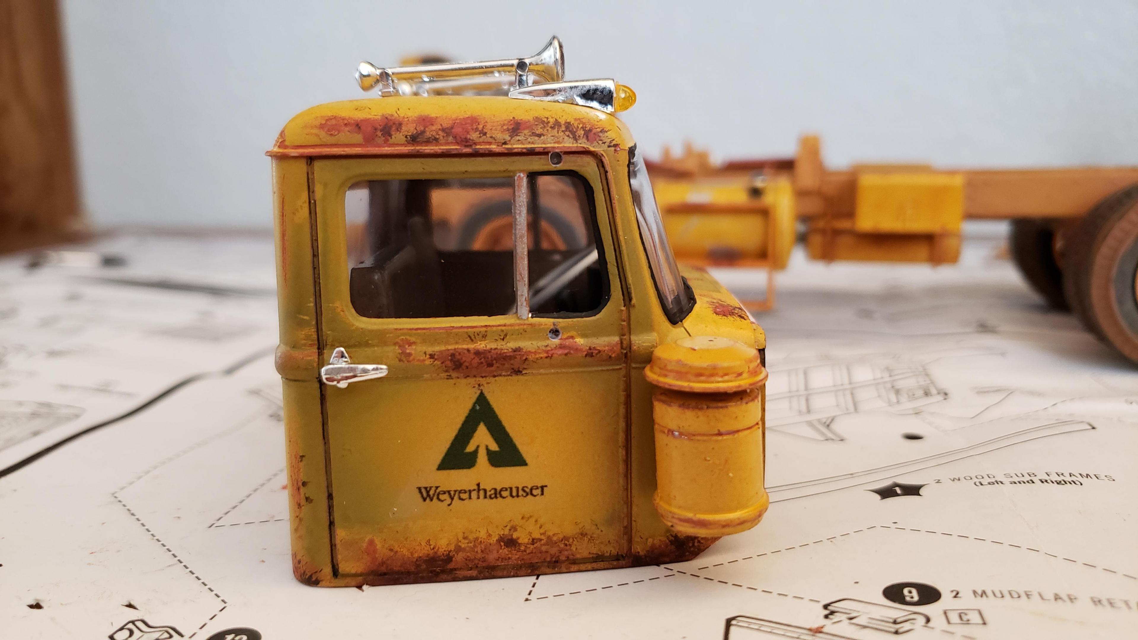

I made custom decals, got air filter, lube finer and power steering resevrior mounted
Mounted the cab
Hood and fenders
And bumper
I got the stack mounted from the weird muffler. As you can see in the photos, I used mirrors from the snap pete kit. Since the provided mirror brackets are a scale 1 1/2" diameter, I decided to scale it down a bit. It's now time to start on the logging bunk
