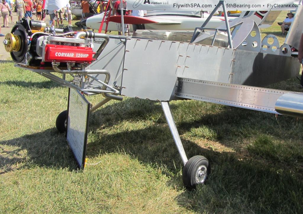

Not original but it shore is purty, if you want to do a little dress-up.  Corvair engine installed in a Sport Performance Aviation Panther homebuilt aircraft.  Corvair engines were also installed in boats, and the first prototypes of the M-561 Gama Goat military vehicle.  They were prone to overheating and breaking down in the Gama Goat and replaced by a 3-cylinder Detroit Diesel engine for production.
