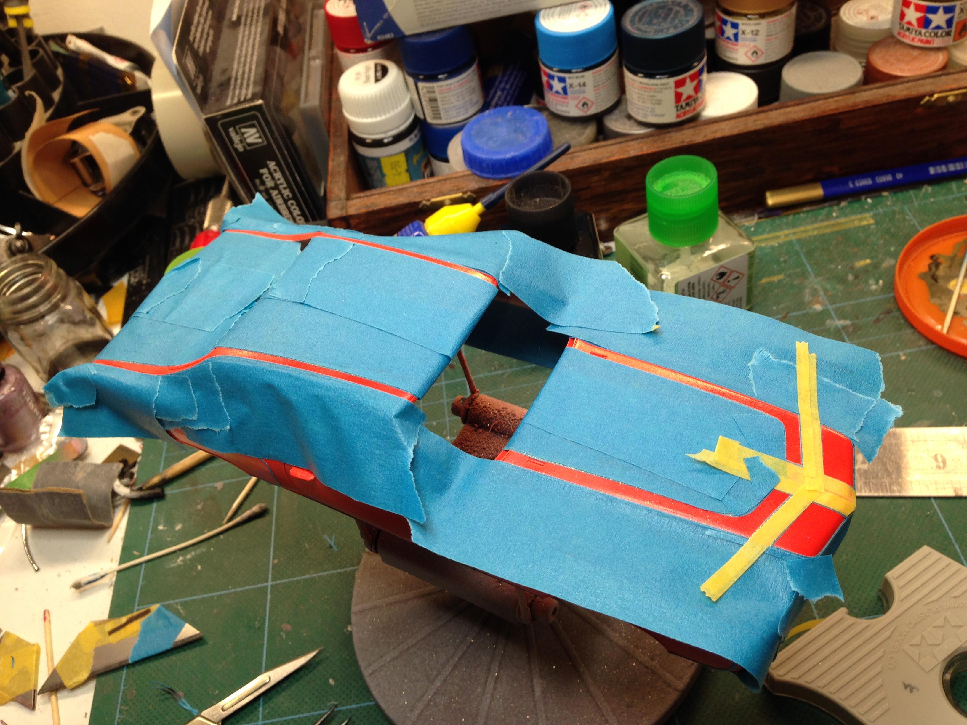

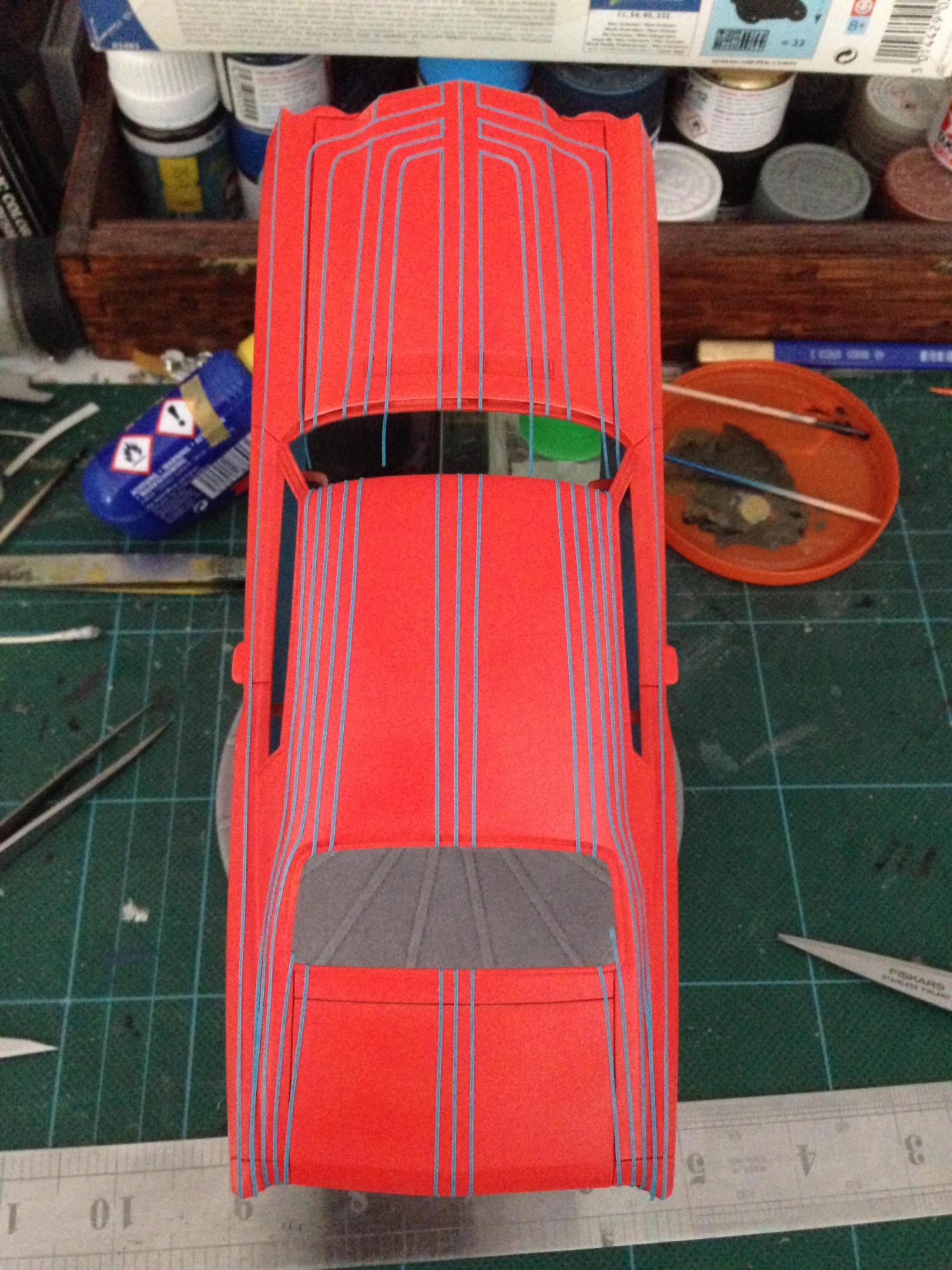

geetee66 Posted March 16, 2020 Posted March 16, 2020 All I planned was that it will be mainly orange. nice body on this kit. Mold lines were well positioned and feint. here's the tape so far

espo Posted March 16, 2020 Posted March 16, 2020 I'm looking forward to seeing this paint work. I know you have your design down, and I don't want you to take my comment as criticism as I'm just interested as to your design. I'm looking at your masking of the rear portion of the body and the trunk/boot in particular. To my eye it looks like the pattern widens toward the rear with the lines on the top of the trunk and rear fenders sort of converging at the outer edges of the fenders. Is this part of your design ?
geetee66 Posted March 16, 2020 Author Posted March 16, 2020 2 hours ago, espo said: I'm looking forward to seeing this paint work. I know you have your design down, and I don't want you to take my comment as criticism as I'm just interested as to your design. I'm looking at your masking of the rear portion of the body and the trunk/boot in particular. To my eye it looks like the pattern widens toward the rear with the lines on the top of the trunk and rear fenders sort of converging at the outer edges of the fenders. Is this part of your design ? Thanks for taking the time to consider this, Espo. No offence taken, buddy. Yes, it's kinda deliberate. I basically use body lines to help orientate the pattern. The widening of the lines is an extension of the diverging lines on the hood. Once the lines are painted and look separate, I'm confident the pattern will make more sense. At the end of the day, it's all freestyle and a bit of a gamble, but I enjoy surprises!
espo Posted March 16, 2020 Posted March 16, 2020 1 hour ago, geetee66 said: Thanks for taking the time to consider this, Espo. No offence taken, buddy. Yes, it's kinda deliberate. I basically use body lines to help orientate the pattern. The widening of the lines is an extension of the diverging lines on the hood. Once the lines are painted and look separate, I'm confident the pattern will make more sense. At the end of the day, it's all freestyle and a bit of a gamble, but I enjoy surprises! Thank you for the insight in what your doing with your design. As a former Monte Carlo owner I'll be even more interested in your paint work.

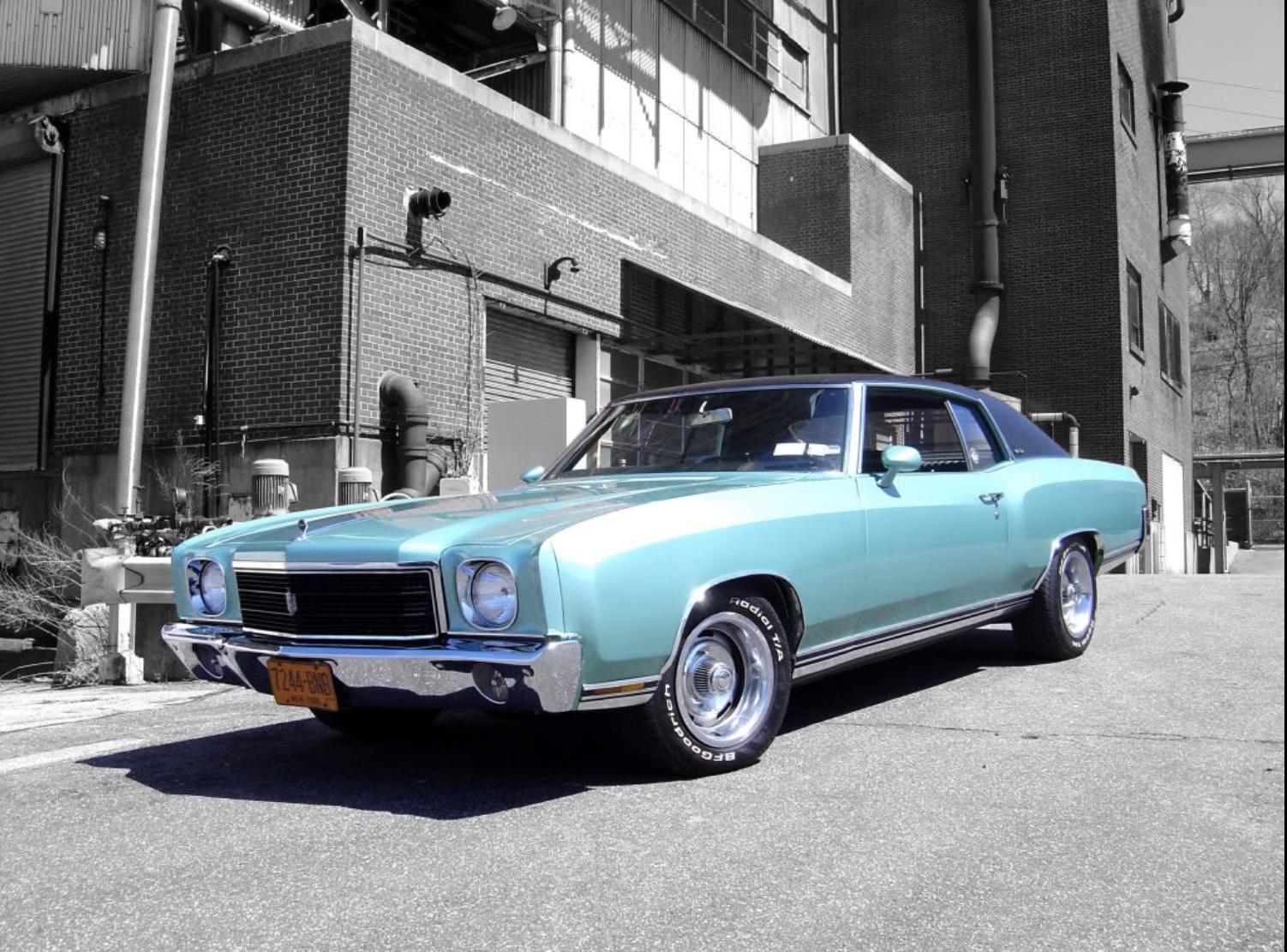

Superbird McMonte Posted March 16, 2020 Posted March 16, 2020 29 minutes ago, espo said: Thank you for the insight in what your doing with your design. As a former Monte Carlo owner I'll be even more interested in your paint work. same here! And I’m a current Monte owner!

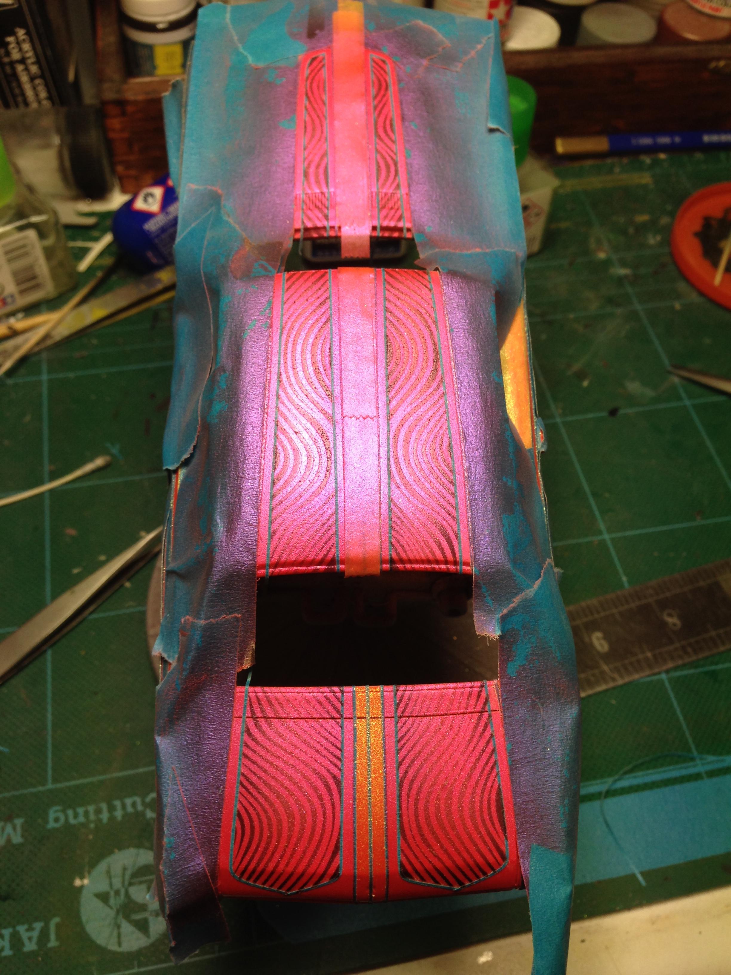

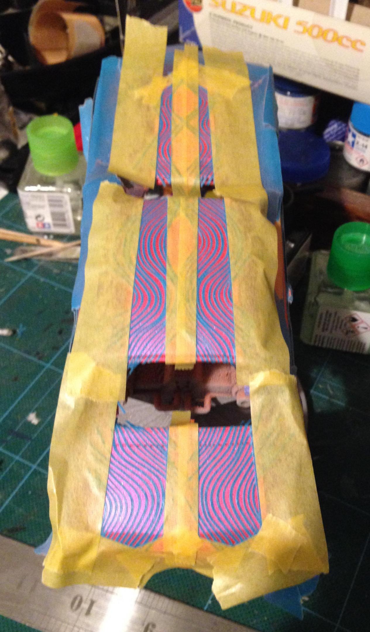

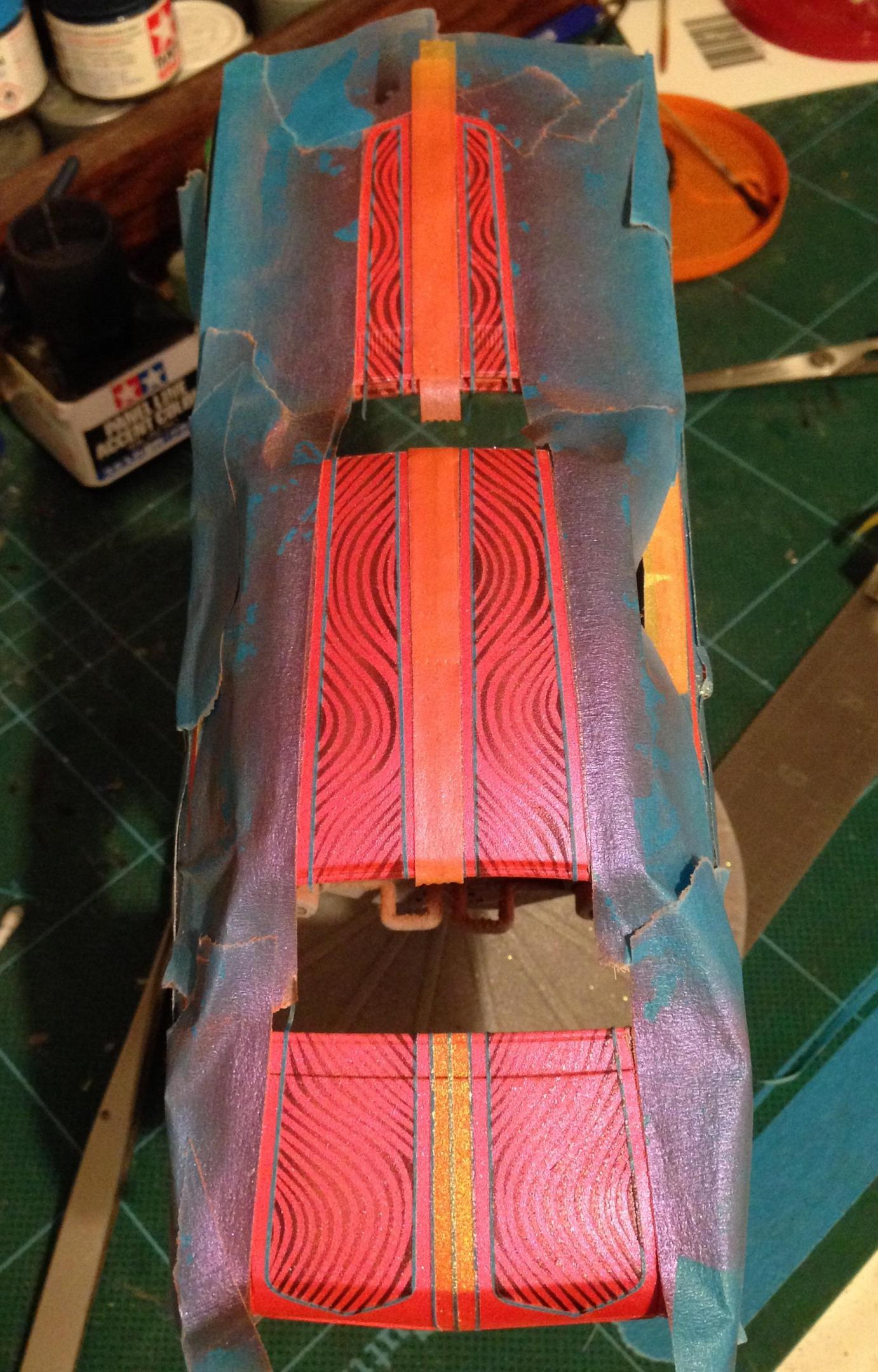

geetee66 Posted March 17, 2020 Author Posted March 17, 2020 On 3/16/2020 at 9:14 PM, Superbird McMonte said: same here! And I’m a current Monte owner! Sweet ride, man! I doubt I could get that parked at my house, without hanging over the pavement/sidewalk.. Nice body lines on these Montes. I love the long hood. anyway, got some more tape down last night. Thought about it all day at work. Decided it was no good. Came home, took it off and started again. I really like fingerprint patterns on lowriders, but they're a bit fiddly and so it took all evening and I forgot to eat. gave it a subtle fade around the edges. More colours to come. I haven't started the sides yet.

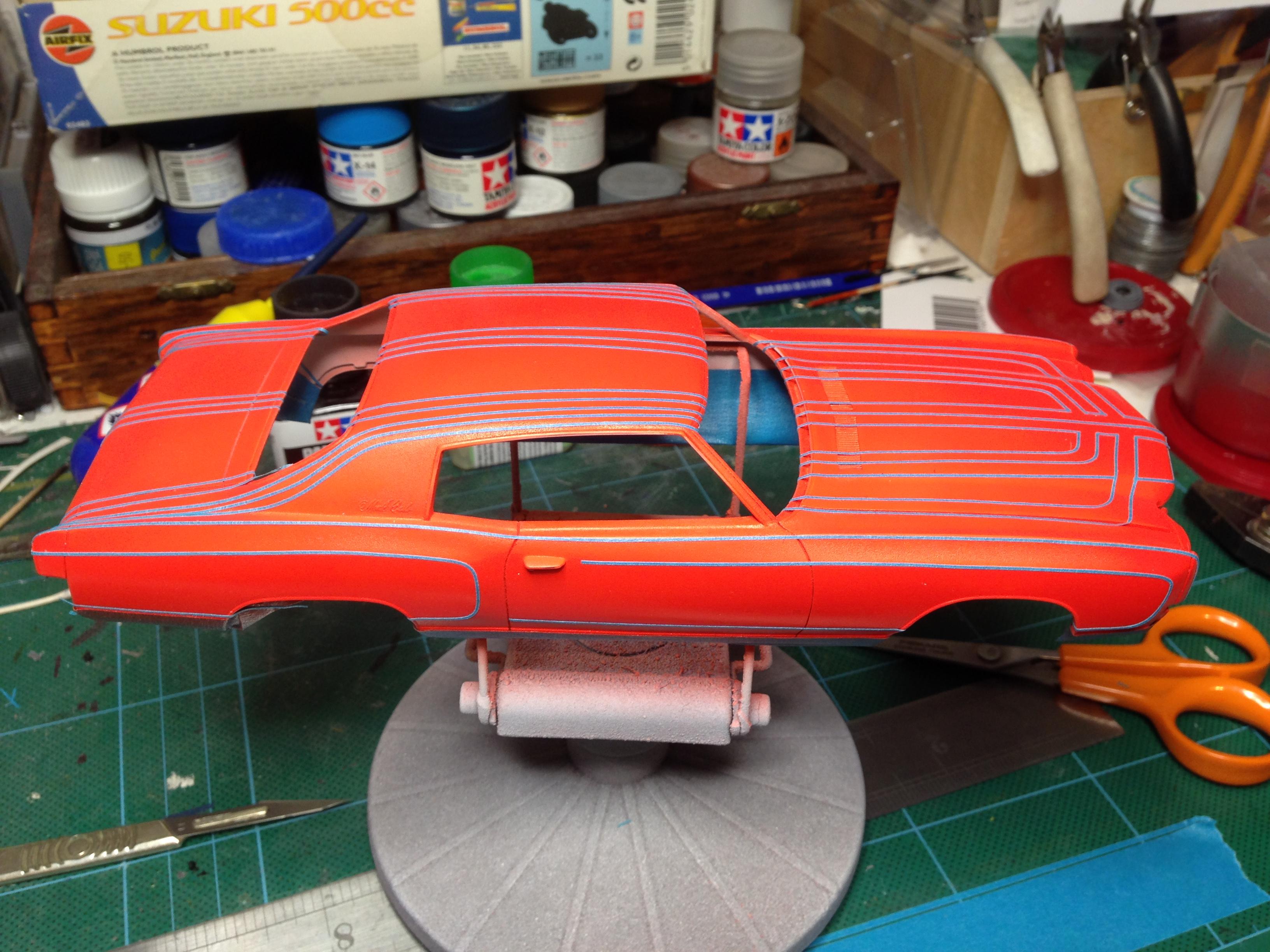

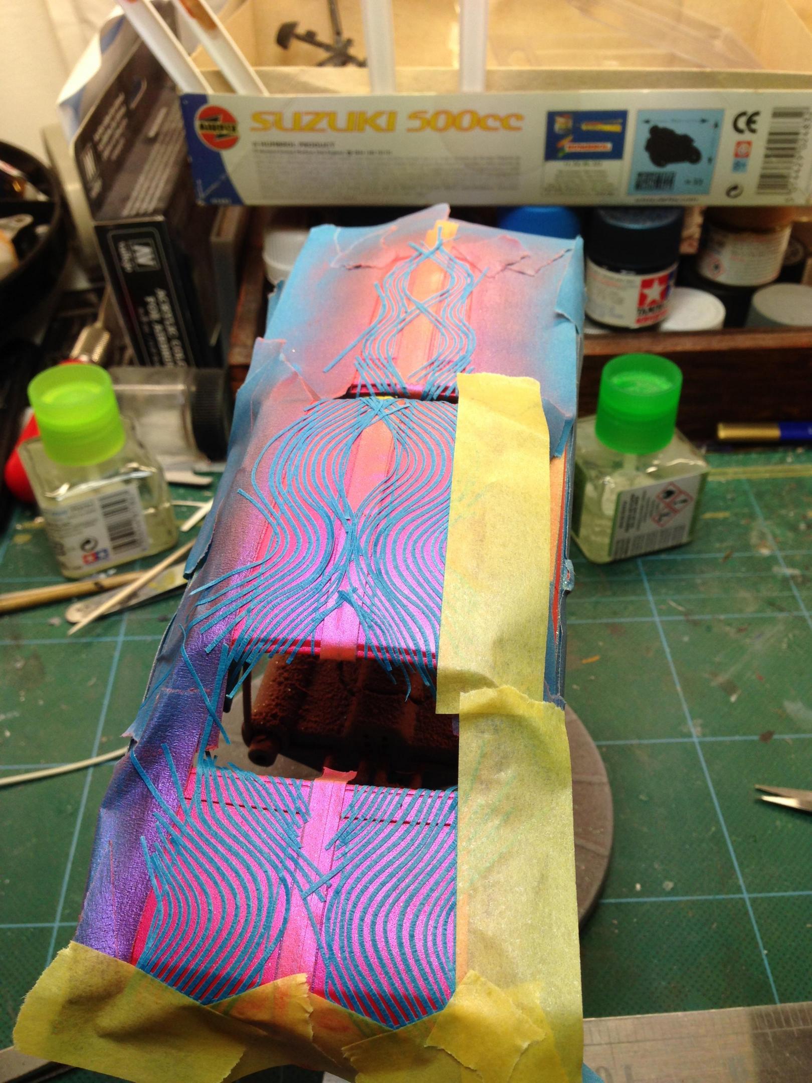

geetee66 Posted March 21, 2020 Author Posted March 21, 2020 Thanks Espo I'll definitely use that technique. been doing a bit more painting today. The sides are about to get done, too.
johnny rocket Posted March 21, 2020 Posted March 21, 2020 I am just wondering are you cutting the curves out of the blue tape or was it a straight line and you created the curves
geetee66 Posted March 22, 2020 Author Posted March 22, 2020 2 hours ago, johnny rocket said: I am just wondering are you cutting the curves out of the blue tape or was it a straight line and you created the curves I cut the tape into 1mm strips and curve it as I lay it down. I've got a bit quicker at it, now. If a line goes astray, just lift it and reapply. I like to paint as soon as the tape's done. If I leave it too long, some tighter curves want to lift.

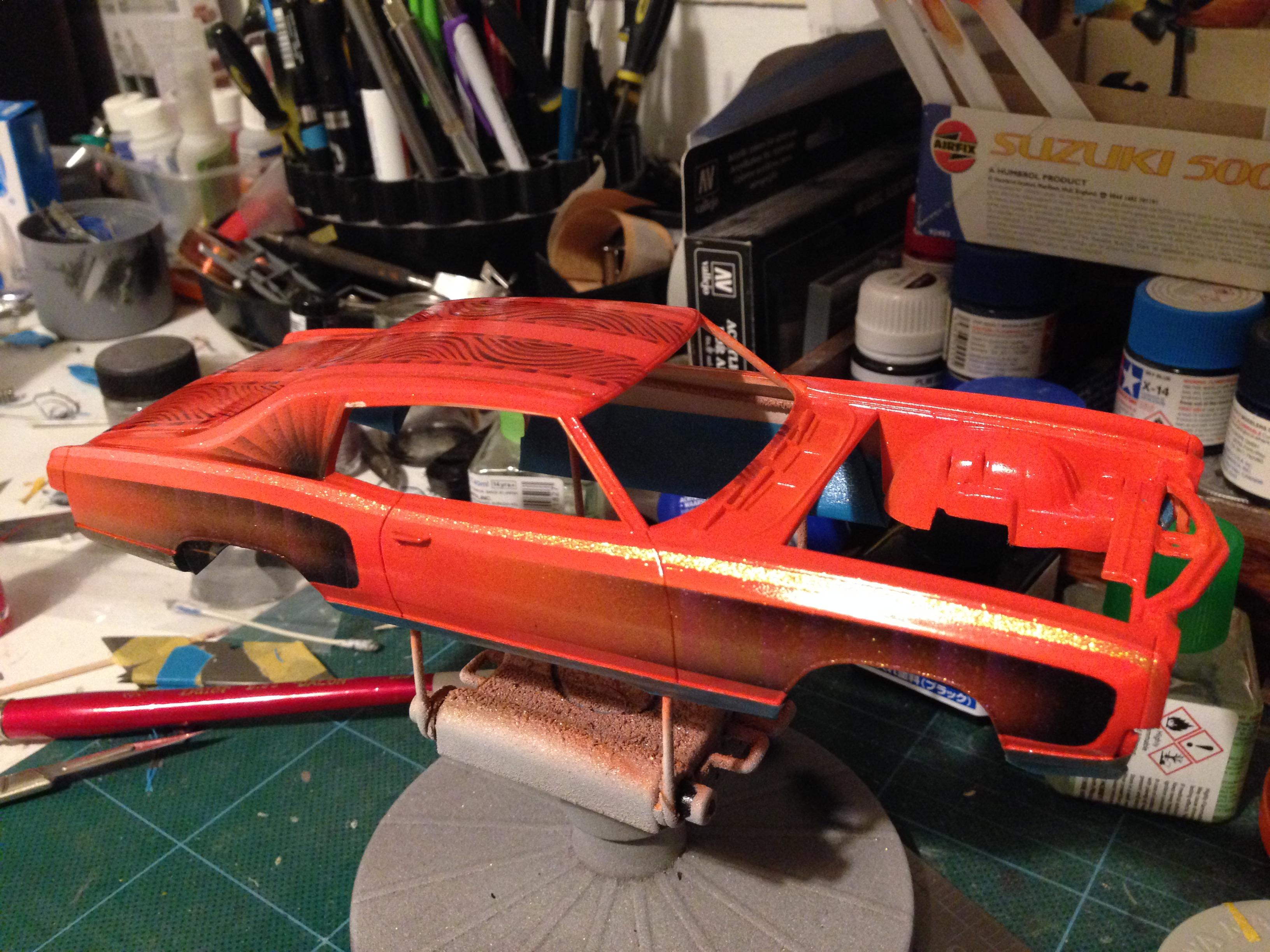

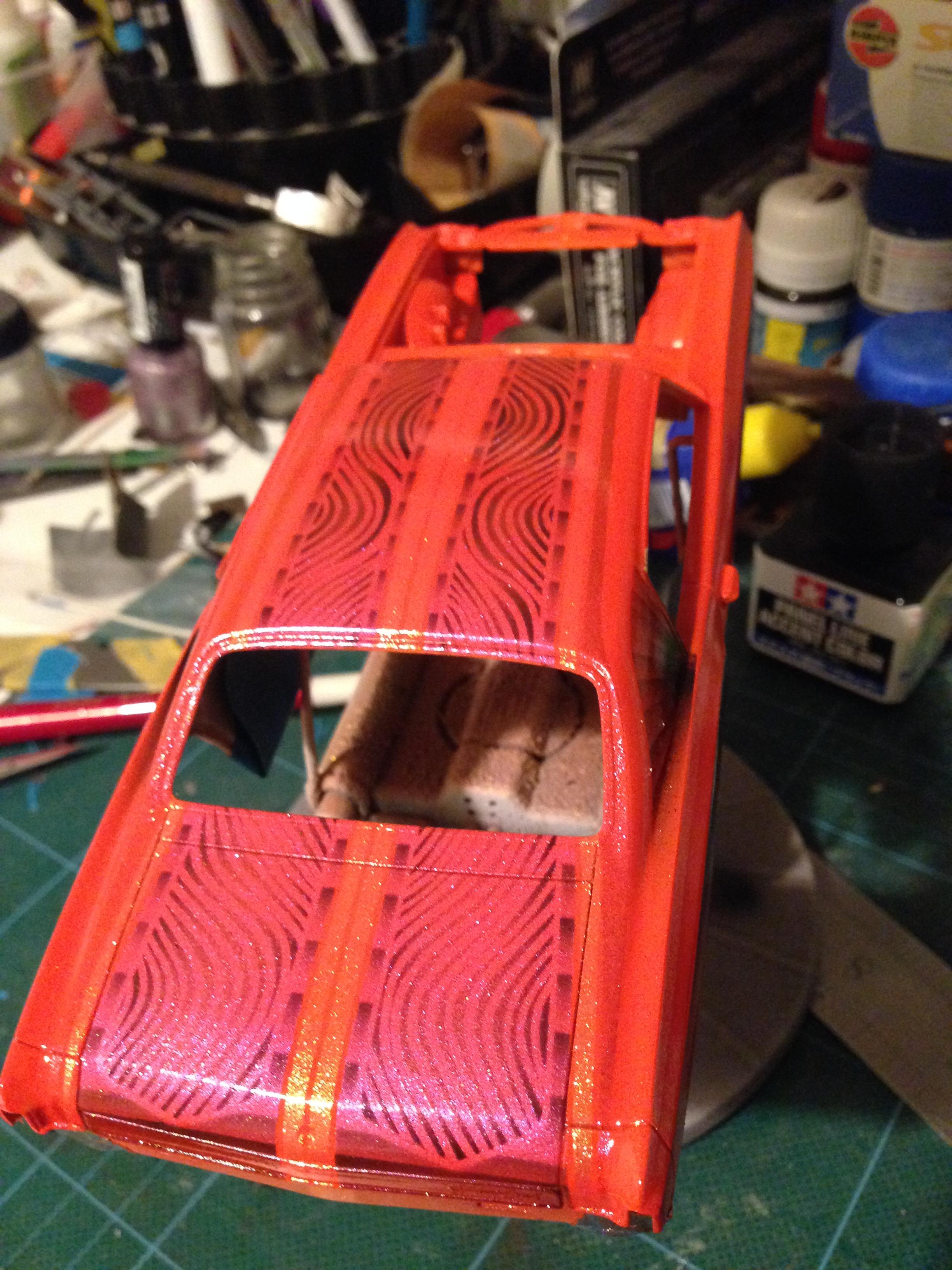

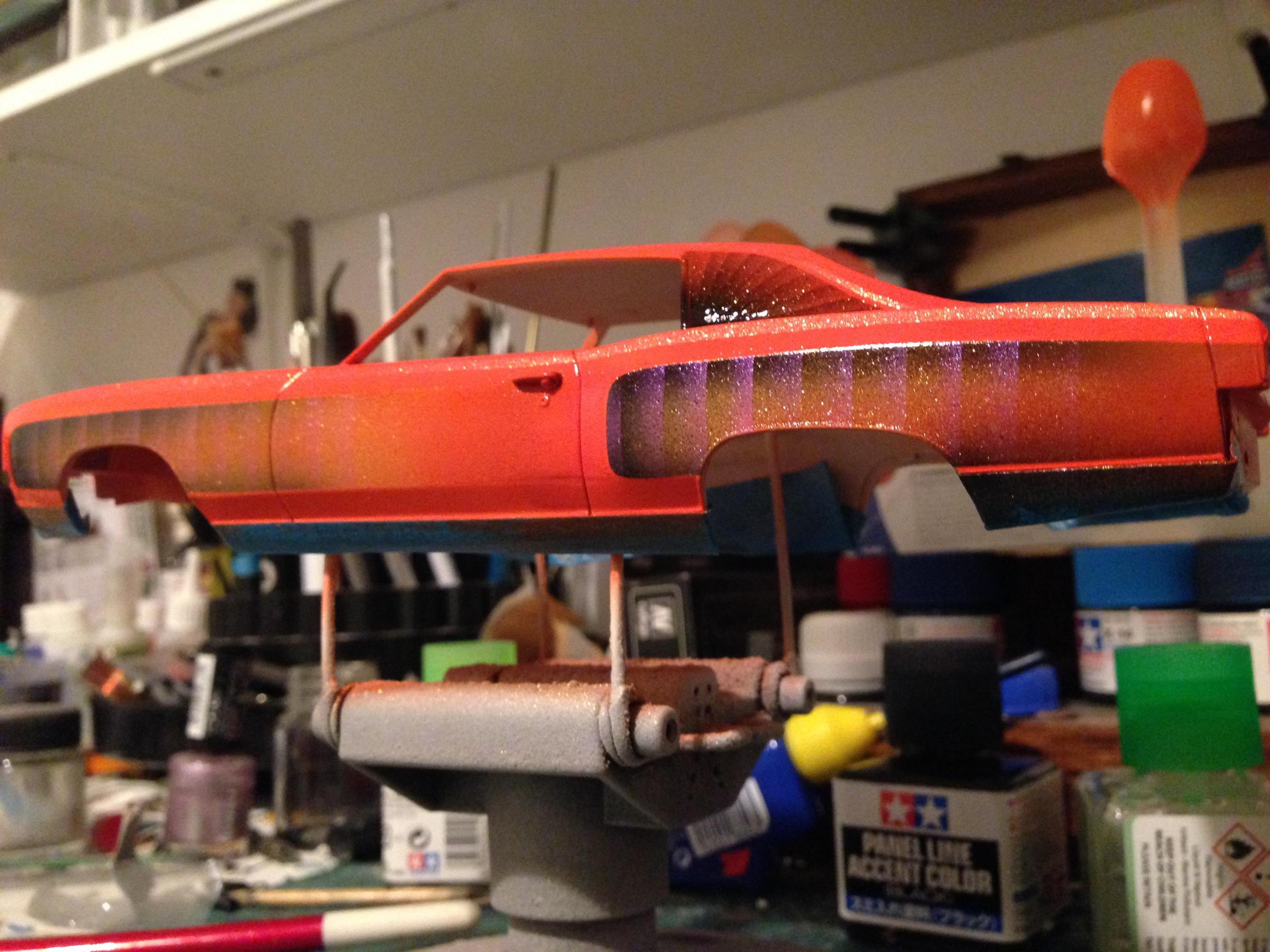

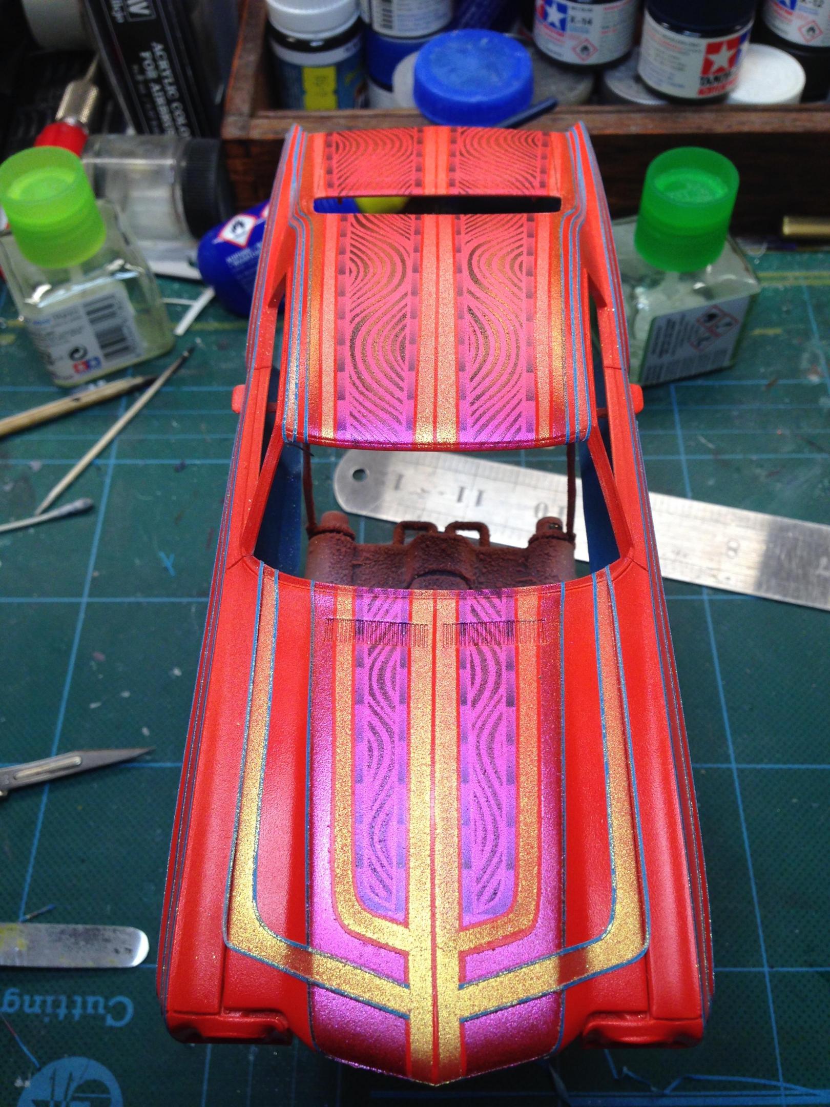

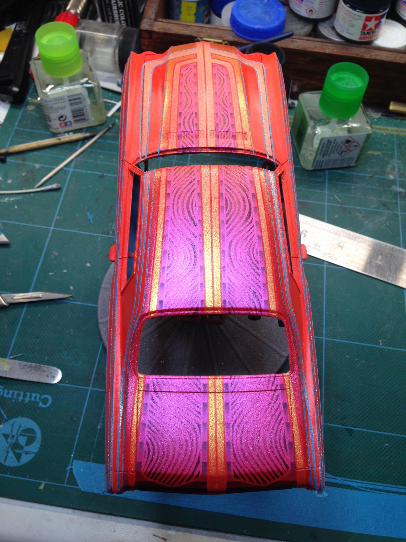

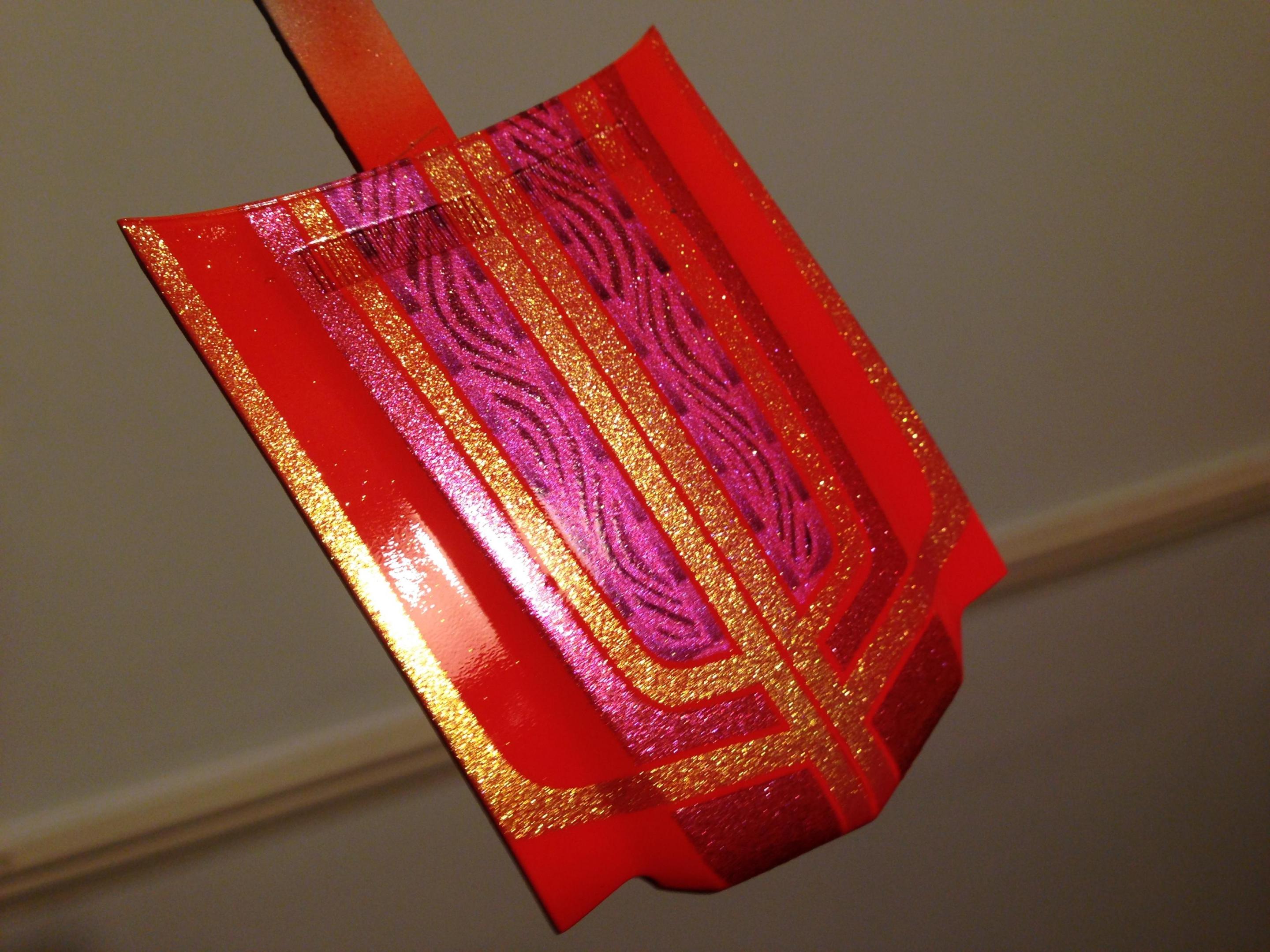

geetee66 Posted March 22, 2020 Author Posted March 22, 2020 Finished the paint today. Gave it a couple of clearcoat and the colours really pop, especially the flake. It'll need a wet sanding but it's not too bad.
espo Posted March 22, 2020 Posted March 22, 2020 The gold color on the hood and sides in curtain light look almost like Gold Leaf. Great paint work.
Modlbldr Posted March 22, 2020 Posted March 22, 2020 (edited) That is amazing!! I love the fact that the base is red and not the more common silver. You are getting very good at this style of paintjob Geoff. Later- Edited March 22, 2020 by Modlbldr

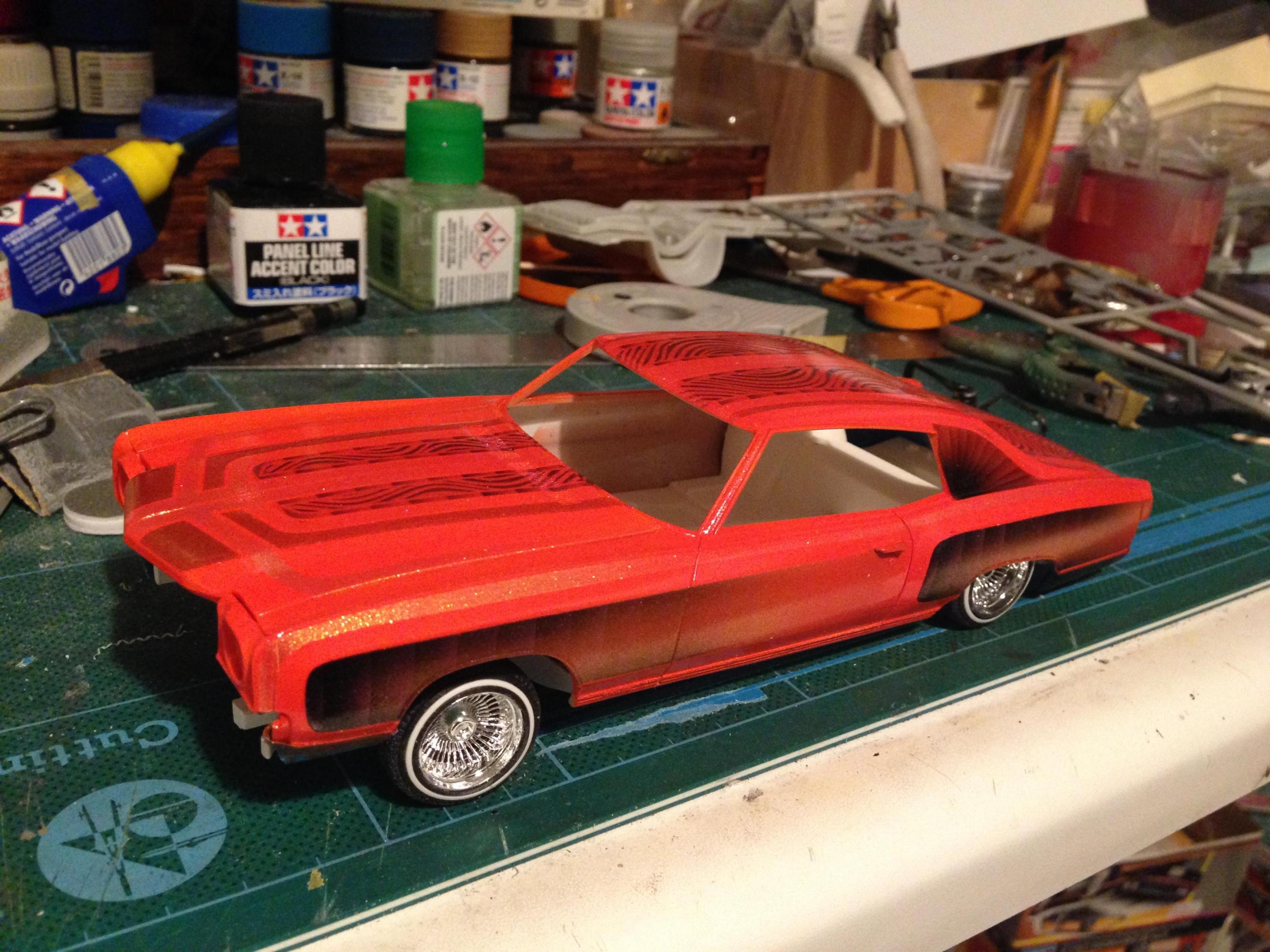

geetee66 Posted March 29, 2020 Author Posted March 29, 2020 Got the ride height sorted today. I had to cut away a little bit of chassis and grind out the transmission tunnel, and shorten the shock absorbers. But it was an easy job. Drilled out the Pegasus wheels to fit onto the kit axles. Easy. got the tail-dragging look I was after.
Belugawrx Posted March 29, 2020 Posted March 29, 2020 Another stunning paint job Guy..this is going to be amazing in the sun?
Modlbldr Posted March 29, 2020 Posted March 29, 2020 Sorry Guy. Been calling you Geoff. Still a great looking build. Nice stance you've got. Later-
geetee66 Posted March 29, 2020 Author Posted March 29, 2020 5 hours ago, Modlbldr said: Sorry Guy. Been calling you Geoff. Still a great looking build. Nice stance you've got. Later- ? don't worry. No offence taken buddy! glad you all dig the paint! suspension and some engine parts are now gloss black, awaiting some Molotow chrome. Chassis now orange. Interior and engine, today. And some more clear on the body.
geetee66 Posted March 29, 2020 Author Posted March 29, 2020 7 hours ago, Belugawrx said: Another stunning paint job Guy..this is going to be amazing in the sun? Ah, the sun. I remember seeing that. Bright thing. Lives in the sky. yeah, these colours go wild under good light. The camera never seems to pick up the subtleties that the naked eye can see.
