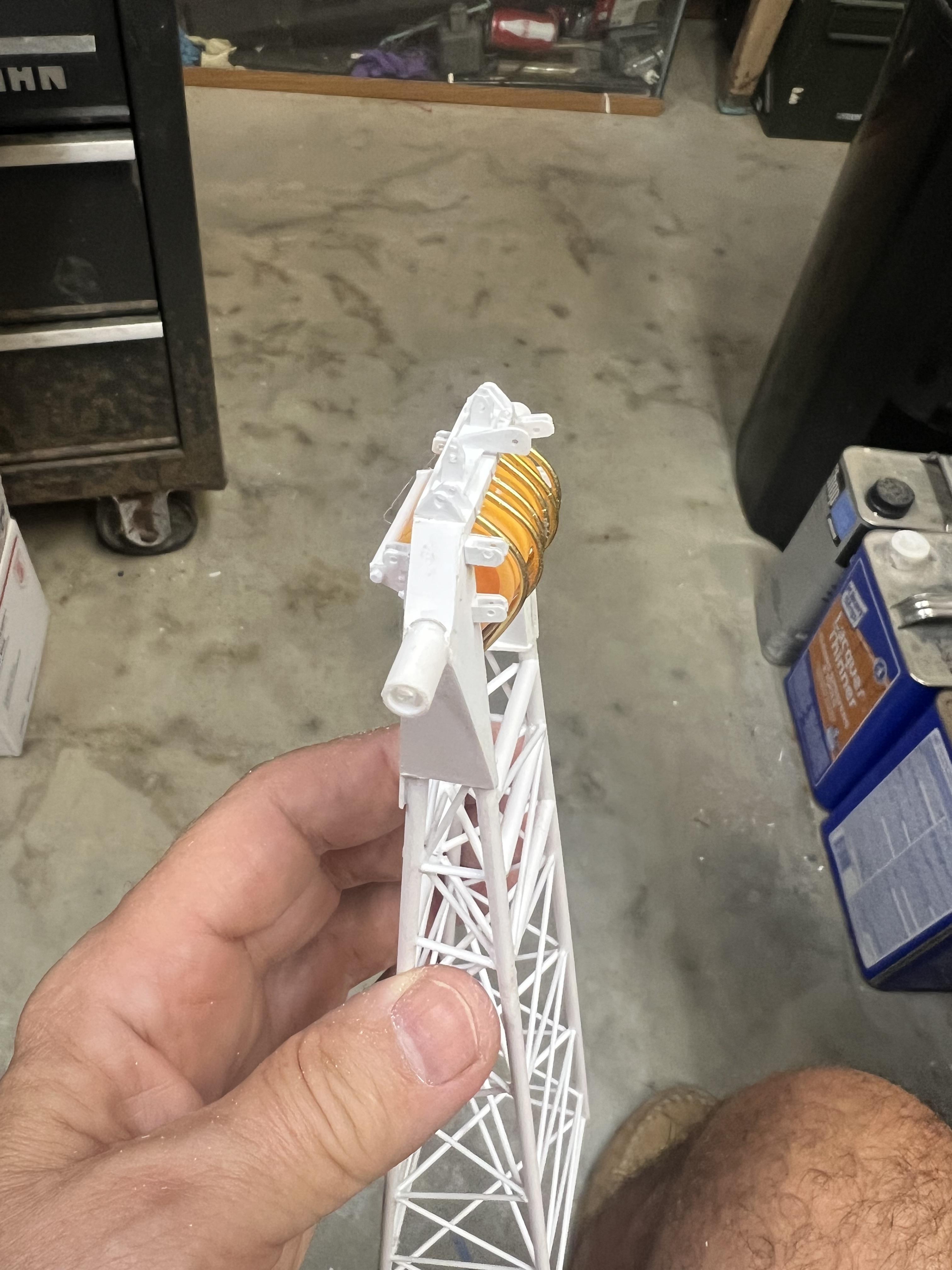

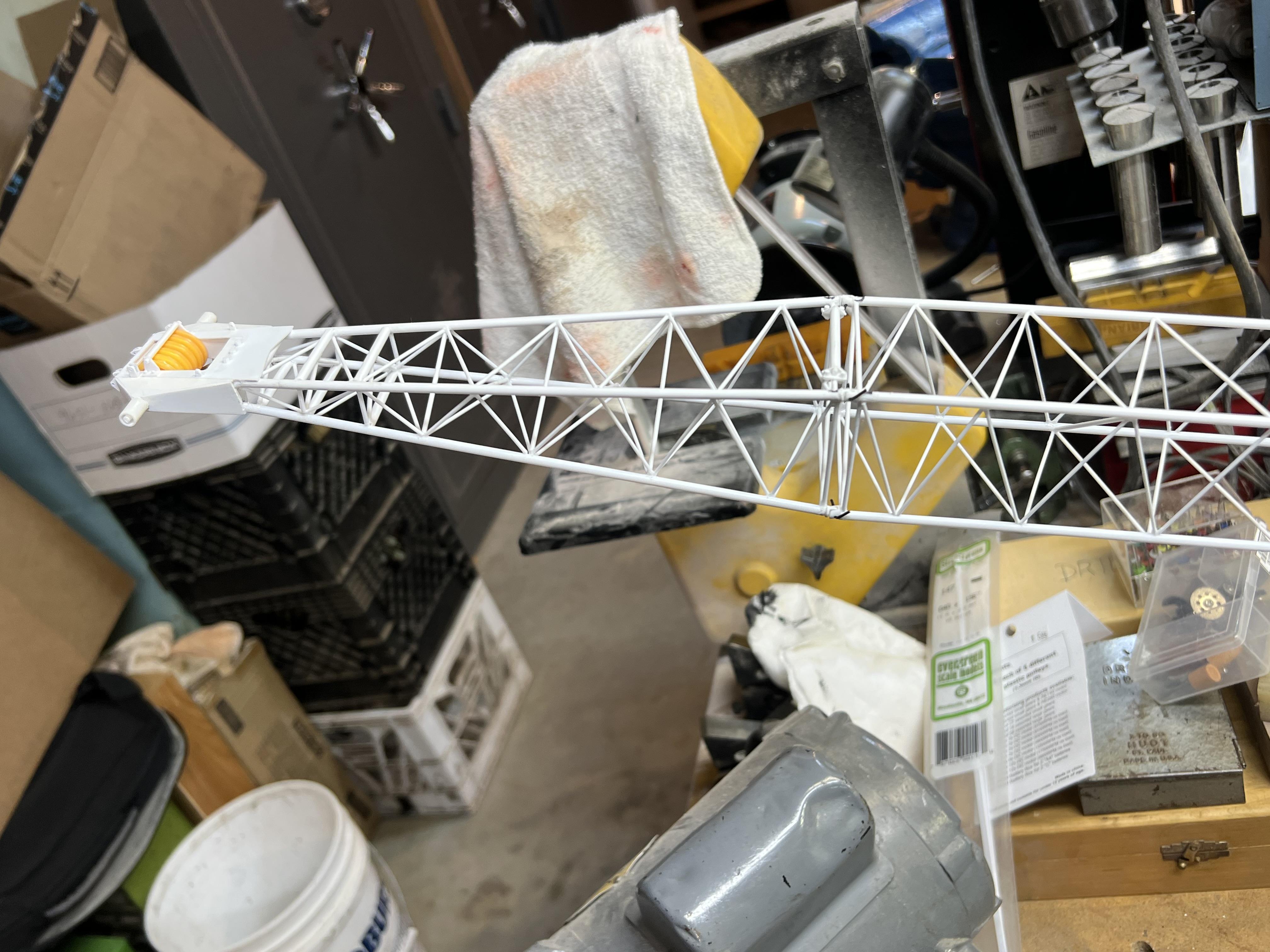

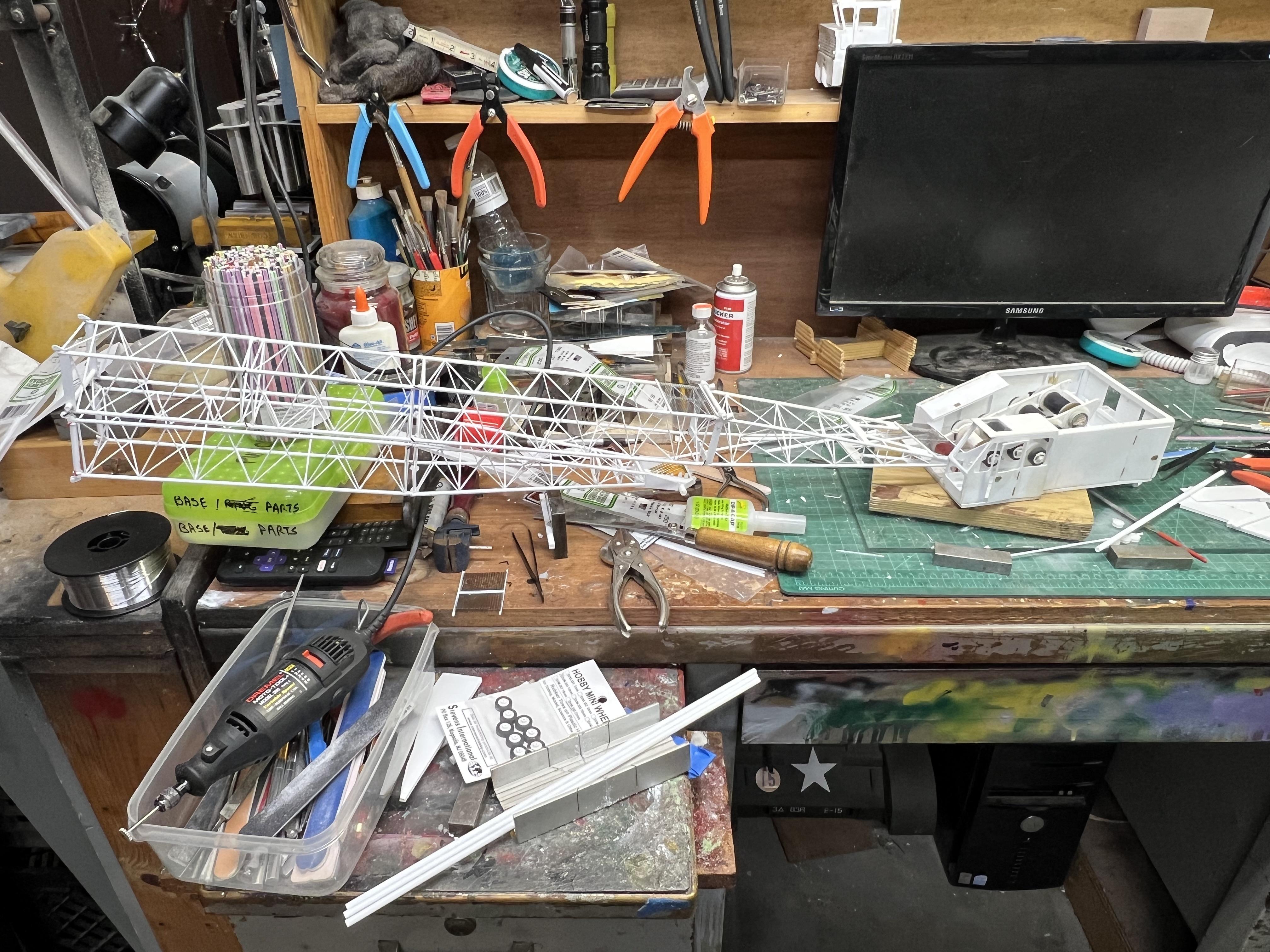

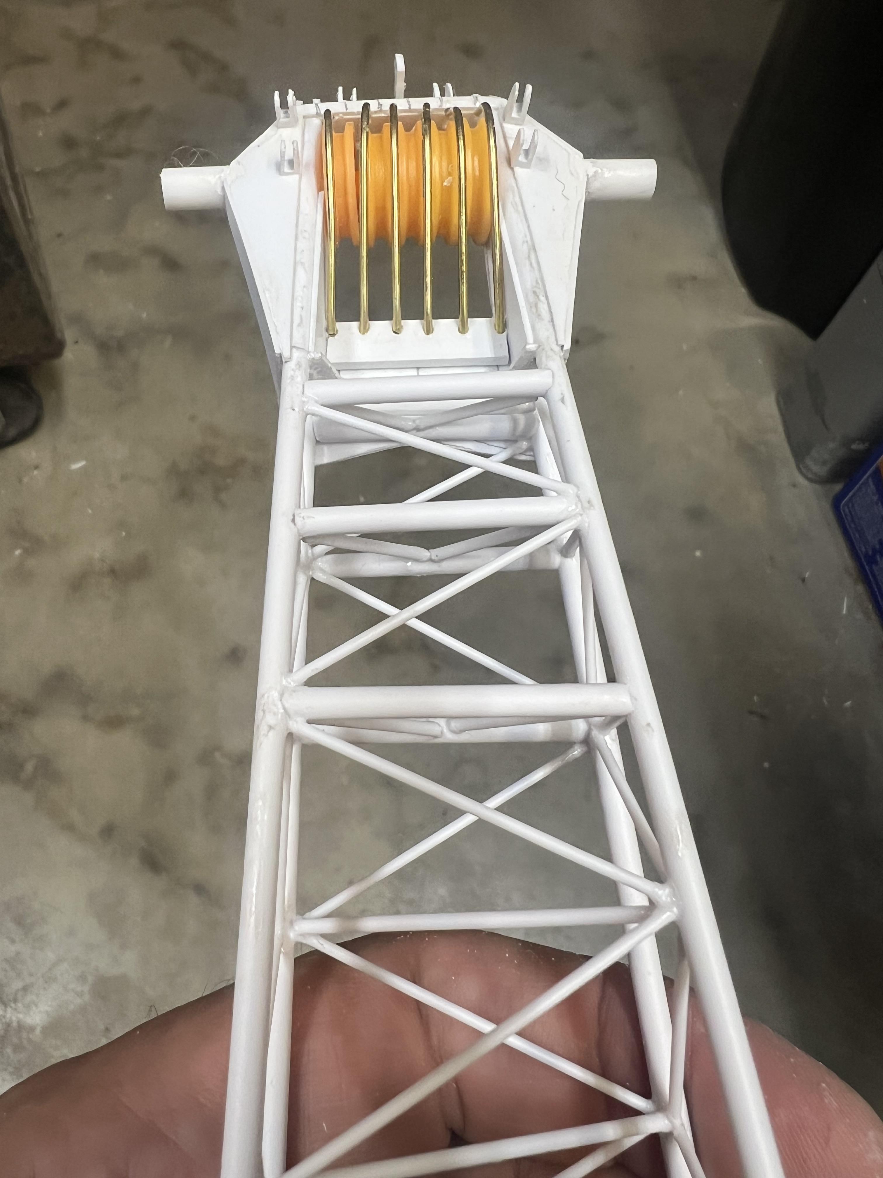

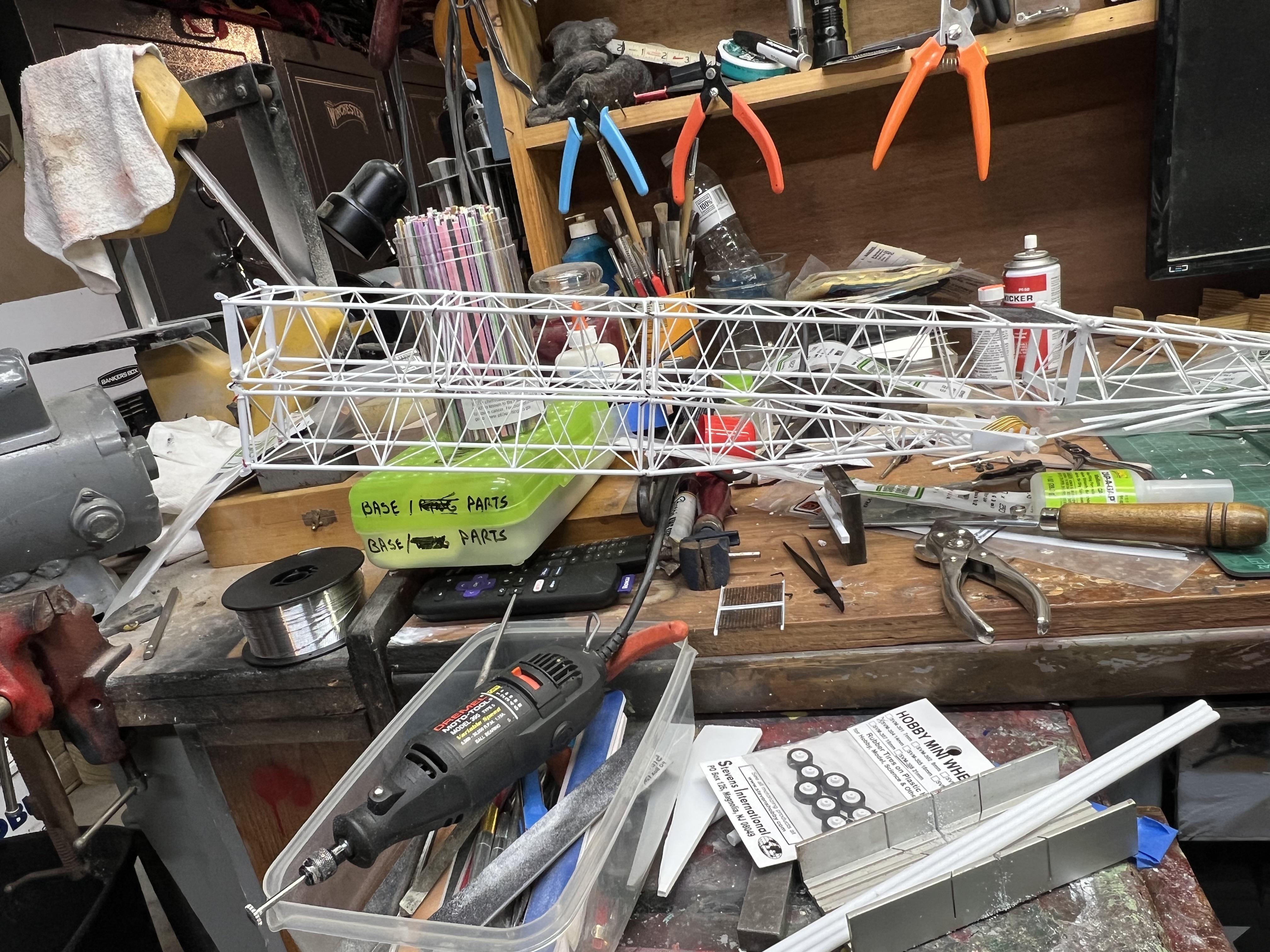

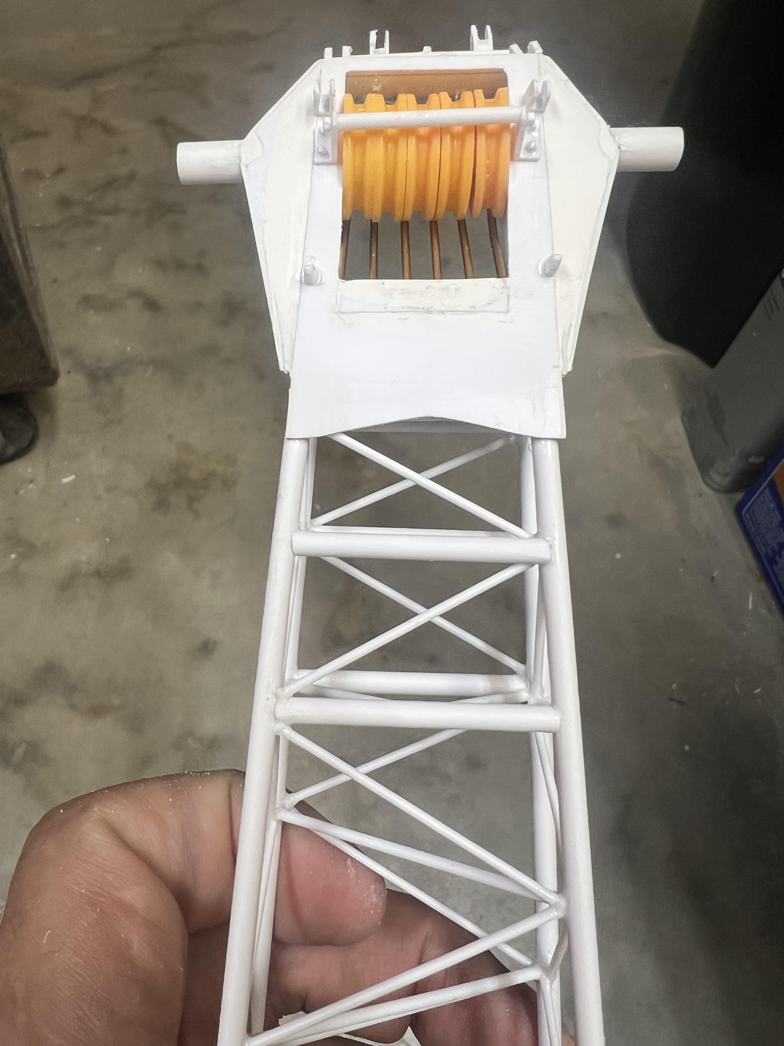

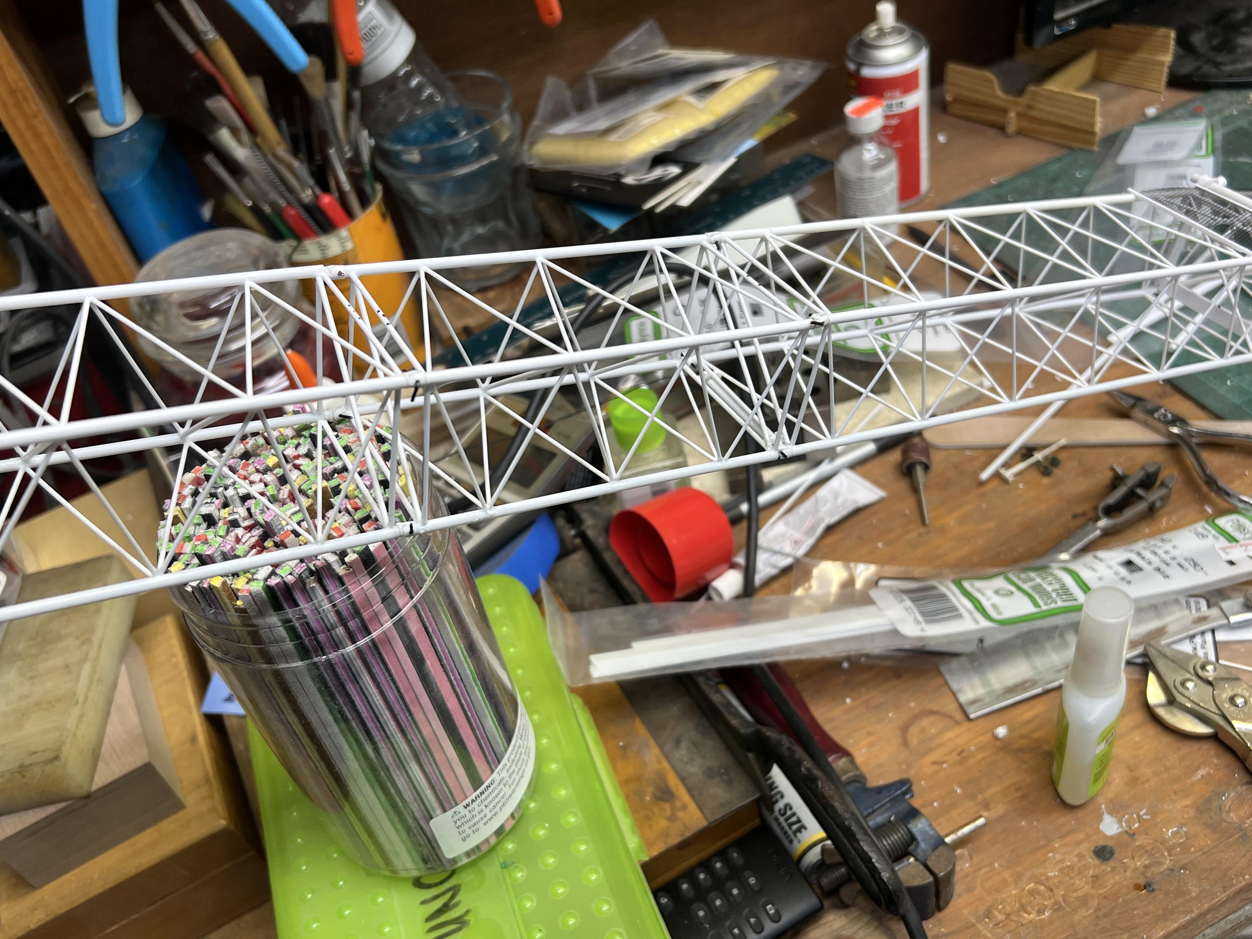

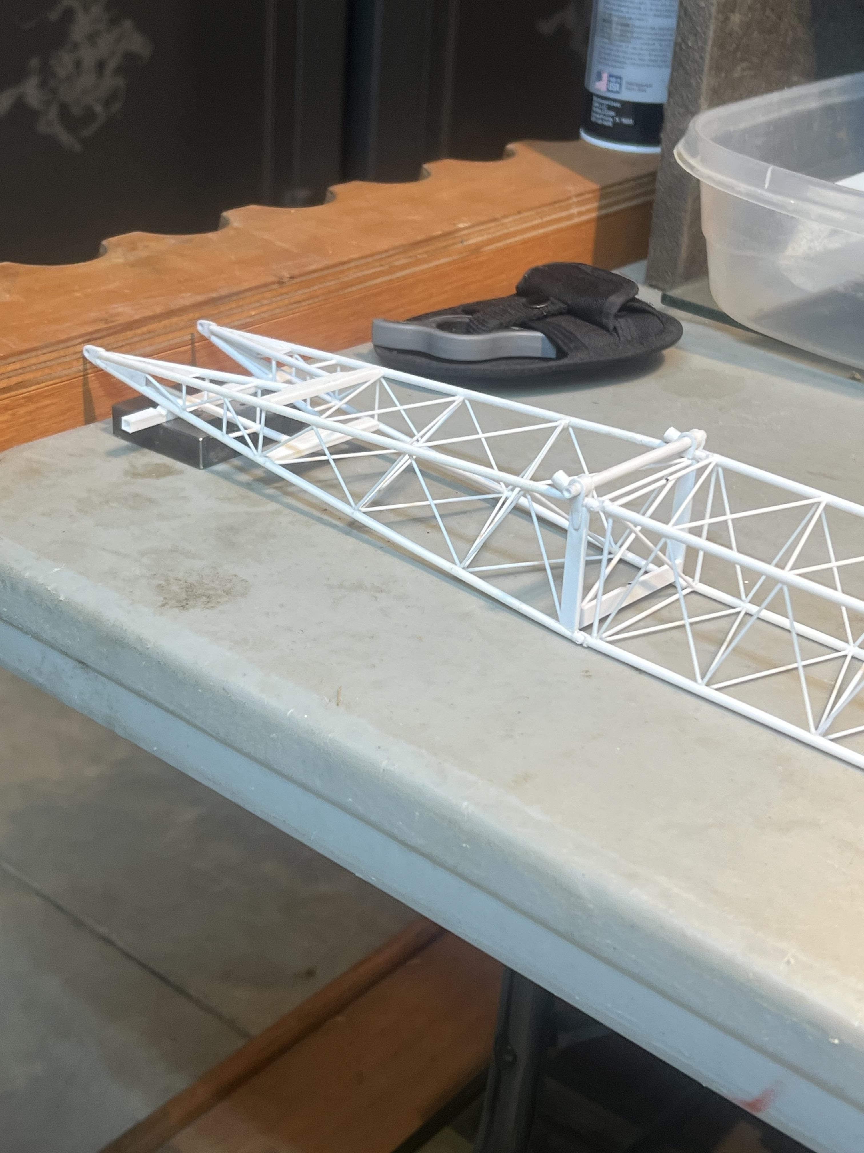

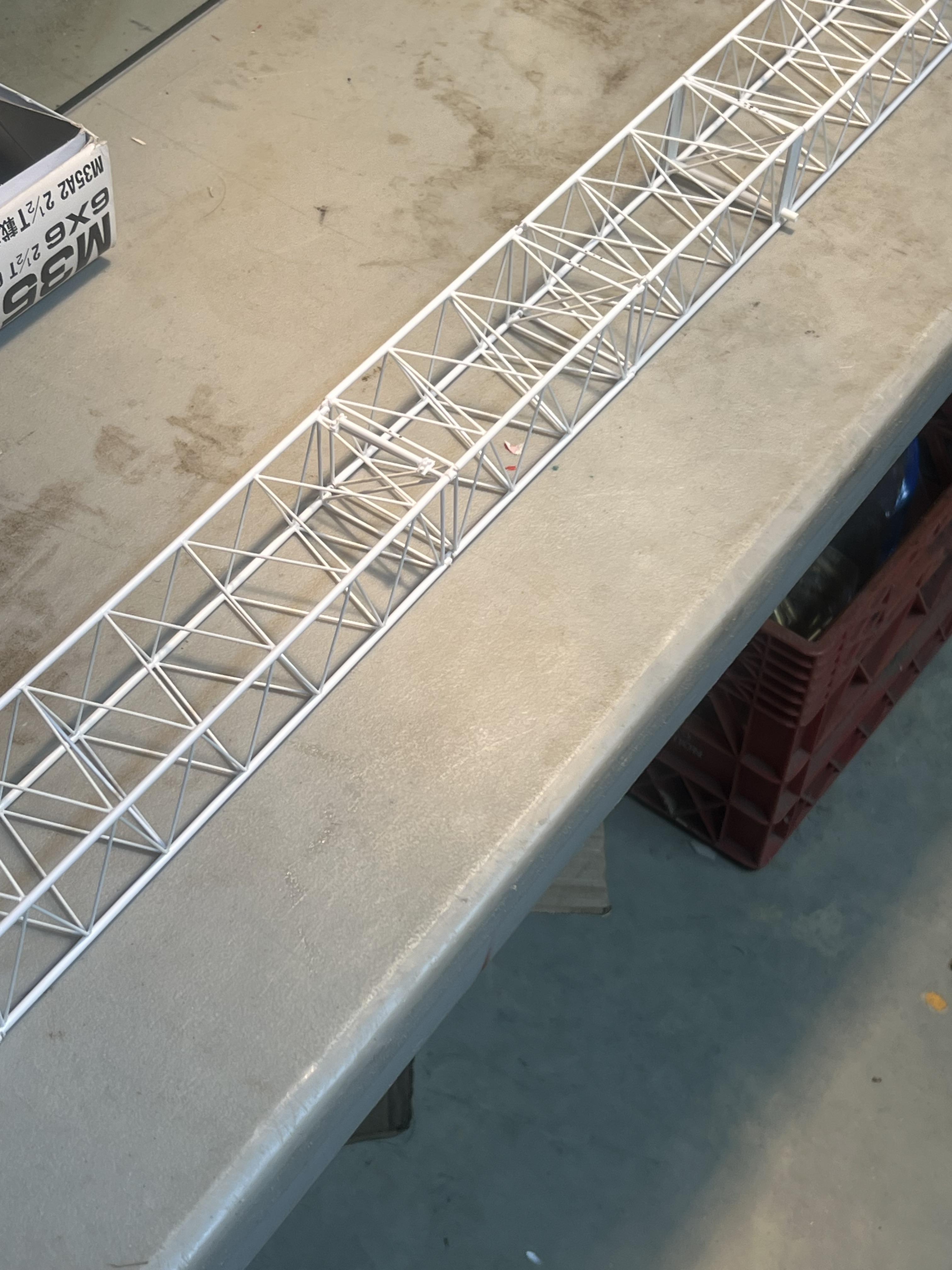

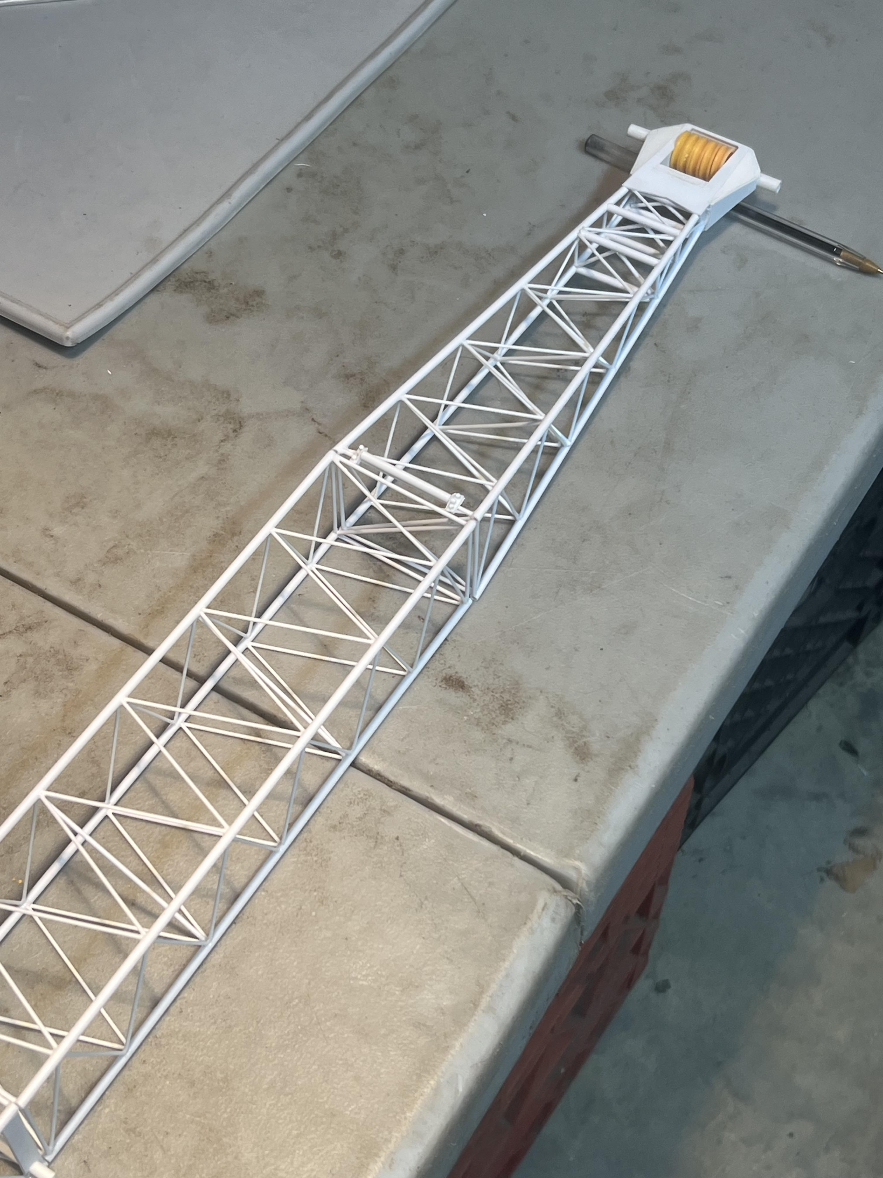

Here is the complete boom, not yet pinned together but to give an idea of size. Finished all the lattice work on the boom head.  Still many many more bits and pieces to add to just the boom sections, but it is definitely looking the part! Going to add the jib mounts and the boom folding tires next. Lost a day yesterday, went out into the woods bright and early to prepare for upcoming deer season. Walked smack dab into a tree branch and badly scratched my left eye, my good one of course. Thought I was gonna have to pick the eyeball up off the ground! Got to the eye doctor and spent from 10 AM yesterday until 8 this morning with both eyes shut and lying on my back. But, still better than working! Much better now!
Edited by redneckrigger

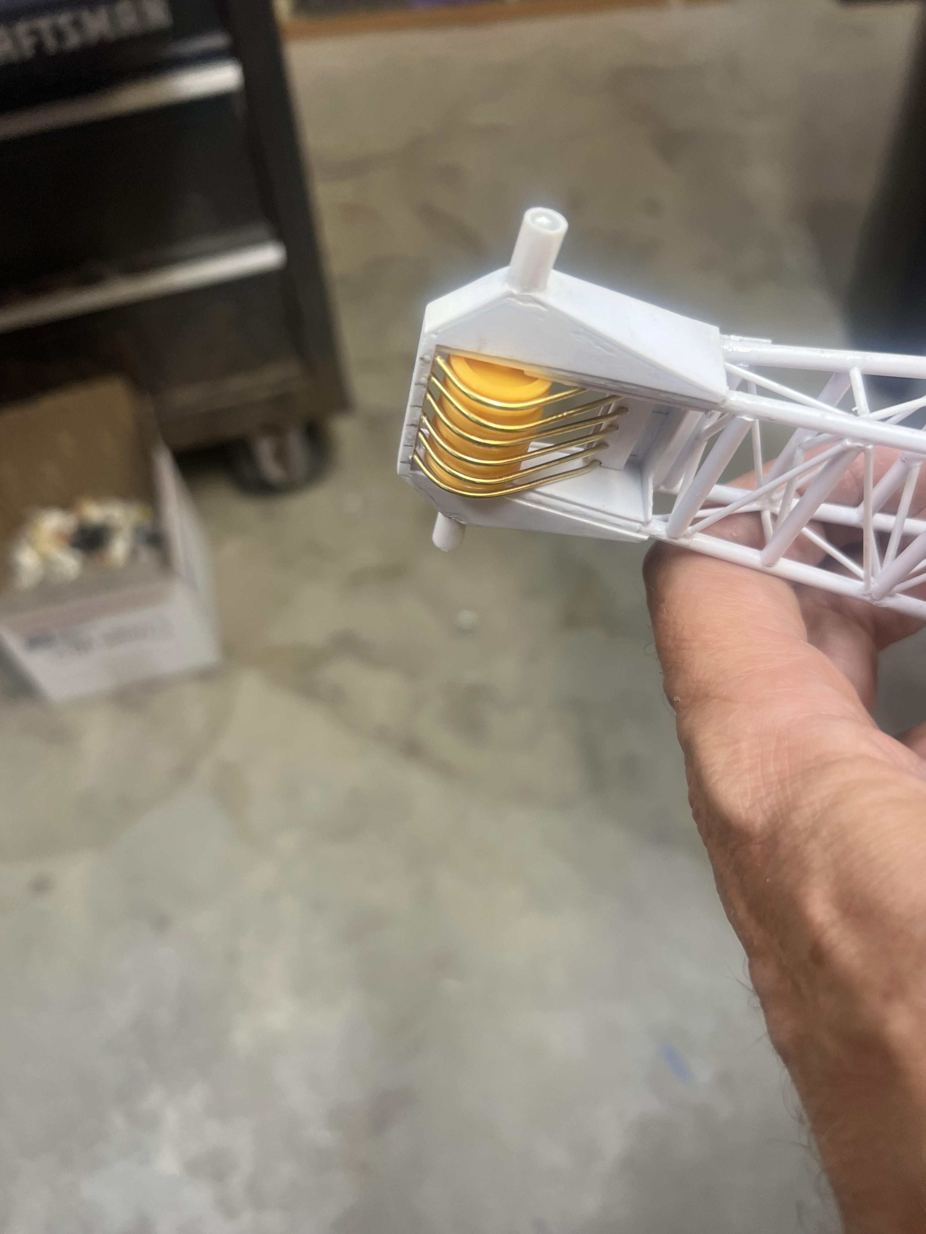

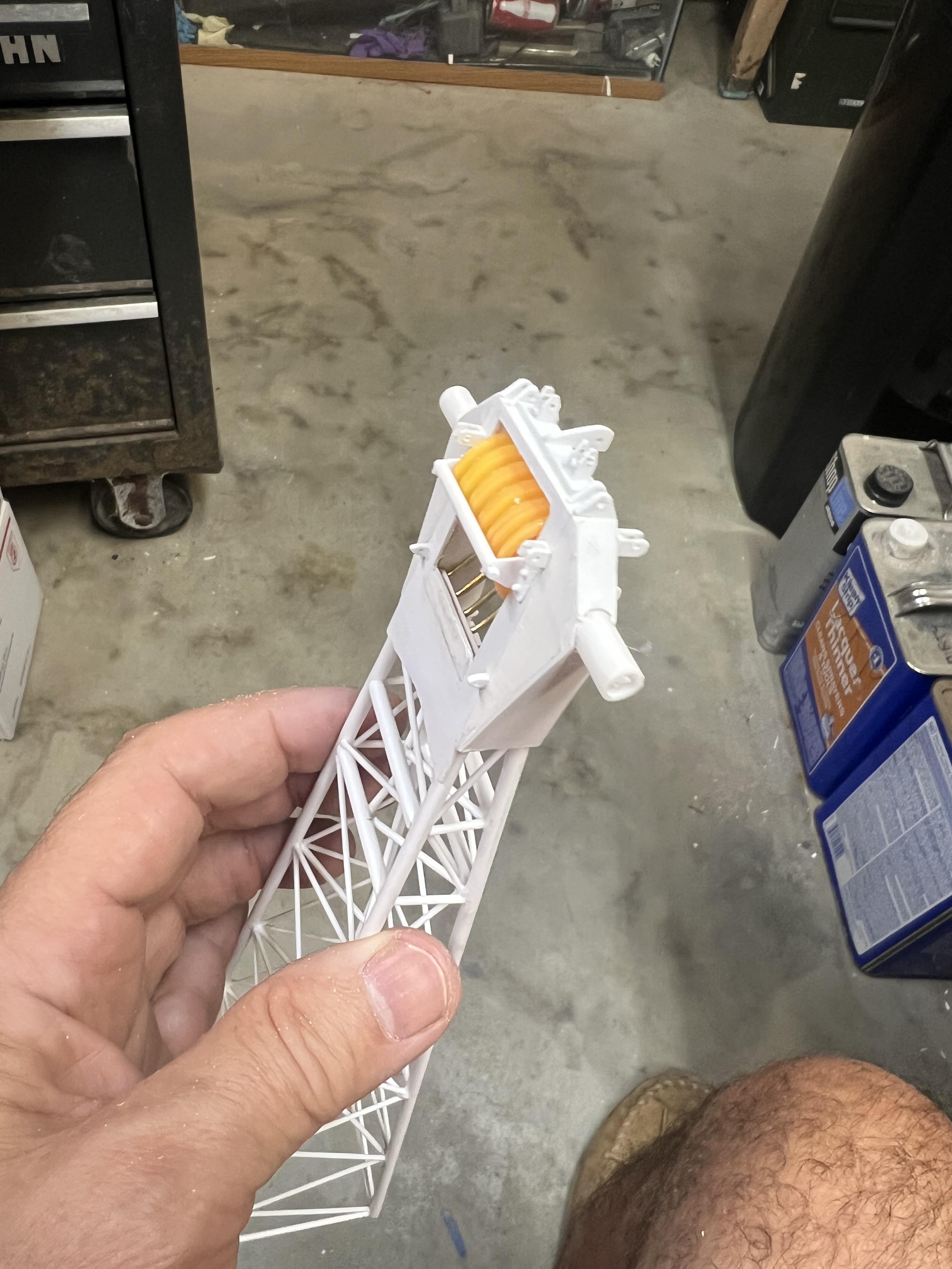

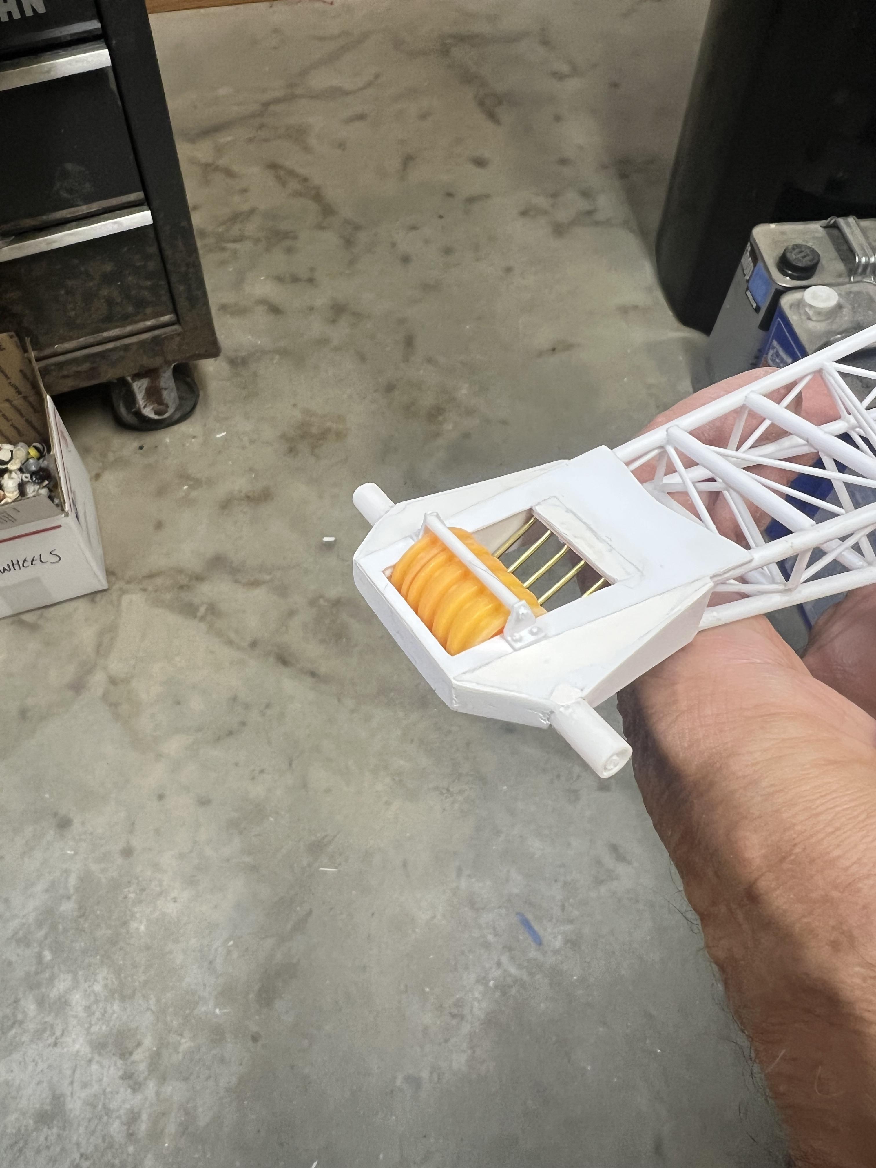

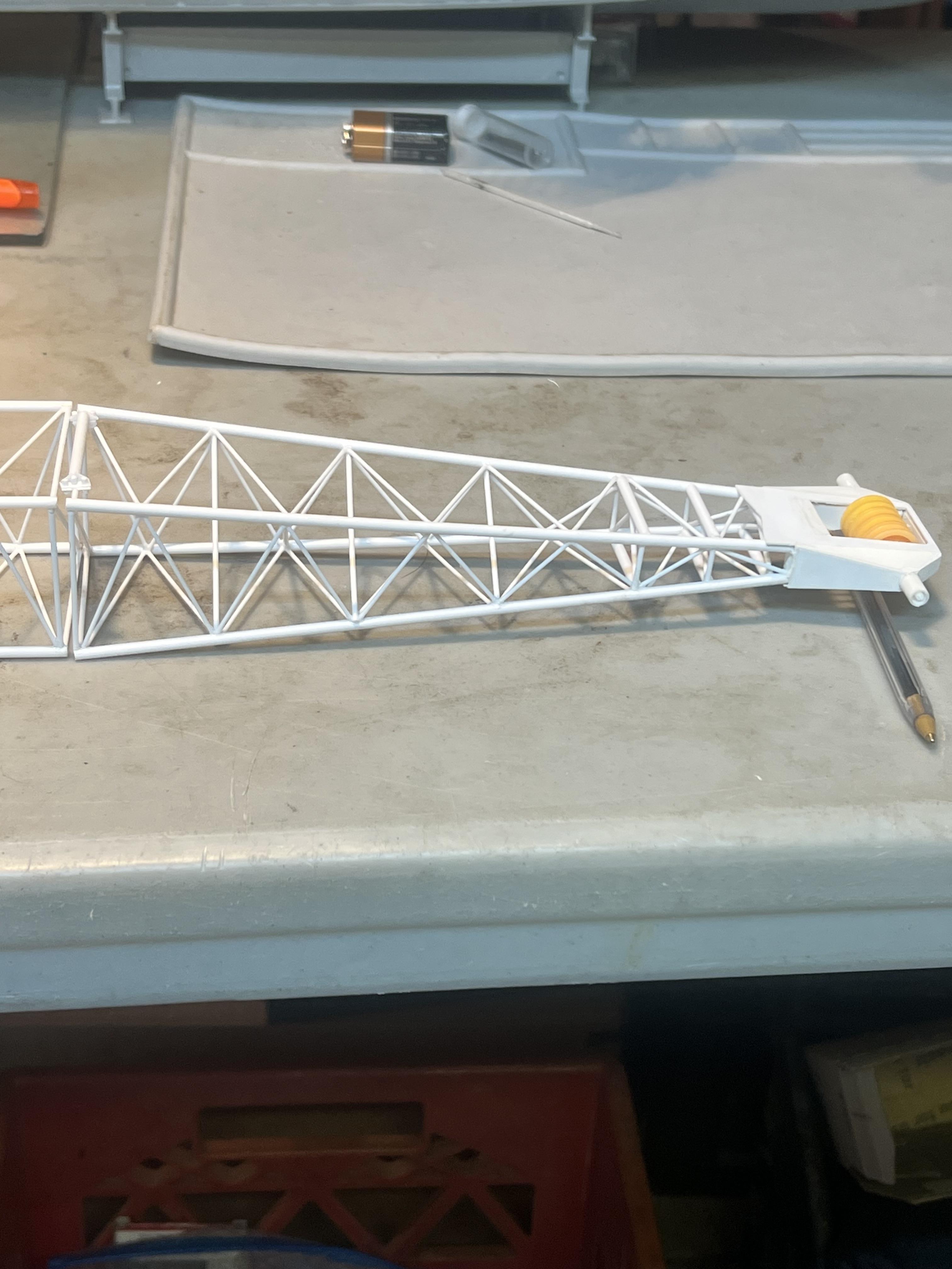

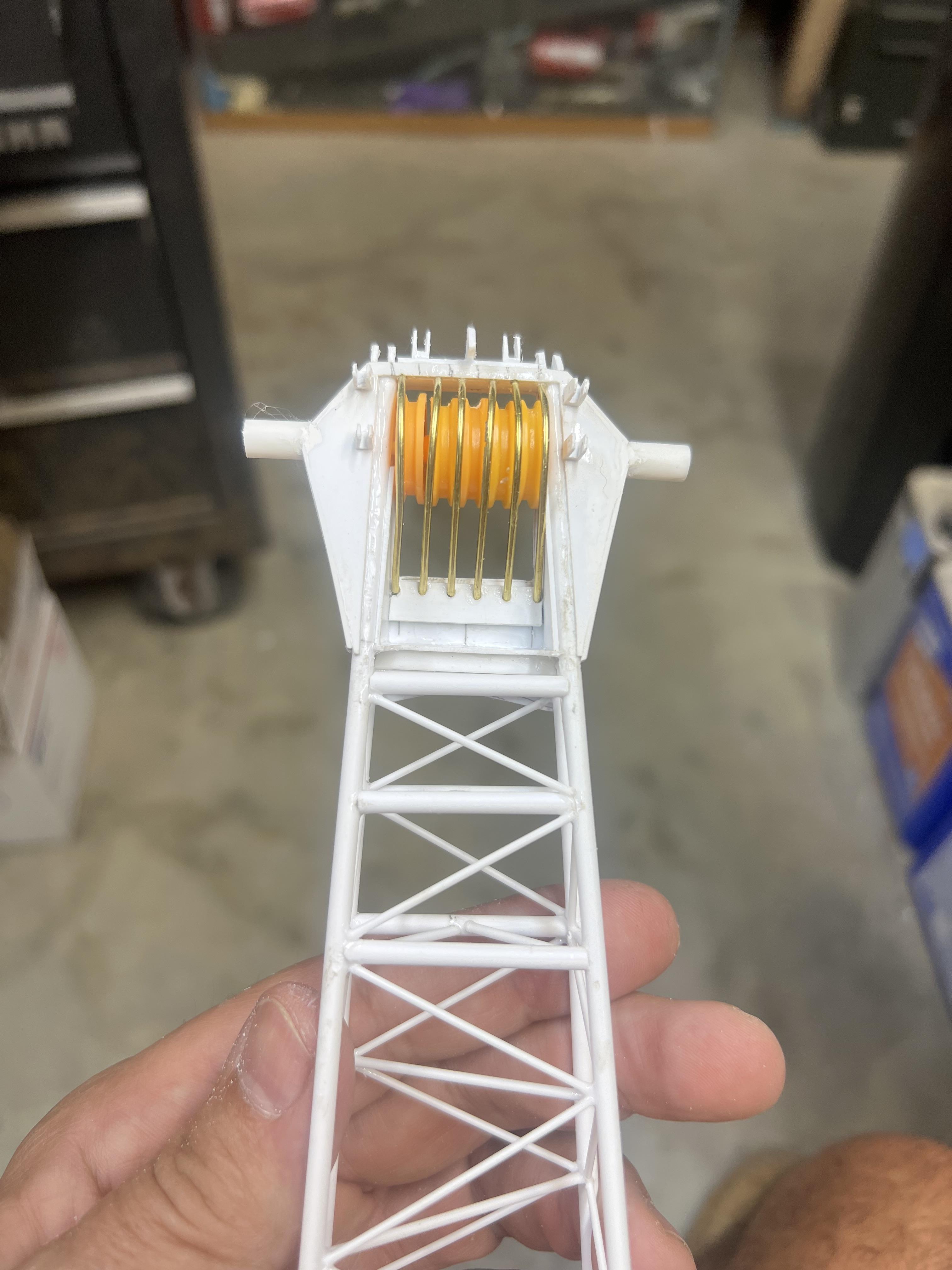

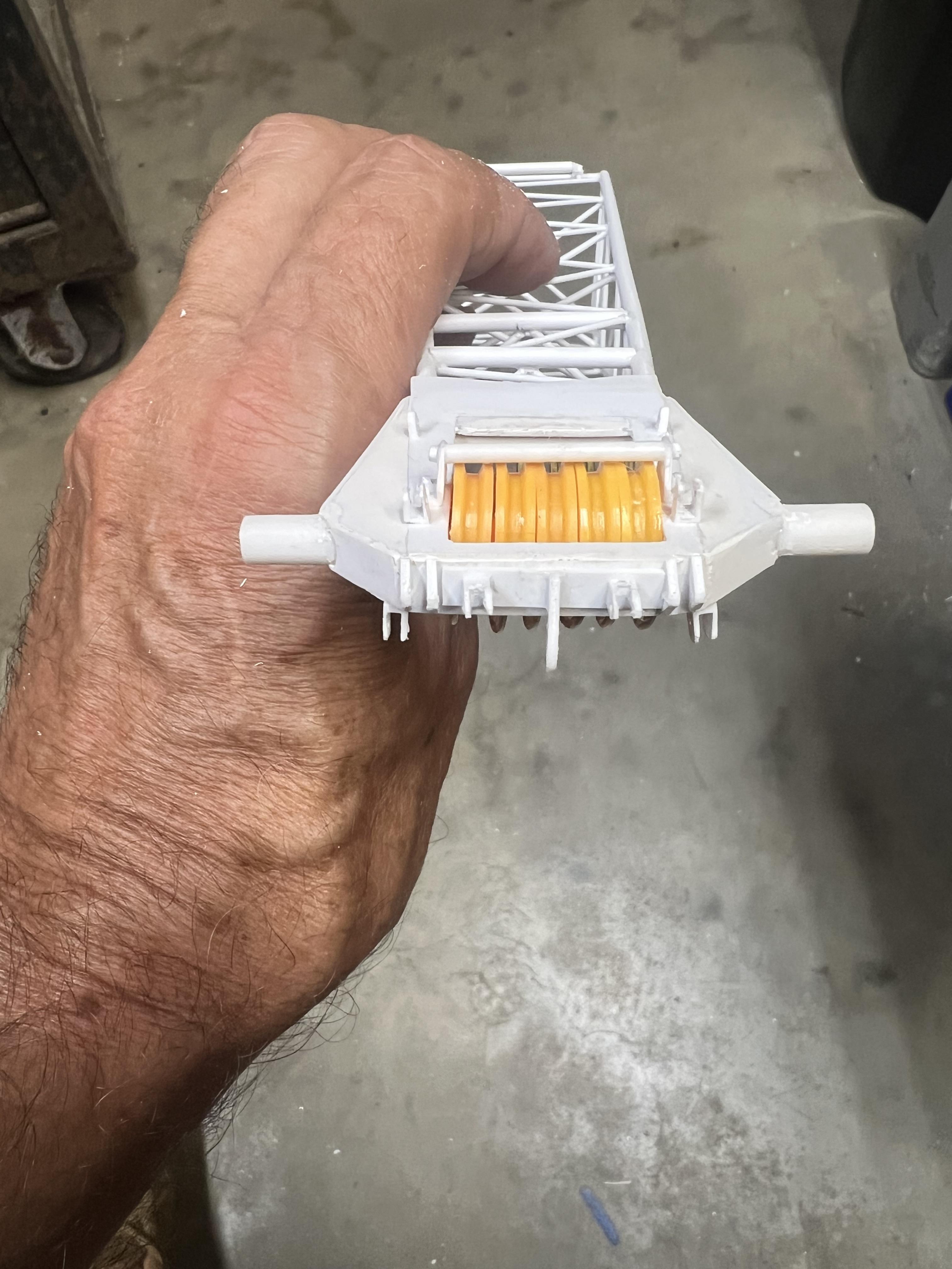

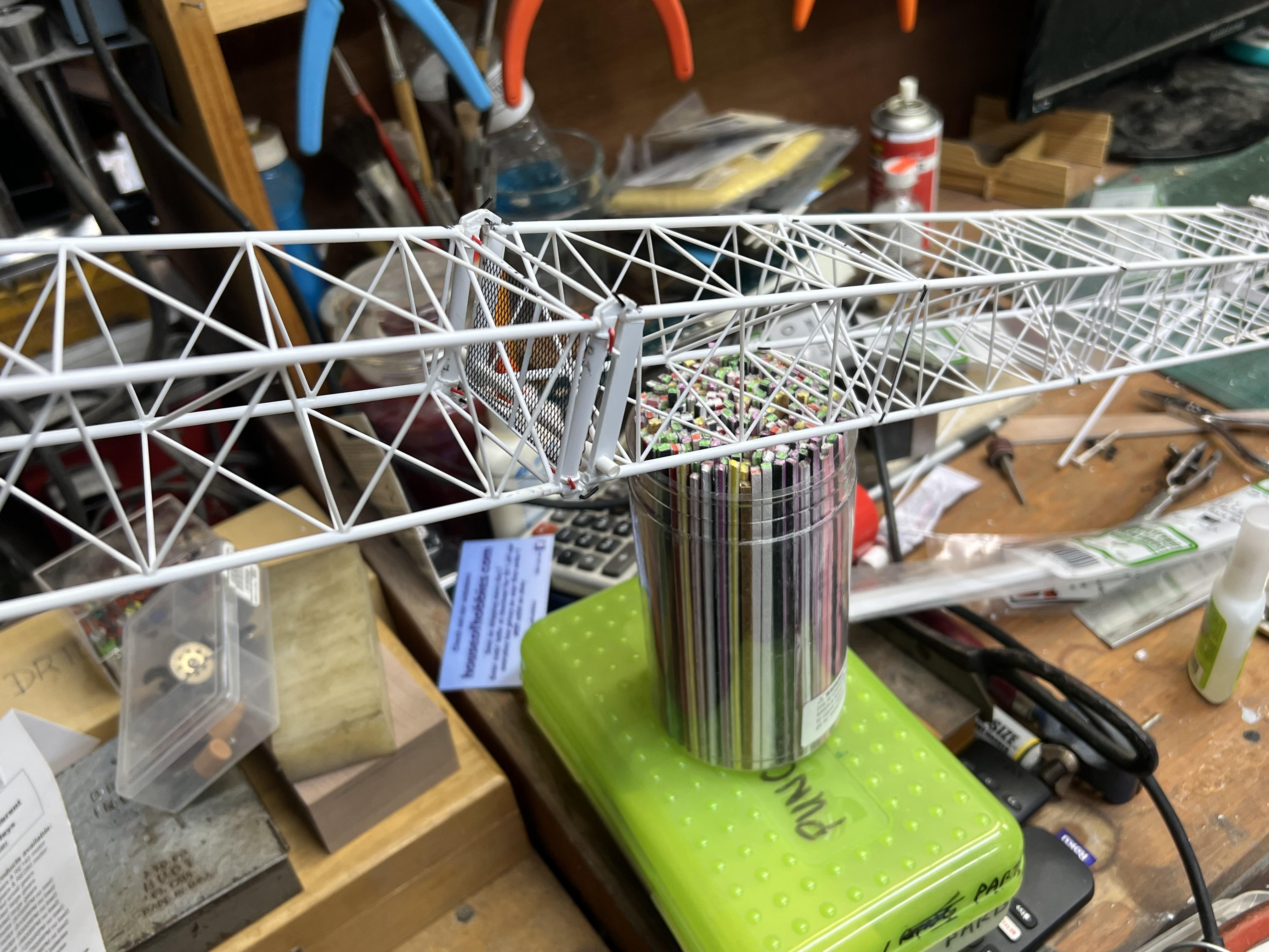

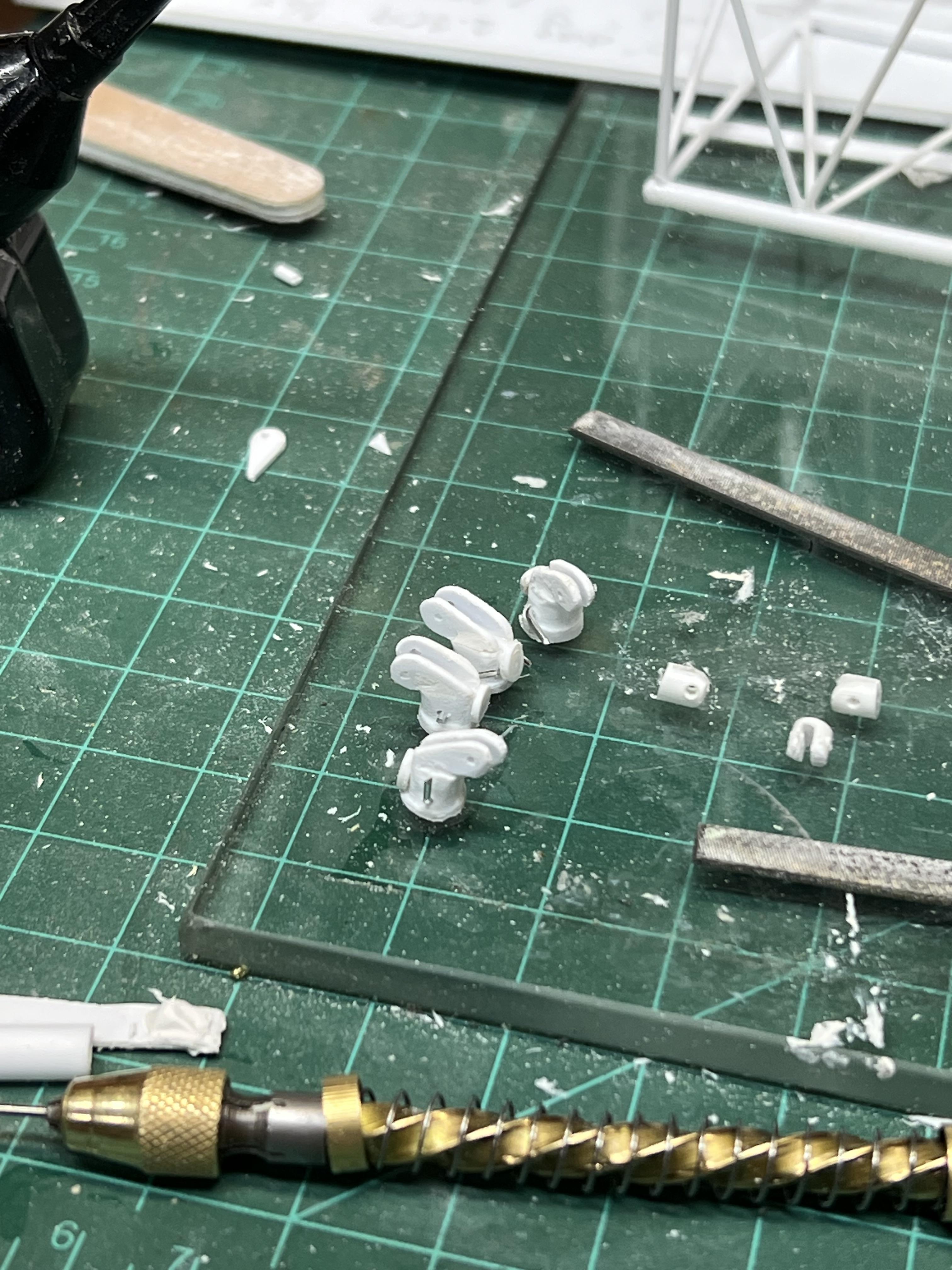

Added all the little attachment points to the head gear for the folding tires, the jib, and the lifting link.  Feels great to be getting things done with this build.  Appreciate all the good words from everyone!
  • Like 5

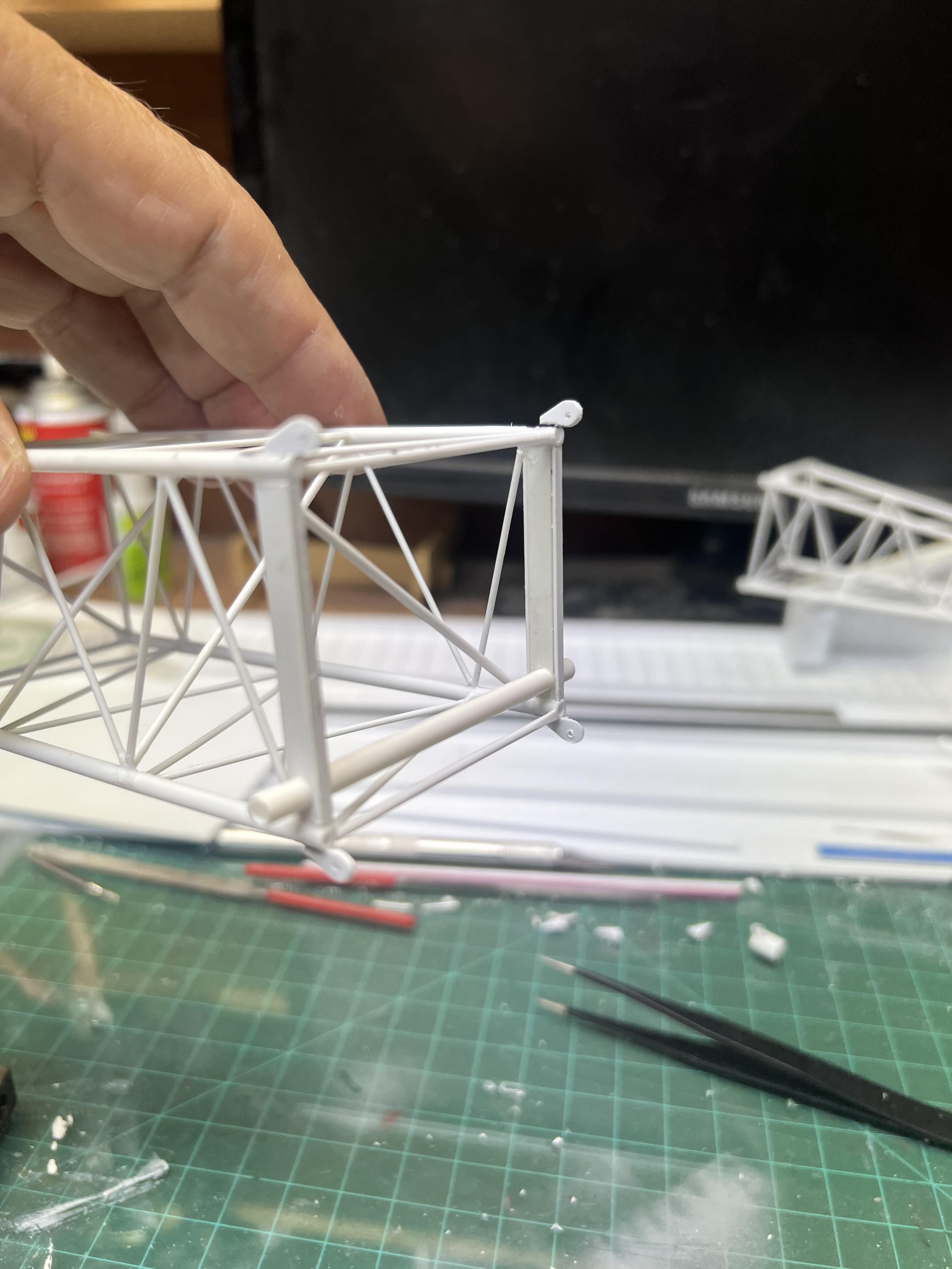

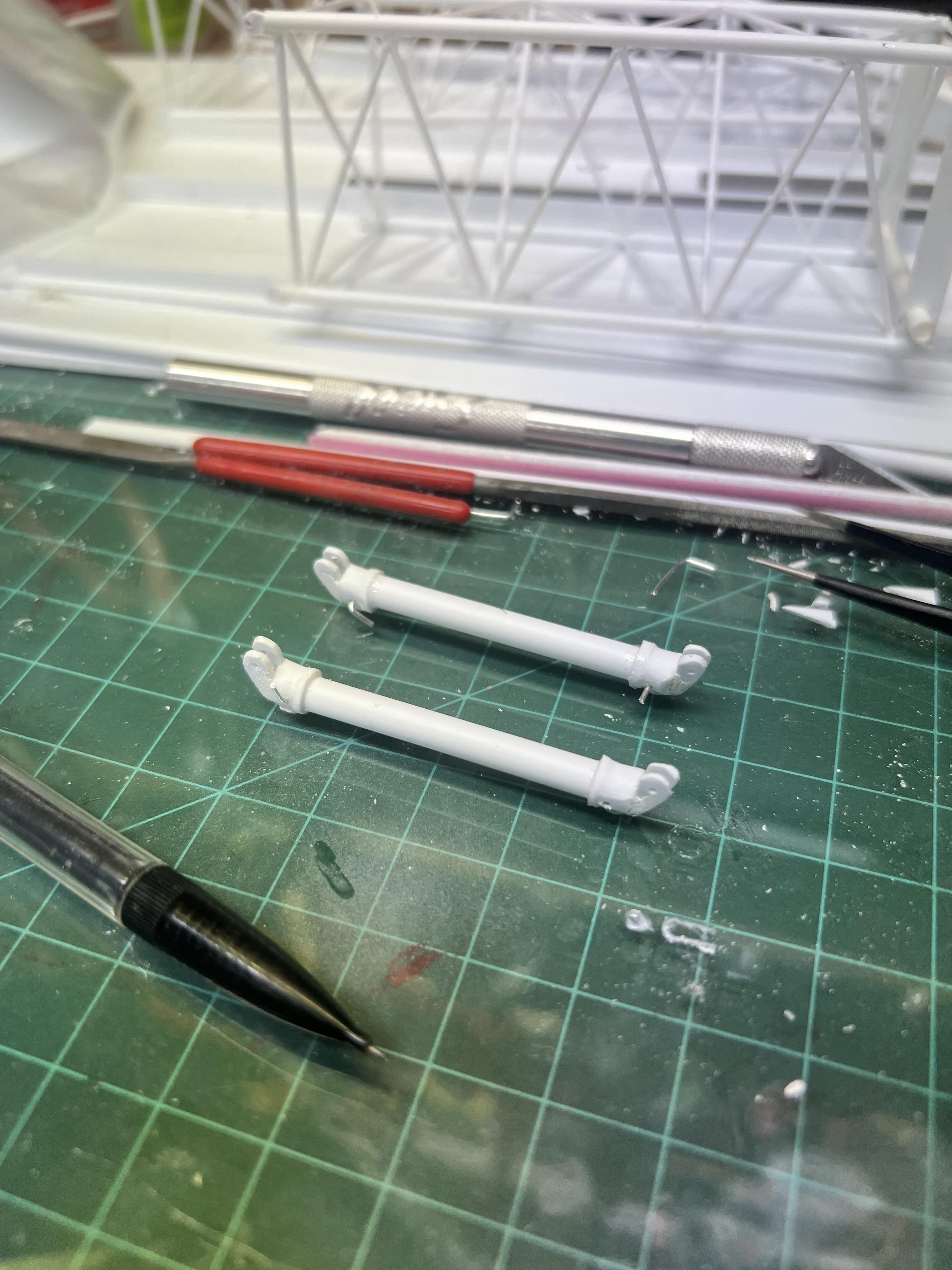

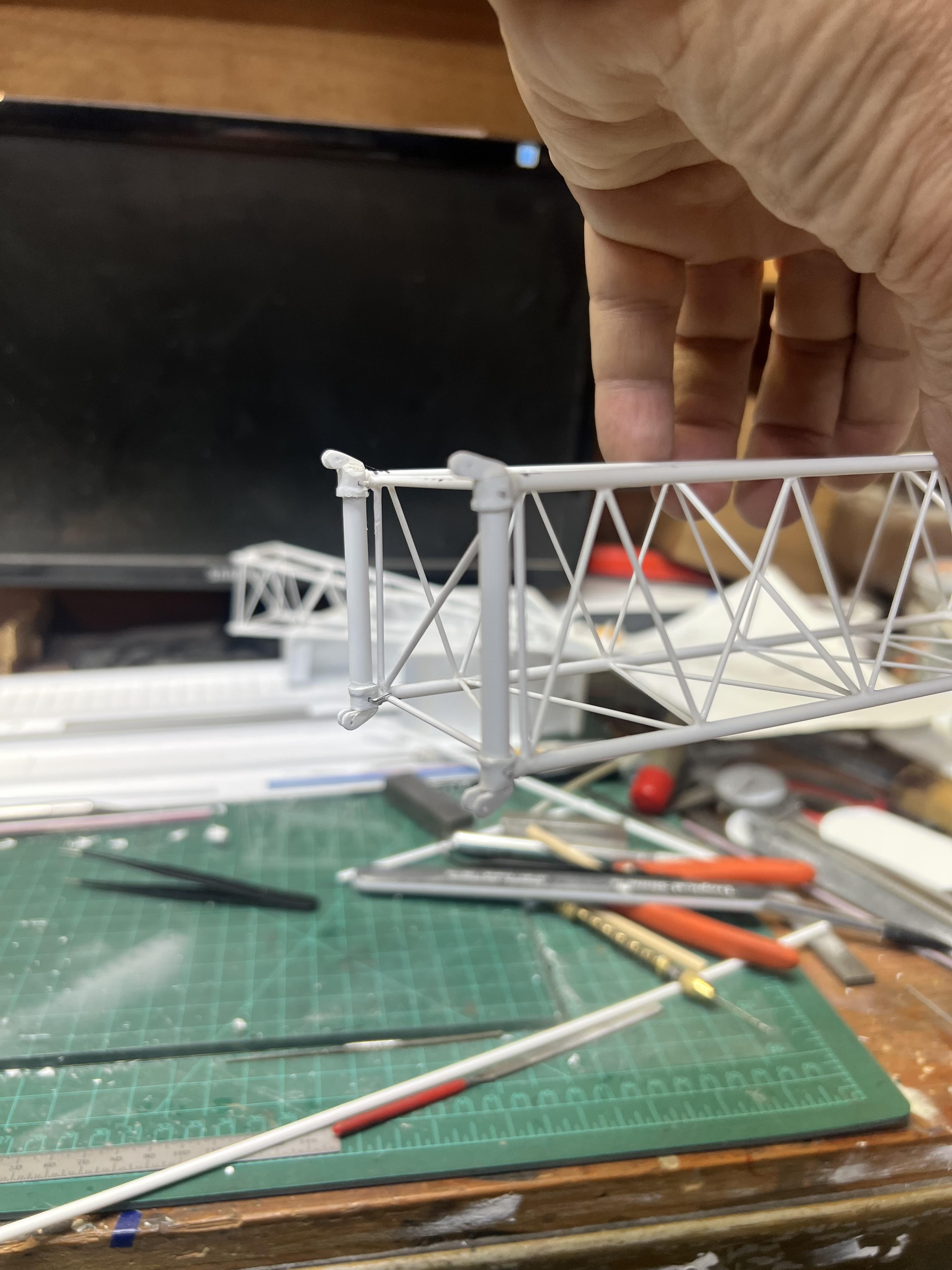

Made up the boom folding tire assembly tonight.  Needs some finishing touches but you get the idea.  Glue has to dry before I can do that.  Taking my bride out for a short 50th Anniversary jaunt, so it has until Monday to dry!
  • Like 6

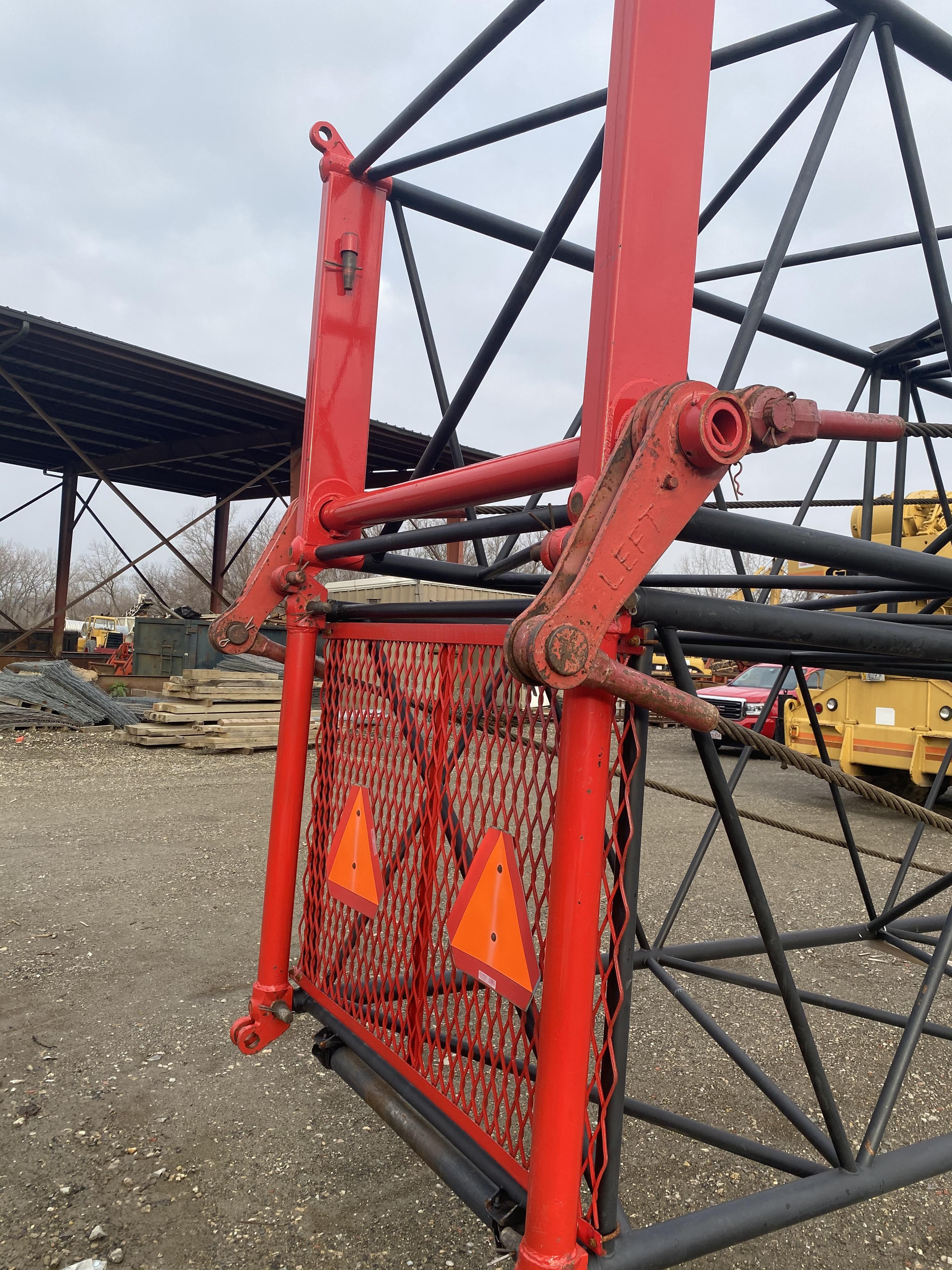

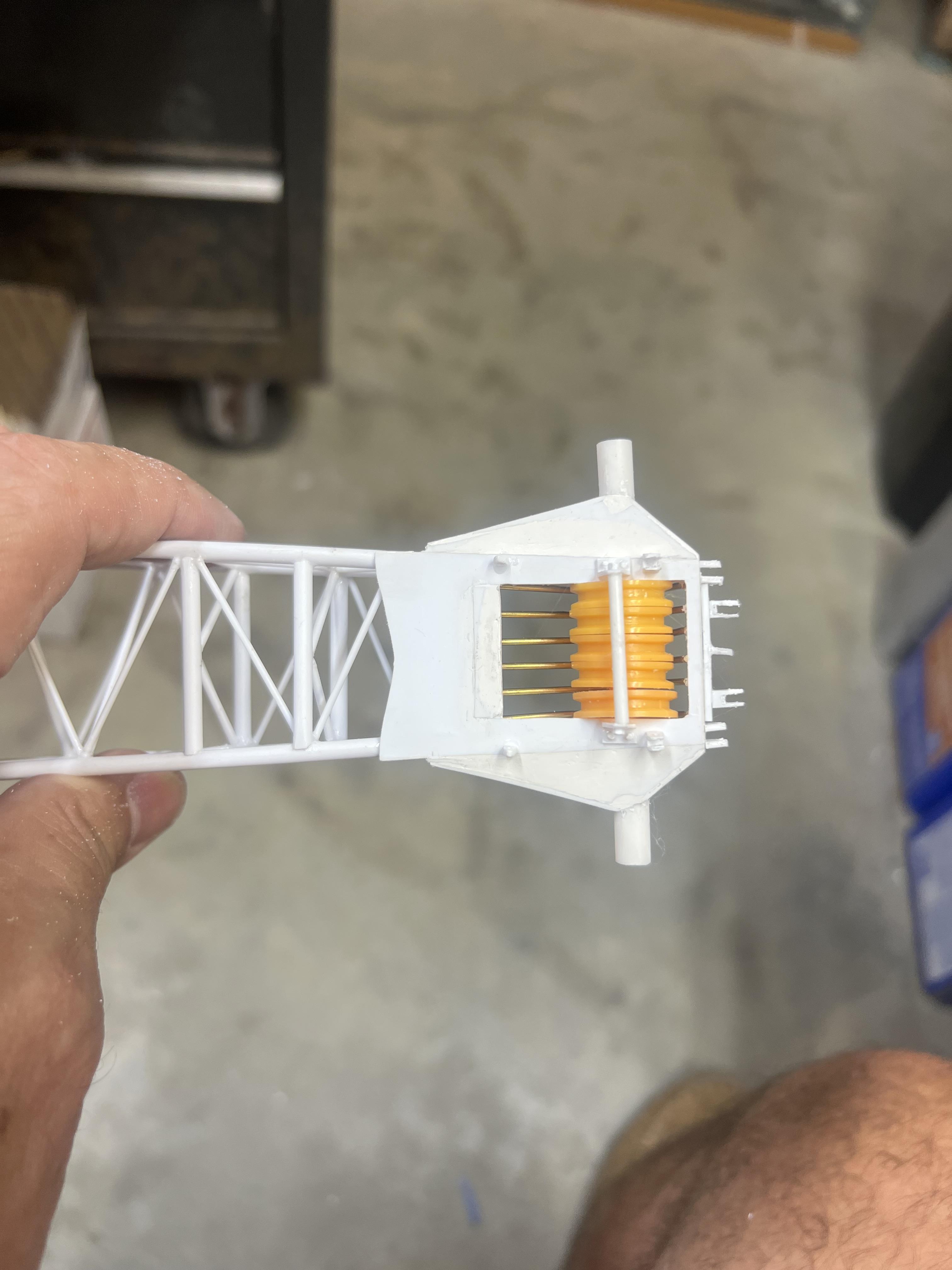

This is the boom folding tire assembly in place.  It attaches to the very end as shown and when the boom is folded to where the folding end is vertical, the boom is lifted and the two wider attachment points are detached, rotated around the axle and reattached to the other side of the head gear, boom is then lowered and folding continues until it is folded, then a link is attached from the center point in the end to the main boom. The axle will be trimmed and finished after painting. I don’t intend to have this on the finished crane as the boom will be in working position, but it will be stowed on the carrier. Also shown is the actual crane I am trying to replicate, with the boom folded. This was taken last fall on a local job.  It has 100’ of boom in place in this photo, as I am building this one to match. It is capable of 210’ of main boom and a 30’ jib totaling 240’.

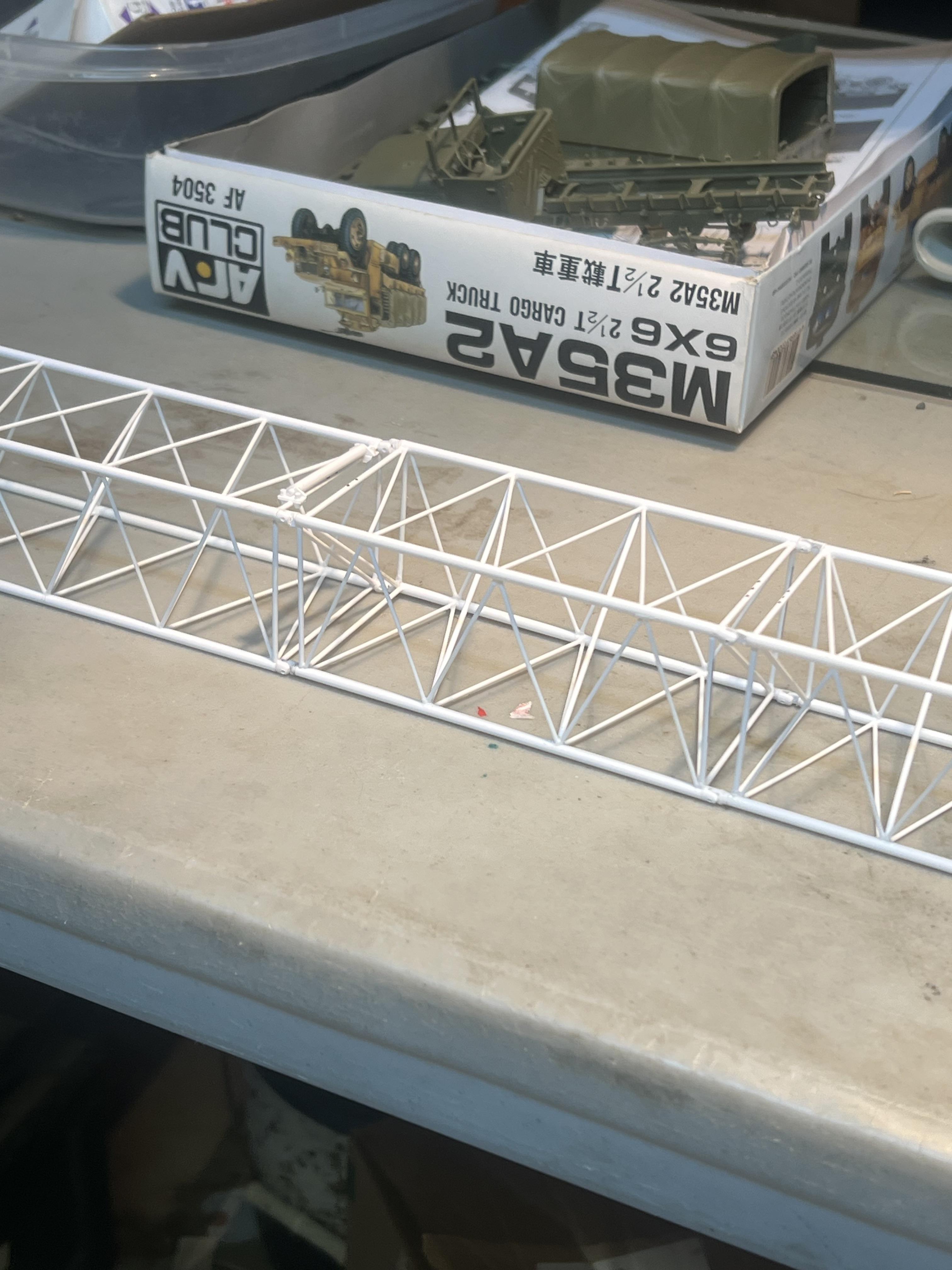

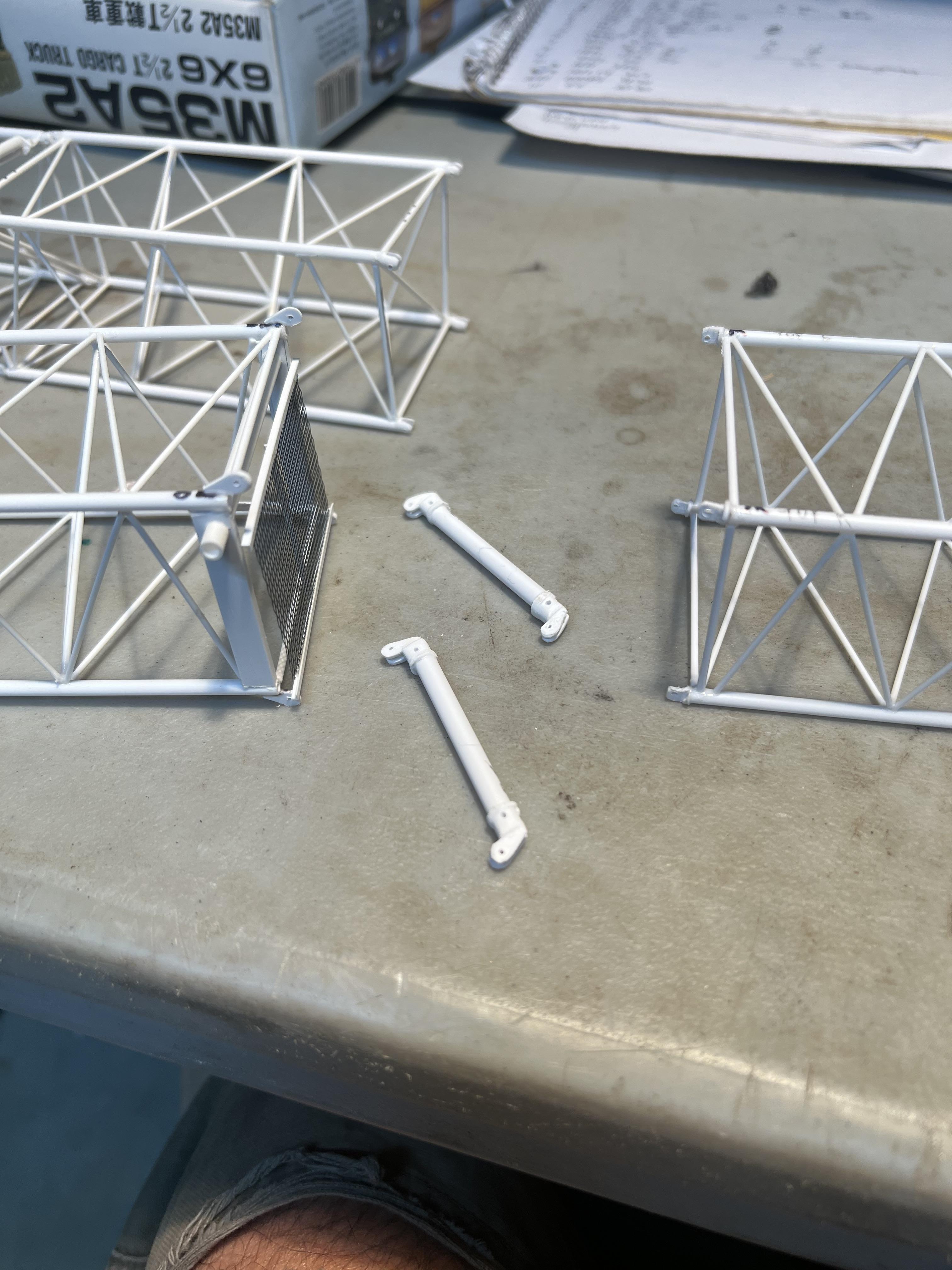

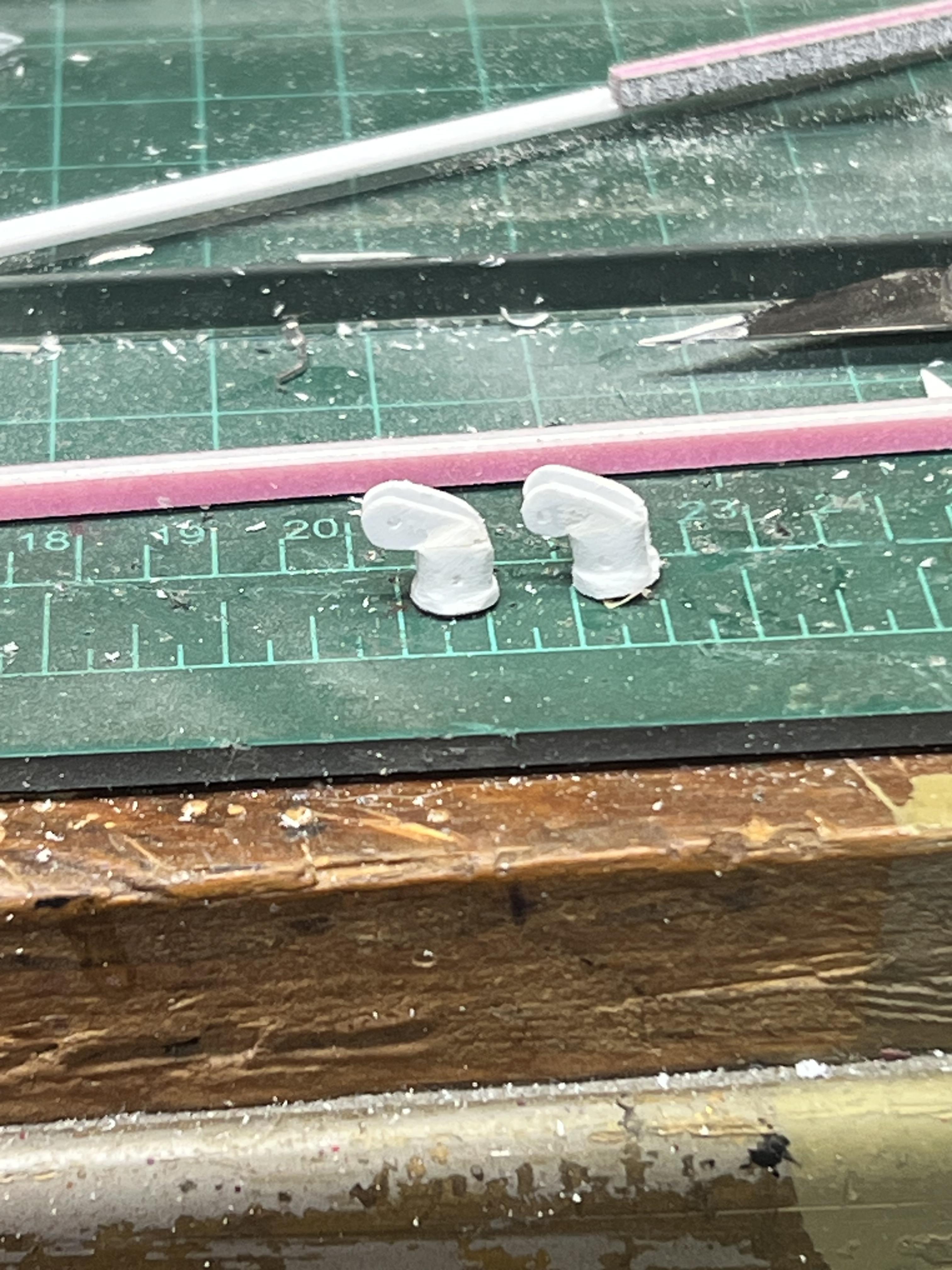

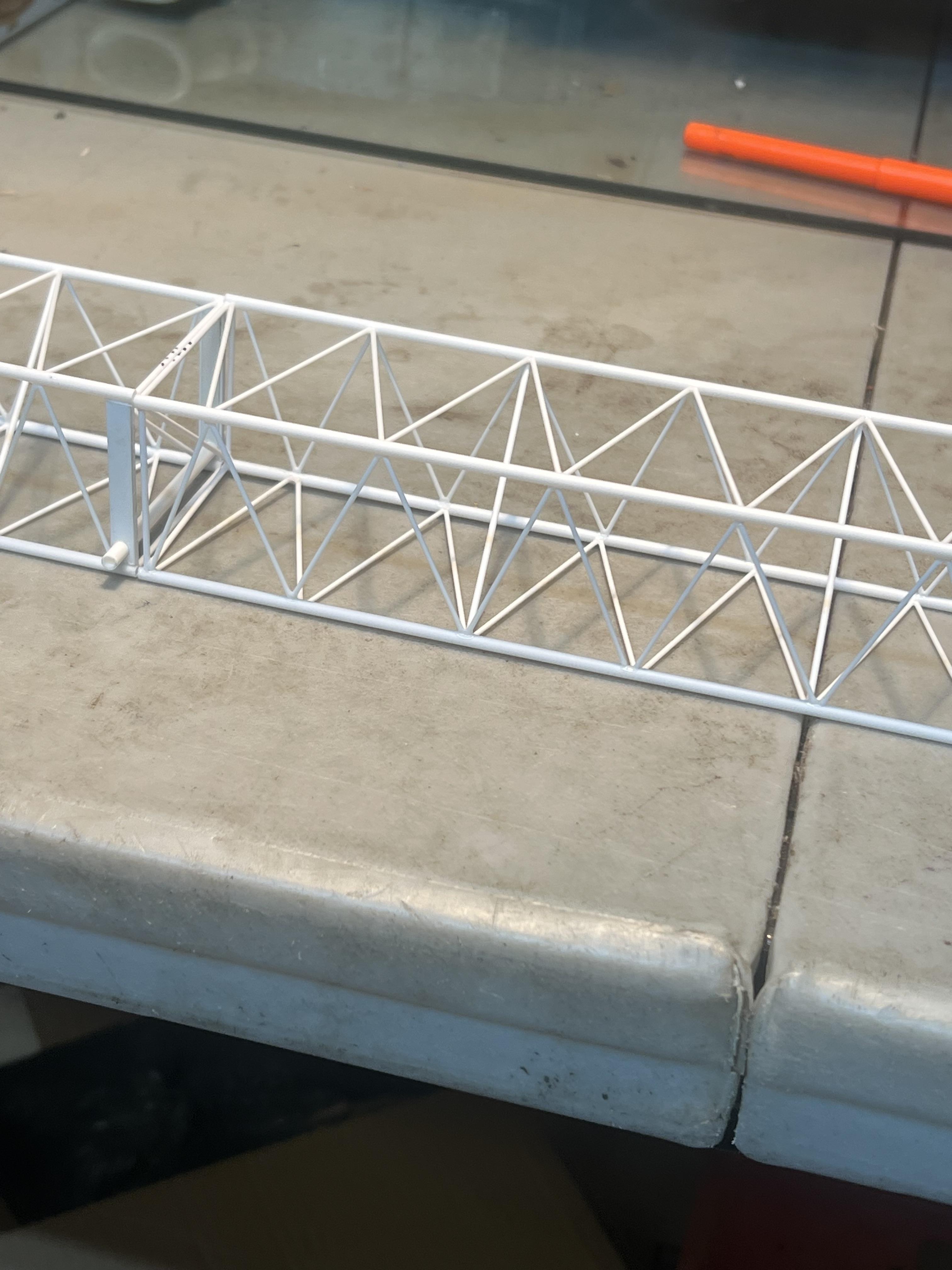

Just finished up the folding boom joint assemblies, the offset joint pieces on the 20’ section are removable so they can be put on any section.   Added the offset male parts of the joint to the short folder section. Just gotta wait for all the glue to dry and will pin it all together and see how it looks and works.  This is totally a static model, and the boom will be assembled and not folded, but what’s the fun in designing all the working parts into it if you can’t prove they work?!

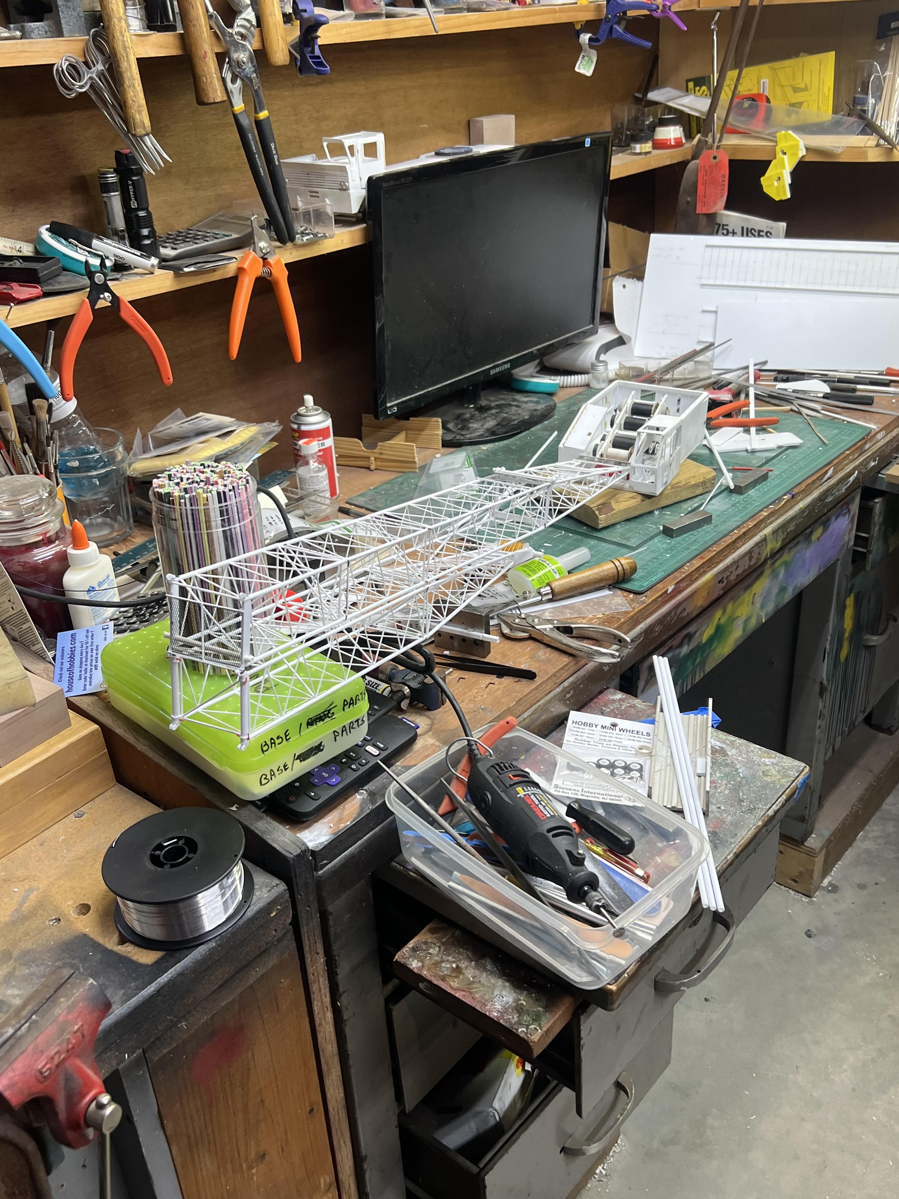

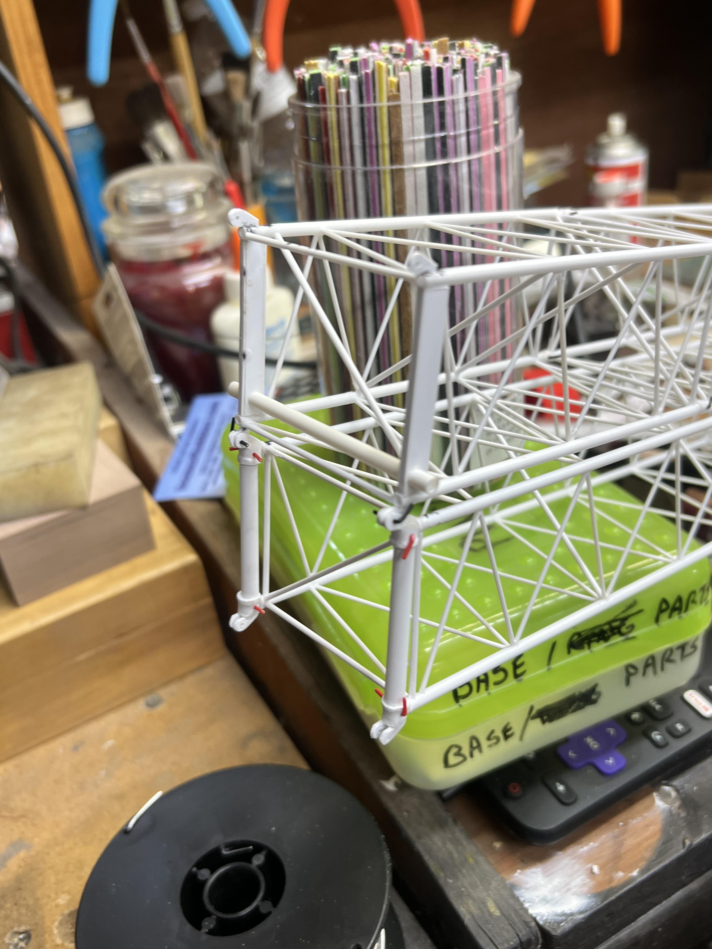

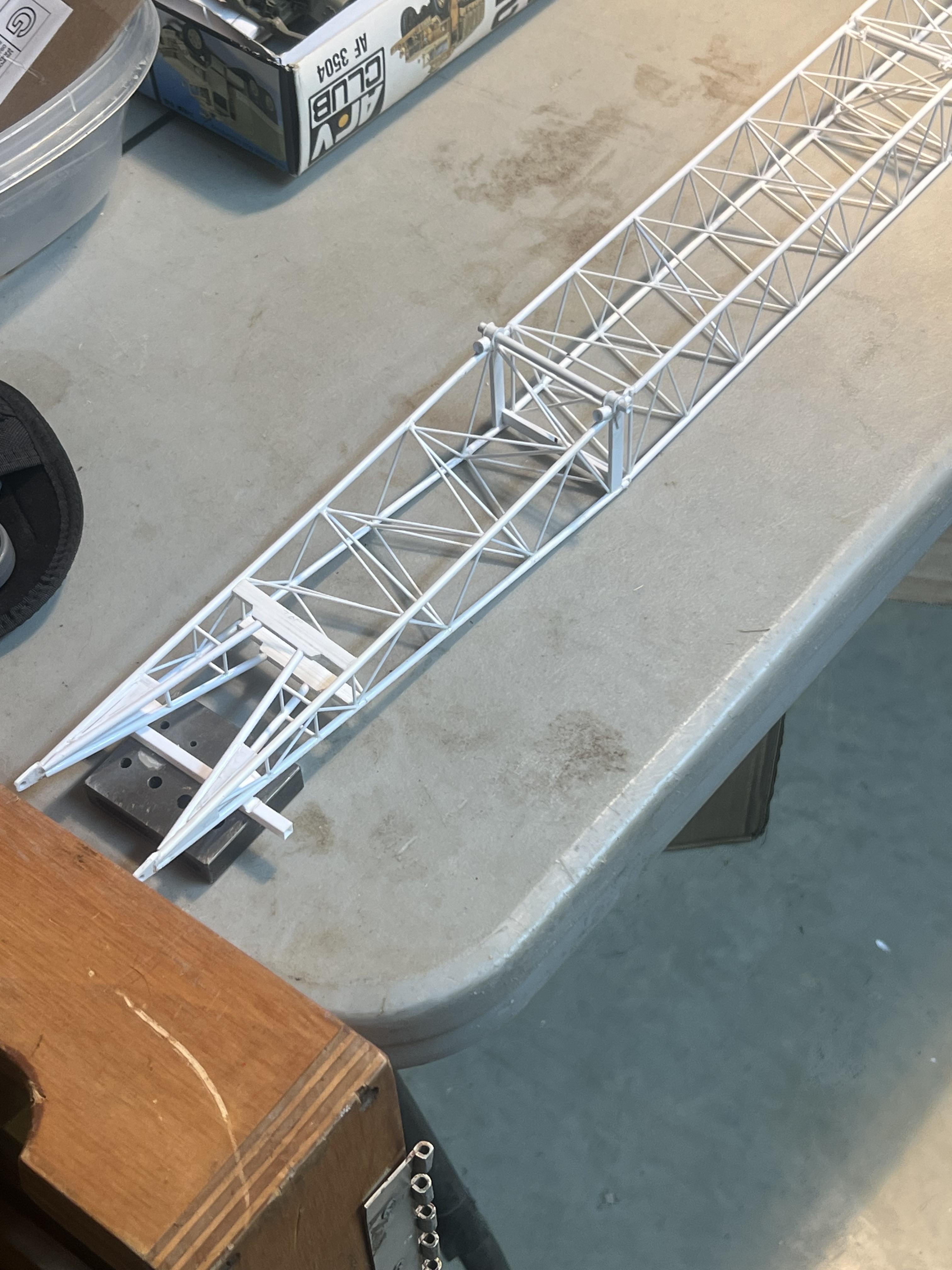

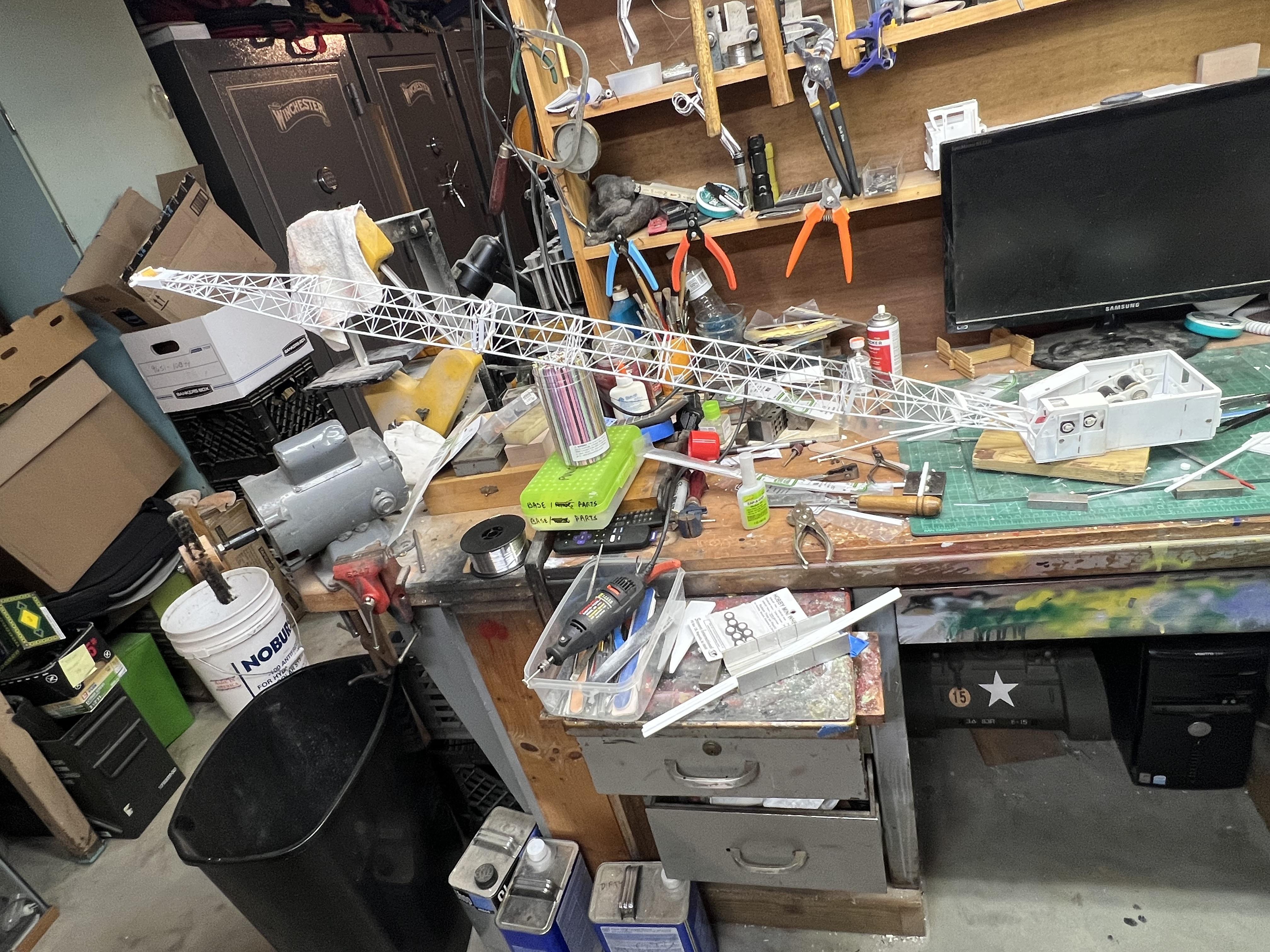

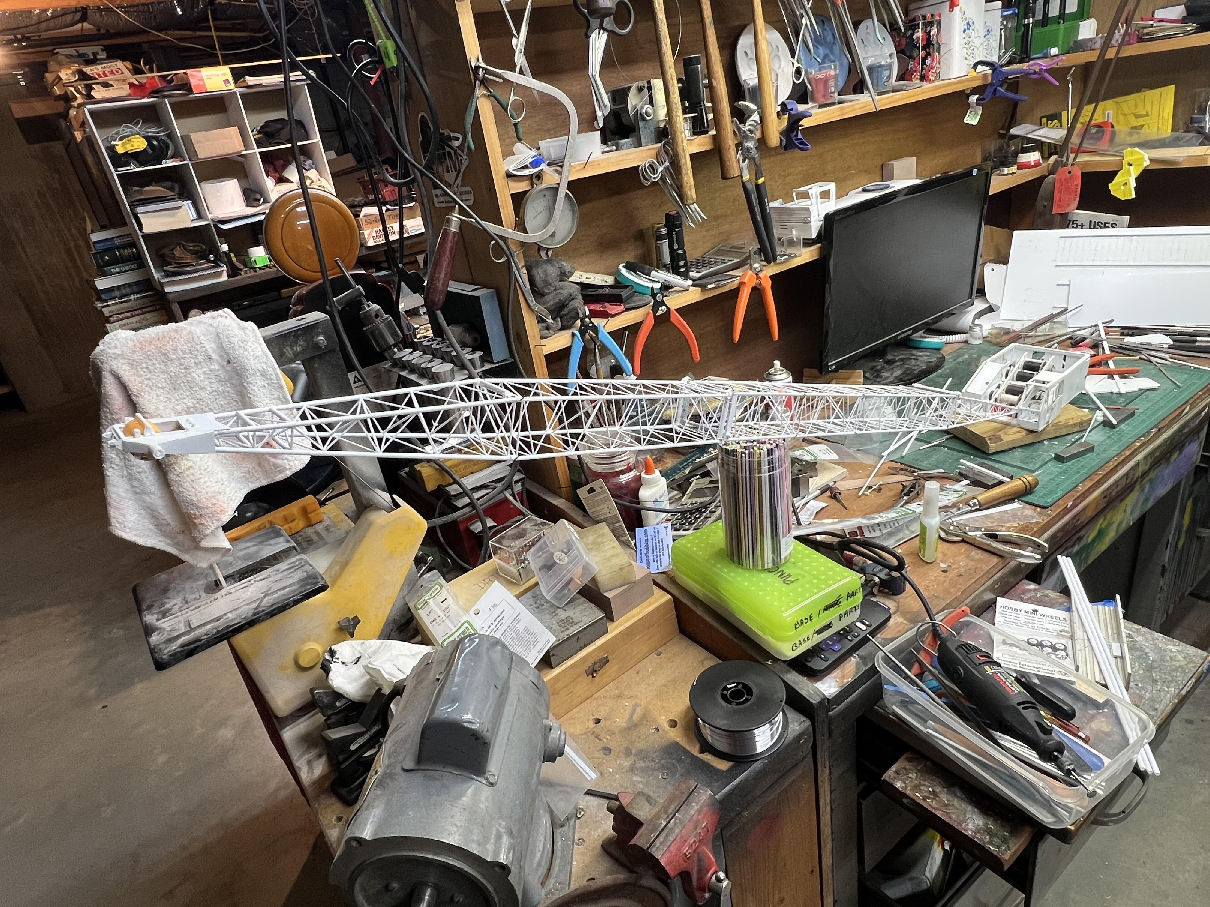

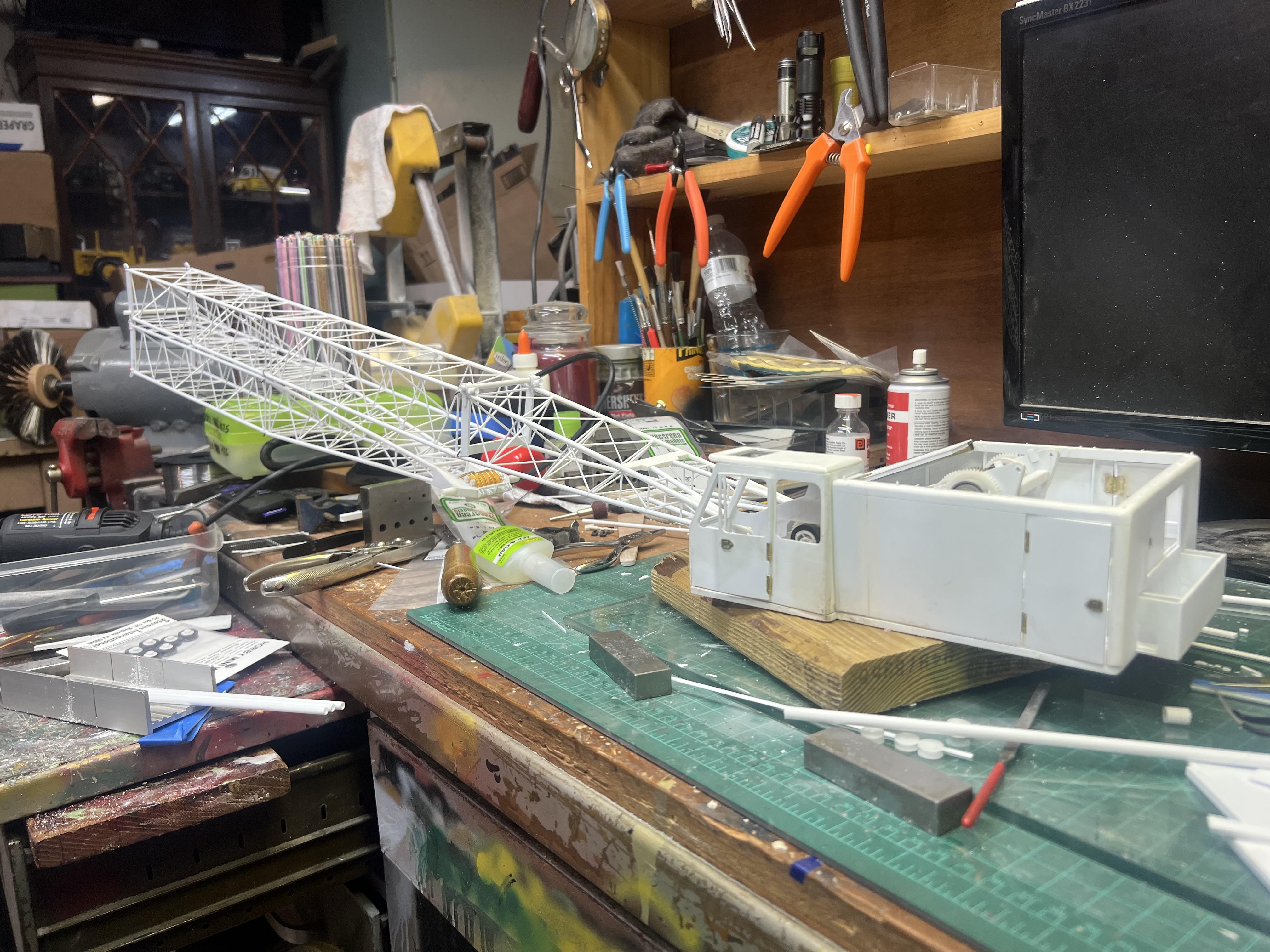

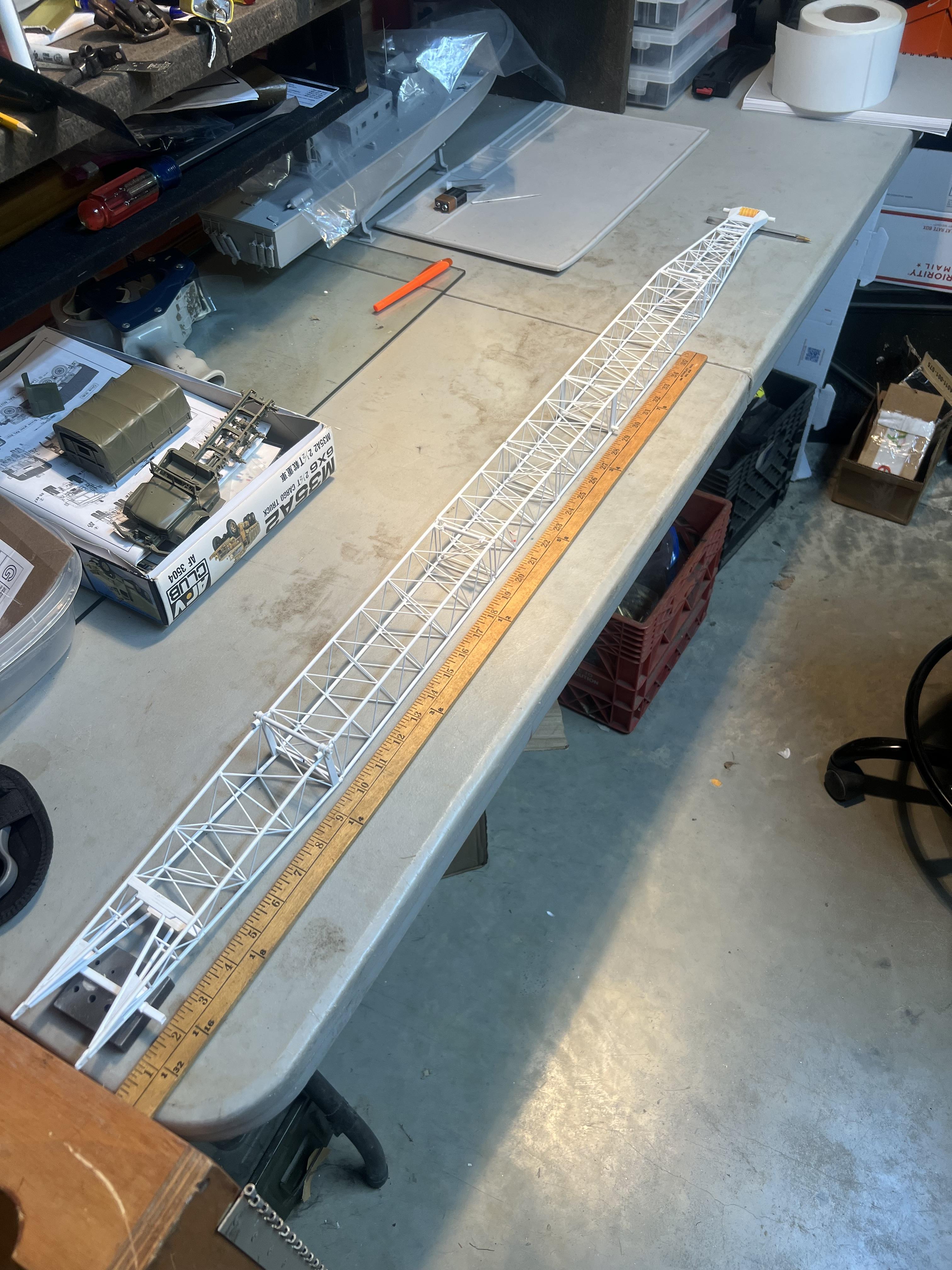

Well, reached a milestone in this project today.  I got the boom folding points all done and installed and for the first time, got the entire 100’ of boom all assembled and pinned together.  And then, of course, I had to try the hinge.  And it folded perfectly.  Shown is the boom attached to the upper assembly, which I have mounted on a work board instead of the carrier.  And then it finally hit me, where the heck am I going to put this monster when it is done?a.  Sure am happy I decided to only build 100’ of boom!  I still have to  make all of the pendant attachment points, the bridle, the live mast, the boom backstop, the bail, the counterweights and their removal system, and an endless list of little stuff! But this is a huge point in this build.  Thanks to everyone’s words of encouragement! I hope to display it with the boom raised, and for transport I am thinking of quick attaching cables etc, so that the boom can be in one 4’ piece.  Time will tell……LOTS of bridges to cross before that!
  • Like 4
